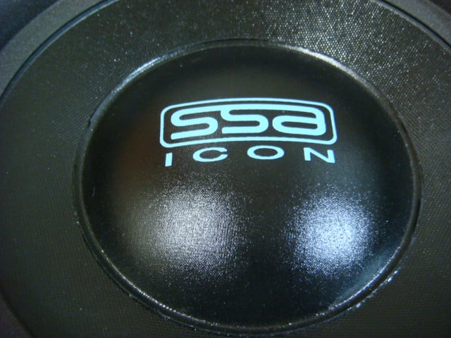

Posted December 17, 20169 yr Popular Post I scored this classic ICON the other day. It's brand new and has never seen power. it was in the original box from SSA with the stickers and brochure and the blue foam pads were still intact. I was told it was a D2 so I planned on wiring it in series and powering it with a US Acoustics 2300 at 4 ohms bridged. I hooked up the US Acoustics and it was screaming and then the fan kicked on immediately. I hooked up my DMM and found out the ICON is actually 1.5/1.6 ohms. So wiring in series results in 3.1 ohms and not 4 ohms. I just sold my US Amps USA-1000 so the only amp I have left that would be able to handle the new ohm load is an older US Amps USA-200. It's rated at 520W x 1 @ 2 ohms bridged. I know the older US Amps are underrated but do you think it'll be enough to push the ICON? I'm going to be putting it in a 1.1 cu/ft sealed enclosure. If it doesn't hit the lows like I think it should, I'll build a ported enclosure for it.

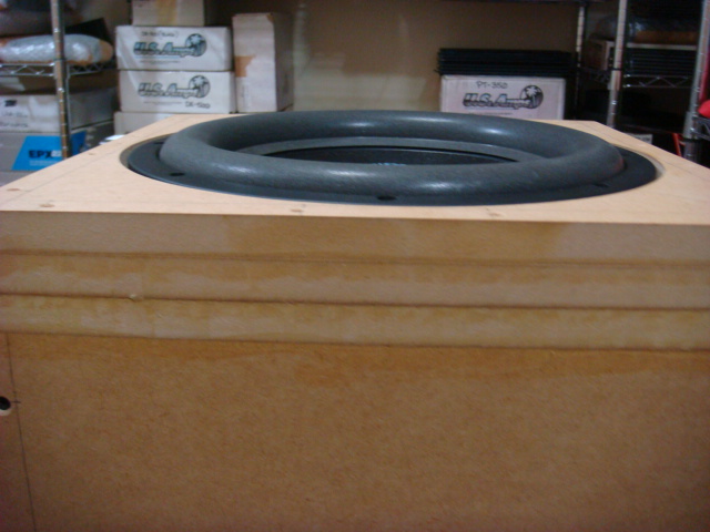

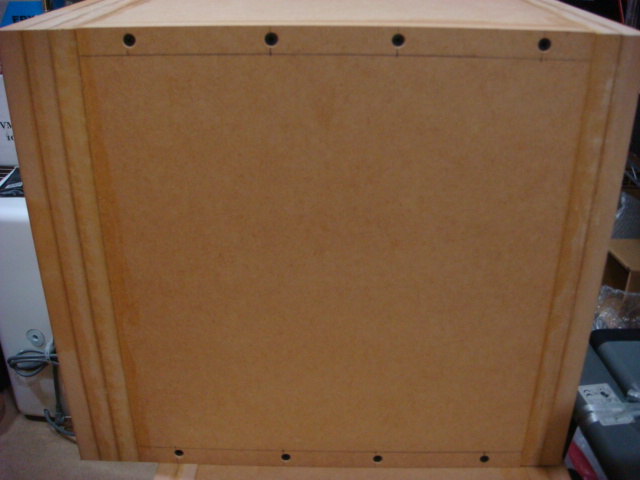

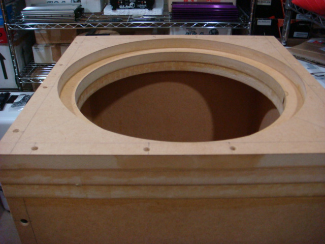

February 5, 20178 yr Author Life got in the way (daughter got sick and then the wife and then me) and postponed my build until this weekend. Just finished glueing and screwing MDF. I doubled up the rear and front panels and added a third on the front for a flush mount. The cutout diameter in the sketch ups state 11 3/16", which was a little big. I think I should've used the specs on the website (11.150") and sanded it down. I'll remember that for the ported box next time. I have 2 pieces cross-bracing the sides (2 top-to-bottom and 2 left-to-right). I'm going to use T-nuts to secure the ICON. Waiting for glue to dry to finish the enclosure... In the meantime, I hooked up the ICON to the PC1400...I have to say I was a little disappointed. It was not very powerful like I had imagined it would be. I think it was only getting the 400W @4. I think I've narrowed my amp choices down to the US Amps PT-1100, US Acoustics 2300, or Kicker ZR600. I have a ZR1000 but it's getting repaired and think that might be too much of a power drain for a daily driver. The ZR600 should be plenty if I go that route. Any advice on which amp I should run? I'll post some pics once it's all together.

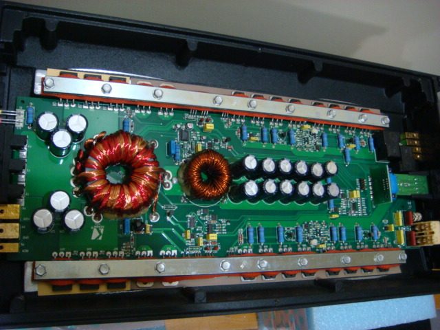

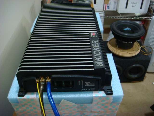

February 15, 20178 yr Author Good news... I got the Kicker ZR600 today. It looks awesome! The first thing I did was take the bottom cover off and inspected the guts...beautiful! I hooked up the DMM and o-scope and set the gain. I set it to 60V (it didn't start to clip until around 70'ish). I hooked it up to the ICON and did some freeair. WOW!!! This is going to be great. Now for the not great news but I can deal with it news... When the ICON was digging deep, I heard some squeaky/whining noises coming from the amp. I still had the bottom cover off and it was elevated so I could hear it well. It sounded like it was coming from the caps in the center of the board. I emailed a guy that's going to fix my ZR1000 to see if he could verify what the issue/noise is and fix it. I can understand if the caps are going bad. This is an older amp. Anyways, I should have this up and running once the ZR600 gets "touched up". On with the pics...
February 15, 20178 yr Author Here are some pics of the box. I still have to insert the t-nuts and fill in the screw holes. I think it'll be pretty sturdy for the ICON.
