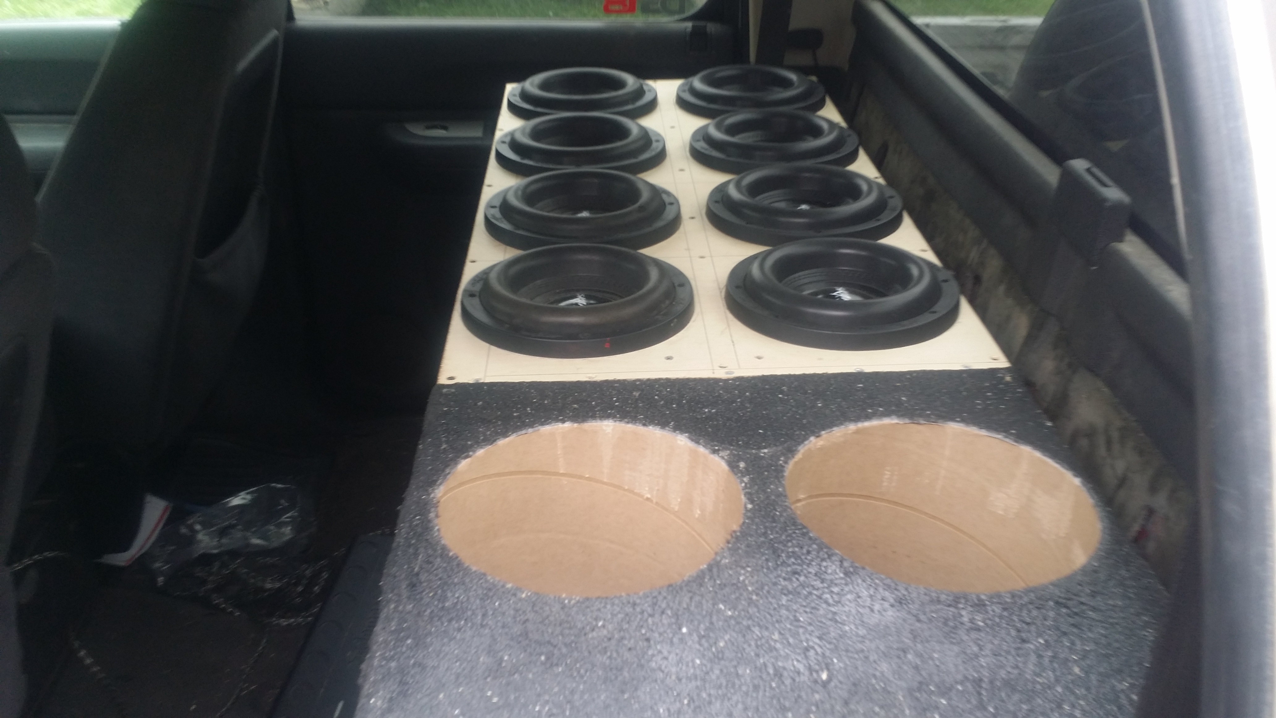

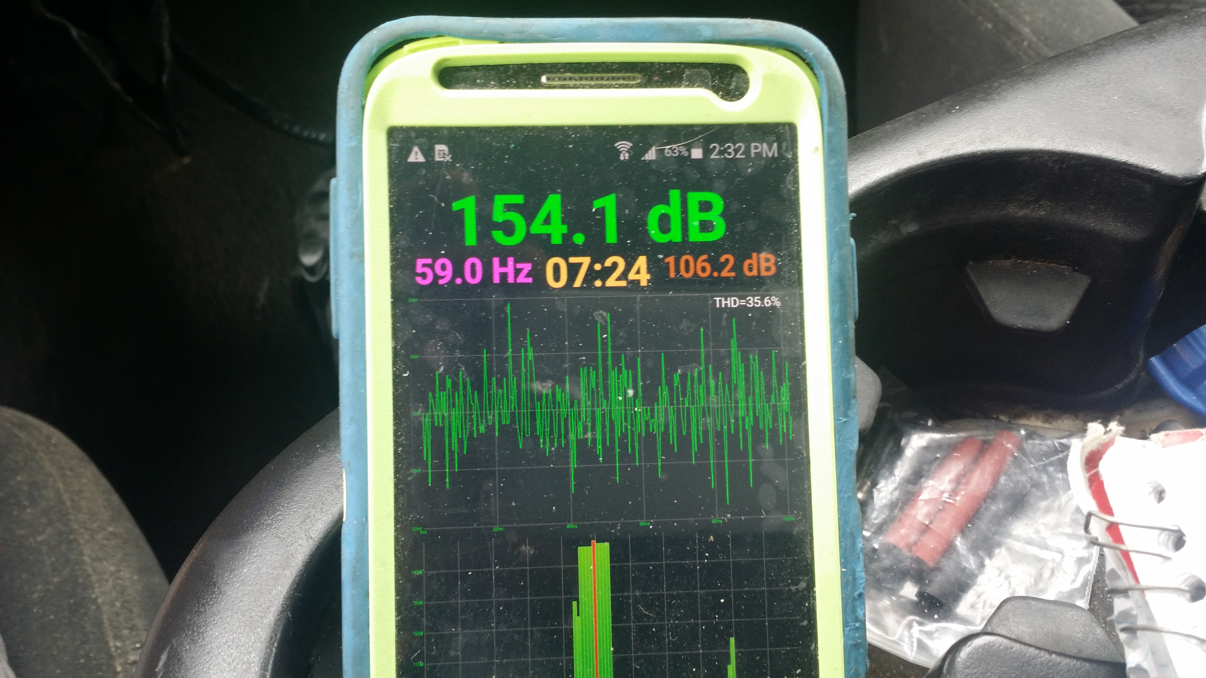

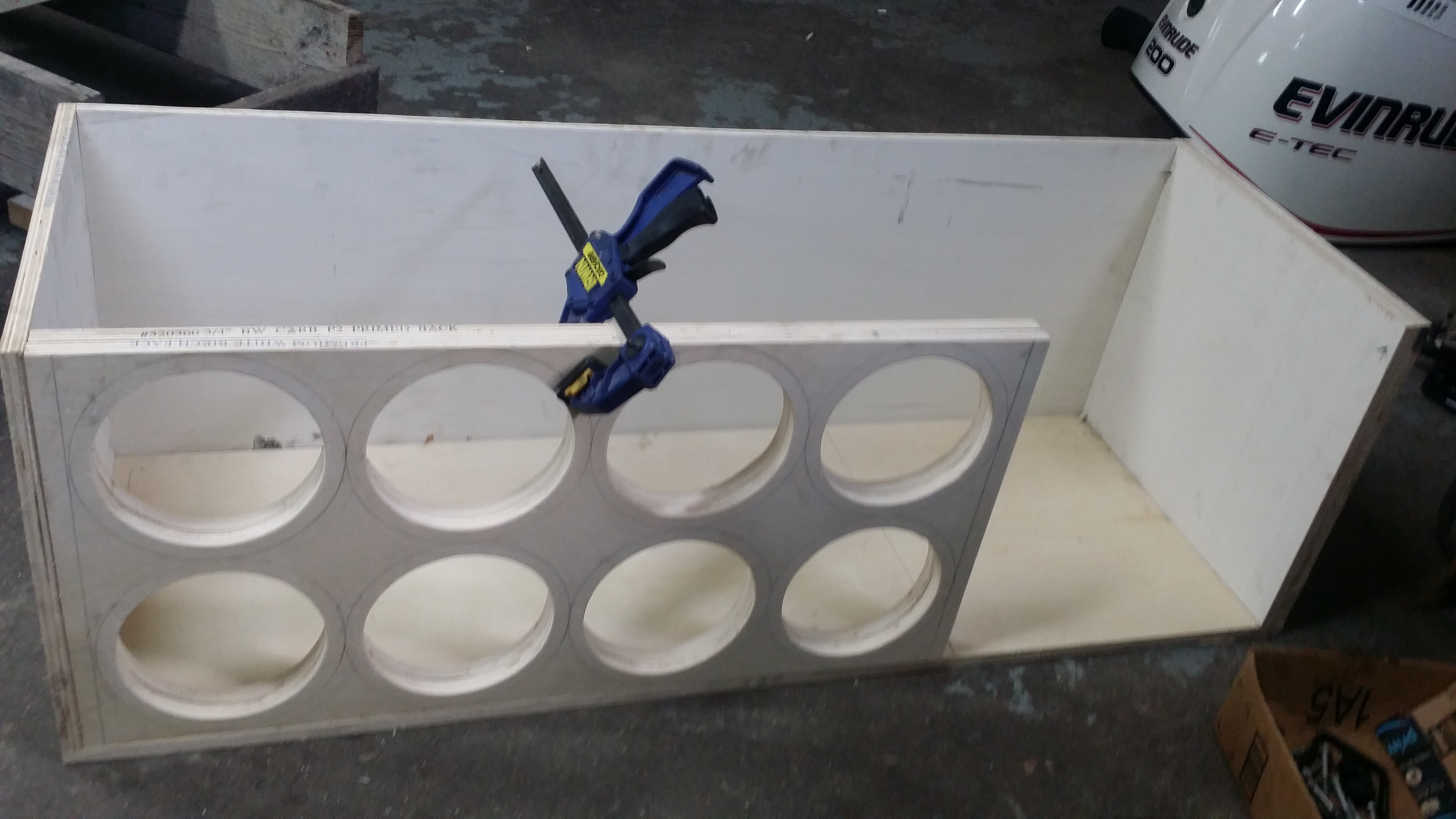

This was just the test box...8 skar zvx 8 's...ran this on a taramp hd 8 k for testing...box is tuned to 34 htrz with the areo port slip in, 55 htrz with the areo port out...so far some good numbers

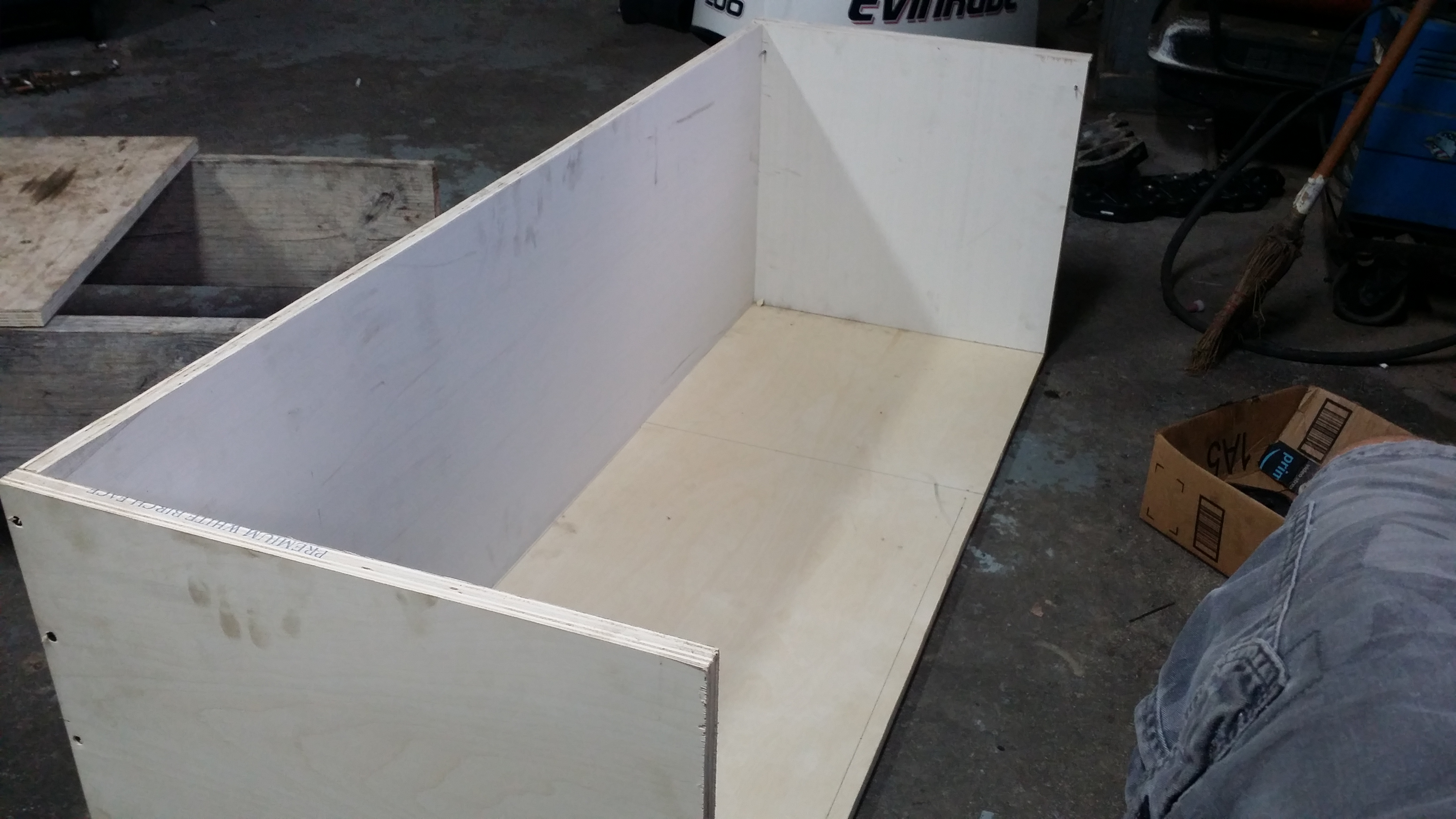

Building the new box for the 12 8's this weekend. .either running 2 taramp 8's or 10's on them...testing was done on 8 's with one taramp hd 8k,3 14 volt batteries and one 350 amp ds18 alternator. Meter in the kick outlaw cause I run usaci.

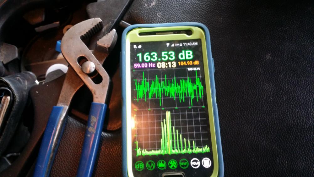

The 18's on a taramp 10.9k did a best outlaw score of 163 and change,streetbeat 30 second average was 158.8

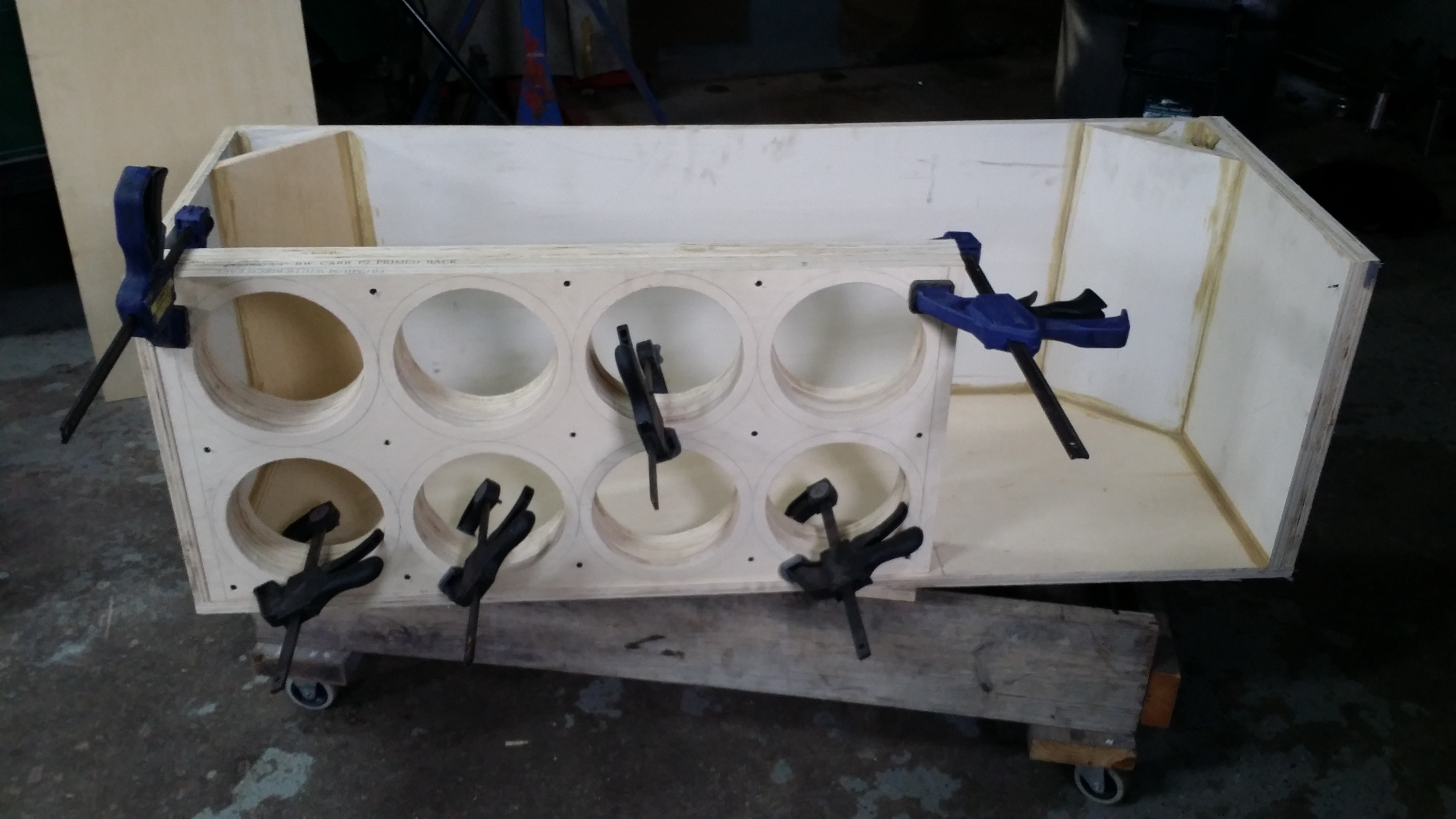

More pics of the 8 8's before I build the new box for the 12 8's

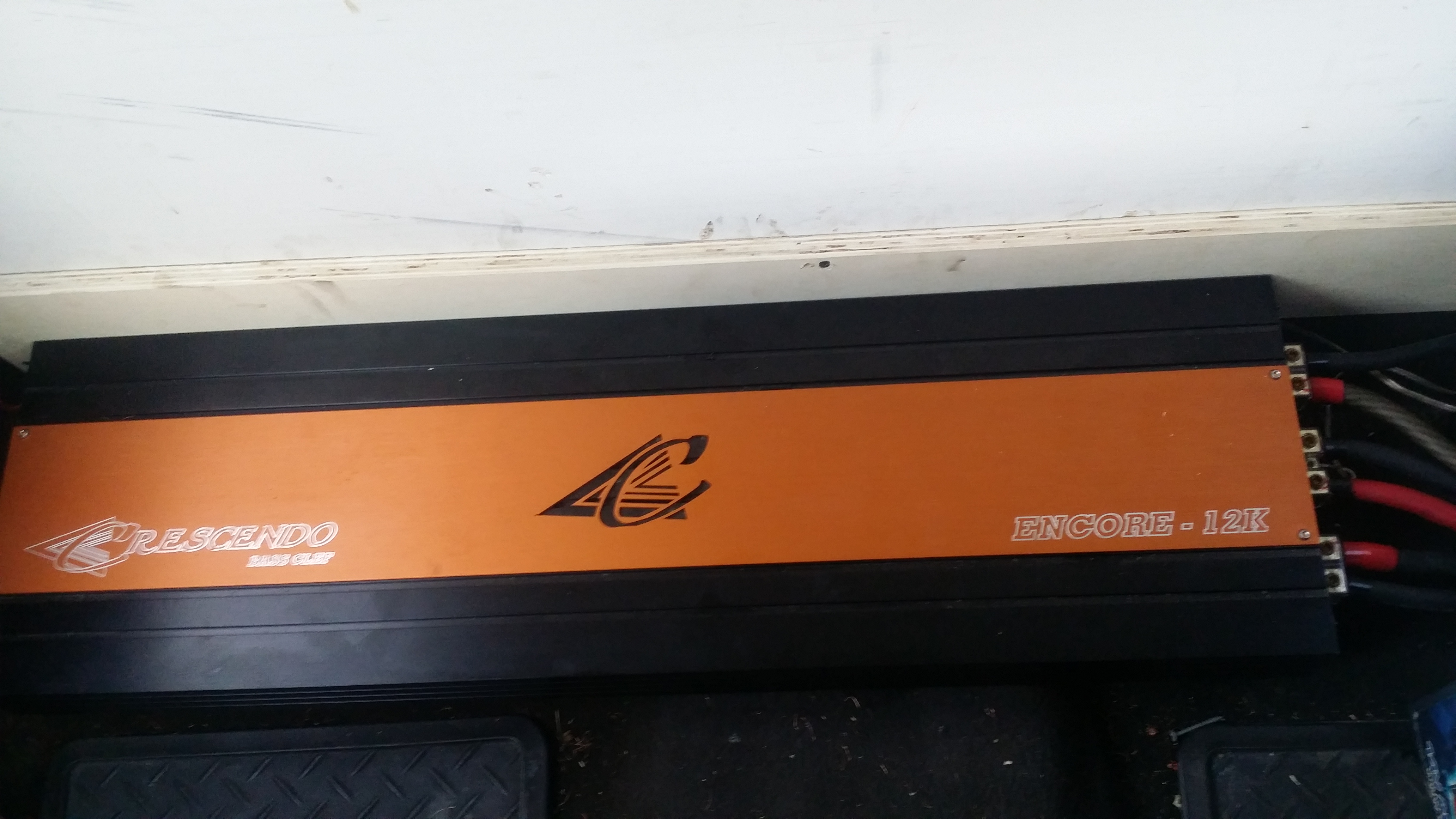

A short video with the crescendo 12k on the 8's

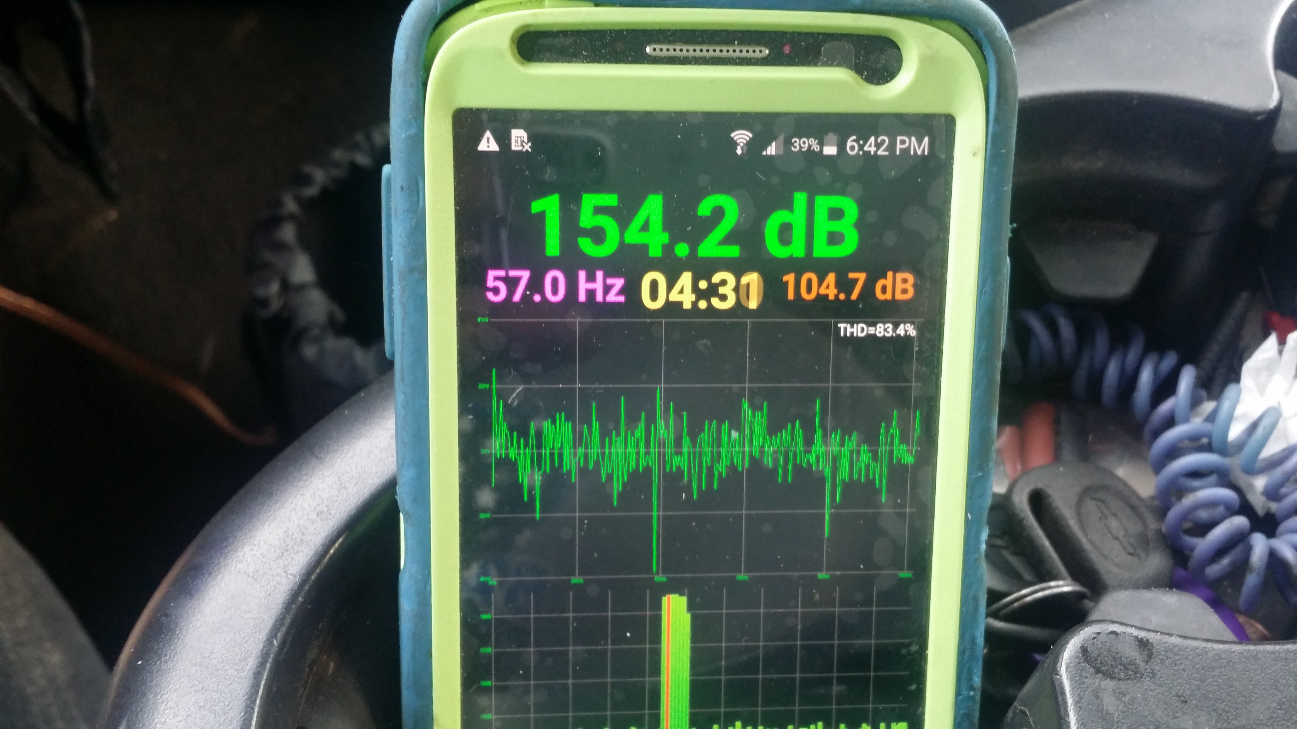

Got some new number
