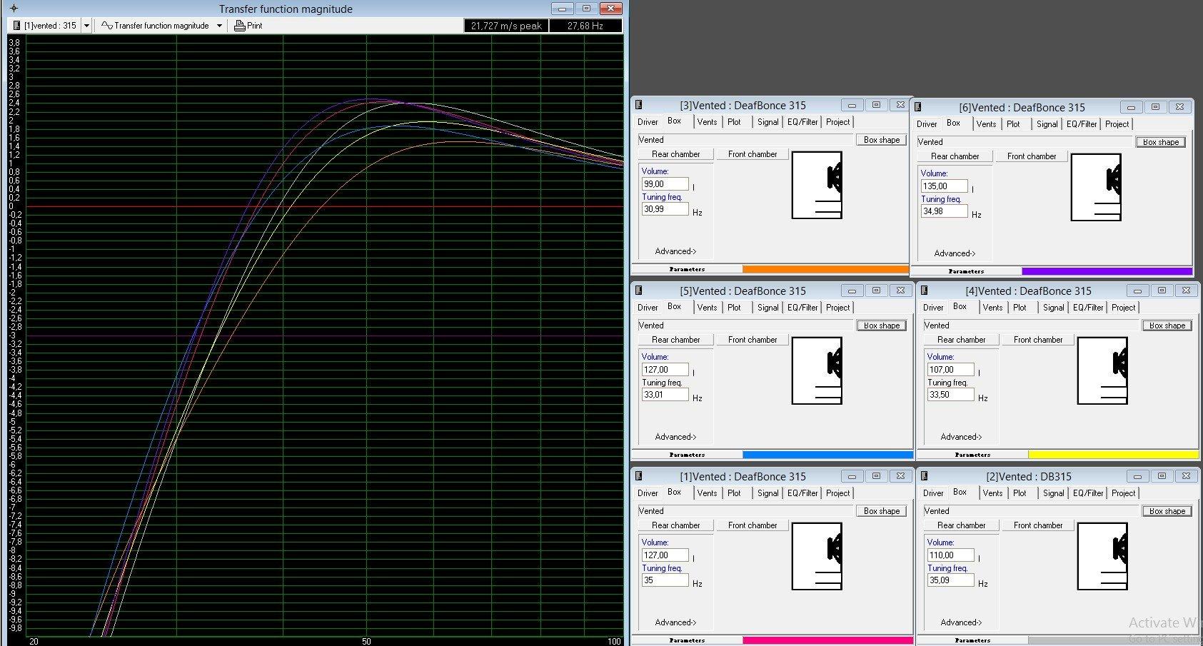

Which box is best of them all? Subwoofer is Alphard DB315 (2.5kw) 1600Rms clamped

I always work on a good flat graph but without tuning really funky I've never made a graph with that much Volume ..
Here's my issue... I've only worked on winisd for about an hour or two total, so I may be doing something wrong but... Actually I'm gonna go work angraph now just to see what's going on

Ok going to hit winisd now.
The purple one. :)
