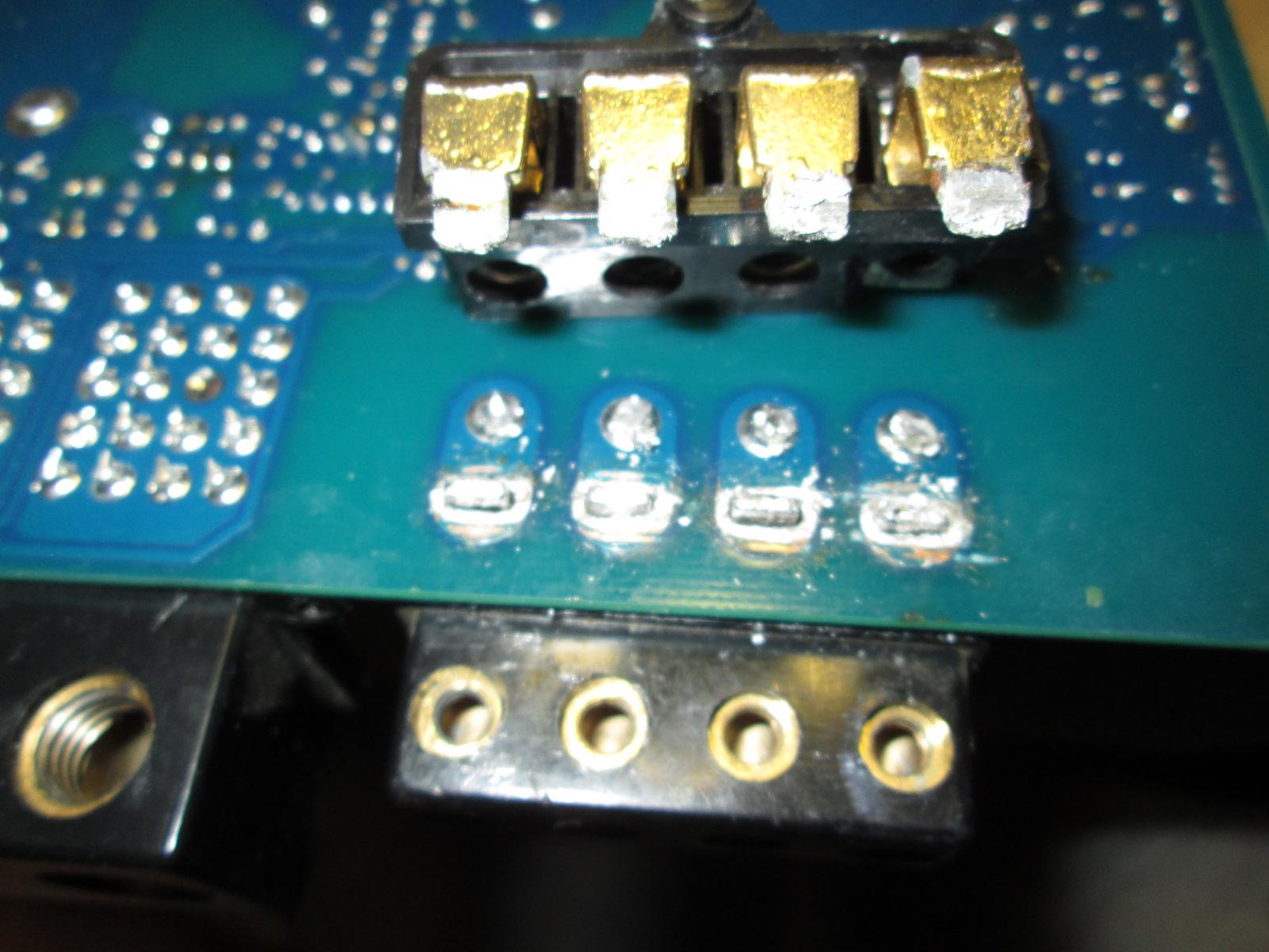

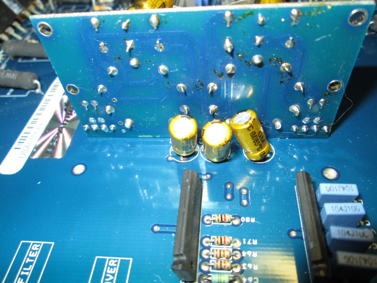

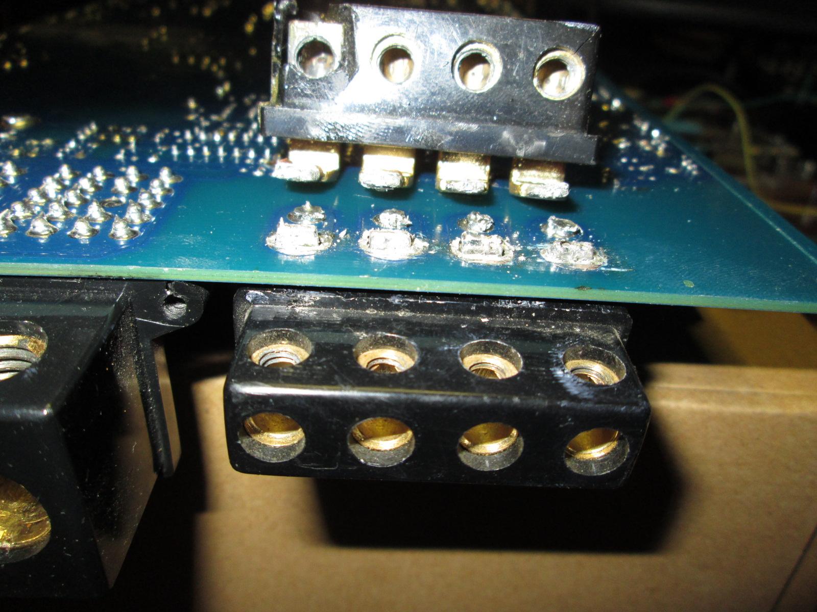

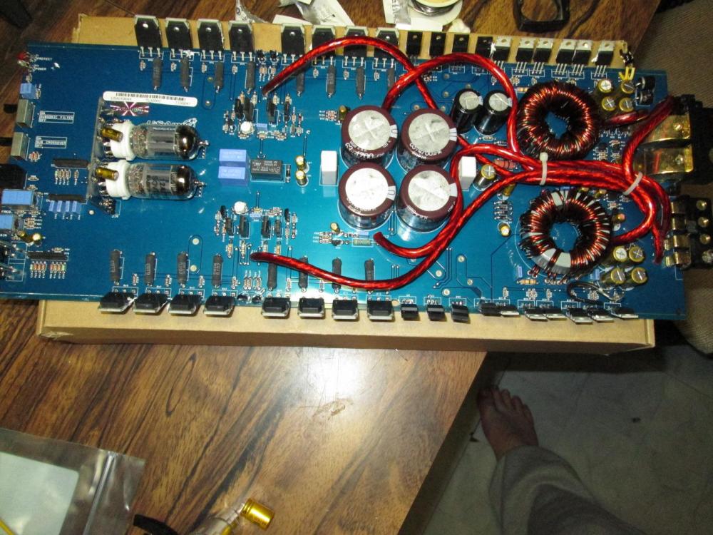

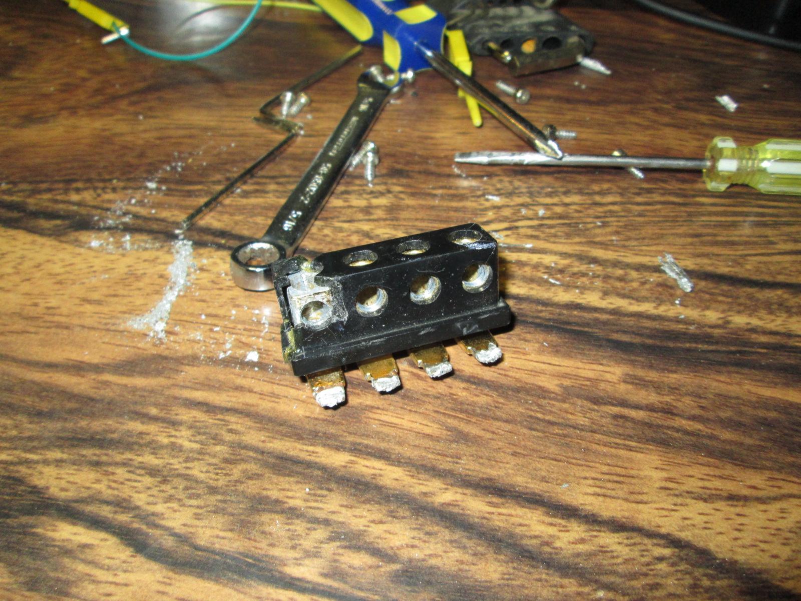

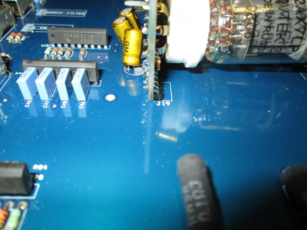

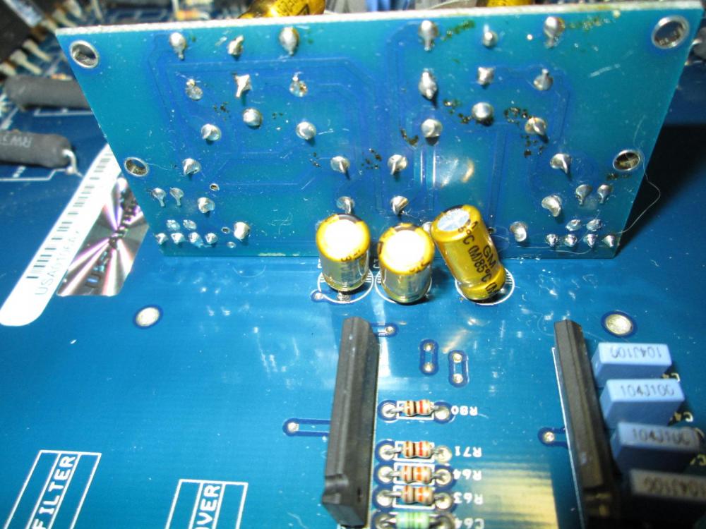

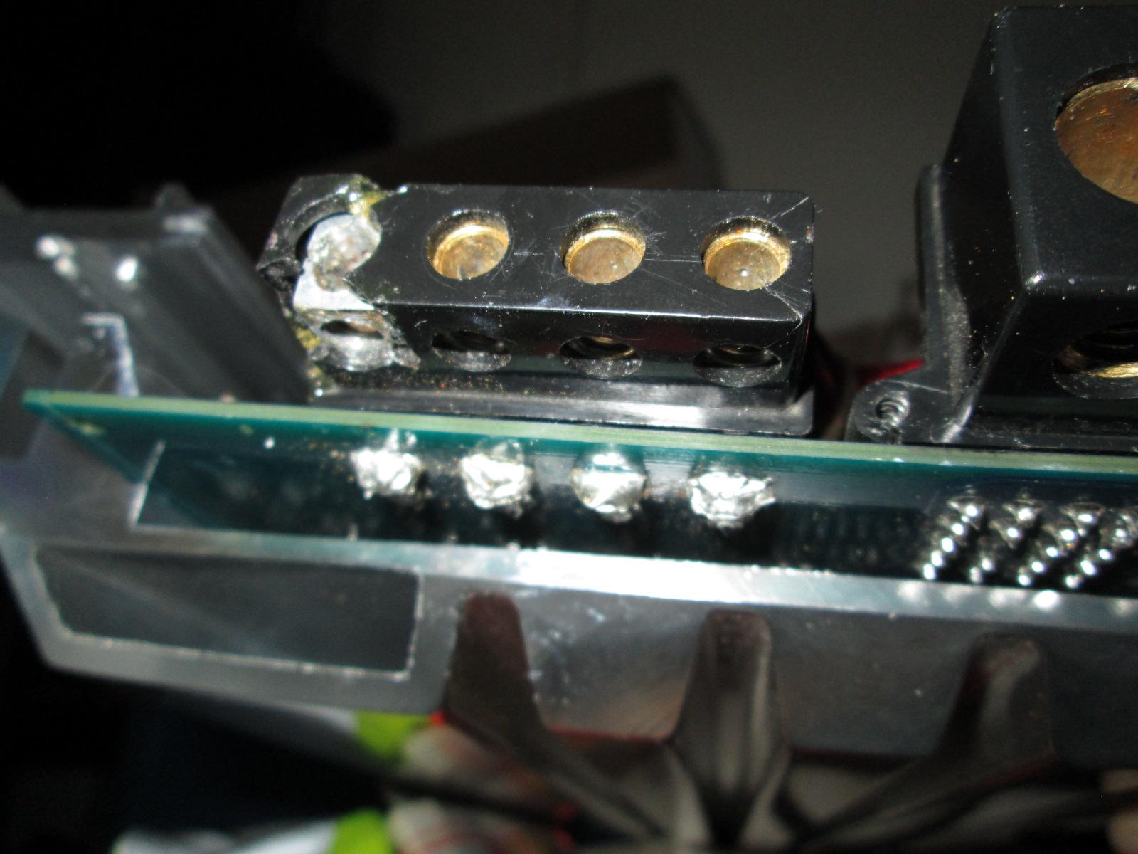

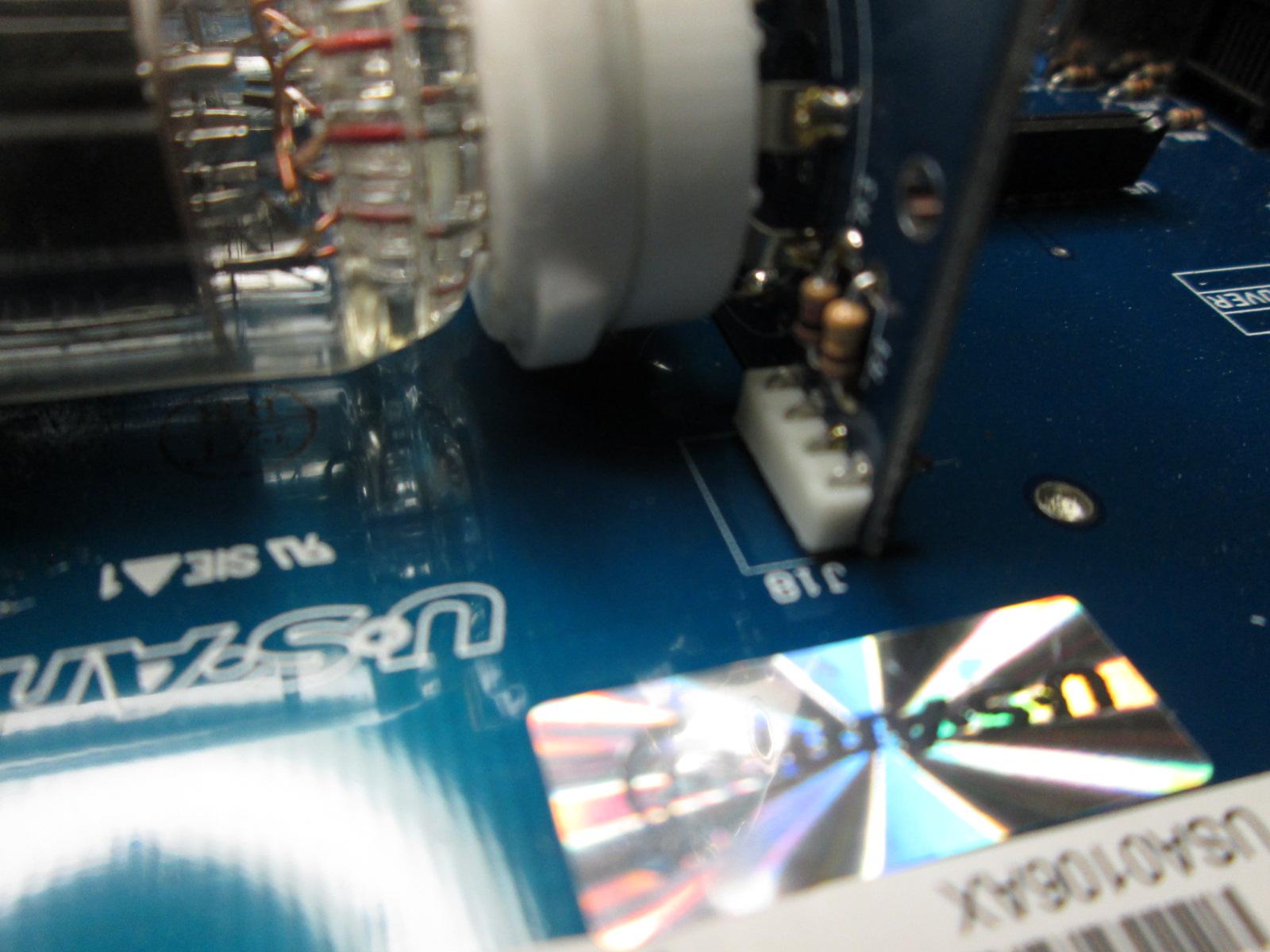

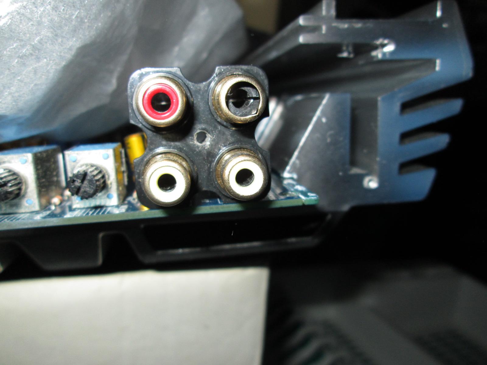

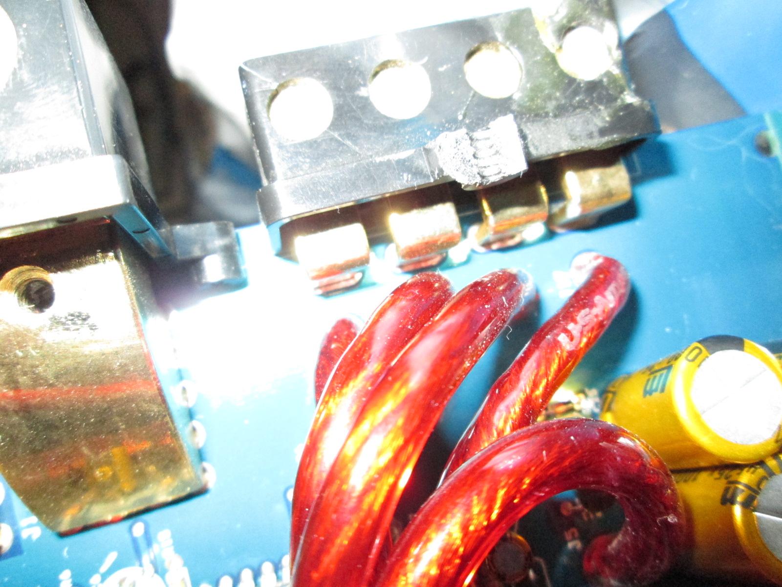

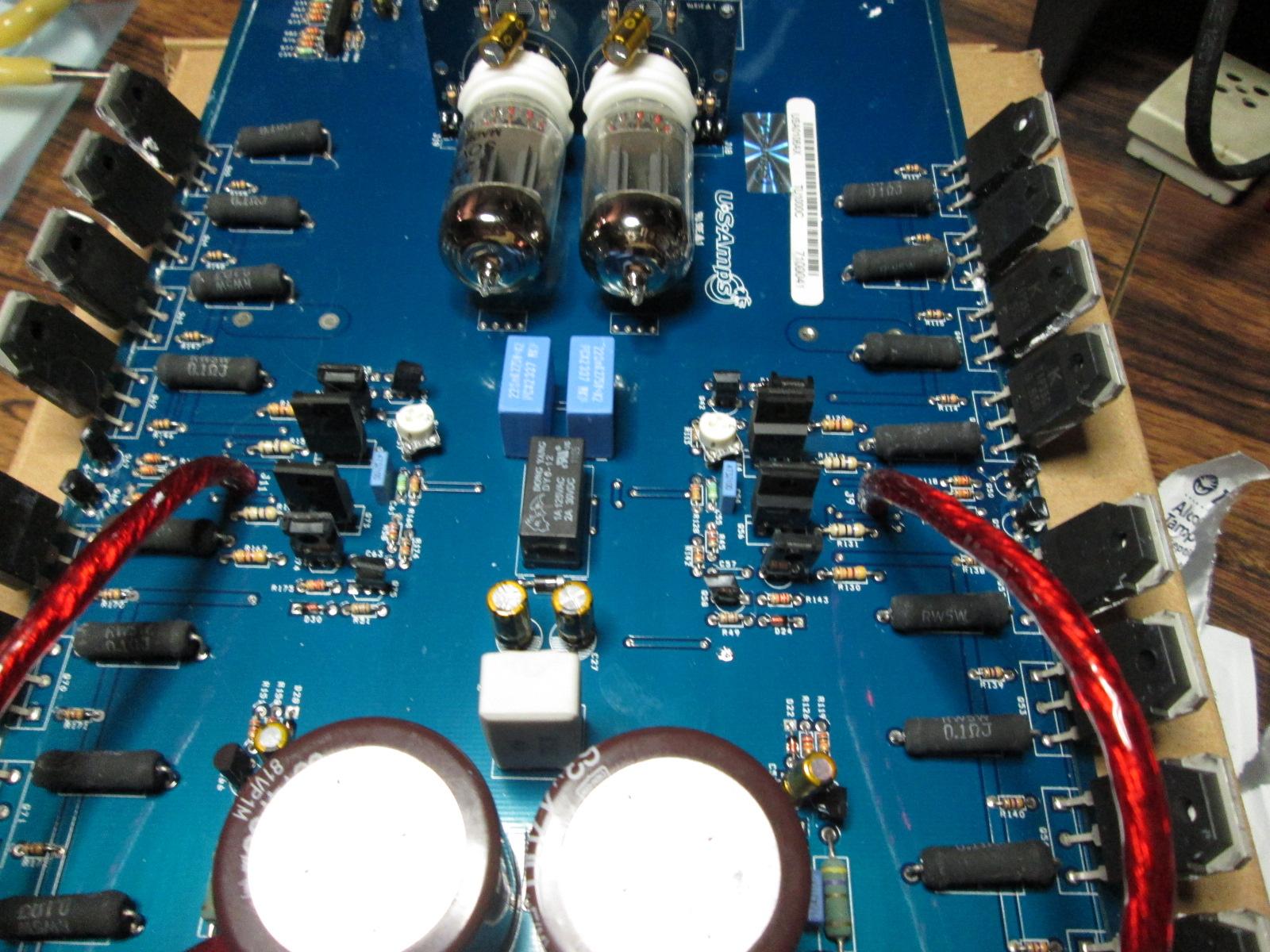

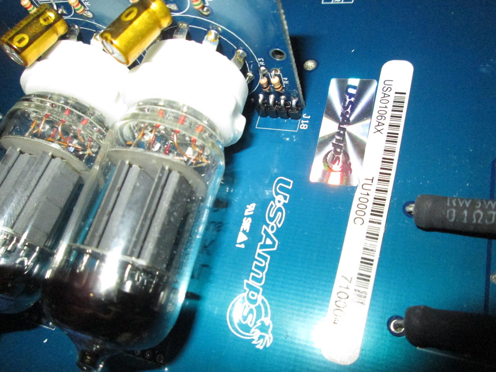

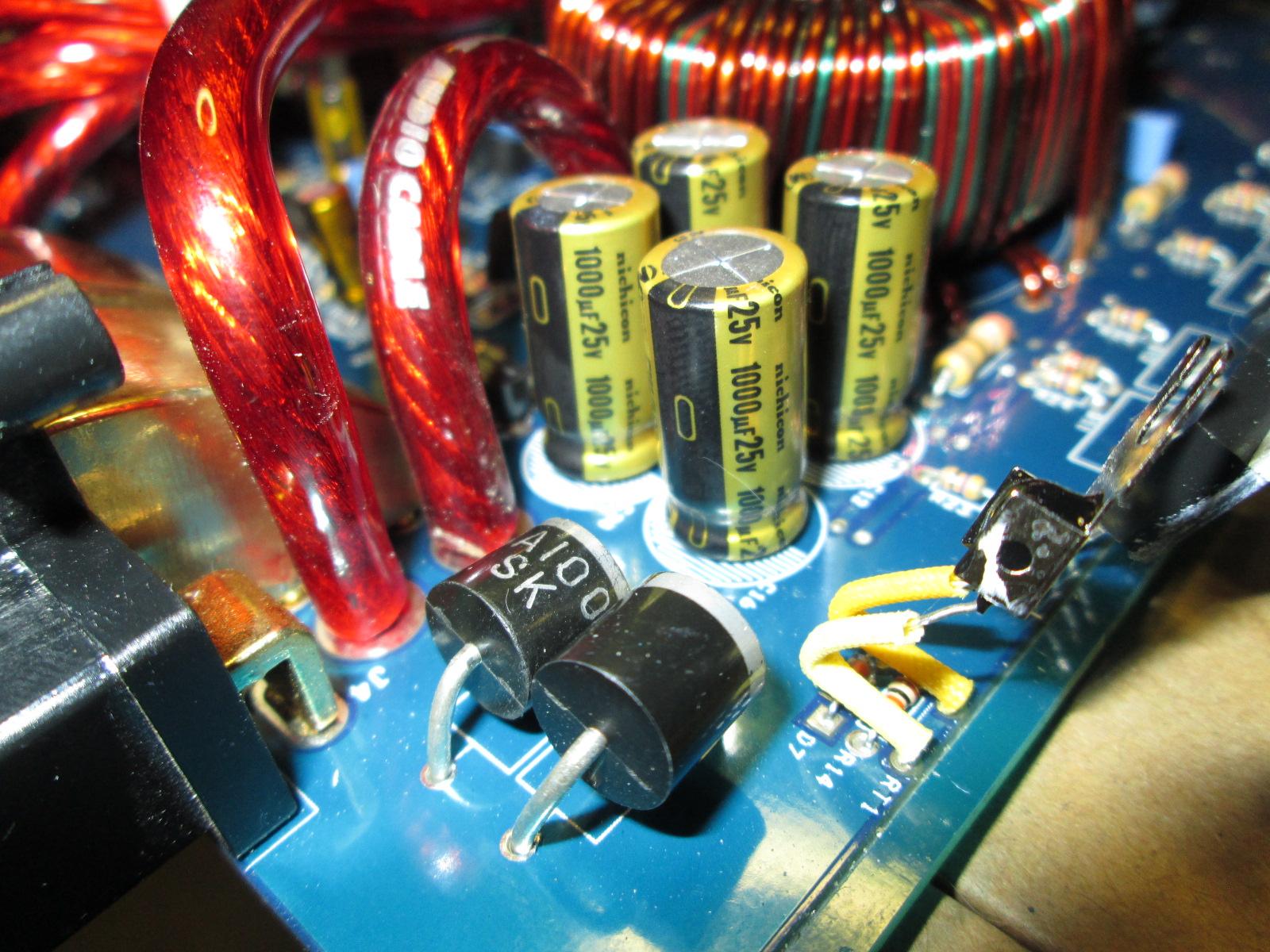

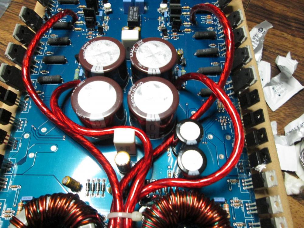

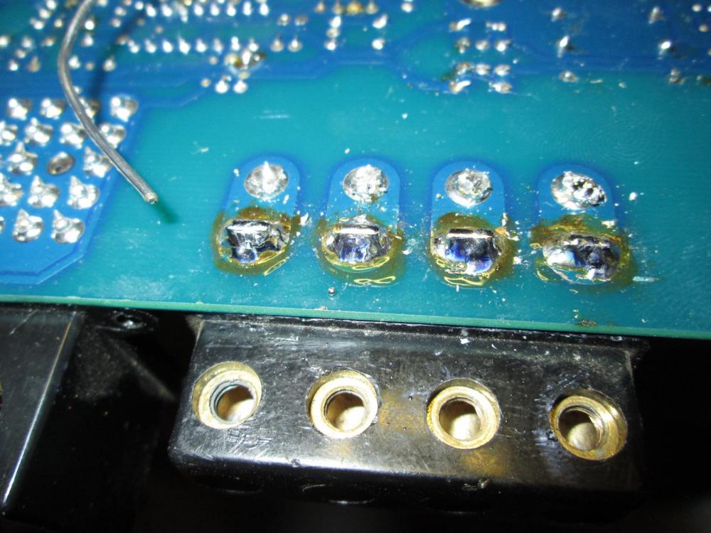

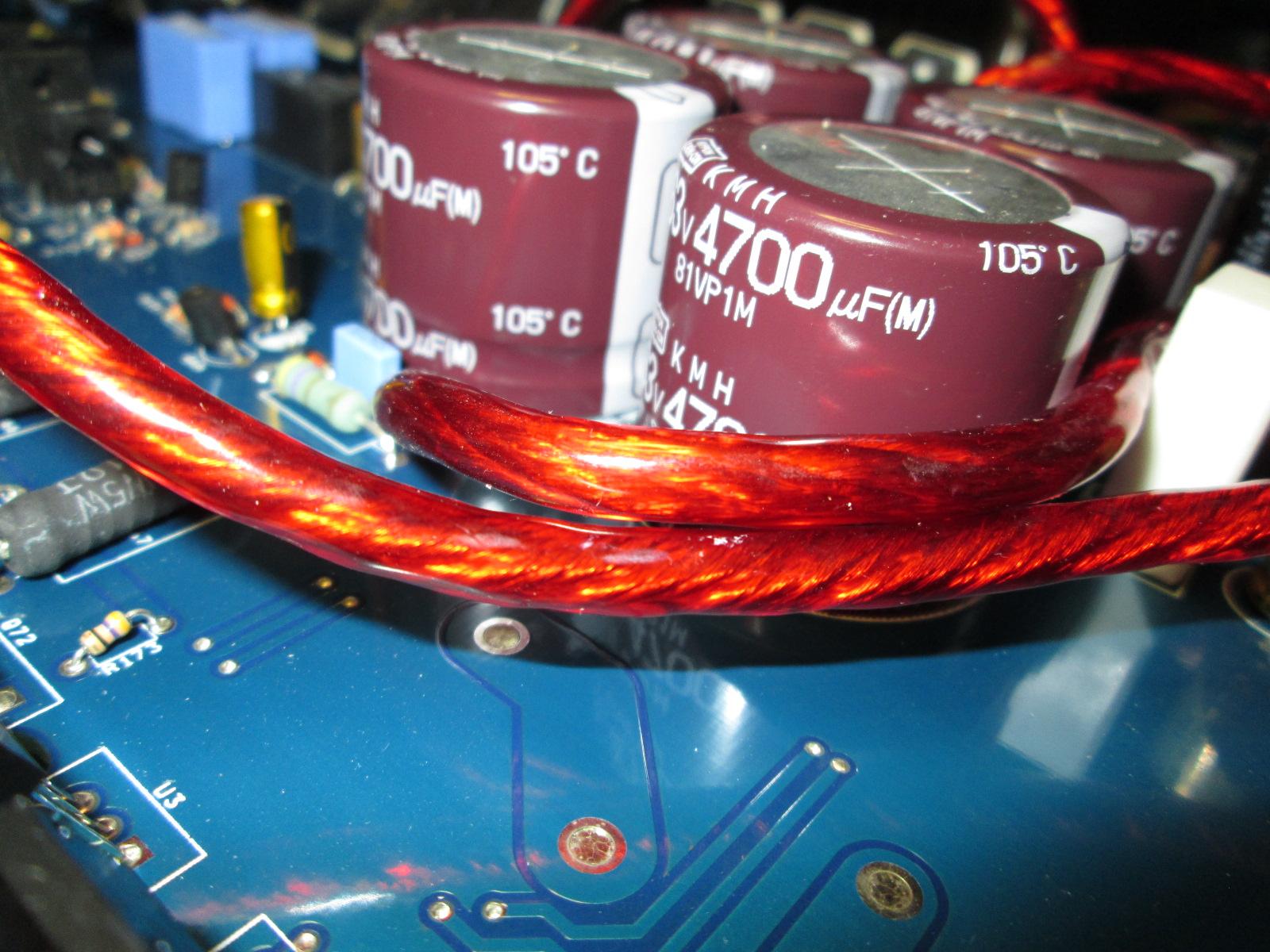

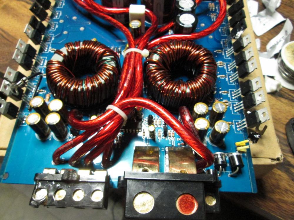

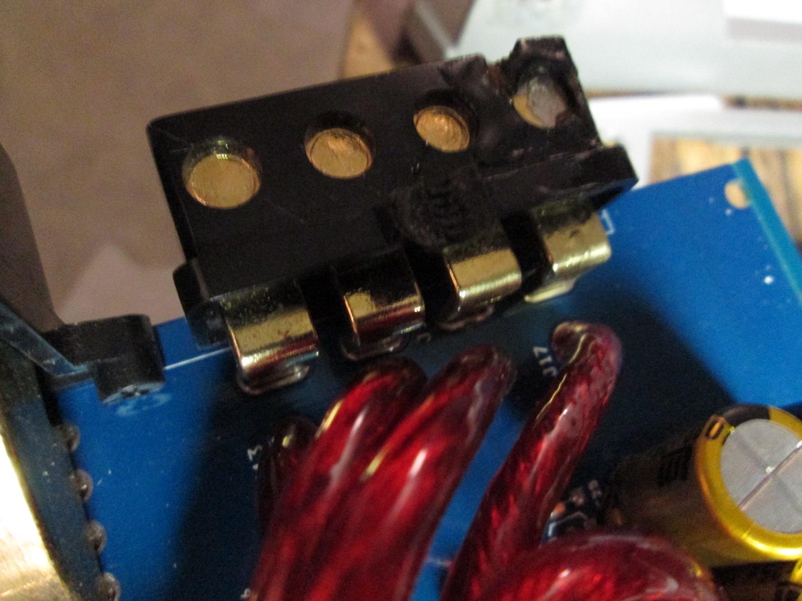

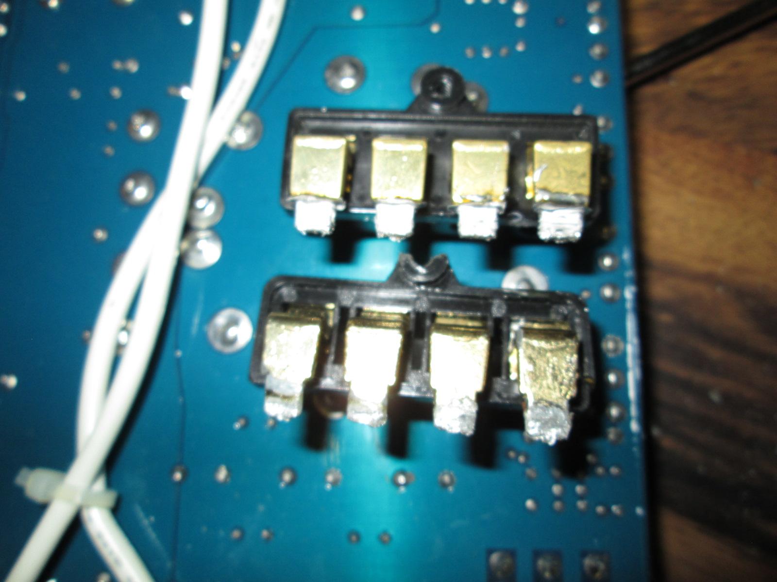

Posted January 4, 20197 yr Hi there, I am trying to locate a part for my AX-TU1000c. I got it used and the 4700uf caps were bad, one was detached from the board. Also the pin headers were cracked on the tube board. I recapped most of it and replaced the pin headers but I need a couple parts. The previous owner busted a speaker block and tried to solder it together. I'd like to replace this but its very hard to find this part. Does anyone have any idea where I can find this PCB Barrier Terminal Block? (other than buying a parts amp) I could use a rca PCB Mount A/V Concentric Outlet too. I did test the amp removed from the heatsink and it is working after the recap but I'd like to replace that barrier terminal. I am Edited January 4, 20197 yr by Cartel
January 5, 20197 yr Author Someone must have heard me. I found an amp with the same terminal. Sorry clarion but you're worth more dead than alive.
