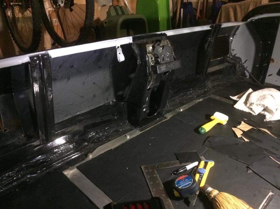

The trunk before any Damplifier Pro sound deadening.

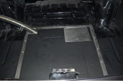

Installing the Damplifier Pro butyl sheets.

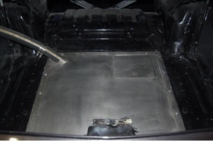

Interior trunk walls only needed one full sheet of Damplifier Pro each to reduce sound to just a deep thump.

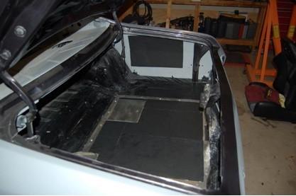

After the Second Skin Damplifier Pro was installed. The Damplifier Pro dropped the sound of the fuel pump to nearly no sound at all.

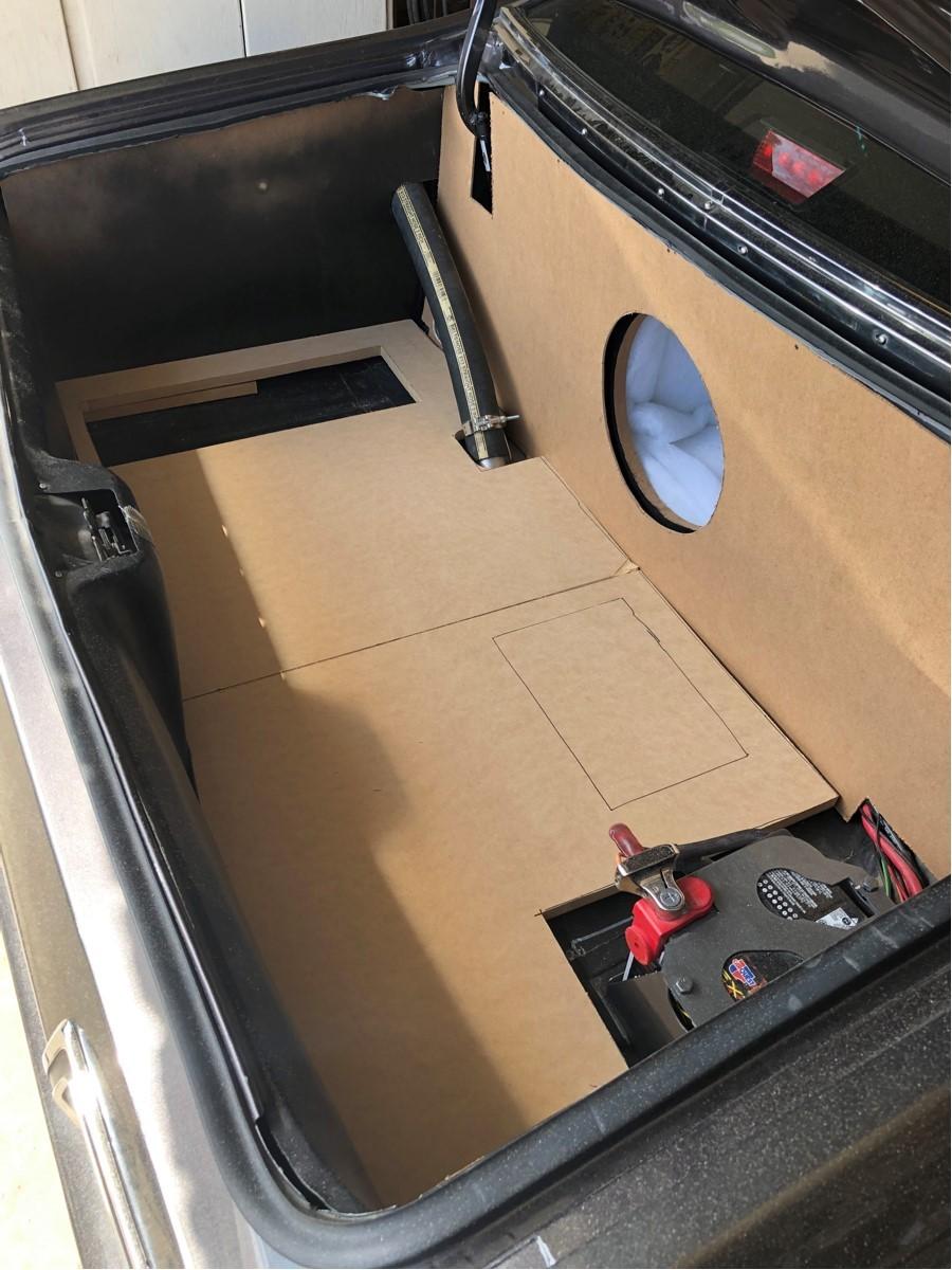

This photo show cardboard being used to make templates for the false wall and also inner quarter walls.  The cat little box is to show a cover for the trunk mounted battery.

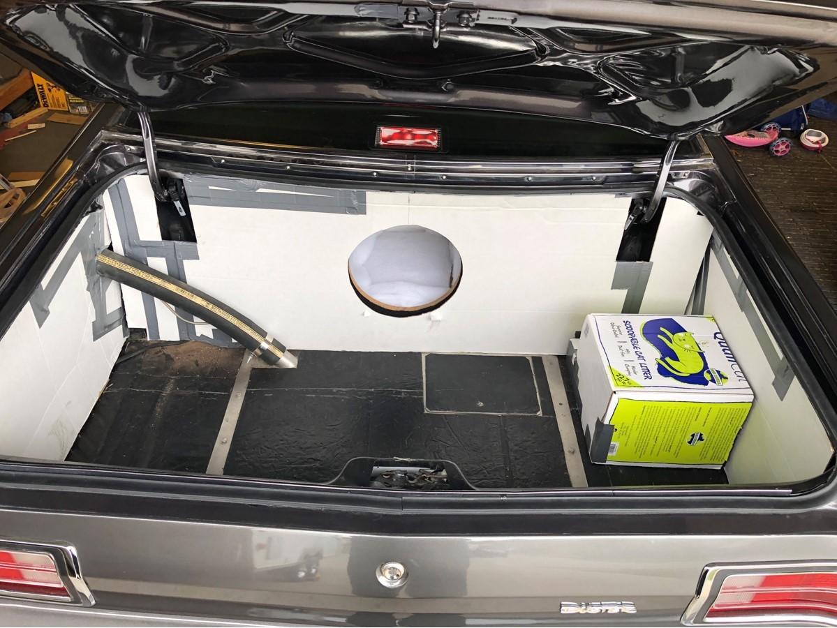

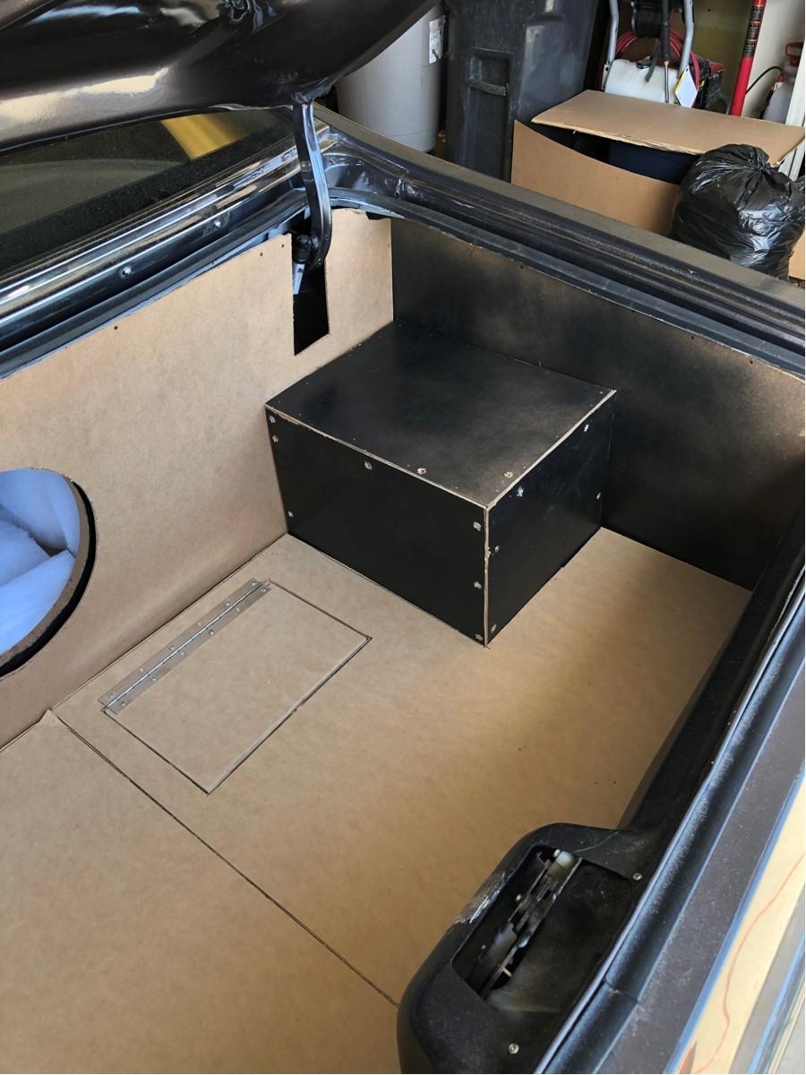

These two photo’s show all the card board templates being replaced with mdf or fiber wood panels.

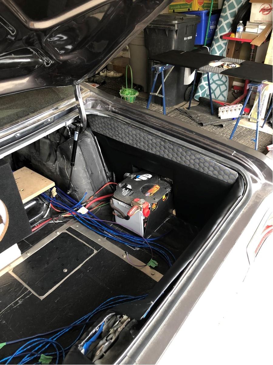

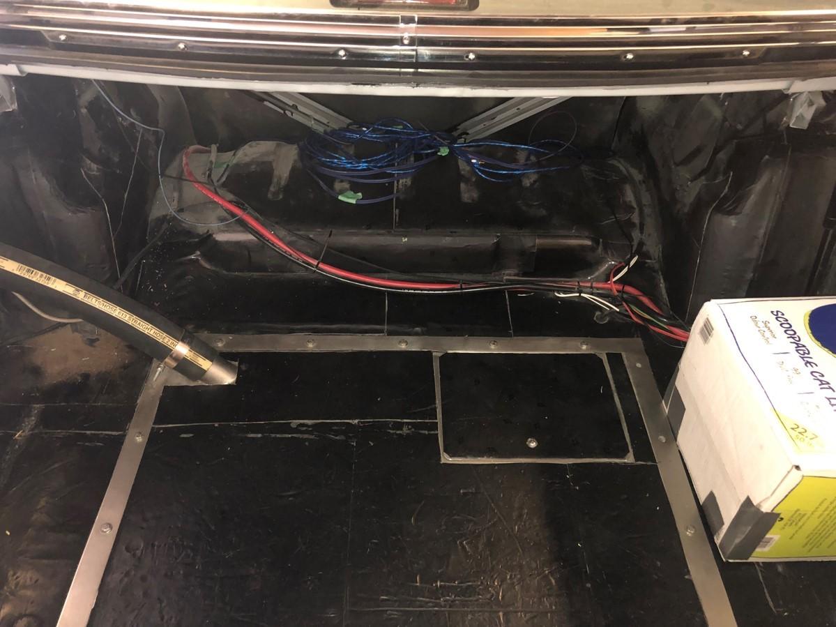

The wiring was completed for the stereo and the sub box was mounted into it’s final resting place.  You can see the battery here which will be covered by the upholstered box.  Behind the battery is the first upholstered panel I completed.

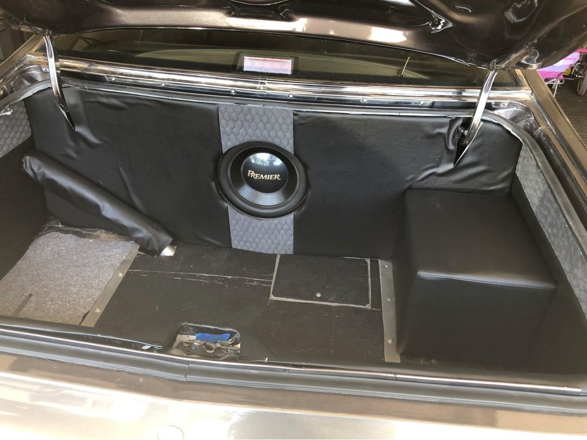

This picture shows more of the upholstery being completed.  I have to work the wrinkles out with steam.

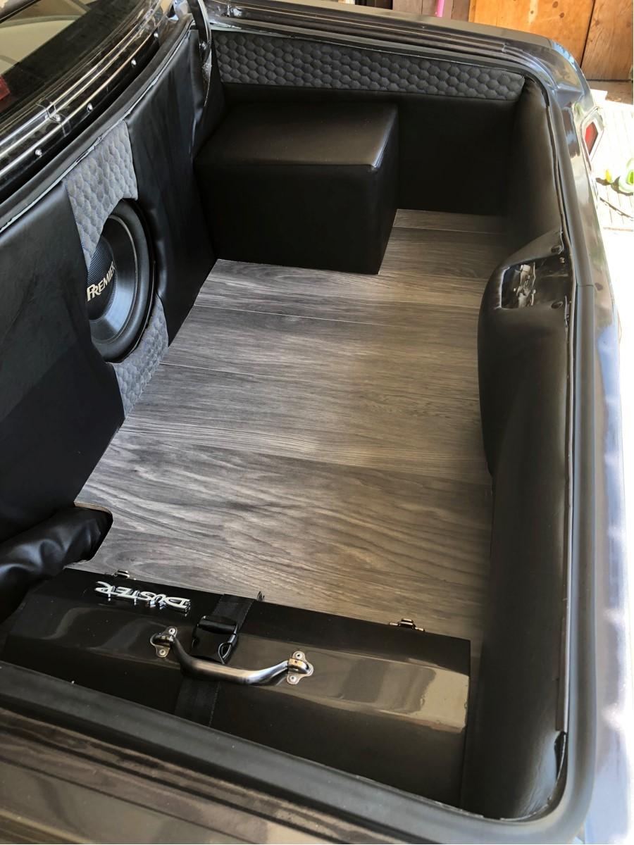

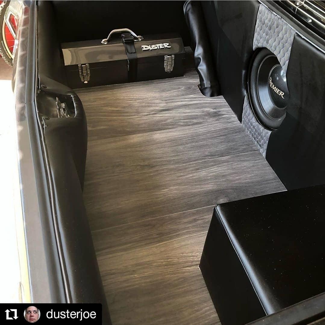

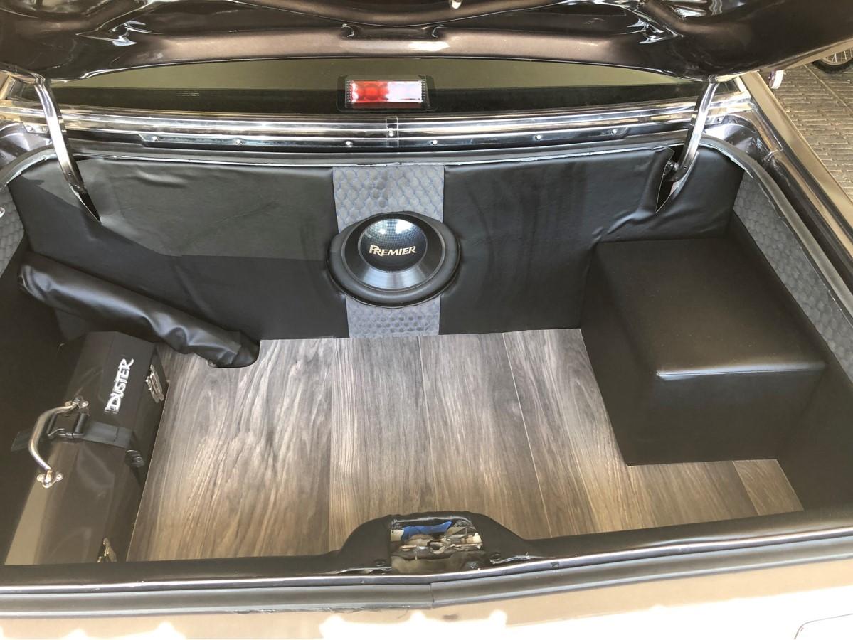

Completed Trunk with matching flooring.
