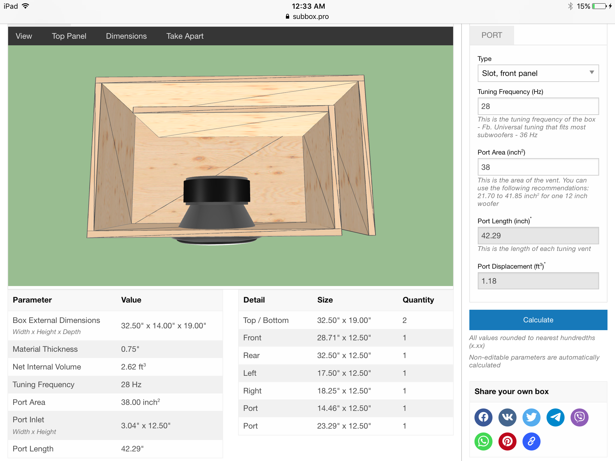

Thank you sir!  I placed an order for a 12" GCON, powering it with a 1500W amp @ 1ohm.  Box is going in the trunk of a Hyundai Elantra.  The box I came up with is a slot port with 2.5 ft3 net internal, port area of 43.75 in2 and port displacement of 1.17 ft3, tuned to 31 Hz.  Sub back, port back.  Any advice is welcome!
  • Admin
Heck yeah. The Port Area is a little above what I usually suggest, as you are at 17.5 square inches of port per cube, and the Gcon tends to be in the 15-15.25 per cube.
Thanks Aaron!  I used a port calculator and that was the area it spit out for box size and max power.  I'll bring it down a bit.

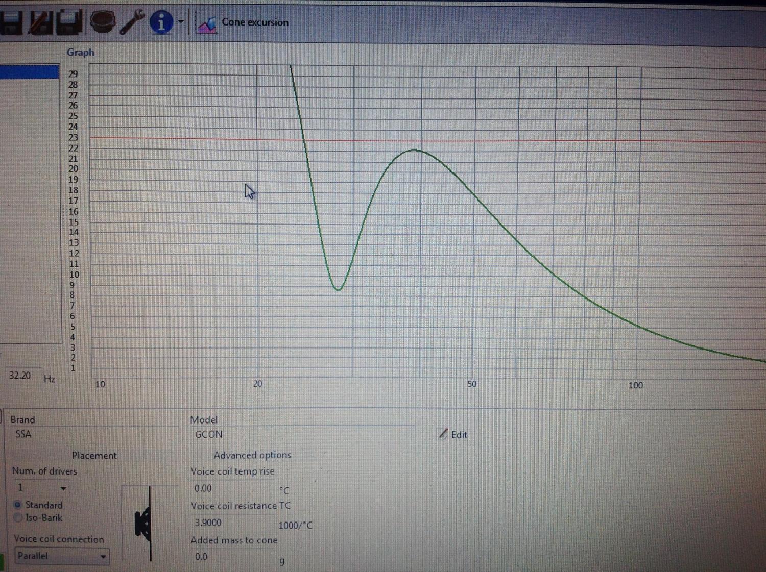

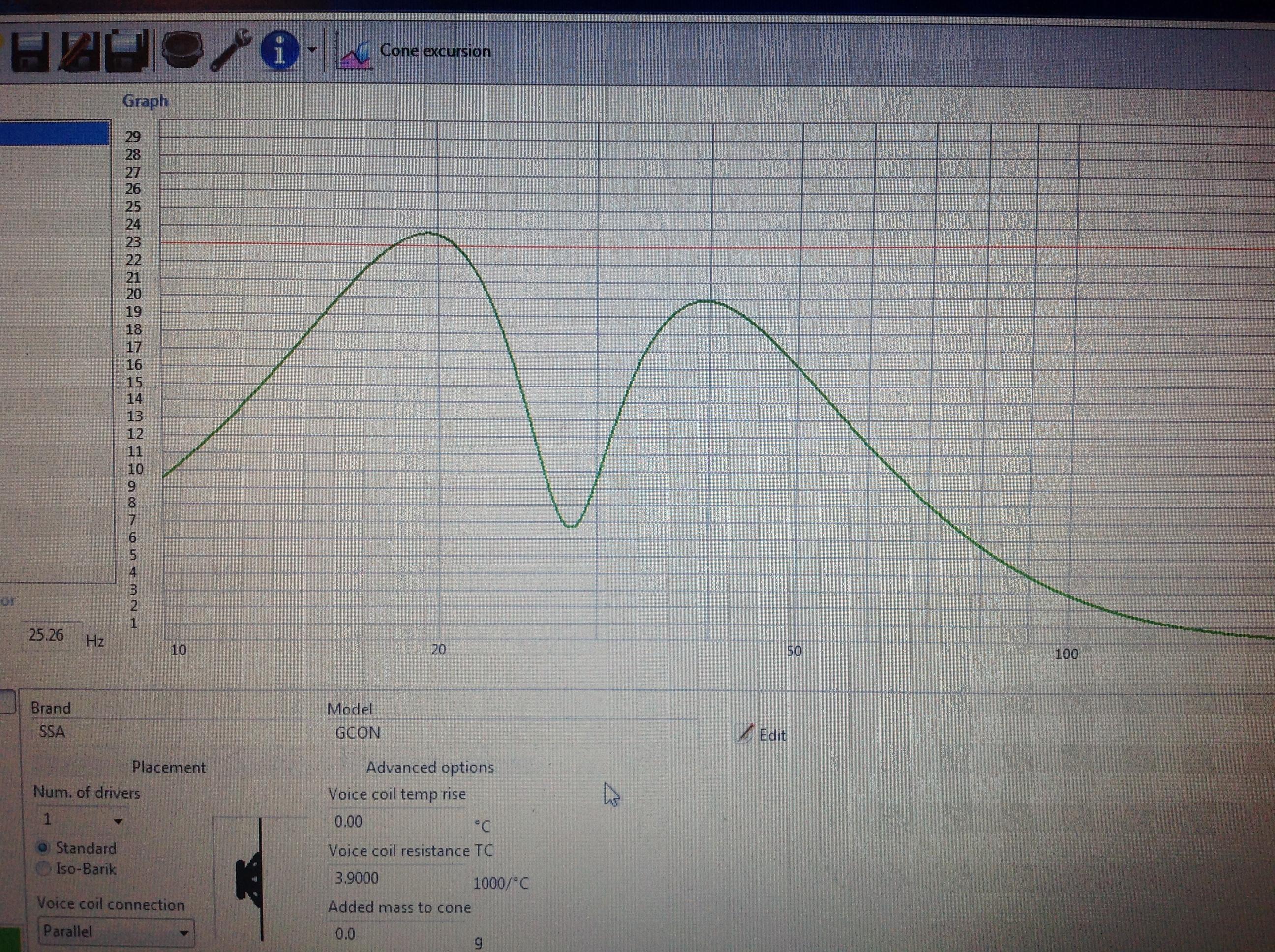

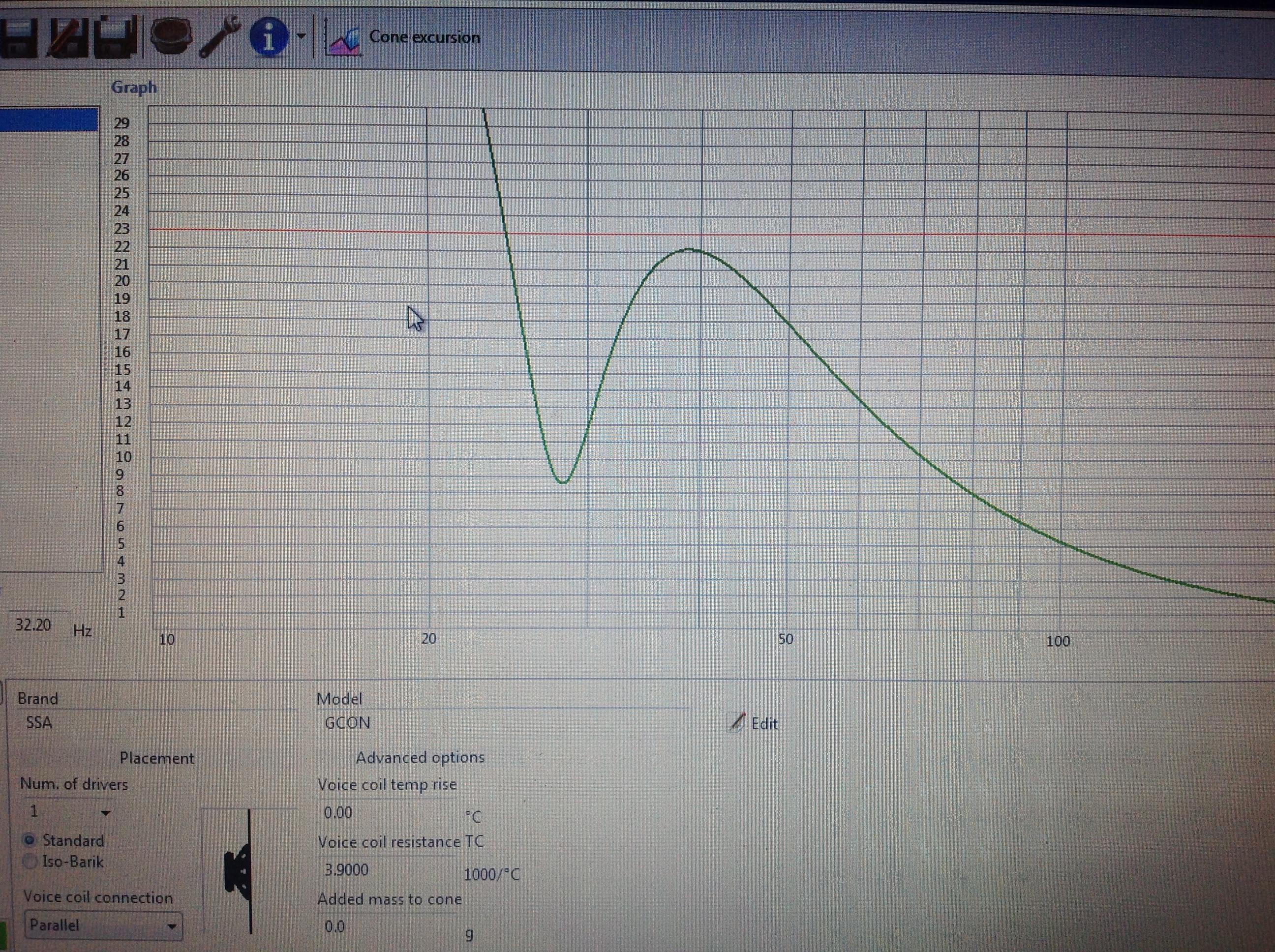

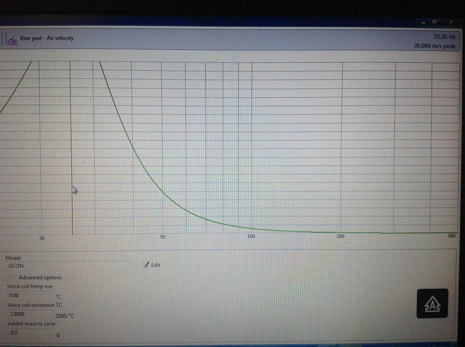

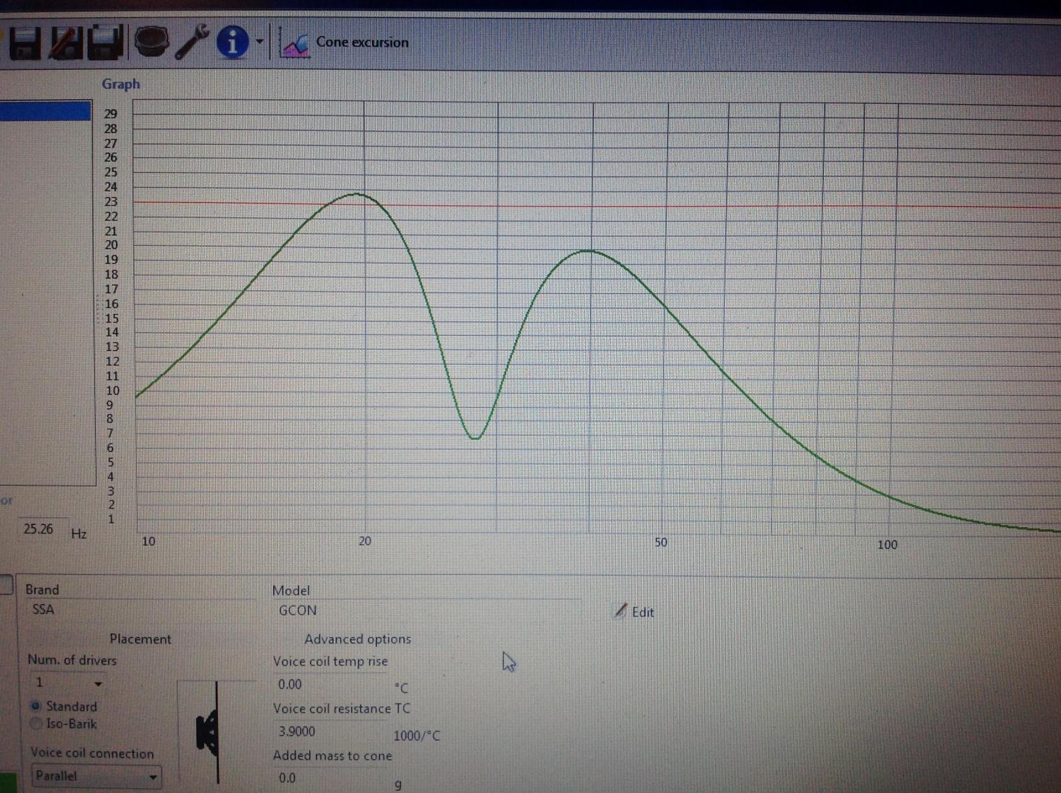

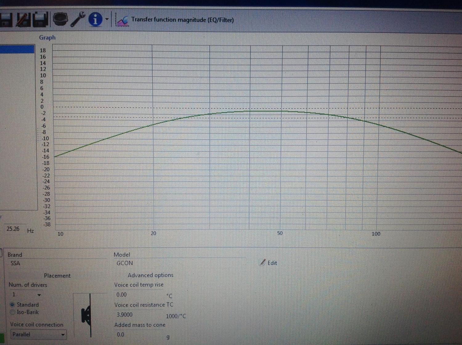

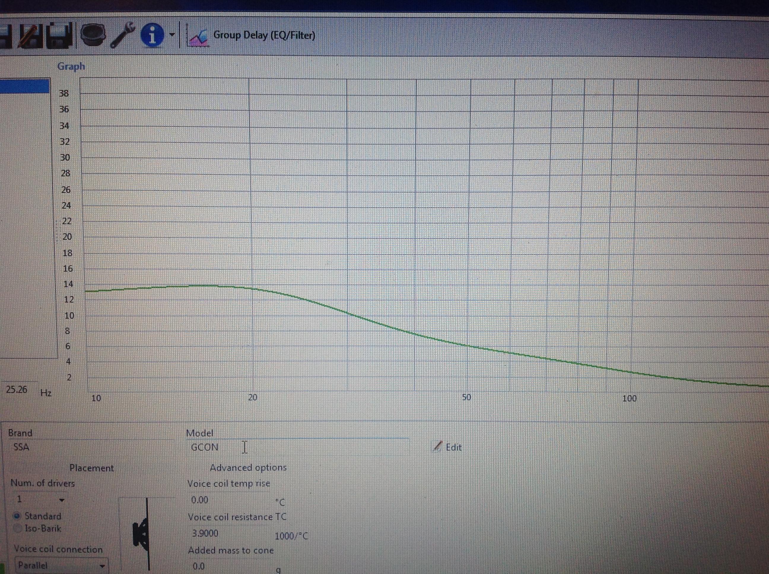

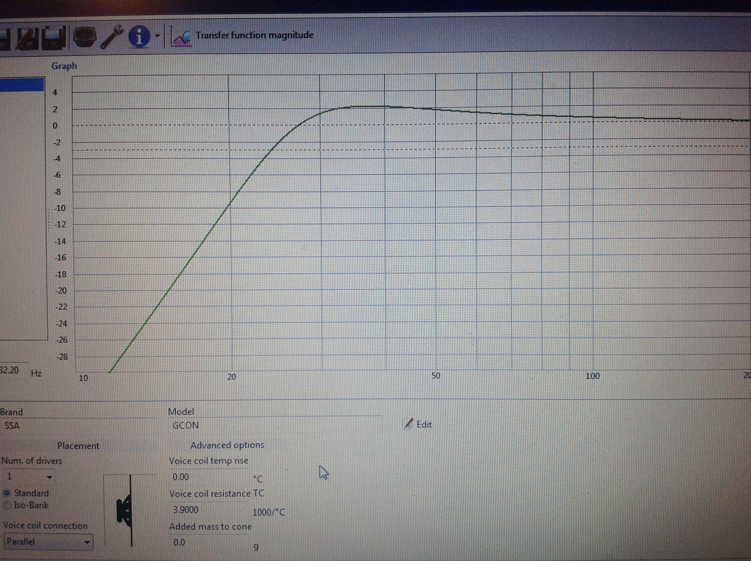

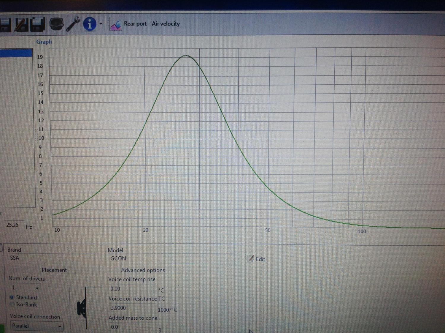

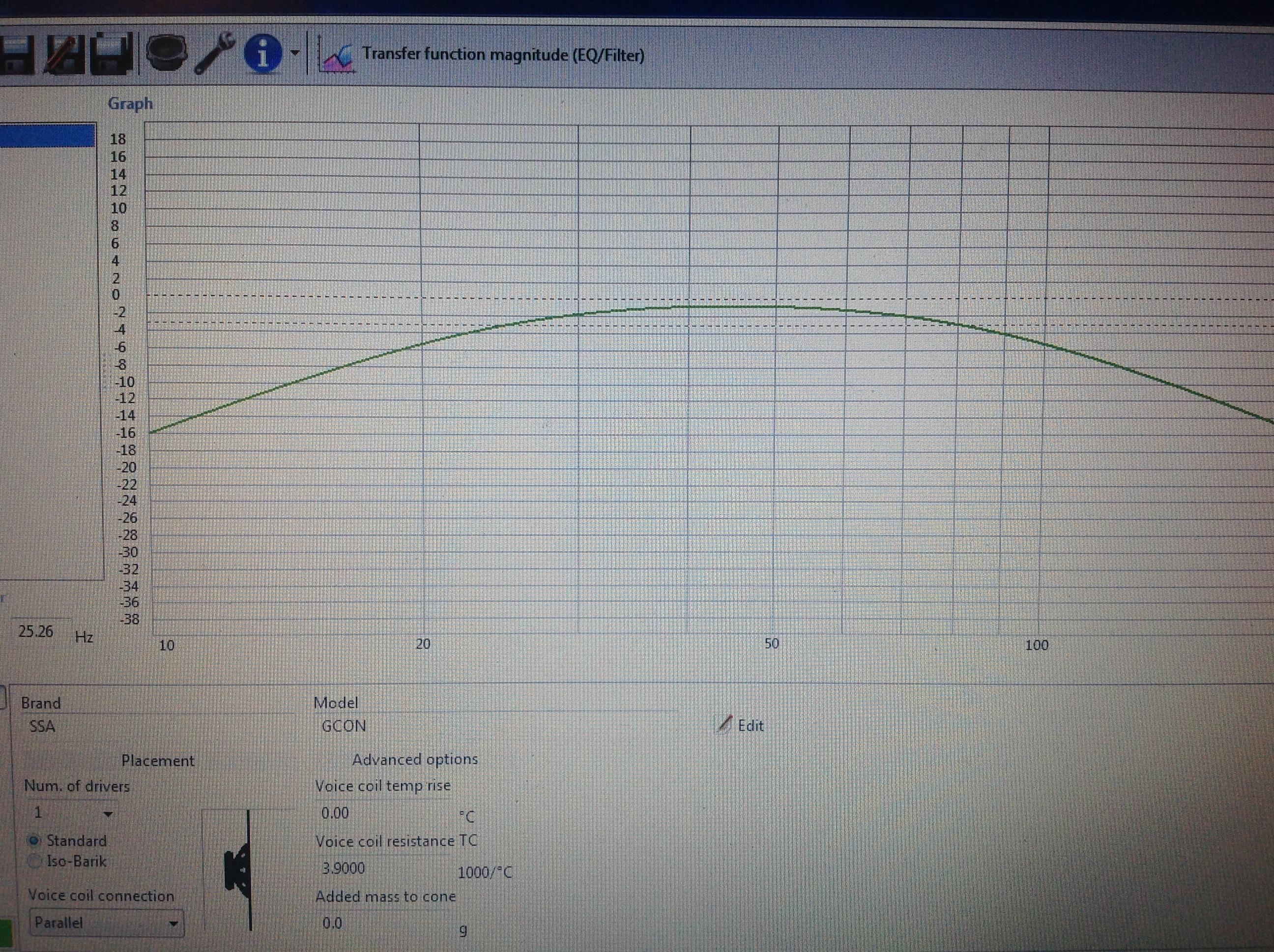

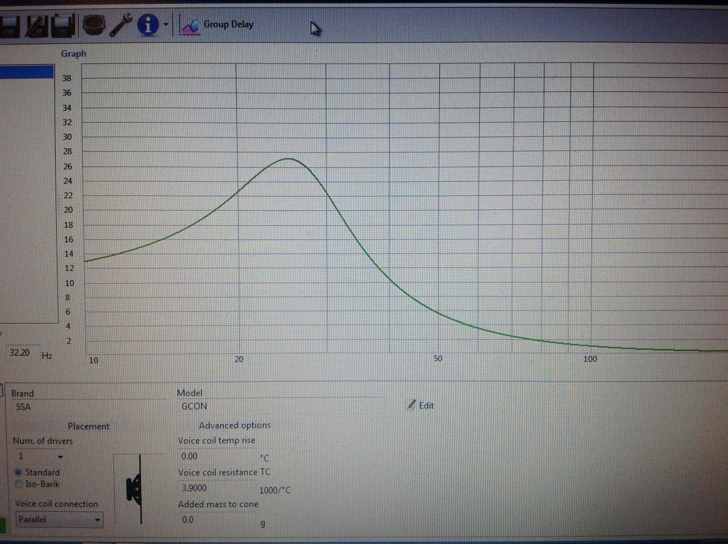

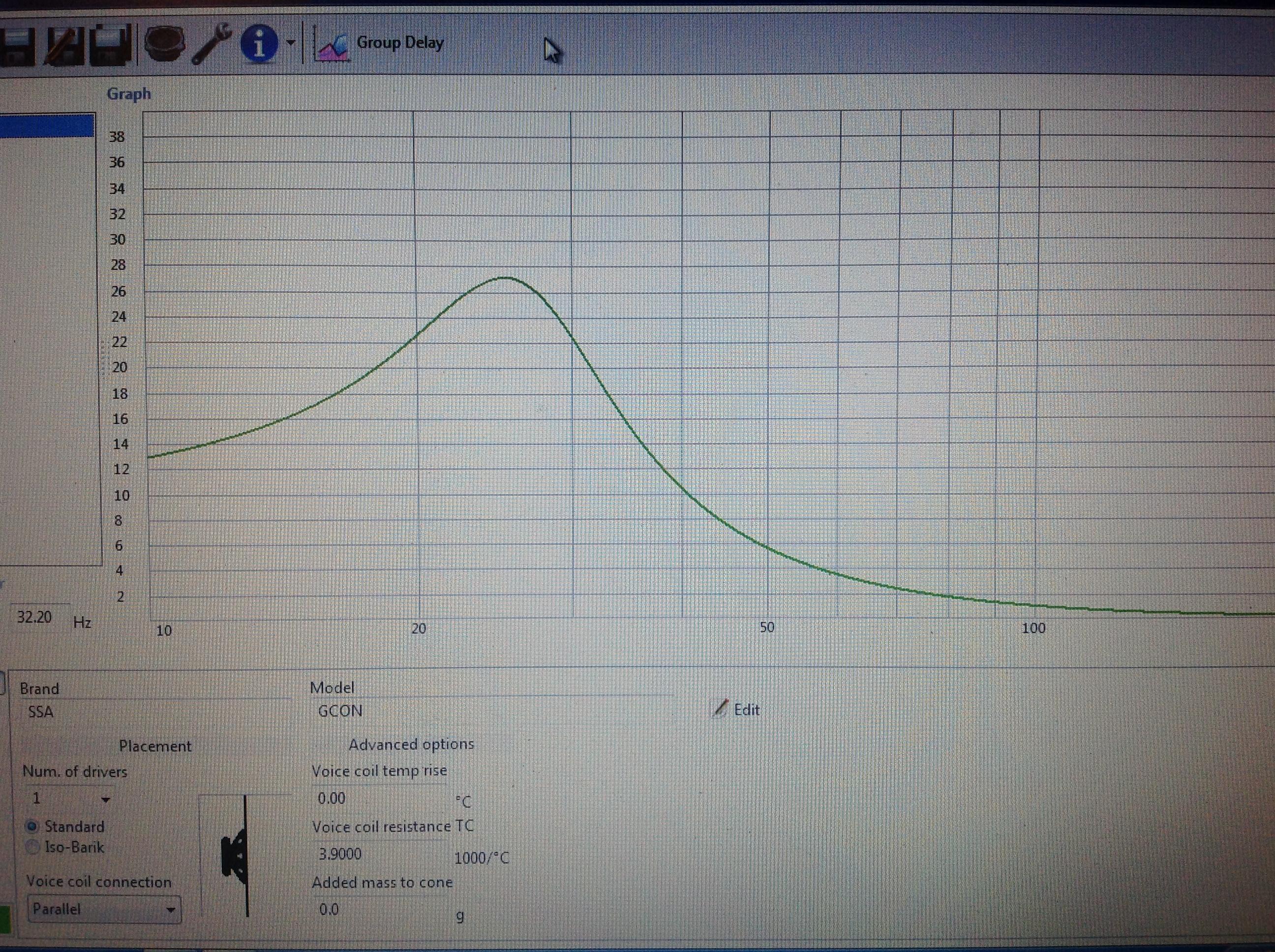

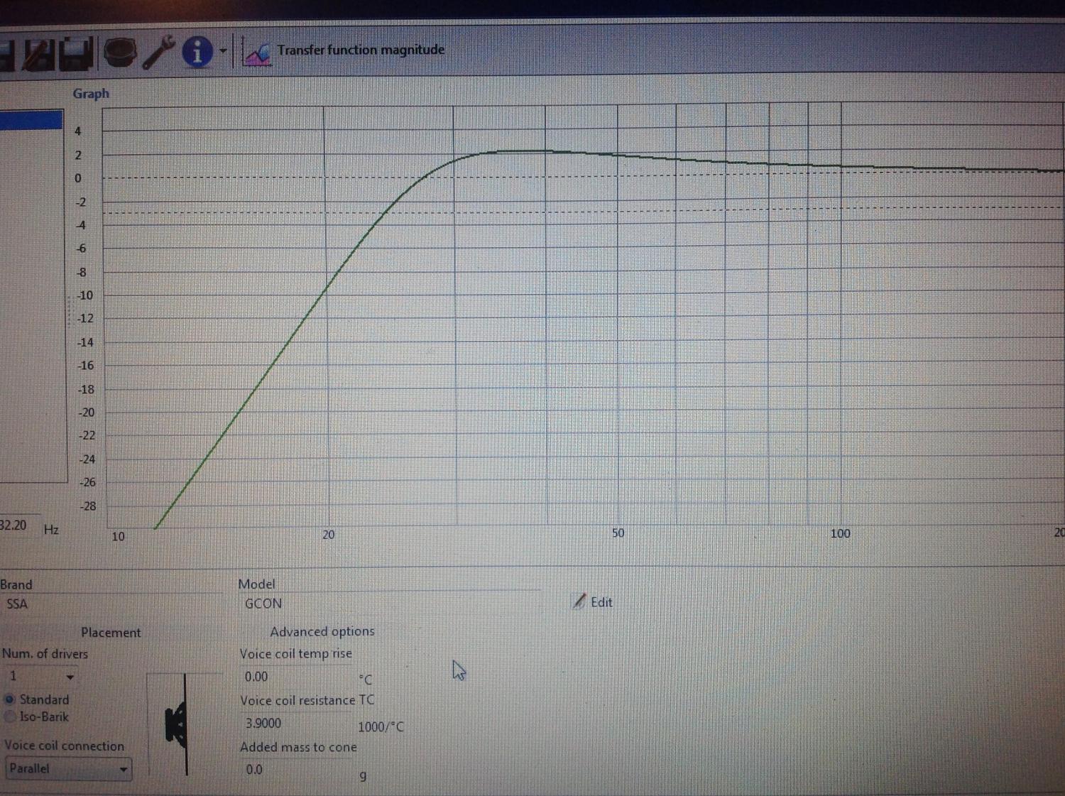

Okay, so this is what I've come up with.  Screenshots of WinISD graphs included.  Please let me know if anyone sees something that doesn't look right.  Thanks!
Transfer Magnitude w/ high and low pass filters on
  • Admin
Also, from what I've read the Gcon will handle 1500w dynamically without issue.  Would you agree with that?  Or should I use a lower-powered amp?
The Gcon can handle over rated power.  If you want to add a little power handling, the flatwound coil will help for sure.  But that will change specs and sound a bit.
