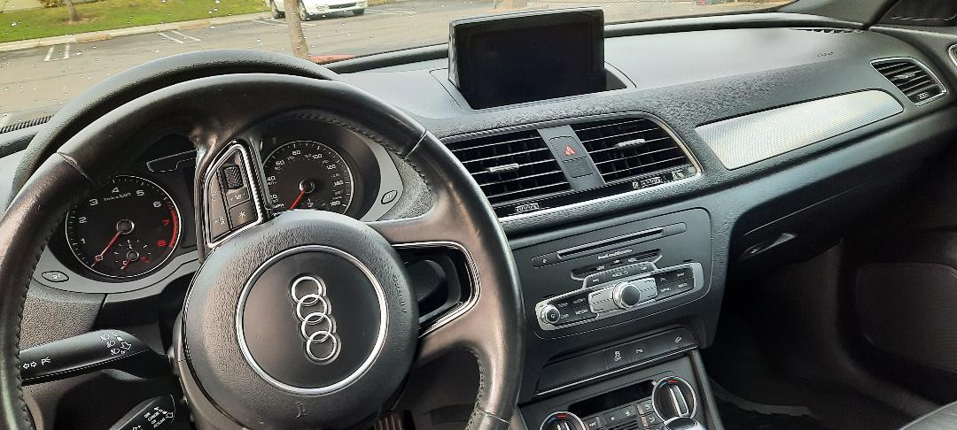

Posted March 8, 20241 yr I picked up this car recently and wanted to toss in some equipment that I've had laying around BNIB for years. I don't know how much of it will fit or how to make it work but I'd like to use all of it if possible. This is all the same stuff I was going to install in the old Merc. That car didn't work out and was sold a few years ago. I'm going to attempt to install this myself again but was looking for pointers so I don't fuck anything up along the way. I've been looking at a few videos on how to take the interior apart etc. Not gonna go crazy like I did last time tho. I think when it gets here, I will start with the h/o alty and the big 3. I bought an alt from Mechman that is about 370 amps. Planning to lay a few runs of neg and pos 1/0ga cable. I'd like to grab a D4800 for under the hood and something else in the back if needed. Maybe a D3100 if space limitations don't get in the way. I've seen the JP batts as well and look nice for how small they are. I've seen that using an aftermarket head unit is a bad idea which will prob make this more difficult to source a signal but Idk. I've been cruising the AudioControl site and might have come across a few things I could use. An LC8i for the mids and tweets and an LC2i pro for the sub. Might as well add in the Epicenter too. The Epicenter isn't prob needed tho I do like cool shit. I was looking for a DSP model but they're sold out everywhere. Only thing I could find was the D1200 amp/dsp for $1300. I would go that route but I'm too lazy to sell all the shit I already have. I'm thinking this stuff will cover the signal issue from the factory head unit? Would I need anything else? I have no idea so I'm hoping to get a lot of help here lol. My thot was to buy the LC8i, LC2i PRO, and Epicenter. I think these 3 would cover what I need to install the 8 speakers and 1 sub. I'm not sure how all this goes but assuming the Epicenter will be after the LC2i Pro and before the amp. I was also wondering if my sub is D2 ohm wired to 1 ohm, the speaker wire is only 1 channel. Would I plug pos into one left channel and the neg to the second pos channel? If I only use one side, I would only get left or right audio but not both correct? I will most likely make the lcd screen swap I've seen on YT as well. Other than that it was gonna look stock for the most part. I like the look it has, just needs some beat. Do you guys think this will work? What are the obstacles you see right away? I'm open to all ideas or changes. The items that I already have are as listed: 1- SSA 15" D2 XCon 1- AudioQubed Q1 2200D 2- NVX JAD800.4 4- SSA Evil 6.5" mids 4ohm 4- SSA Evil 1" tweets 4 ohm Mechman 370 amp billet alternator sound dampener wiring and cable
