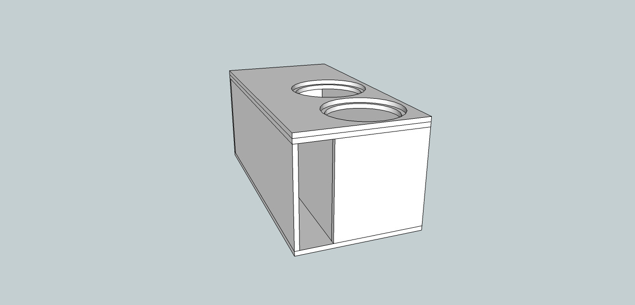

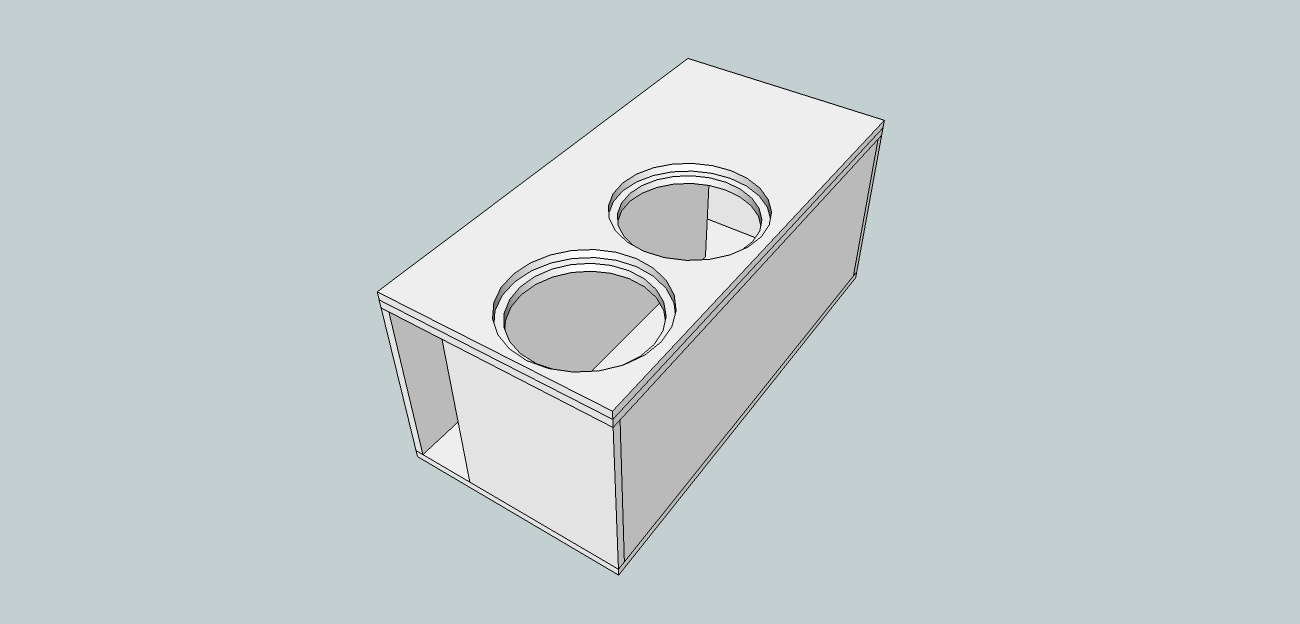

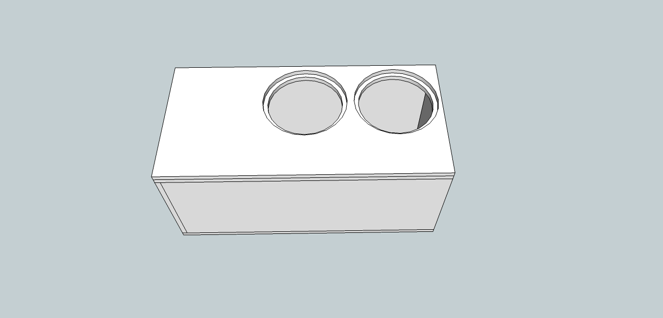

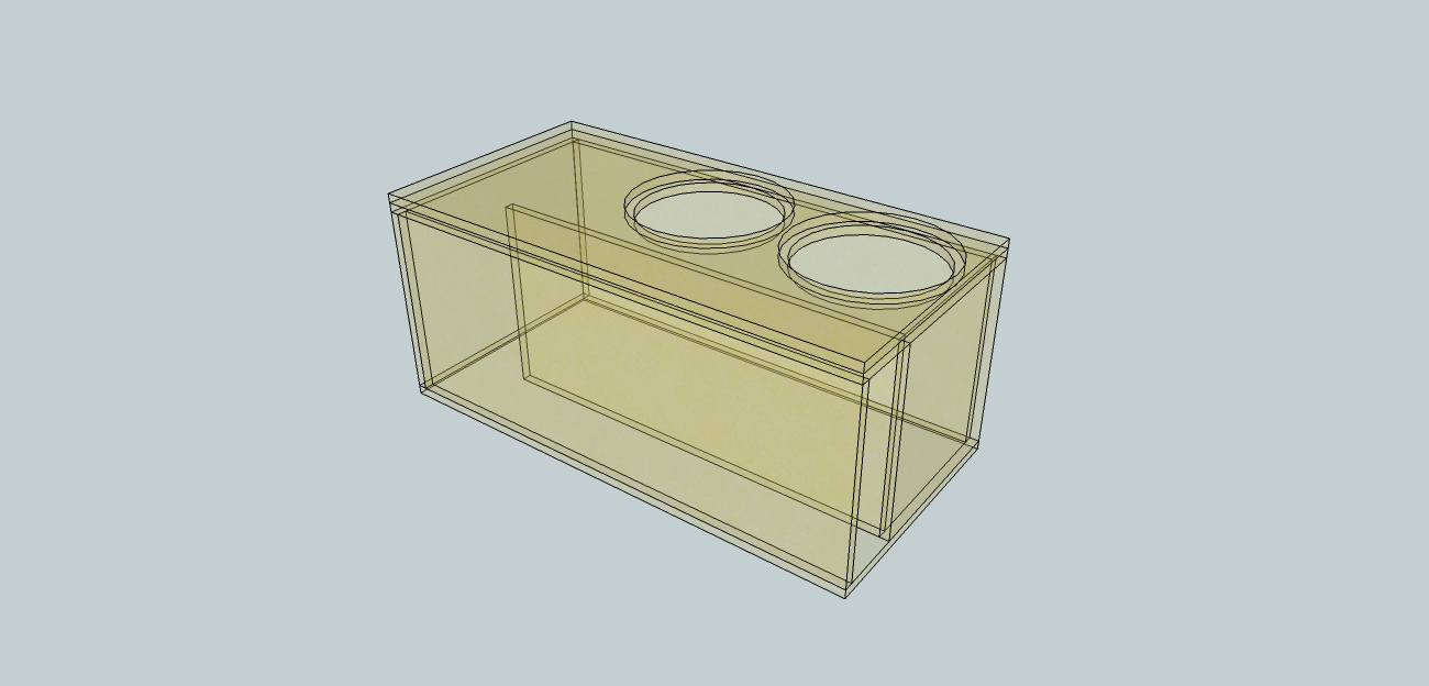

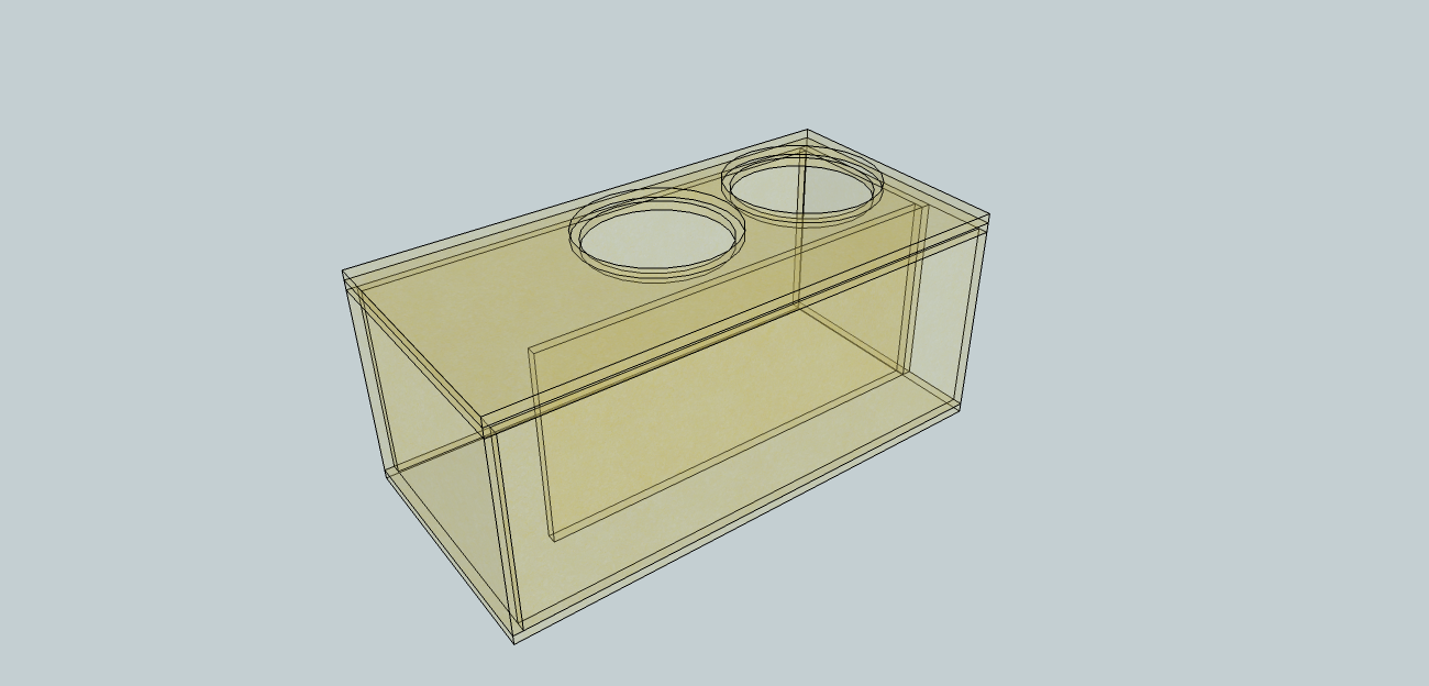

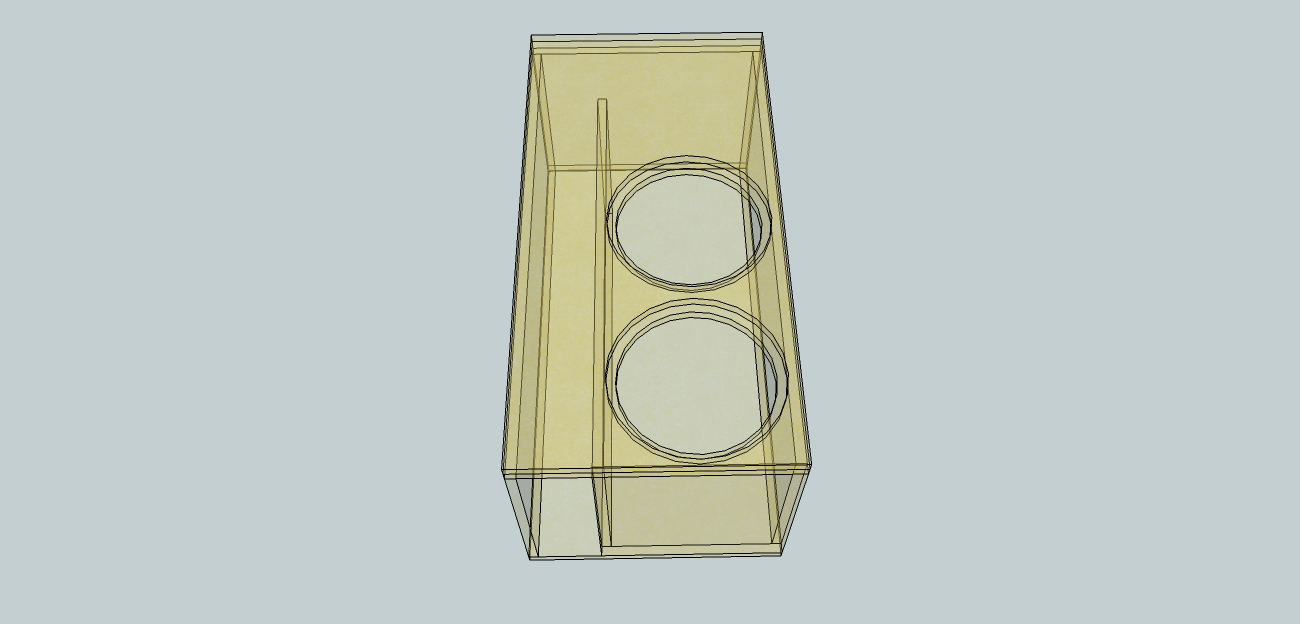

		ok so i used sketchup to design the enclosure you mentioned to the best of what i could tell you were saying. Did i do it right? is it tuned correctly? whats it tuned at? Oh and i think i kinda went overbaord on screenshots, lol
