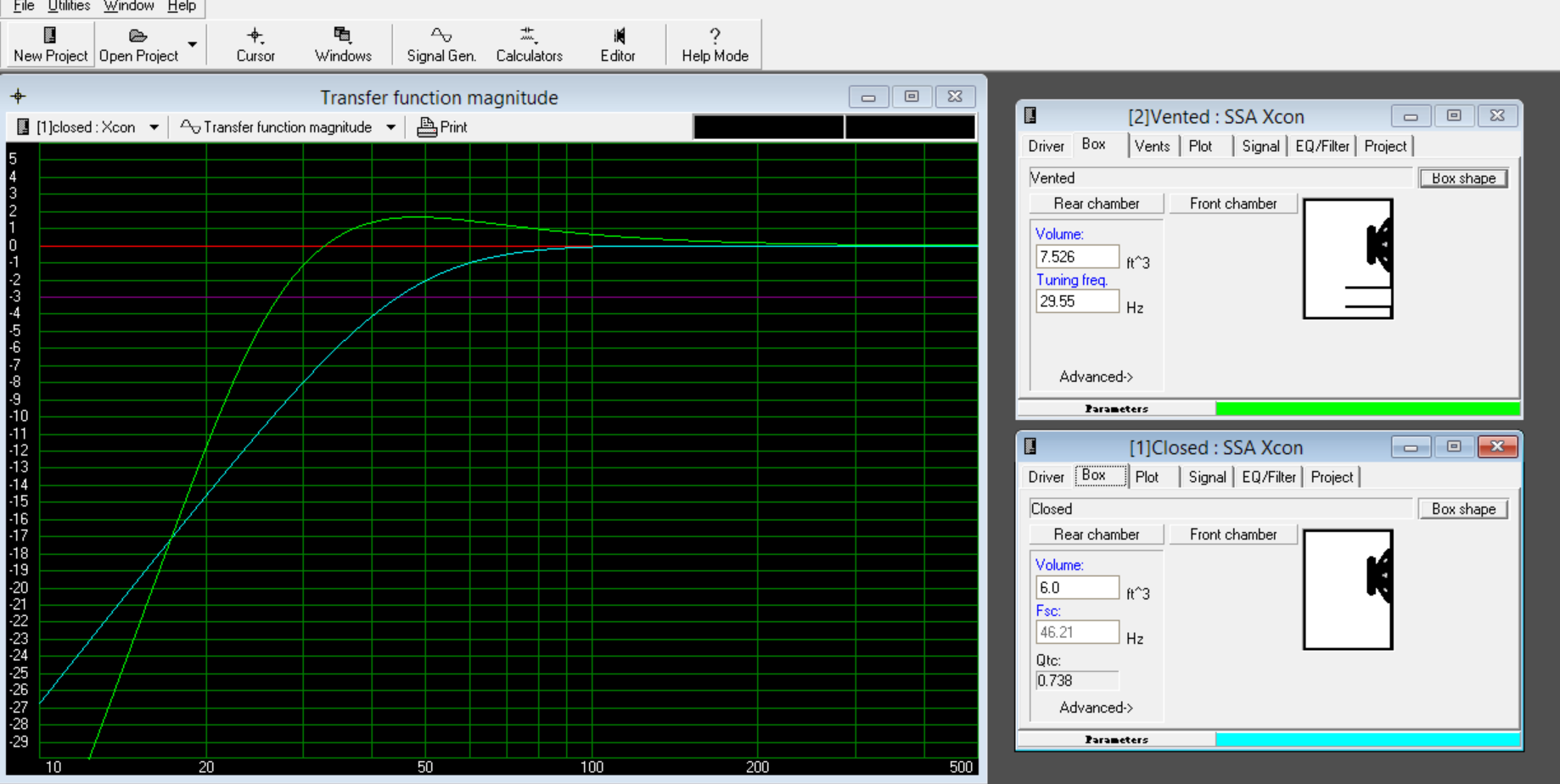

  3. Yeah, thats pretty much my dilema. Does it look like I used Winisd correctly? Its a fairly confusing program. 6ft^3 sealed or 8ft^3 ported...its gonna take up a lot of space either way, may as well just port it.
  4. Hey guys, I have my second Xcon and needing new enclosure but have been debating staying ported or going back to sealed (save cargo space) Anyway, I am first time user of Winisd and not sure if I did this correct so could someone let me know if it looks ok? How do you interpret this graph? To me it looks like ported is the way to go. (I modeled using two 15" Xcons at 1000rms each) Let me know if you need any additional info about my setup...believe my SUV cabin gain peaks @ 49 Hz.

  9. yes, I would be going from 1400rms @ 2 ohm to 2,000rms @ 1ohm. (In the future who knows?)Basically 1,000 rms to each sub - whether it be ported or sealed. Considering sealed mainly for space and/or lower cost for the enclosure. But if my plans allow me to have the bigger ported box and the price of the enclosure is feasible, I will gladly stay ported.
