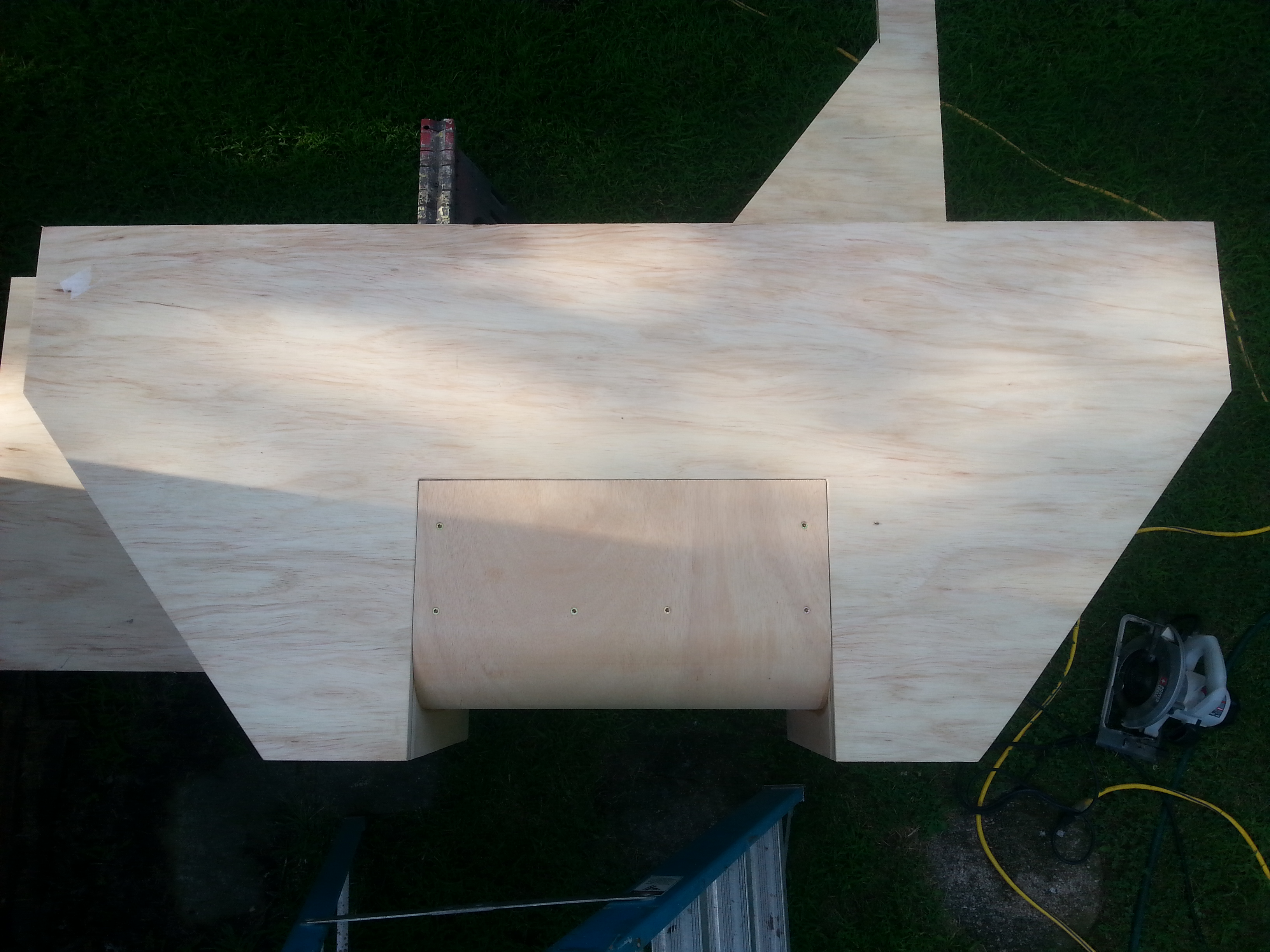

  • MI....I haven't been up there since I was a kid. LOL Thank you for the compliments!!! Well, I have one more freaking panel to cut and it's too dark to see out here so........ HERE'S SOME PICS!!! (onl
  • Whew it's been a long time since I've done a build for myself. This one is modest and not going to be as insane as my last, but then again I am a little bit older now...
