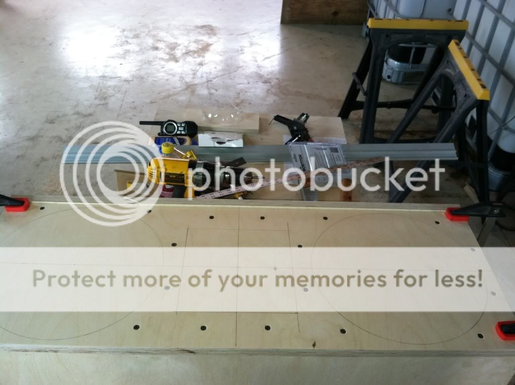

This is how I had to leave it today. I got the outlines for the PR's drawn and if you look very closely you can even see the center holes. Those holes are drilled down to the first baffle beneath. That hole lines them up perfectly so I can transfer the hole for yhe plexi windows through both.

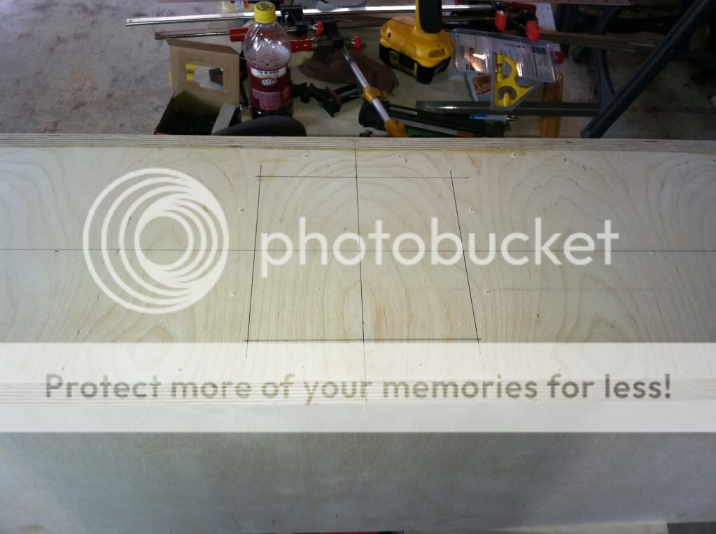

Here I've drawn on the cutout for the plexi window that's on the front center.

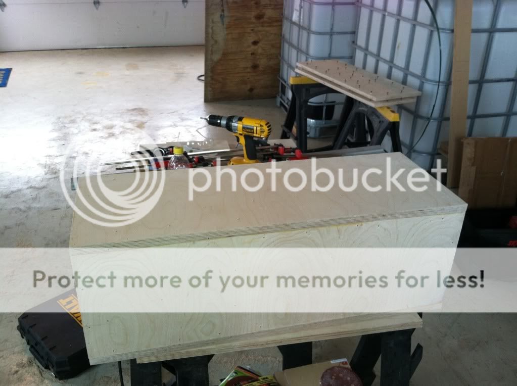

I've gotten the front double baffle screwed onto the front of the enclosure, everything is set and will be centered up and in good alignment at this point thanks to holes I drilled as reference points through the double baffles into the body of the enclosure.  The holes are drilled through parts/areas that will be removed by the cutouts so there's no worry about sealing them up later.
AED7E3B2-5E6C-46CB-88A2-9220D95B8E23-194
Notice the double baffle panels removed in the upper right corner?  Back down to the body of the enclosure now.  Getting ready to draw on the cutouts for the plexi panels using the holes I drilled for reference.
