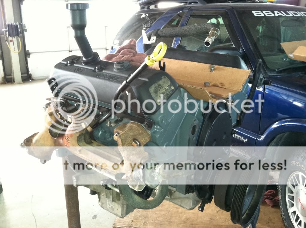

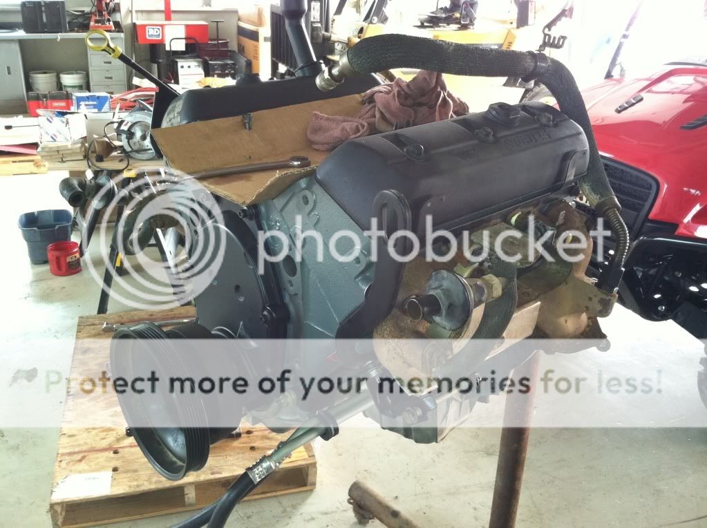

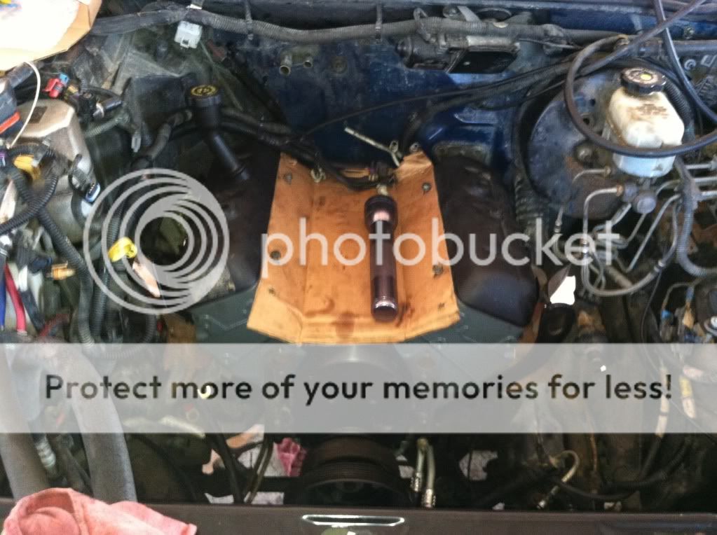

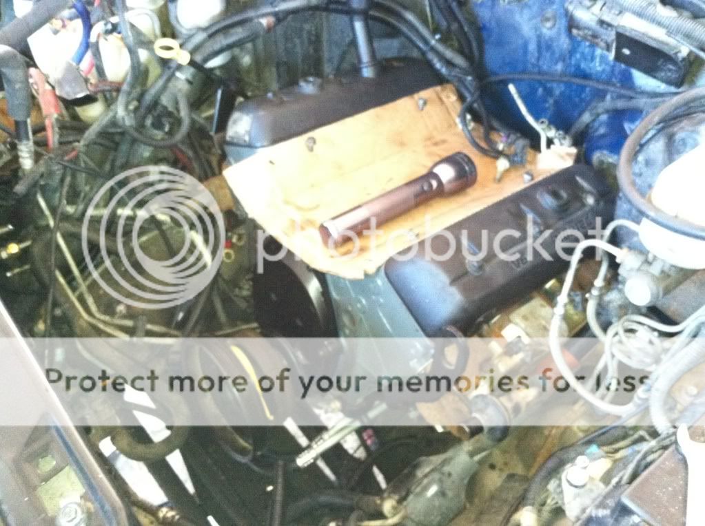

Well, with all the necessary parts in hand finally, the last of the reusable parts cleaned up and installed on the engine, and the vacuum lines finally replaced in the truck, the process of installing the new engine can actually begin.  And has.
I don't know how anyone could possibly replace the vacuum lines with the engine and transmission bolted into place.  I had a tough enough time doing it with the engine out and the front of the transmission lowered down.  I managed to get it done, every rubber vacuum and vent line under that hood has been replaced with a brand new one.  My 4WD and heater/AC controls should work wonderfully well now that the vacuum can actually reach the locations it was supposed to.  I could see them collapsing under the vacuum before, shouldn't be a problem now.  I also tested the 4WD actuator under the battery tray as well with a vacuum pump here at work to verify it was in good shape.
On to a few pictures for the fun of it.
Here's the reman engine on my dad's old engine stand he built himself when he was doing all his engine/transmission work.  It's pretty damn sturdy, though this V6 wasn't any sort of load for it really.
8A3A617C-96EA-4034-80B9-99112FE3C4A0-355
5BFA5B3F-8C5D-47BB-BDFD-78F8053ABC17-355
Here's that engine dropped down into the truck.  At this point it has 6 of the 9 bolts that connect the trans to the engine on the bell housing along with the motor mount bolts in it.  There's still a lot to do but I think I can call this making some progress!!!!
0EE35455-F18C-42E0-85FA-74786756BA4A-355
BB382853-D95B-4E23-A98C-E75D4D629CFC-355
Finally!  It feels as though it's taken a year to get this far.  I'm so damn glad it's sitting in the truck.  All I gotta do it get it put back together and I'm done, I hope.
Craziness!!
You've never seen craziness like this thing.  It's an American built Chinese puzzle box!  Everything has to come apart/go together in a very specific order and you need hands like a child to reach quite a few things in it.  For example the upper bell housing bolts on the sides are SO close to the firewall that I had to stick a pry bar up in there and push the firewall away from it to even be able to get a socket on the bolt.  That was even after taking the rear transmission mount out and lowering the transmission down until it was resting on the cross member.  Damn do I wish I had a body lift on it, LOL.

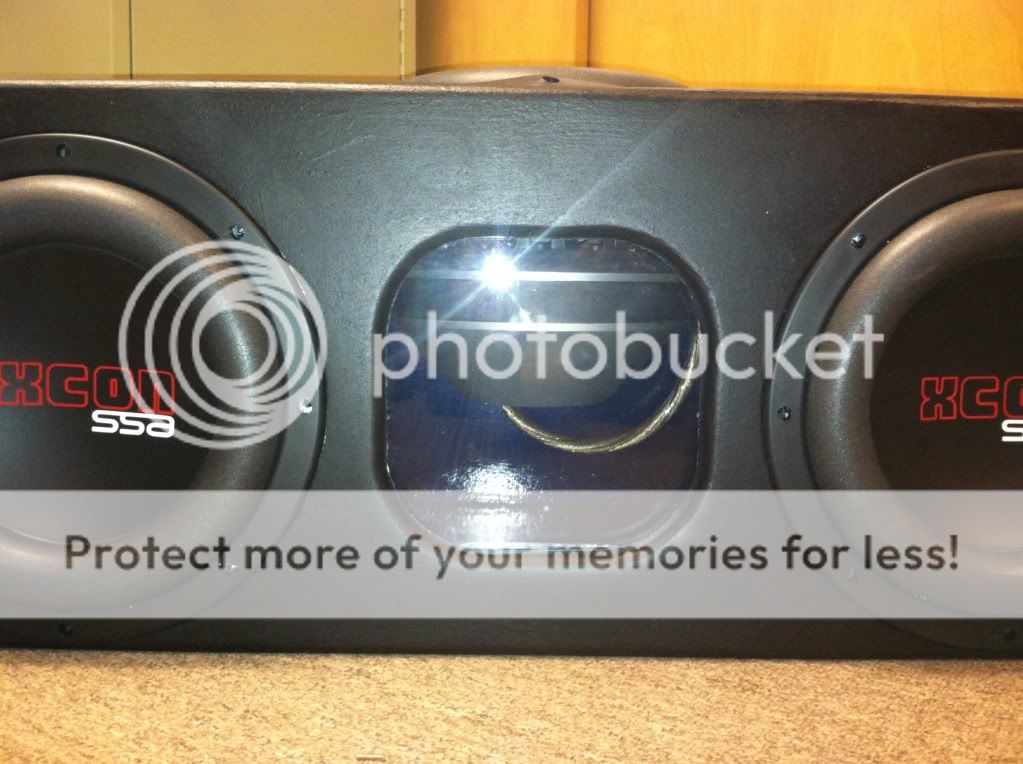

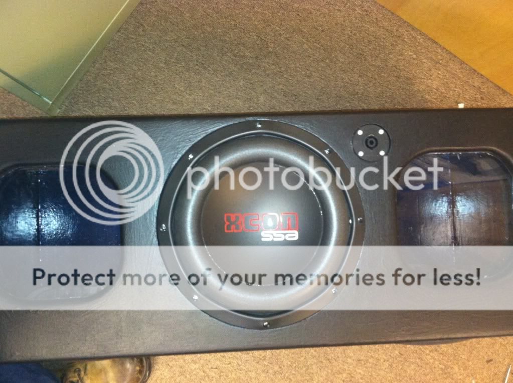

OK, GREAT NEWS!!!!  Got the engine completely back into the truck yesterday, everything on it, timing set and the engine test ran.  Things went very well with it, it started and ran without much of a problem through the initial start up period and it drove around just fine after that.  The only problem with the whole thing is that it appears I didn't get quite enough RTV on the very bottom of the timing set cover where it meets the oil pan and I have a fairly good oil leak right there.  It shouldn't be too tough to lower the oil pan back down, clean off the oil and reseal it all while it's in the truck so I'm not too terribly worried about it.  Couple that with the fact the enclosure is done and the PR's ready to tune and it's been a good week!  Here's a few pics for the fun of it.
The engine as everything sits right now.  Simply unreal how long this has taken and how much work has been done.
3FFAEA85-FDAB-4678-A46B-48E53A464239-121
This pic turned out nasty, but it gives a great overall view of how it looks.  Even came out pretty damn close to what I had envisioned.
08C94BBE-C907-4852-8A45-0B780D13A12E-122
Here the motor of that XCON can be seen through the plexi, per it's design.
B9219BEA-CCD4-4A1A-A194-E92F2DD0BFA7-122
It will be so much fun to try to explain to people that there's only one sub in the box and then see the look on their faces when they look through the windows on the top and get this POV.
EDF0BA15-58A1-43FE-8C6E-539740DD56B7-122
