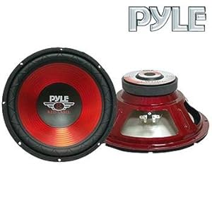

August 2, 201115 yr For the sake of keeping it cheap, I say go ported. I did a Tang Band 8", the WP-740 I think, ported, 1.5cuft with a 4" aero tuned to 28Hz. It turned out pretty bada$$. I used a 150 watt plate amp. I'm sure the REx 8 is pretty similar to the Tang Band. I'm not sure about the PR setup. The seem to drop off pretty quick below tuning, at least that's what I've seen when modeling one in WinISD. With that being said, I think it would be uber bada$$ to use this as a PR:My linkI don't know if it'll work worth a damn, but it would be a hoot to hear some good bass and see one of these wanging.

August 4, 201115 yr For the sake of keeping it cheap, I say go ported. I did a Tang Band 8", the WP-740 I think, ported, 1.5cuft with a 4" aero tuned to 28Hz. It turned out pretty bada$. I used a 150 watt plate amp. I'm sure the REx 8 is pretty similar to the Tang Band. I'm not sure about the PR setup. The seem to drop off pretty quick below tuning, at least that's what I've seen when modeling one in WinISD. With that being said, I think it would be uber bada$ to use this as a PR:My linkI don't know if it'll work worth a damn, but it would be a hoot to hear some good bass and see one of these wanging. PR and ported have pretty much the same roll-off, both are 4th order enclosures. PR's have a little notch in the roll-off because of the resonance of the PR, but that's generally the biggest difference given equivalent alignments. Wouldn't recommend trying to use those Pyle's as a PR As to the original question, PR generally allows for smaller enclosure because the PR displaces a lot less volume than a port, especially in small enclosures. However they can be an added expense to the cost of the system which isn't necessary if space isn't a concern, and it saves the issue of having port noise from having insufficient port area. Other than that performance between a PR and a ported enclosure will be roughly equivalent. Other than that, without knowing your goals hard to give any further recommendations.
