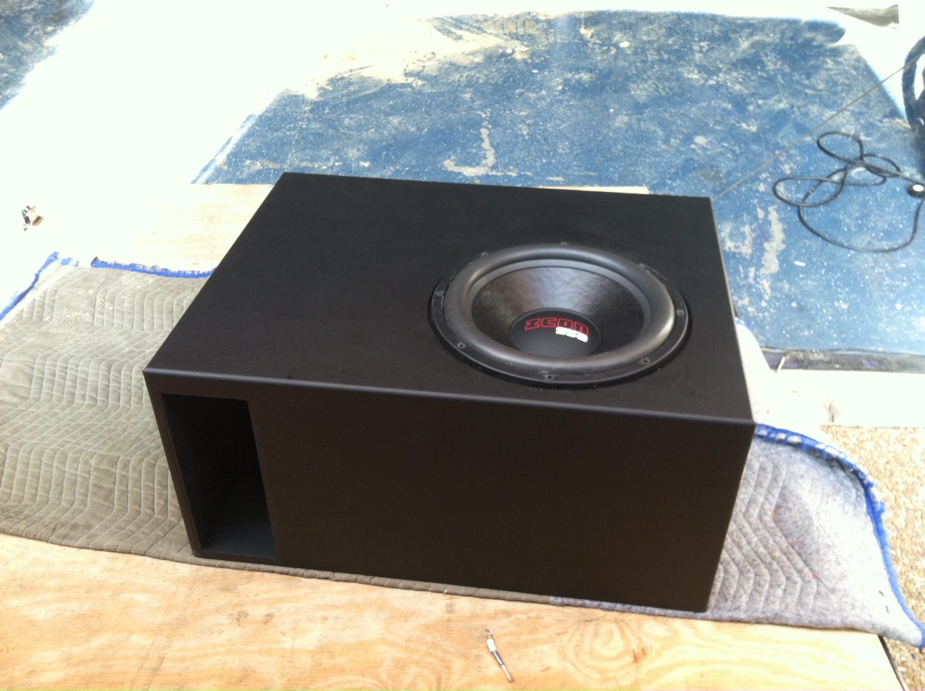

Dat box is da sexaniss!!! Senchez is probably scared of it though.....LOL
Badass bro!
What is that coating? Looks more than straight paint.
In for vidzzzz
It is regular flat back paint brushed on. It was still wet when he took pics. I will let him give his opinion but it slams hella hard. Threw the box in my truck to test before his and seriously pounds. Very clean, tight, deep and hard hitting. Making me rethink my build and I may just snatch up some Zcon 18's

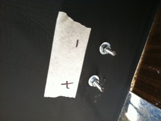

Are those still the galvanized bolts for the terminals?
Well its textured somewhat. Its just fake leather but looks and feels good to the touch. Cleans nicely to with soap and water.
The terminals are just zinc plated all thread. They work just fine.

Ok, I did a few things this morning. First was, I corrected my RCA's, the sub output, was NOT going to the sub input of the AQ :Doh: !!! This is what was REALLY causing the scratching noise, well that combined with too large of an enclosure. Well, I did that, then I installed the Zed to give it a listen and wow. I really can't explain how amazing it sounded. for 600 watts, there was a good bit of output. but compared to 1200, I simply took it out. But man oh man, like, never mind, I'm not even going to attempt to explain how well it sounded with the Zed lol. I will be installing a amp rack this weekend, so that will be the next update so stay tuned!
So you never got a chance to try the old box with the correct signal?
Either way, the new box is way nicer.
