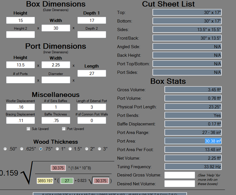

Dimensions: 30w x 15h x 17d
2.25 ft3 tuned to 32hz
I got a design from RAM-Design. Here is what it looks like in Torres.
I haven't really designed a box for myself yet, I'm still learning about box designing.
post-23205-0-59343200-1343192379_thumb.p
I am peaking around 37hz according to WinISD. I do know you cant always trust that because it doesn't know car accustics.
Any type of box that I design always comes out to peak around 37hz with the Icon. Is there a way to actually drop it down to 33hz?
bigger box ??? But then you lose power handling...
I tried a bigger box, but it stays the same.
Less port? might do it... Not too sure.. I've modeled my Xcon and with a bigger box the peak is lower only by like 2hz though so not worth the size difference to me...
I just really wanted something that hammers the lows.
Can you just tune lower? Like say tune to 30hz and see where it models for peak? I'd think that should murder the lows but you might need some fill-in with the speakers of your front stage as the subwoofer won't be reaching the higher frequencies as much....
That did drop it down to 33hz. How low can the Icon go? Could I go to about 29-30?
It can go however low you'd like .... Obviously you can't push it the same way as if it was tuned higher...Not sure what would happen to power handling or excursion issues? ... someone else may need to chime in there... But you have enough port area? Again someone else should chime in...
Yes, you can go that low. As long as your an advent user. Or just know how to use your senses lol. I don't see a problem with tuning that low. i wouldn't do it. But thats subjective matter.
