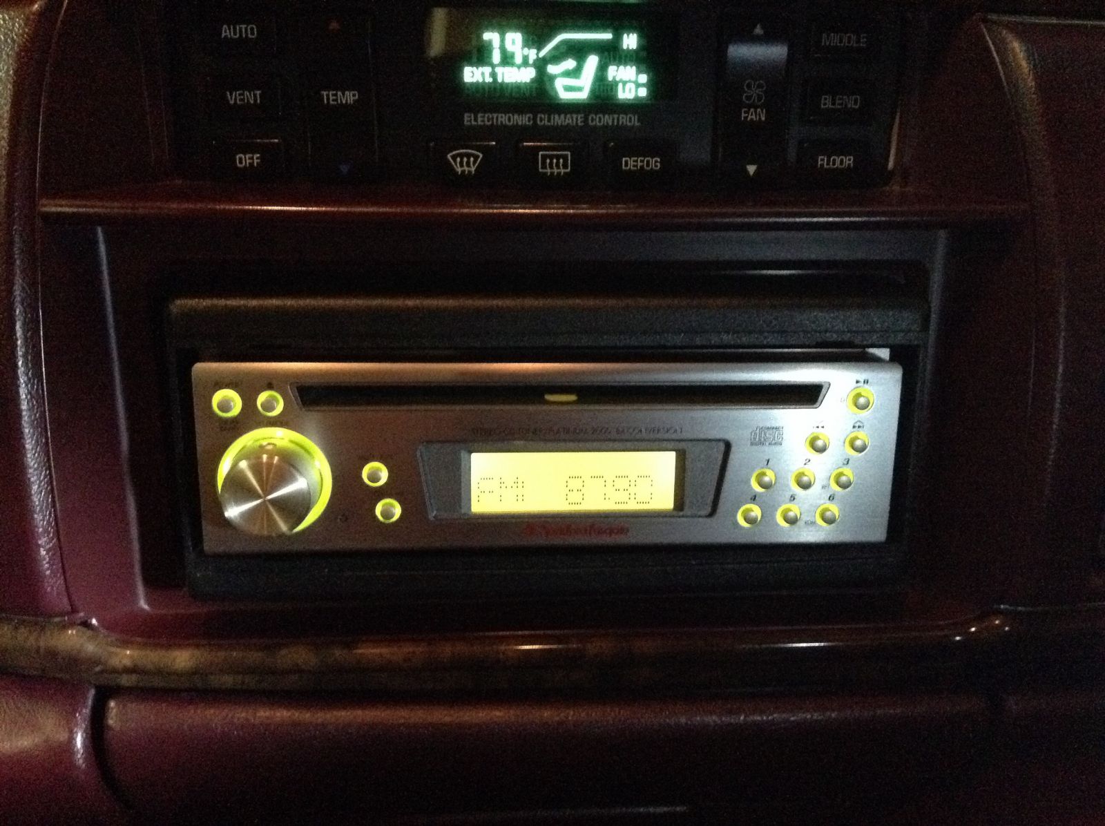

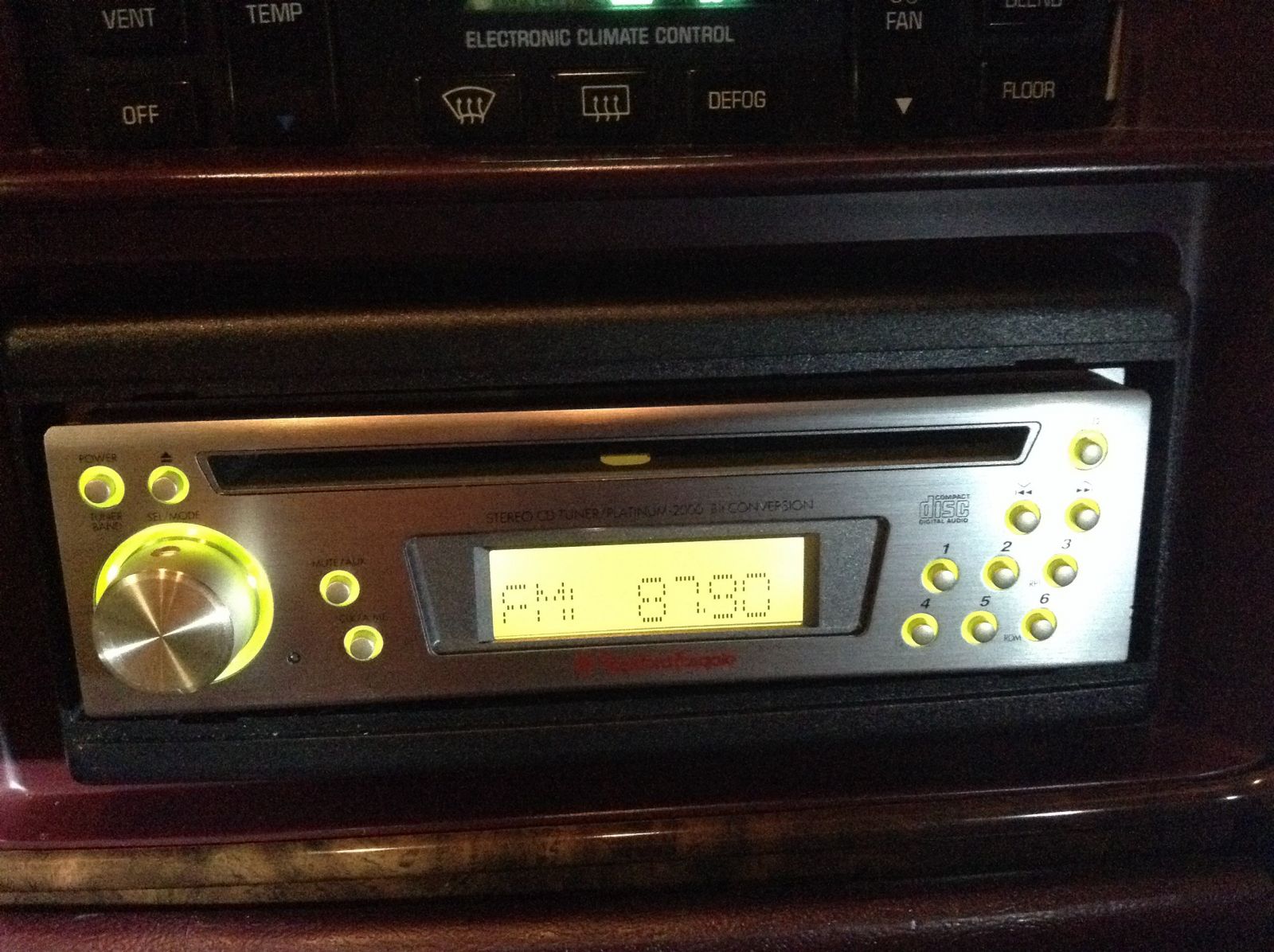

Anyways, got my Rockford Fosgate RFX-8250 installed today.  For those not in the know, this was RF's high end HU offering about 12 years ago (date of manufacture on the bottom of my unit is April '02).  It was OEM'd by Denon and is basically a rebadge of one of their units, although the exact model # eludes me at the moment.  I didn't buy it because of supposed sound quality advantages to the unit.  To be honest I simply love the aesthetics.  Nice and clean, simple, classy, functional.  That's it.
As with everything else, it took me a lot longer than anticipated.  Learned something new about my car today as well.  When removing the old HU I accidently ripped the connector off of the antenna wire (FUCK !!).  And apparently with my car if the antenna wire is not connected to anything the blower for the AC runs full blast and the display for the HVAC system stops working as do the HVAC controls.  So I was pretty excited about having to run to Radio Shack and praying the whole way there that they had the connector I needed.  They had one, literally, and it was sort of a shot in the dark when I bought it...but luckily it worked perfect.  I'd been screwed if they hadn't had that connector.  Then I had to make a 2nd run to town to get screws for mounting the HU.  The damn Japanese make their high end HU's ISO-mount, which pretty much nothing in the US is compatable with.  The dash kit I have supposedly works with ISO, but the fit/finish of every kit I've used ISO mounting with is shitty, and because of the design of this particular kit the screws I had weren't long enough.  So I wasted 2 hours today just driving to and from the store to get materials sad.png
As you can see (kind of), there isn't a trim ring.  The HU doesn't have one, and I couldn't get any of them I had lying around to fit.  I tell myself that I'll try to figure something out and get a trim ring on there, but the truth is I'm lazy so this is pretty much how it is probably going to stay.

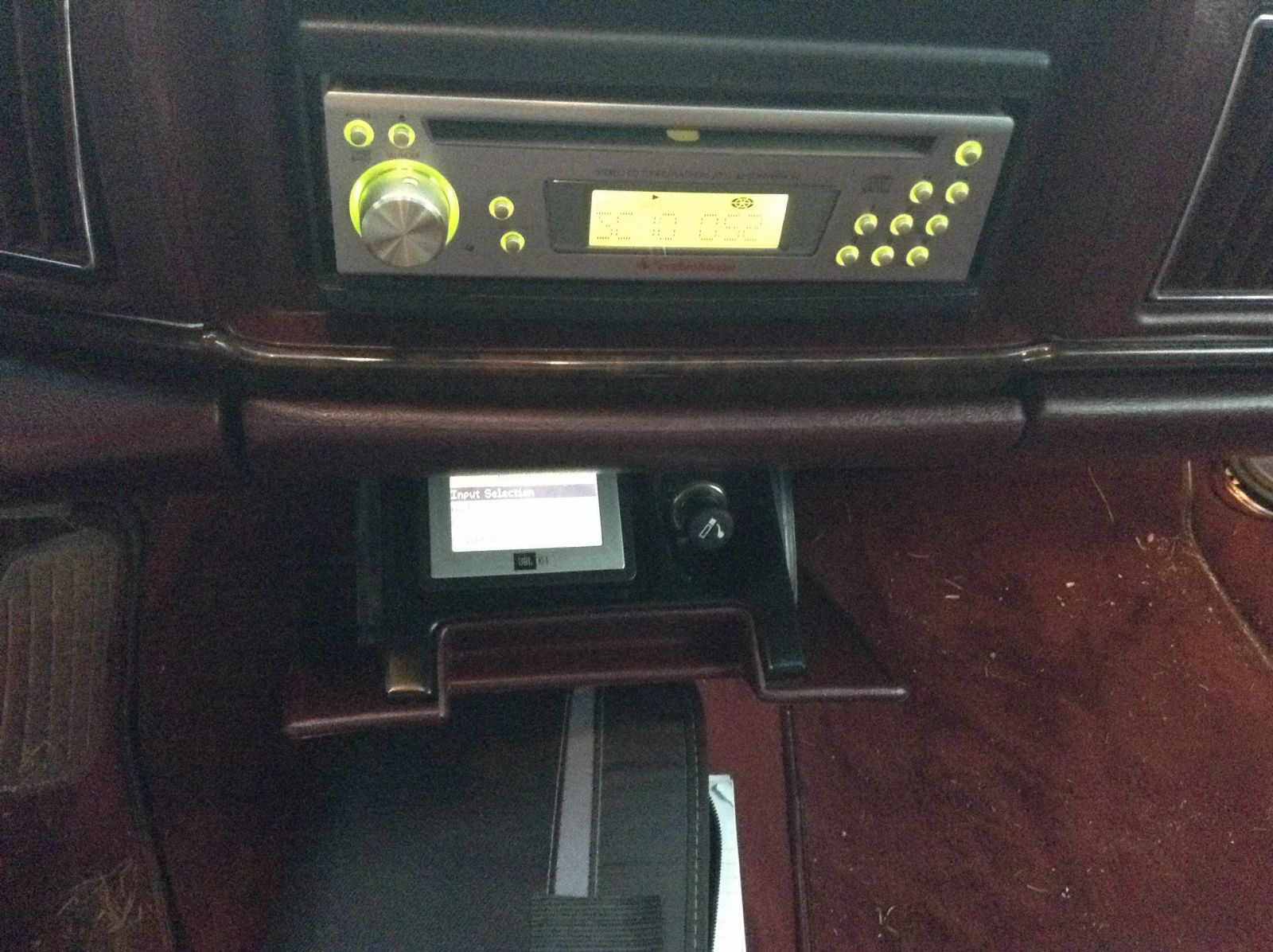

I needed to come up with a good hiding spot for the MS8 display... I really like hiding the display for a few reasons.  First it's one less thing for theives to see, being that it would look like a GPS to someone in passing it's one less reason for a theif to double take at my car.  Second it's one less thing shining in my face at night.  And last I think it just adds a little something extra to the install to have the display in a unique location and not just out in the open stuck on the dash somewhere.
In my old install I had the display for the MS8 hid in the overhead sunglass holder.  Unfortunately the Buick doesn't come equipped with a sunglass holder because, being designed for old people, it's presumed their "sunglasses" will always be clipped onto the owner's tri-focals.  So I had to come up with a new spot for this car.
What I found is that the display is almost exactly the same size as the ashtray.  So I popped out the ashtray, built a little mounting panel and secured the display with velcro to the panel so that it was still easily removable without having to tear the whole assembly out of the car.  Turned out well.  Simply flip the door shut and it's out of sight.  I was a little worried that the angle would be poor from the driver's seat but the display is easily visible :)

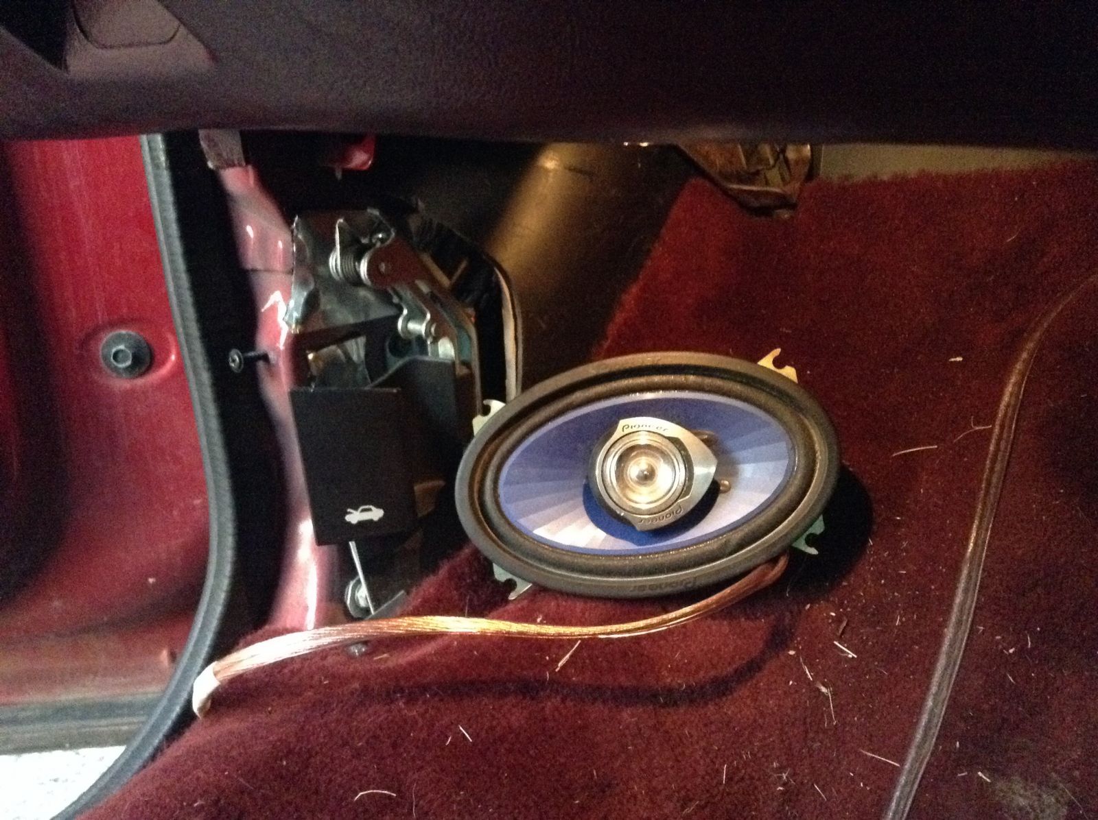

And as you can see from the last pic there, I finished up my kickpanel install as well.  What do you guys think ?  I spent quit a bit of time working on aiming to get the best imaging...I think it flows well and blends in nicely with the vehicle.  Almost looks stock !!

The hidden display is a nifty idea, I always had the screen off unless I was tuning.

Nice hiding spot.
Just caught up on the build. Nice updates. Sub baffle came out sweet. Love the invisible kick panels. New age shit right there.
