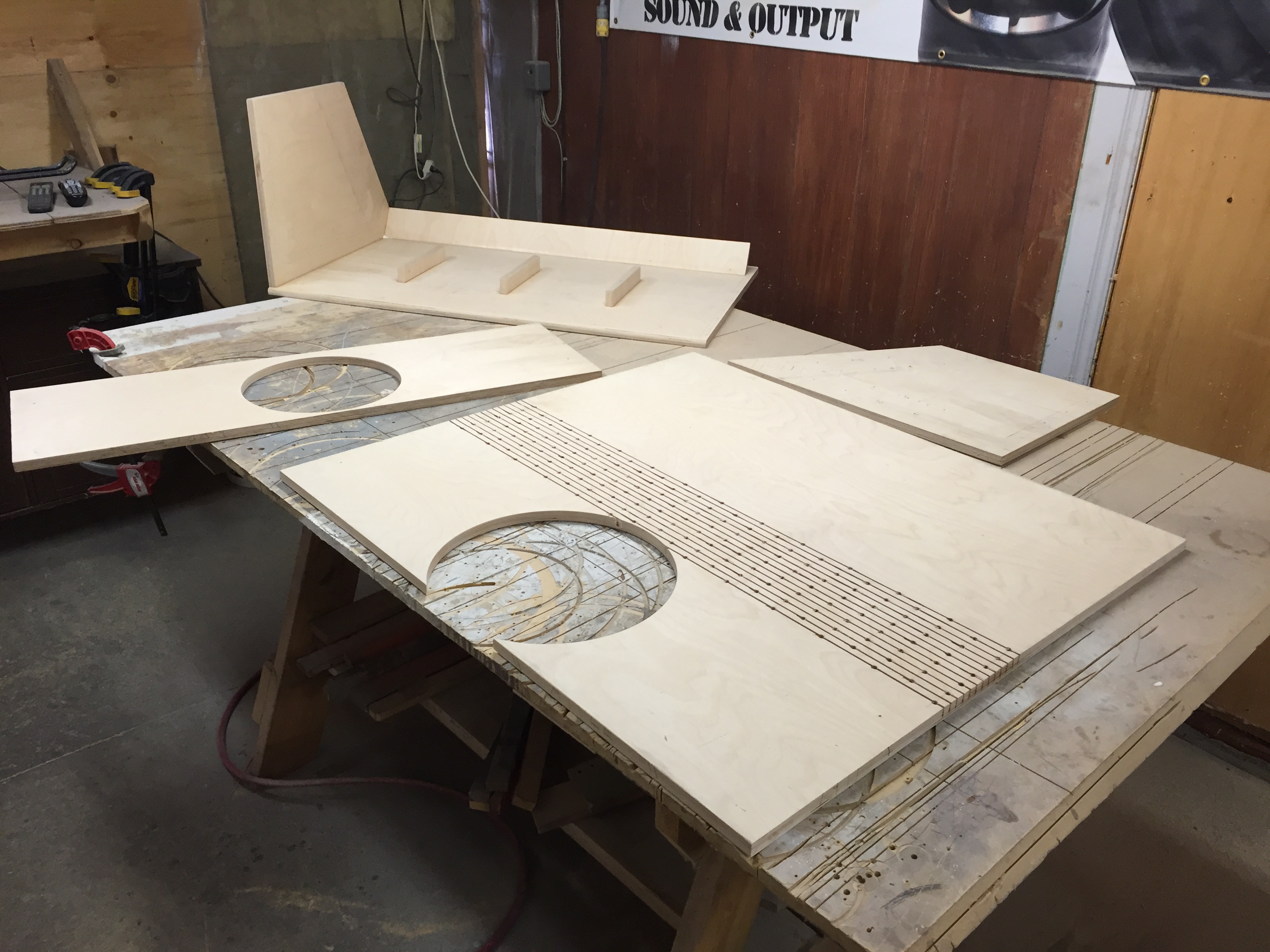

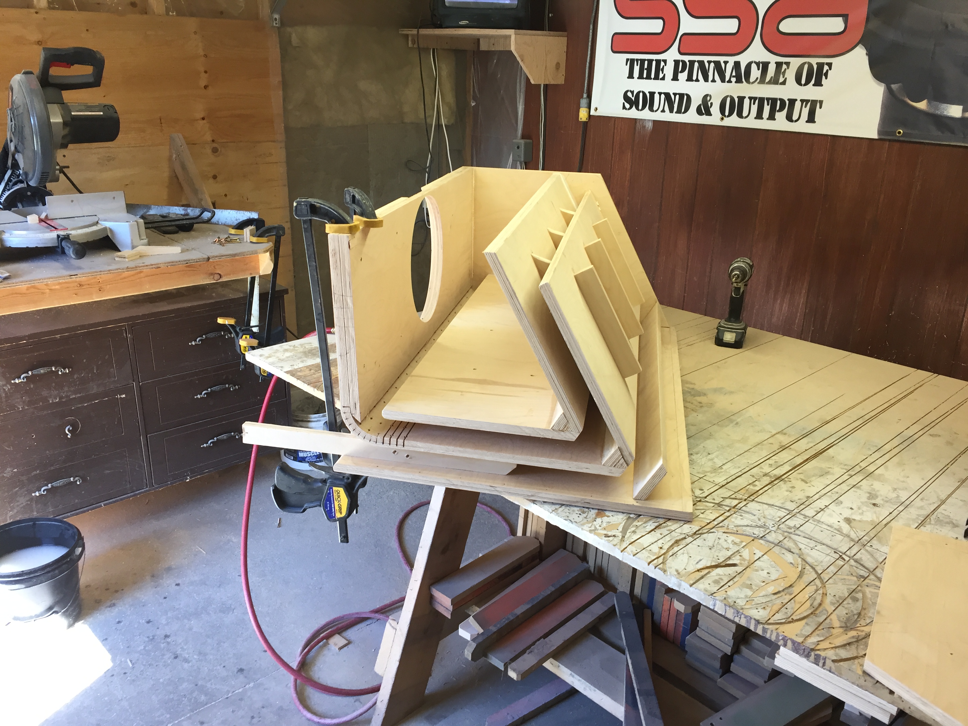

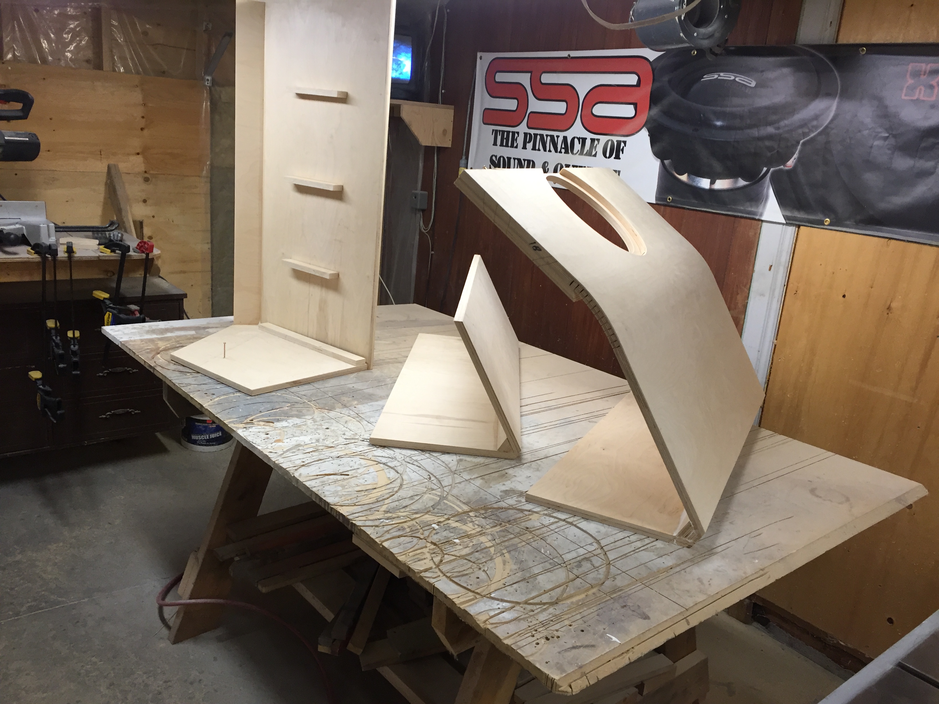

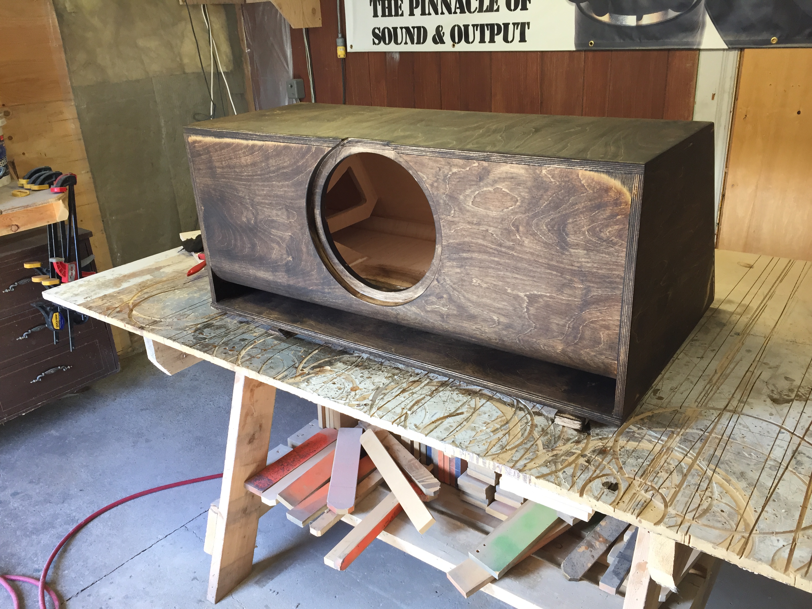

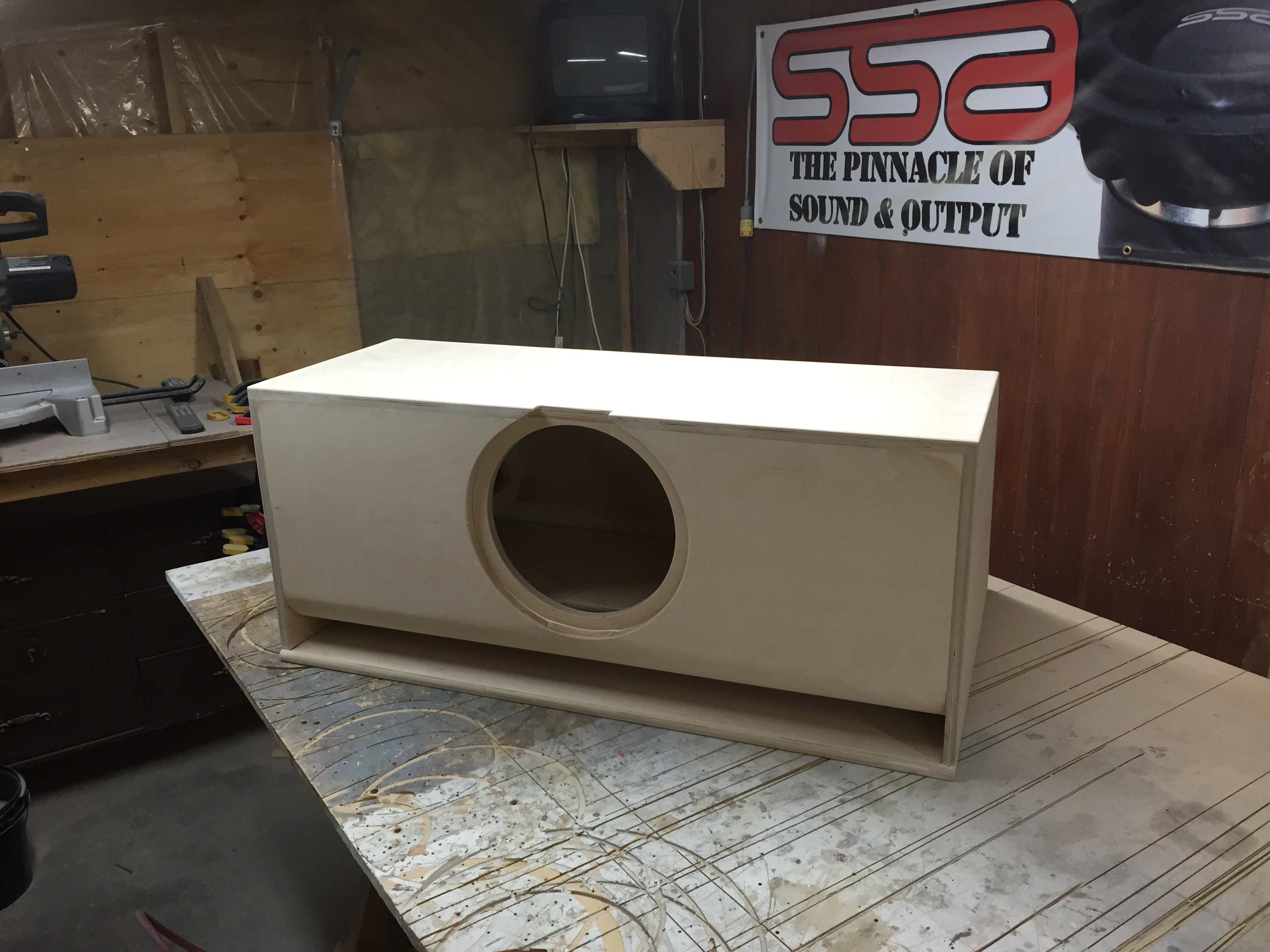

Posted April 10, 20169 yr a Baltic birch single kerfed flared enclosure for a FI Q 12" ..... 2.25cf3 tuned at 30hz
April 12, 20169 yr Love the stain man, what color is it that? Another wonderful creation, even a single sub enclosure is a work of art.
April 12, 20169 yr Author that's a dark oak stain I like working with birch but I'm not cutting another sheet until I have 60 tooth blades on my saws the shit splinters a bit with 32 teeth unless you cut REALLY SLOW.........................
