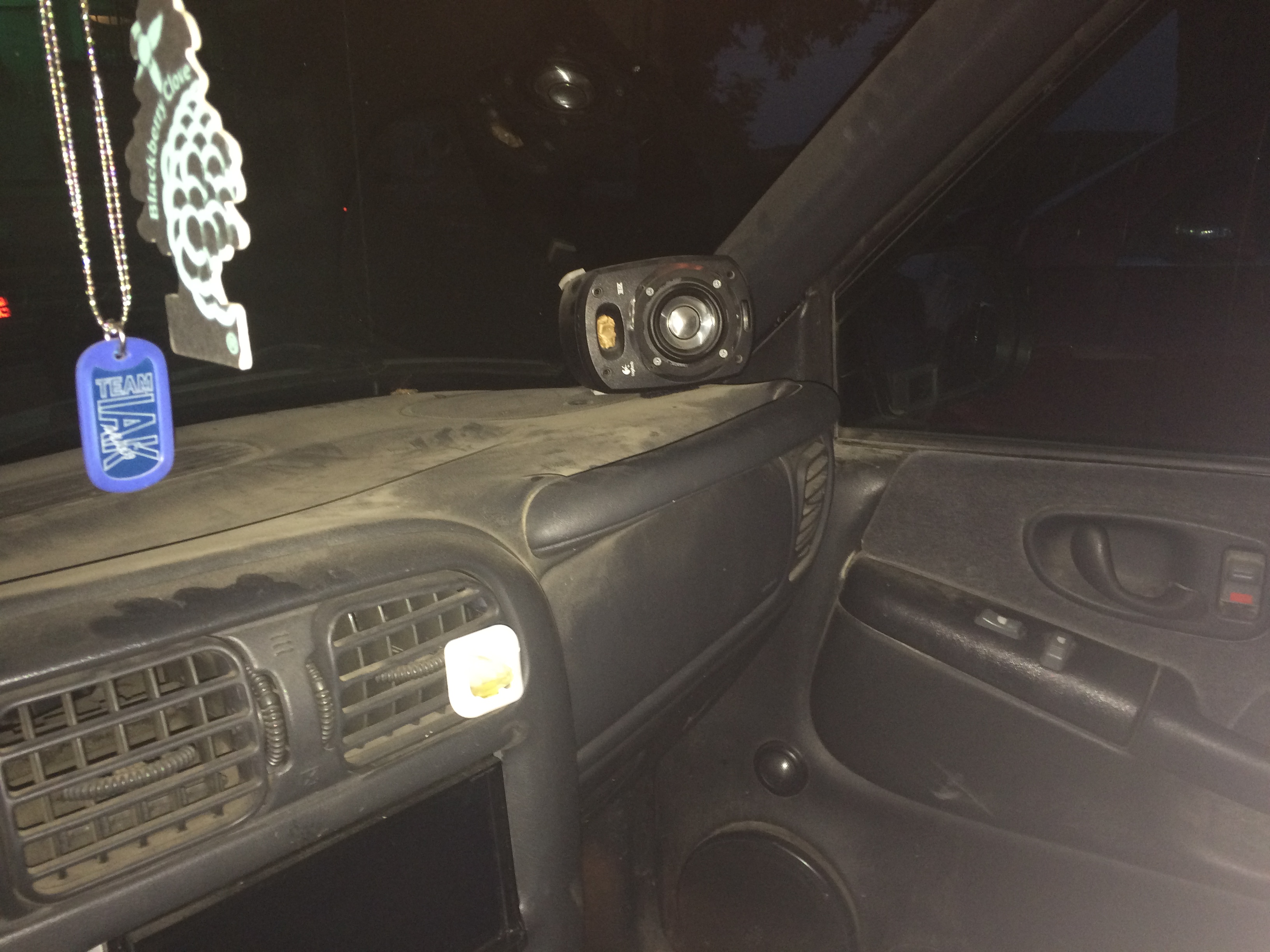

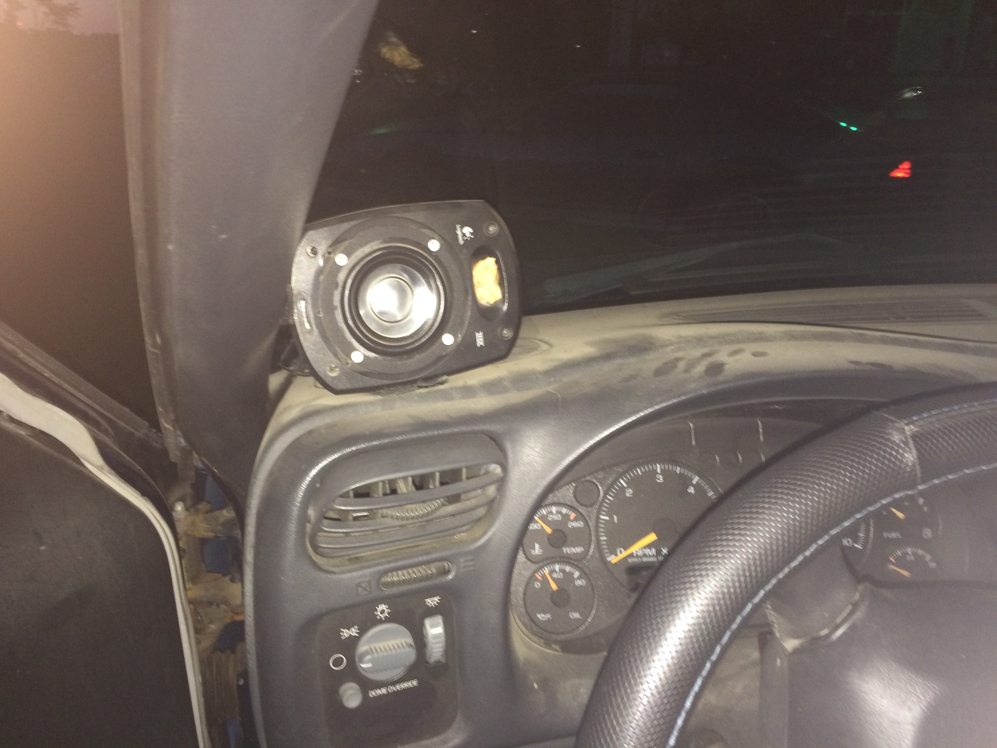

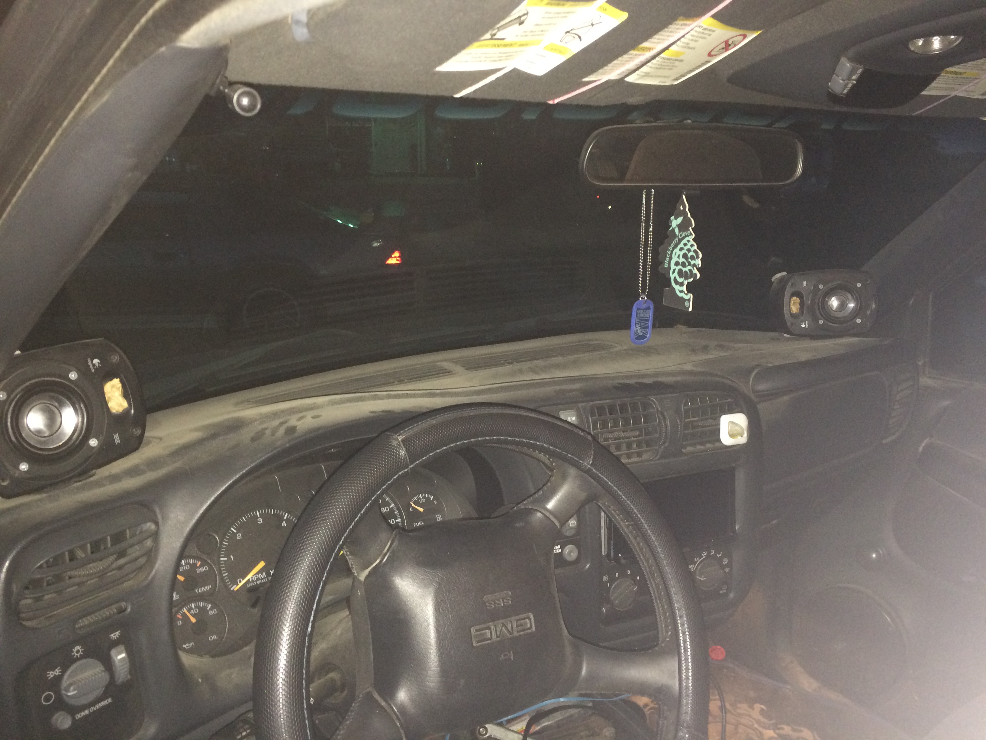

I tested the Auras, Faitals and some Fountek FR88EX drivers in small enclosures mounted on the far corners of the dash in my Jimmy. They are aimed on axis and I have a Focal Solid 2 powering them.
The Auras are fantastic but lacked the very upper octaves to my ears. Again the Faitals had no issues at all getting to the top of the spectrum but lacked the warmth the Auras have in spades and that I prefer to have. I ultimately ended up using the Fountek drivers as they seemed, at least to my ears, to be a fusion of some of the best properties of the Auras and Faitals.
Forgive the mess that my Jimmy is in on these pictures, it's really a beater not a show truck. Hard to keep it clean between the gravel roads and the mud/dirt/dogs/kids that are in and out of it constantly.
Also the little enclosures will be replaced by custom built fiberglass pods mounted to the sail panels when time and funds allow. Right now they work so well and are mounted securely enough that I'm not in a huge hurry to get them done.

This is what I was talking about. Myself, I would rather mount off axis, and adjust it the best I can, then have a on axis out of place speaker. Not saying it's what anyone else should do, just saying it's what I prefer myself. That speaker on the dash would drive me crazy. I believe in fixing the sound instead of just moving it to try and fix the problem. To each his own, but thats why I never understood the hole install is everything bit.
