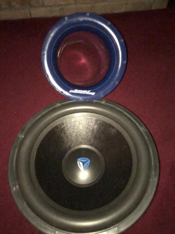

  • Box #2 taking form, much like box 1 but 4.5 c/f tuned to 35hz with port on drivers side for 2 Zv.4 12's. Just going to be raw finish for BassRace testing.
  • All is wired didn't take pictures!  Box #1 3c/f tuned to 34hz with DC XLm1 15":
  • Tonight's work still needs to be wired up! Had to break out the ole' dremel to do a little trimming:
