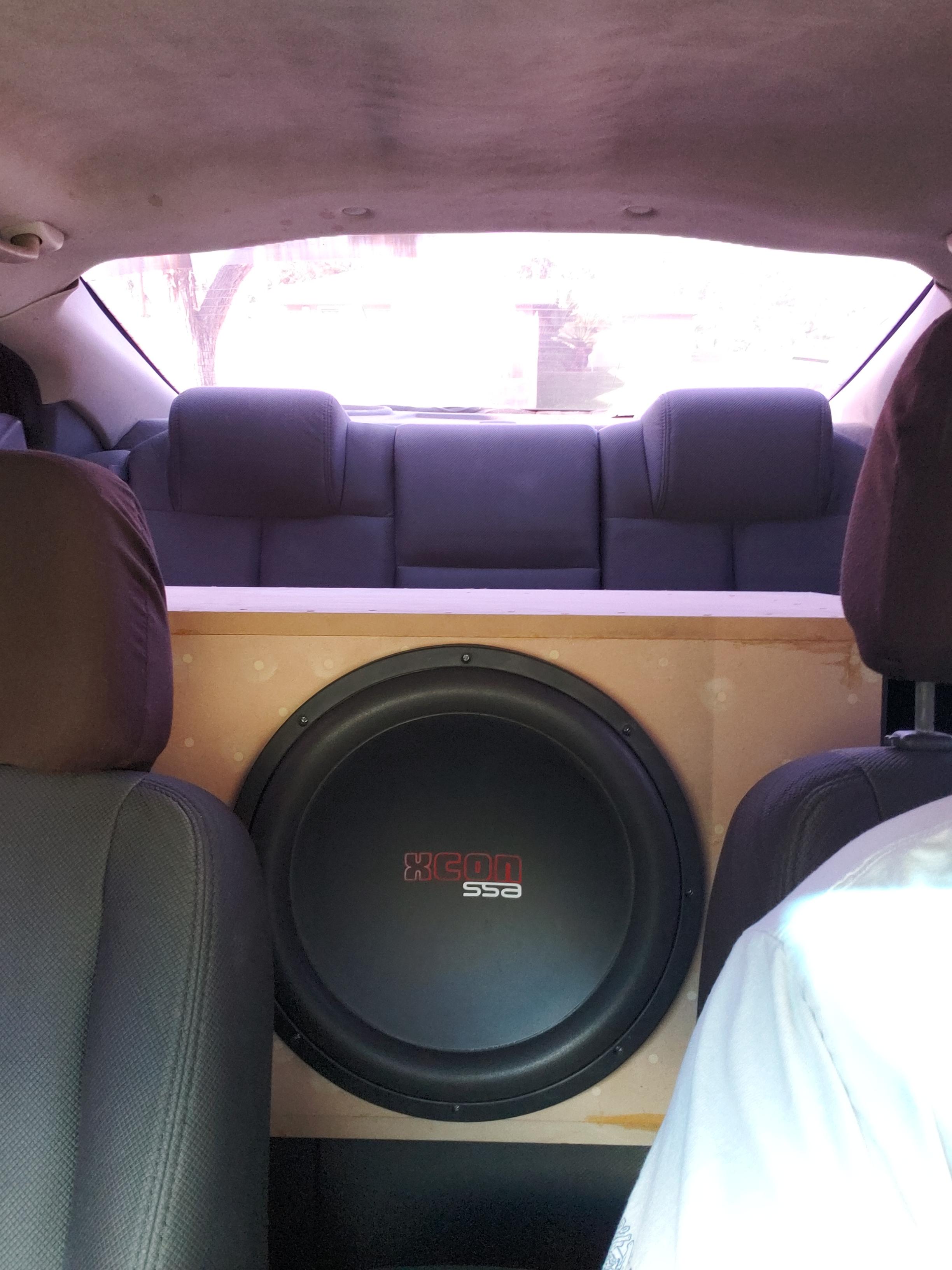

Thanks for all the suggestions, I think I'll go with what most have stated and try a smaller box for the 15. Here's what I ended up doing for the meantime haha.
  • Admin
Back seat driver!!!! ;)

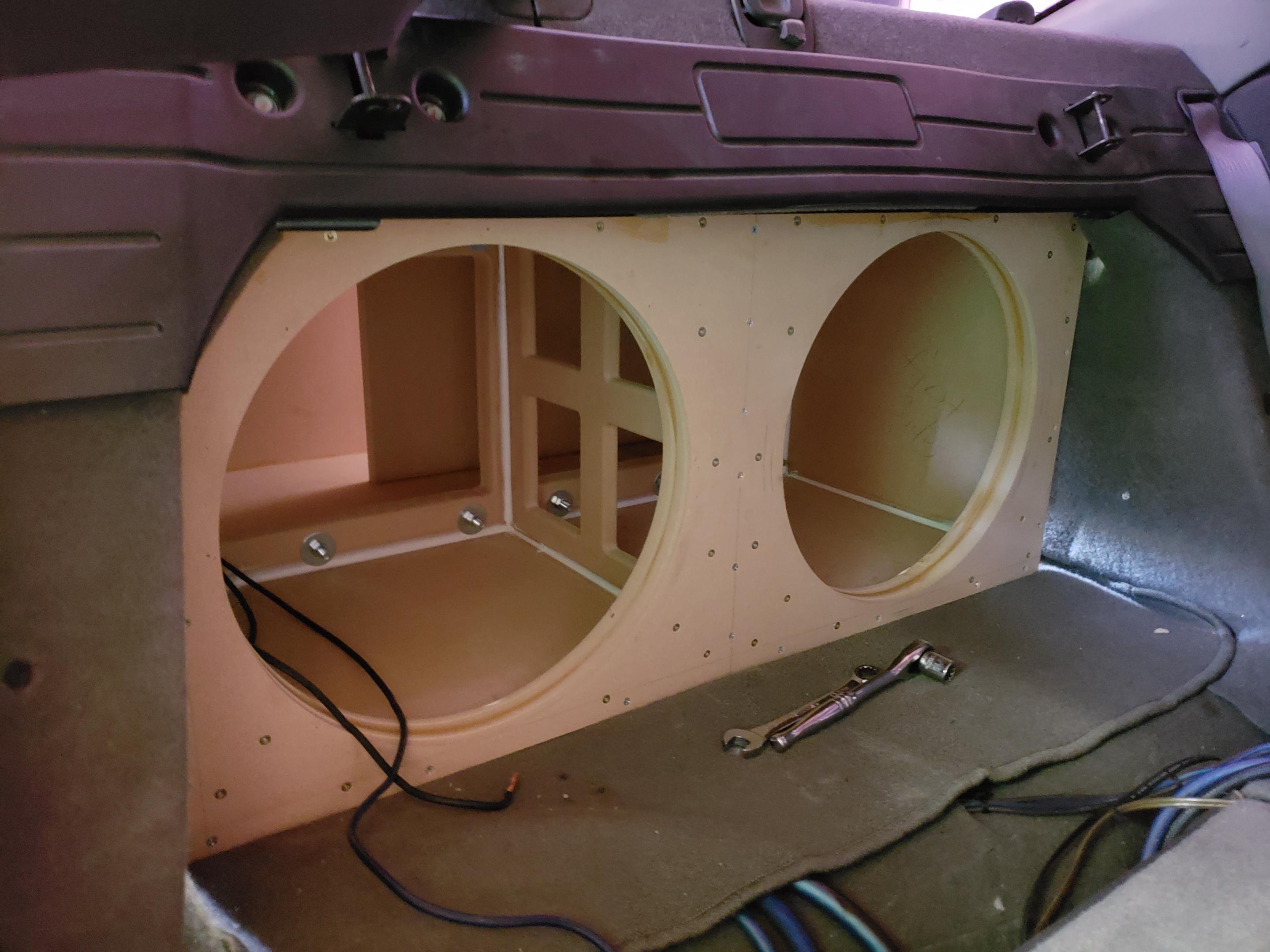

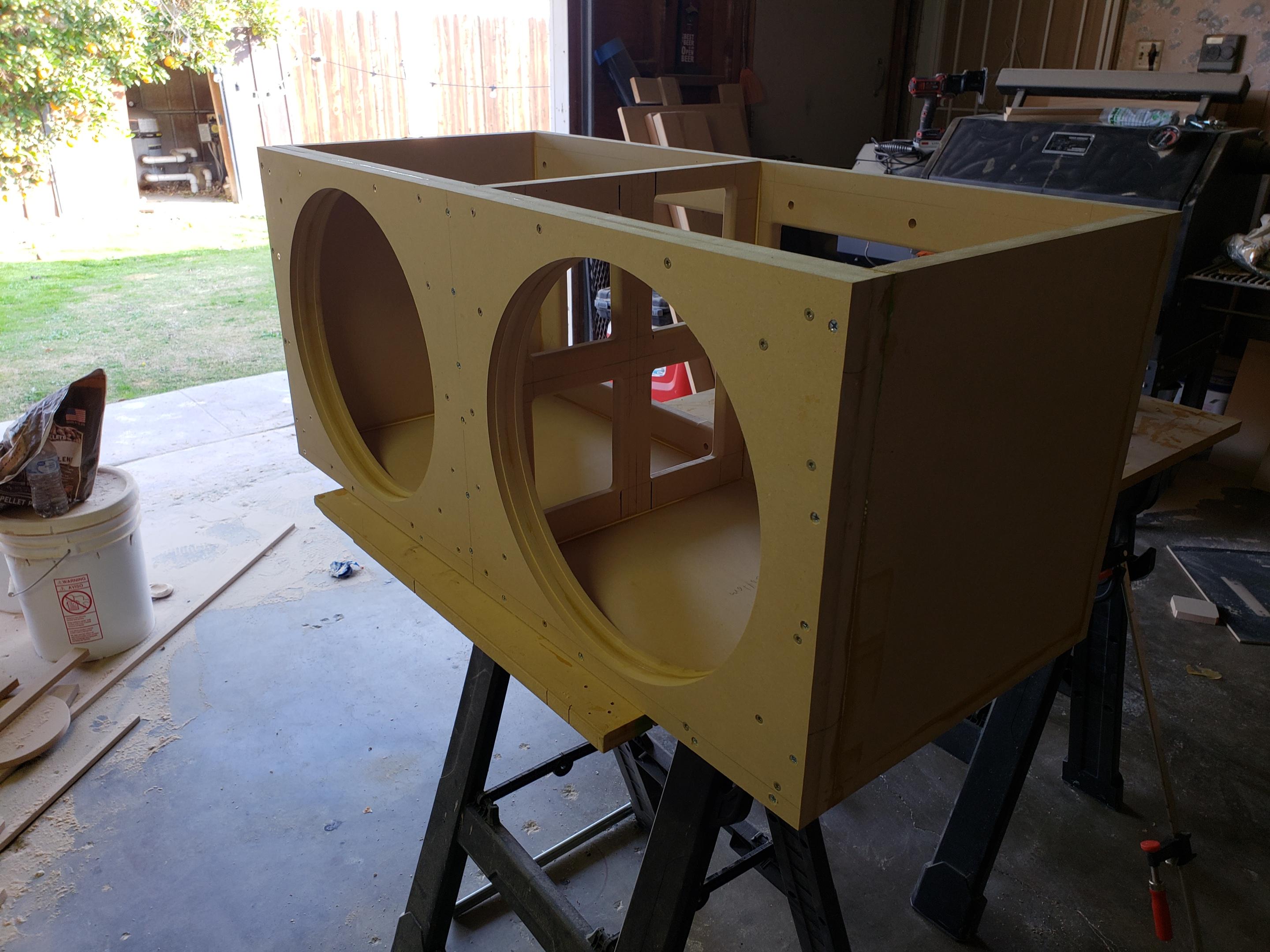

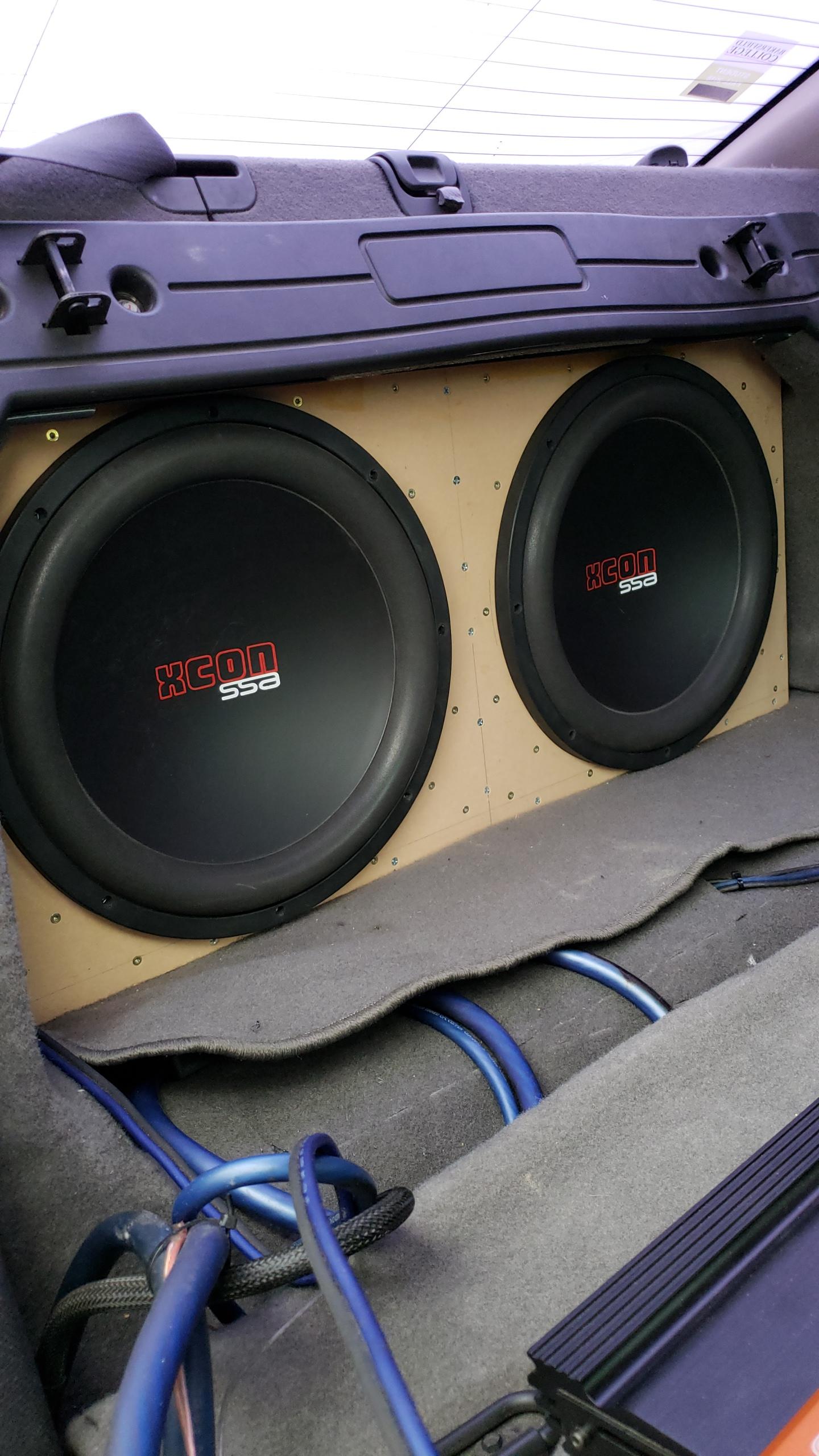

So I ended up going a different route, and went with 2 15's haha.
Built the box in two parts so it could fit in the trunk more easily.
  • Admin
Looking good so far.
:woot:
Well that escalated quickly, looks badass man
1 hour ago, jcarter1885 said:
:woot:
Haha thanks man. Some day I would like to get it metered see what kind of numbers it does.
