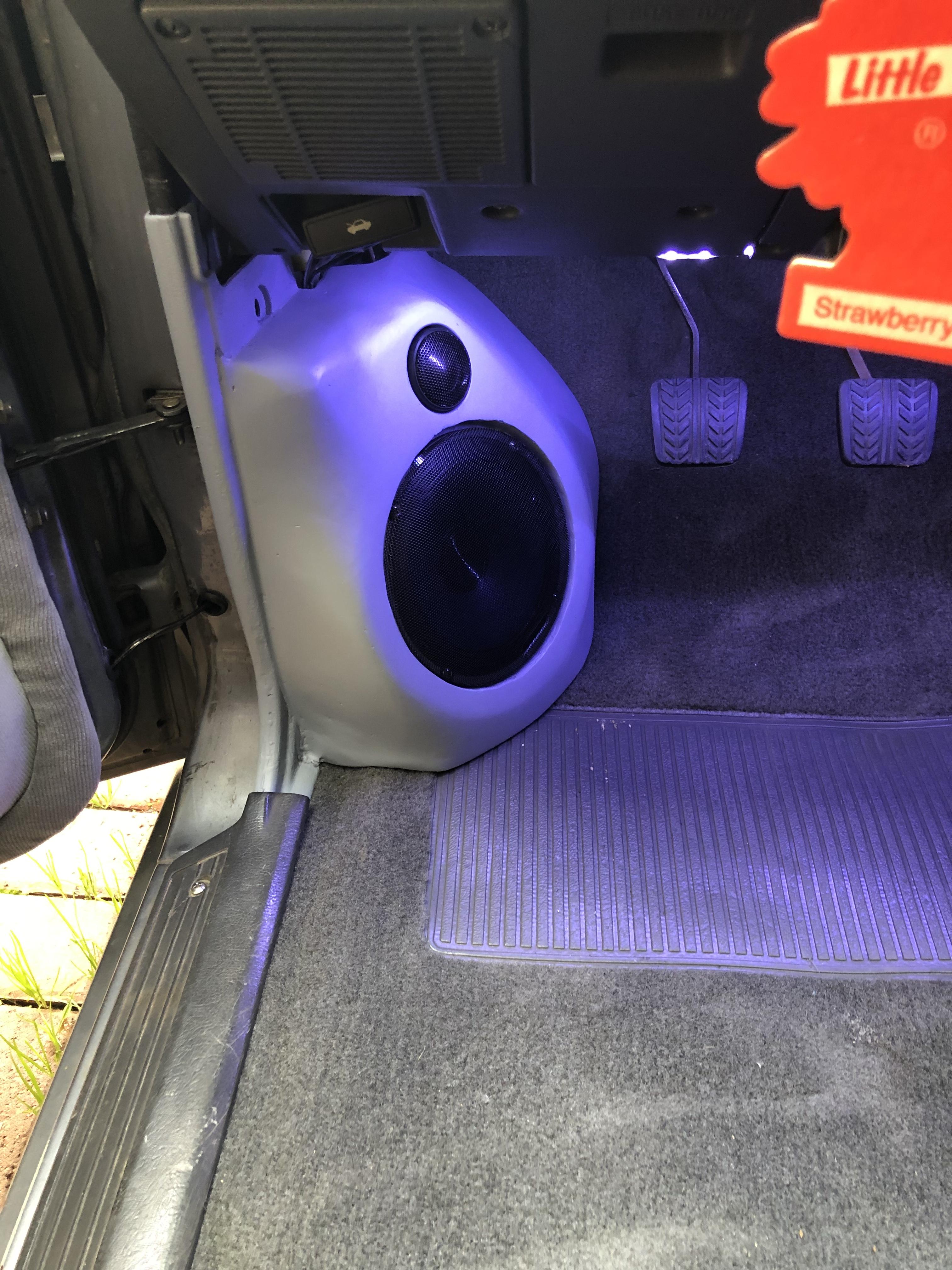

I currently have the new alpine type x components on my 90mazda b2200 installed on some custom kick panels i made and dont like how they sound. I just purchased 4 10s Savard Rap subs that i plan on installing them in the back space of the seats. So im looking for drivers that could keep up with subs but maybe little more vocal. Im not going for SPL or SQ, something in between. I was thinking of adding 2 5” drivers per door wired down to 4ohm and 2 tweeters per door “ or maybe gonna install in A/C vents” down to 4ohm as well. The amp i have for vocals is a Twisted Sounds 150.4. I was planning on raw drivers madisound or PE, with budget of around 40-70 per driver depending what i need.

Not sound good and being pushed means new drivers, not adding more.  The more descriptive you are the better we can help.  Would also be good to know how it is all setup.
Generically speaking though more drivers will sound worse, not better.
Yes the drivers are few months old with not that many hours on them since my truck is my project weekend vehicle. I am running them active the mids on ch3,4 and tweeters on ch1,2 but factory crossover for extra protection. I removed the tweeters last week and add my old 4” prv speakers to stock location on lower part of dash. The mids kinda seem like they dont like being sealed on the kick panels.

What are your mids in ? a fiberglass box ? If so, it will be difficult to make them sound good ! Can't you use your doors only ? I'm not an installer, just thinking.
You have good speakers, a good 4 ch amp : it's an install problem. You're in good hands with M5.

I purchased some used SSA Evil mids,tweeters and ampere audio 3” mid range last week. Im gonna be adding the tweeters and mid range to the A pillars and mid bass to the doors instead of kick panels.
