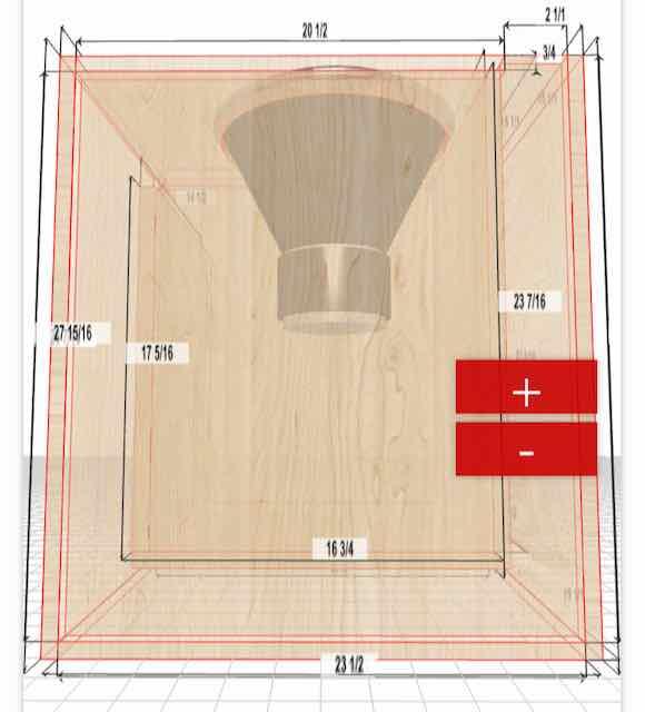

I am rebuilding a box for my HST-15. My current box sounds great, but there are a few things I wish I had done differently. So I thought I would do it again with the improvements made. Here is the box design.
The box is 28" tall x 16" wide x 25" deep. I will be in the back seat of my 2008 Tundra. I have had the rear bench seat modified. Basically the middle seat was cut out so the box sits in between the rear seats. I will be powering it with a Taramp's HD 3000.1 with the duel 2 ohm voice coils wired to 1 ohm.

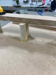

I won't bore you all with the pics of the wood being cut or the pile of cut pieces. I know that is something we have all seen and it's nothing special. I started the assembly by adding a piece to the inside end of the port to later be rounded over.
I then started glueing and screwing the port pieces together.
IMG_0115.jpeg.dd0ff8c55f106178d95abe01379042f5.jpegIMG_0116.jpeg.43797ca0d4590f4746bc8f24bbb2b6e8.jpegIMG_0117.jpeg.21d2a74bf736eb1b4f6f4084bfa67a07.jpeg
I used that small piece of wood to help keep the port pieces square.
IMG_0118.jpeg.baf9750dd18264f5f4c3af97b671a64c.jpegIMG_0119.jpeg.d2e0d24738f87e200f9fbf6ddec281dc.jpegIMG_0120.jpeg.404500ac9d61b608619f71f3e8b662c1.jpeg

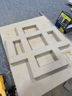

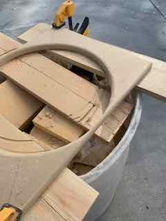

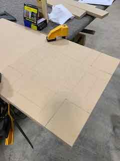

Once the port was assembled I began to get the port brace cut out. After drawing it out on the wood I drilled holes for the jig saw. Then did some cutting.
IMG_0125.jpeg.84cfdf0357ccb74858acfc7101b31ecf.jpegIMG_0126.jpeg.cabc1aaab674c457707f1293ec7b7204.jpegIMG_0127.jpeg.3fe0477fc0478338673747d632451036.jpeg
Now that all the cuts are done it's time for a quick test fit.

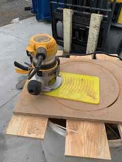

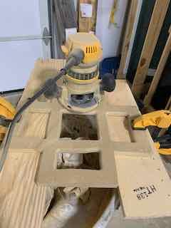

Since I was happy with the test fit  I switched over to the router so I could round over all the edges.
Then it was time to do a bunch of sanding for smoother air flow. The router left a small bump in the middle of the round over that needed some elbow grease to smooth over.
Nice and smooth.

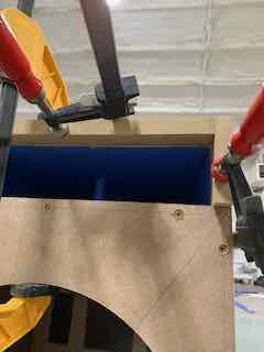

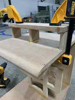

Then it was on to attaching the port brace to the port.

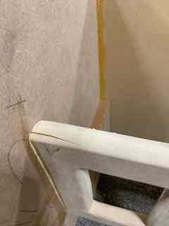

When I screwed the brace in there was a small split, even though I was predrilling all the screw holes.
From this point on I used my next larger drill bit to avoid splitting any more wood. Well I pushed some glue in the crack and clamped it.
IMG_0136.jpeg.8ecf86b40de3298f3079526211cd39b2.jpegIMG_0137.jpeg.42cc559889f9ac7b01877b7a0b8cd806.jpeg
Whew. Disaster averted. Lol.

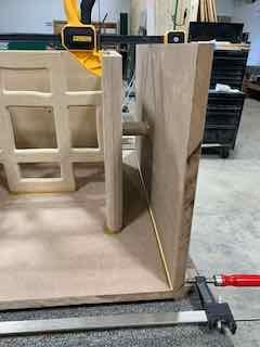

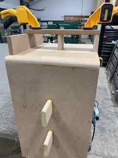

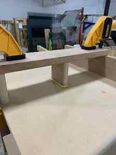

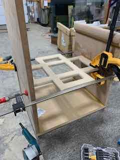

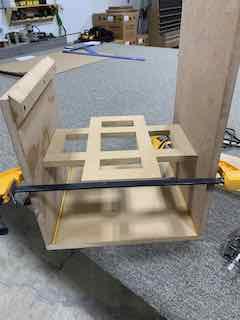

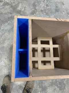

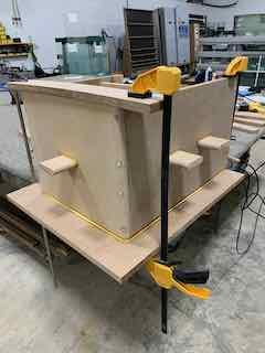

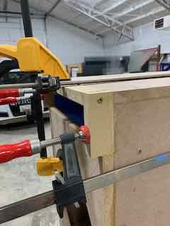

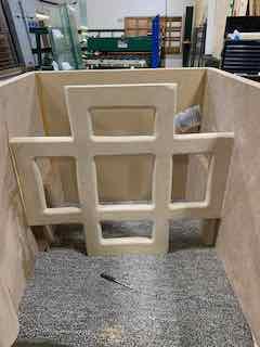

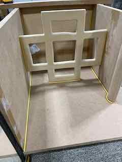

Next up I  added the small braces that will be inside the port itself. They are only three inches wide so they won't effect the port. I did the same thing in my current box and they seem to really help make to box much more solid.  Time for some creative clamping to get them attached.
IMG_0138.jpeg.f8065383b4f0cb744e422b997245f2b5.jpegIMG_0139.jpeg.80c521bab0dcca3f356cae32da8a8731.jpegIMG_0140.jpeg.2f94632f7af6cb98620f3cf3299b4781.jpegIMG_0141.jpeg.6c2e3fa6798c77f5862f5ccacd93c1cc.jpeg

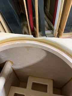

In this picture you can see how I rounded over the end of the port.
There are two braces on the long port wall and one each on the bottom and third port wall.  The bottom two corners of the  port were rounded over. I had to remove the screws in order to use the router. Using some saw dust and wood glue to make some filler I filled the up screw holes. After some dry time and more sanding it is like the holes were never there.

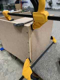

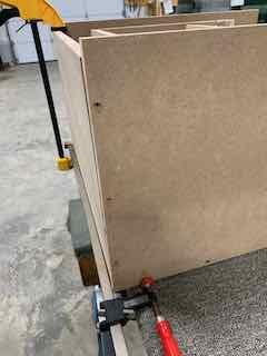

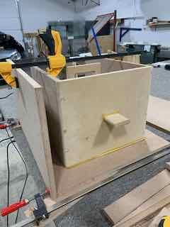

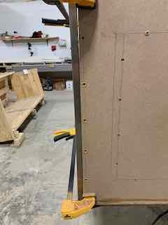

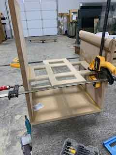

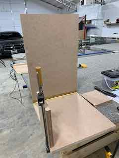

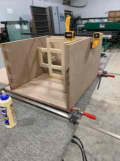

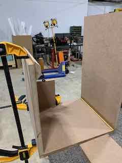

Time to start adding the outside walls. First I got the side all lined up and then drew where the port sides were. All the screw holes were then drilled.
IMG_0145.jpeg.019ddeca882cc7b3da97326152cdf561.jpegIMG_0147.jpeg.13d315dab27dd05c4415e9ffc48e708c.jpeg

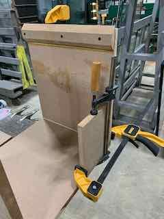

Time for the glue.
IMG_0148.jpeg.9252c6b42fc582ba68e29c5940409f06.jpegIMG_0149.jpeg.072306746ce9b01f4312774a821383fc.jpeg
Then all clamped up for the screws.

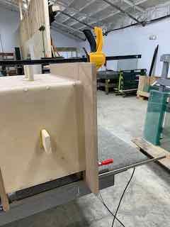

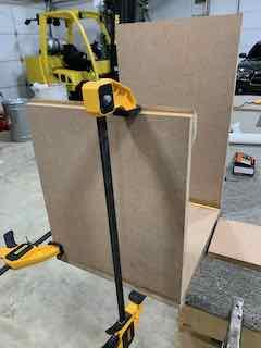

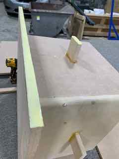

Now to add the front panel. Glue all set.
At this point I started to add the screws to all panels before attaching them. That way I could have the screws poke out a little to help line up the walls much easier.
IMG_0152.jpeg.e7bb326b0e3f4f423828518bcdc67ad2.jpegIMG_0154.jpeg.1c53d2aaa88e6461ad1c1f21ed86d730.jpeg

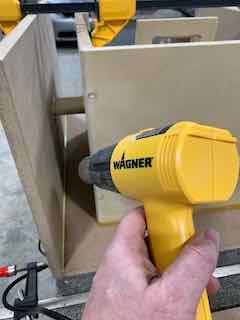

Through out the whole build I have been using a heat gun to help start the drying process for the glue. Also I made sure there was a nice bead of glue on all seams. This was then smoothed out to help ensure a good strong bond and a good seal on all seams.
IMG_0153.jpeg.12f489daf63baf86417e8f0899b5ed47.jpegIMG_0155.jpeg.d279330e2dcd15603af95a56344725c0.jpegIMG_0156.jpeg.9d18910d0a02a89e5ce6fc5508059793.jpeg

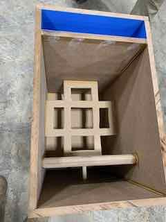

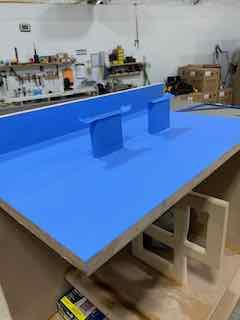

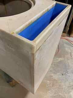

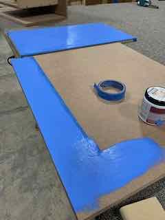

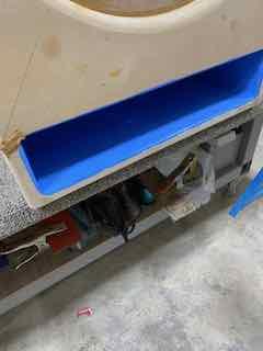

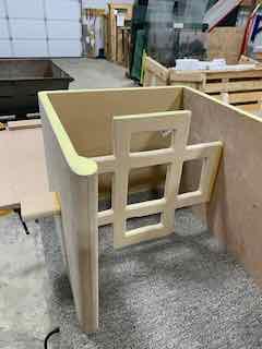

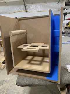

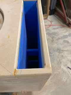

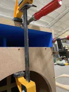

Let's address the inside of the port opening shall we? I wanted to do something a little different with the color, not the same old boring black port. Not to mention I plan to wrap the box in black vinyl. My interior is tan, the truck is dark green. Both colors were considered. Tan? No too close to the color of the wood and ...........boring. Dark green? No not enough contrast with black. So I went with the color of my favorite college basketball team. Carolina Blue. Go Tar Heels!! Should look cool. First I prepped the panels with tape where they would be glued to ensure a great bond.
IMG_0158.jpeg.7213b4a7ec7cae6dfc8cb8a3813aaeaf.jpegIMG_0159.jpeg.df8942ba8a6bb49d3237cecce265b02e.jpeg
And painted.
IMG_0160.jpeg.617de363ea66b3eacb40c6b9cc78ef02.jpegIMG_0157.jpeg.f1f3b526f78cf49cf2a415e799553392.jpeg
Looking Good!

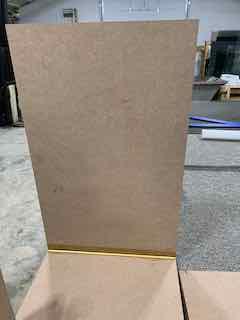

Now that the paint is dry, I added the other side and bottom. Nothing really to show. Holes predrilled, glue applied, clamped, and screwed together. IMG_0161.jpeg.b5d211226e618fcbb29904f30e3a5bfd.jpegIMG_0162.jpeg.469264a9c1bfaa73859329451860eeb7.jpegIMG_0163.jpeg.0985d94e6eef466243a2a59137cfb373.jpeg
IMG_0164.jpeg.0d980655faa63ec2c6211c91d44565eb.jpegIMG_0165.jpeg.be041ff4106f0992ee9dd1a64ab5989f.jpeg
Love that blue.

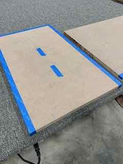

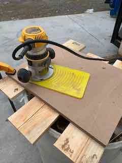

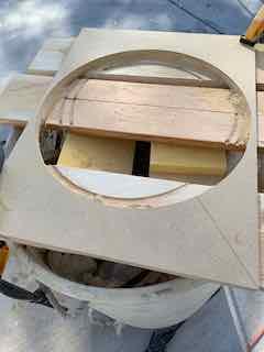

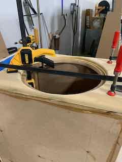

Here are some almost action shots of the baffles getting the sub hole cut.
IMG_0168.jpeg.5f192a0060cb62dac0a0fb9ee3764537.jpegIMG_0167.jpeg.be064a076517dc69e44ce4c2e5fe3d4a.jpeg
I was about to cut out the beauty panel that will trim out the speaker, but as I was finishing the second baffle the router started to cut weird. Well when I lifted the router up the bit had snapped. This was the first and only time I used this bit. WTF? Thankfully when I took the bit back to Home Depot for an exchange, there was no hassle. Bring the new bit, show the broken one and the receipt. Bingo all good have a nice day.
Forgot to ask in my last post, do I really need the second baffle if I am going to glue the beauty plate to the baffle? Can I get away with a single baffle and the beauty plate?
If your "beauty plate" is properly adhered to the baffle, it will provide the extra stiffness you are looking for.  No need to do yet another baffle.
P.S. nice work.  Keep it up.

Time for another update. I work on this during lunch hour at work. That being said there was not a whole lot of progress today. Today the beauty panel was cut out an d the edges were rounded over.
IMG_0173.jpeg.d17fb8e8a461c0435cff5ee67bb93d58.jpegIMG_0174.jpeg.28946eb03239920fd986b780df9926ba.jpegIMG_0175.jpeg.7141527e9e8e1f36085eb5732a2a6f2f.jpegIMG_0176.jpeg.d205b423d6cf401560d63afe51045bb8.jpeg
Turned out pretty well.

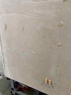

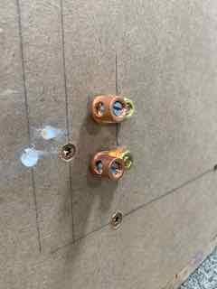

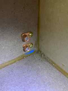

Some home made speaker terminals was also added. They are made from brass screws, brass nuts, and some copper lugs. I picked it all up at Home Depot. The first pic is the inside. The bottom of the box is on the right. The second pic is the outside.
IMG_0178.jpeg.4909d25826ca35235a1f6de0fb7ac5a7.jpegIMG_0181.jpeg.fa810a70219599baafc04be388dcce20.jpeg
Should work very well I think.

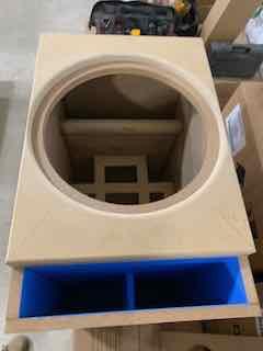

Here is a pic of the baffle and beauty panel sitting on top of the box.

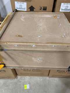

Not enough happened yesterday to really warrant an up date. So today I will combine the two updates in one. Yesterday the first baffle was attached to the box.
IMG_0183.jpeg.e2a5b14bff5dc3e1e9d68f467d5bf5fe.jpegIMG_0185.jpeg.9efb641b57ff25f175c315ba57f4ae16.jpeg

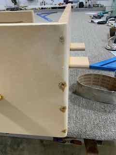

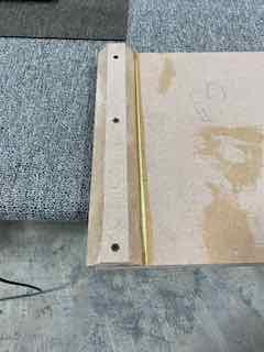

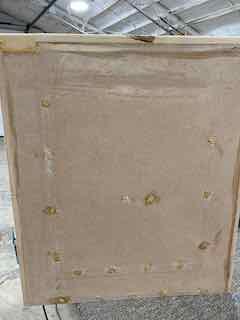

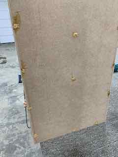

Some of the screws on the box didn't all the way flush with the surface it was screwed into, so I removed a few of them and filled the holes with glue.
I know not very exciting, but there it is. In the above picture you can see the port cap up close. Nothing else to report today. I'll be back tomorrow.

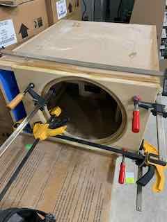

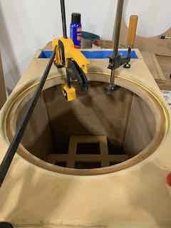

Sorry for the delay. I just have forgot to post my updates. Here we go. I glued the top beauty plate on the box.
IMG_0190.jpeg.68f4005e56c098d289848209f9e43b70.jpegIMG_0191.jpeg.7fcaf81e3f057c11111b7ee1eab07f87.jpegIMG_0192.jpeg.6ead616cbad51b242ebb66db508cba3a.jpeg
All glued up and clamped.

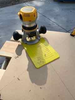

Then the edges were rounded over in preparation for the vinyl wrapping.
 IMG_0193.jpeg.a3f94e288457e049f727b7d2a9437f0f.jpegIMG_0194.jpeg.0b2663f707456cc170e42ba3c23fec16.jpegIMG_0196.jpeg.ca1c830a5a60254e02b5c48d12b01a85.jpegIMG_0197.jpeg.5b7c4918af2daebbb470dcee85a1c5ef.jpeg

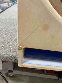

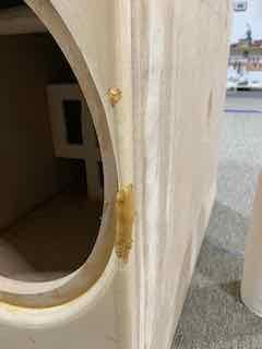

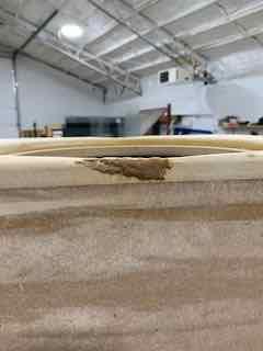

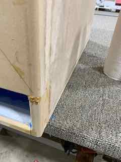

For the most part this went really well....... until I tried to go over some of the edges again. Like an idiot I wasn't paying attention when I tried to redo the beauty plate.

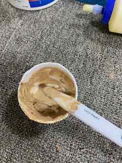

After a VERY long stream of VERY loud cursing I calmed down and started to figure out an easy fix. I mixed some glue and saw dust to make some home made filler.
Then went about filling the F up and a few other places that could use some filler.
IMG_0201.jpeg.7e2e81e92afbd3c98e305f535fea866b.jpegIMG_0202.jpeg.d8f41f8bdfe729f4f696fe4a5a8e279c.jpegIMG_0203.jpeg.025eca0ba5598b5b659d27016de48468.jpeg
Finally The end of the port was touched up with some more paint.
IMG_0204.jpeg.d1e4b25794a6de601dd142746c40bb51.jpegIMG_0205.jpeg.e70b37b80cc1731217bdf693bf5d5399.jpeg

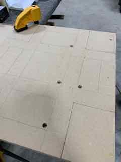

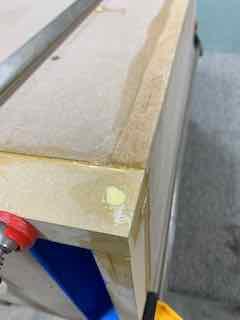

Well again there was not much progress today. I went to start sanding my repairs and the main one on the beauty plate had a bubble in it. So I had to refill it. Since I had to mix up more filler I mixed enough to fill all the screw holes. First tried to fill them all with glue, then caulk. Each time when it dried the filler shrank. Time to over fill with home made filler.
IMG_0210.jpeg.a7c57c04b0c6a38c5e167264dcffe3d8.jpegIMG_0206.jpeg.1cf03d231890c1364ffc58b3dca96b35.jpegIMG_0207.jpeg.57ed84938547f6bd63050ae8e851c856.jpegIMG_0208.jpeg.ee33eca831cd0a465d1be75cde192d68.jpegIMG_0209.jpeg.2733cc68b3bf8ba571168ac969da6006.jpeg
Hopefully this will finally do it. I will have my work cut out for me tomorrow with some sandpaper.
