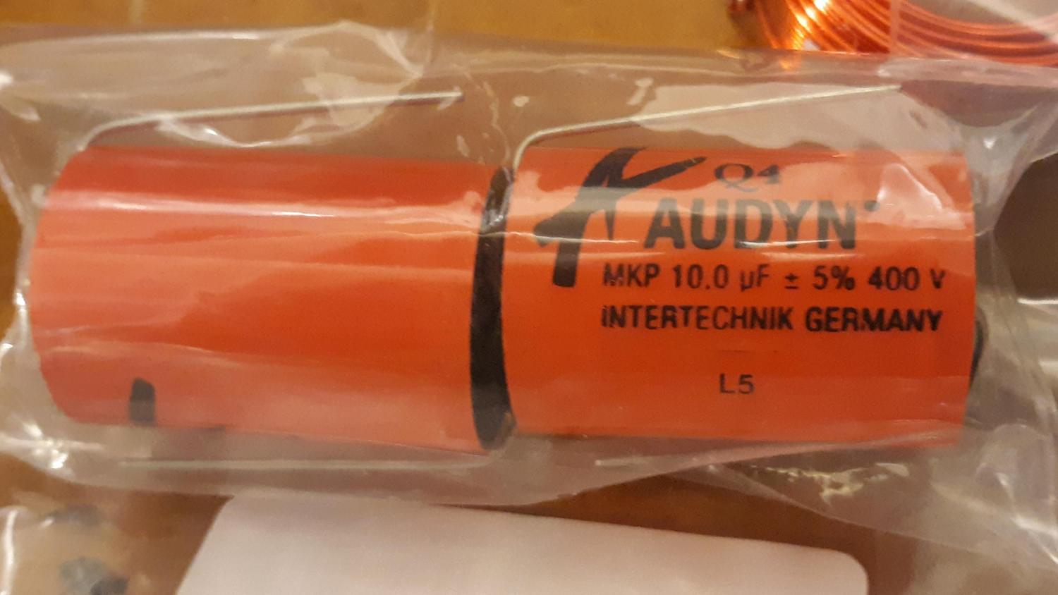

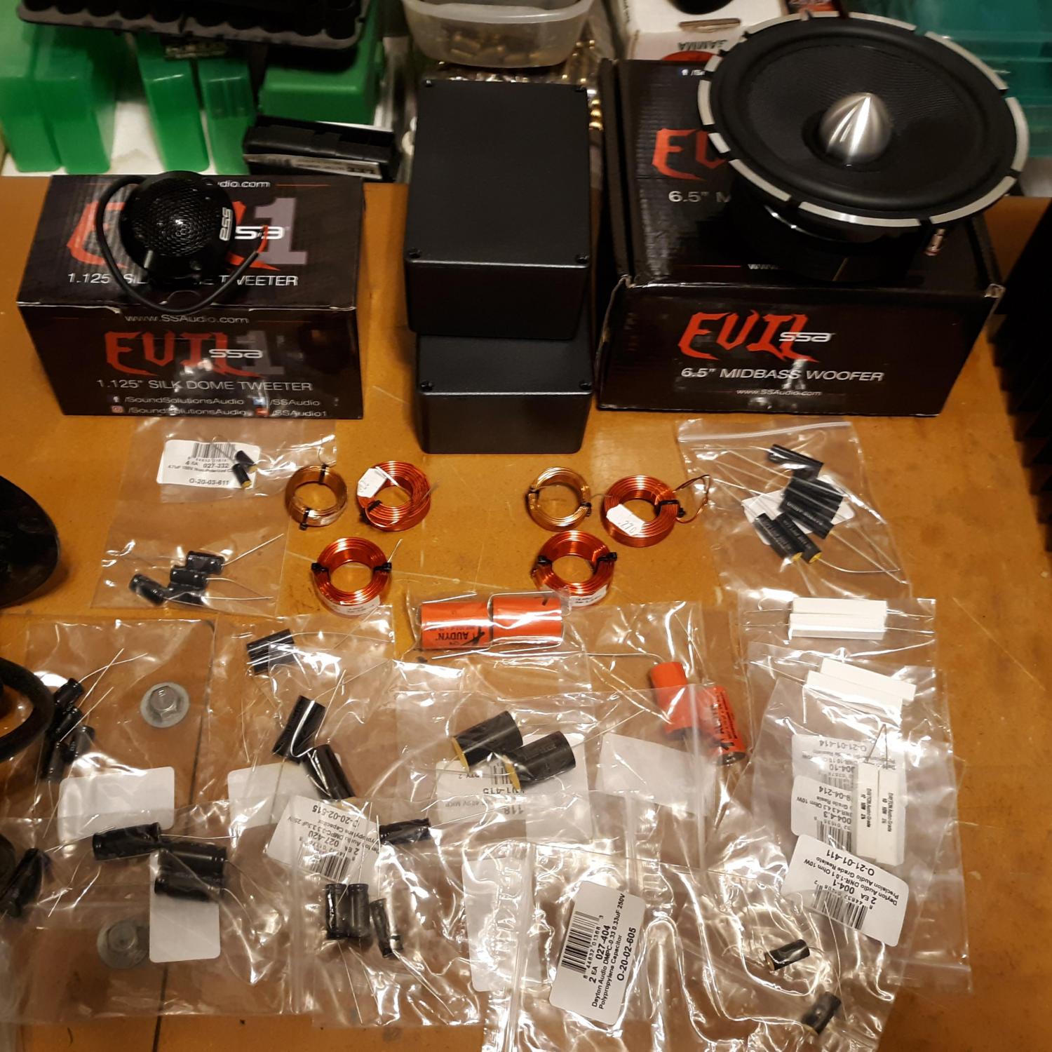

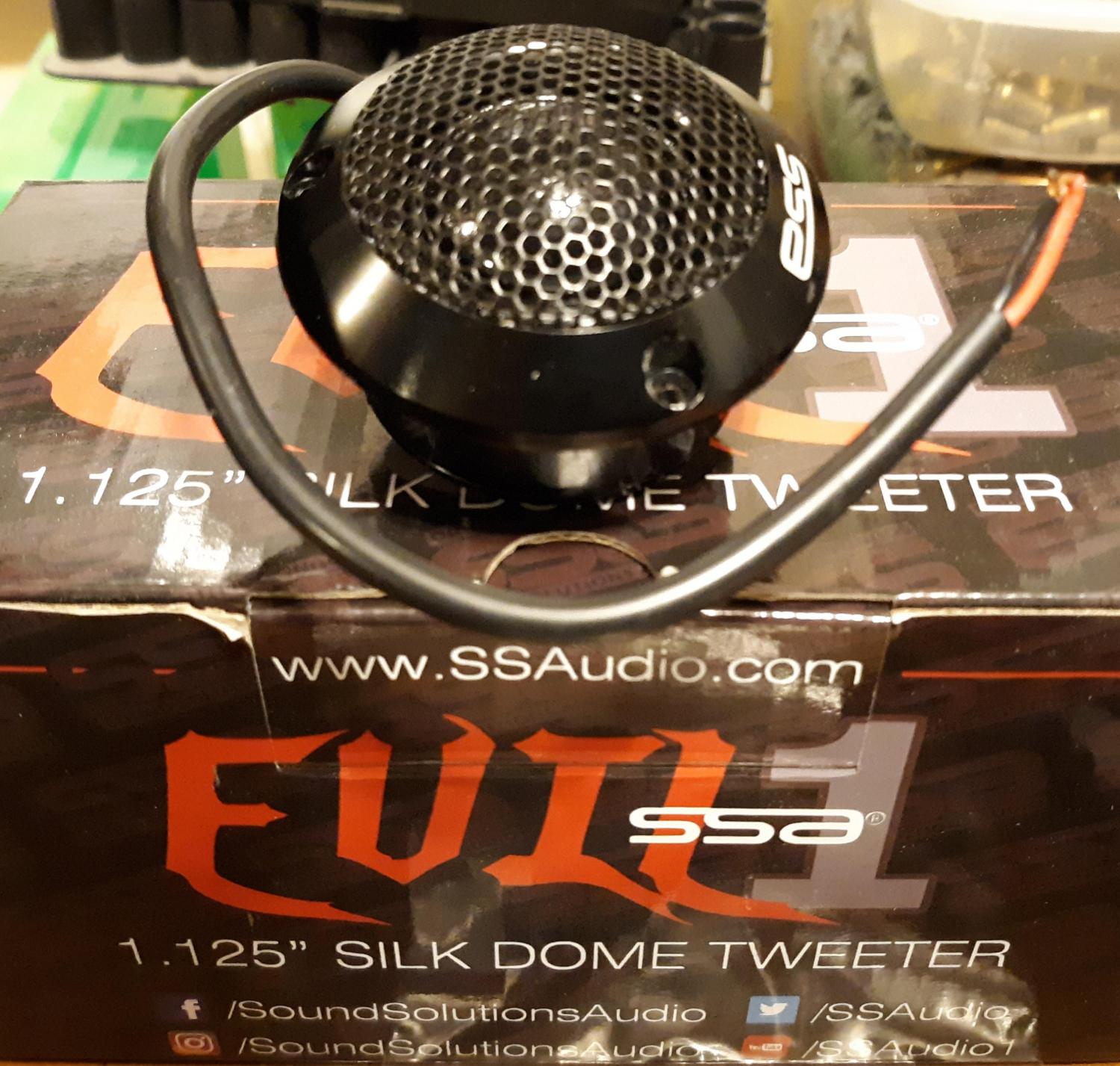

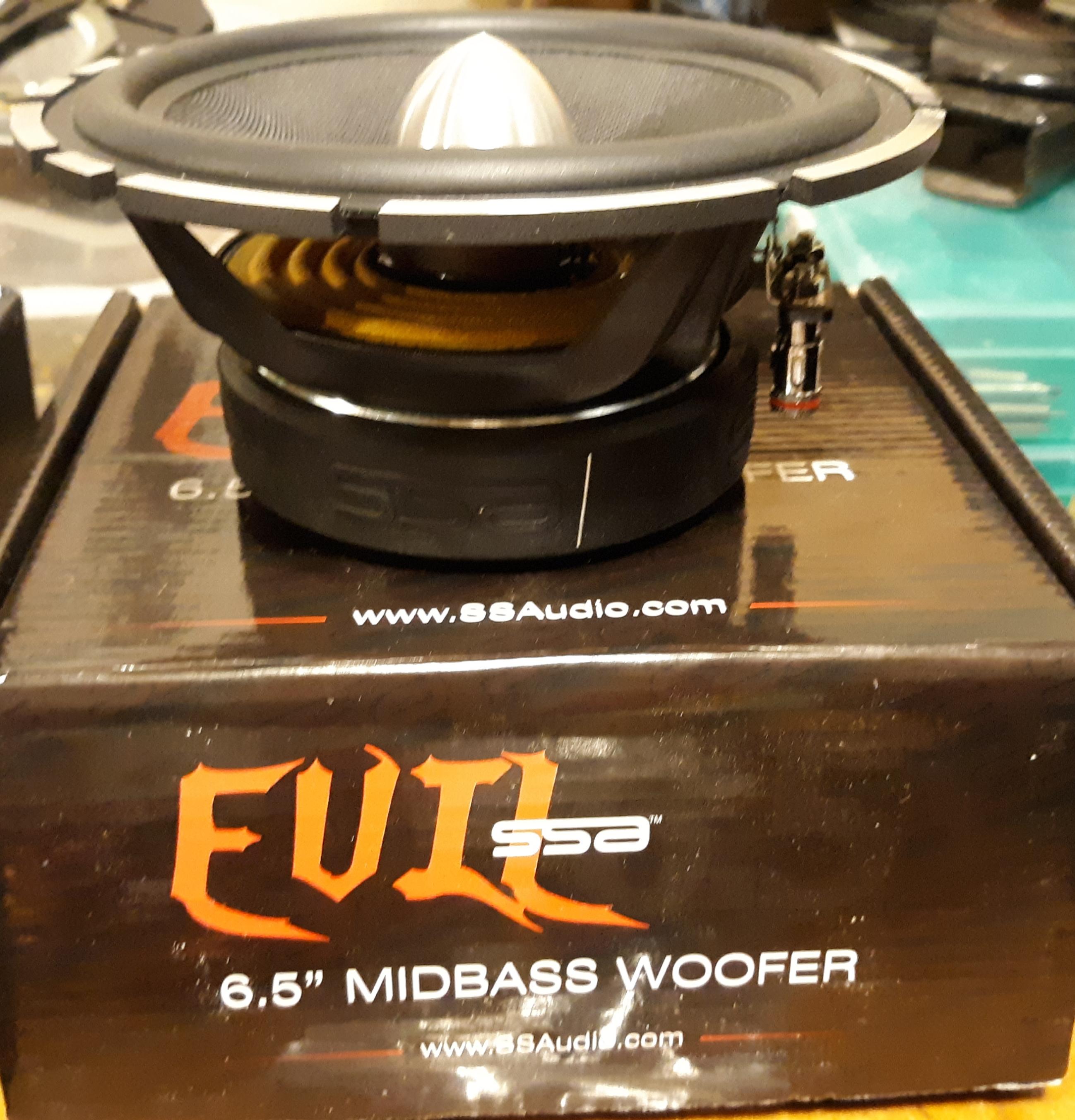

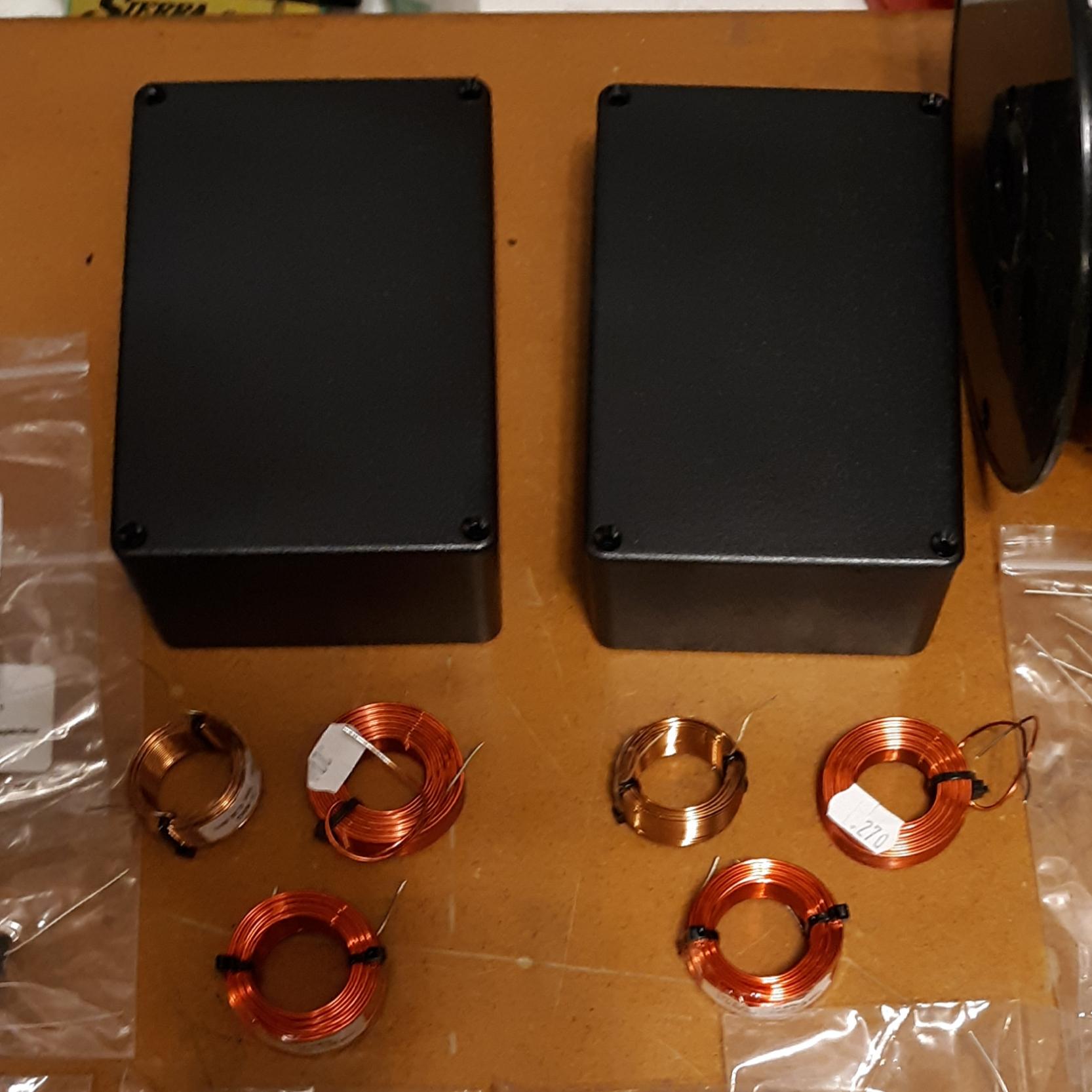

Posted May 15, 20205 yr Popular Post I'm building a set of passive crossovers to do justice for the SSA Evil midwoofers and silk dome tweeters. This is a no compromise design that uses 48 (!) parts per set. They will be potted in epoxy resin inside ABS enclosures and hard wired with direct connection to the drivers. I have been working with these drivers for a while now and really like them. Install will be in a 1978 F-150 a good friend and I built. The rest of the system will be a SSA 150.4 and a 10" custom built PSI sub.

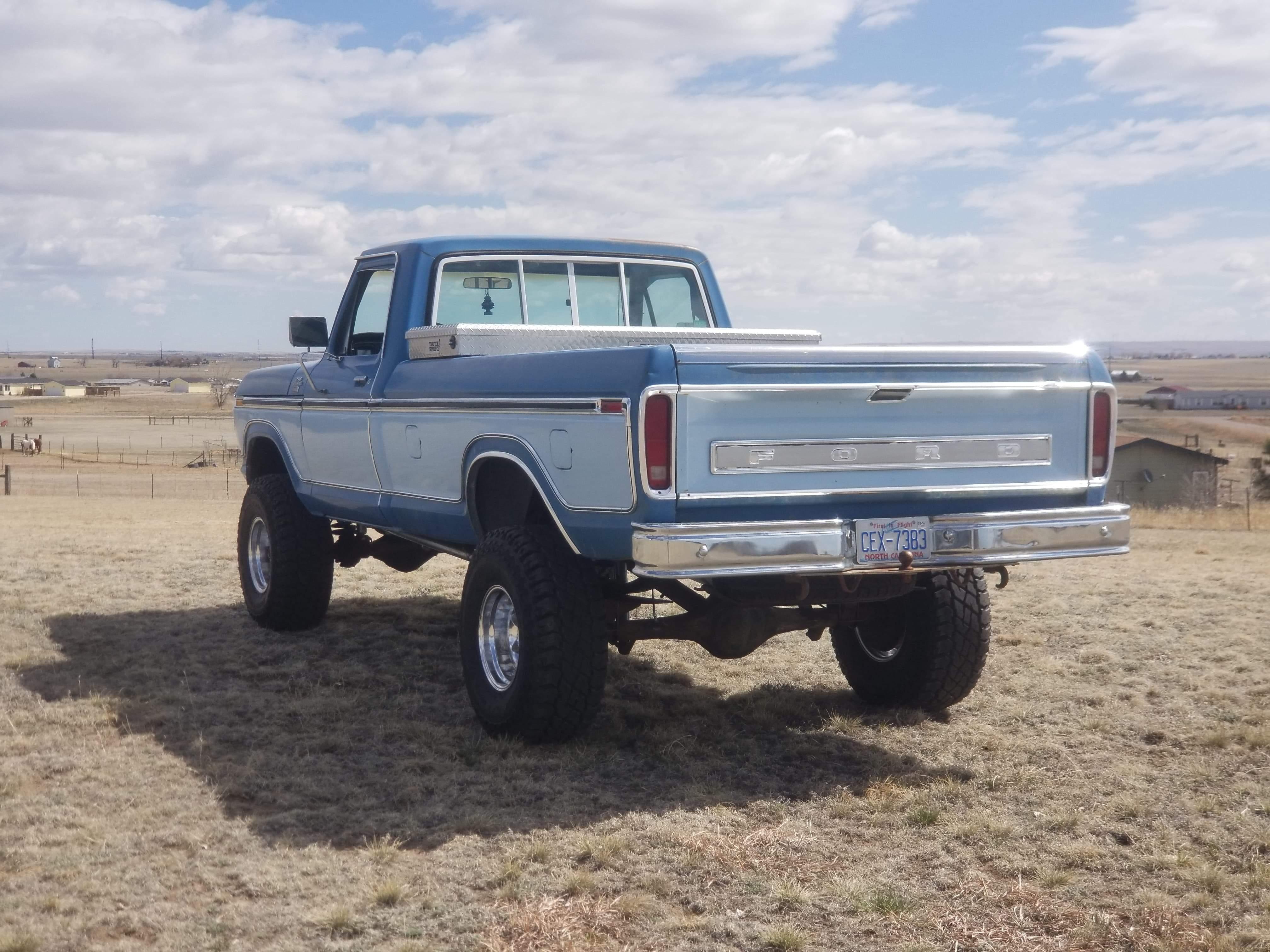

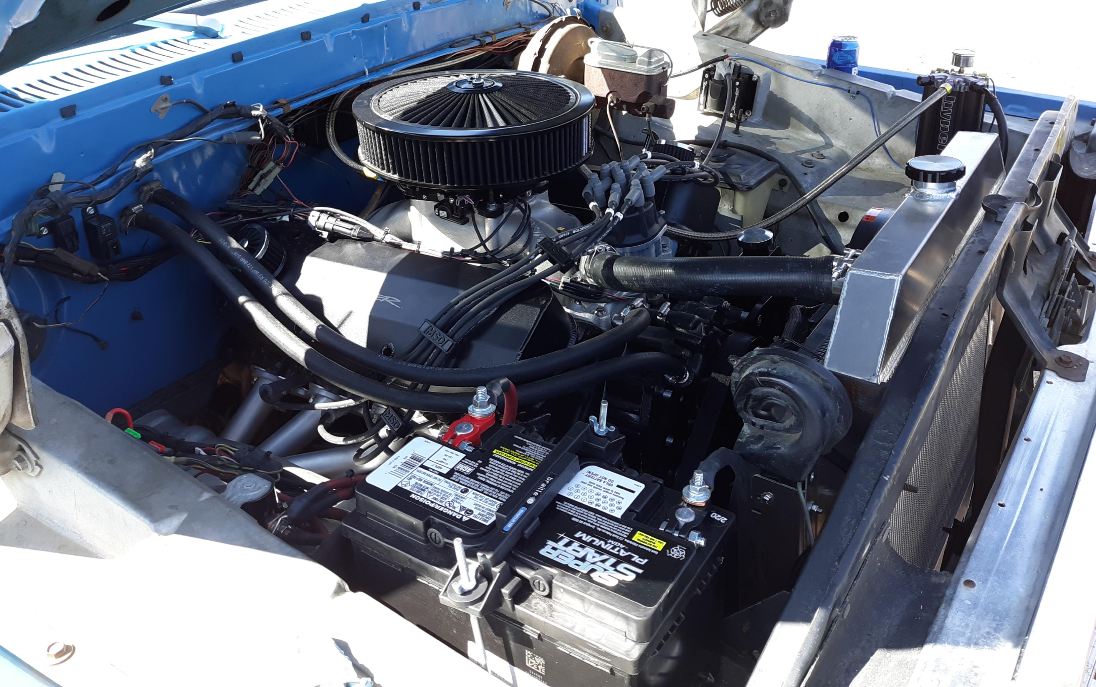

May 16, 20205 yr Author Popular Post We built a fuel injected 429 for it. Pics were before we had the exhaust done...

May 16, 20205 yr What are you crossing your speakers at if you dont mind me asking? I currently have 2 Evil mids and 2 SB Acoustic tweeters on my 150.4.

May 16, 20205 yr Author 10 minutes ago, jcarter1885 said: What are you crossing your speakers at if you dont mind me asking? I currently have 2 Evil mids and 2 SB Acoustic tweeters on my 150.4. 2Khz, asymmetric electrical slopes, steeper on the midwoofer.

May 16, 20205 yr Author 1 hour ago, ///M5 said: Awesome work. Love the truck. Can't wait to o hear and see updates. Making me want to buy something classic. I cancelled my Vette order and will soon have an empty garage stall It's been a fun project for sure. You would have really liked the design phase. I spent literally a 100 hours voicing these and measuring a little over a year ago.. A pair was on a test baffle for about a month. Listening, measuring and tweaking...
