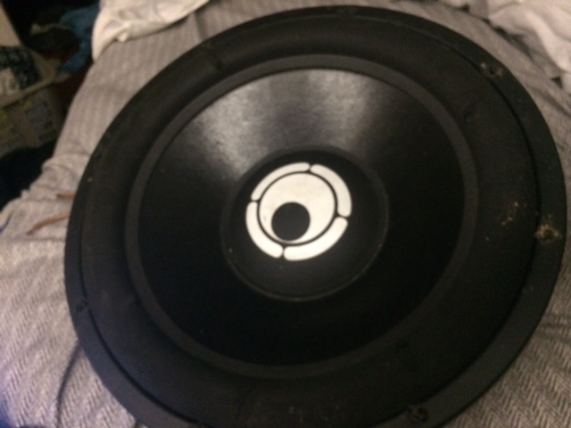

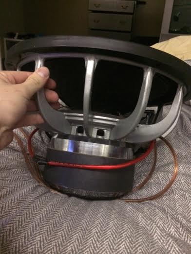

  15. So I just picked up a used sub and Im trying to figure out what it is, any ideas?
