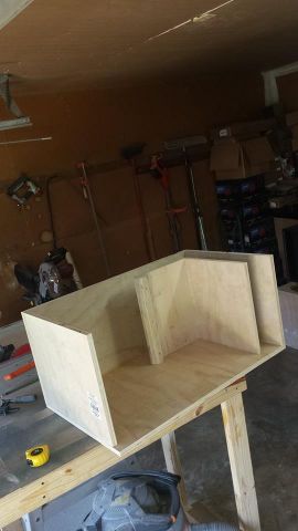

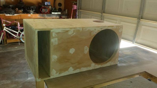

Enclosure for my SSA Icon 15", double baffled and braced. 3.46 cubes @ 32hz with 16 in^2 of port area.
Looks fantastic.  How's it sounding in that box?
I havent even hooked it up Aaron, finally got all the pieces to my build and started having car issues. I been on the car hunt for a minute now, so build may be on hold. I already ripped all my electronics and wires from my current car, sold radio and mids so even more pictures to come as I make purchases. And hopefully a new ride by the spring for a build log. Sucks  I know but at least I have equipment once I buy a car.

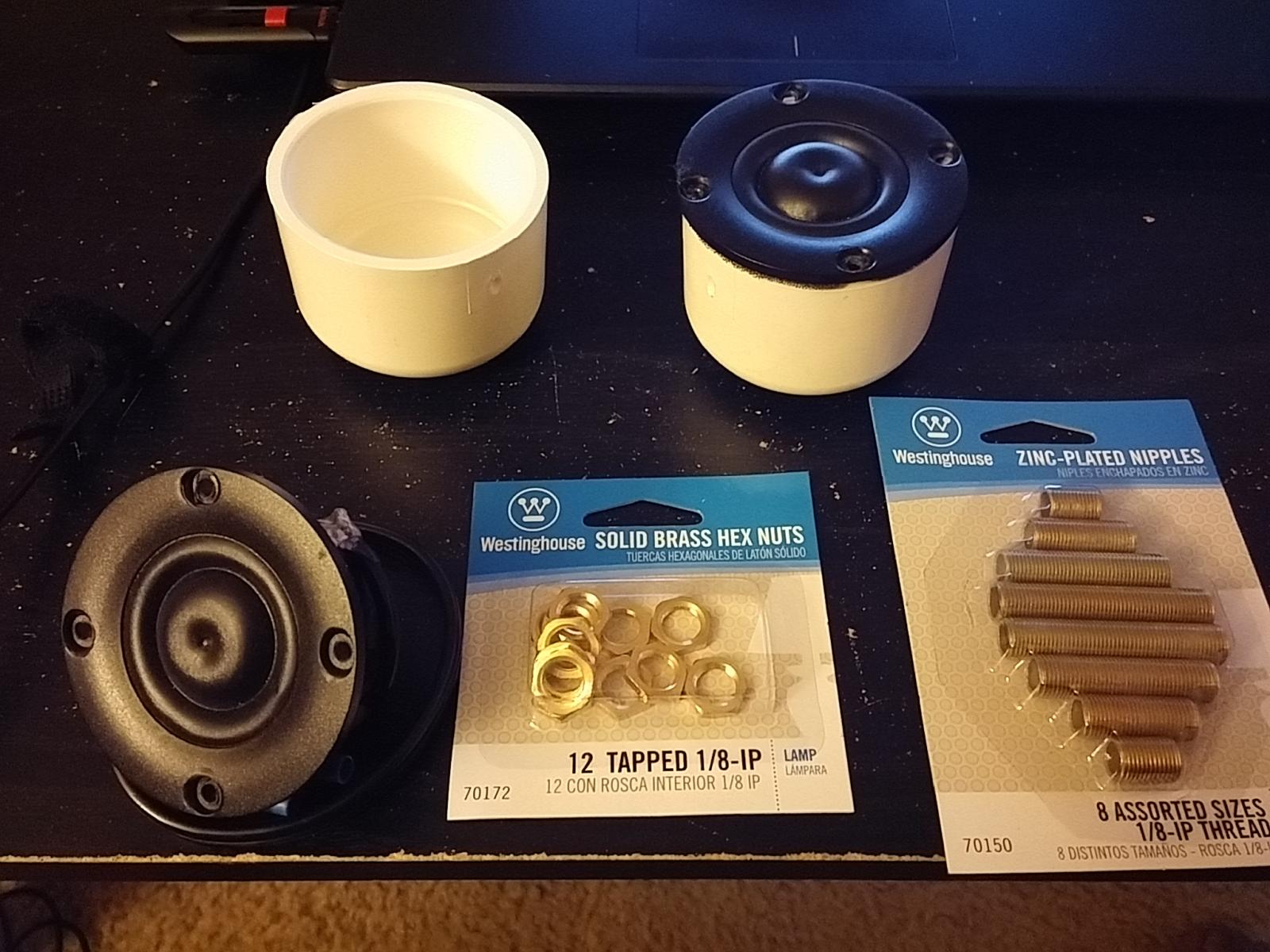

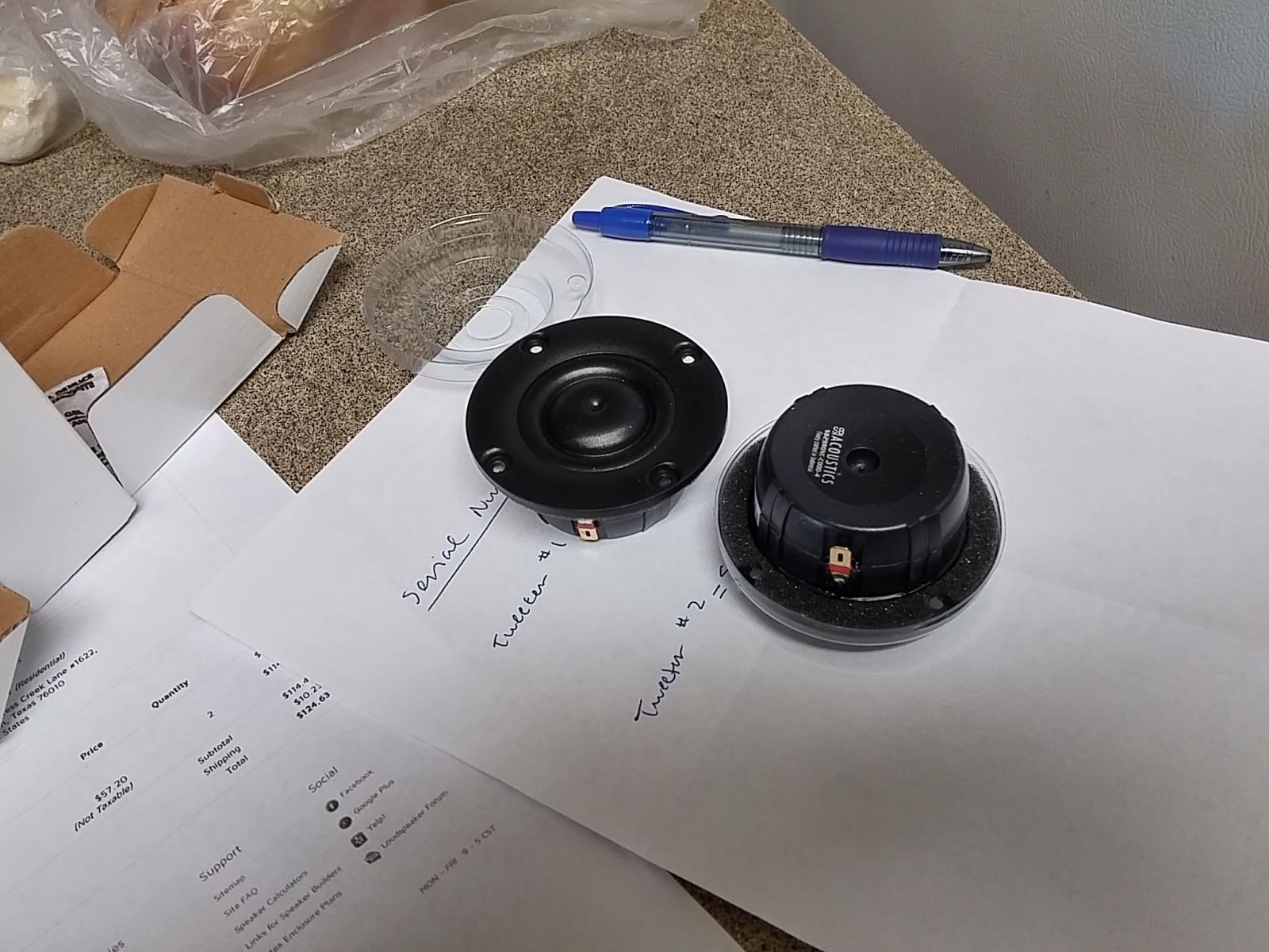

Since I love these SB Acoustics SB29RDCN-C000-4 so much I got another pair.
large.20160620_103745_HDR.jpg.dafc368c0e
This time around I'm stealing the trick from Diyma and making some tweeter pods for them, will help out greatly with on-axis aiming.
large.20160607_215301_HDR.jpg.89d8248452

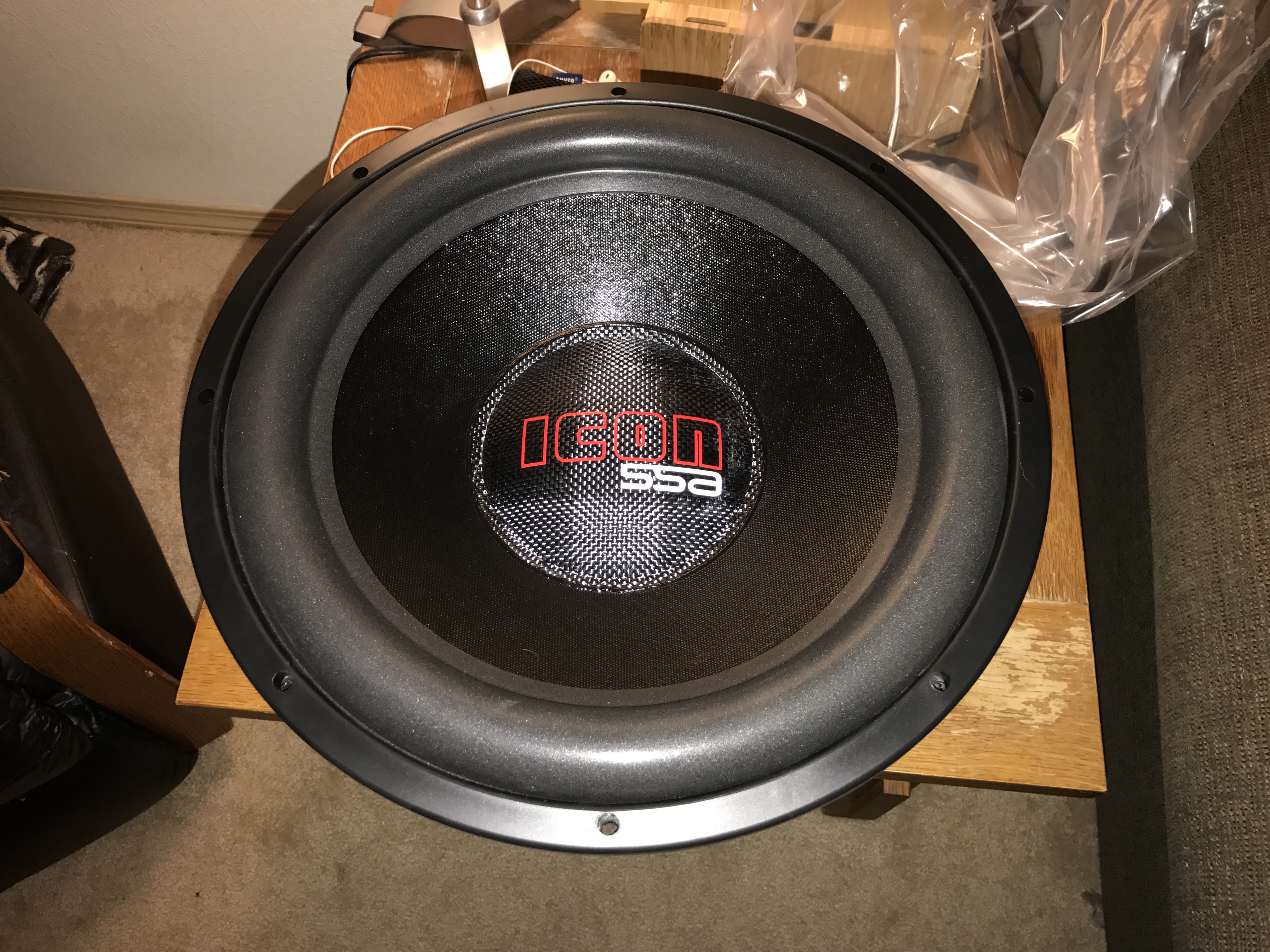

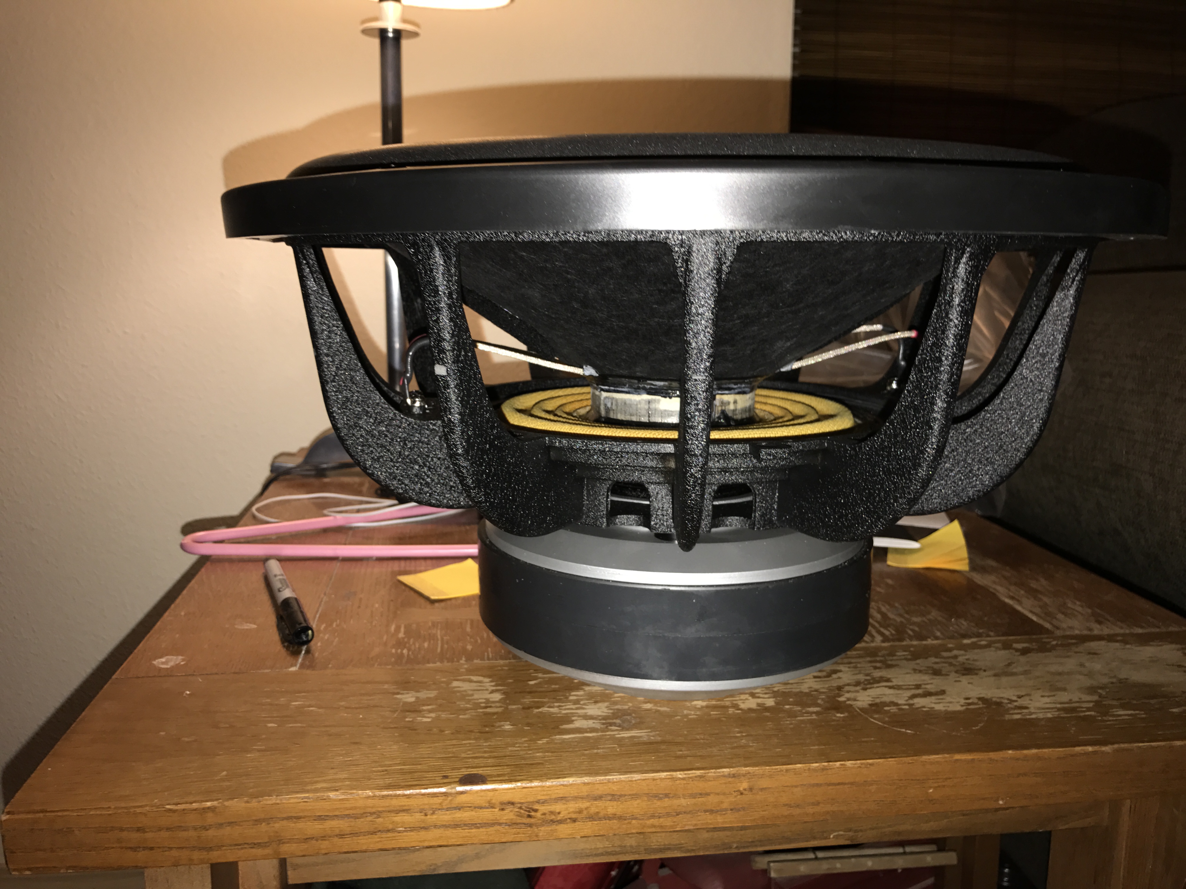

I'm new here but wanted to show off my new sub
SSA Icon 15 dual 2ohm
awesome pick! started my connection with SSA through the Icon as well. Good luck and post up a build log for sure!
Nice sub, I've owned two different gen Icon 15s before and loved them both.
