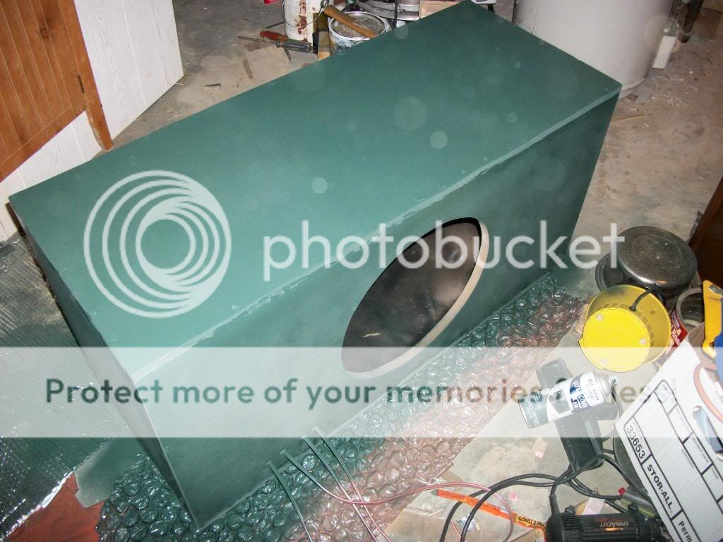

So to anyone who happens to be reading this, How well do you think this is gonna work and sound? My 5 cubic foot box tuned to 25hz. I Have the entire inside covered in rubber sealant paint with caulk along the edges, wood filler filling in all the cracks on the outside, and some overkill amount of screws and a overkill sealed port, everything is absolutely airtight. Let me know what you think. remember this is gonna be getting about 300 watts of clean power.
I am posting current progress pics, for you guys to look at until I get it finished, its something for me to do while i wait for the stuff to dry. they will be up in ten minutes.

Sorry for the wait it should be done b around 10pm central time tonight. gotta let stuff dry
I am putting the pics up they will be up in ten minutes, I only have the first coat of paint on but you will get the idea.
here are the pics these are of a minute before i started painting, and then the last one is my first coat of paint.
first coat
I will post a couple more pics once the painting is done.
Here are the last pics the paint isn't completely dry but good enough for you guys to get the end result. I know it needs about another 2 coats of paint but i'm out of paint, and this is only my temporary/test enclosure for the house for my xcon, until I get my super nice one getting made by audible customs. Enjoy!

Looks a hell of a lot better than my first box.
