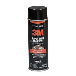

The 77m was too weak. I ended up using the 3m 'Super Trim adhesive'
Make sure its the "SUPER" cause they make other strengths in the same looking can.

I agree that the 77m is not the route to go. The 3M 80/90 is better, but only marginally. It will let go at some point (been there, done that). I use some stuff a friend of mine has that comes in a 5 gallon bucket, is a funky orange color and will make you higher than a kite ( :werd_msword: ) while working in his 40x60 shop. He buys it at a local fabric/interior design/auto covering supplier. Of course, I just "borrow" some of his. :peepwall: I always use his sprayer, but I think if you could buy it in smaller quanties you could brush it on. Heck a local supplier might be able to make you up some small quanity spray cans of some really good adhesive. :shrug: I know a couple of local auto body supply shops do it with paint. Couldn't hurt to check.
That is the exact stuff I bought. Cool deal.
Can I get high on this one too? lol
As 6appeal stated that even this glue can and will release over time. I used hot glue on the back of the pod around the edges to help combat this. secondly the vinyl must have tension from all directions not to bubble. The 80/90 is kinda like contact cement in a can, SO I am sure you could probably catch a buzzzzzz.
