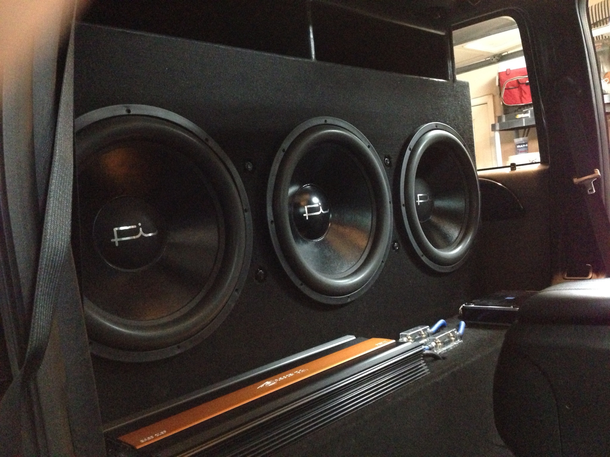

Subs are in and playing, but something isn't right. The 40 + notes are very loud but below that is isn't what the 2 were like, lacking lows badly compared to before.. Also subs are getting very warm quickly. I checked twice while wiring them in box but must of fucked up somehow. The outside wiring looks right.
I'm not happy right now, why the hell are the subs getting warm so quick?
Any ideas? I do have two runs of 16guage going to each coil. Not sure what that would matter. But I guess I will remove the subs and redo it Saturday.

~.5
(3) D1
Have you checked your drop yet? Adjusted your gain accordingly?
Lower ohm load, so yes, his voltage has dropped more, no settings have really been altered at all. The gain was lowered slightly, but not make much of any difference.

Amp doesn't get warm at all, voltage does drop more but only to high 12.8-13.0. After listening this morning all the way to work (40 min) they were only slightly warm to the touch. Maybe I was expecting too much, I did only add one sub and no extra power at this point. Getting a lot of windshield flex compared to before and thing rattle at half volume like they did at almost full tilt before. Alittle discouraged about the lows but maybe its just deceiving.
Still gonna change out the sub wiring Saturday and see if that changes
Got a test tone cd? If I recall your f3 was around 28-29. Play 25 hetz test tone at a lower volume and adjust your subsonic filter until they start to unload then back up a hair.
Then adjust up just a tad with music if need be.
Will do, thanks
I figure I would not have to raise the ssf because I tuned the same, and also reduced port area a hair per sub.
I will definitely try it

The wall with port up high has changes my peak a lot. Seems to peak around 38-40 now. Its loud almost hard to breathe loud but just doesn't seem what I want. I will get it metered but if its gonna be peaking high like this it better be doing a decent number. My sunroof sounds like its gonna break soon.
Gonna retire subs with the jumpers on sub instead of on box. Maybe with all that bs wire I did something. Seems too loud to be wrong but I will try anyway.
Really it almost sounds as is I'm in the dead zone, like when you stand in the middle of a room versus in the back or corner. Idk
Maybe it needs some of that Texas magic Steve can through on it. Lol
Do you happen to have some design on the box handy? I'd be curious to take a look.
iPad spell check is owning my posts almost daily here. Haha
I have dimensions, internal dimensions are 57.25in W....27in H....24in D
You can figure the port is external and is 50.5 wide 5.5 tall and 26.5in depth
At first I wondered if maybe something was off, and your tuning ended up being really high as that could possibly explain what your talking about, but with the above numbers it sounds like it's right where you were shooting for.
Hopefully it'll just be something goofed up in the wiring, or SSF.
Maybe this is how most walls sound. I have yet to hear a actual wall mash out the lows like my other box except 4th orders. Not to confuse moving air with sound, lol. On video it will look more impressive than the last, but to the ear a 150 before was just so clean and low. Idk, a rewire tomorrow and we shall see. Maybe double the power will get things going. The subs aren't moving too much around tuning. Sounds like a 52 now, maybe more maybe less

It's rewired, which didn't change anything but its fine. It is loud as balls. I just have to get use to the peak change and get it metered. For only one amp it's nasty. I will post a small vid next
Current pic. I will seal off and start making it pretty this weekend

I don't know where it is but it's up in the 50's a good bit, I can't imagine what another amp will be like. It's already Much louder than before
