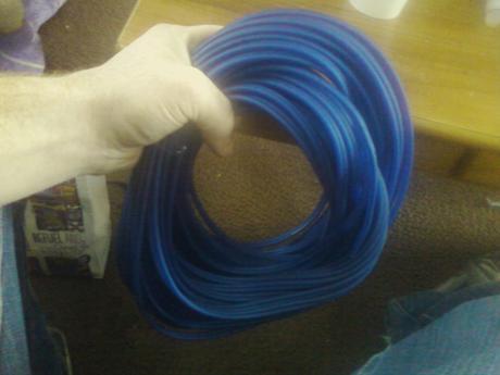

New speaker wire
post-21385-0-70887200-1389040250_thumb.j
post-21385-0-95658000-1389040282_thumb.j
Time to install now, no excuses :P

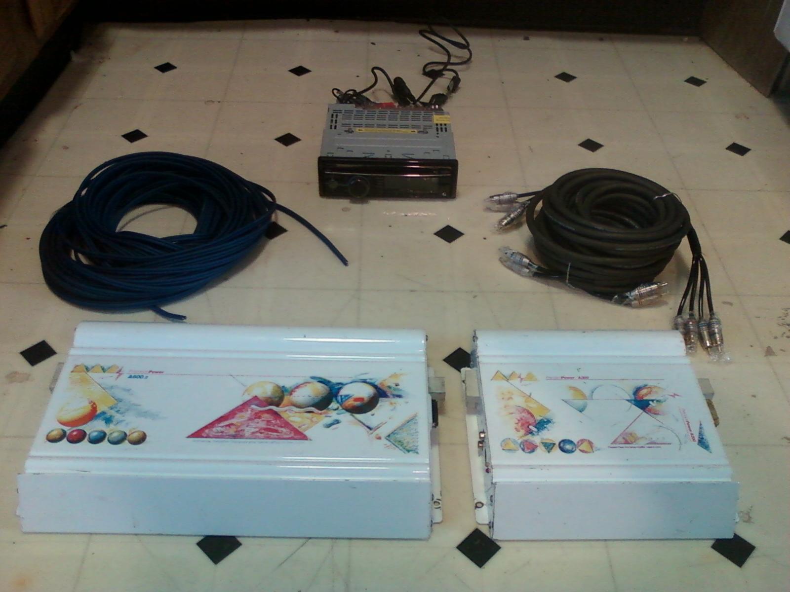

Nice amps to go with nice subs.  :)  Don't let Ryan know you have those amps. ;)
I know I know lol. I want to bad. I was going to today but it was -10f and there was no way and I'm working on a few enclosures in the garage so there is no room
Thanks. And yes really nice subs. Cant wait to get some real power on these

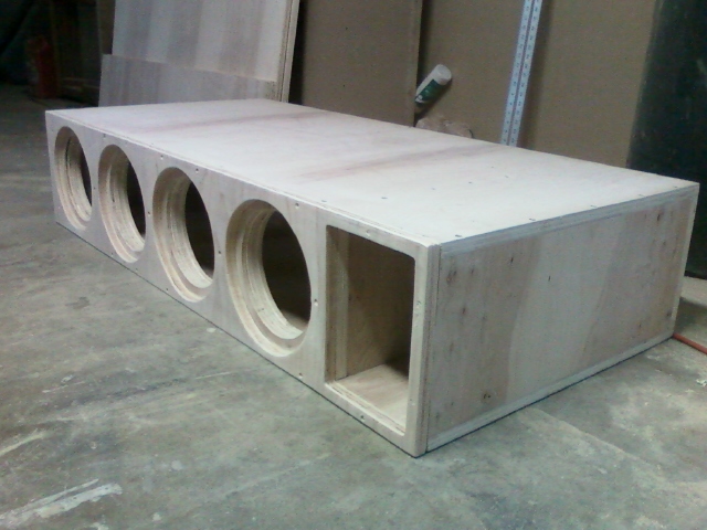

Couple recent enclosure I have done
For 4 sa8v2's

Well about to start the new enclosure this week :)
Its going to be around 6 cubes tuned about 34 (going to most likely make it so ill be able to change tuning). Going to be using a 10" round port this time
I'm thinking about 13" tall. 37" wide. And 32 deep. And 10" port close to 25-26" long (some of port will be out of the enclosure). Going to be using birch this time cause I'm really trying to cut down on weight
Those dimensions are close to what I built with my square port 80in port area. Tune to 32 originally. Wasn't musical enough for me wouldn't play more dubstep style music which is most of my listening. But also struggled on the lows(28hz and down but I believe they needed more space after some tips from this forum. I am interested to hear your results from the round port. I was thinking along the same path but was told to go to a 8in port to be able to play more range. Thoughts????
I think I'm actually going to be trying and 8 inch port first
