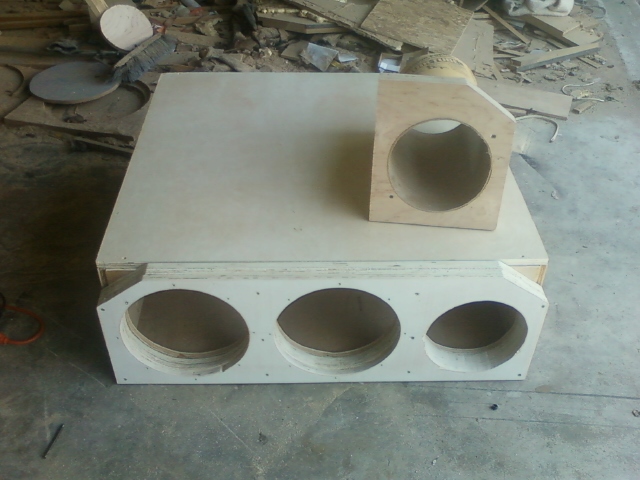

I usually make my baffles the exact shape as the opening into the cabin when doing a "trunk wall" . Seems to make it easier for me to seal off.
post-21385-0-10618800-1404664035_thumb.j
