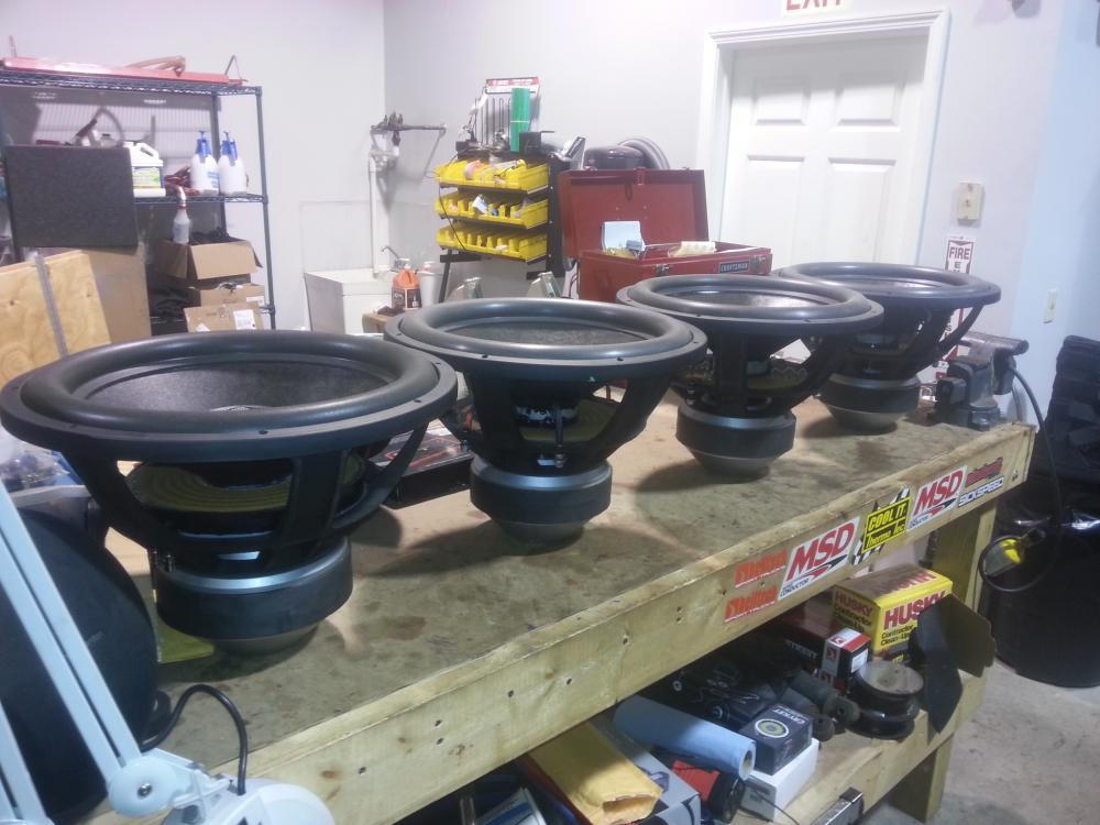

Starting a build log of a friends escalade  we are doing a build in. Currently he is running 2 sp4 18s on an ampere 9k enclosure tuned around 26-27 . Highest on the meter was is a 150.9 sealed on the dash at 35 . Goal for the new build is a 153 and still tuning close to the same as he is now. He doesnt really care about the numbers though . Mainly the lows . His shit now hits pretty hard down to like 15hz lol and pretty well up into the 50s so we are going to try to make it as musical is possible with what we got to work with .
Going to be 4 sp4 18s

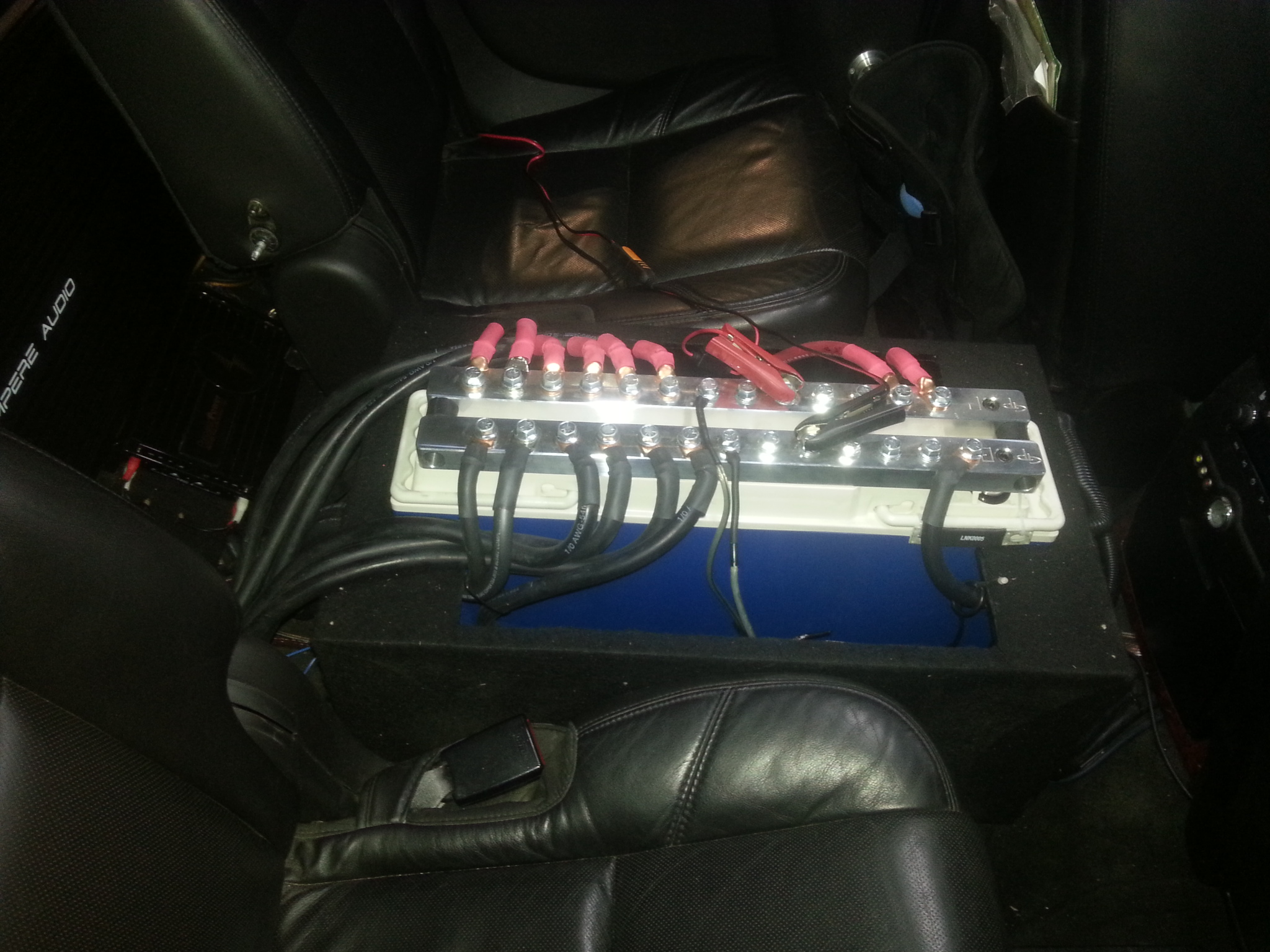

 Ill post up some pictures of his current setup and what we are working on now tomorrow once I get to the shop

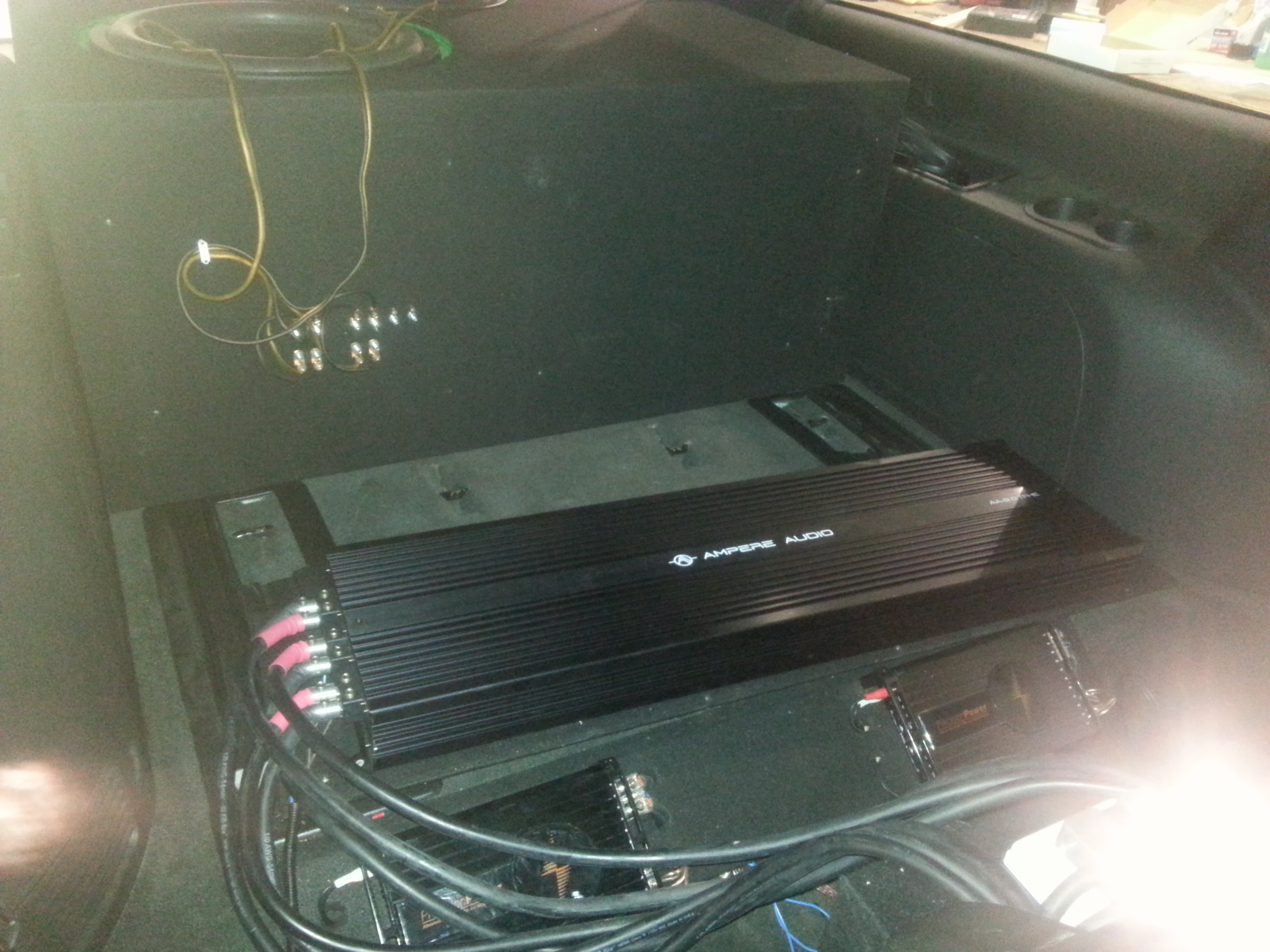

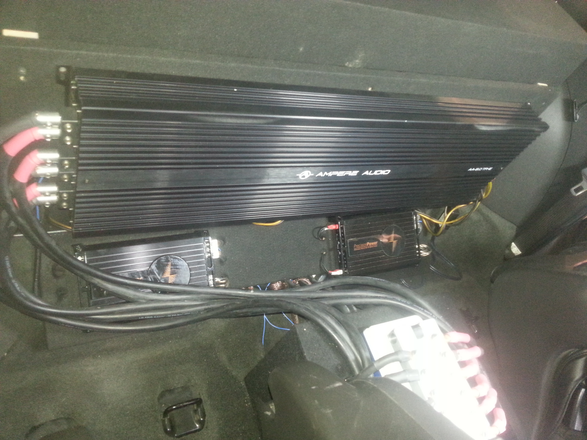

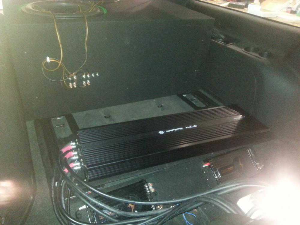

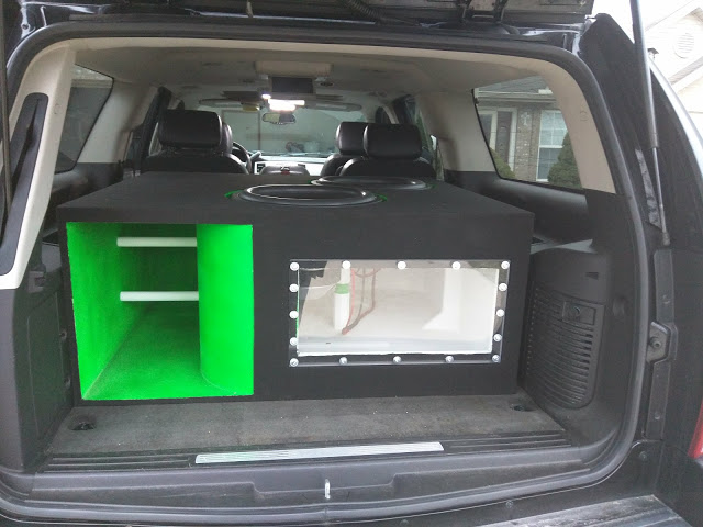

This is the current enclosure

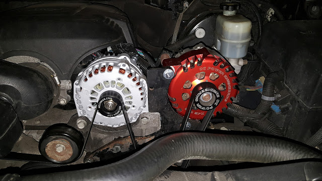

Alts. He is thinking about changing to ones that he can externally regulate
Yessssh! Tuned in. Sick Box btw. Did y’all have a part in that ?
Yea built that one a year or so ago
Looks sick. Great work.

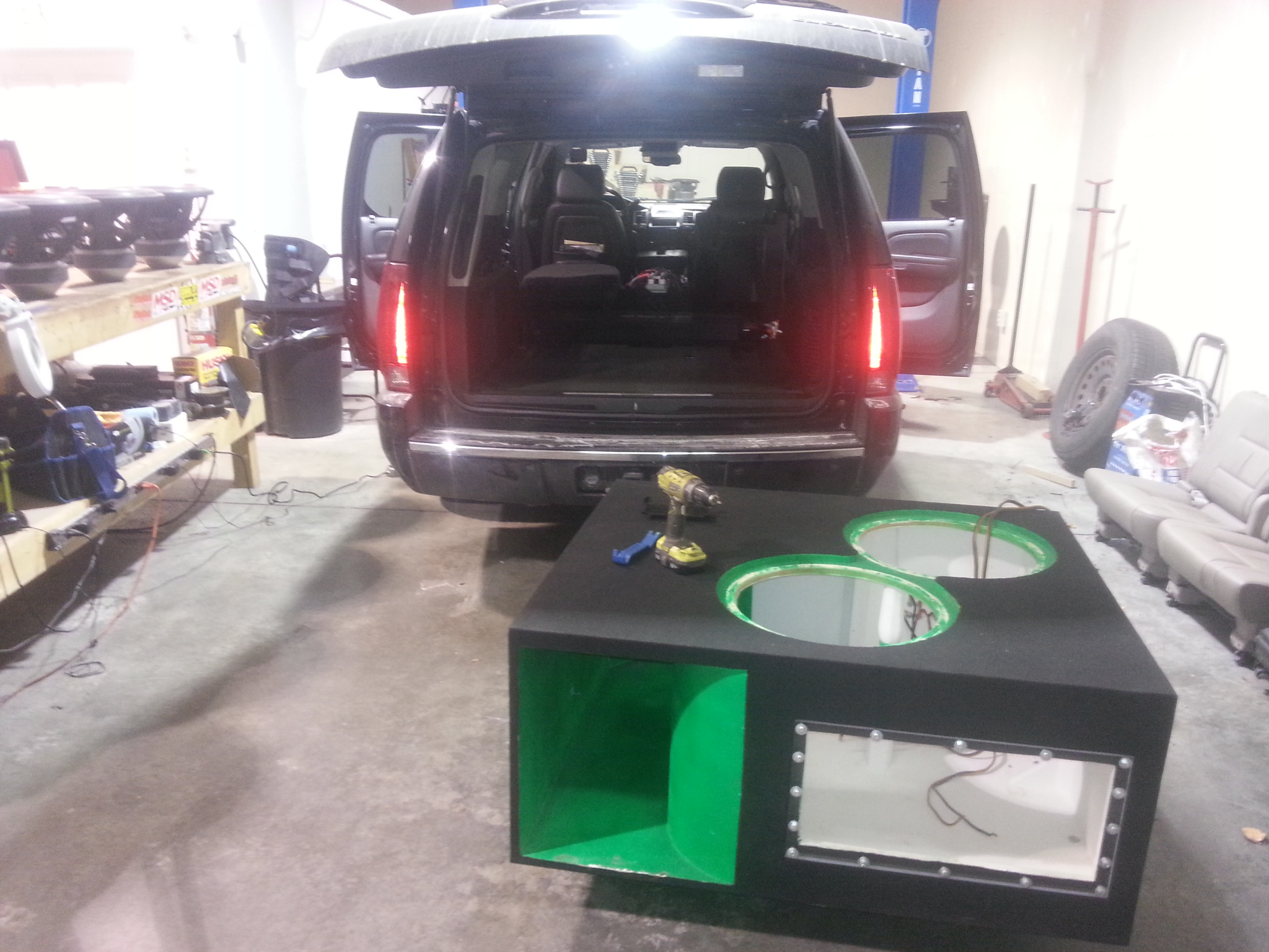

Takin the old out
:popcorn:
Yeah buddy
Officially out with the old

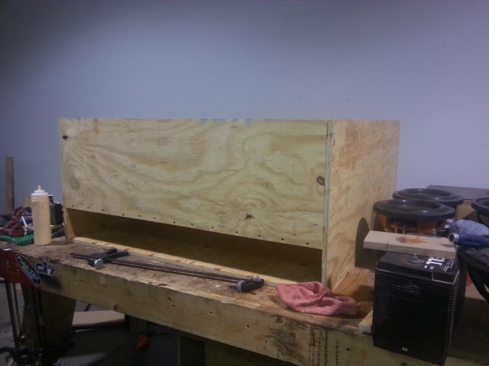

Preview of the new enclosure
Only going to end up at about 17 cubes net . Tuned to 27-28
Whole thing will be douple layered except the baffle that will be 4 layers
If anyone wants the old enclosure for cheap let me know lol. Its just going to be taking up space

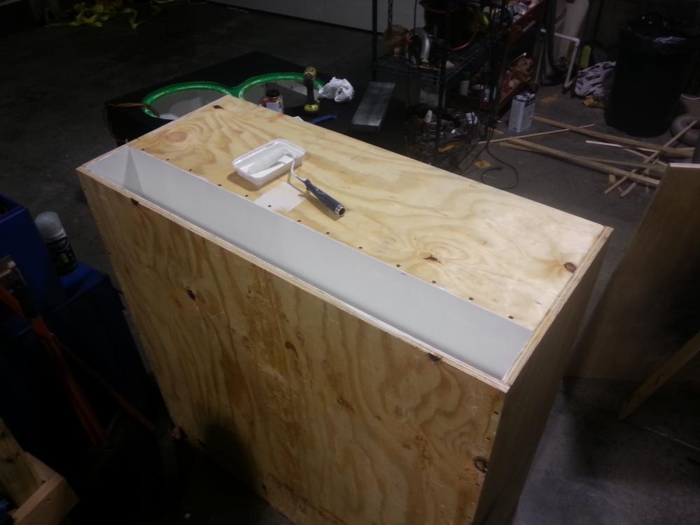

Hopefully gettin the enclosure mostly finished up today
Thick baffle
