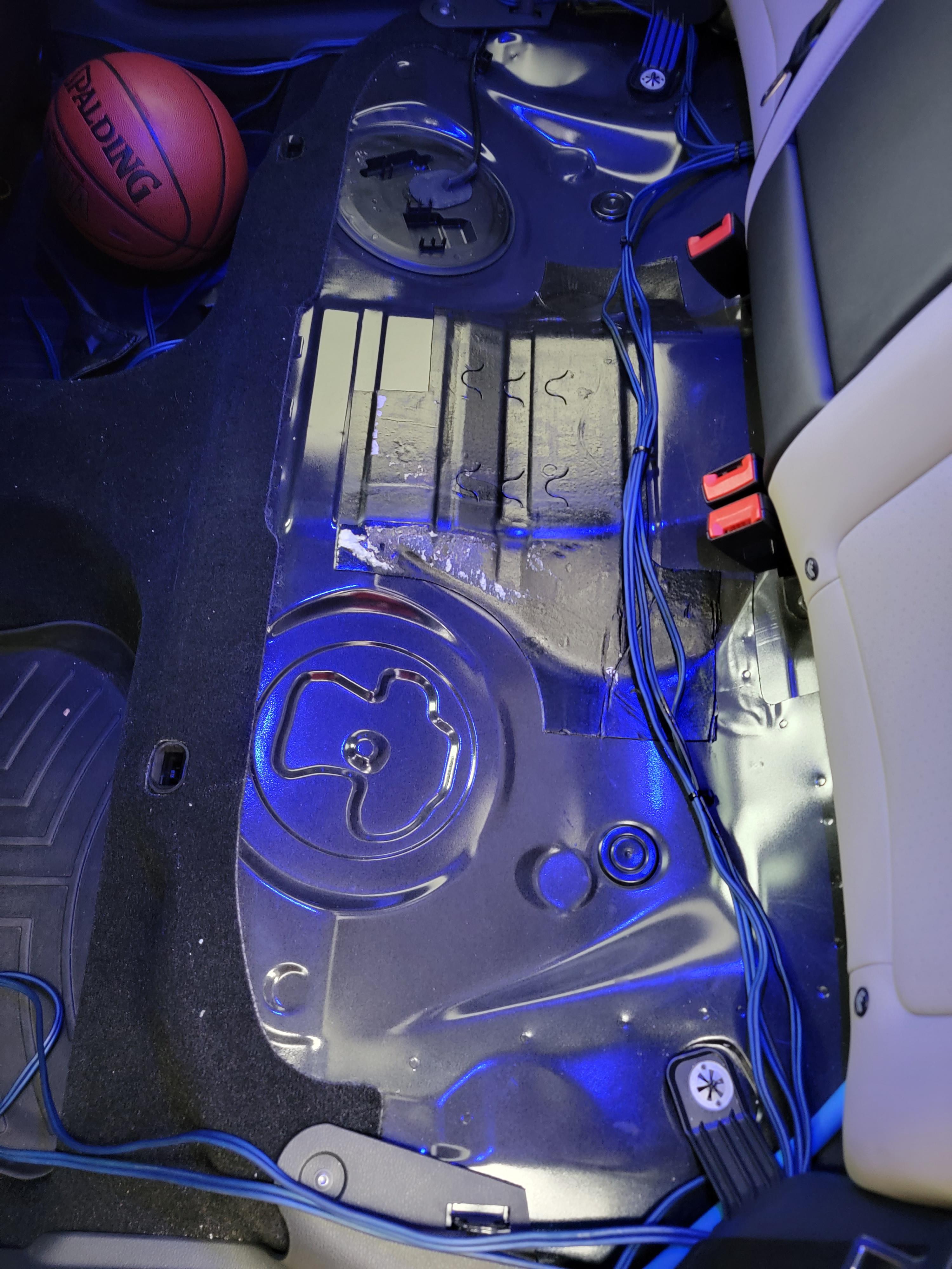

    Sound deadening has began
  • jcarter1885
    jcarter1885
    I'm 80% done with the sound deadner, the trunk deck is next. I didn't do the under side yet because I don't feel like uninstalling the factory subwoofer till it blows or until my new Fi sub gets here.

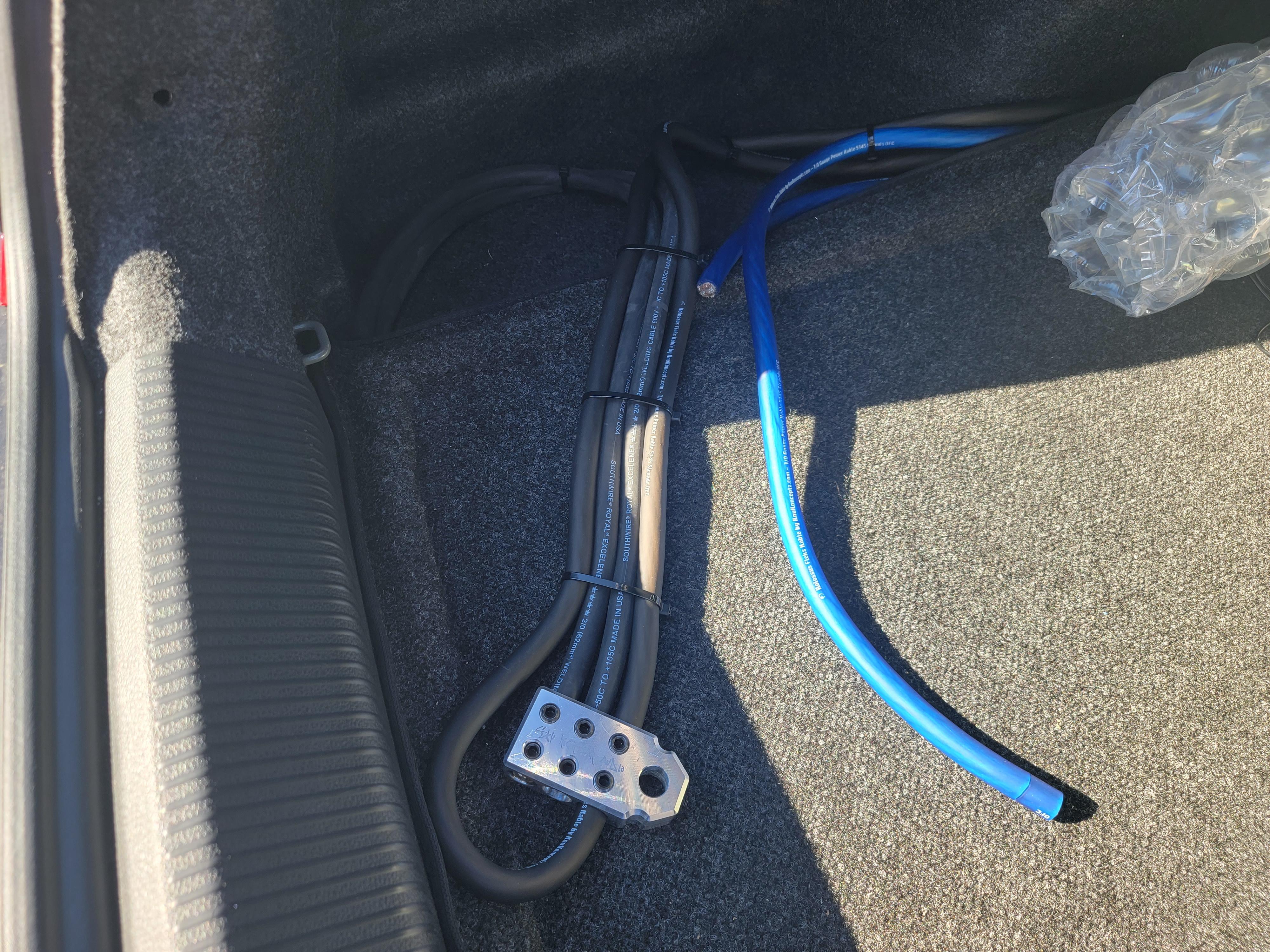

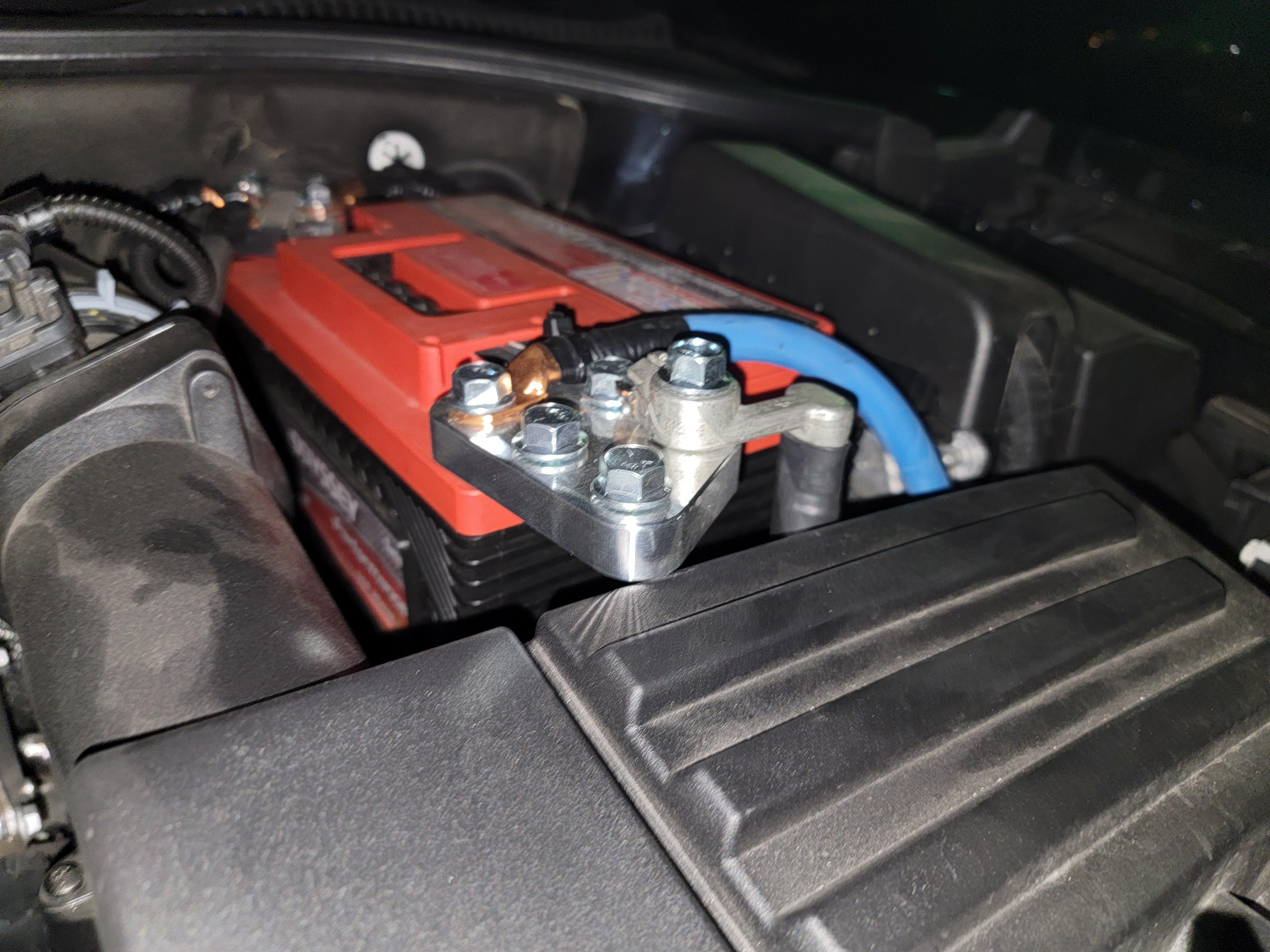

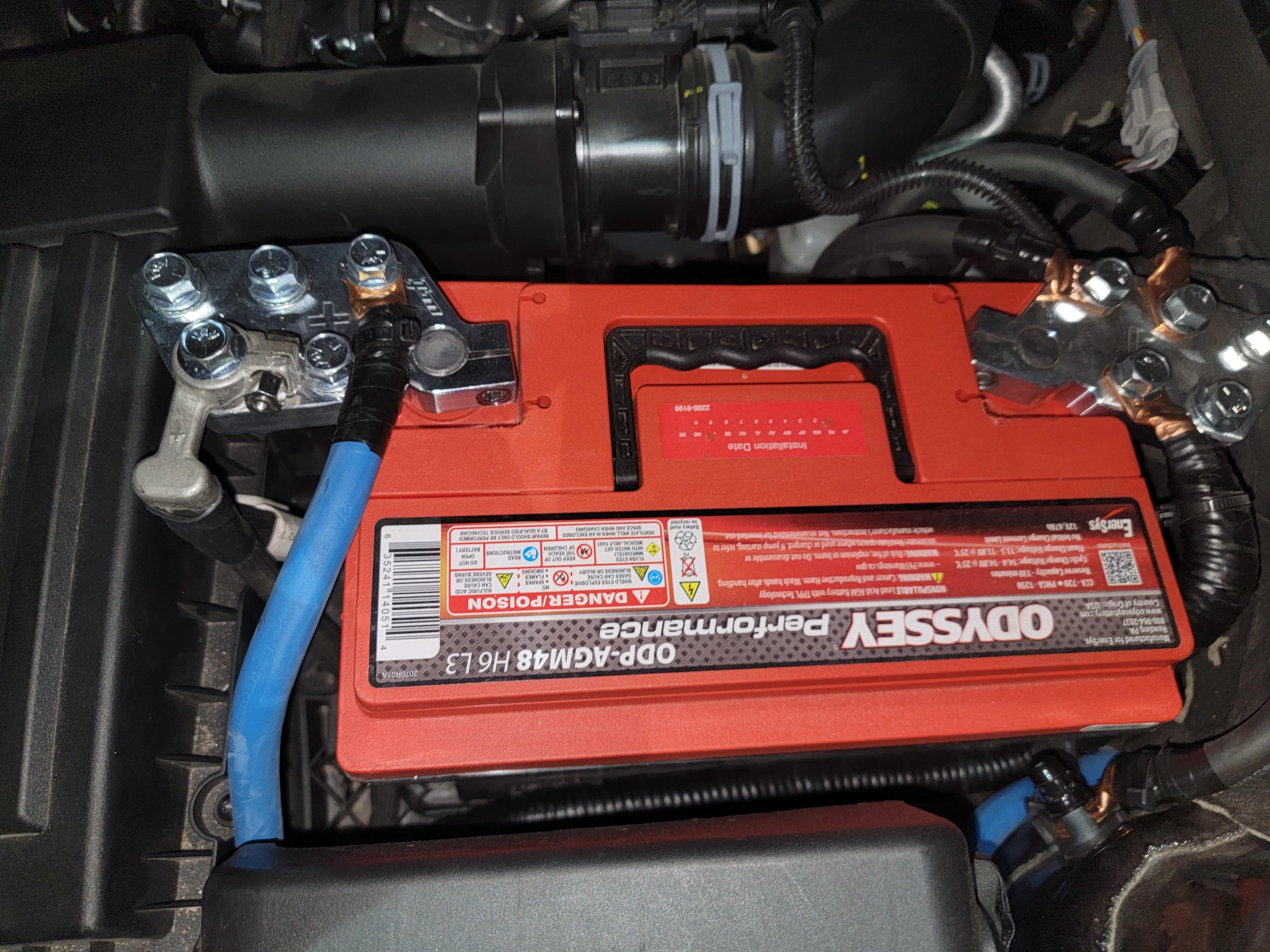

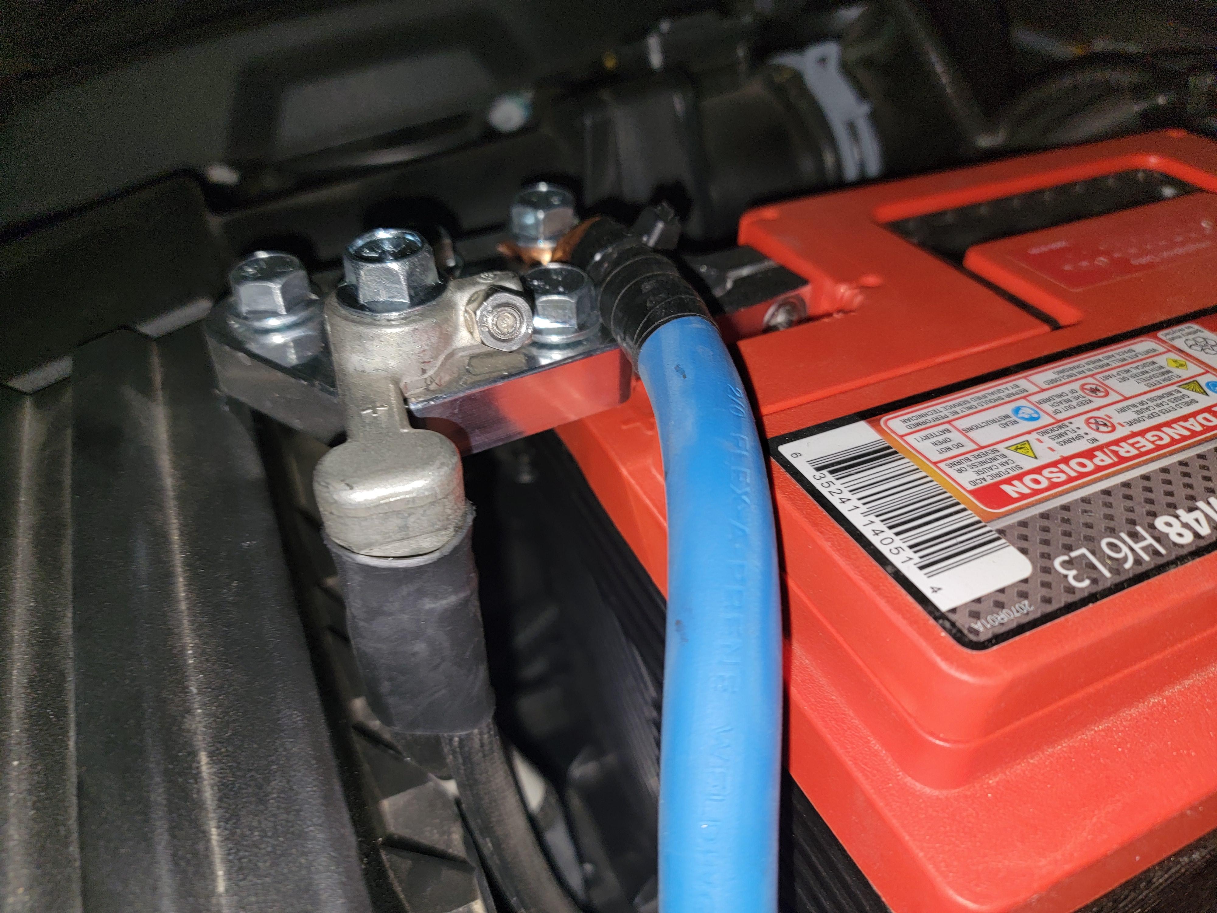

I absolutely loved my idea to attach the factory terminal to the distribution block but it was hard to tighten down the added top post I was using in between the distribution block and terminal. So I just bought a longer bolt and put the terminal straight to the block itself.

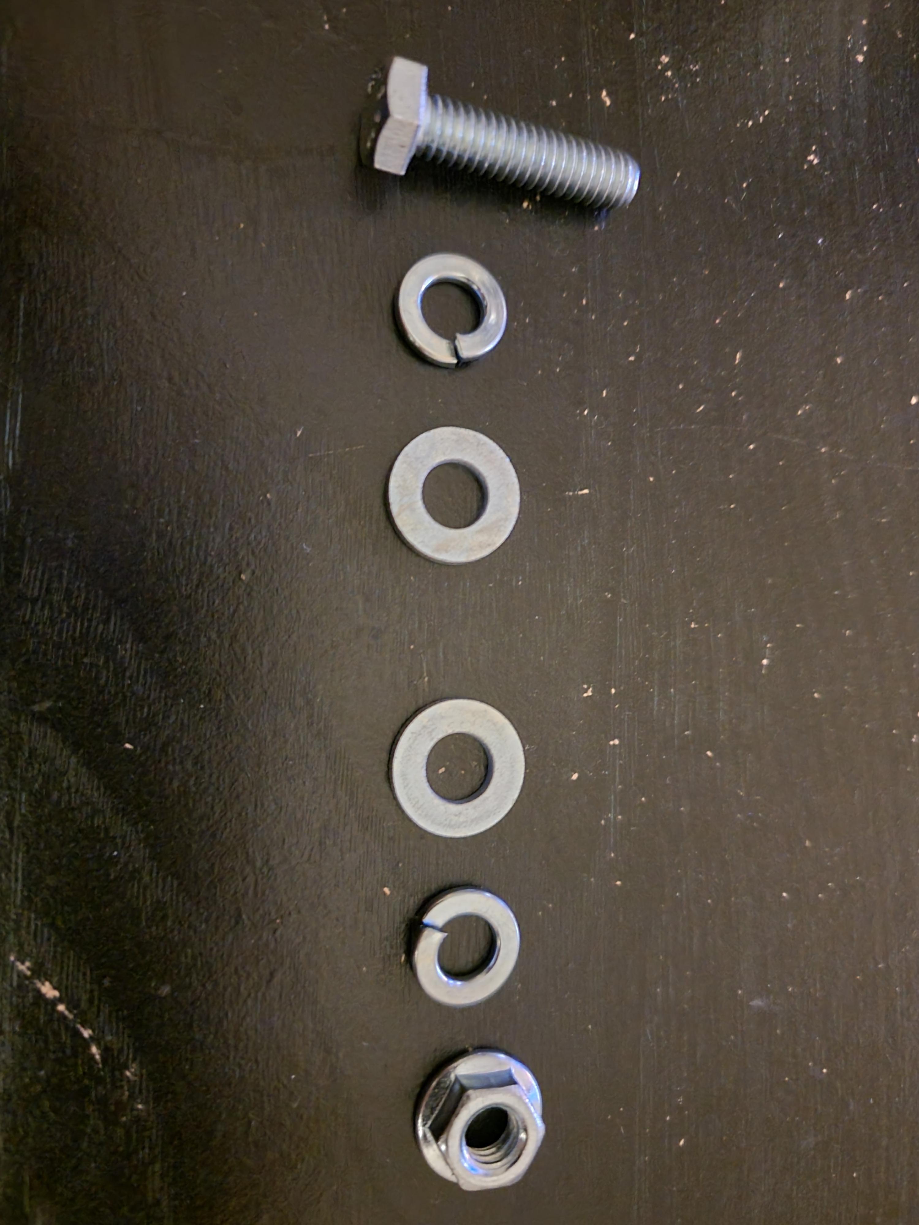

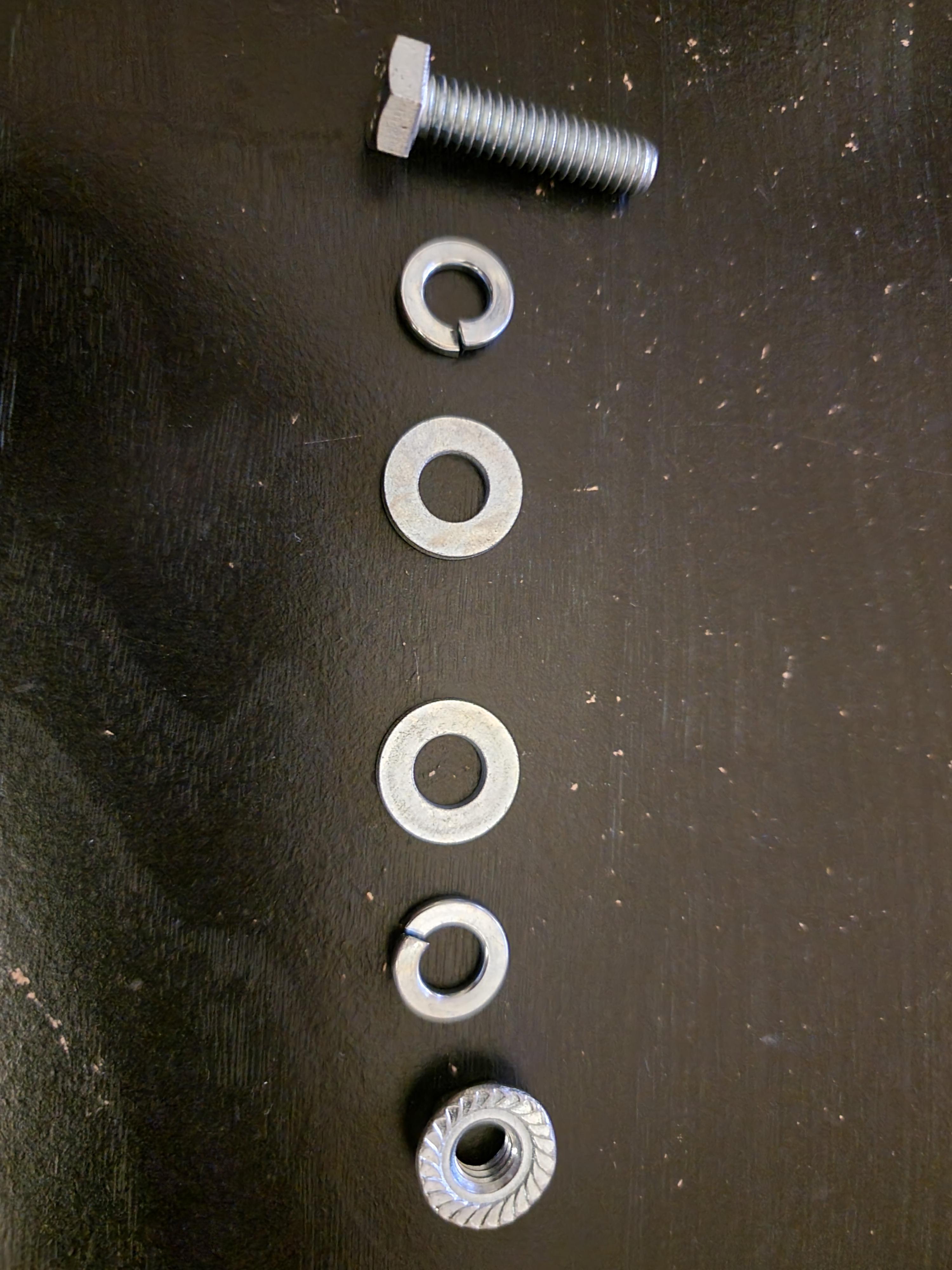

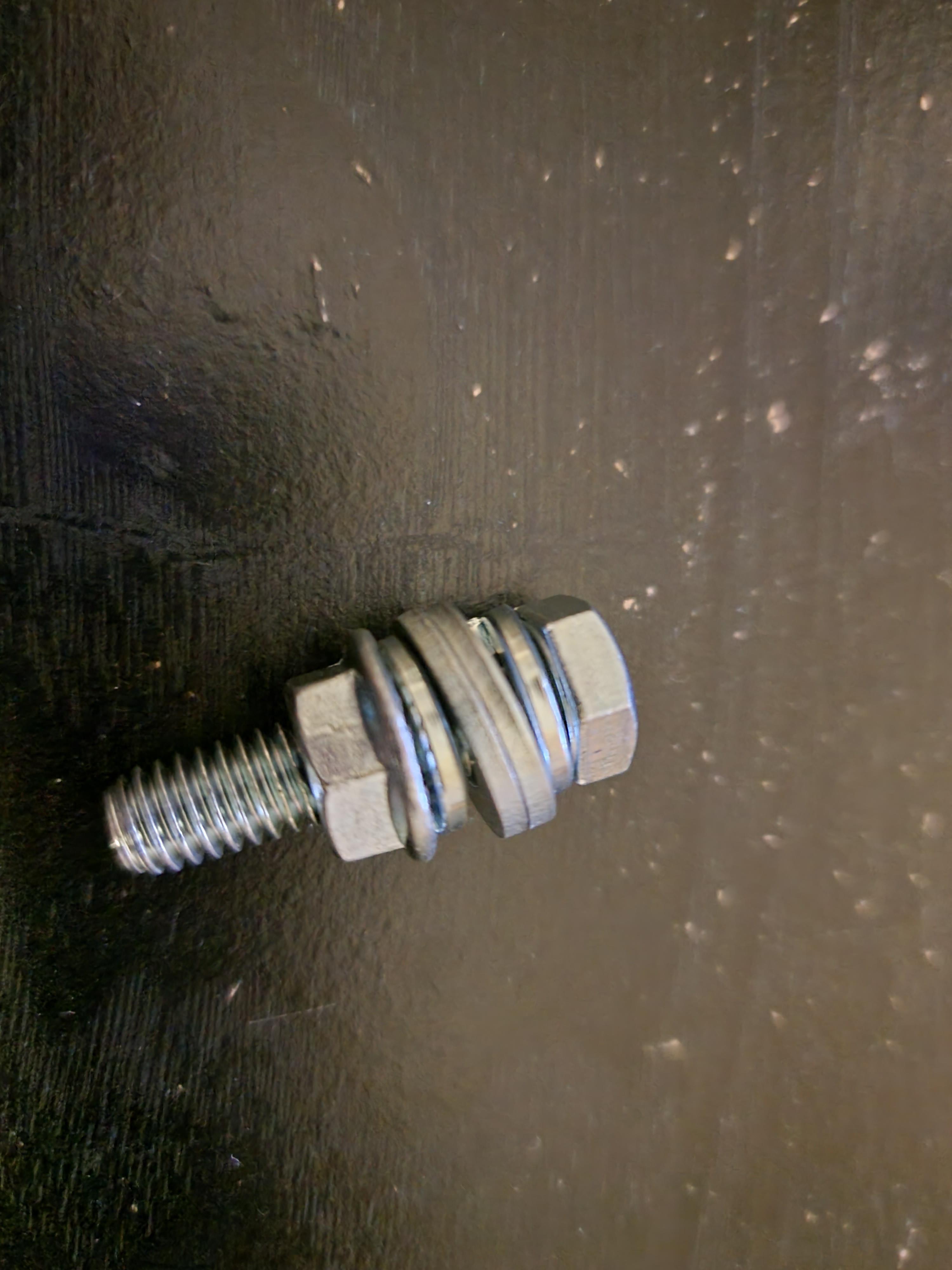

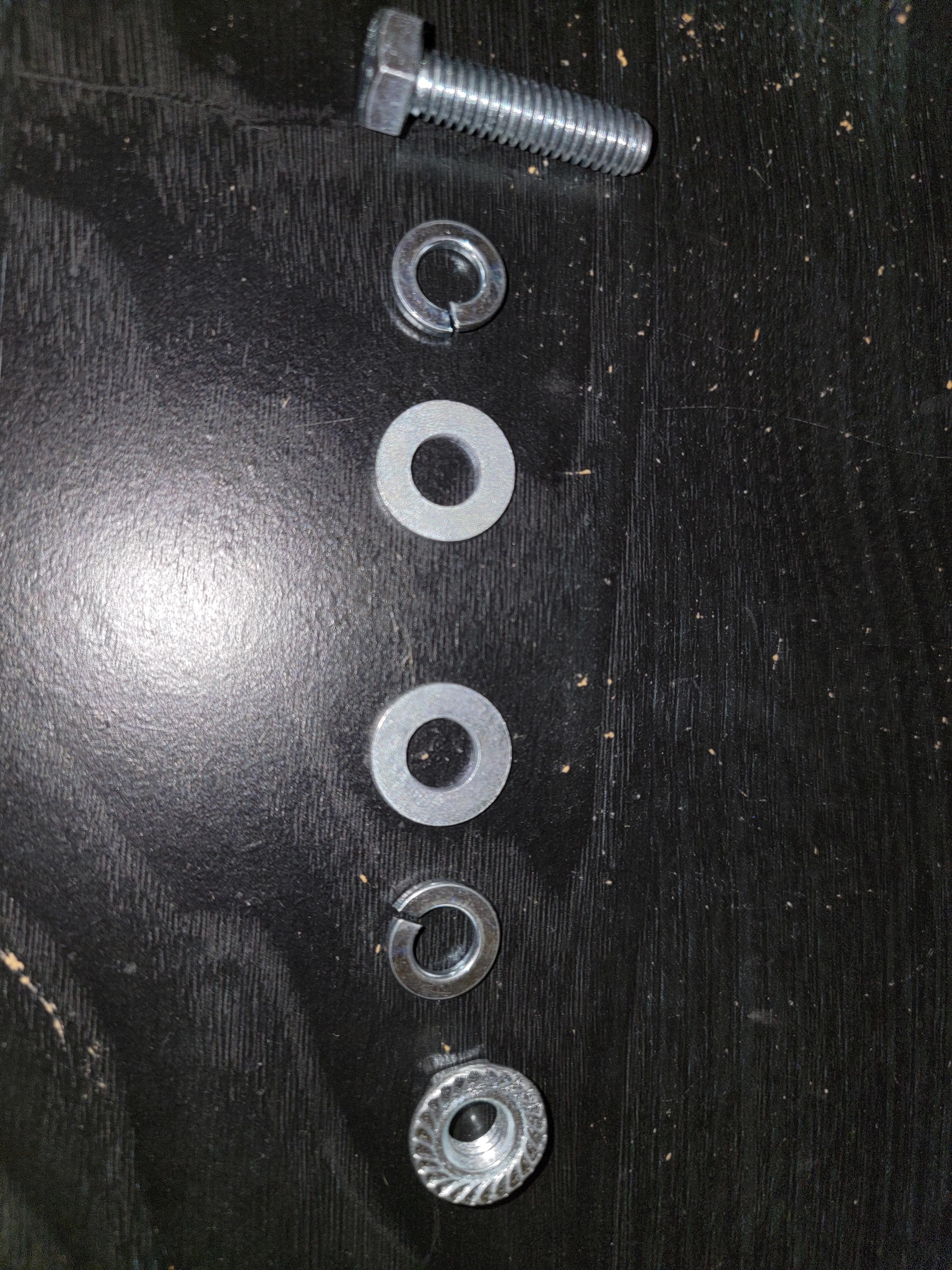

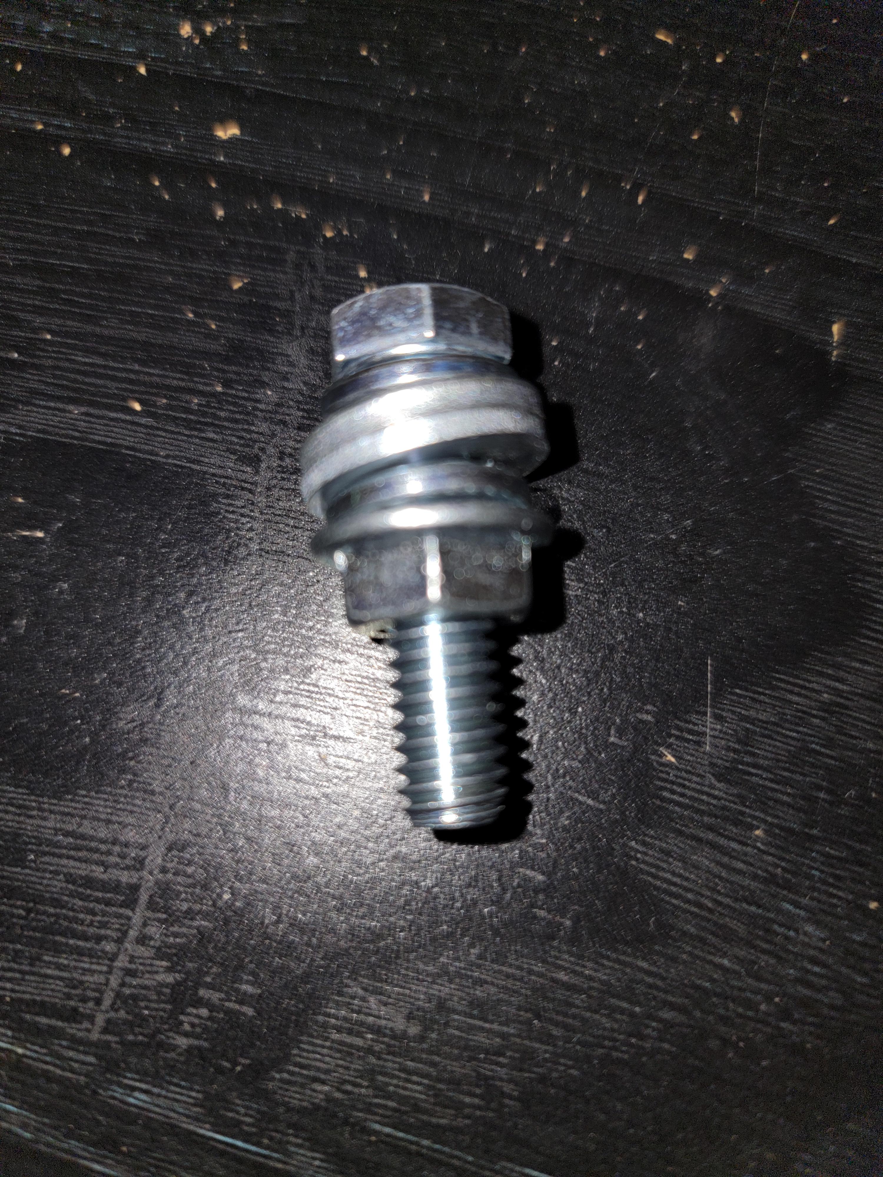

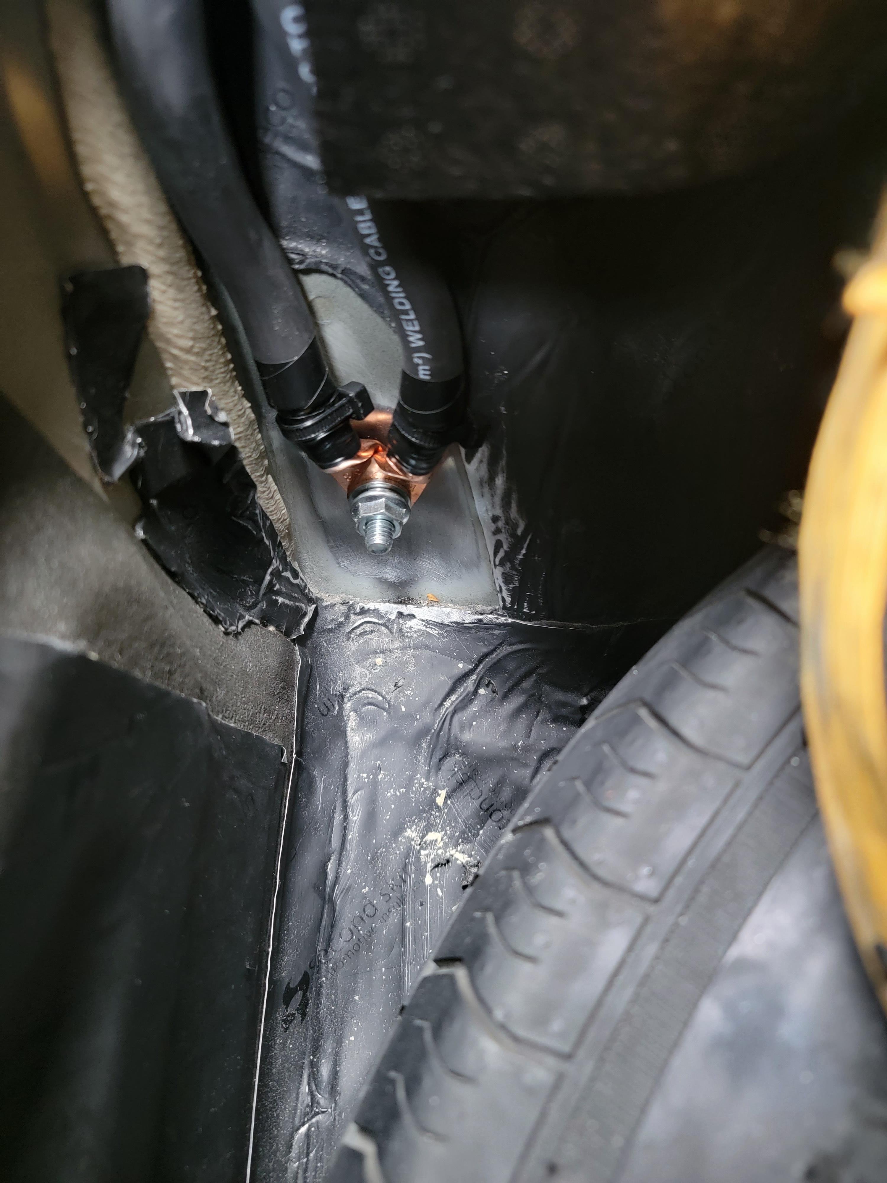

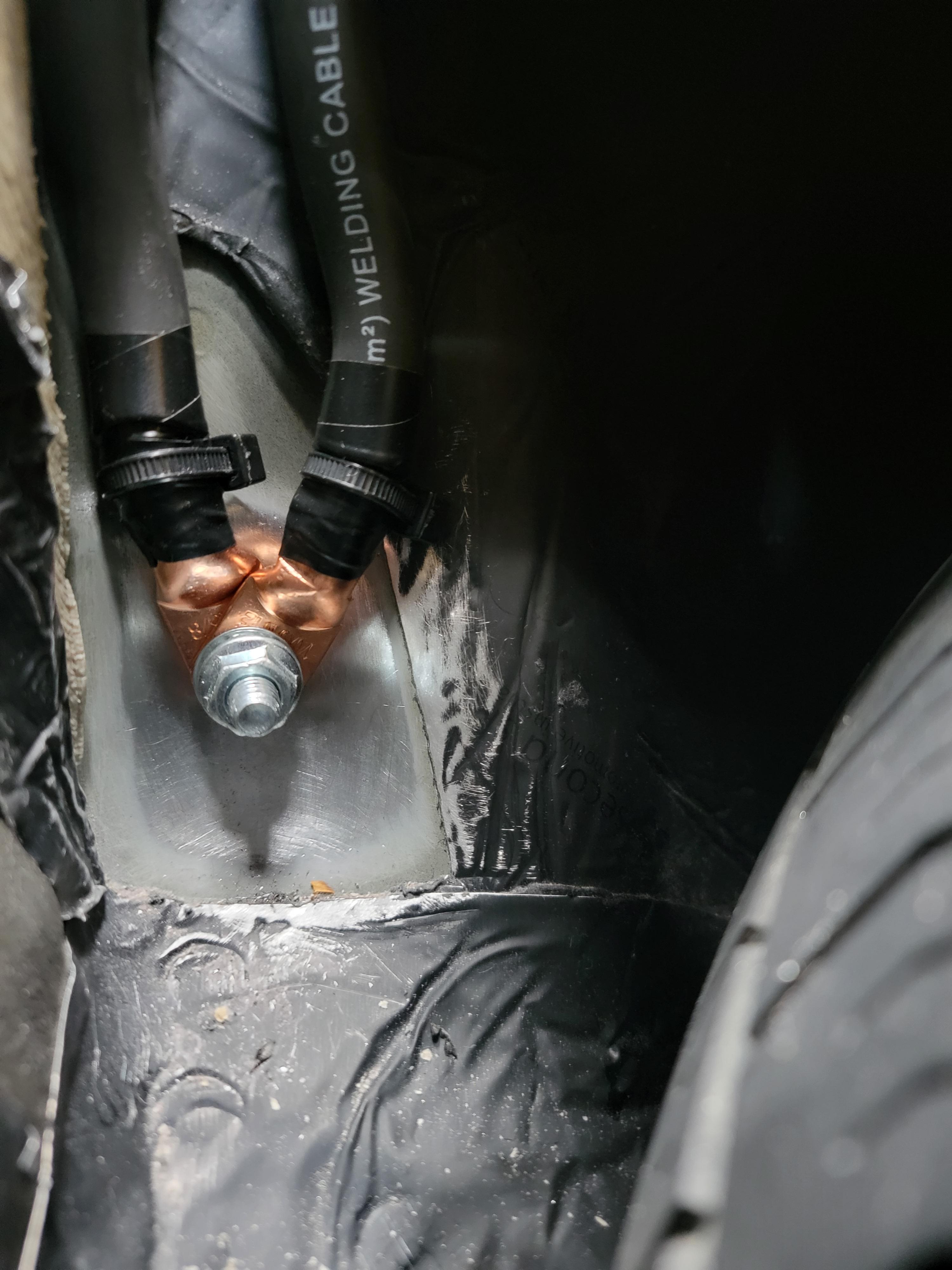

Bolt washer setup for my trunk ground wires, everything is mounted just needs to be covered to prevent rust and oxidation.

22 hours ago, jcarter1885 said:
Ok one last question do I do it on the grounds in the trunk? Will I have to still spray paint over to reduce the metal from rusting in the areas I sanded the paint down? Or can I just cover it with a layer of this and be ok?
Thanks man
You can do it either way.
Trunk 2/0 welding cable grounds are complete and covered with spray paint.

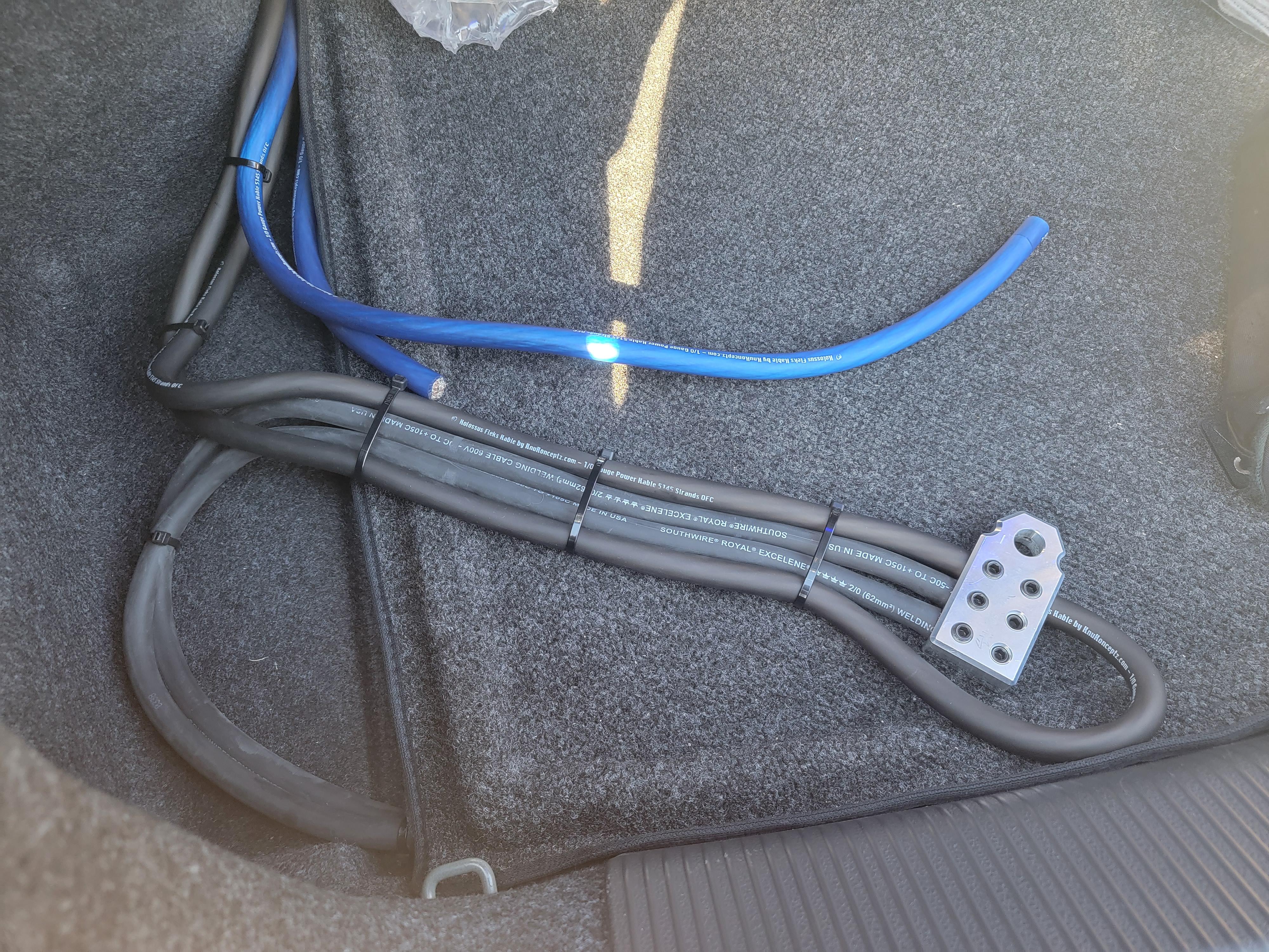

Some rear battery wire management, all zip-tied together even though it won't be seen behind the battery.

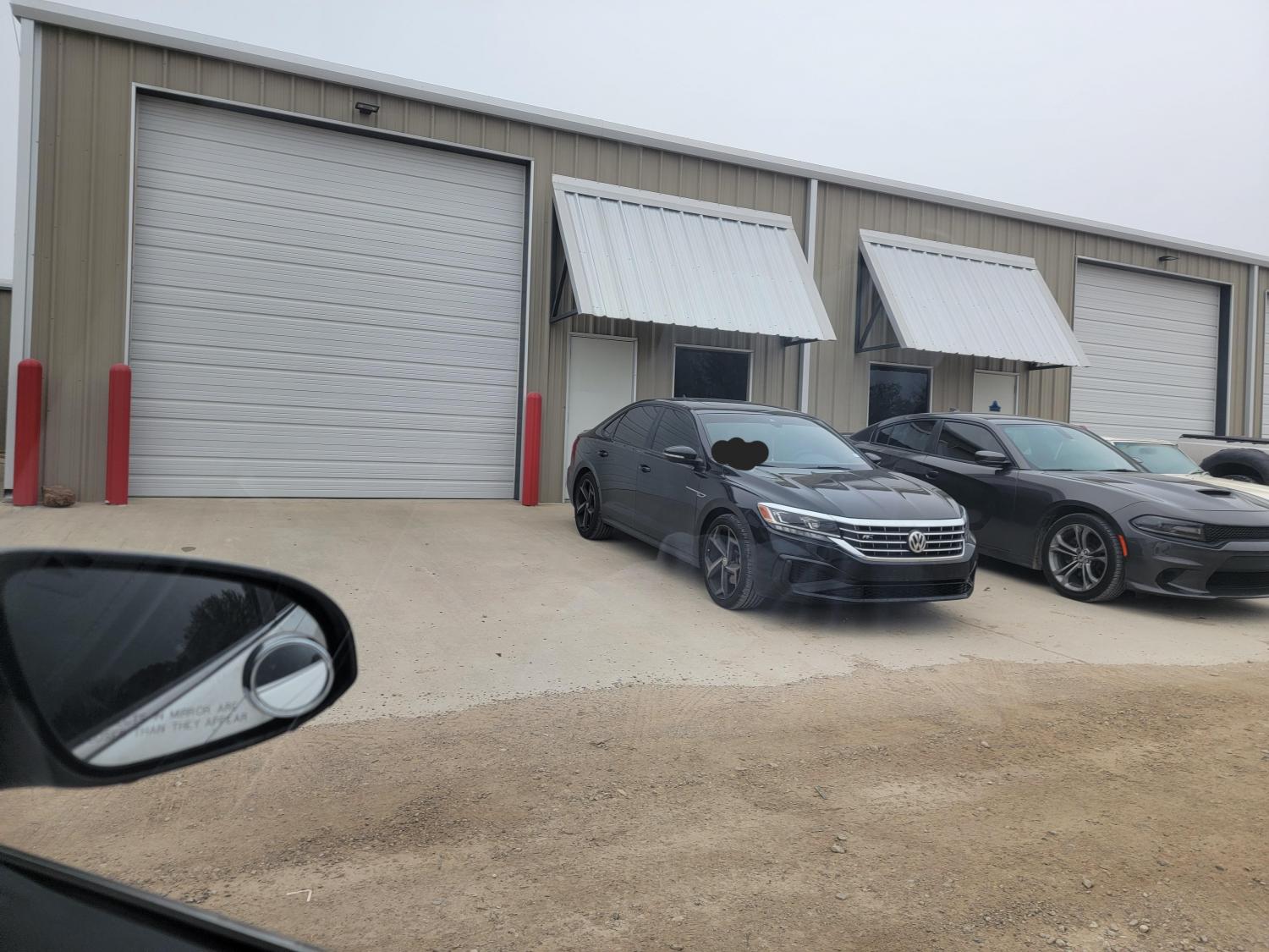

Dropped her off today, I know she is in good hands. I've never had a shop work on any of my cars, Ive always done my own work since college.
Work getting done: horn mounting, front/rear door speaker rings fabrication and speaker install, front/rear door tweaker pads and rings install, front/rear door speaker wire to molex connectors install, Nav-TV unit installed, rear battery platform and mounting, setting up front stage with DSP tuning.

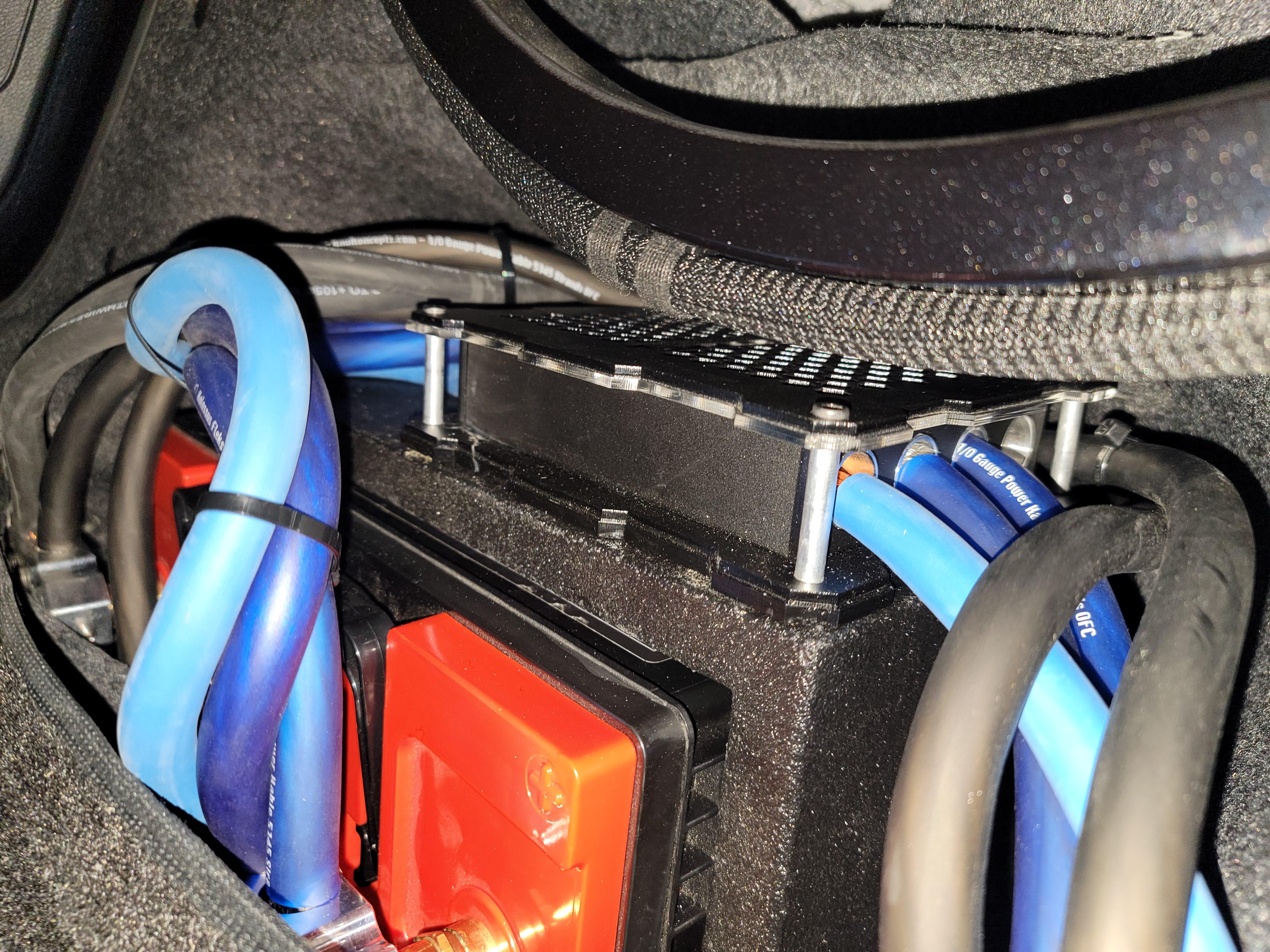

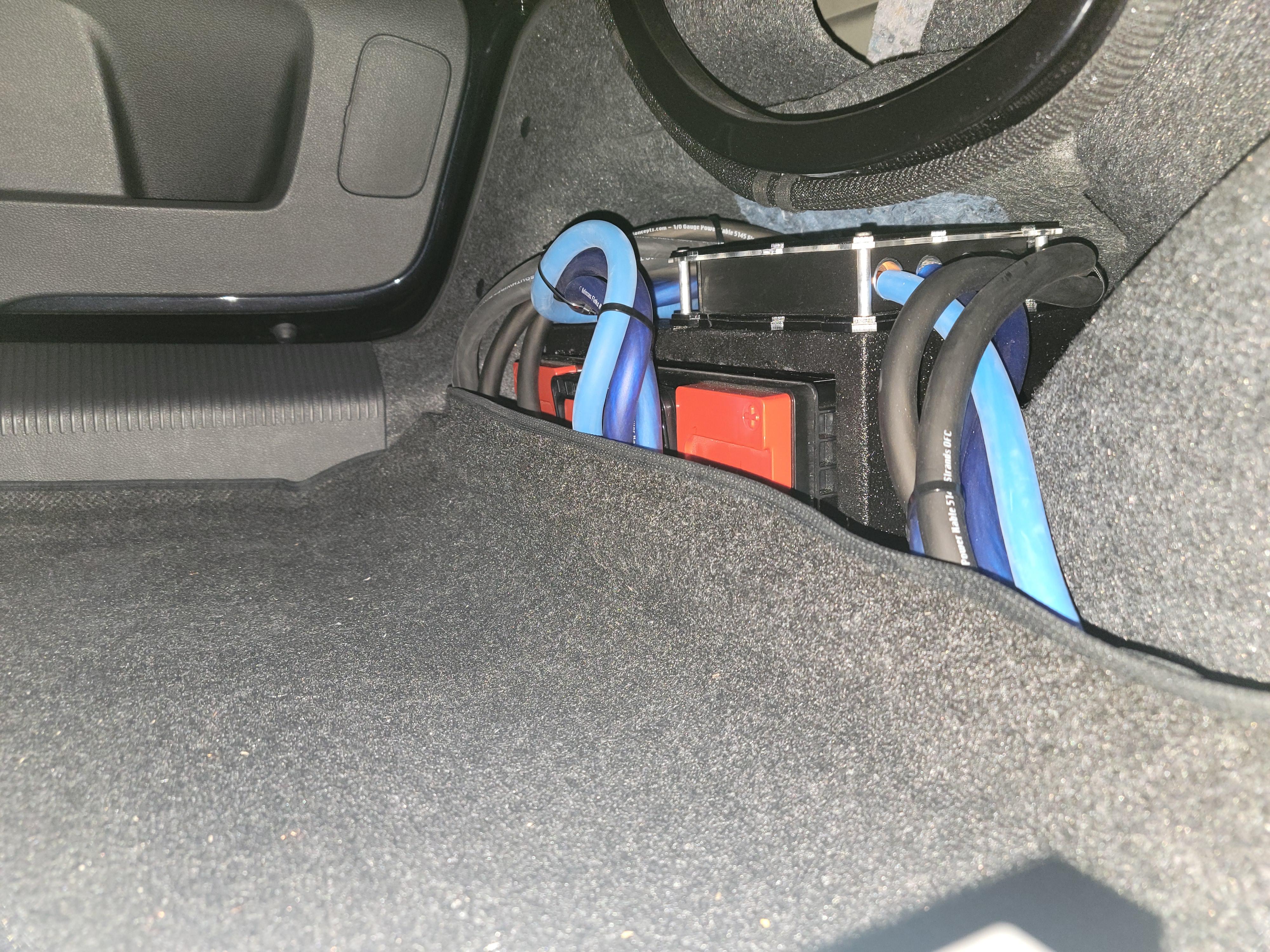

Got rid of some zip ties and added wire loom for remote start wire and DSP power/ground wire.
Look at how much room is left to spare, story of my life.
