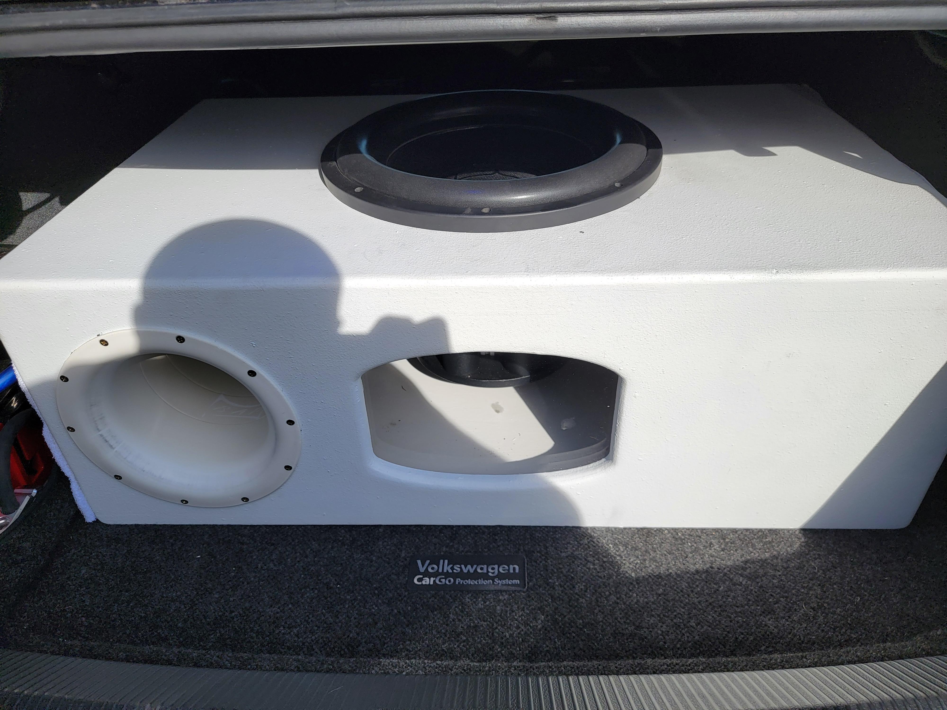

March 17, 20224 yr Author Inside wire hole is now sealed, letting it all cure for a few days. There's a show at Crossfire Car Audio on Saturday, I doubt I'll make it though but we will see.
March 20, 20224 yr Author 5 hours ago, Tirefryr said: ALways gotta let the hole cure. Nice and tight! Yes sir, no point on rushing it all. I also added some wire tie down clamps and covered them in amazing goop as well. Wires were ziptied together as well. I love amazing goop.

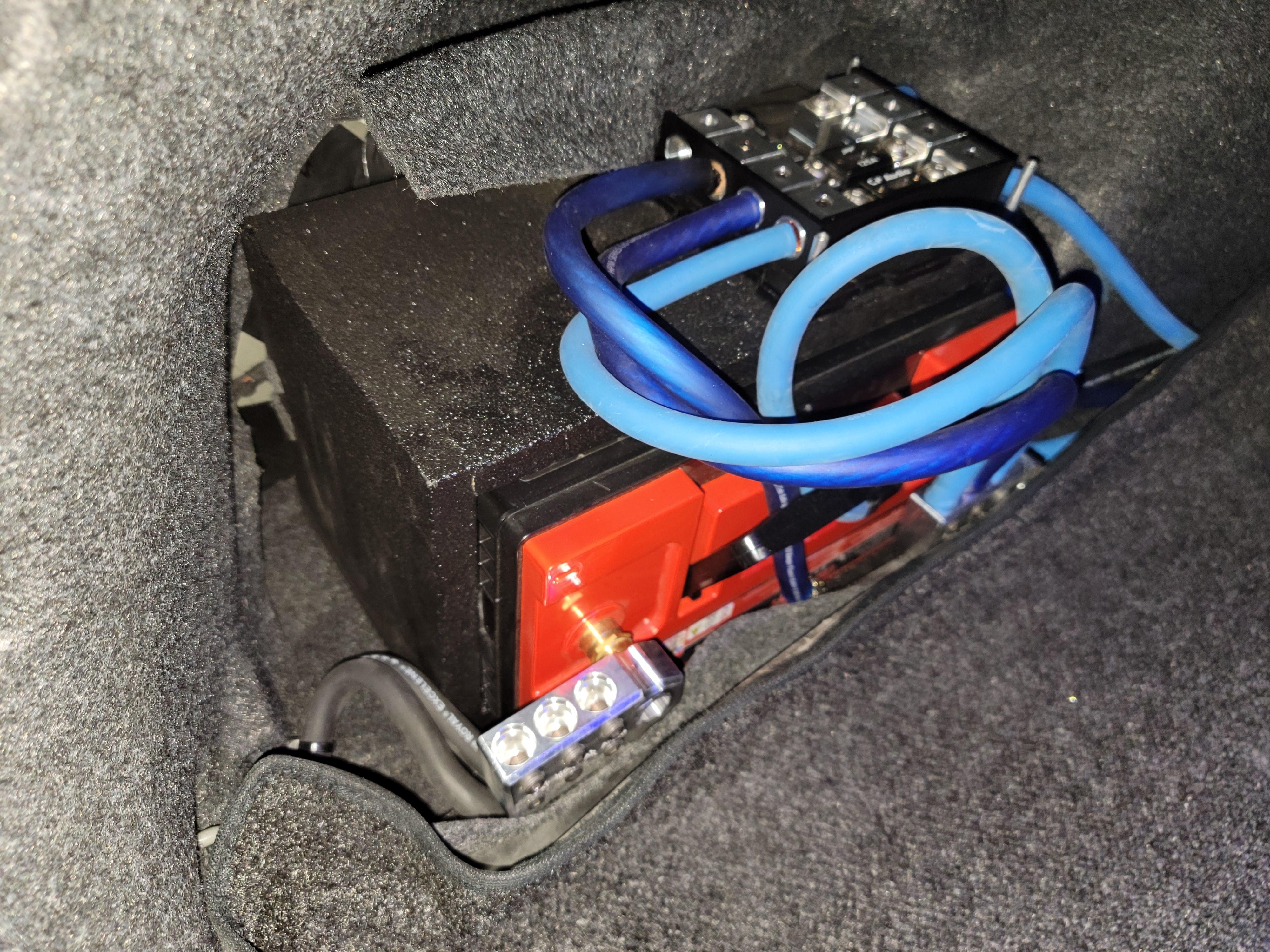

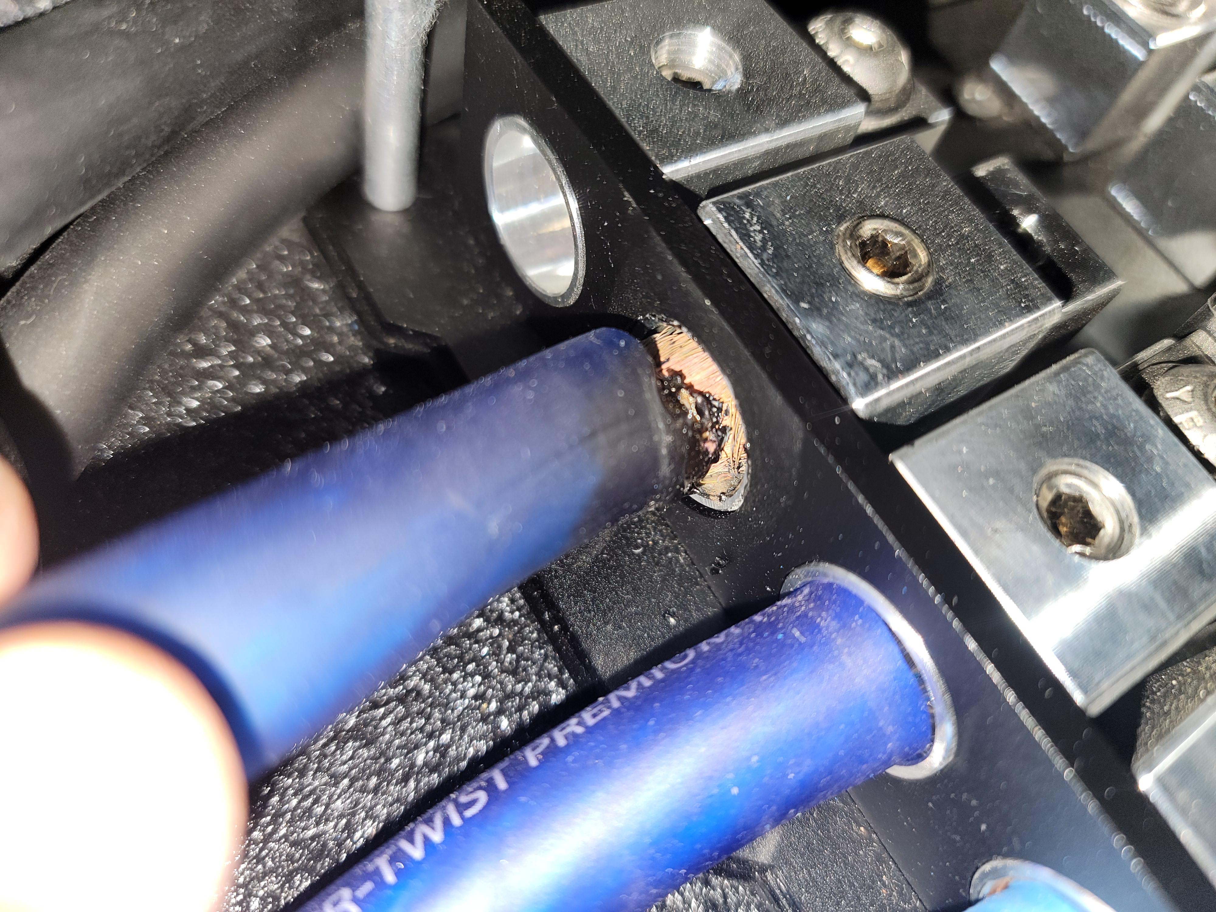

March 21, 20224 yr Author Good news and bad news, I'm glad I decided to work on my trunk wiring with the enclosure out because I found this. Any input on why or what happened? Fuse wasnt burned or blown but some discoloration. I also cant get the terminal unscrewed to remove the wire. Upgrading subwoofer amplifier power/ground wires to 2/0 welding cable as well. Only car audio wire will be speaker wire and power/ground wire for front stage amplifier for now. Edited March 22, 20224 yr by jcarter1885
March 21, 20224 yr Author Going to change a lot of things. That fuse holder will be coming out and I will be getting an SMD Fuse holder and will crimp all wires to prevent this from happening in the future. I'm also trying to upgrade amps to a Crossfire 4K so this may delay the box going in for a while. H/O Alternator is in the works too, trying to stop buying car audio this year.
March 21, 20224 yr That's definitely a loose connection issue. Under high current, this will generate a lot of heat and you'll get what you see here. I've seen DC motors weld cable to terminals with as little as 30 amps. It happens before you know it too.
March 21, 20224 yr Author 7 hours ago, Tirefryr said: That's definitely a loose connection issue. Under high current, this will generate a lot of heat and you'll get what you see here. I've seen DC motors weld cable to terminals with as little as 30 amps. It happens before you know it too. Thanks I greatly appreciate it because I never seen this before and it had me worried. I'm glad I caught it when I did. I will buy a crimper and will be crimping all my wire from here on out. No more set screw style fuse blocks from here out either. Not blaming them but if this can be avoided by not going that route then I'm all for it. Edited March 22, 20224 yr by jcarter1885

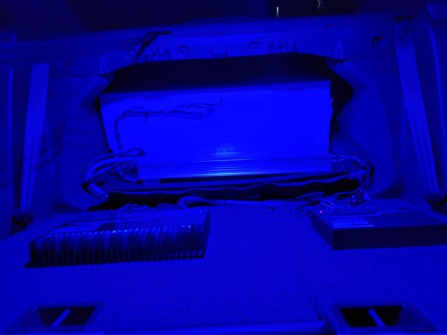

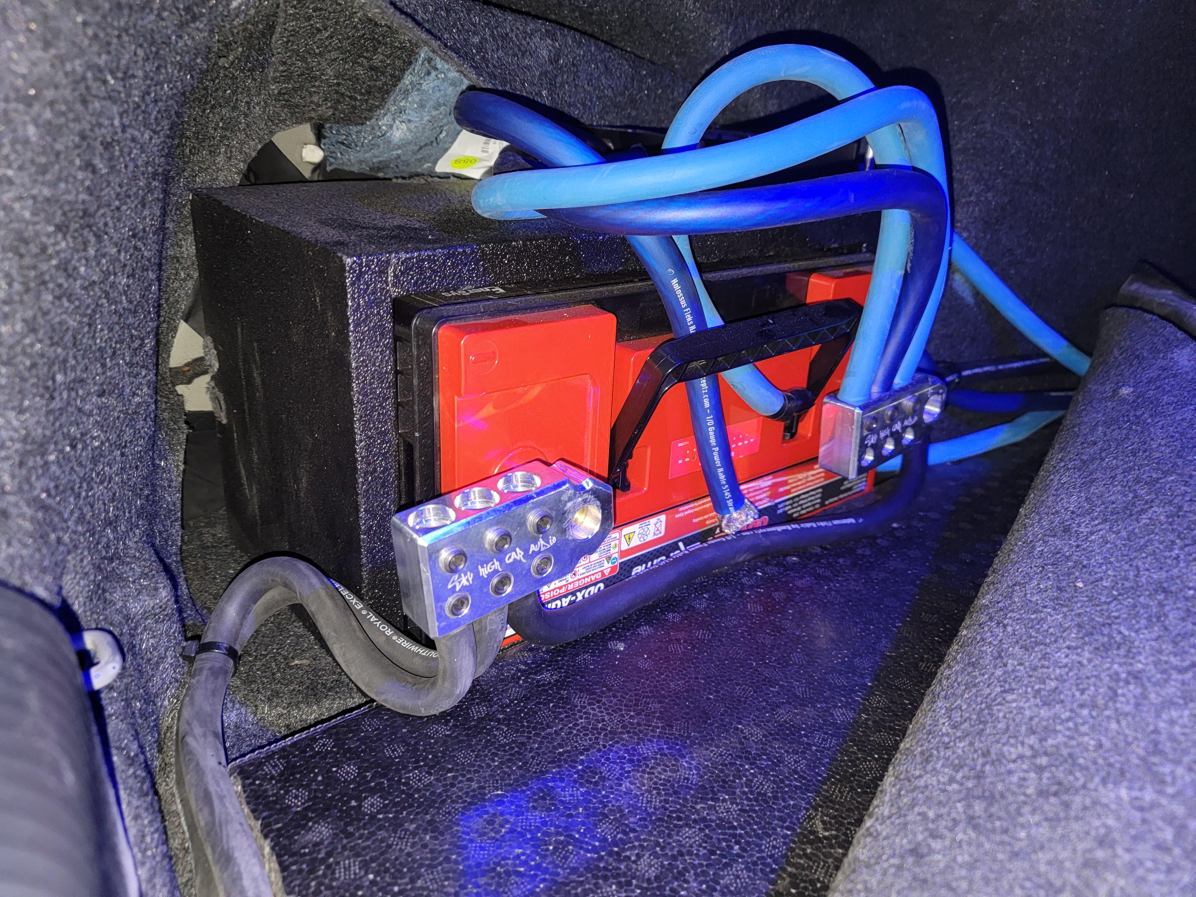

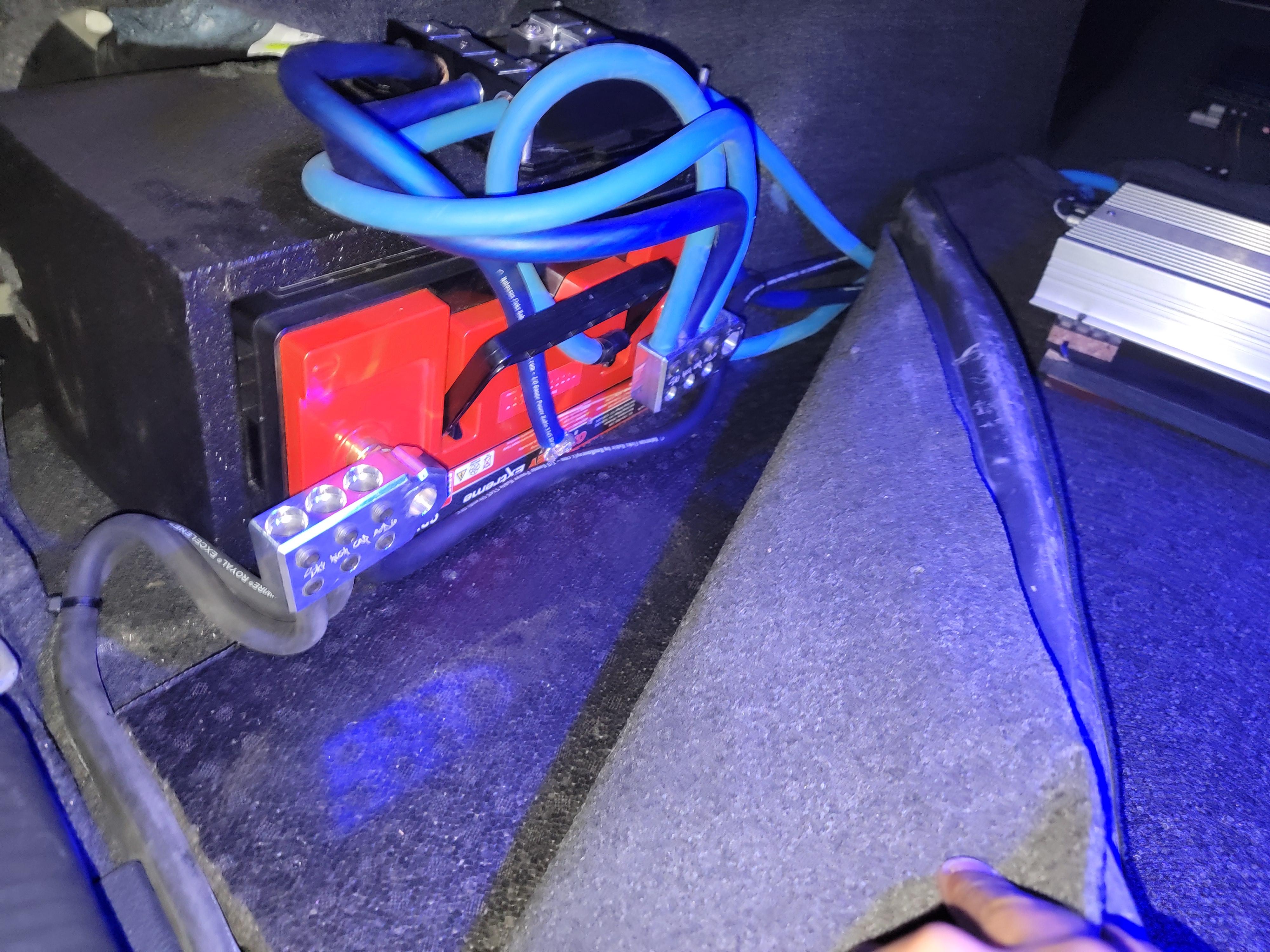

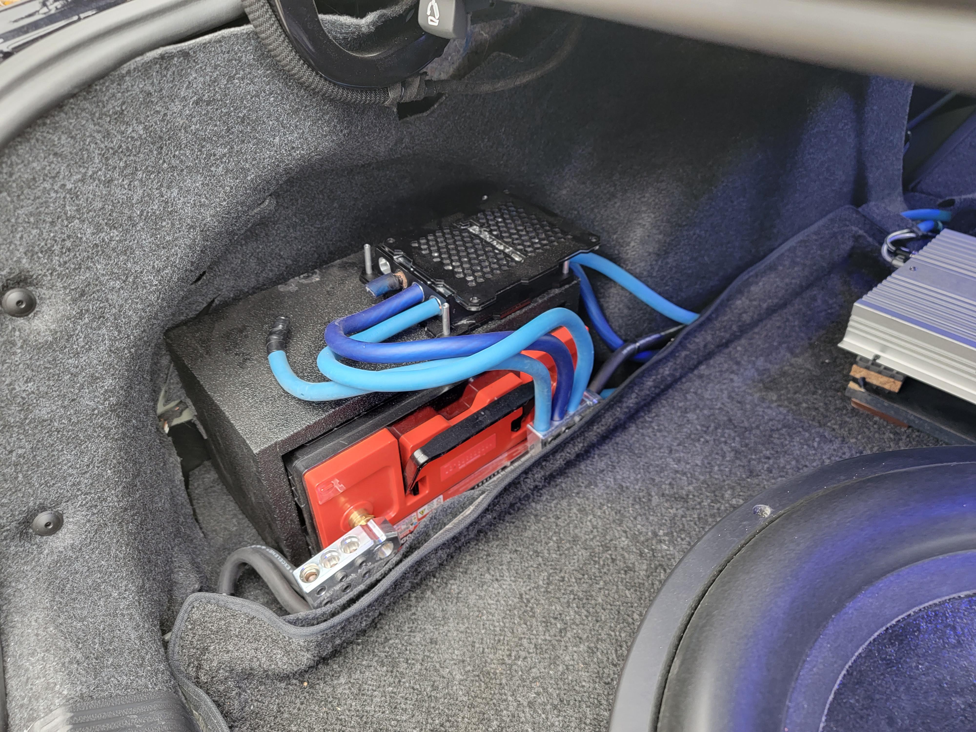

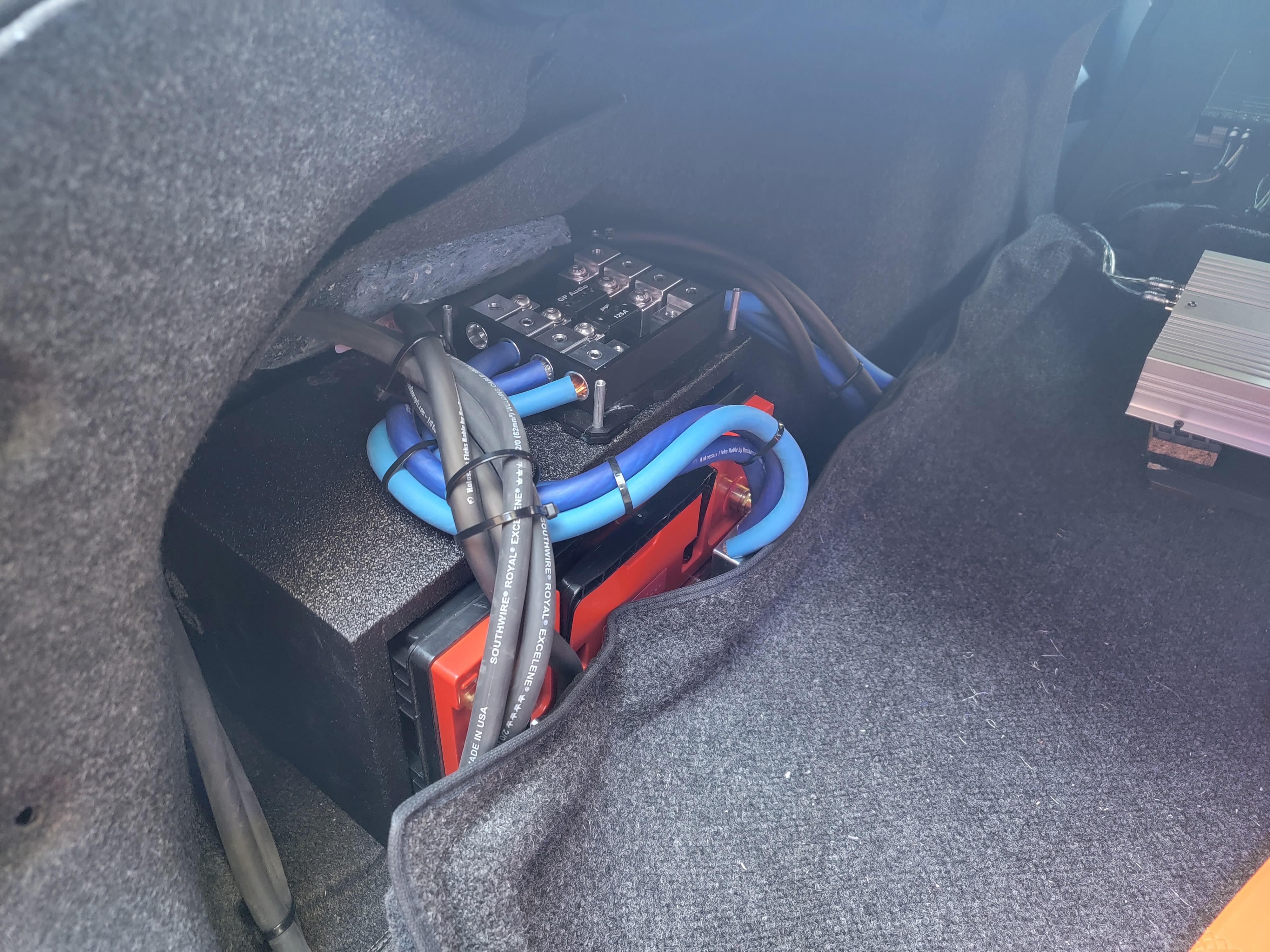

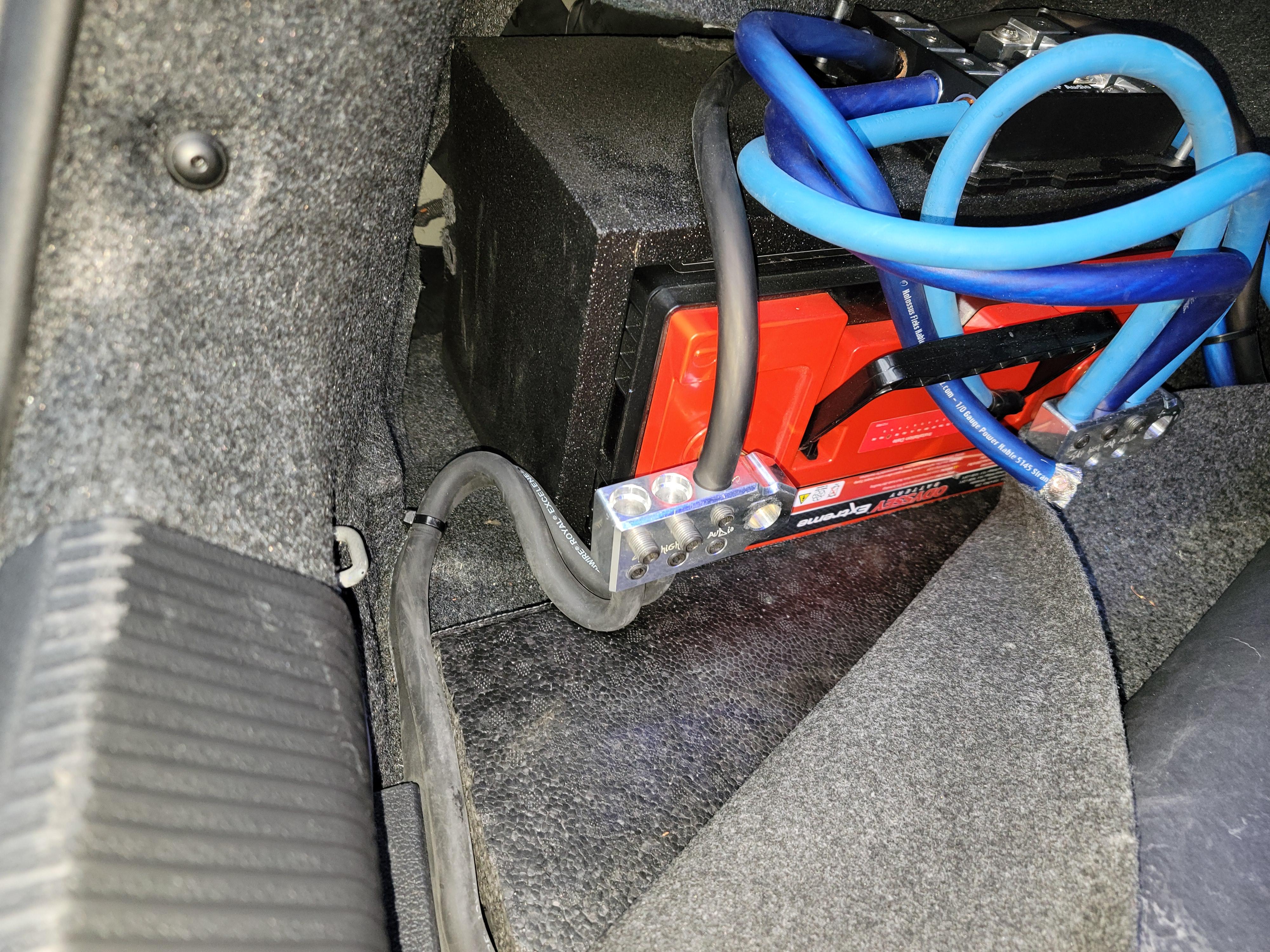

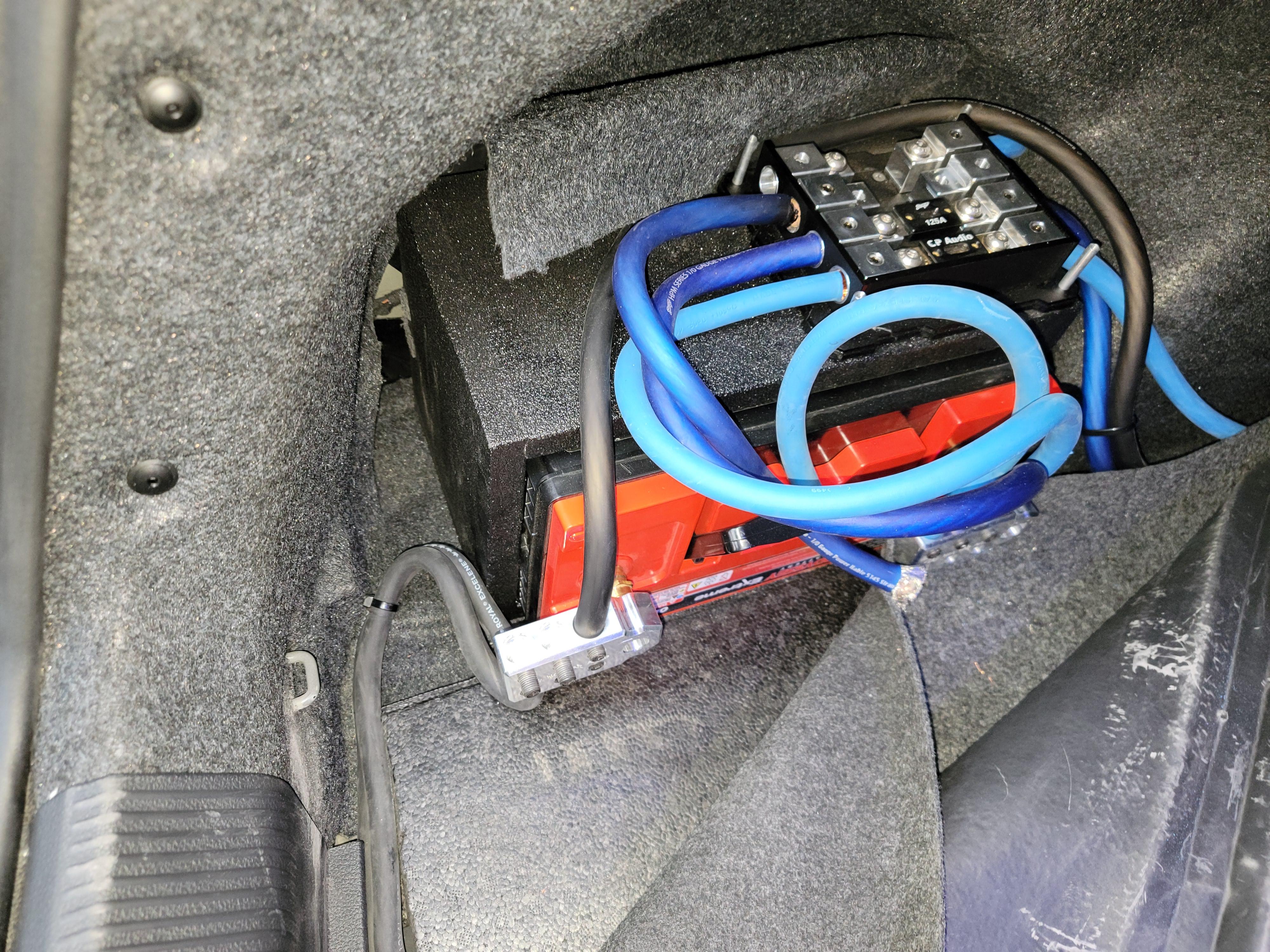

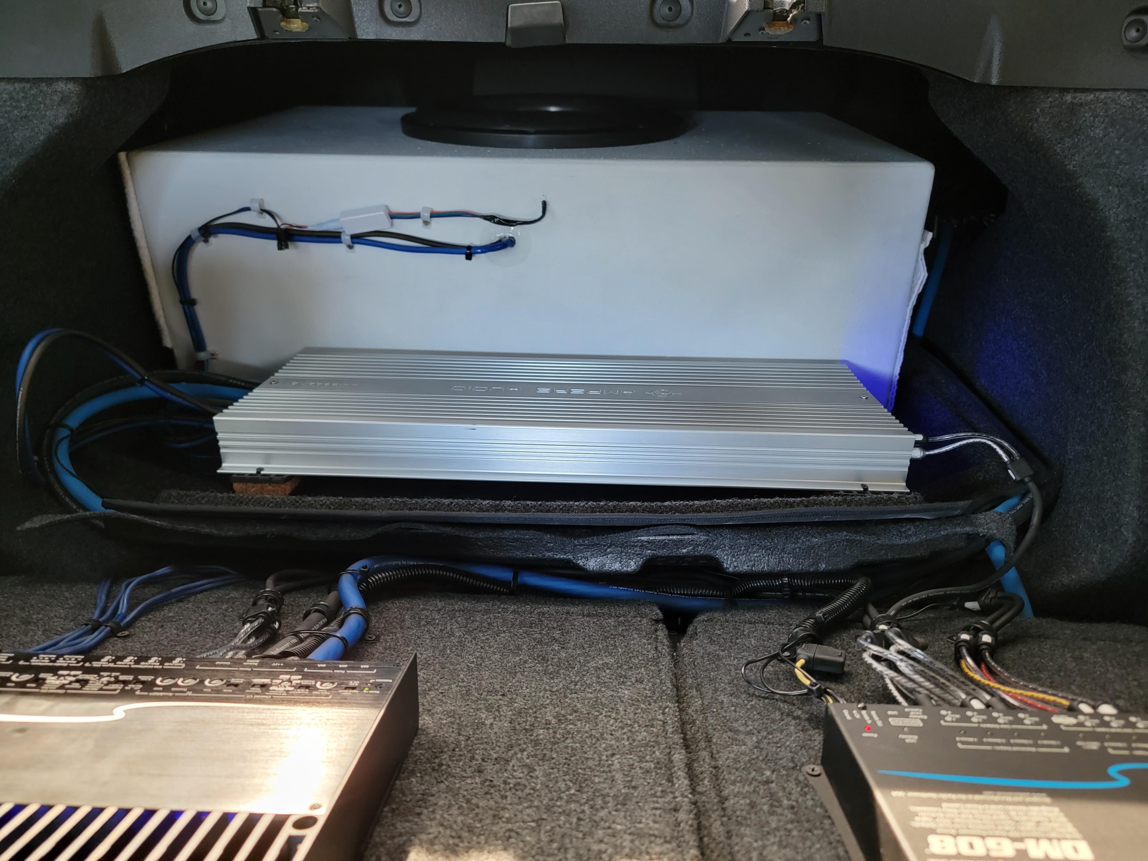

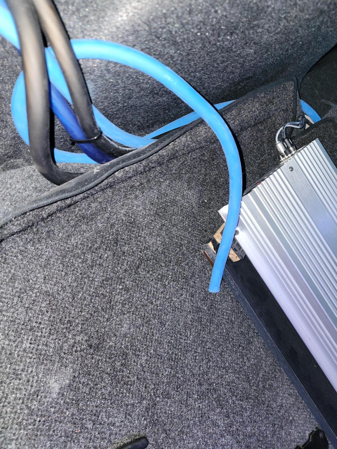

March 22, 20224 yr Author Got a little work done before this storm and tornado warning came through after work, shortened my ground wires coming from the trunk spare well going to battery terminal a lot. Instead of going around the back of battery, above it and back down the front of it. The wires come straight up to the terminal. I also cut the ground wire for my Audio Control amp as well and wired that on that last connection underneath the negative battery terminal. The only ground wire that will be attached on the topside of the negative battery terminal will be for the subwoofer amplifier. I should of done this months ago but I hate working on the car in the cold. There will be no ground wires coming across the top of the battery box. Looks so much better already and I'm no where near finished. Before picture first and after pictures will follow. Edited March 22, 20224 yr by jcarter1885

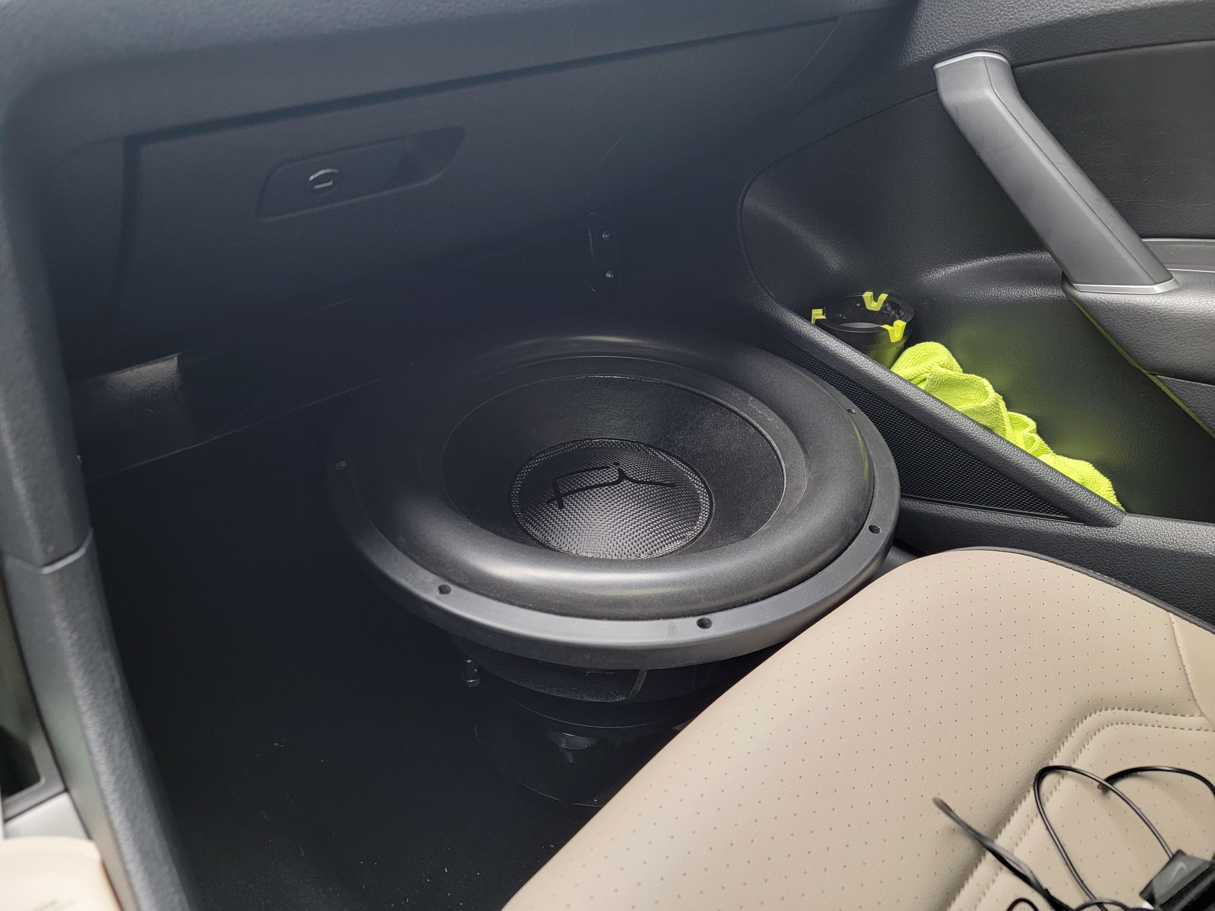

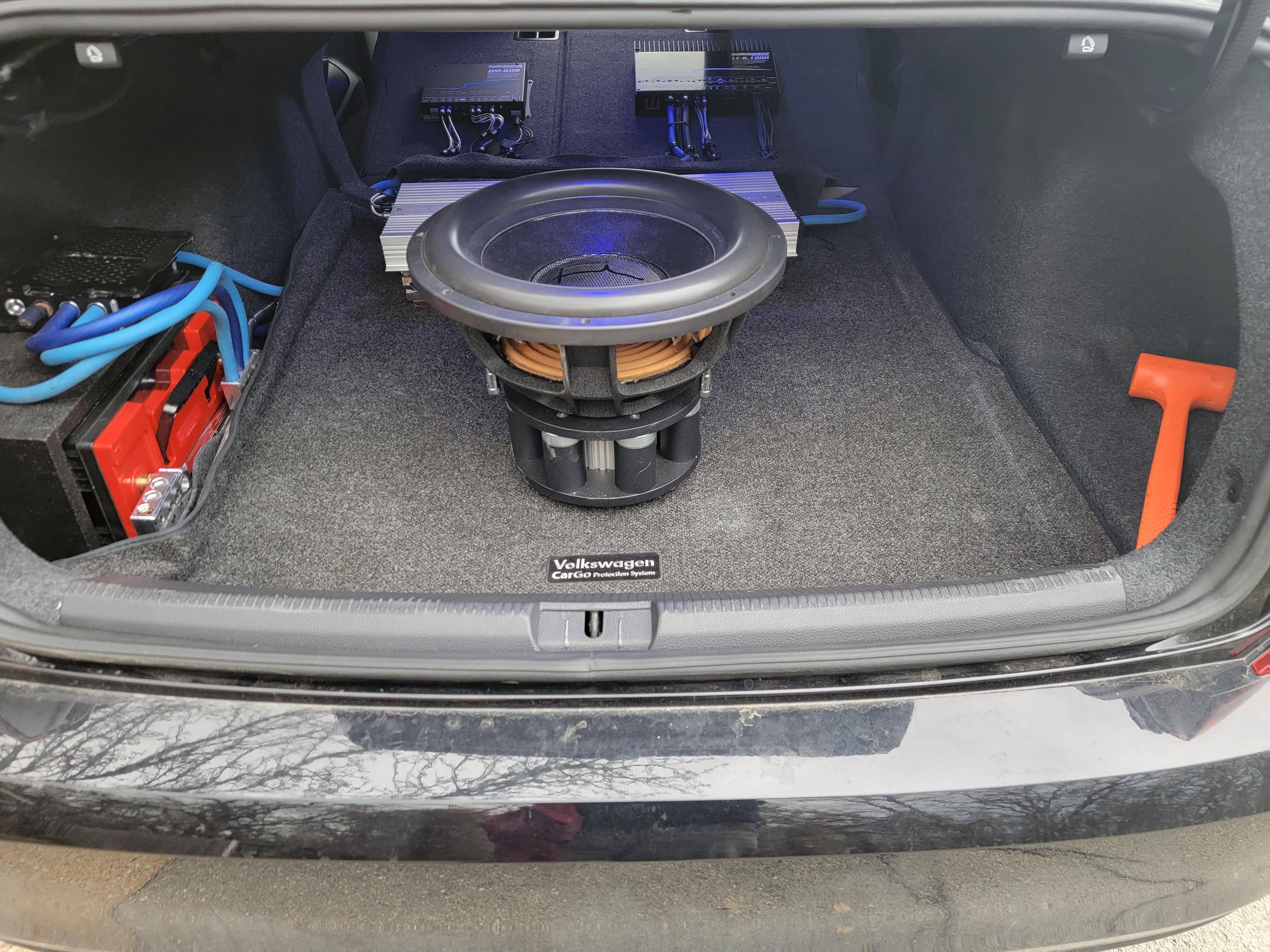

March 22, 20224 yr Author Don't worry, no subwoofers were hurt during transport. Sheesh when your tweeter is bigger than your subwoofer. Edited March 22, 20224 yr by jcarter1885

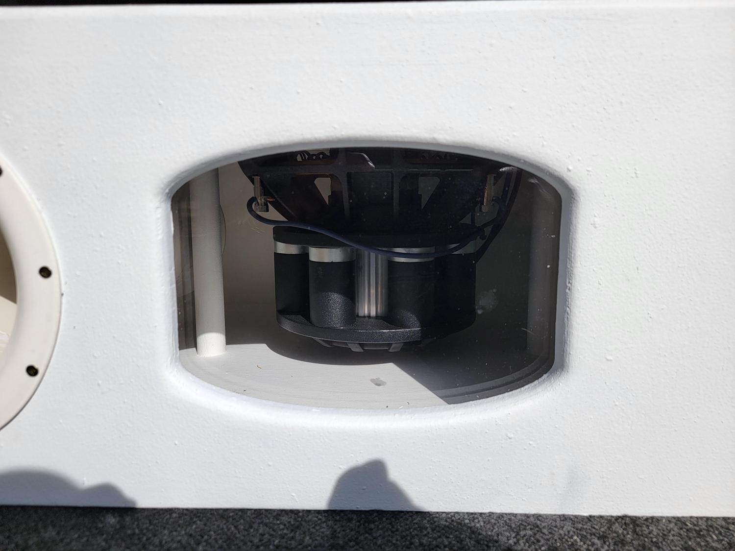

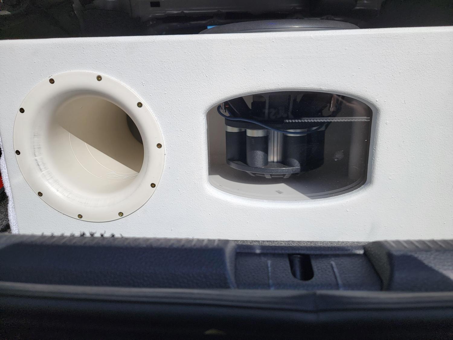

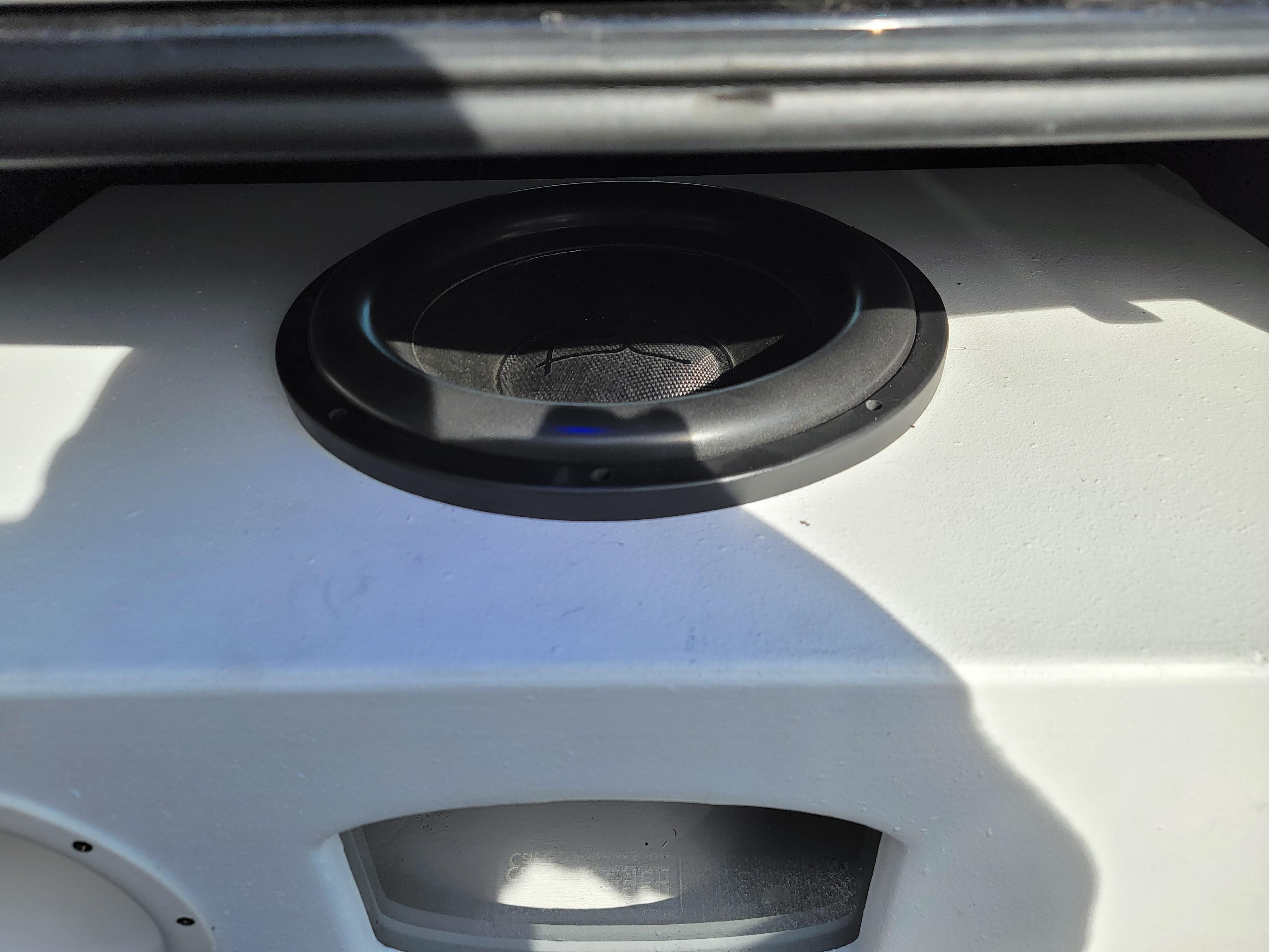

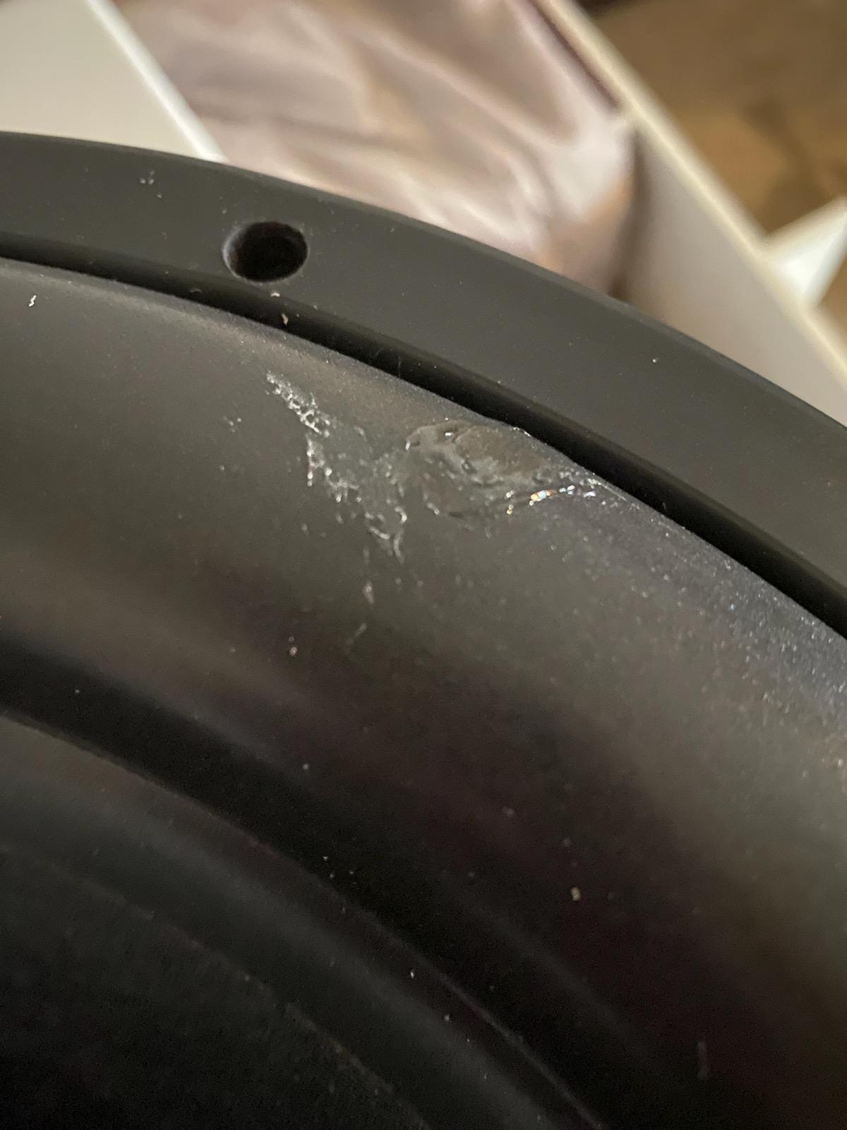

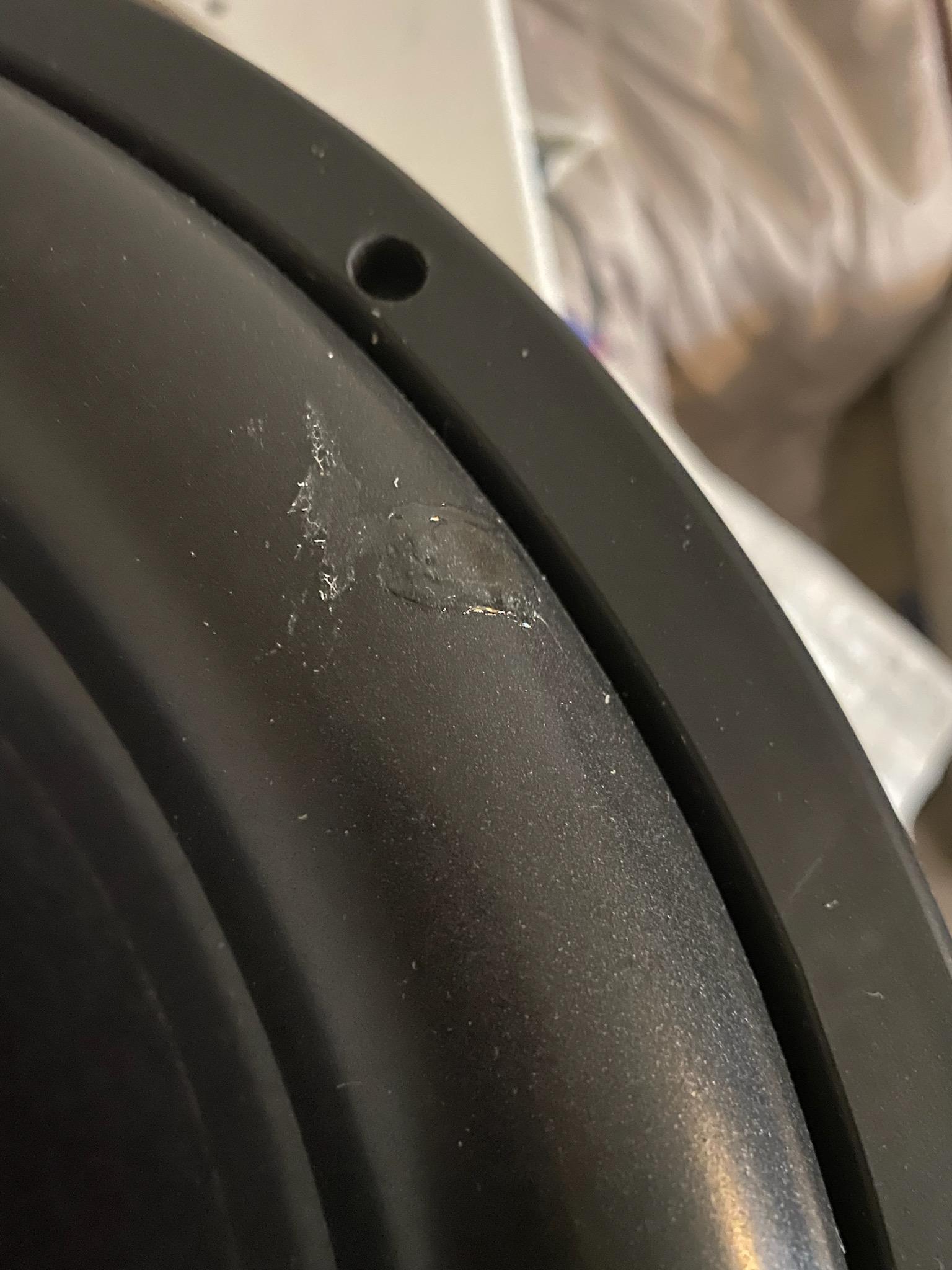

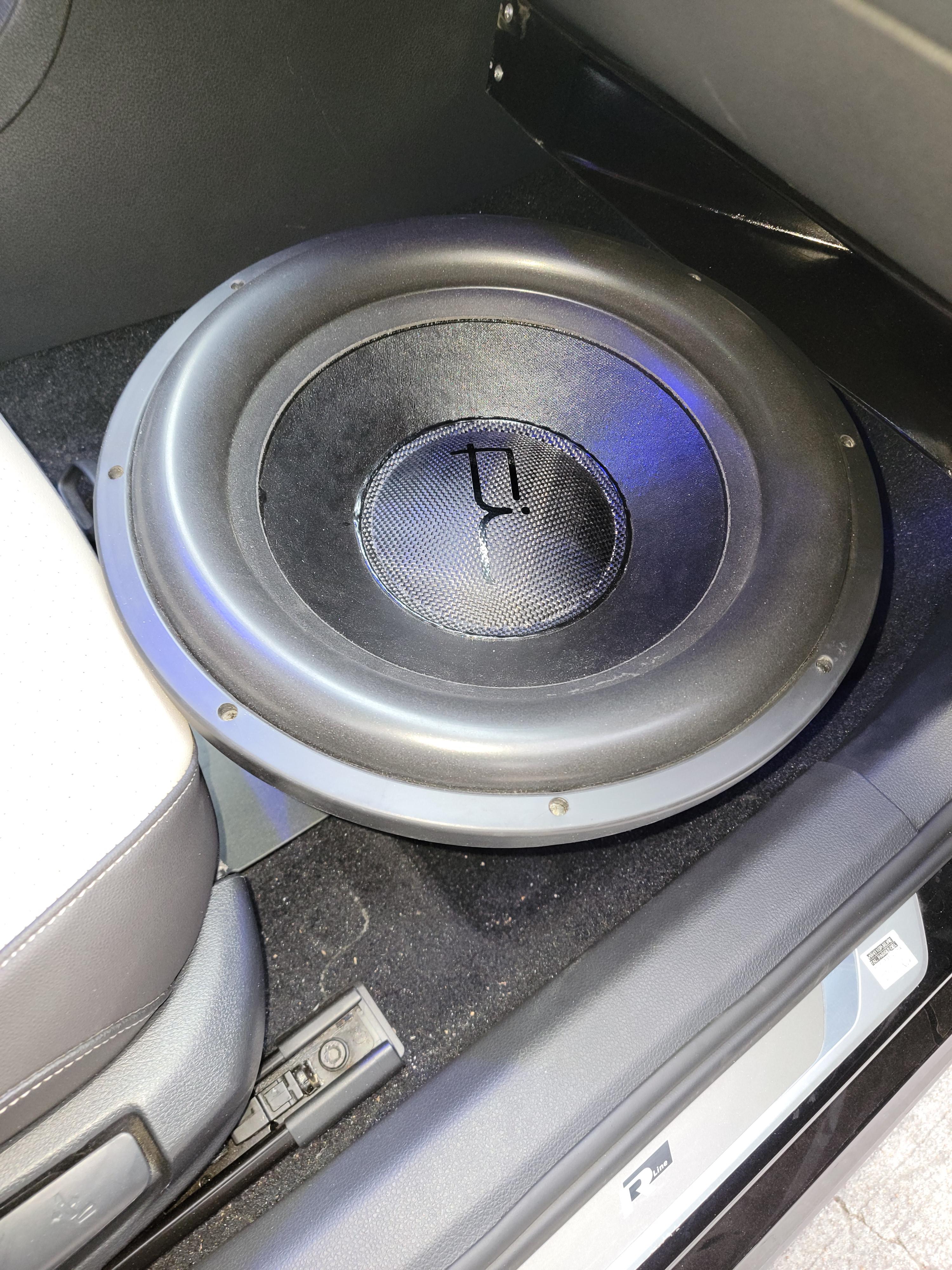

March 27, 20224 yr Author So for the first time in forever I fucked up, but it's ok y'all can flame me. I was rushing and excited, I also tried new screws but at the end of the day it was all my fault. Little drill slippage that I fixed with amazing good, put it on the underside and top of surround as well. Luckily it dries clear and the location of the hole in the surround when the sub is mounted, is at the back of the box so you cant see it anyway. Like Dae Dae said in next Friday, Playas Fuck Up! Haha

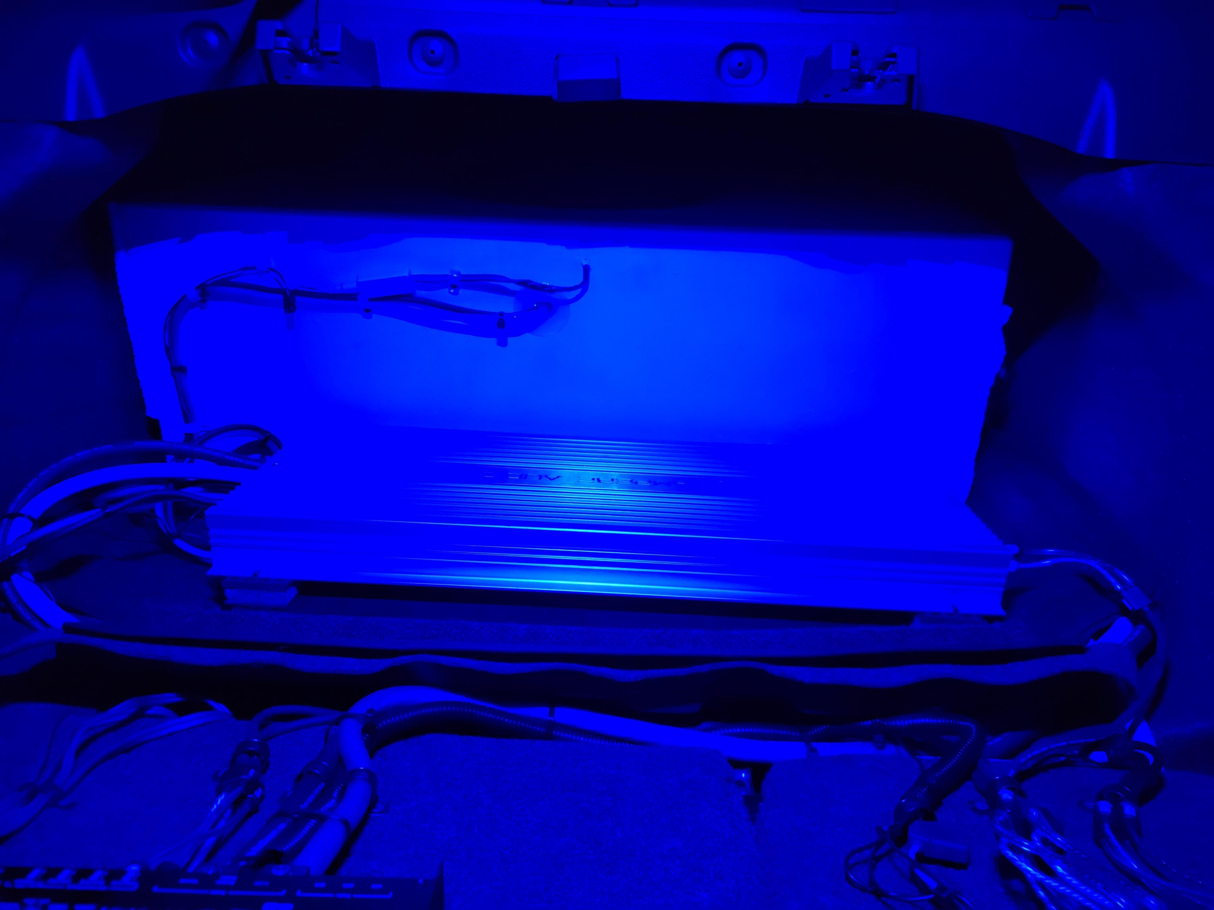

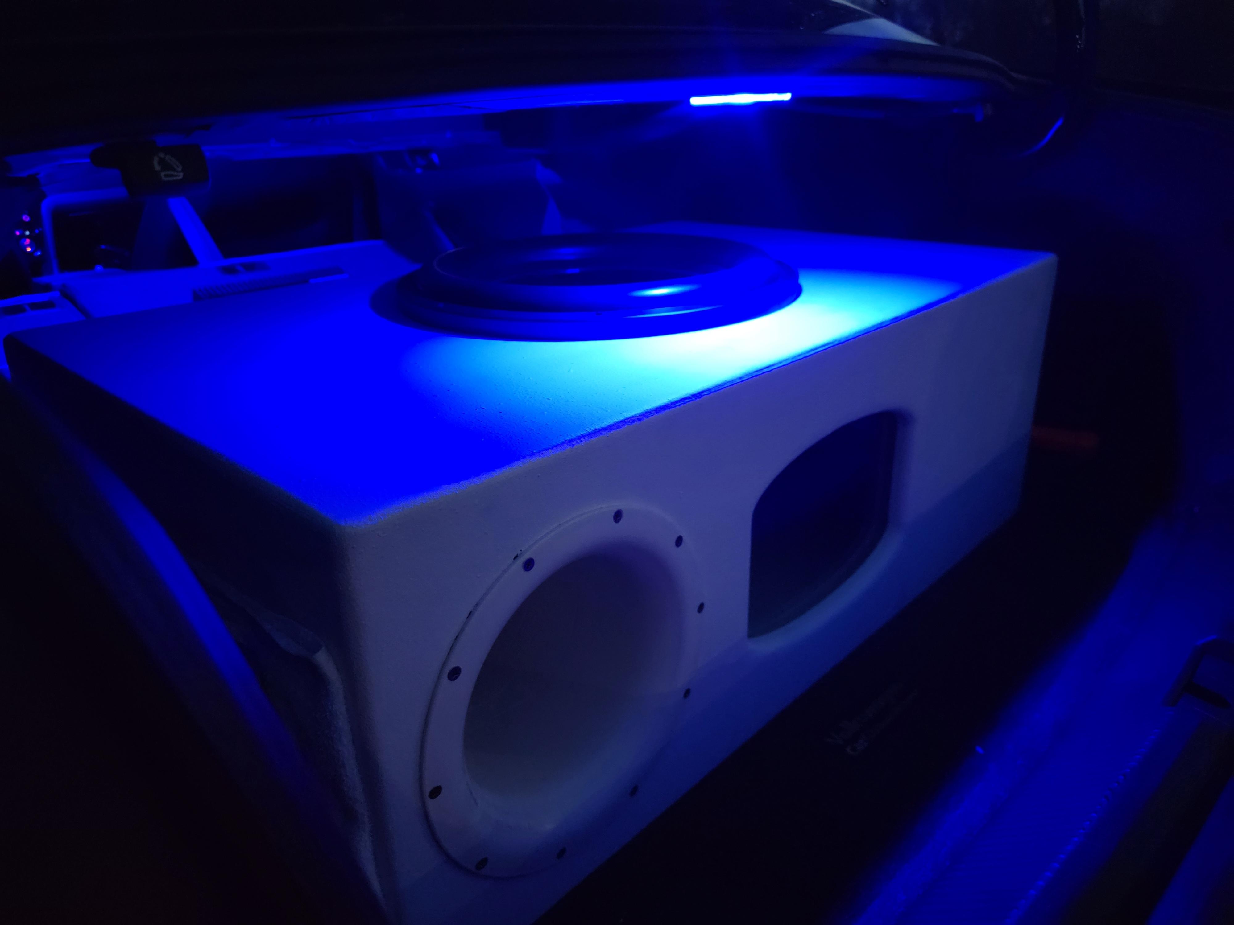

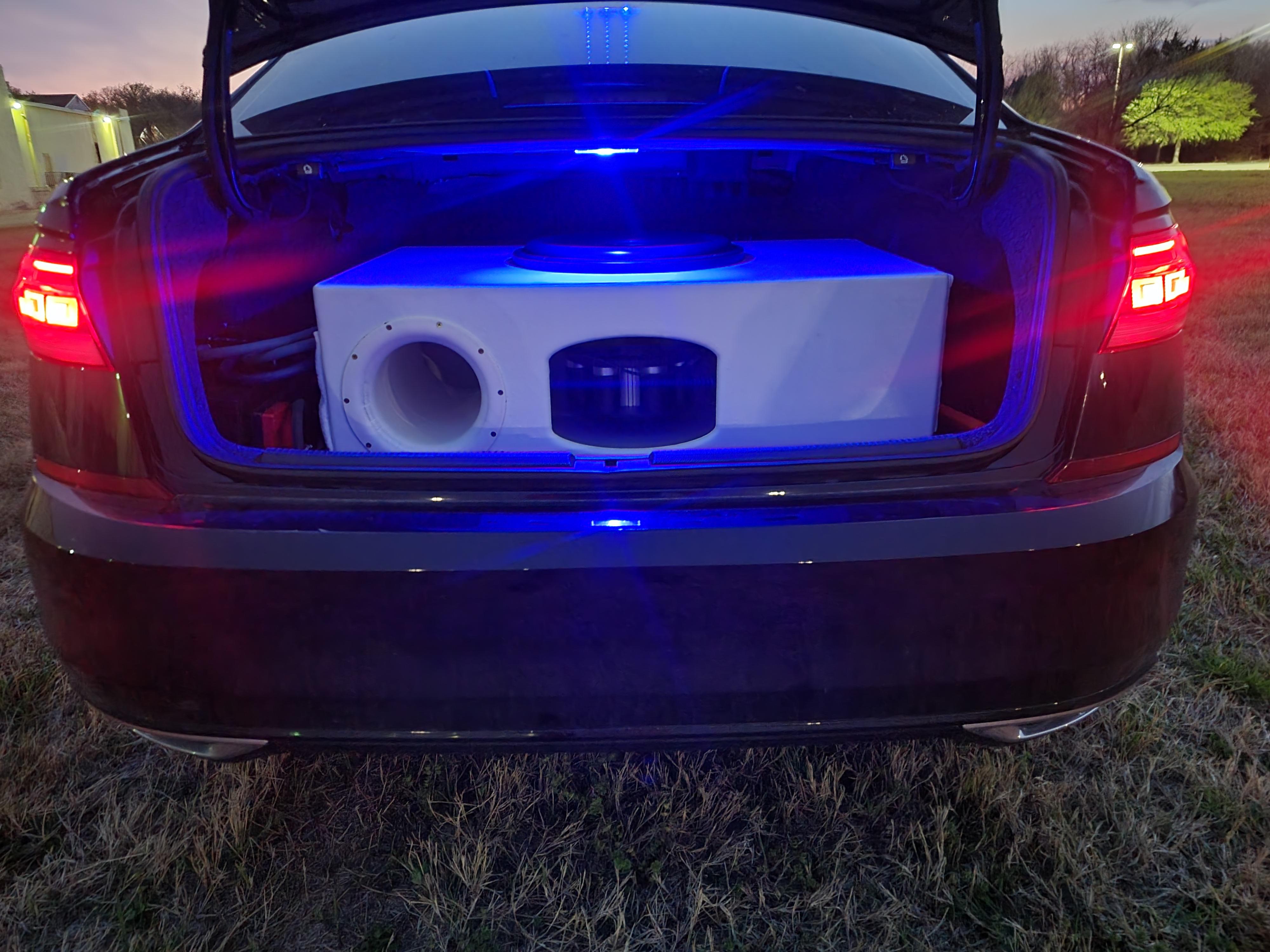

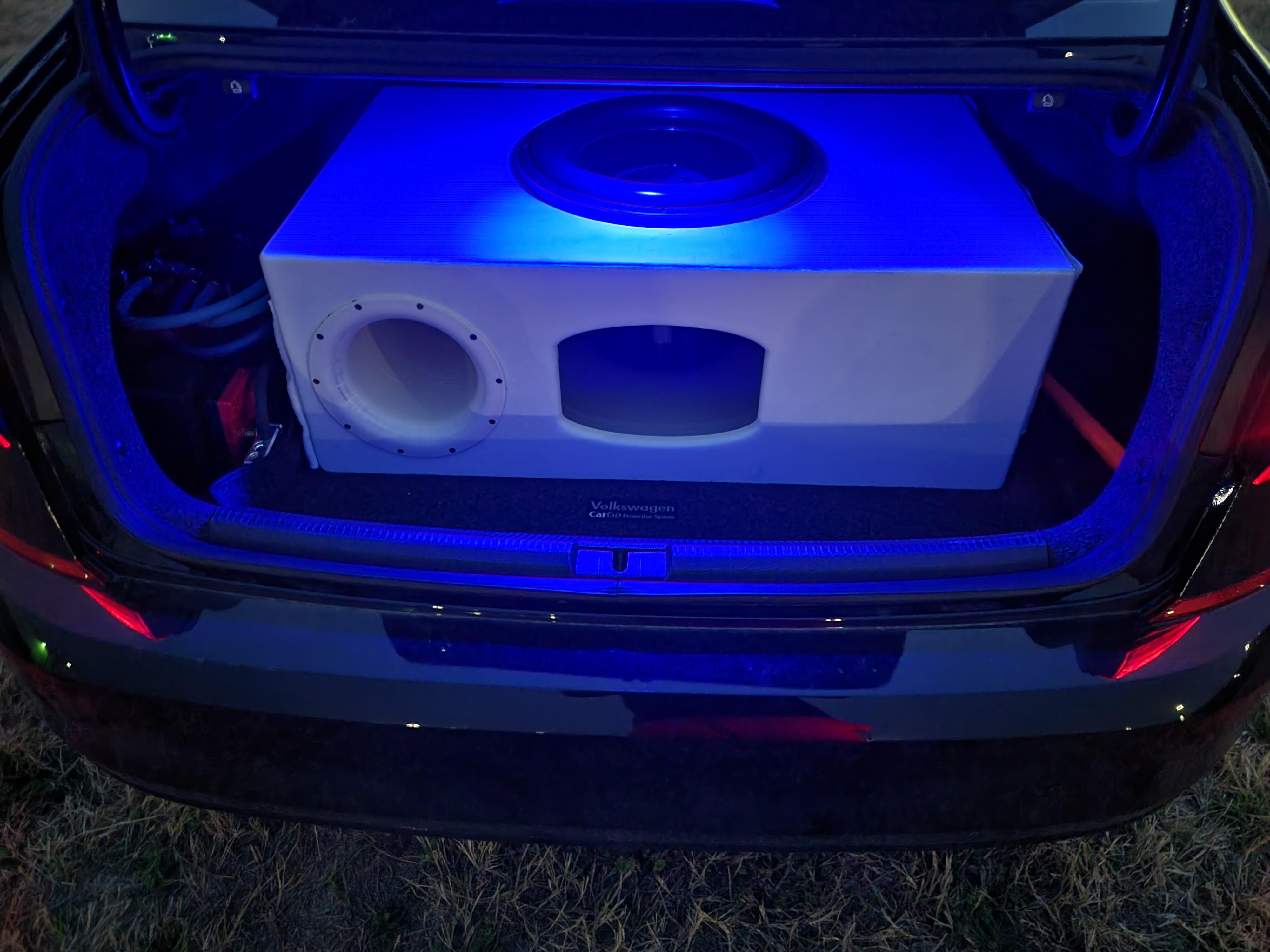

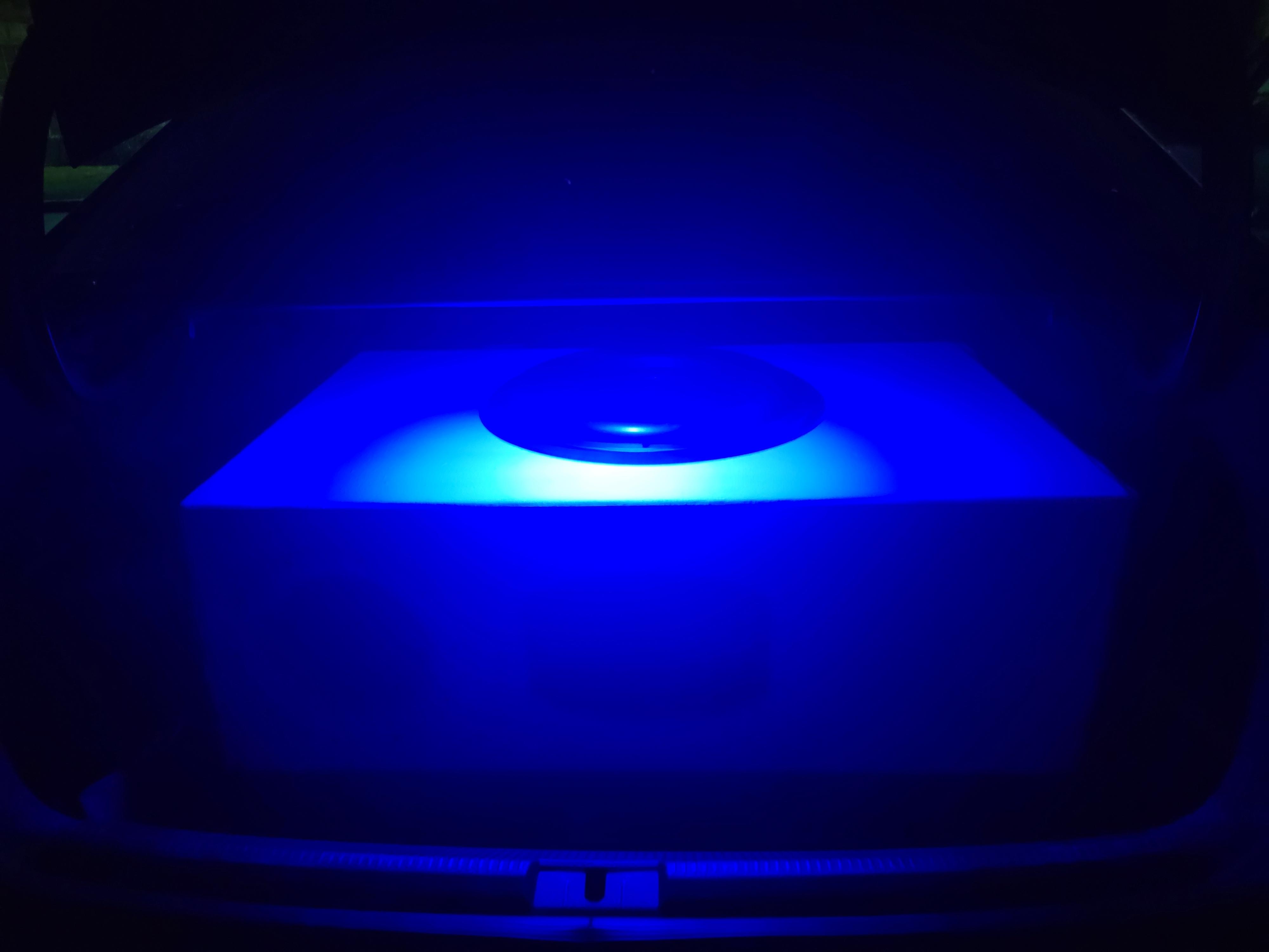

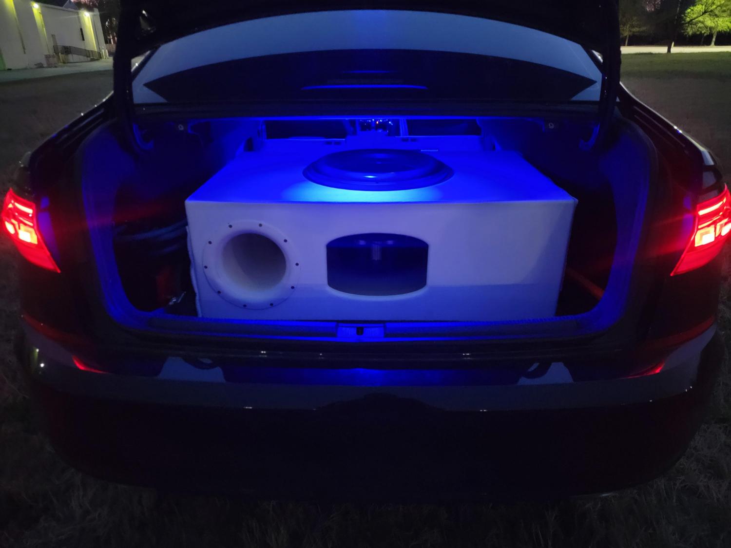

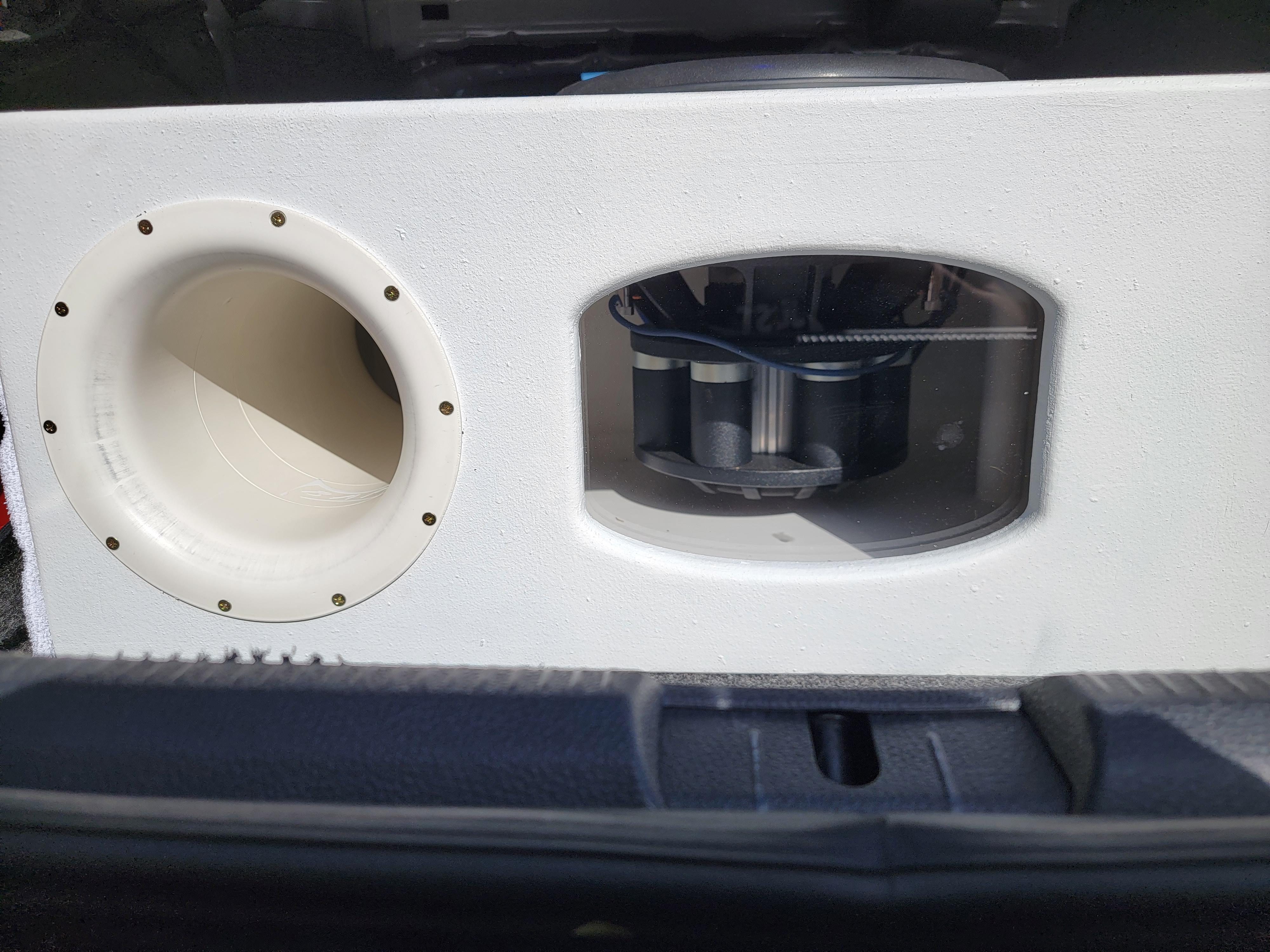

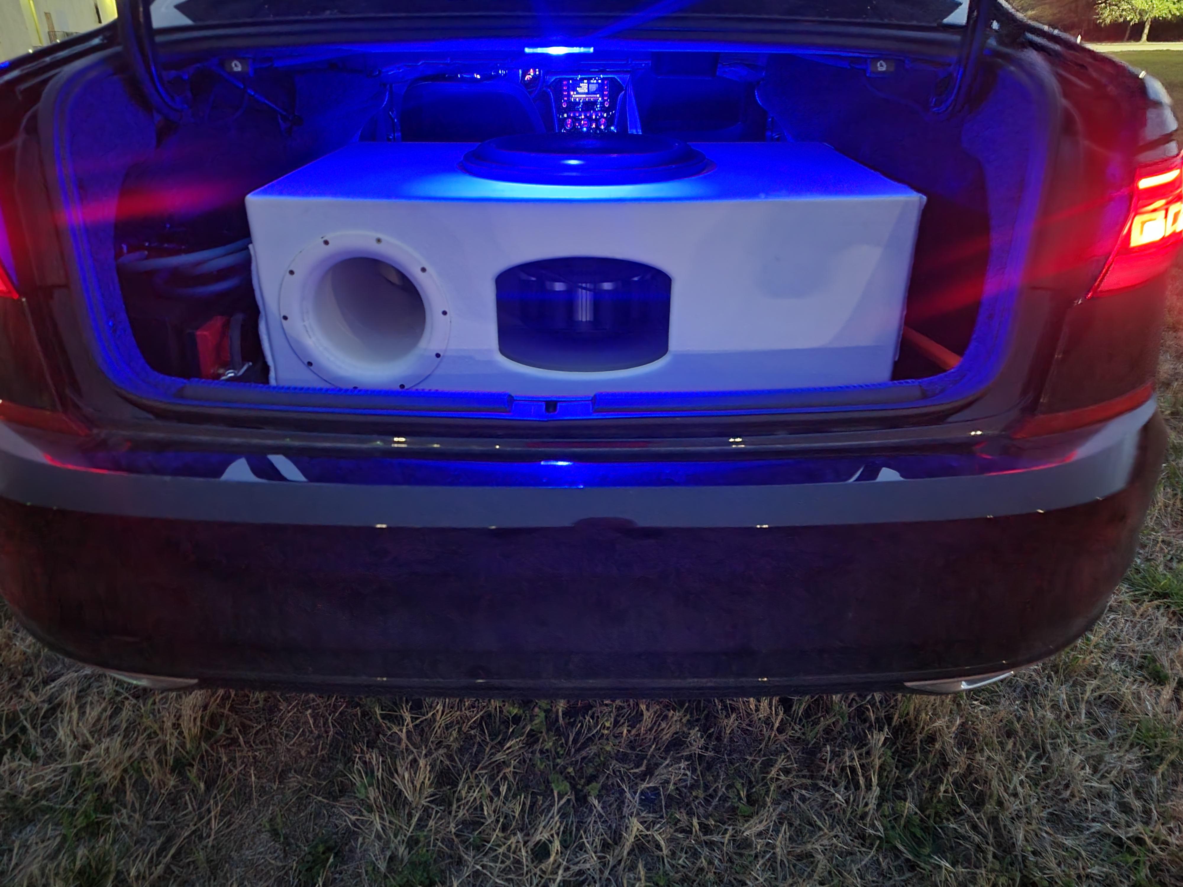

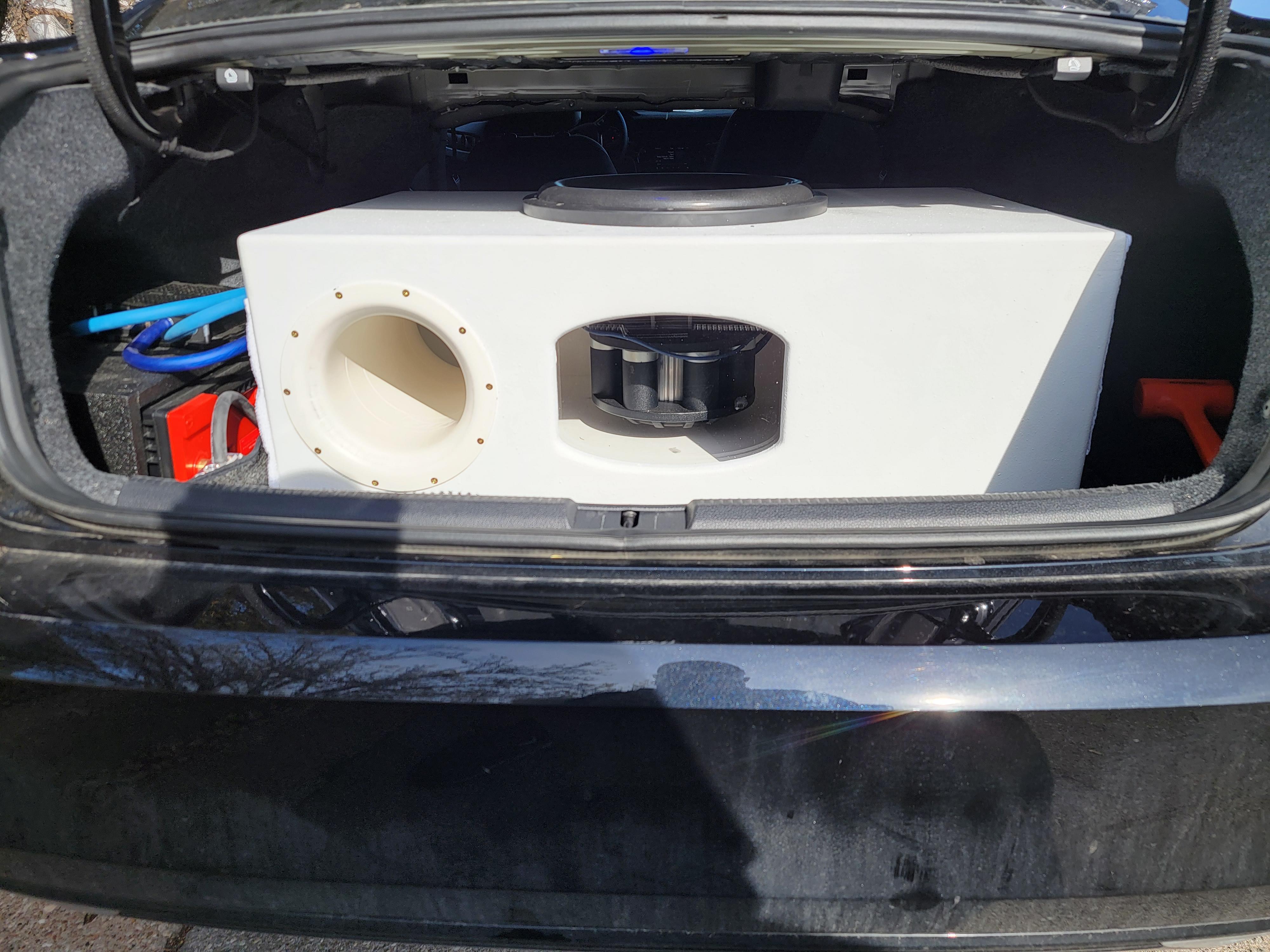

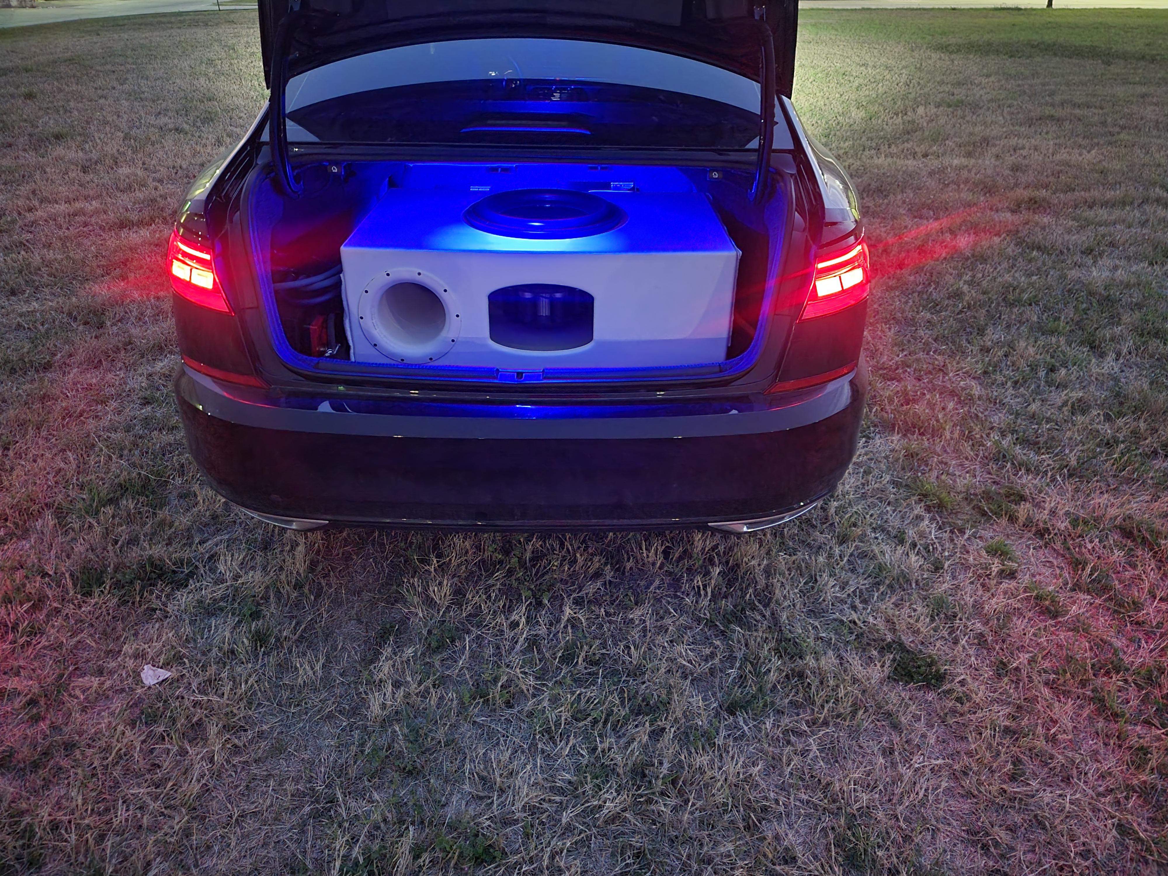

March 27, 20224 yr Author This enclosure turned out perfect, I cant wait till night time and I turn on the blue light to see how it all plays out.

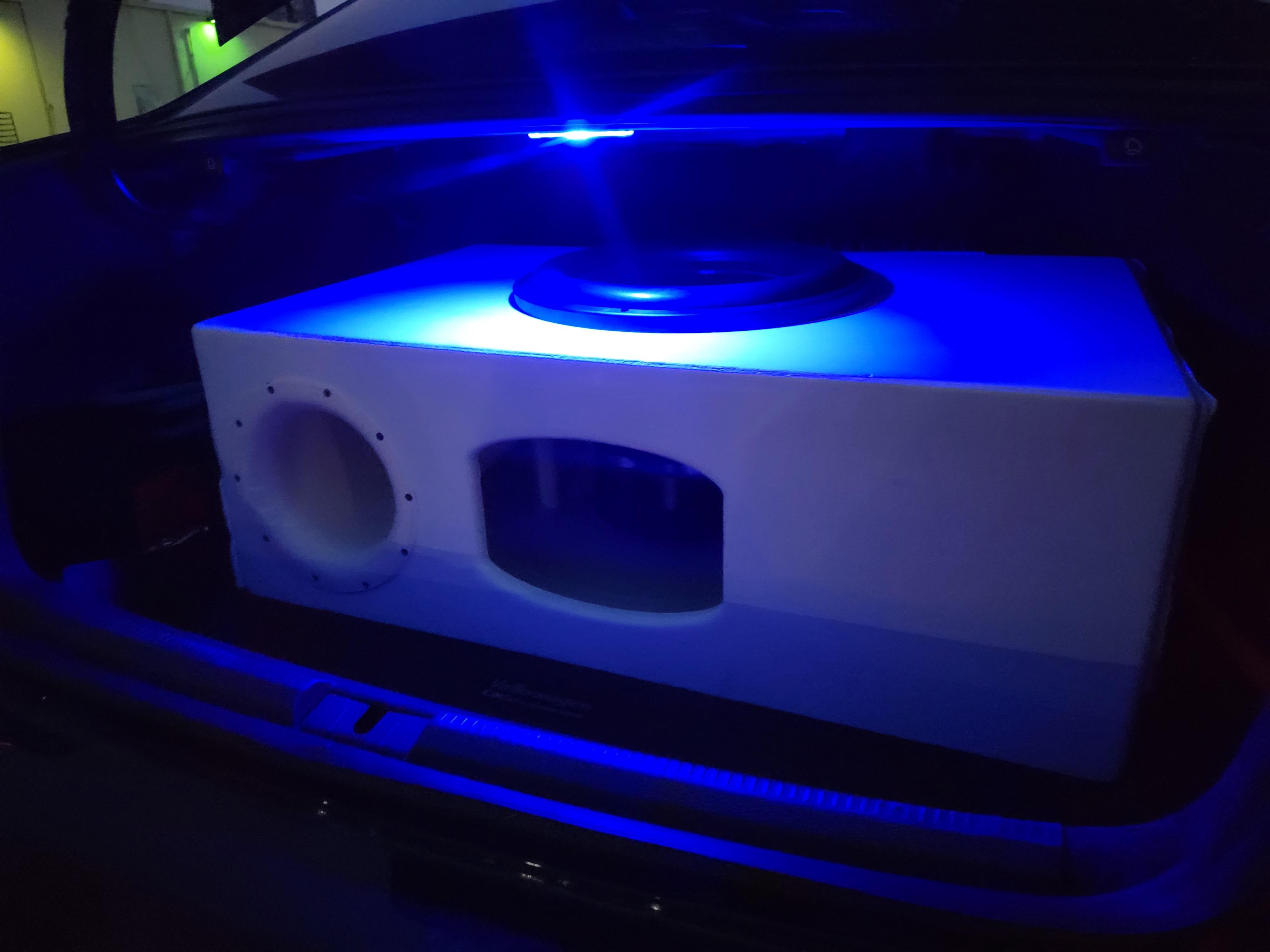

March 28, 20224 yr Author It all started with a vision, then once it's executed you realize that it's way more dope in person. Edited March 28, 20224 yr by jcarter1885

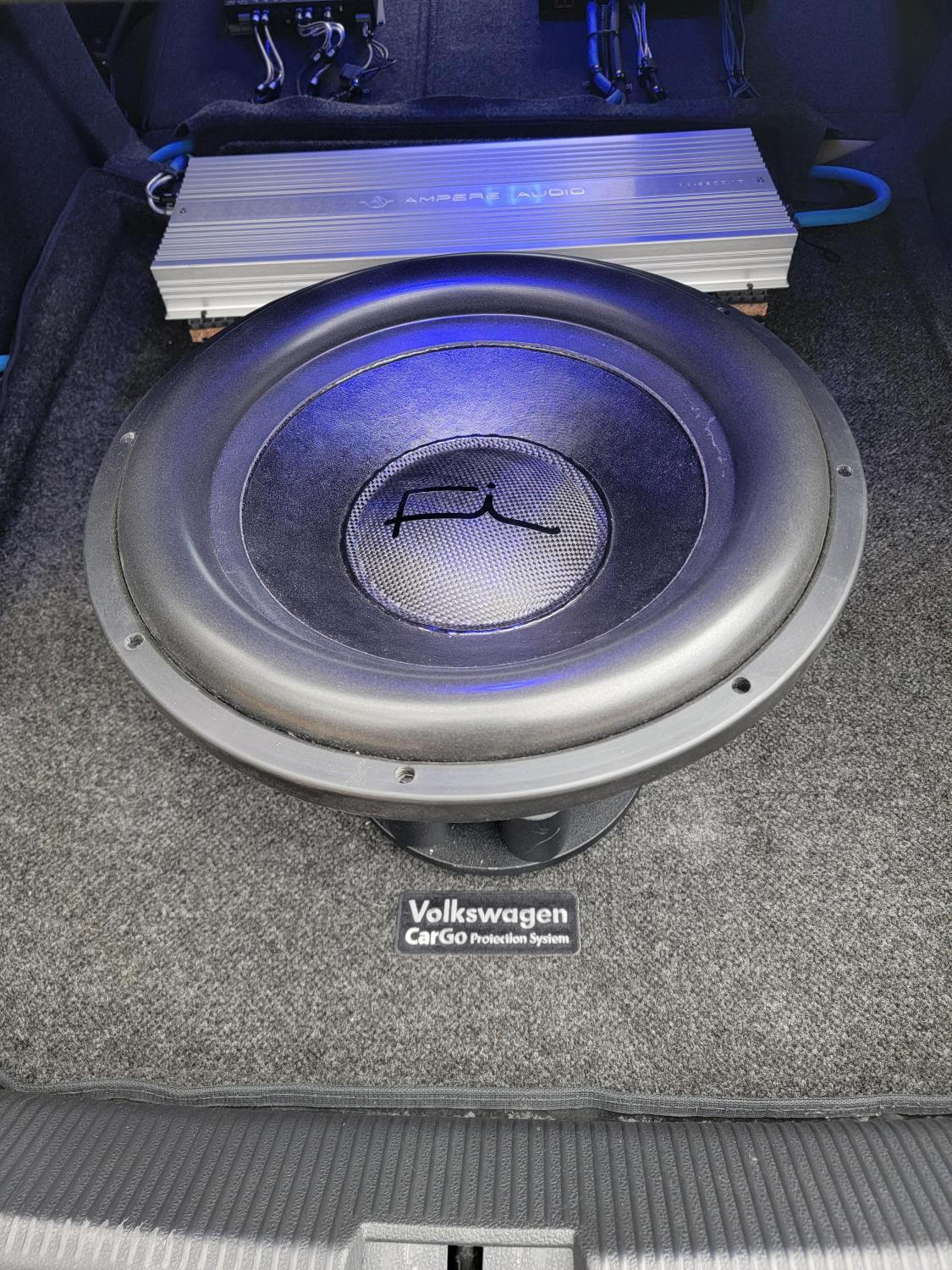

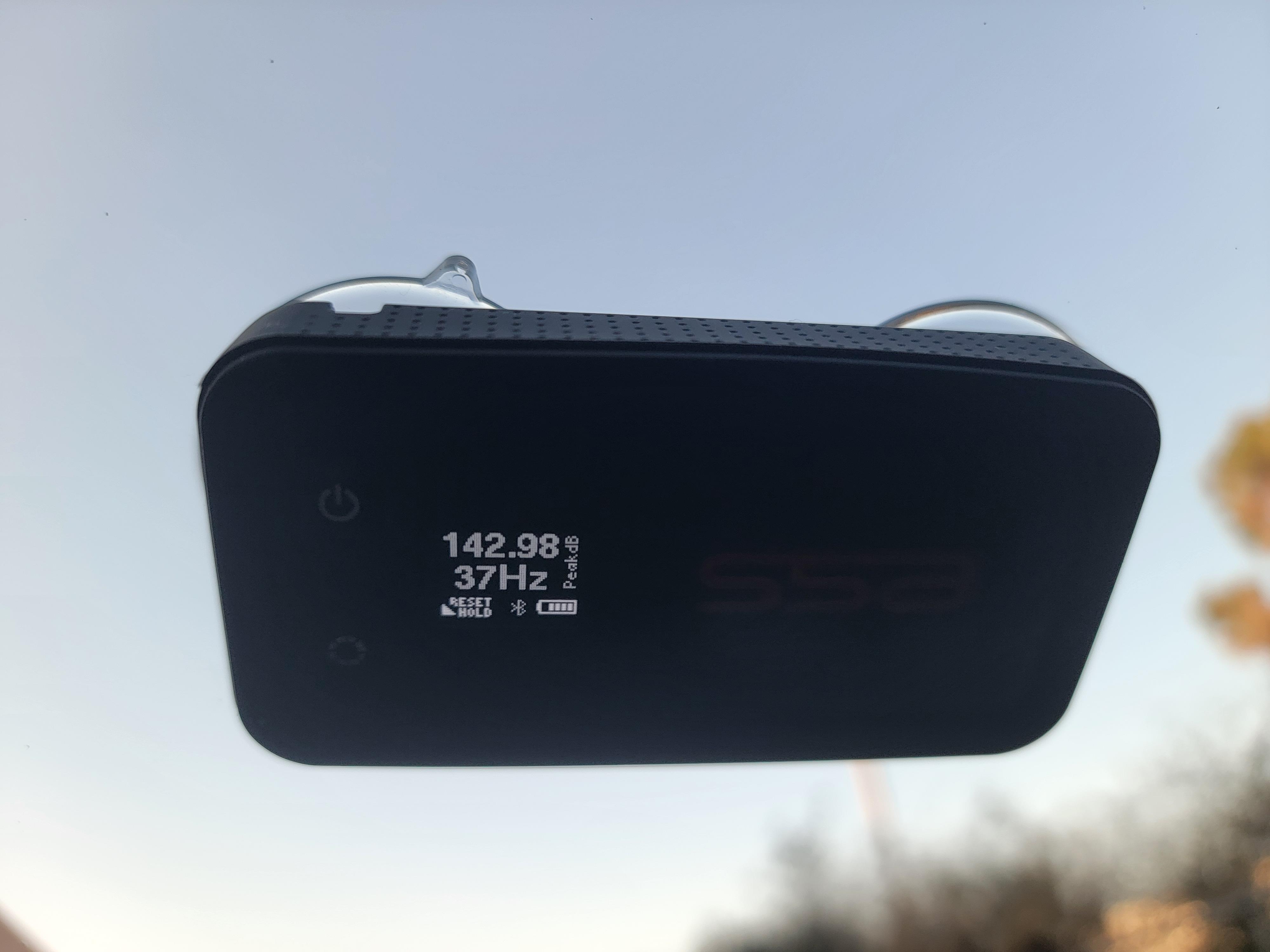

March 28, 20224 yr Author New high score even with lower voltage since it's warmer outside and my car charges at a lower voltage depending on the heat.

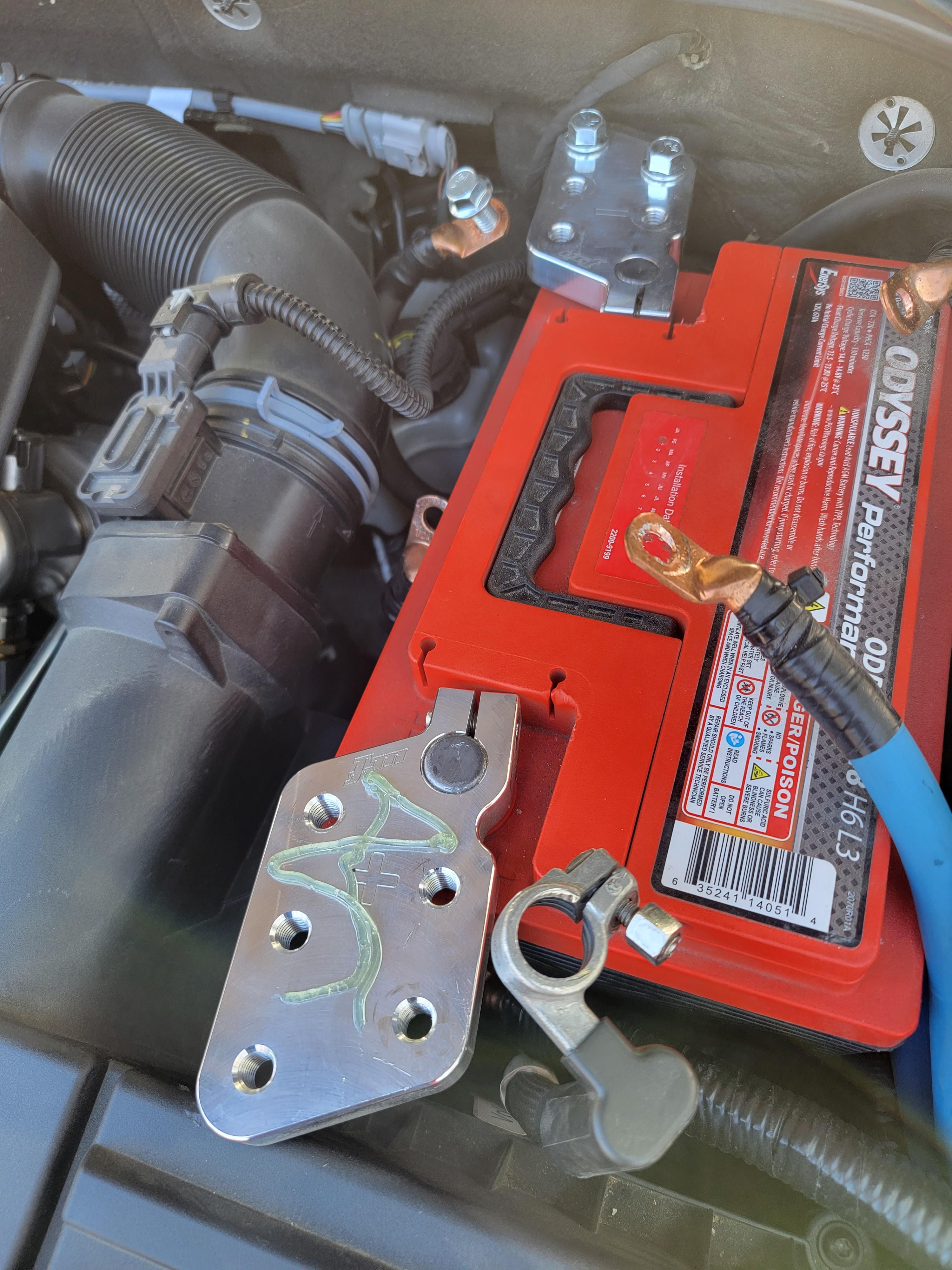

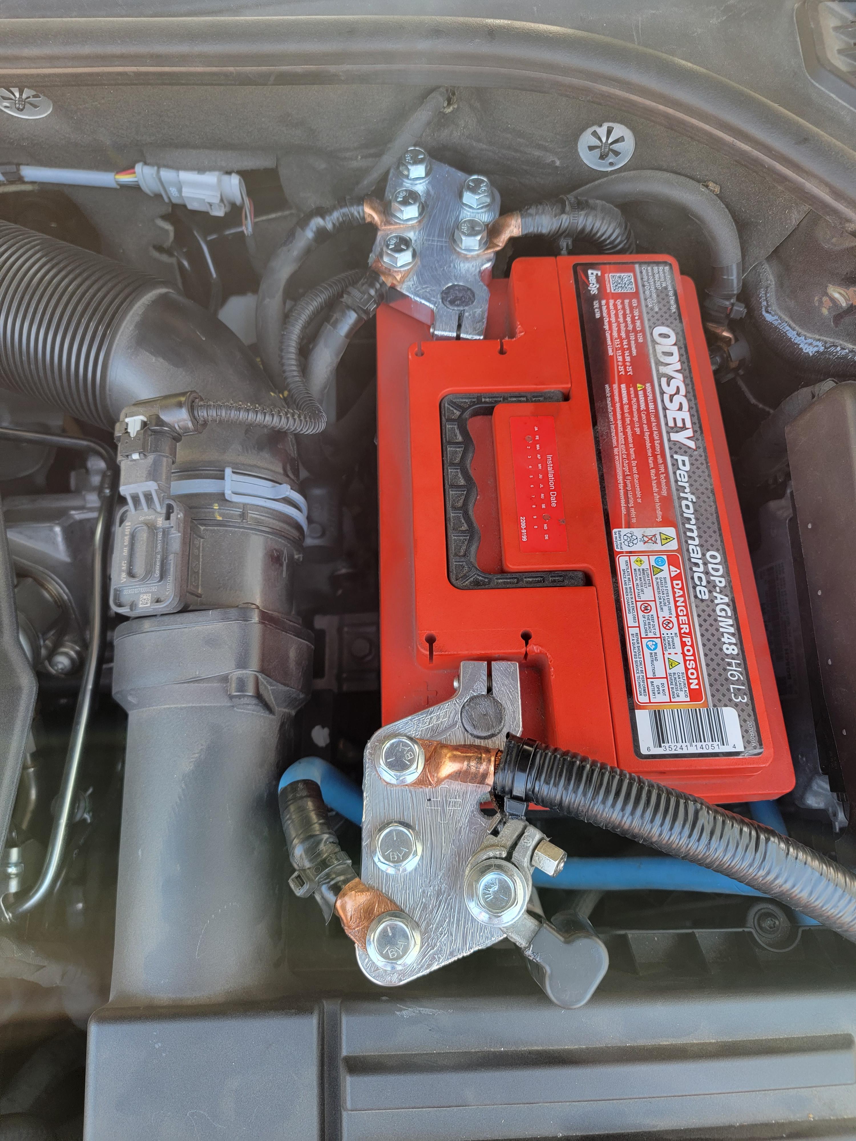

April 2, 20224 yr Author I finally got around to adding some dielectric grease to the front battery terminals. I also added my power wire for my alternator and I should be ordering my H/O Alternator here soon.

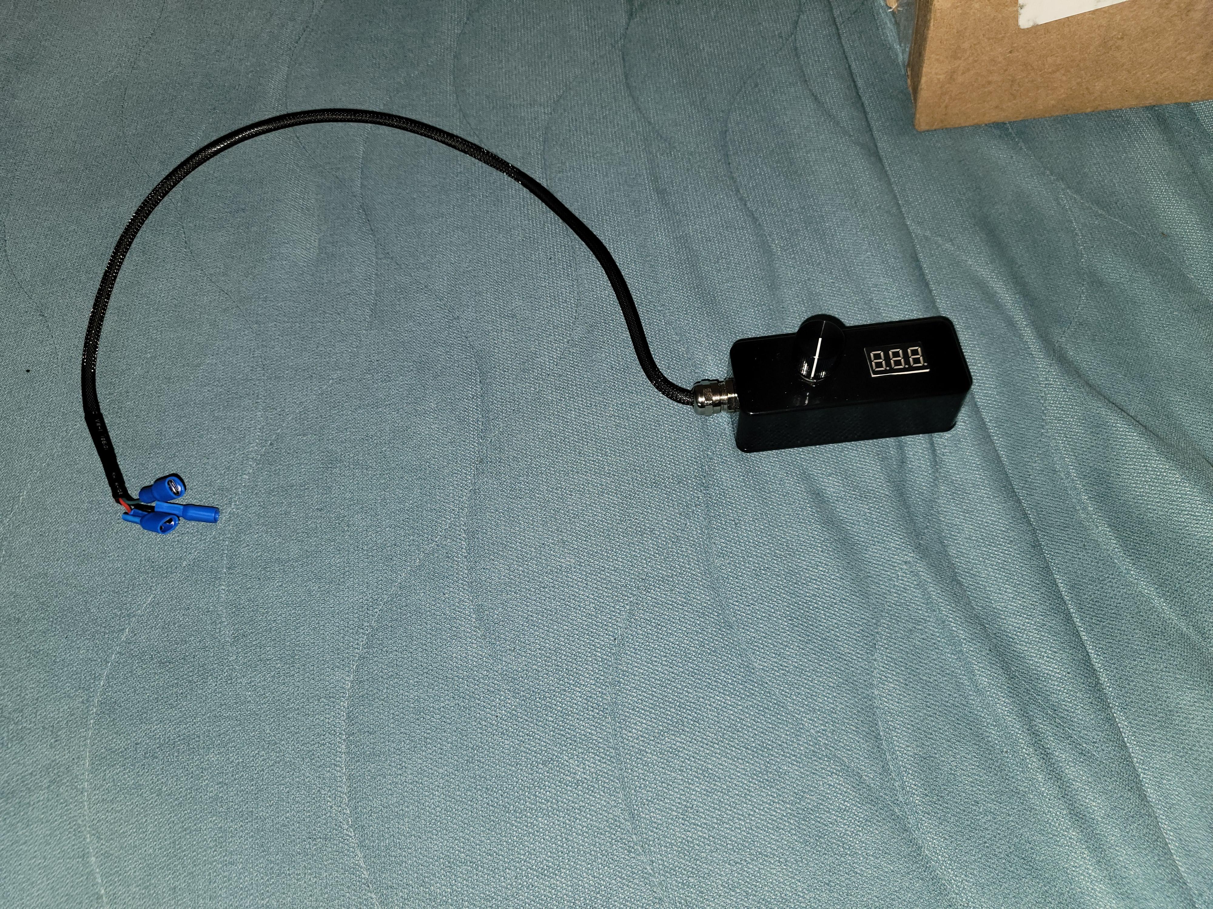

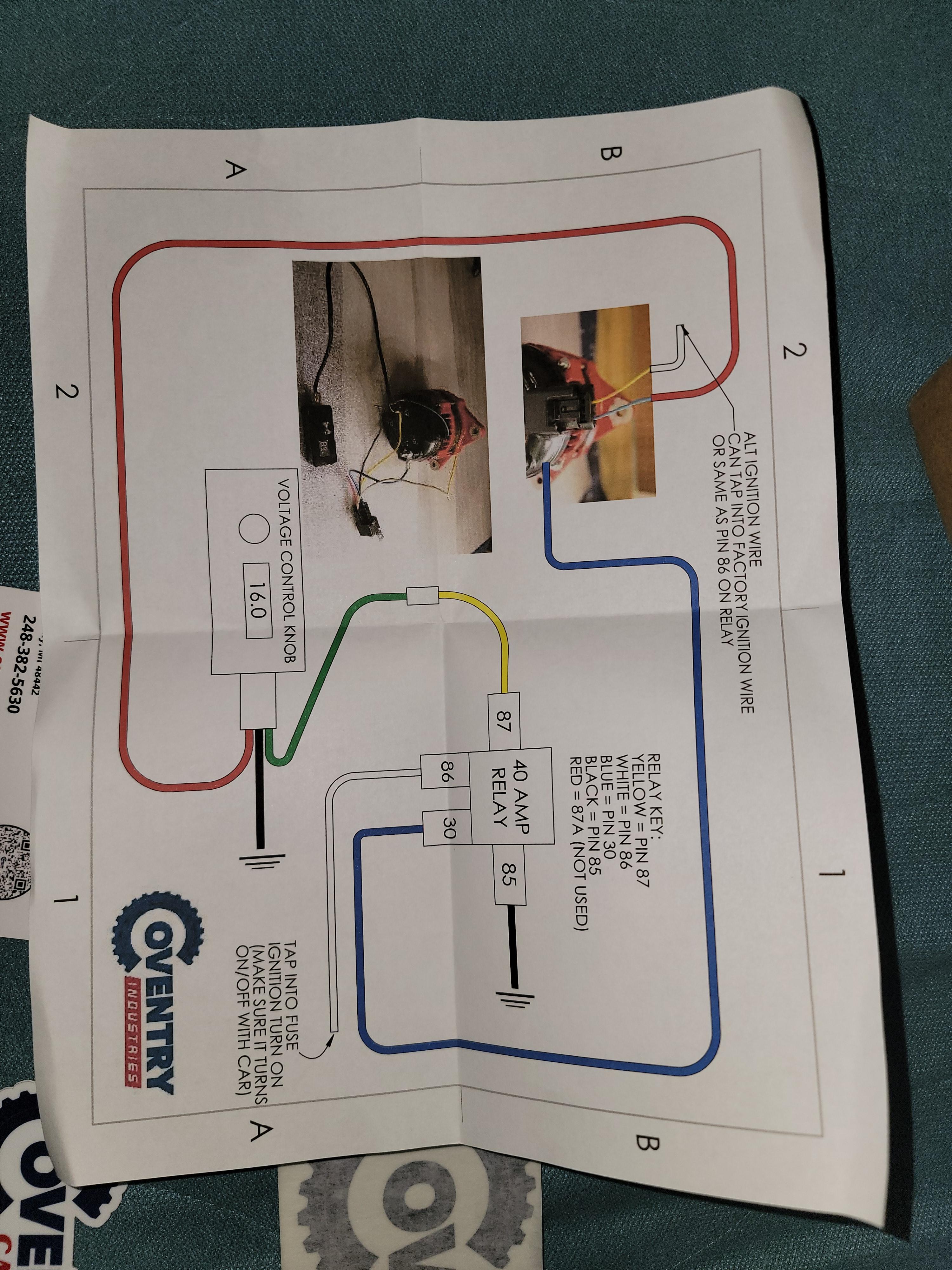

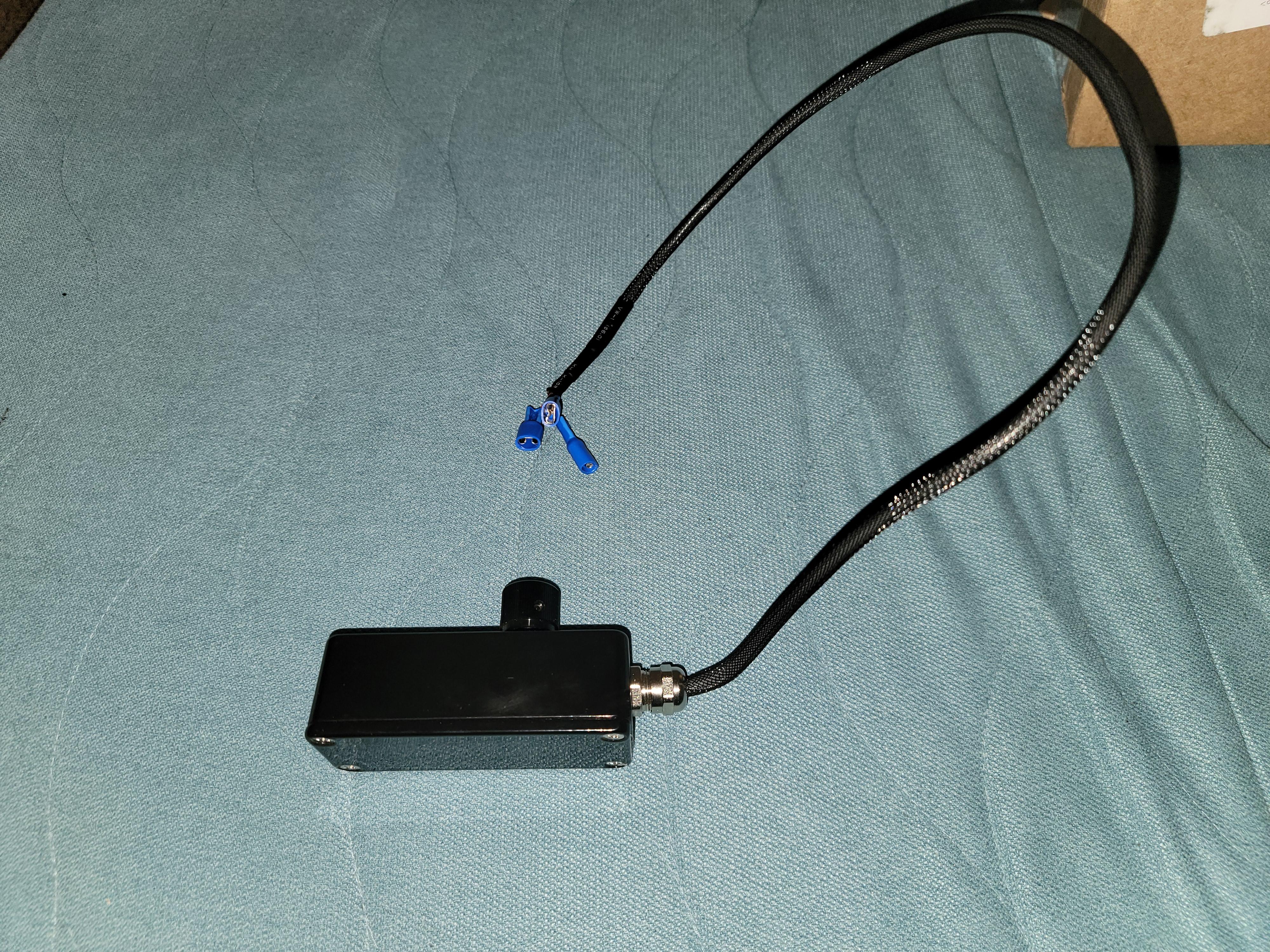

April 2, 20224 yr Author Updates I'm still waiting on Stevens Audio MB-8 2ohm mids to get back in stock then I will send the car to the shop to have them fabricate my Sony 8" H/U in my dash and do my front doors with one pair of 8s in each door. Will be ordering SMD Fuse blocks for under hood positive wires and trunk's positive wires. All connections will be crimped with terminals. I have quotes from Stinger and Brand X for H/O Alternators, just trying to do research to see who to go with. Ive noticed voltage issues from factory as the weather gets warmer and have been following Euro Bass Girl and she gave me some ideas to mitigate that problem. I ordered a voltage regulator controller knob from Conventry Industries that I will install when the new alternator gets here. Edited April 2, 20224 yr by jcarter1885

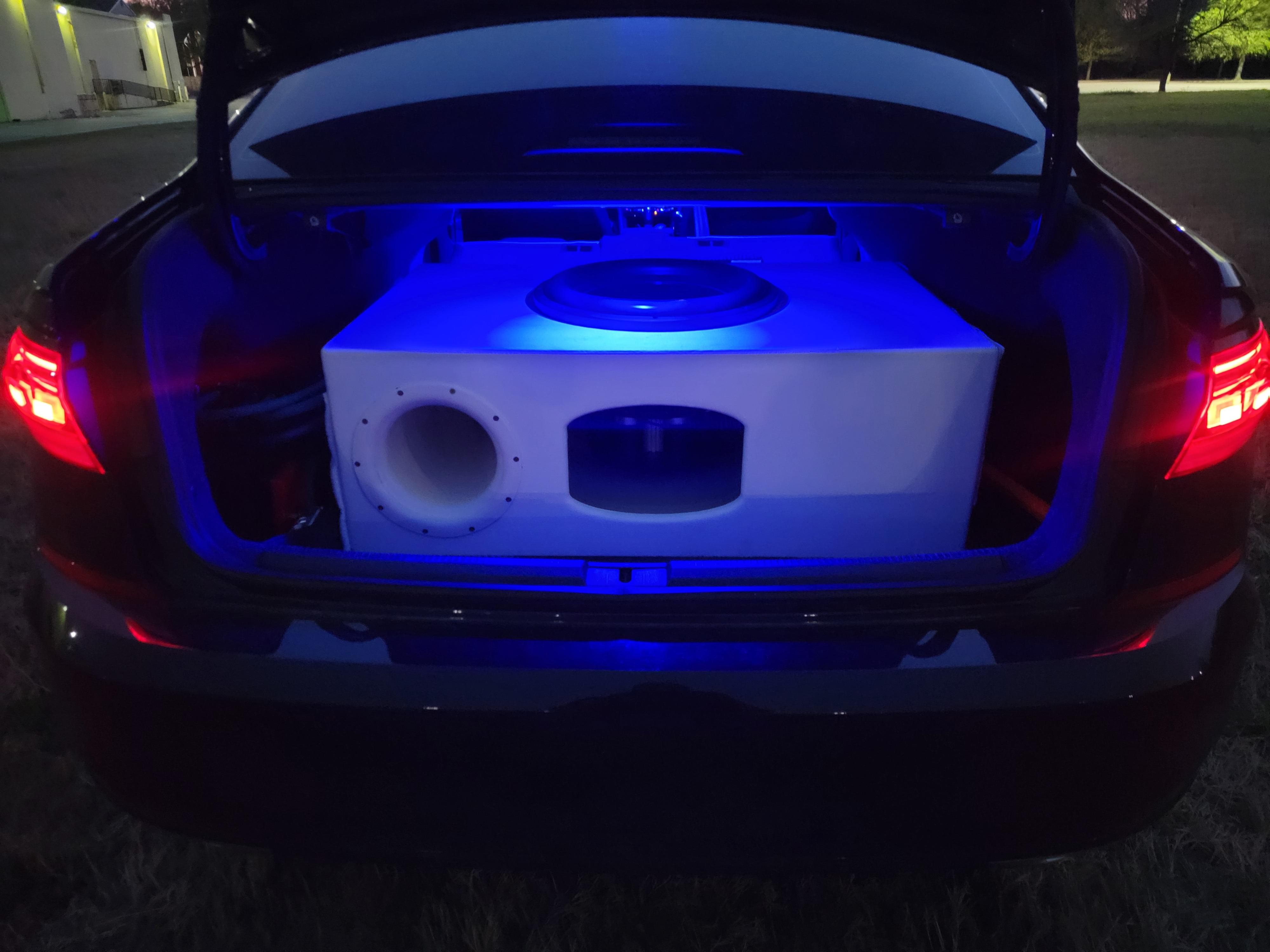

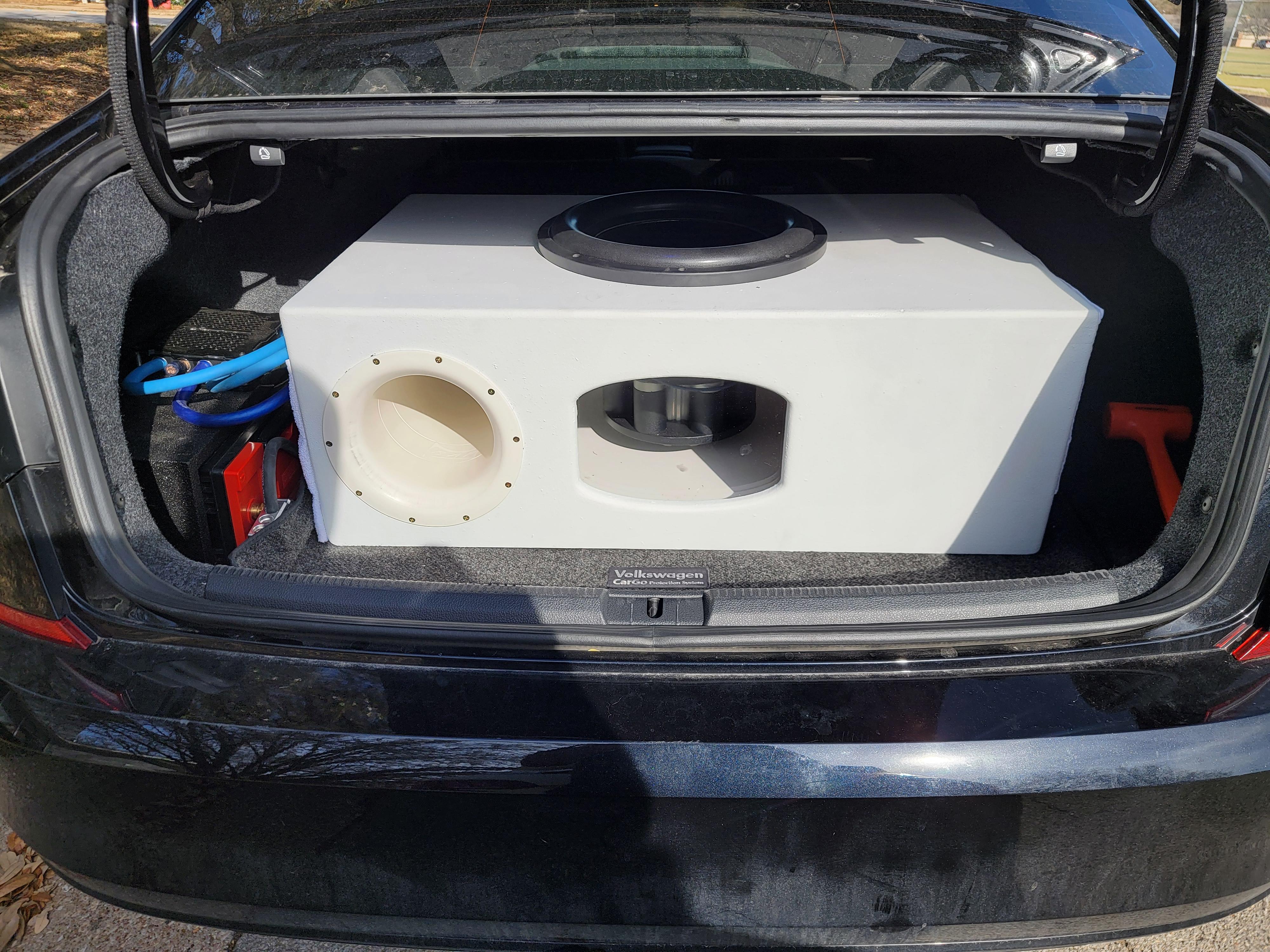

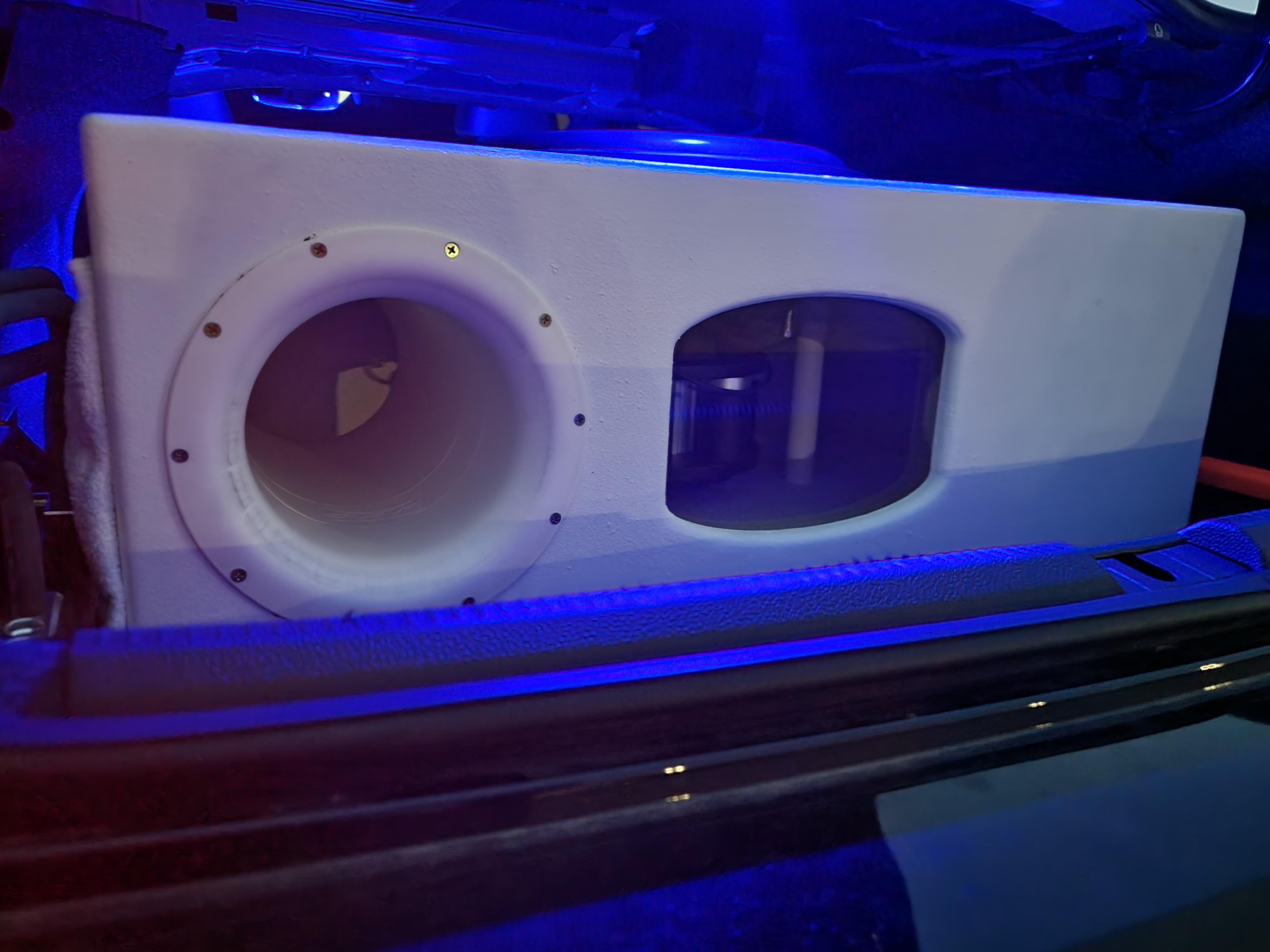

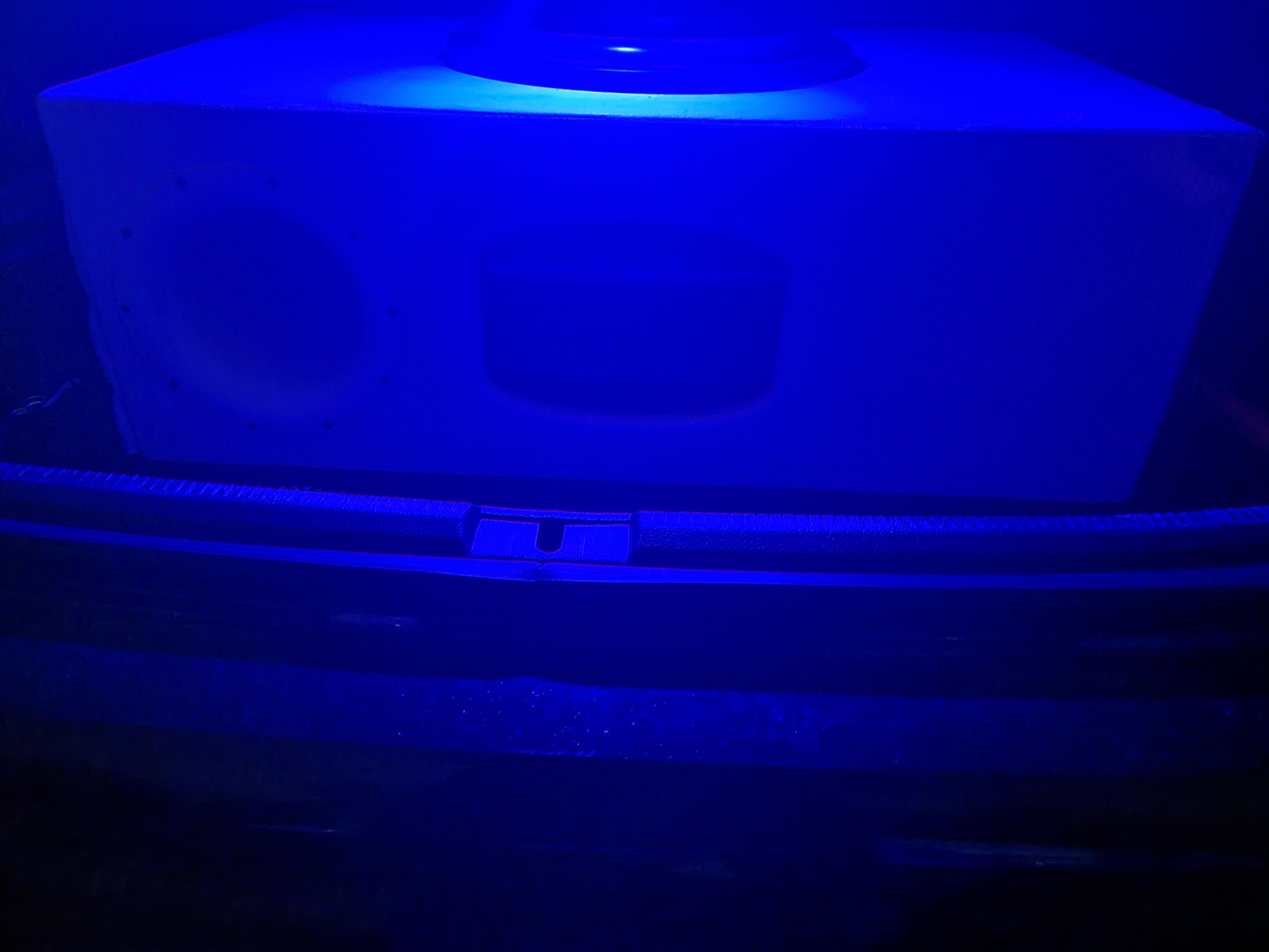

April 2, 20224 yr Author 15 minutes ago, Tirefryr said: DAMN! Is that Duratex on the box? Yes sir it is, now I'm upset my battery box doesn't match the enclosure. I will be getting photos tonight with the enclosure's led lights playing. Edited April 2, 20224 yr by jcarter1885
April 2, 20224 yr did you have any issues with it cracking/shrinking? I had a hell of a time with that.
April 2, 20224 yr Author 1 hour ago, Tirefryr said: did you have any issues with it cracking/shrinking? I had a hell of a time with that. I didn't apply it my box builder did, but from looking at it. It doesn't seem like he had issues nor did he mention any.
