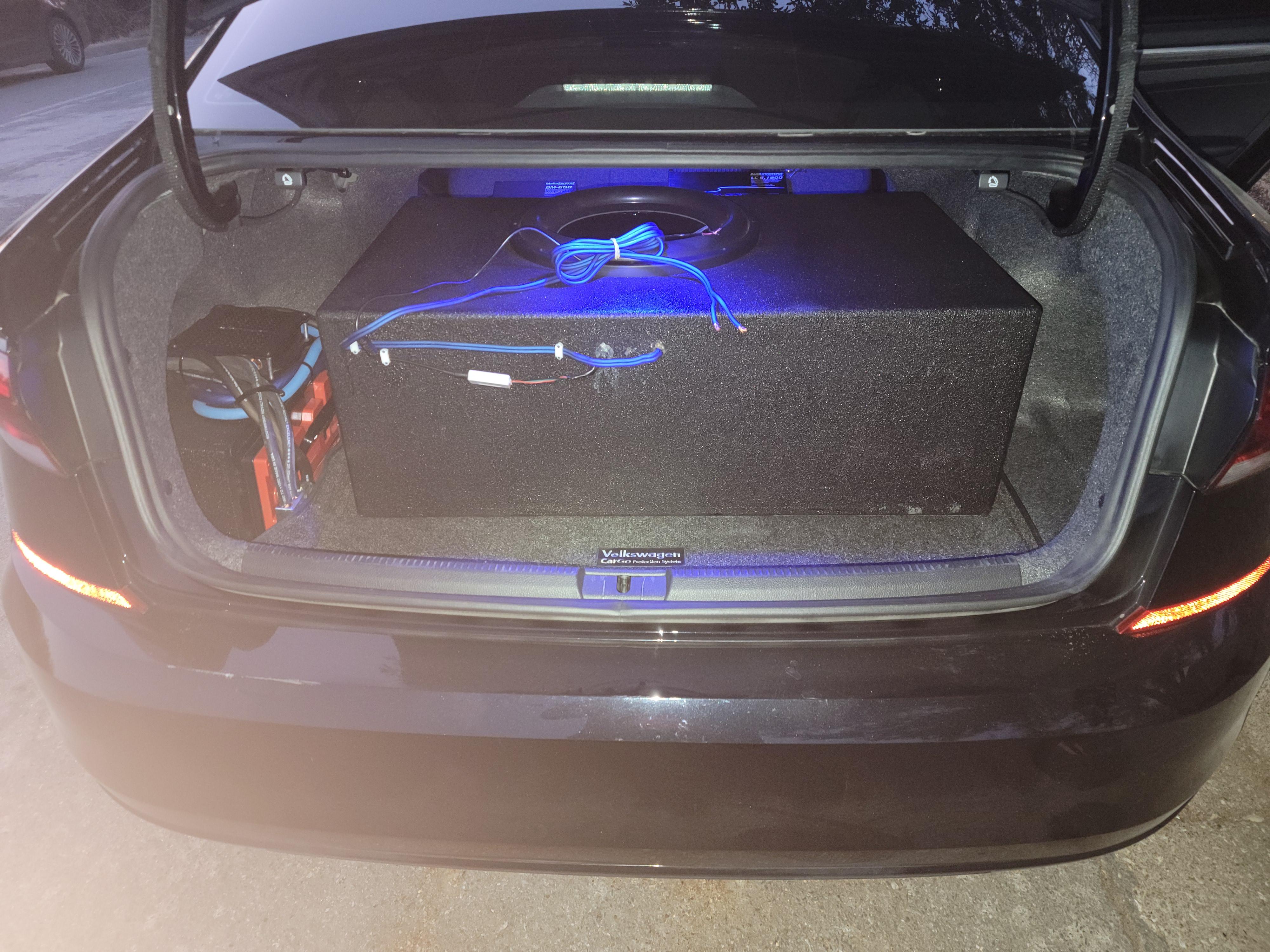

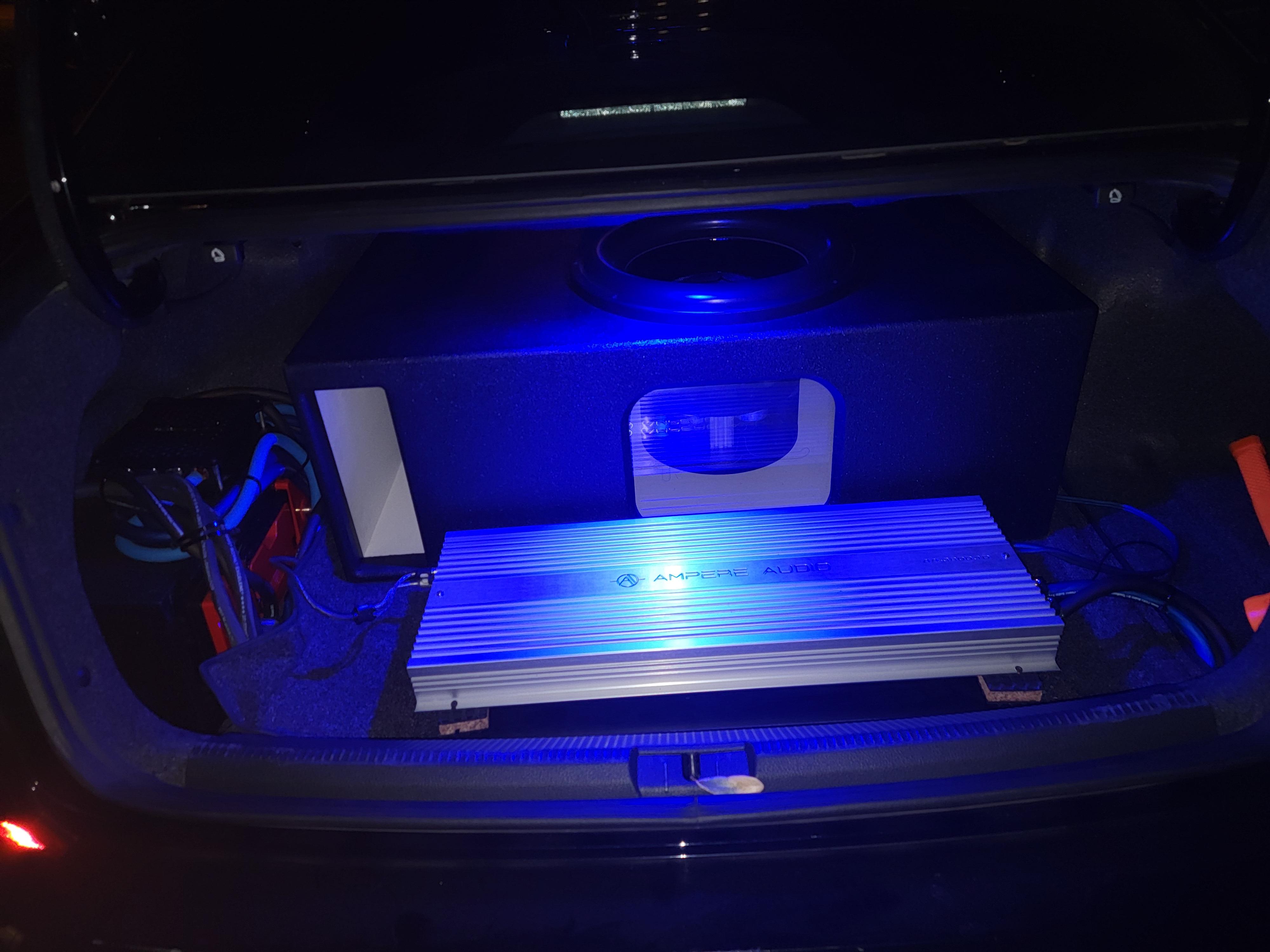

Took the day off to get this done, battery is finally mounted. Box is screwed down to car itself and wedged between foam spare tire holder and car's side panel, used a mallet to get this done. Looks damn good if I say so myself. Time to throw the sub enclosure in :woot:

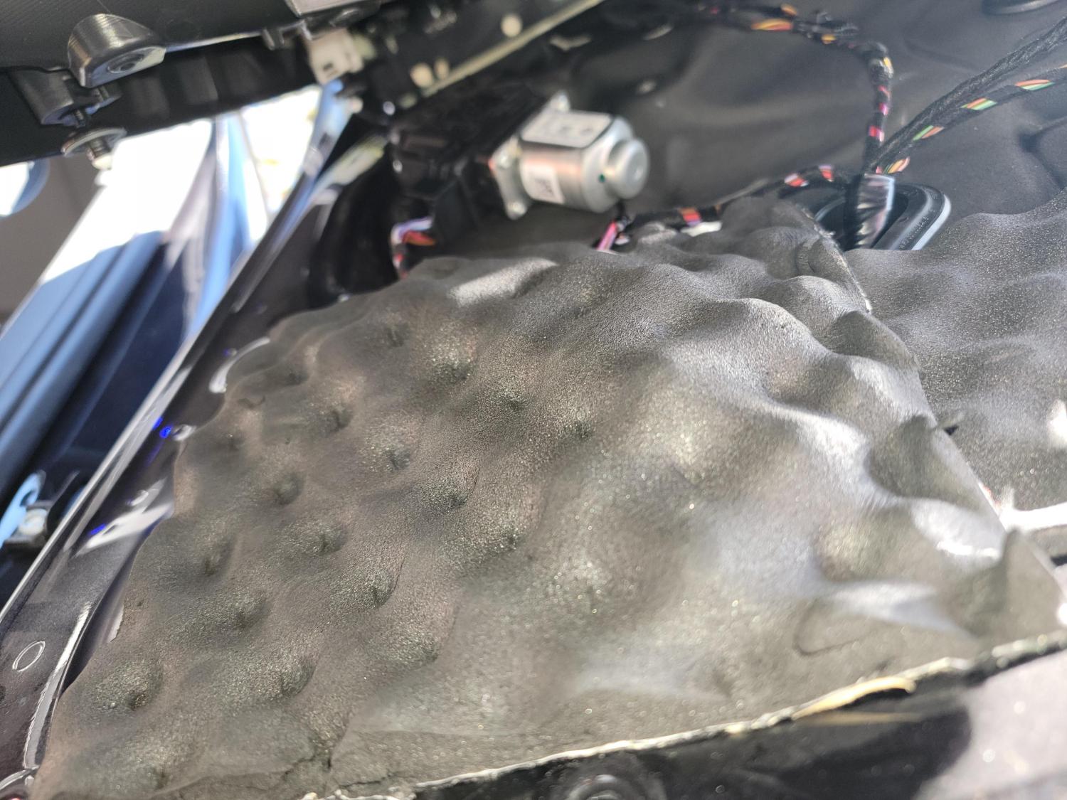

    Sound deadening has began
  • jcarter1885
    jcarter1885
    I'm 80% done with the sound deadner, the trunk deck is next. I didn't do the under side yet because I don't feel like uninstalling the factory subwoofer till it blows or until my new Fi sub gets here.

Once I carried the box downstairs and put it in the trunk I didn't even wire it up. I just closed the trunk and locked the doors. I'm wore out, sheesh.

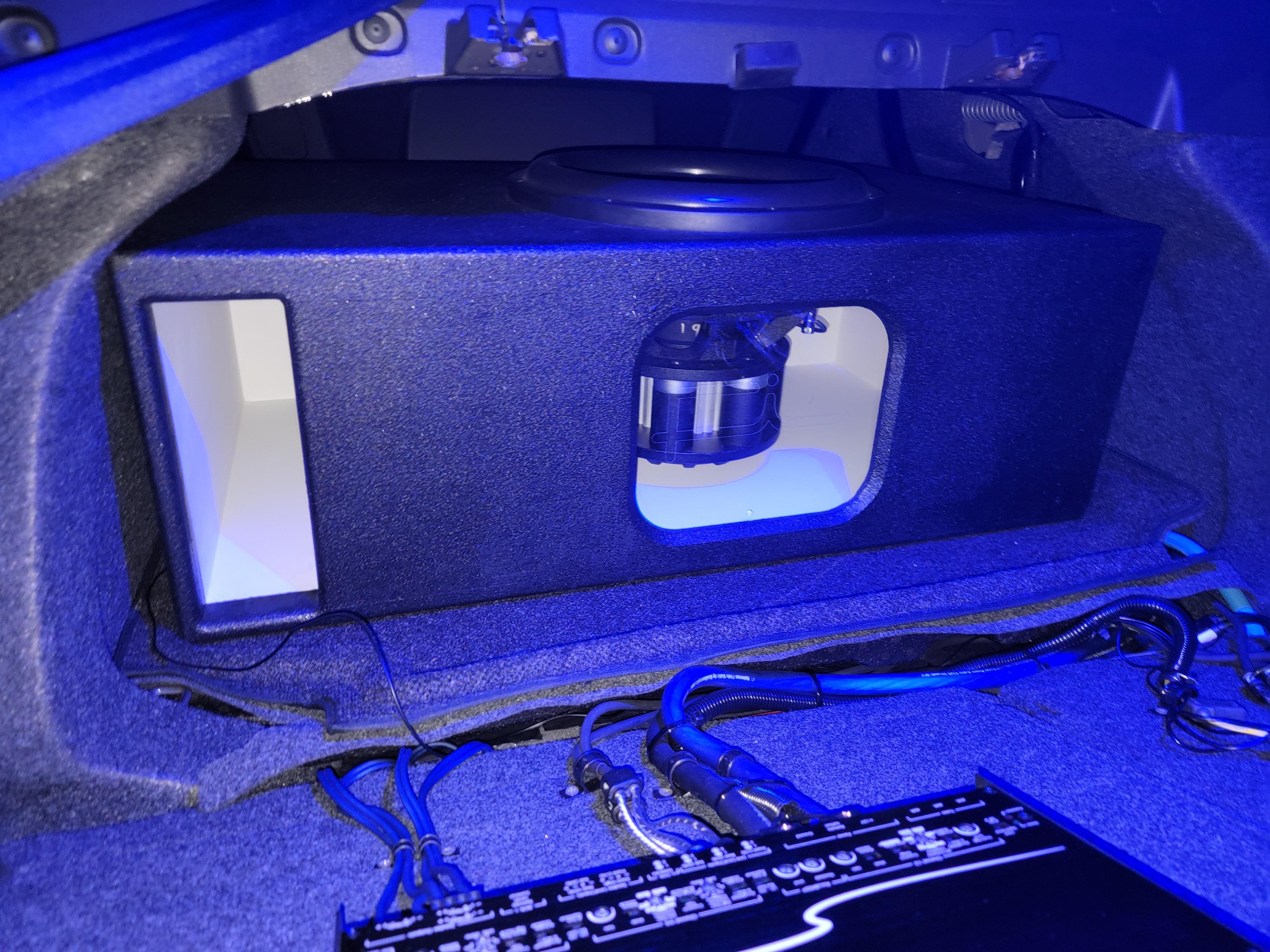

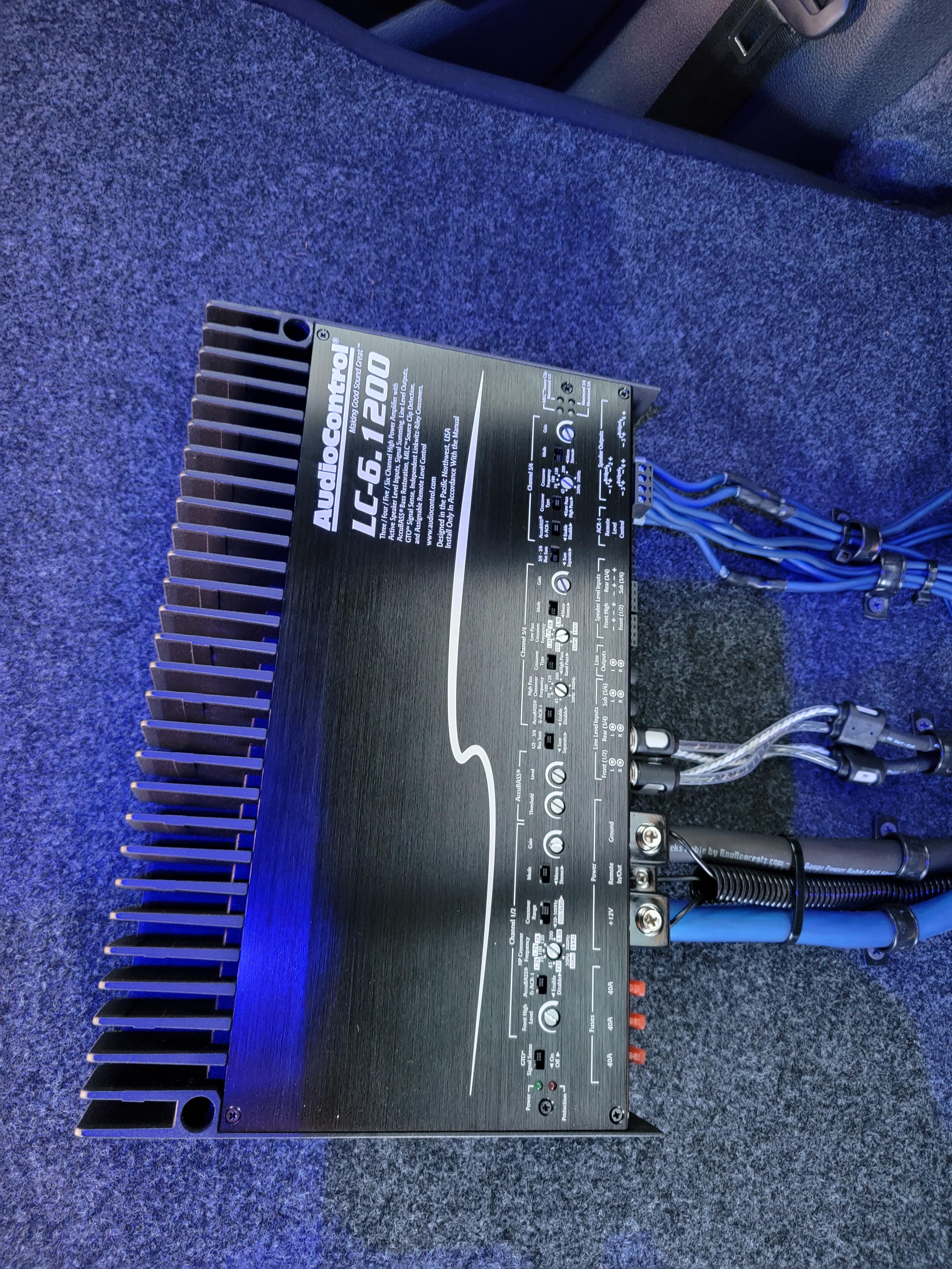

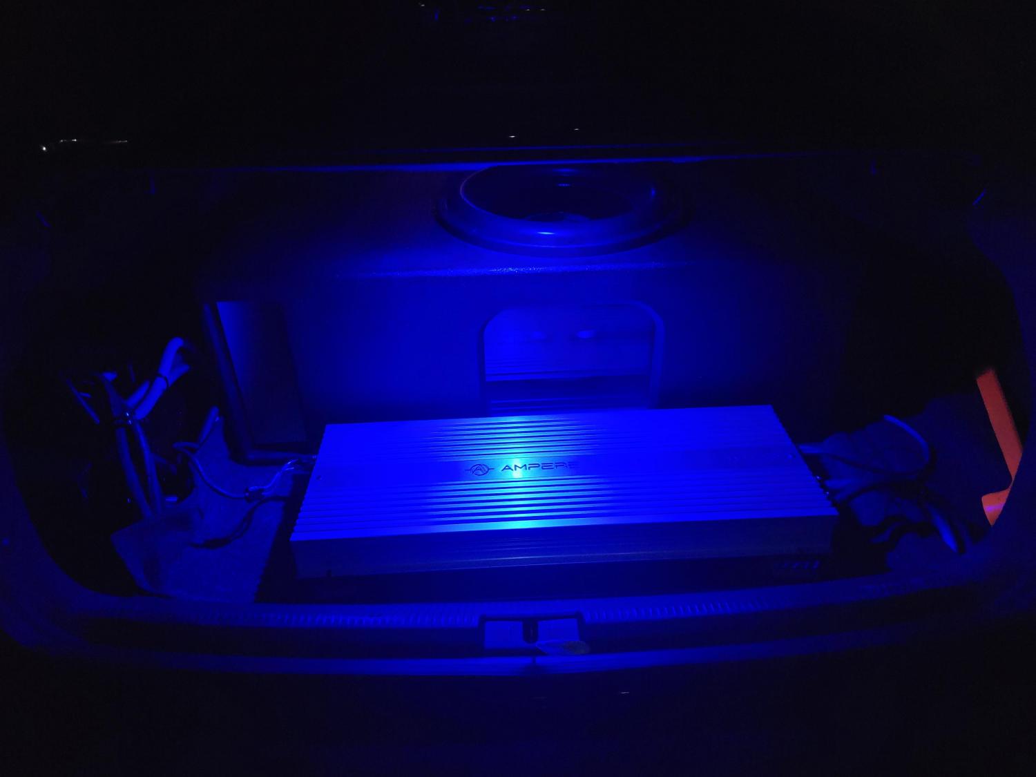

Got it wired up this afternoon, it's on low power as it breaks in. Sounds damn good, glad I went back with Fi. I love how that Audio Control lights up from the top, its pretty dope especially since it matches blue light theme I have going on.

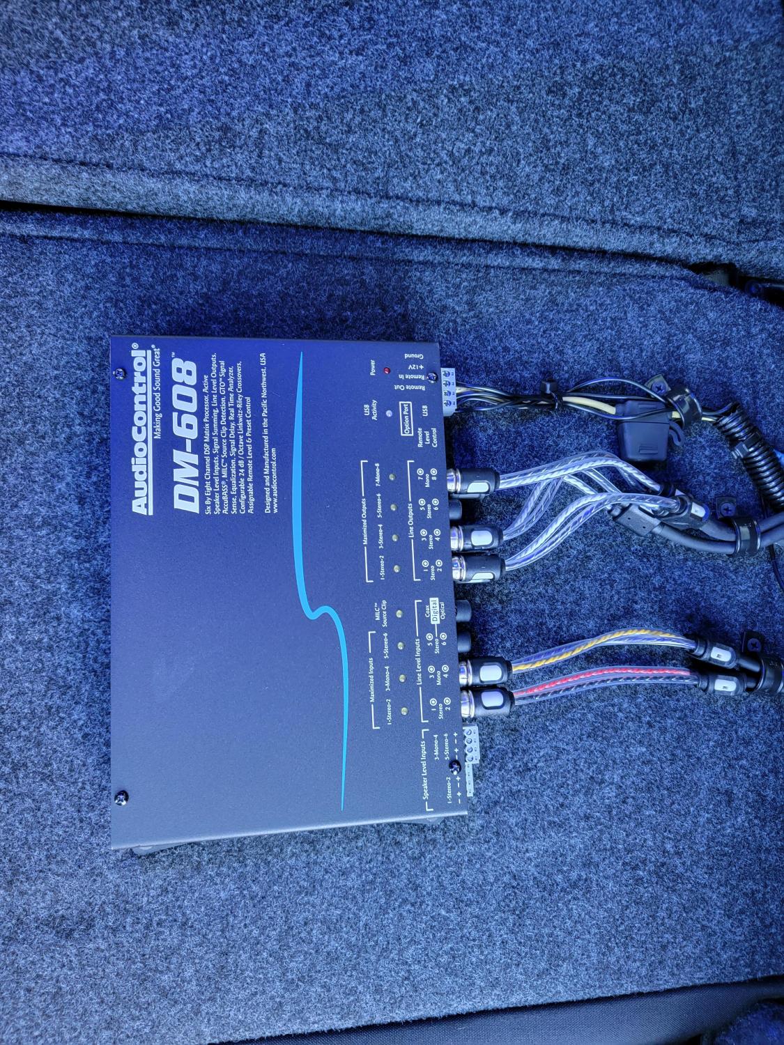

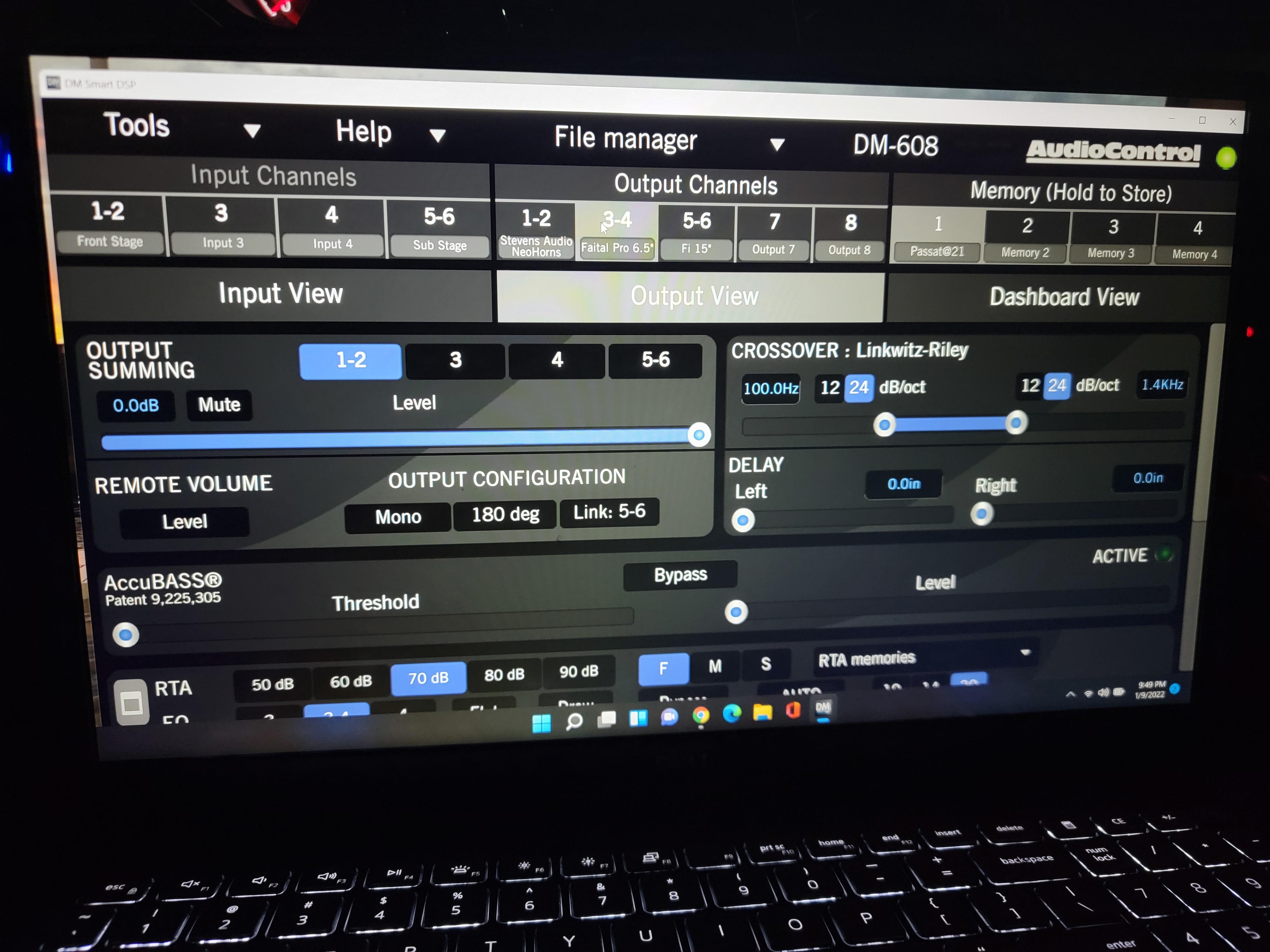

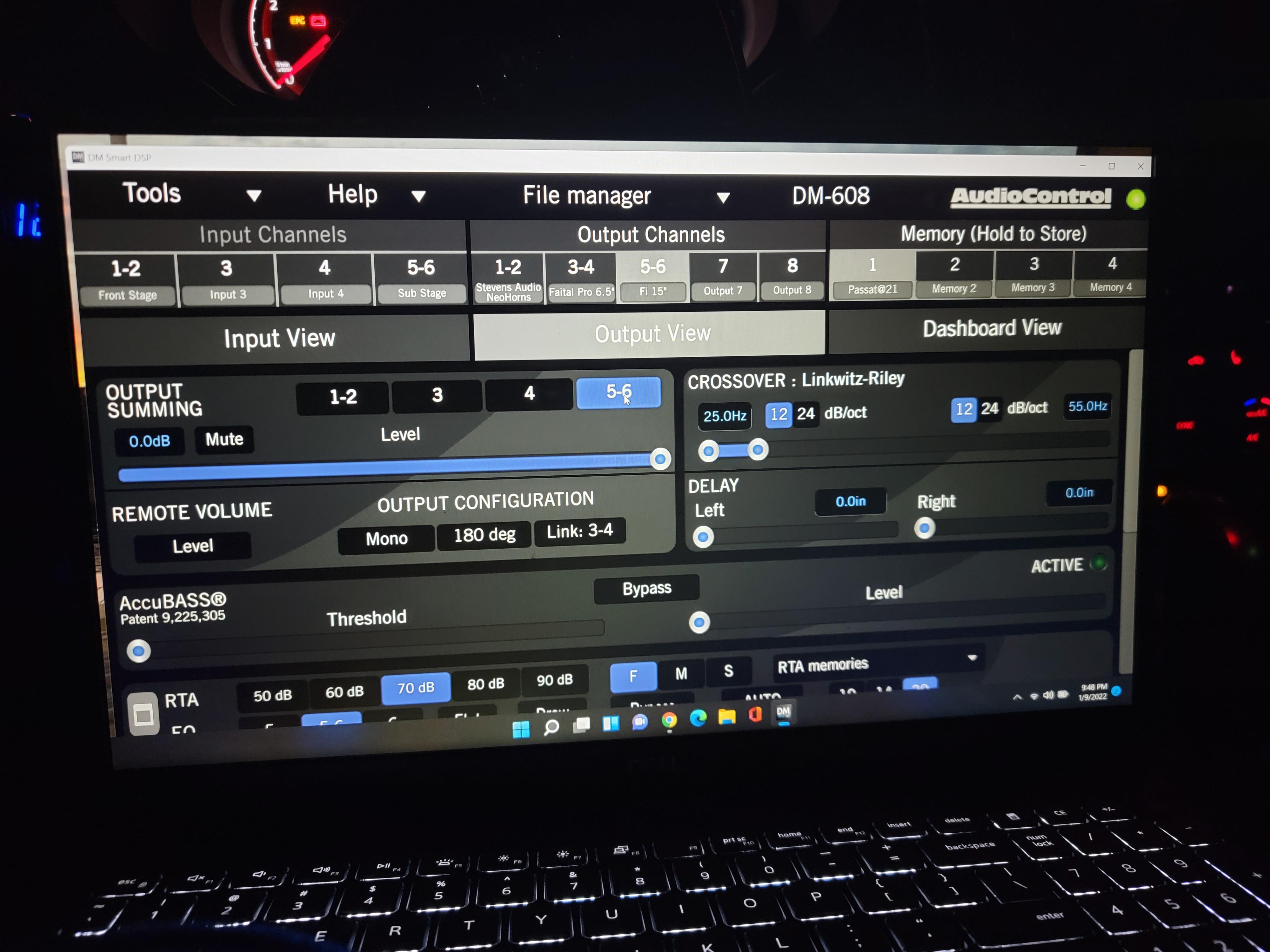

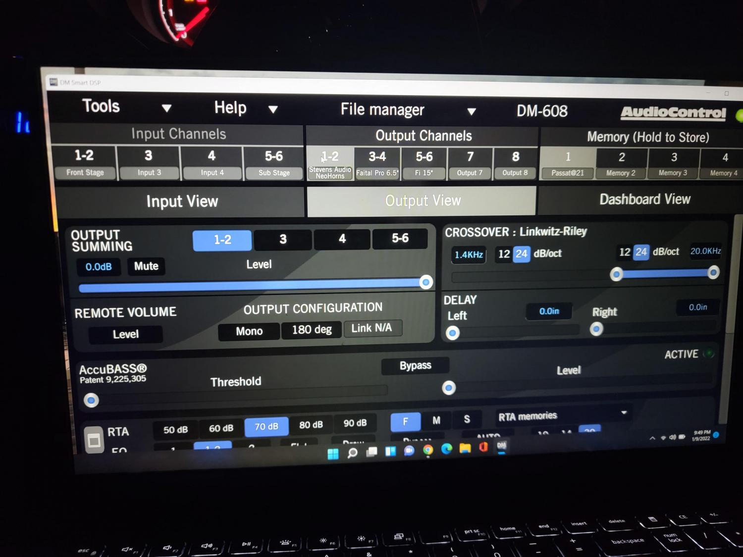

Dropped the slope on the Sub Stage to 12db on both ends.
Edited by jcarter1885

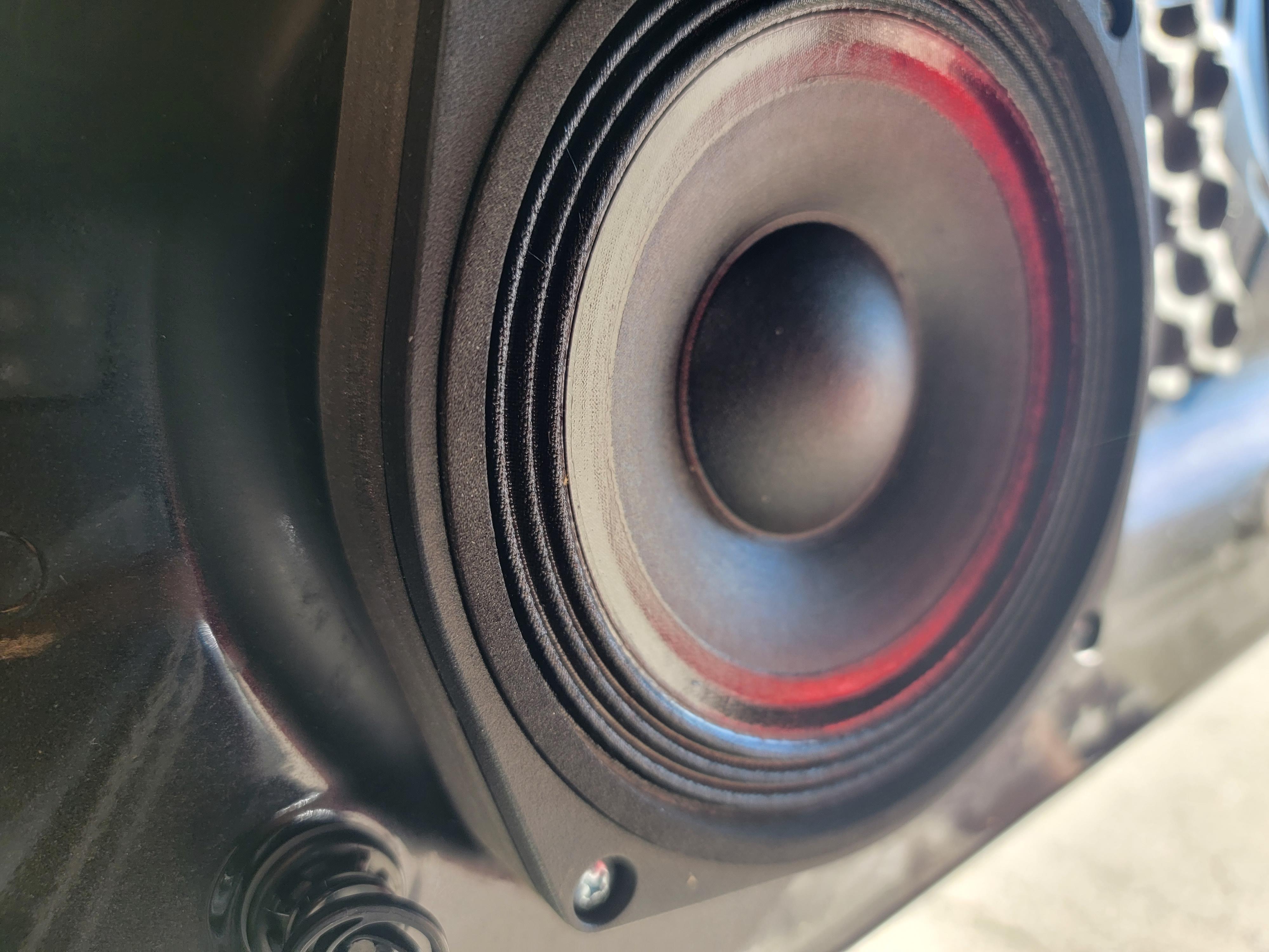

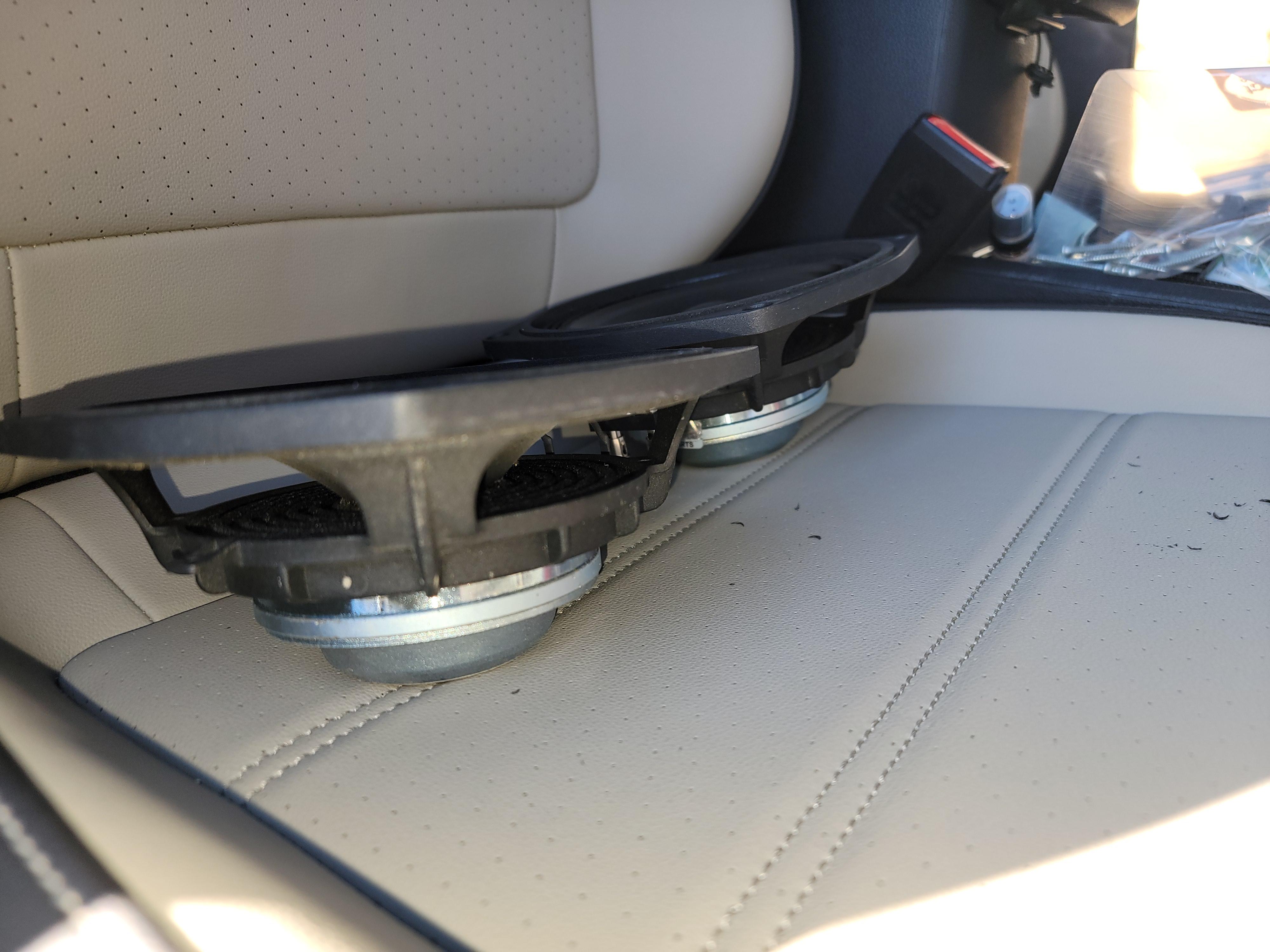

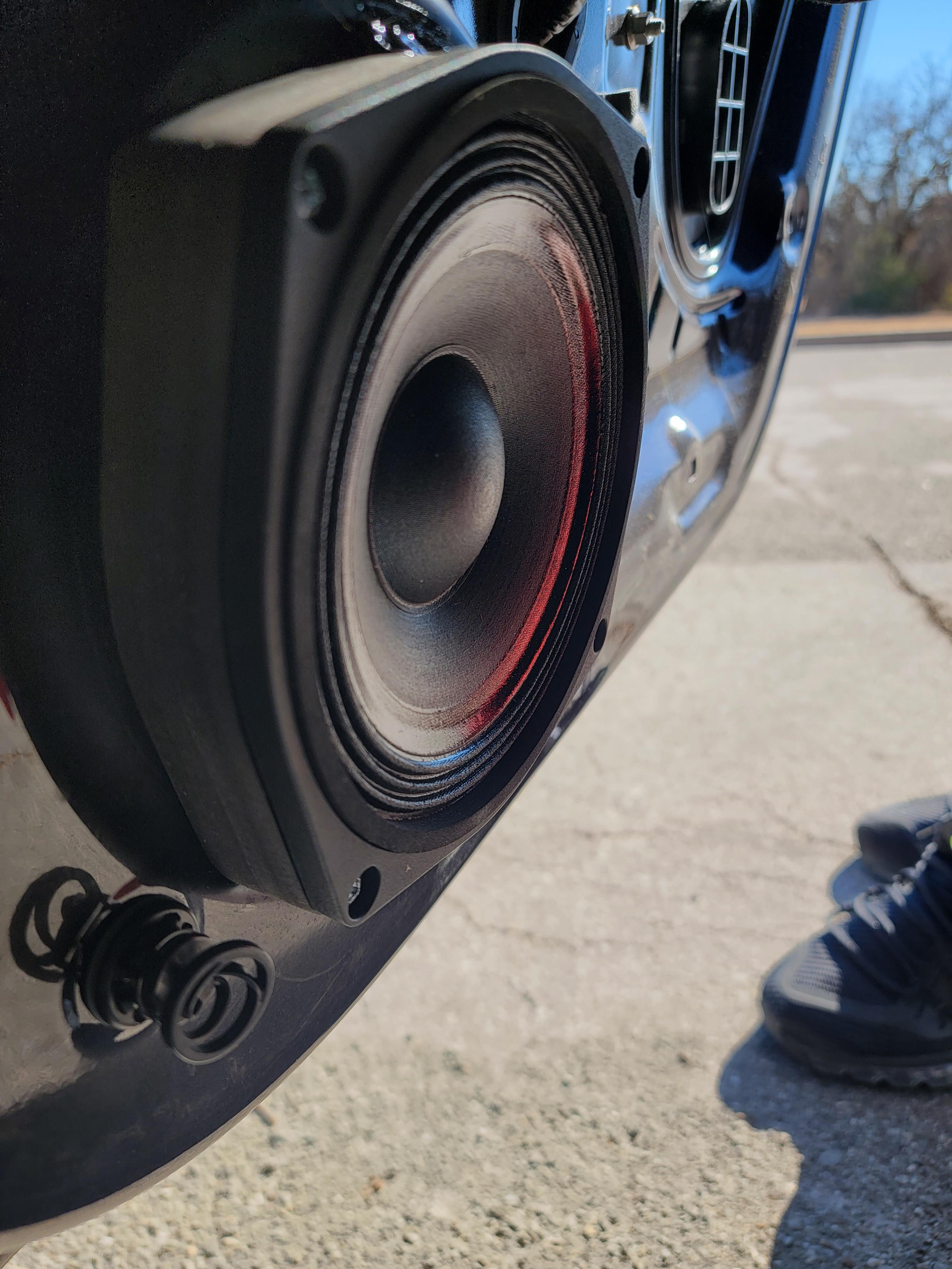

Front Stage will be changed out soon, I'm damn sure keeping the horns. Mids will only be in the front doors, no more rear door fill. Options are:
Two 8"s per front door (Stevens Audio MB8-2)
- Or -
One 10" per front door (Faital Pro 10PR300)

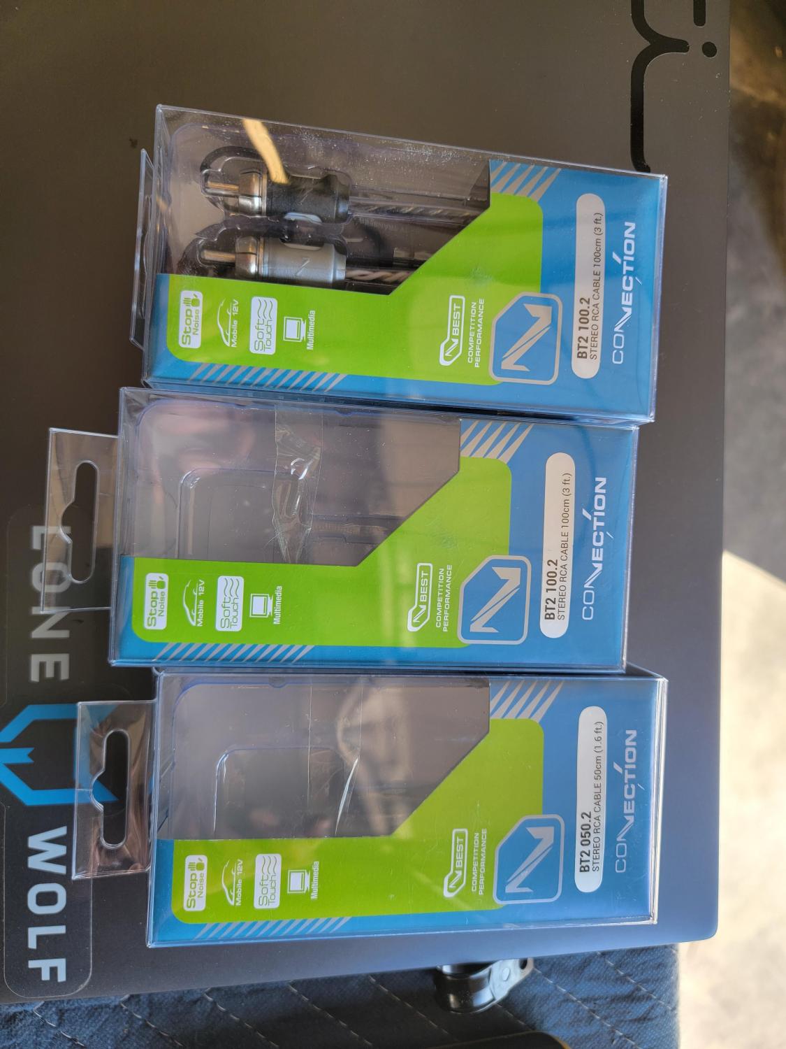

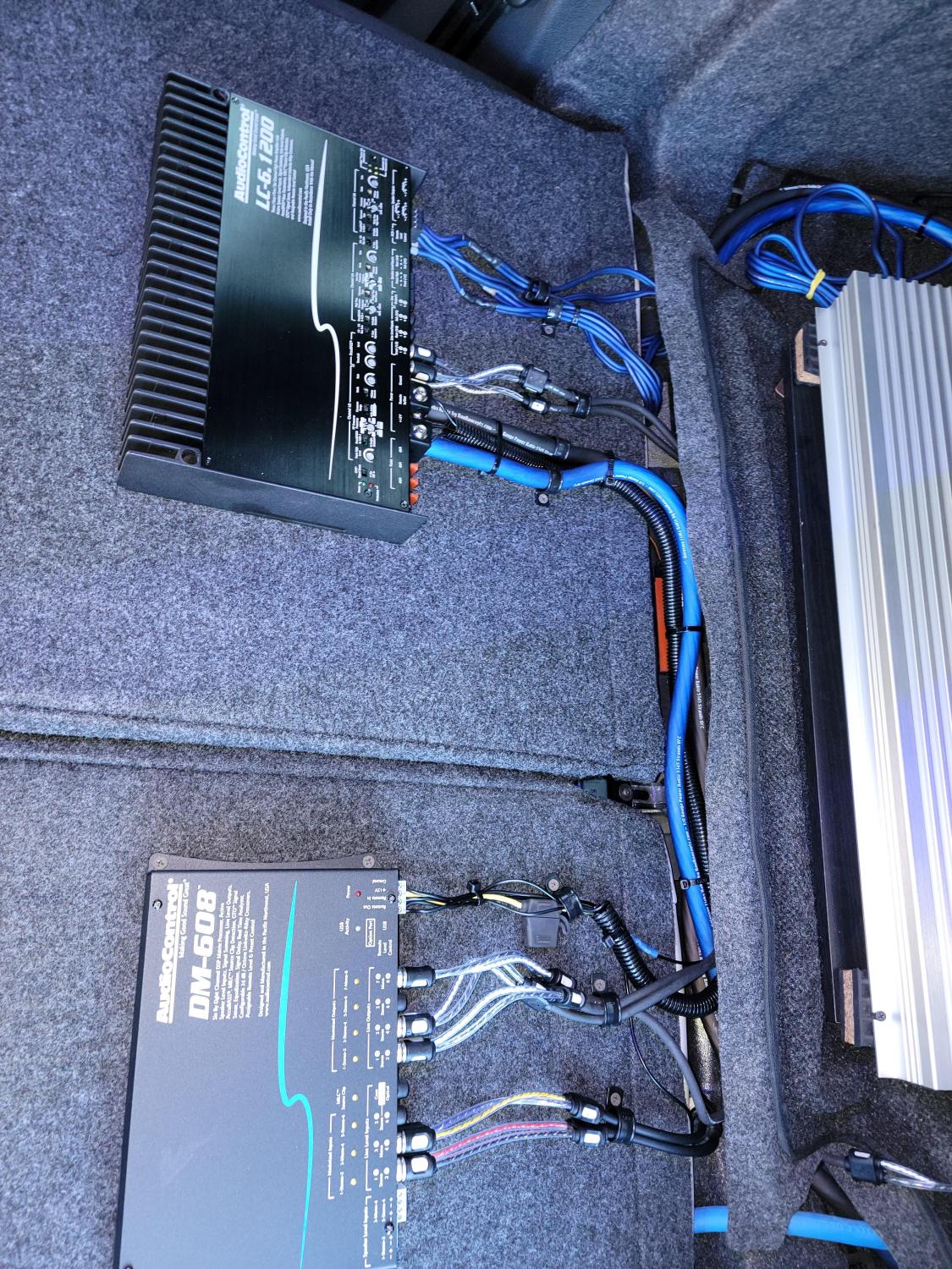

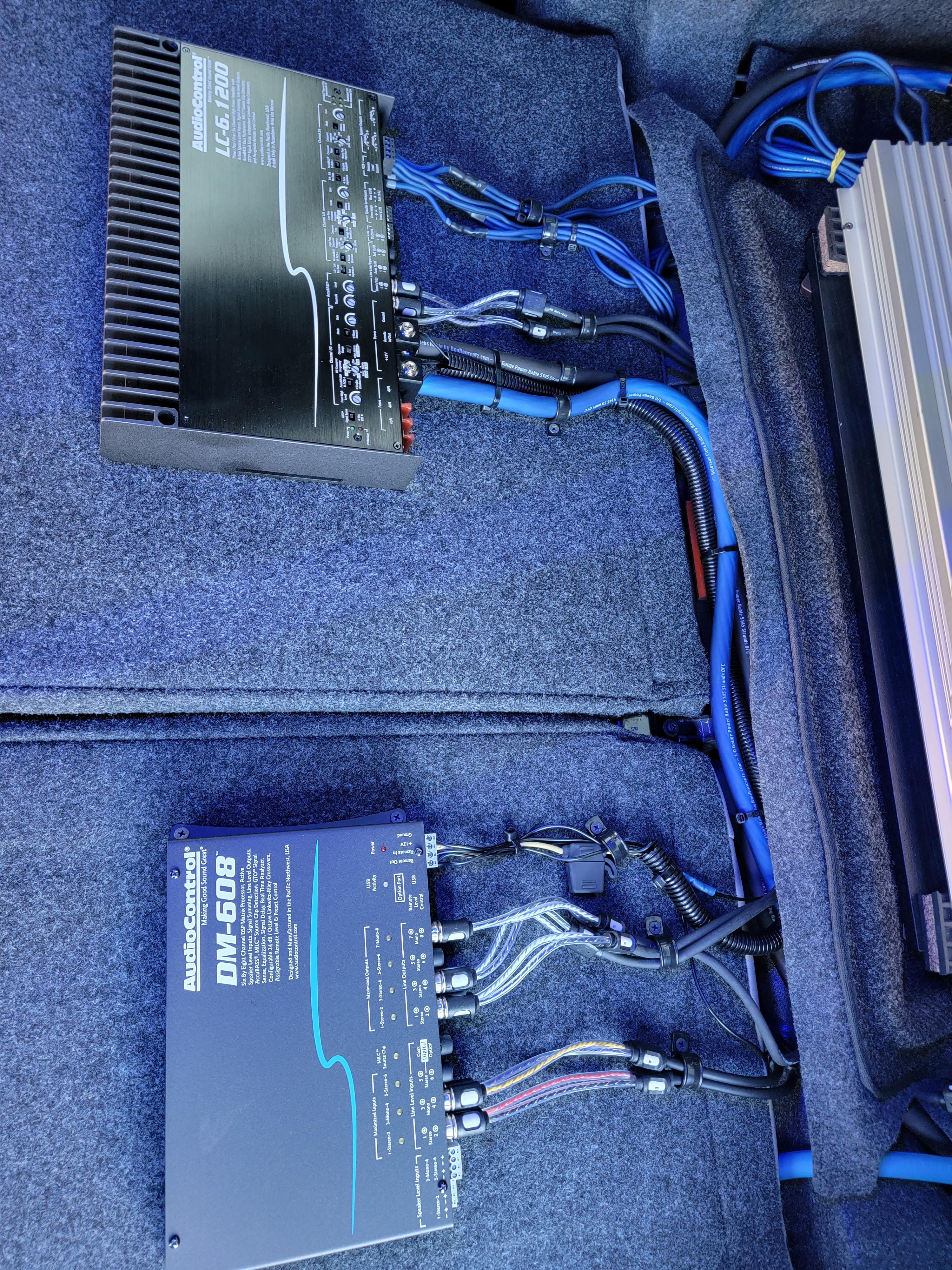

Since my OCD was bothering me I swapped out to more Audison Connection RCAs.

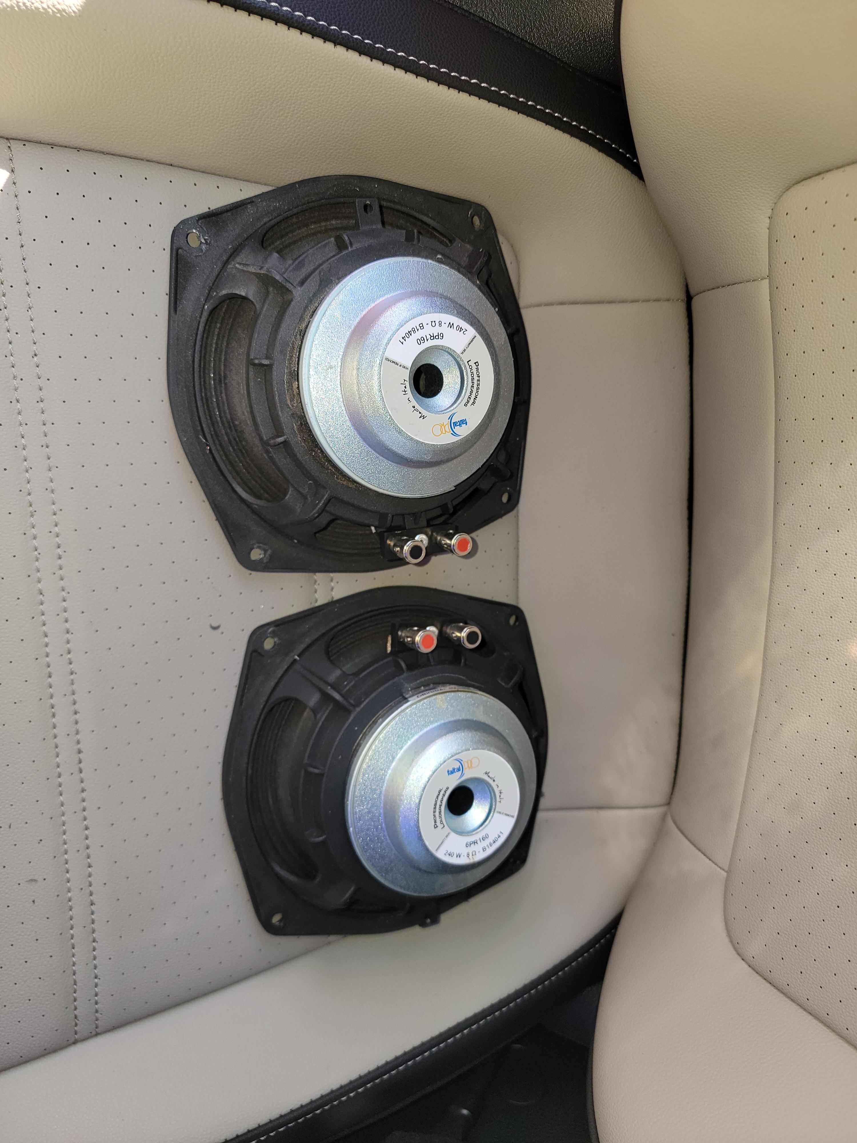

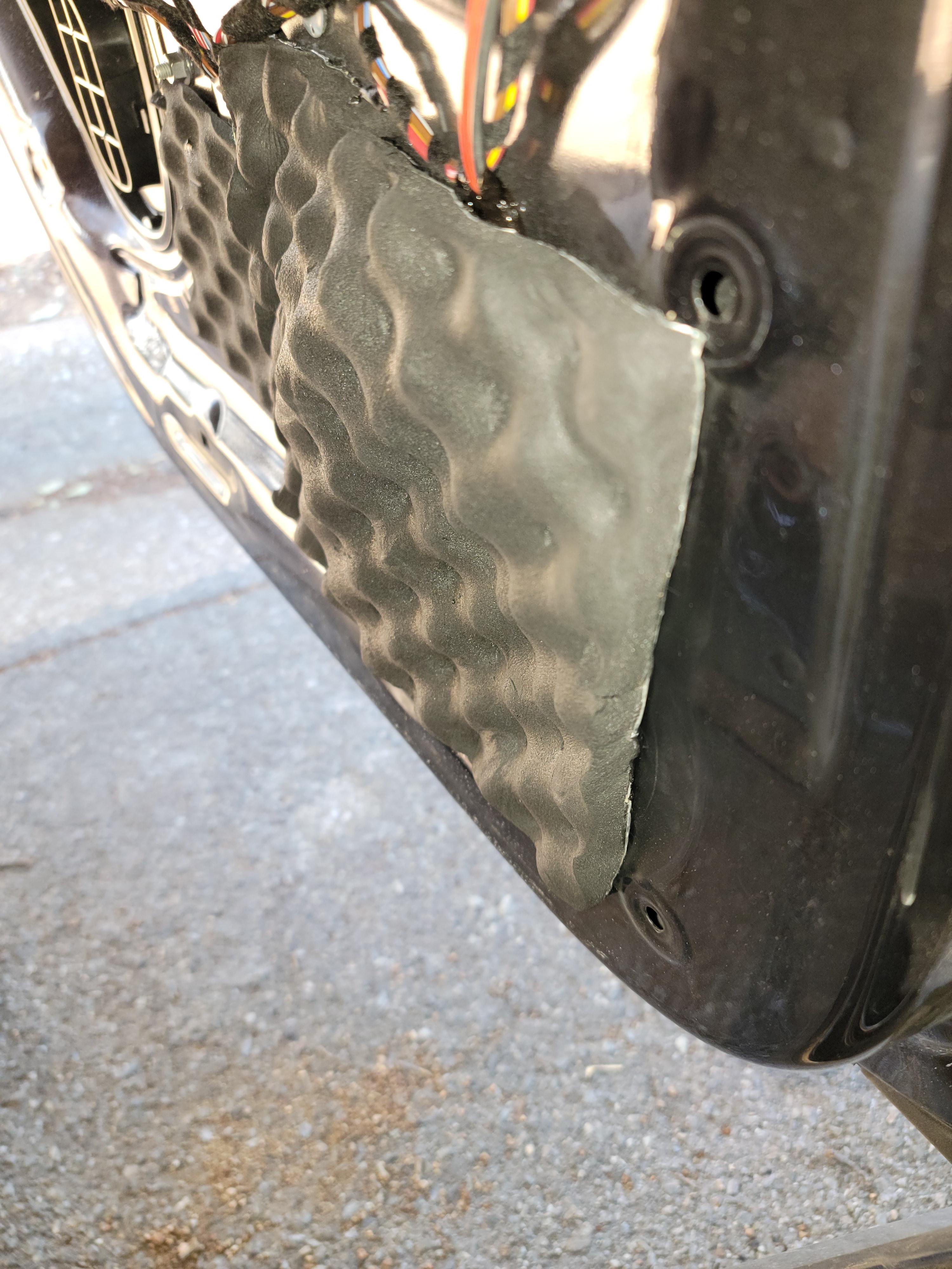

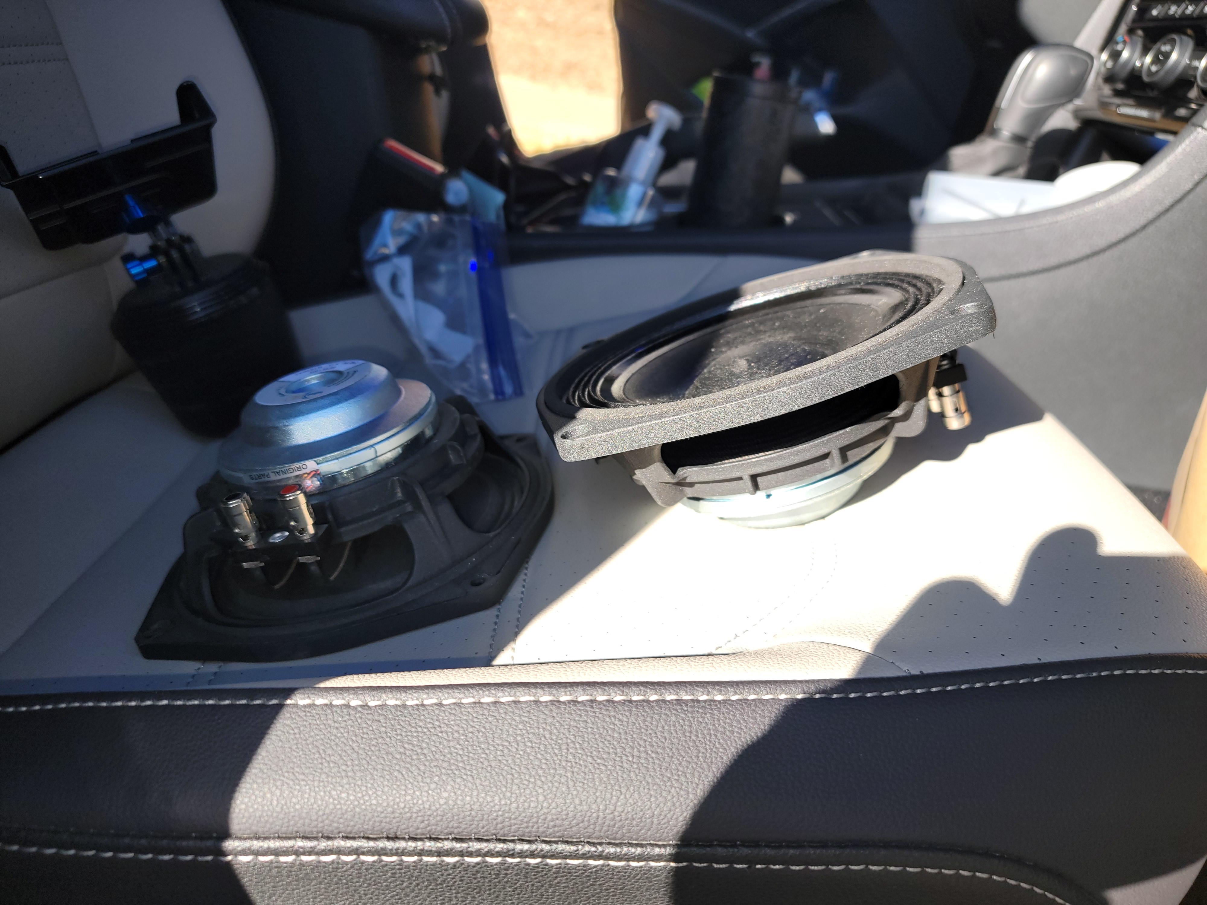

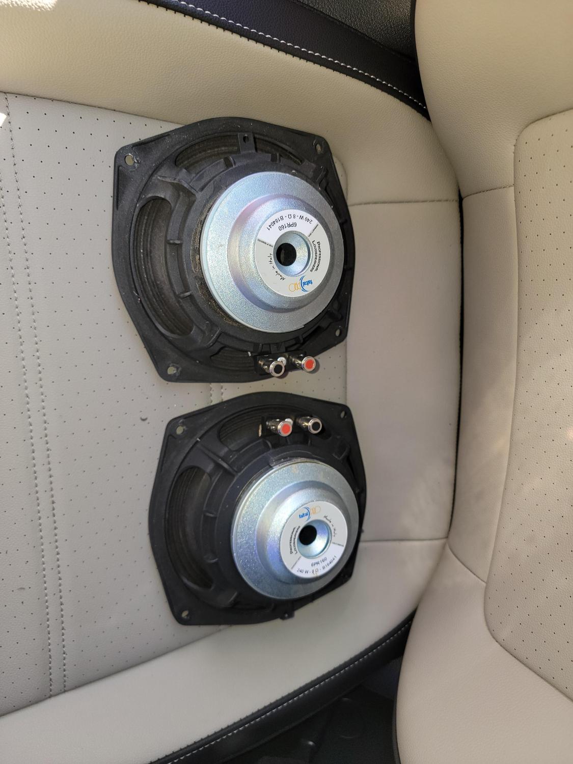

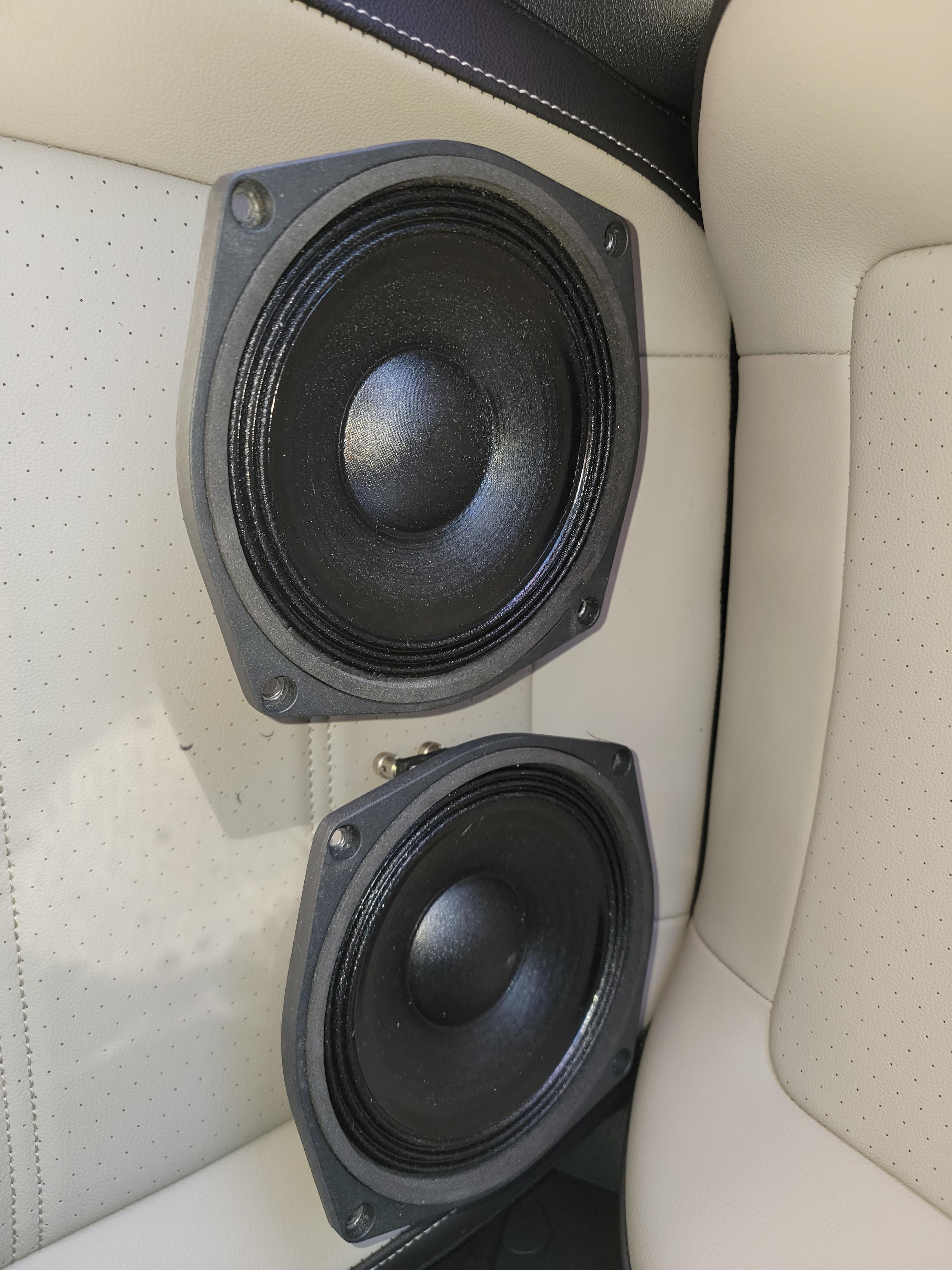

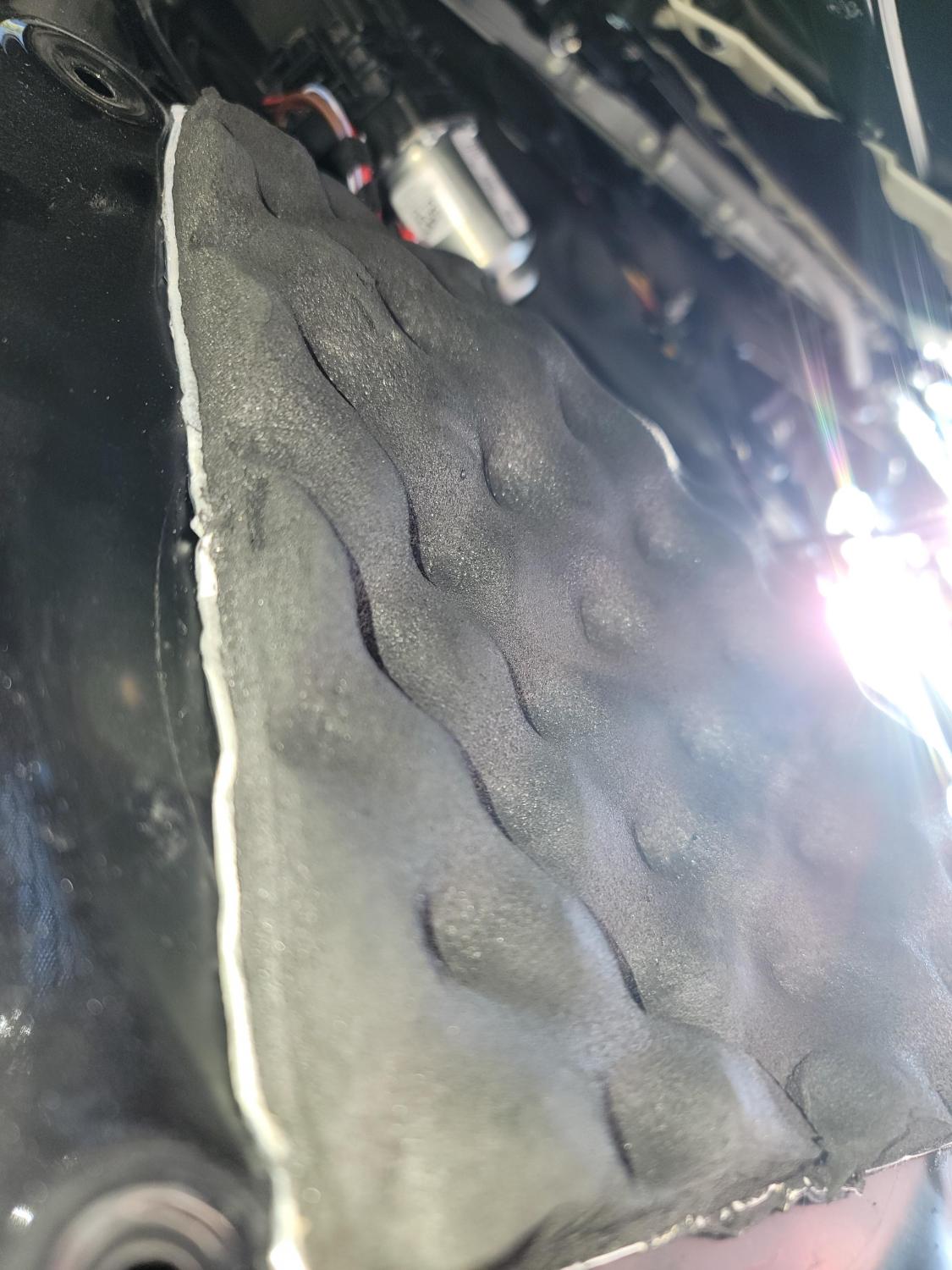

It's official, going 2 8"s per front door, rear door 6.5"s have been removed already. Sucks to see these beautiful speakers and nice rings go after only being in for a month in a half but on to better things. I covered the hole with some thick egg crate dampening.

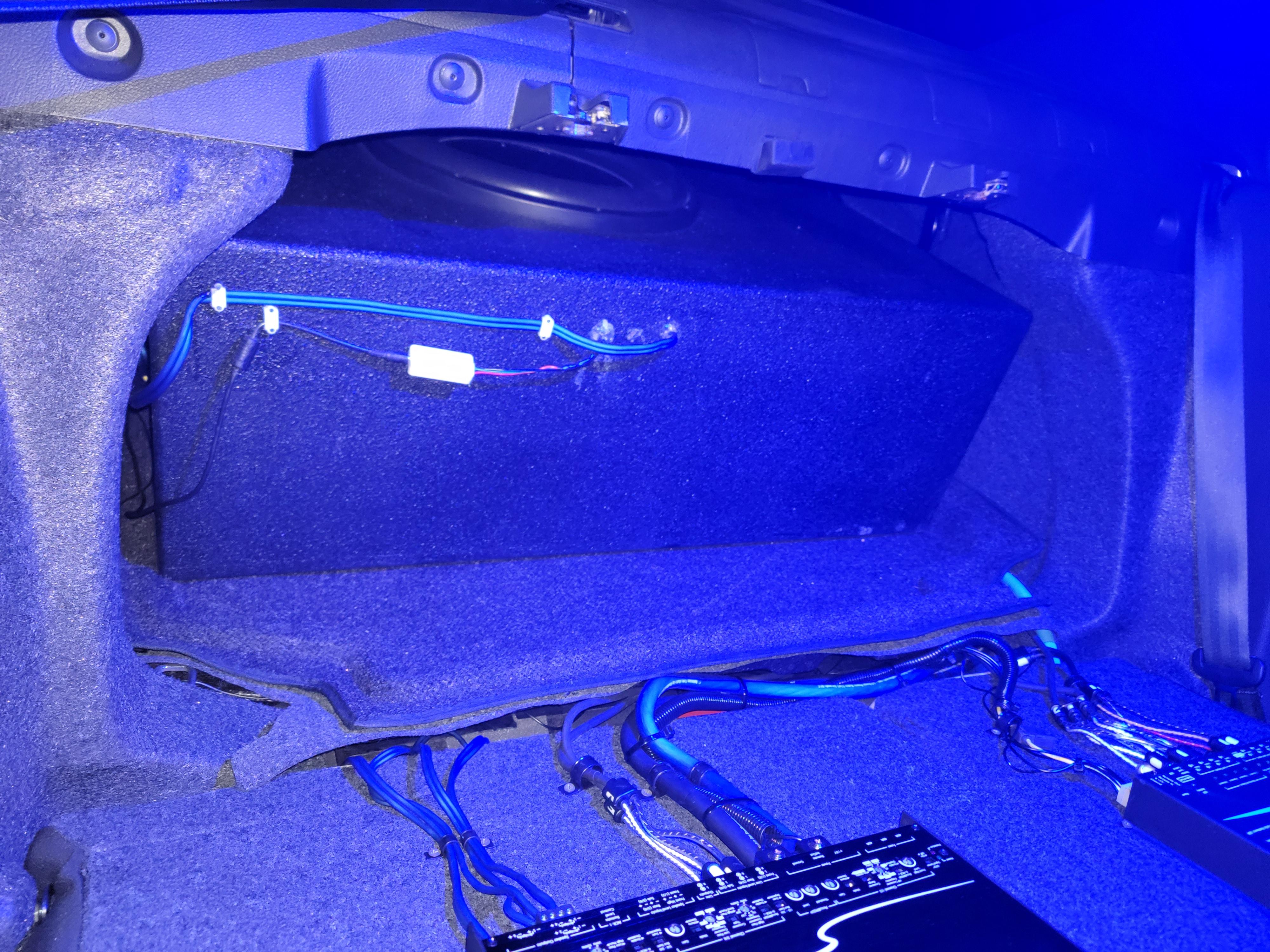

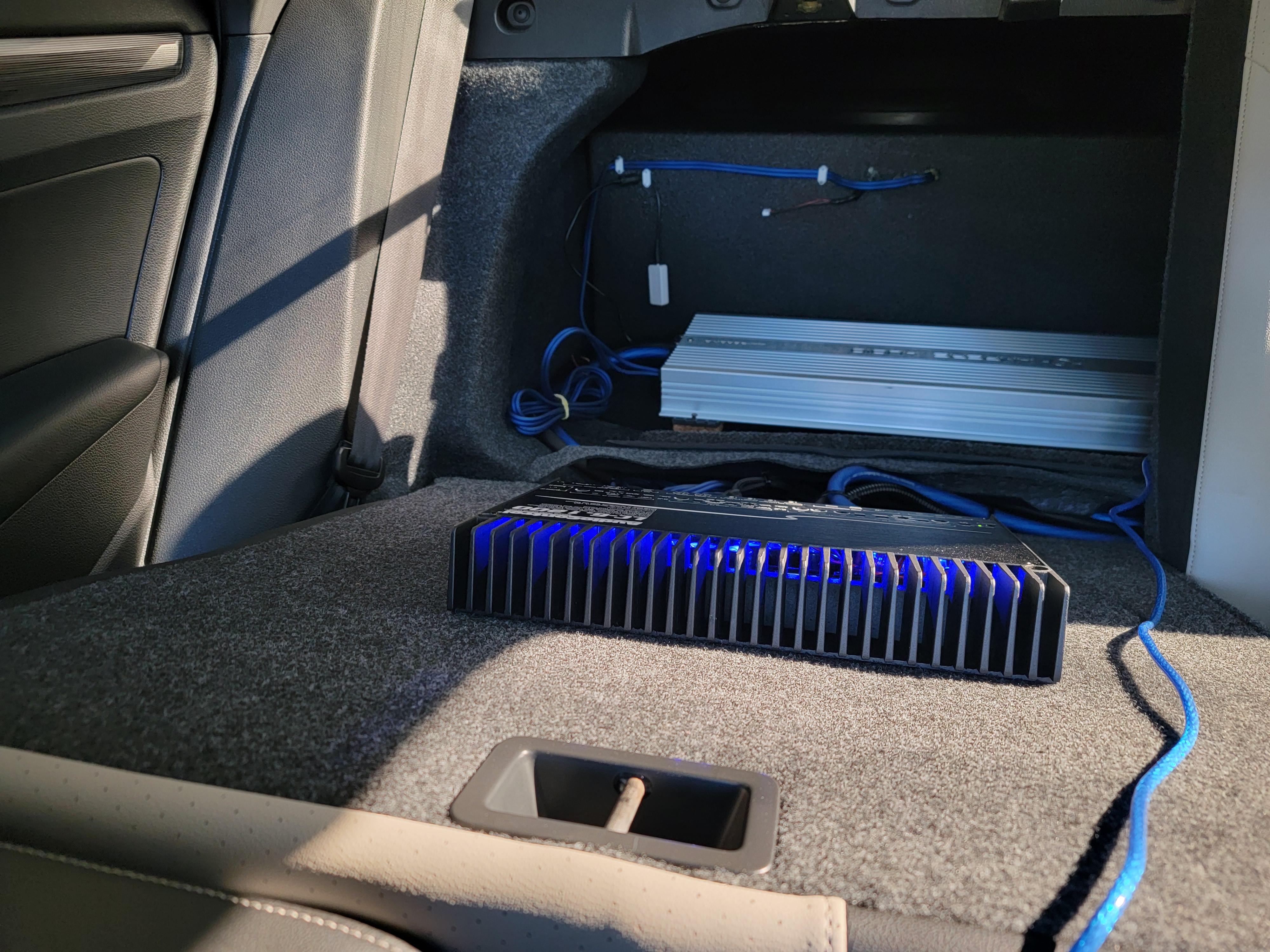

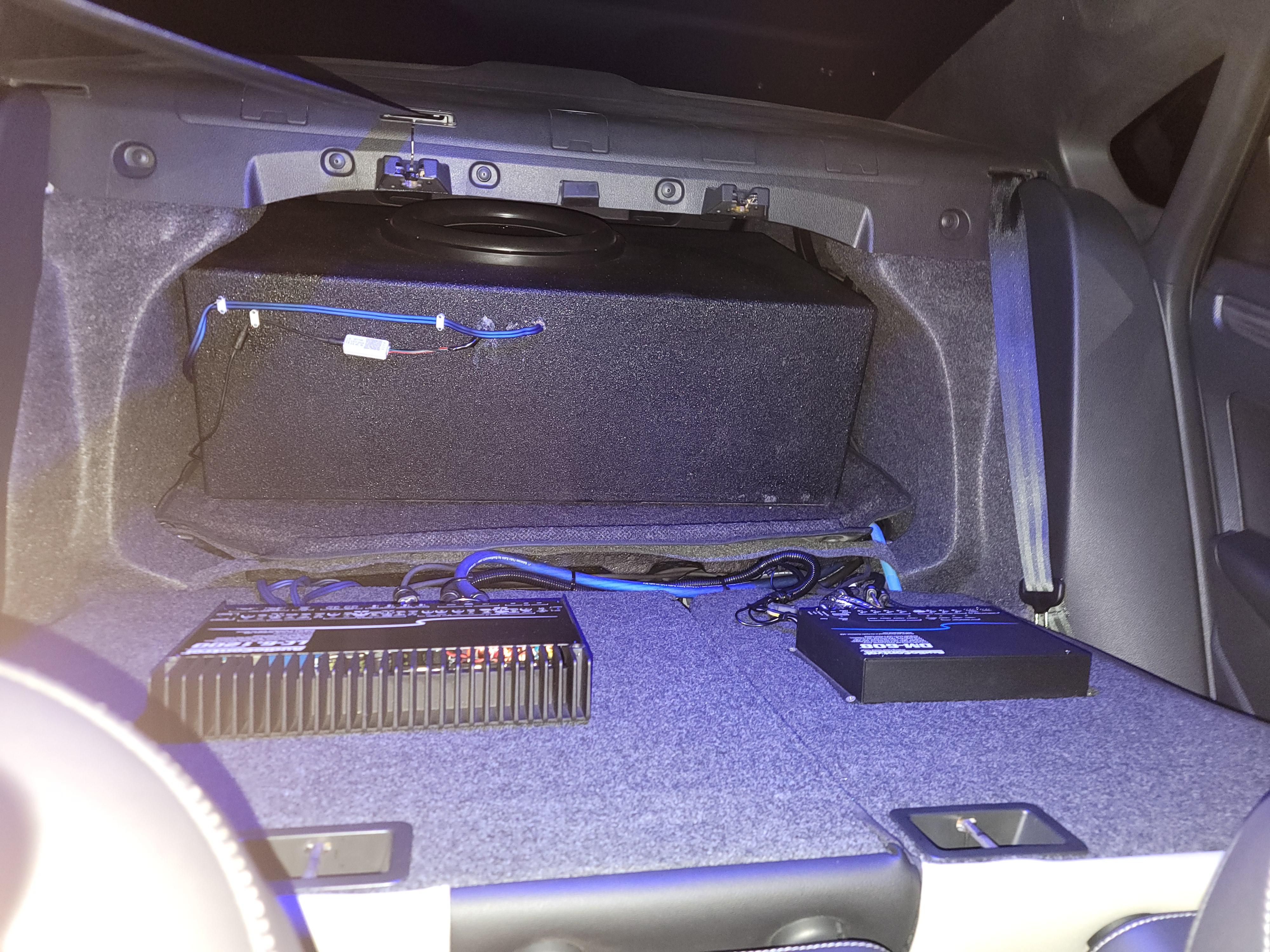

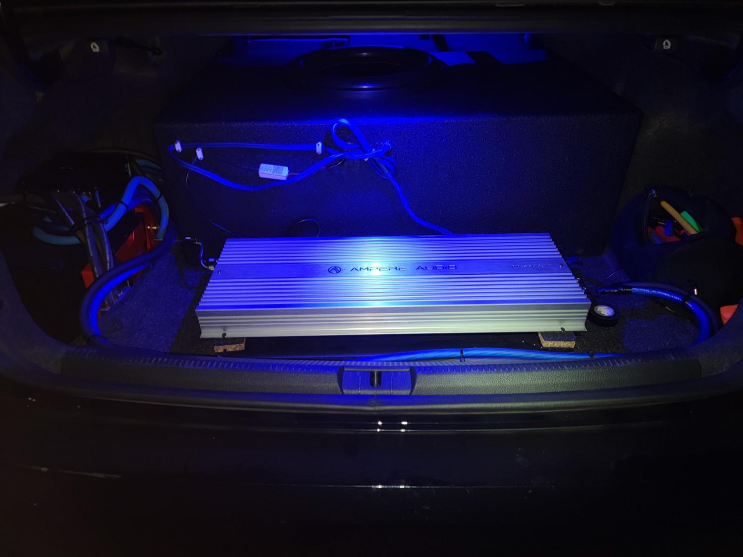

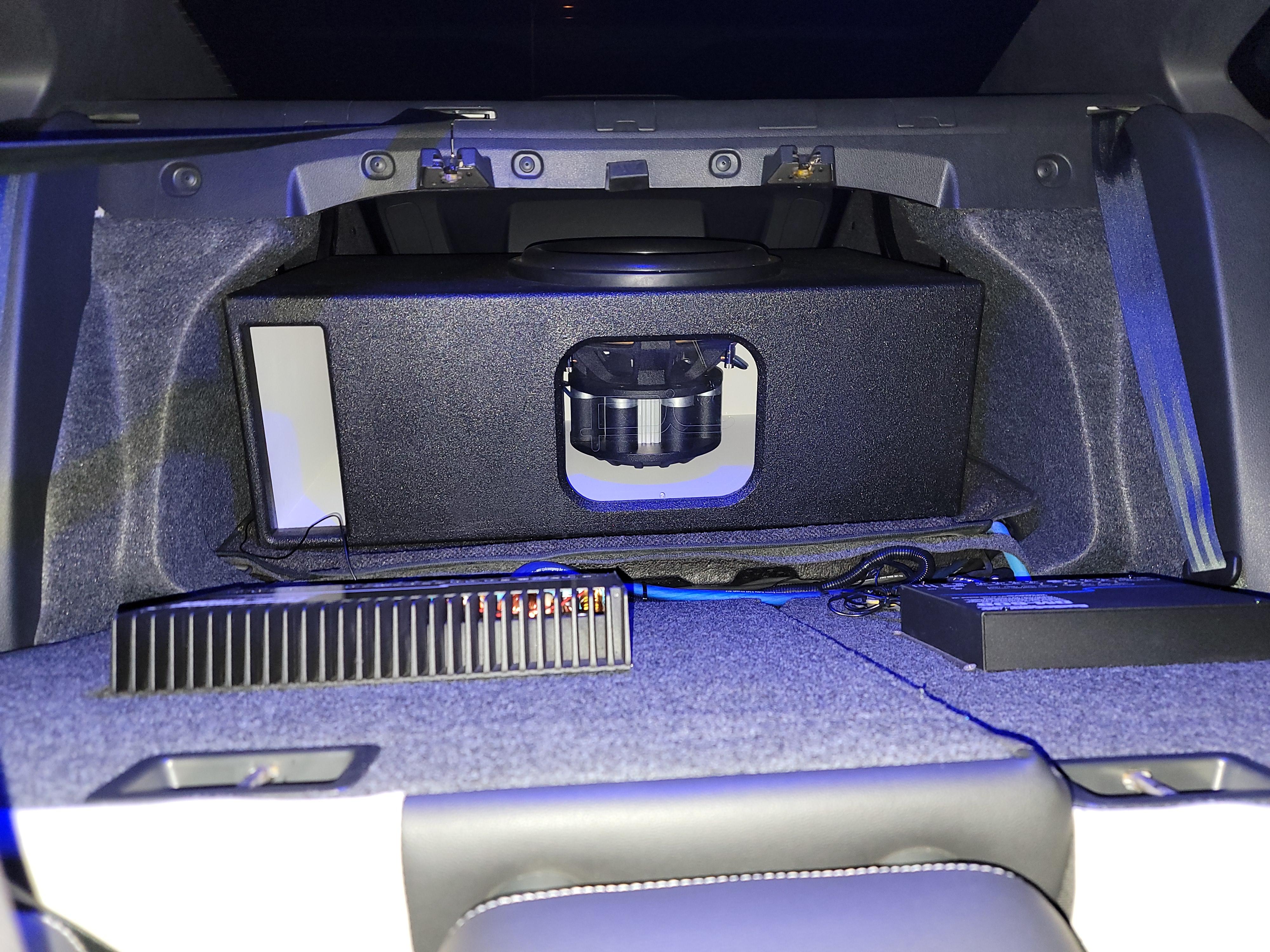

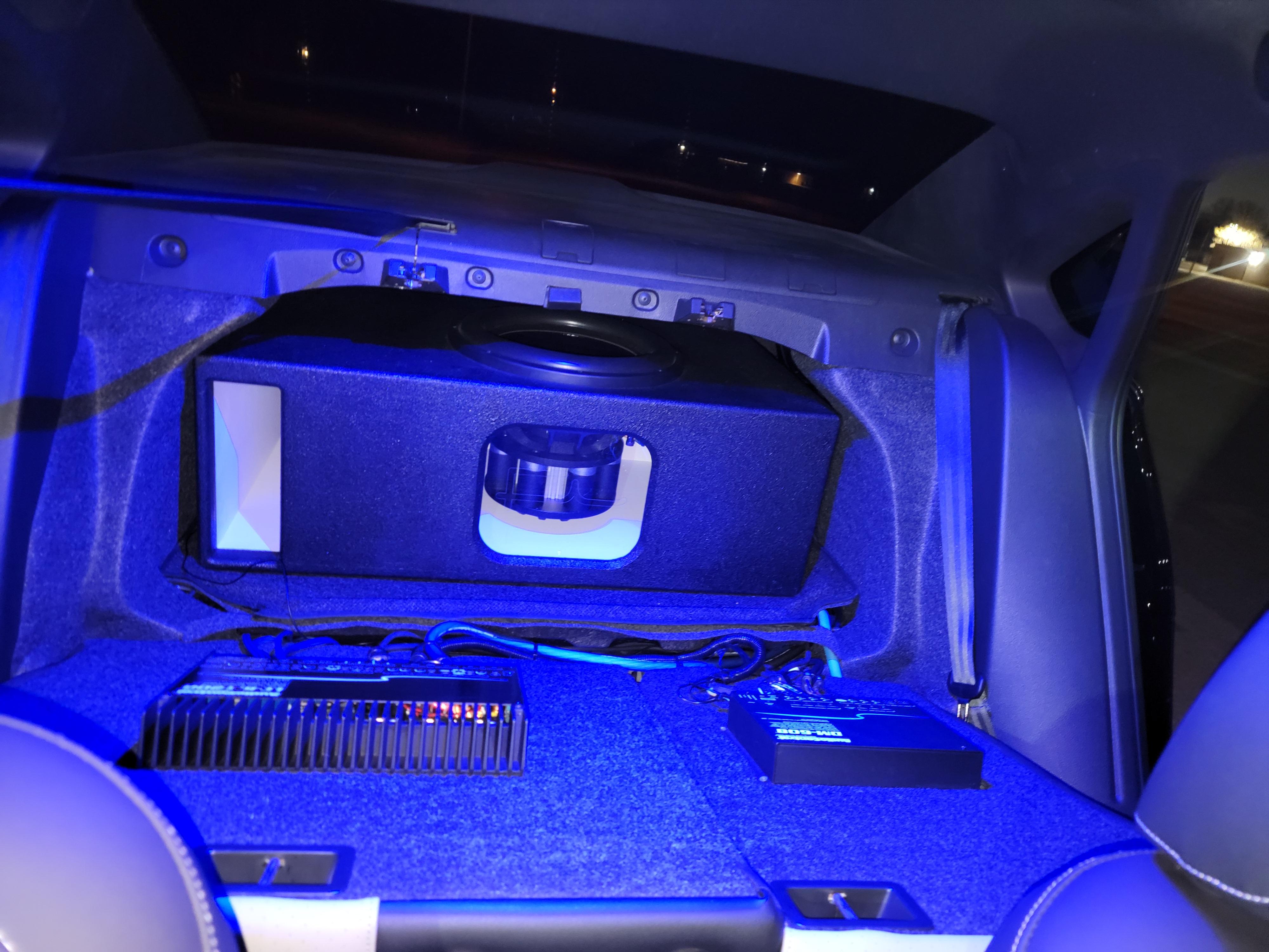

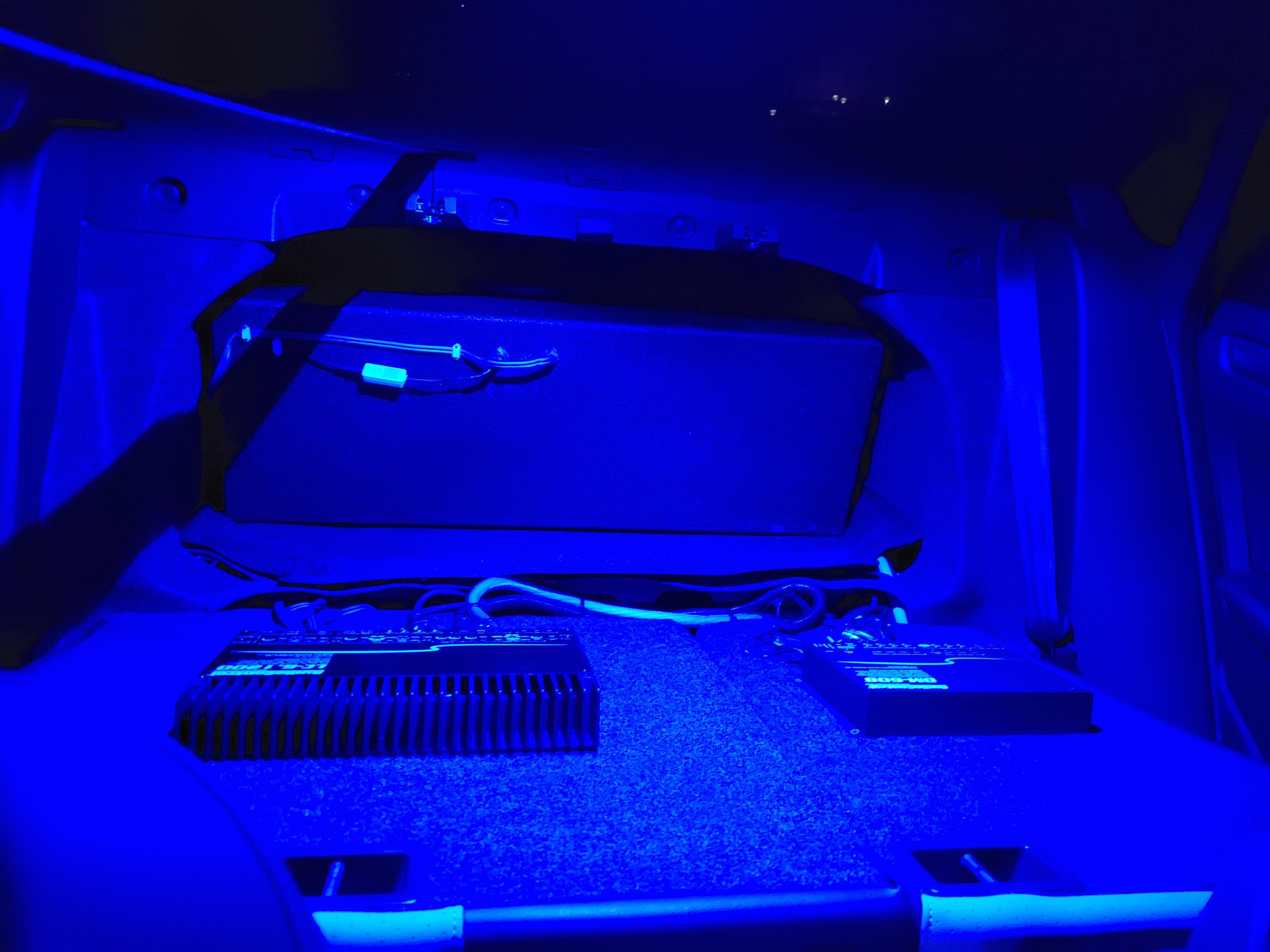

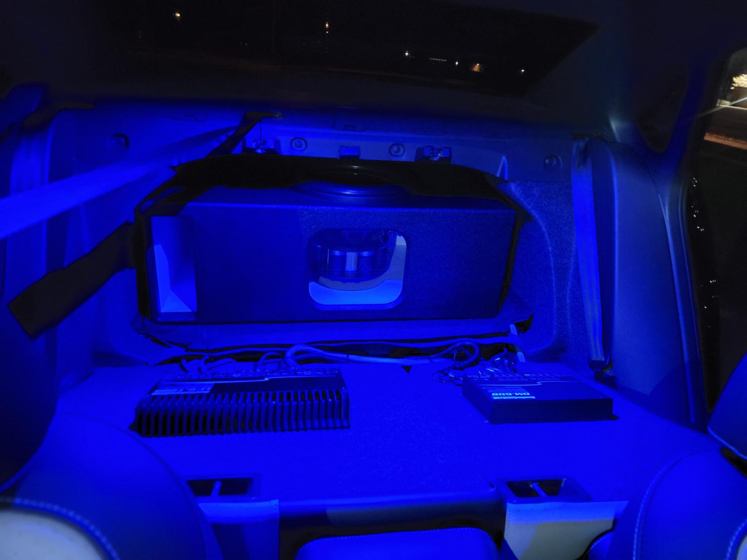

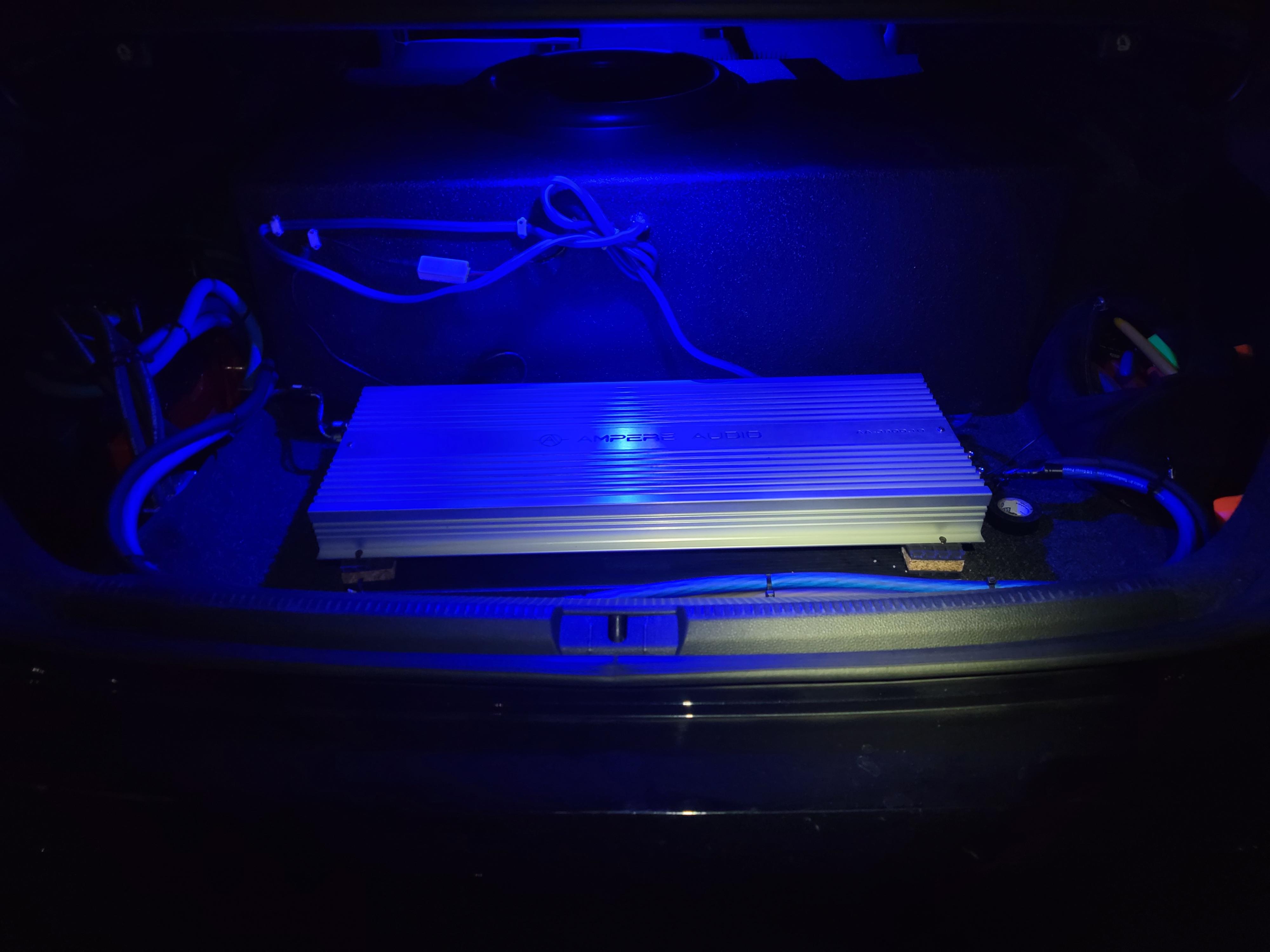

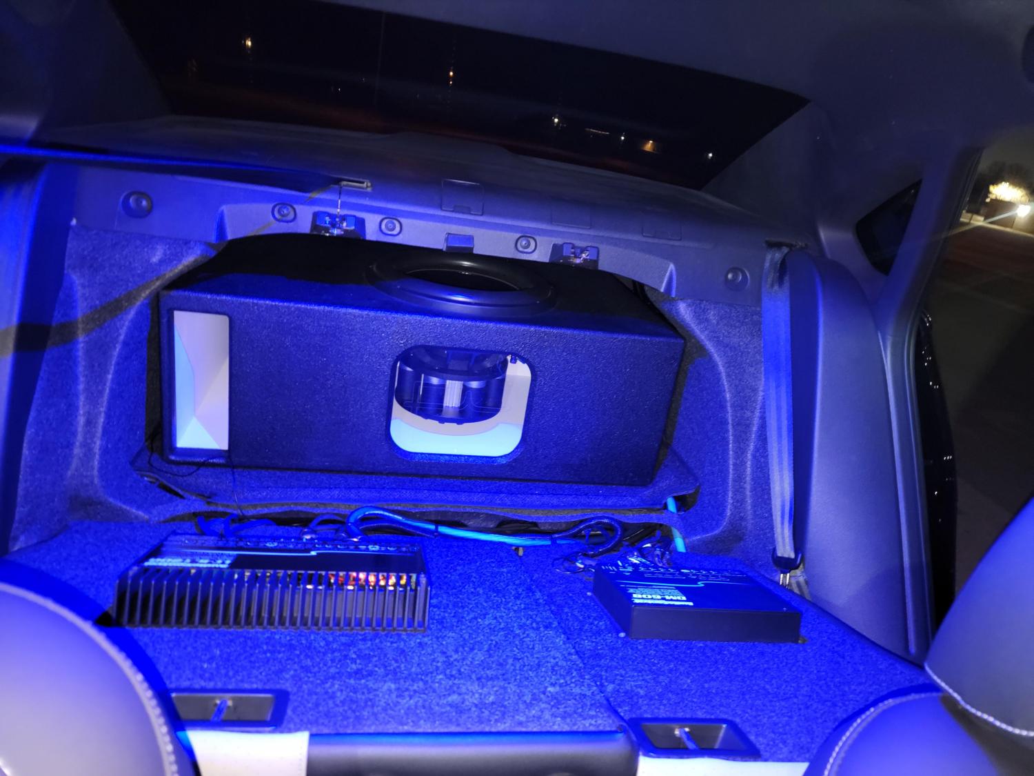

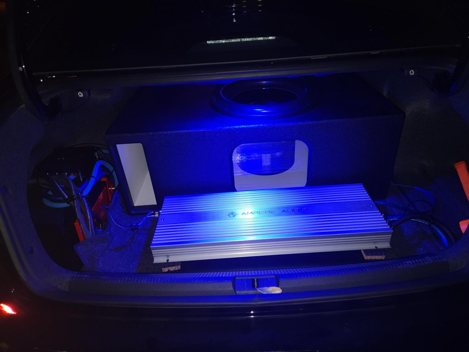

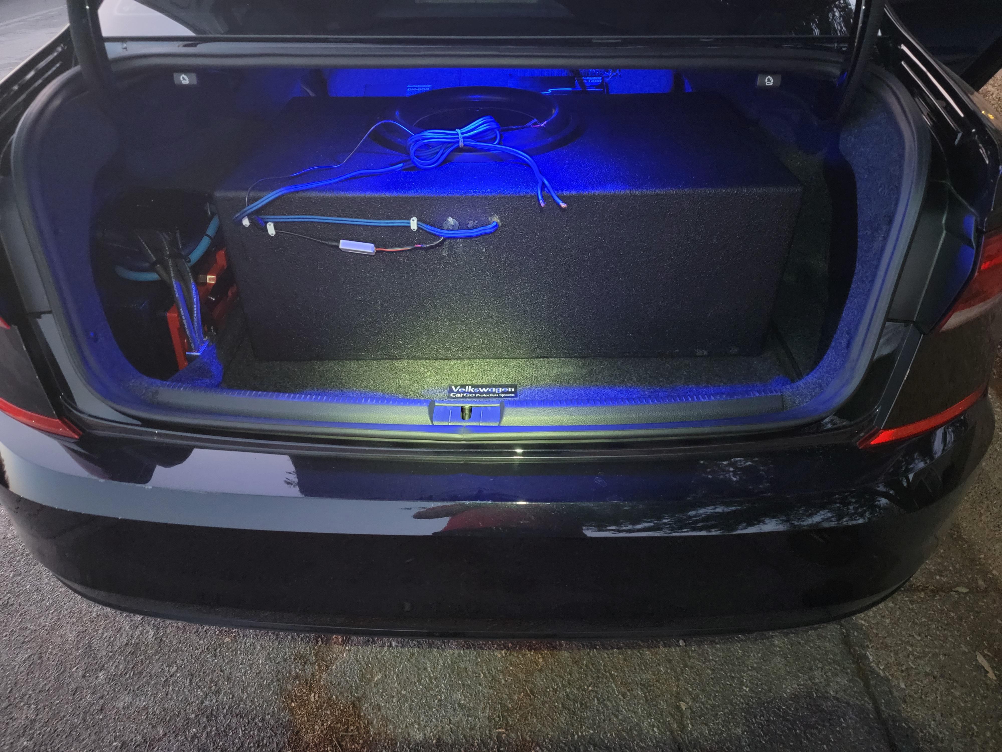

See how bad she is squatting, looks like I got that Cali Lean haha. Don't want to ruin my springs so Im turning the box around to displace some of the weight. I'm also moving the amplifier behind the box so when I open the trunk you will see amp, battery and back of enclosure. With the seats down you will see the front of the enclosure, Plexi window and LEDs show at night.
I turned the box around, didn't do anything else tonight. I'll finish in the am. Amp needs to be relocated still and box pushed all the back, hopefully this helps get more bass in the cabin.
I still have to install the power and ground wires to the amp and it will be playing, I will do that in the AM.

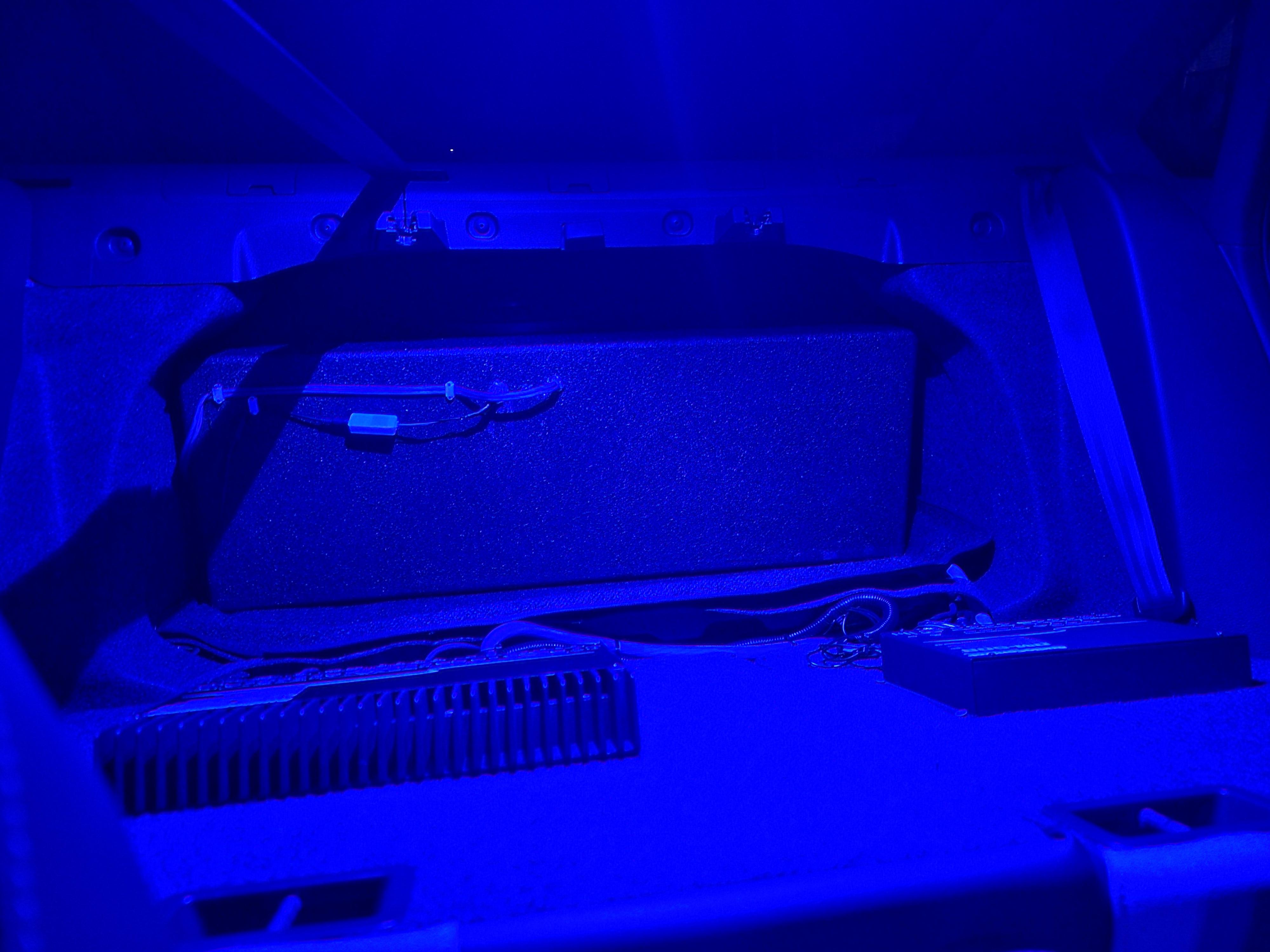

It looks so much better, damn it looks kinda menacing looking back at from the front seats.

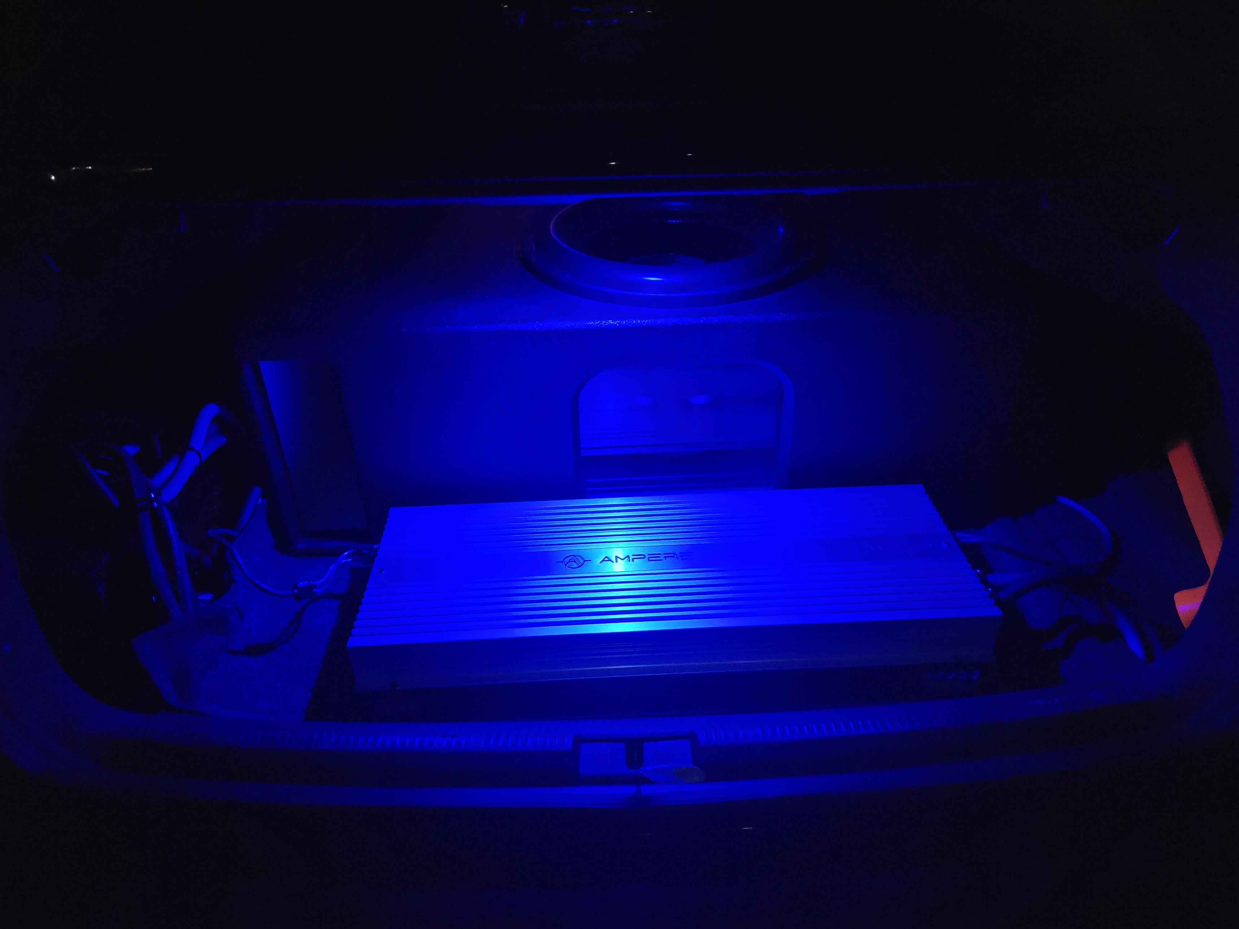

Well that didn't last long, the port definitely needs something to bounce off of. I have to turn the amps gain up more to get the same sound almost and output. Box is back to first orientation but pushed back further towards the cabin and amp is in front of the box now. Will listen in the am when I go get my new tires put on the car.
