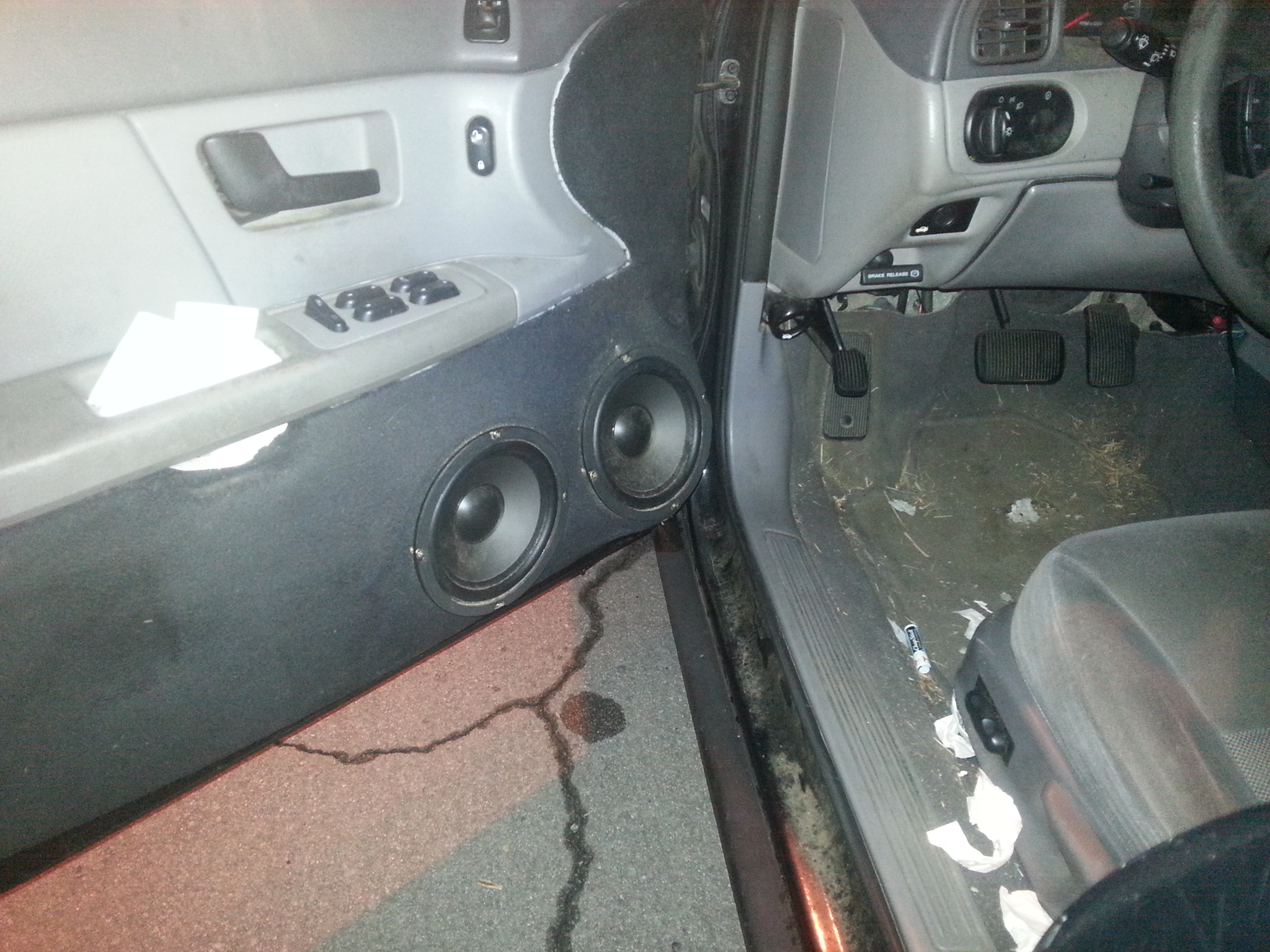

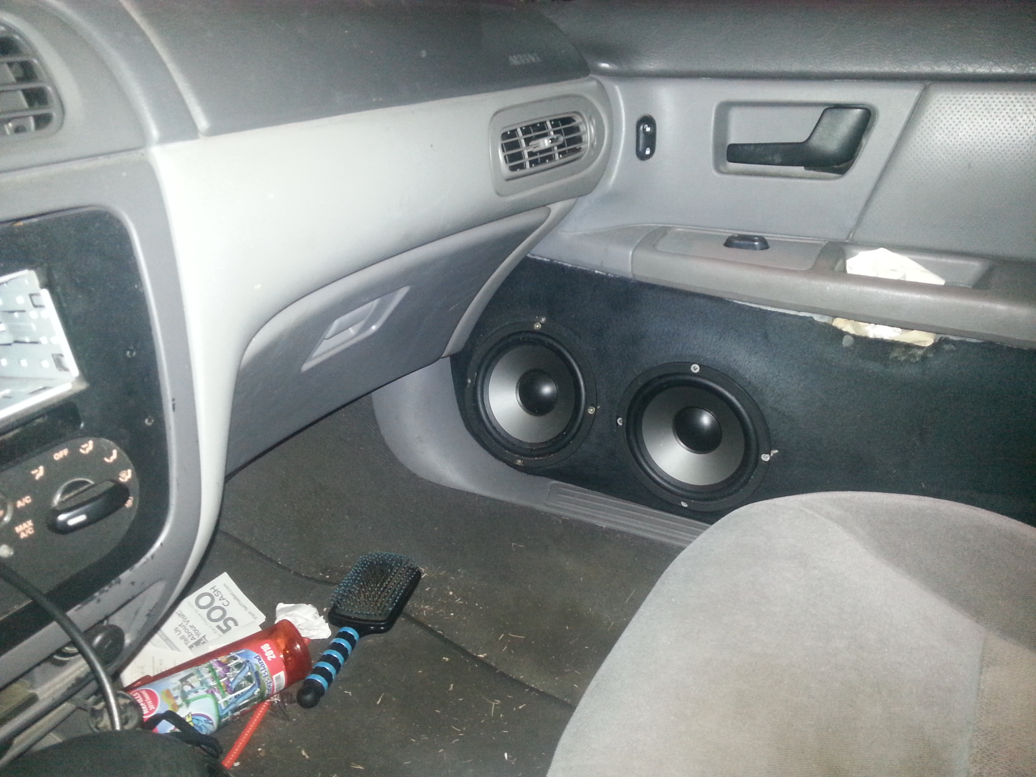

M5 you think it would be better to try tweeters in the a pillars or in the other 6.5 hole in my doors
  • Replies 238
  • Views 33.8k
Definitely pros and cons for both.  Have to balance aiming, frequency response, time delay and reflections.  Obviously related a ton to the vehicle.  My 02 Silverado dash was a hot mess for mounting anything up high, my Escalade great.  Generally between the two cars I run the same mid, but completely different tweeters (both trucks have had multiple mids).  The D2904 which I love (in my Escalade atm) does not sound right in the doors of the Silverado.
So what would I do if I were you?  I'd look at my car.
If this is your car, I'd want the tweeters about where the picture is cut off if putting them on the pillars.
As for the doors, close to the mid wouldn't suck
Obviously your doors might be different with the dual 6.5 spaces...

Mine is pretty much like the second pic
I wouldn't use the 2nd one of those for a tweet.  Only thing you could put in there would be a second set of Evils, just make sure to cross them over to only way lower midbass where the single one could use some extra reinforcement.
Tweeter you could put above the front mid or the pillar.  For you I'd assume you would like it more on the pillar, but am letting the wall portion of the thread influence my decision.
I tried the top corners of the pillar once....was a little overwhelming. Maybe you could do a customization the the pillar similar to a F250's gauge cluster is aimed. Just tossing ideas....
Also have you tried the sit normal in the car as if you were driving & have someone else hold the tweeter in different locations & different aiming angles to hear what pleases your ears. Then figure out how to make it permanent.
When I first did some a pillars I had them at the top of the pillars and didnt really like them . Tried them down wedged in where the a pillars and dash meet and sounded alot better . . . . Guess its going to depend on which ones I get. What size they are .
Yea im pretty much just looking for loud with this build. I just hate when shit is harsh. Like ear piercing . . . . . Not going for anything crazy sound quality  but just Want to be able to hear the front stage while playing the subs loud with not sounding distorted or anything
