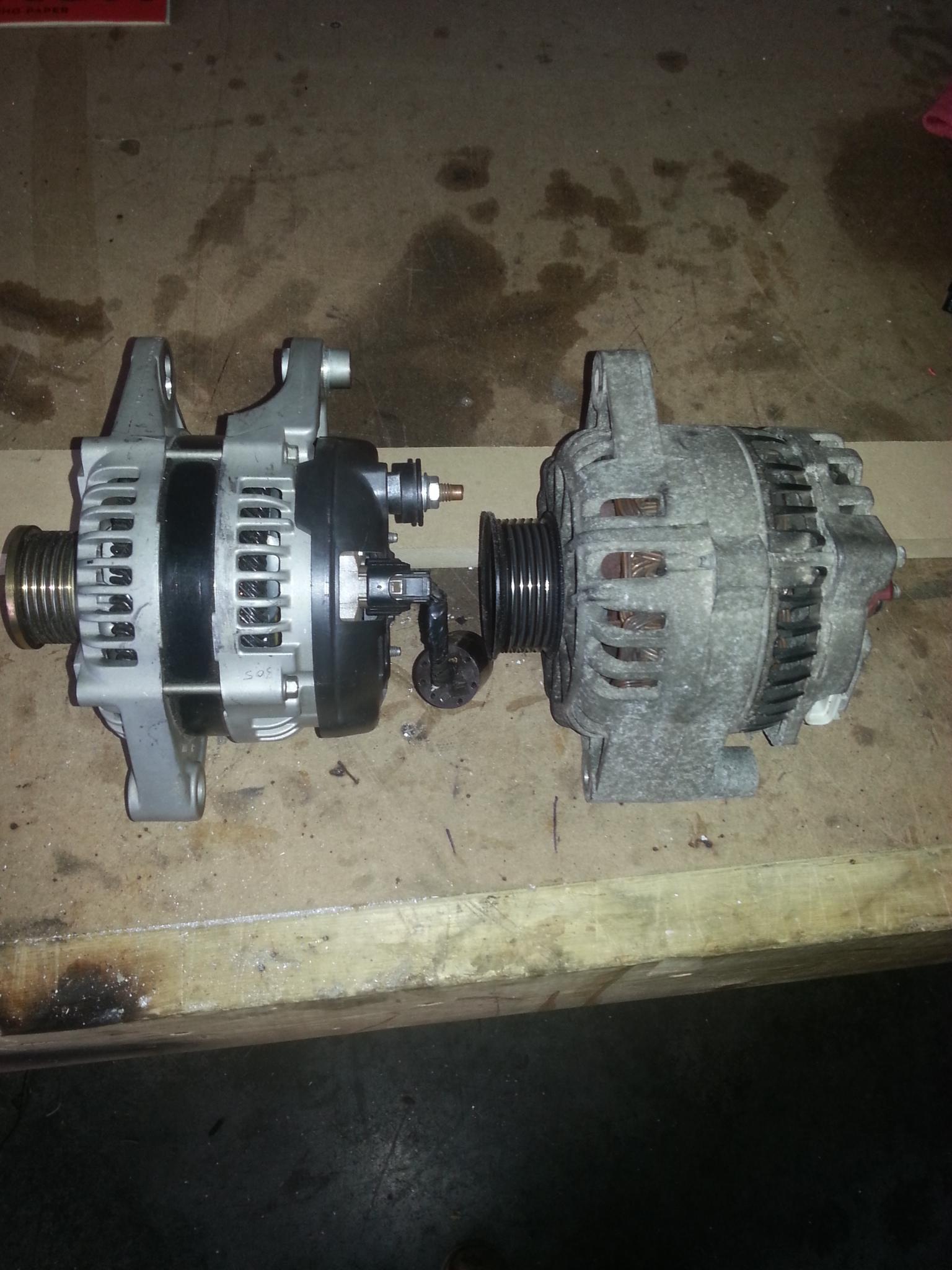

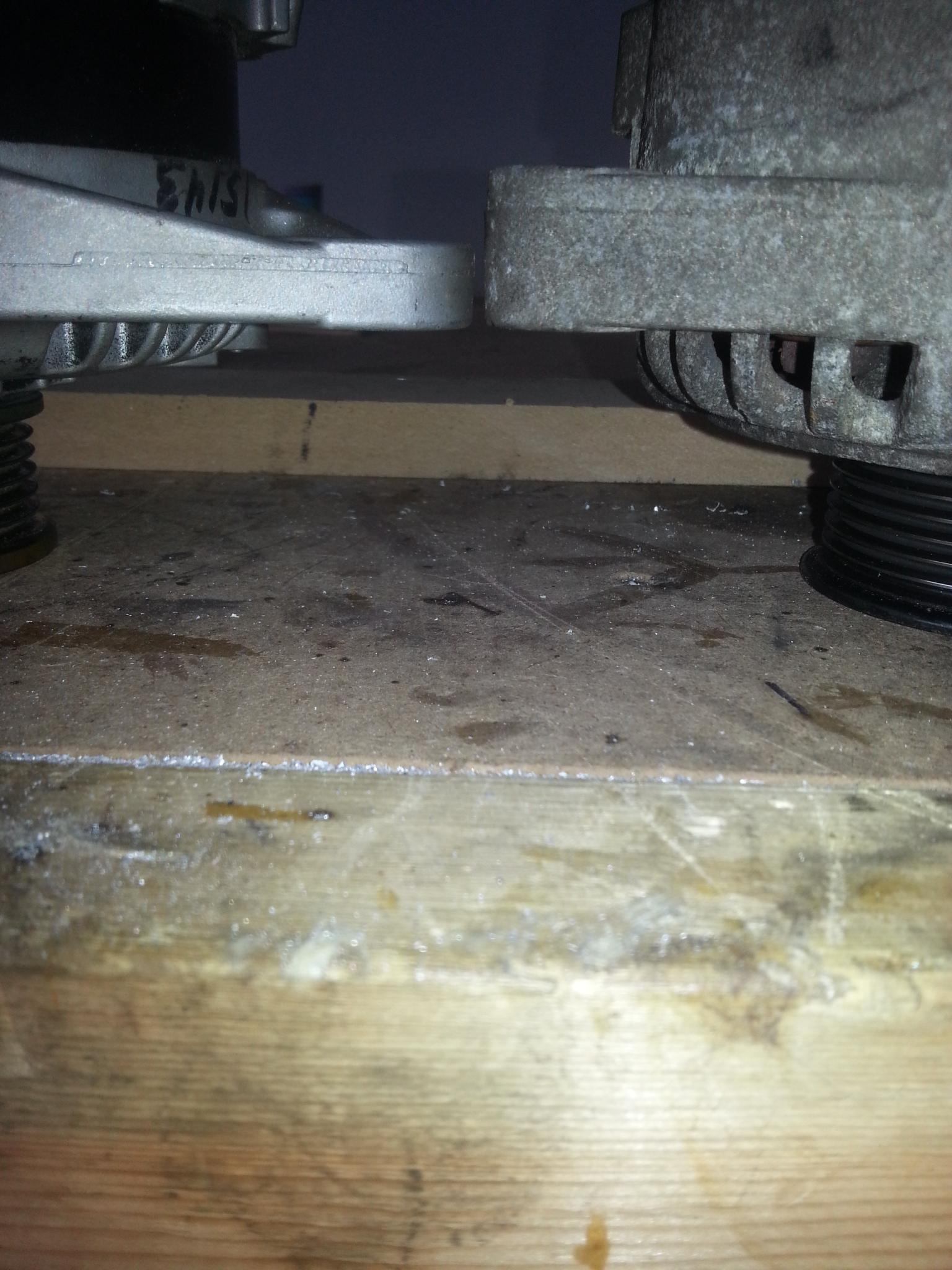

Well stock alt finally went out lol I was waitin for it . Its only be charging in the high 12s for a while now. Luckily I was close to the shop when it did and made it back  going to try to make this ohio gen that I have work today
This is stock next to the ohio gen
Thinking ill just have to use mass washers or some kind of spacer to fill in where the stck alt would have went over to . . If you can tell what I mean from the pic

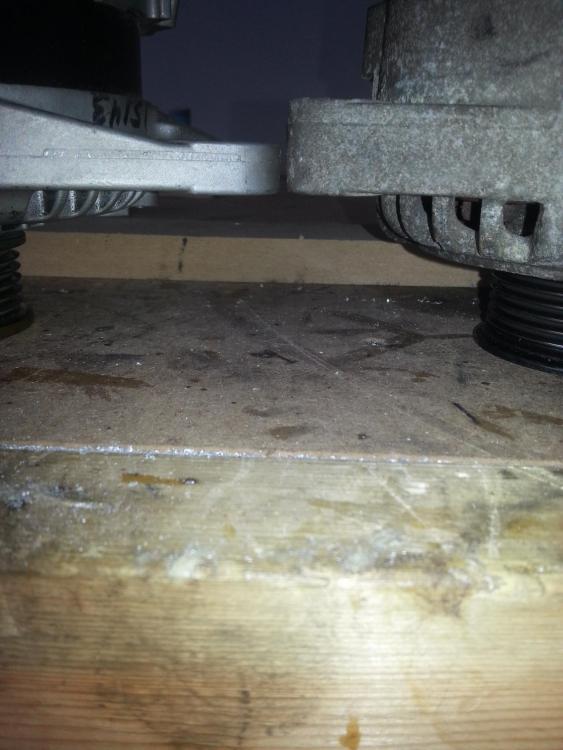

And on the othe side will just have to space here to make them the same size

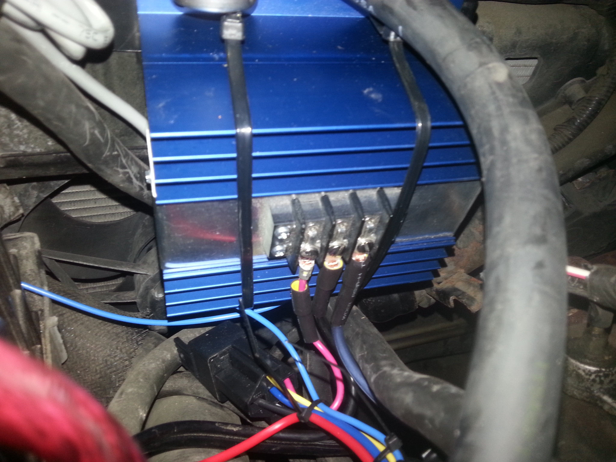

Then I got to worry about the plug
That's how I was planning to use my buddy's as my second on the jeep from his durango. Only reason I havnt messed with it yet is not sure if the stock wiring can handle both at once. Or if I need to regulate one just for the system with one of the transpo boxes. I don't use ac, so all I need to do is fab up a bracket to mount the second where the a.c. pump is and run a smaller belt.

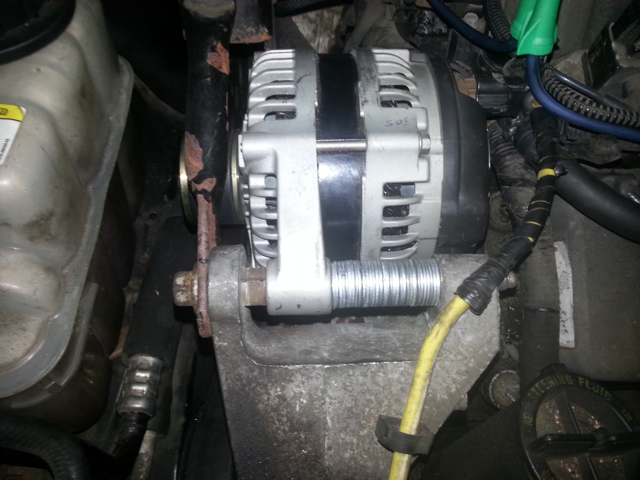

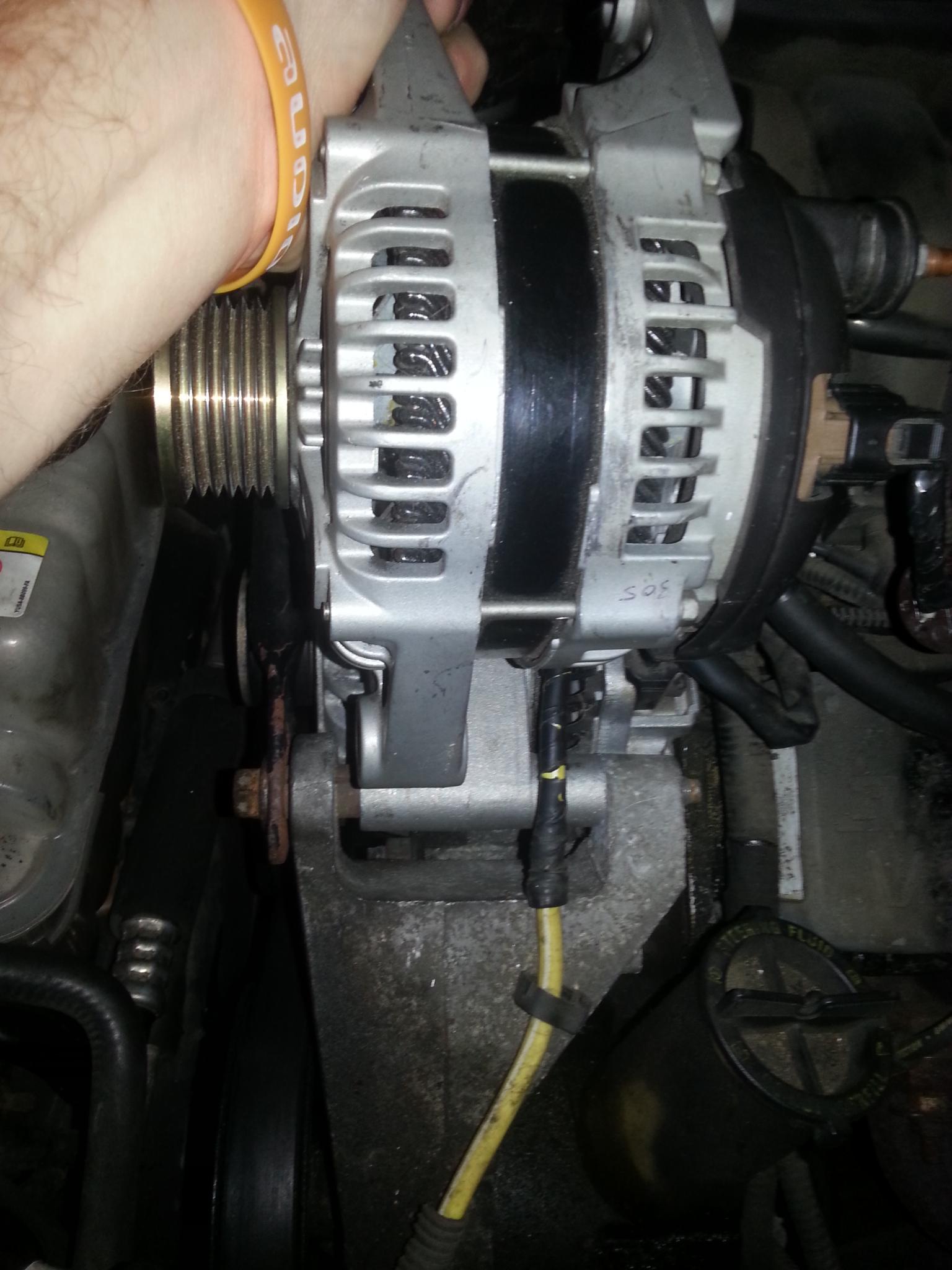

Got the alt to fit perfect but couldnt figure out the wiring . . Going to have to call ohio gen tomorrow and see what wires are on this plug
Actually got it to work

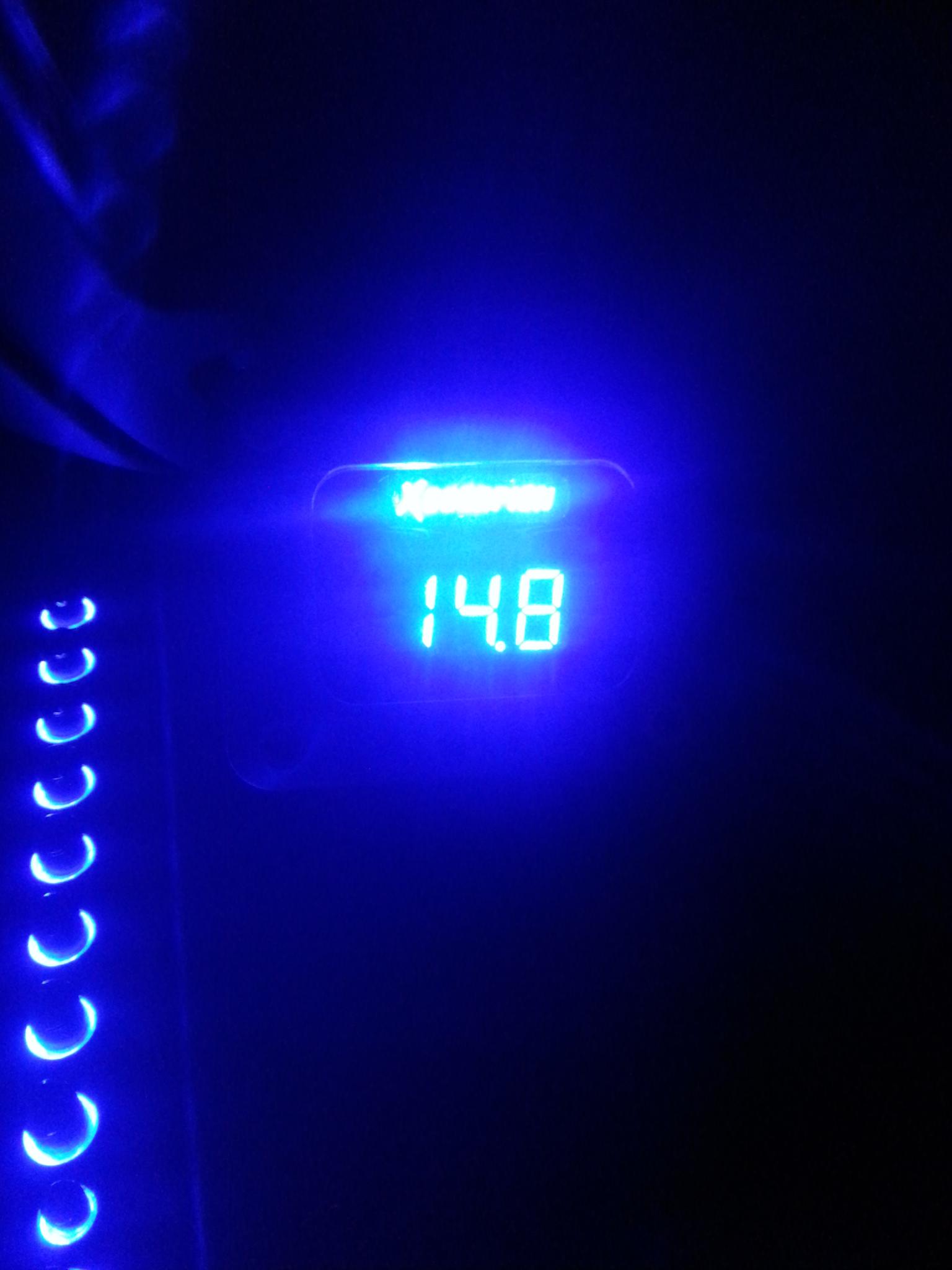

Havnt left the shop yet . Set it to 14.9 so ill check how it holds in a few once I leave
Havnt seen this high in a long time lol.  Its nice
Didnt see under like 13.8 on the way home going full tilt . . But the amp is really far down from just having the stock alt on before . . Ill do some testing tomorrow . Turn up some shit lol
Turned the gain up . Forsure can tell a difference. And still took like almost a whole song to even see 13.9 . Holding voltage like crazy . .But dont know how much power im really putting to the zcons though

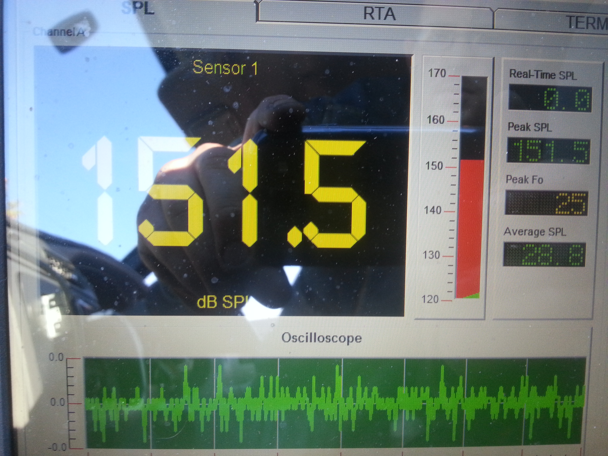

Has anyone had a problem with the bass turning the volume knob on your head unit? Need to figure something out. Made my tweeters pop a couple times yesterday cause my volume went from 30 to 34

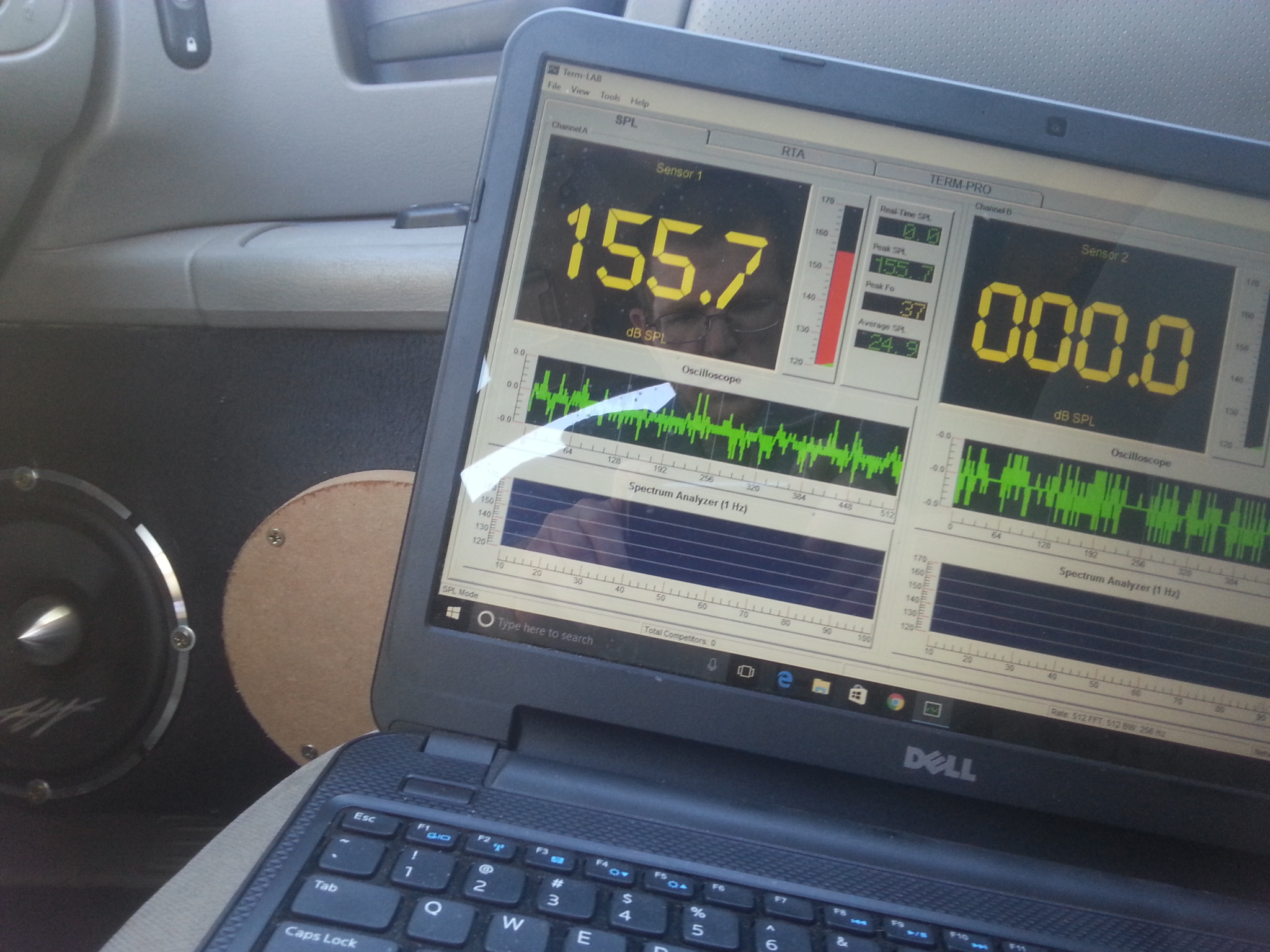

On the dash

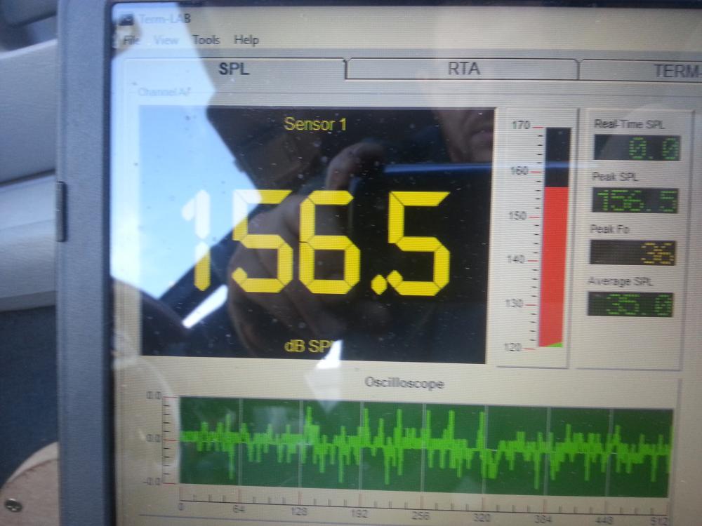

At 25 hz on the dash
151.5 or over from 25hz to 55hz
And never seen below 13.2 while I was metering
