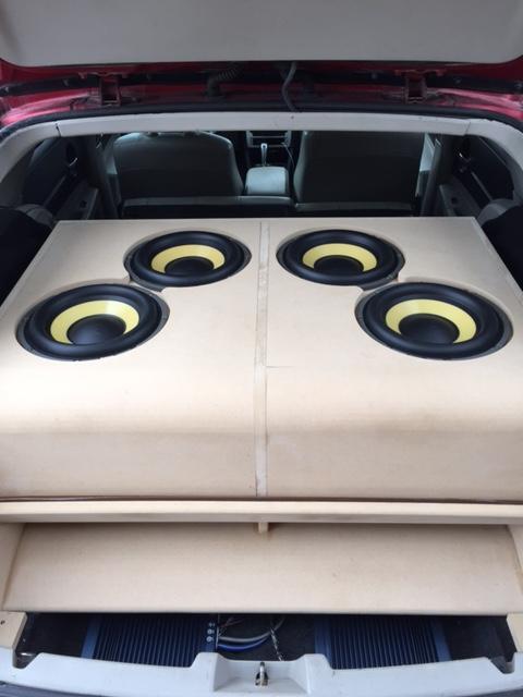

January 2, 20188 yr 1 hour ago, Thumpper said: this is my first run with these subs... they didn't really take to the flat tuned enclosure this new enclosure is tuned 3 hz higher ... the rear firing port will increase output ...I have 7 fans circulating air under the enclosure and the 1 1/2" of space below this one will allow more air to cool the amps Oh ok gotcha. Did you graph out the new Box to get a prediction of the output. How many man hours are in the box? Looks intricate but it seems you built it pretty fast
January 2, 20188 yr Author Popular Post They graphed well at 30hz but they sounded a bit crunchy on the upper notes and the power handling was a bit lacking i stuffed the 30hz enclosure taking it from 2.25cf3 @30hz to 2.0cf3 @32hz per side it made some improvement on power handling and output the new enclosure should fix everything i wouldn't run these subs sealed.... they don't like to be choked out very good SQ subs ..... i'v felt and heard notes over the last couple weeks that I have not experienced in a while

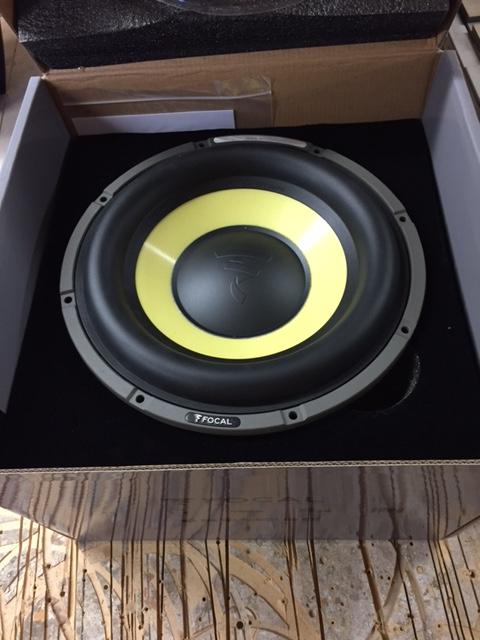

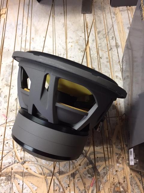

January 19, 20188 yr Author Popular Post The Audiofrogs did not pan out... they can not handle any abuse if you drive them hard the surrounds cut on the trim ring around them.... all 4 were sent back and I upgraded to the Focal Kx 25
January 21, 20188 yr On 1/19/2018 at 12:48 PM, Thumpper said: The Audiofrogs did not pan out... they can not handle any abuse if you drive them hard the surrounds cut on the trim ring around them.... all 4 were sent back and I upgraded to the Focal Kx 25 Wow man, the new focal subs didn't cost you an arm and leg?

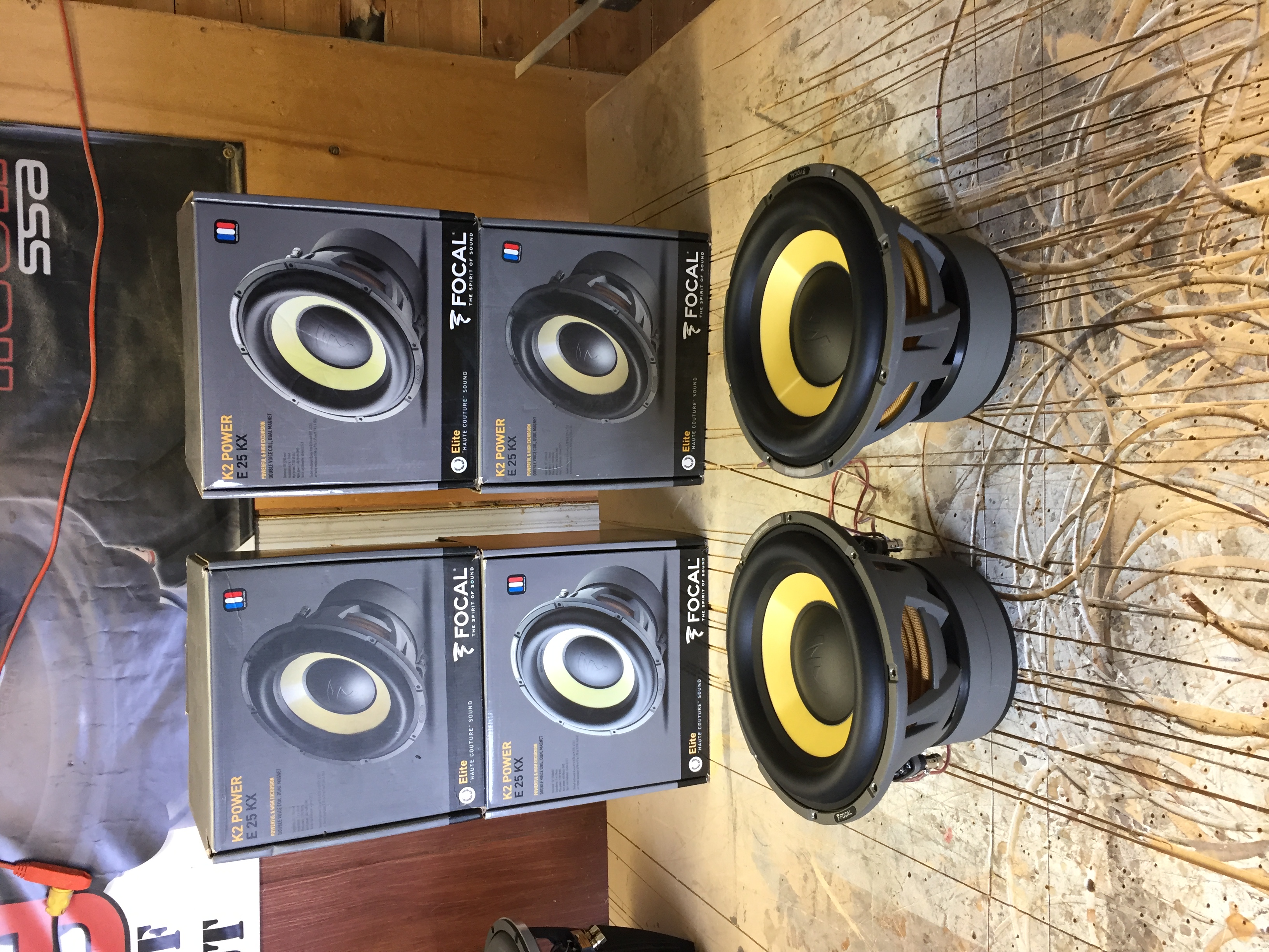

January 21, 20188 yr Author Kind of..... this system is getting expensive I got 4 Focal Kx 25's and a Mosconi Zero One to power them......also have the Focal Utopia Be #7 component kit on the way the rear firing enclosure is a perfect fit , I got 2 Focals in the drivers side of the enclosure and the other 2 will be here Monday or Tuesday
January 25, 20188 yr Author Popular Post I got the 4 Focals installed ( I'll take pics once the pie plate snow flakes stop falling) if I had a chance to listen to both the Audiofrogs and the Focals before I purchased I would have picked the Focals ...they sound deeper , handle more power , better output and are more ridgid on the note separation .. the cones on the Focals are VERY acoustically dead , they dampen extremely well ... they have a unique sound to them

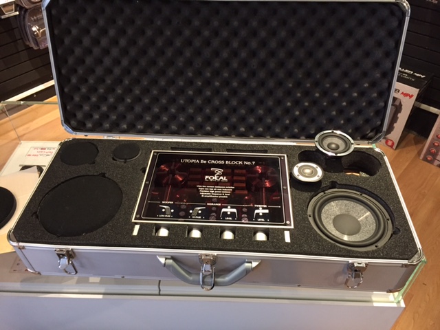

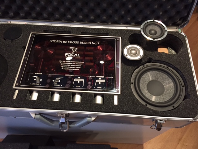

January 27, 20188 yr Author these subs are really starting to impress me , very punchy . tight and accurate with the combination of subs and amp this is the best sounding bass I have had in a while... VERY HAPPY my component set showed up this morning....... if they sound as good as the subs I'm in for a treat these things are going to be bi amped with a pair of Soundstream REF2.640's thru the crossblock
January 28, 20188 yr 5 hours ago, Thumpper said: these subs are really starting to impress me , very punchy . tight and accurate with the combination of subs and amp this is the best sounding bass I have had in a while... VERY HAPPY my component set showed up this morning....... if they sound as good as the subs I'm in for a treat these things are going to be bi amped with a pair of Soundstream REF2.640's thru the crossblock Man thats some Crazy Packaging lol
January 28, 20188 yr There's some serious money invested here lol. Absolutely beautiful tho. Great work man

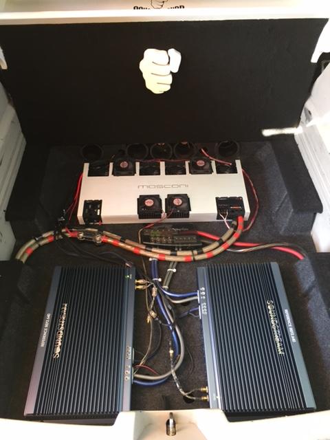

January 29, 20188 yr Author I thought about the $$$ and even said to myself " this is stupid " but I heard the Focal #6 kit with cross block and it was just unreal ... this #7 kit should be Just sick i never would have gone FOCAL subs if it wasn't for the Audiofrogs committing suicide .... it was a domino effect just waiting for the snow to lay off so I can start the pillar pods for the utopia mids and tweets , the enclosure needs cosmetics and the wiring in this system is a cluster fk of colors from my last 3 systems so it's getting a complete re wire The amp rack needs some fiberglassing around the cooling fans
January 29, 20187 yr It's defiantly one I'd like to hear. Awesome work on the enclosure as well. I wish I had the patience

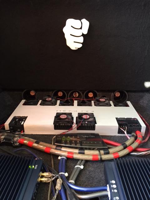

January 30, 20187 yr Author Here's a before pic of the amp rack.... the enclosure completely covers 80% of the area , the fans along the back and the extra fans on the Mosconi is what it took to keep it cool during the summer heat , with this new enclosure having an extra 1.5" of space underneath I think I can ditch the extra fans on the amp i have to clean it up and make a space somewhere for the cross block
