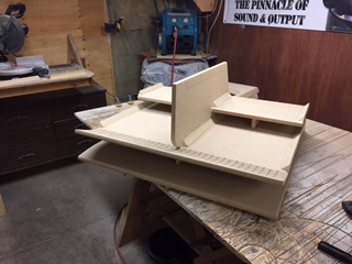

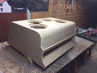

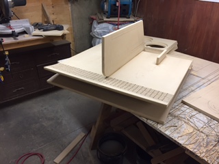

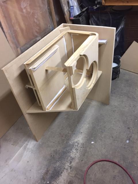

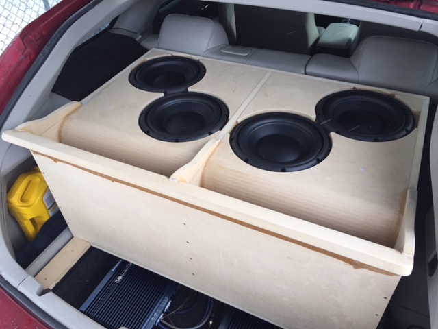

Posted November 5, 20178 yr Popular Post I have not built anything out of the norm worth posting in a while.... how many single 12" box builds does one post ?? this ones slightly different...a quad of GB 10D4's.... my first run in with Audiofrog and starting with 2.25cf3 tuned at 30hz with a 7% port velocity per chamber no cosmetics until the subs are broken in and I'm happy with the tuning

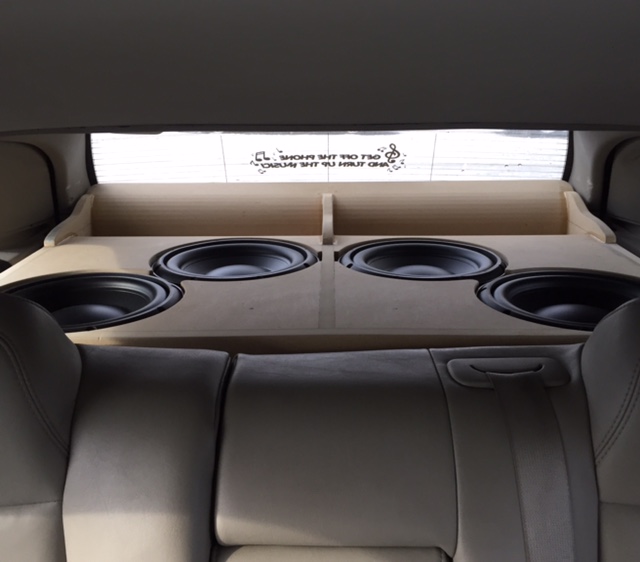

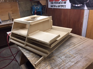

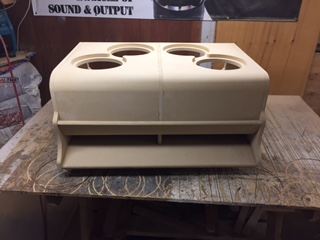

January 2, 20187 yr Author Popular Post this enclosure is 2.25cf3 per chamber tuned at 33hz subs up , port back once again , no cosmetics until I'm happy
January 2, 20187 yr Is it going in the same vehicle, if so what were your goals in creating this enclosure over the other.
January 2, 20187 yr Author 9 hours ago, ManzKea said: Is it going in the same vehicle, if so what were your goals in creating this enclosure over the other. this is my first run with these subs... they didn't really take to the flat tuned enclosure this new enclosure is tuned 3 hz higher ... the rear firing port will increase output ...I have 7 fans circulating air under the enclosure and the 1 1/2" of space below this one will allow more air to cool the amps
