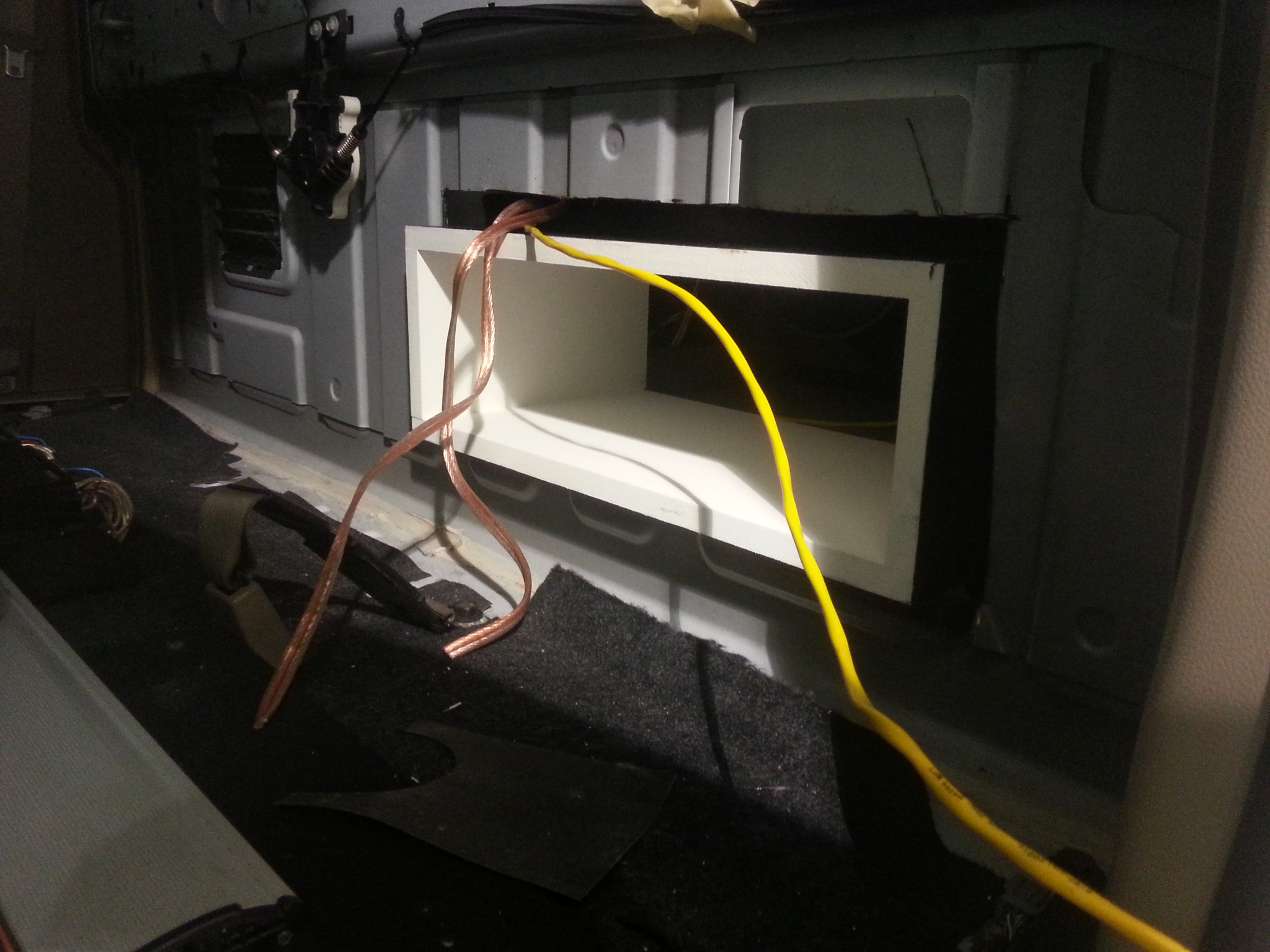

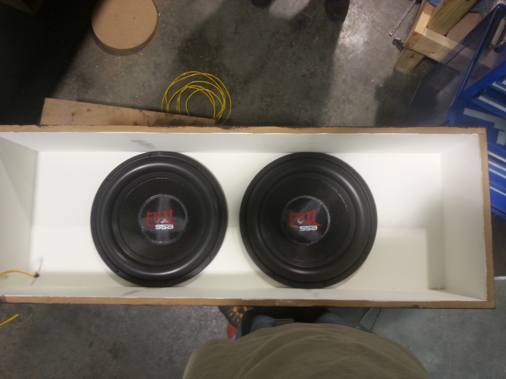

January 24, 20187 yr 2 hours ago, frogcase2002 said: I wouldnt do it if you cant seal it off all the way It’ll be sealed. Just saying thought there could be some cancellation due to the sub and port being larger than I could cut the hole.
January 24, 20187 yr Author 1 hour ago, ManzKea said: It’ll be sealed. Just saying thought there could be some cancellation due to the sub and port being larger than I could cut the hole. Dont think I would do Ported If I couldnt cut It out the Same size as the enclosure
January 25, 20187 yr Oh ok good to know. Hearing that from someone more experienced. On 1/23/2018 at 5:17 PM, frogcase2002 said: Dont think I would do Ported If I couldnt cut It out the Same size as the enclosure

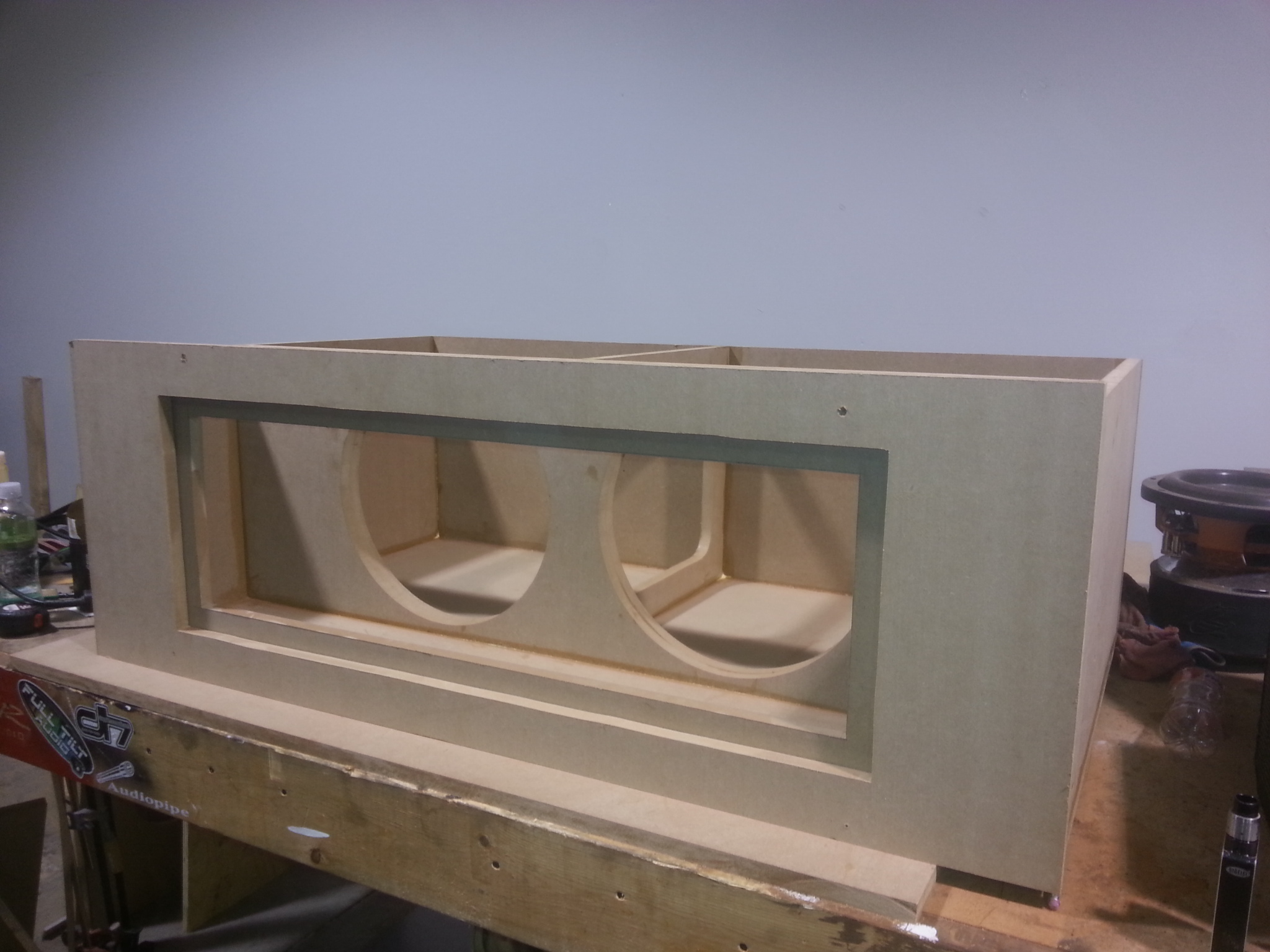

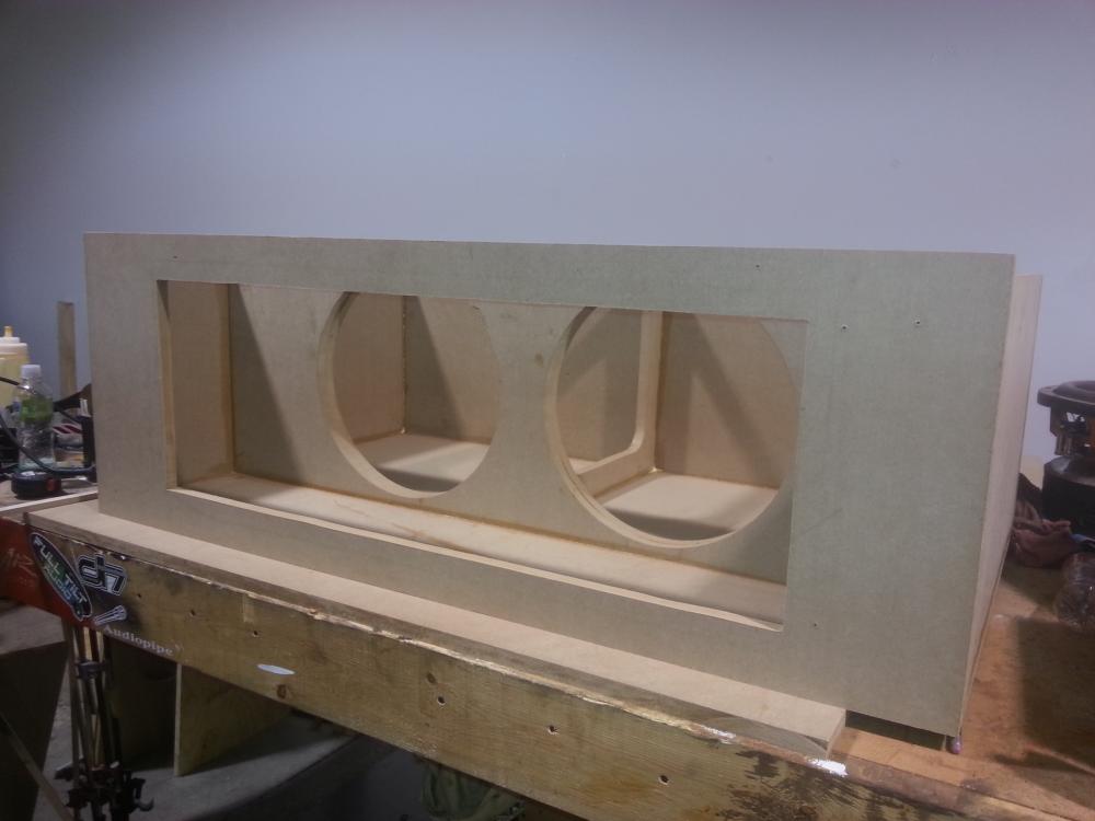

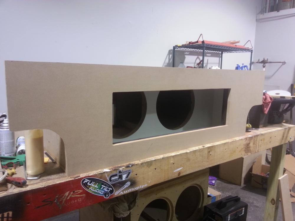

January 25, 20187 yr What if I was to make it like yours. How the sub is facing the plexiglass glass. And I make it a little tunnel into the cut out? I guess that’s like a 6th order idk. Would that little tunnel make a drastic difference ? And whats eats your projection on the out out of the box? What kind of ratio did you design it around

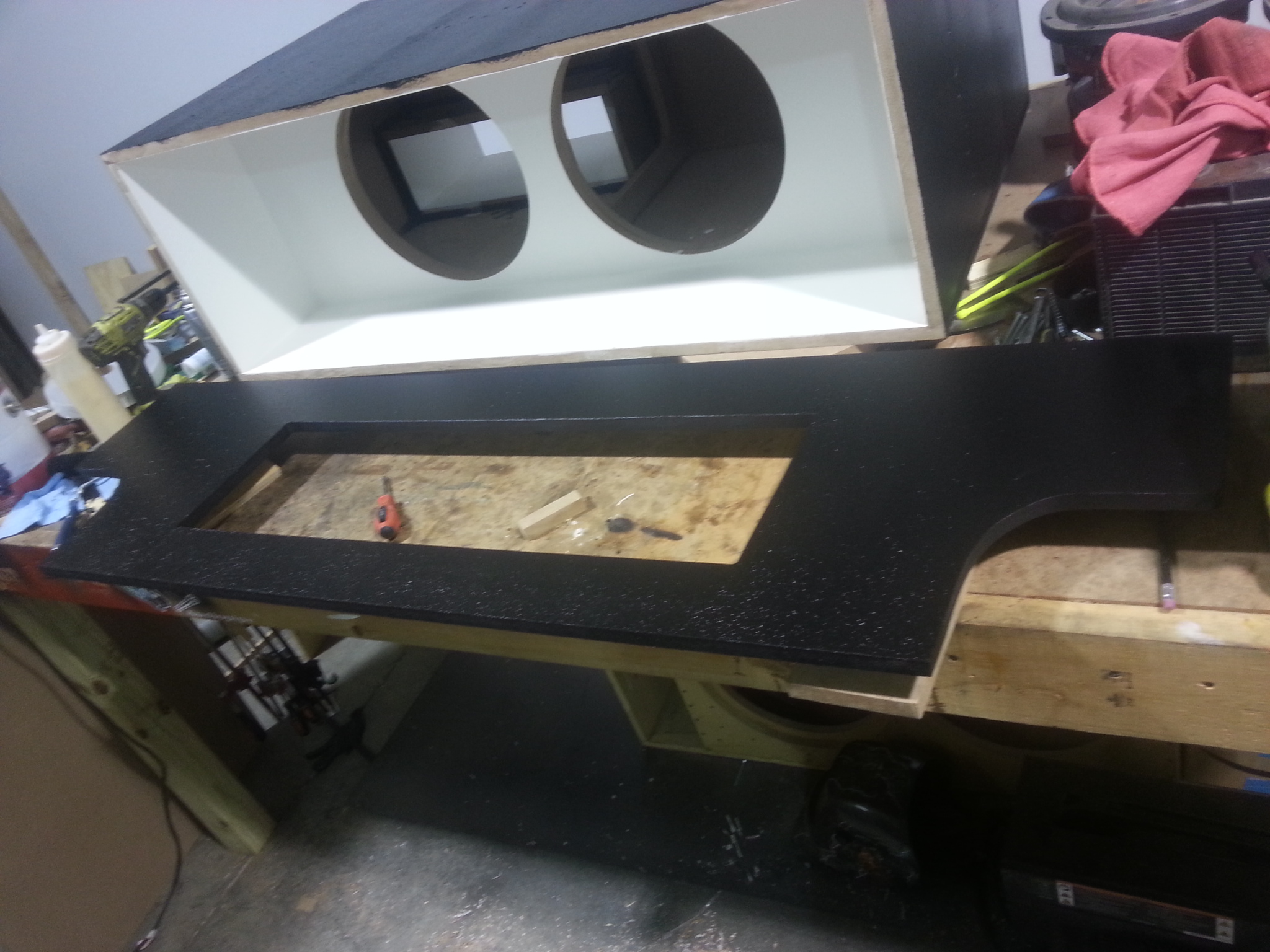

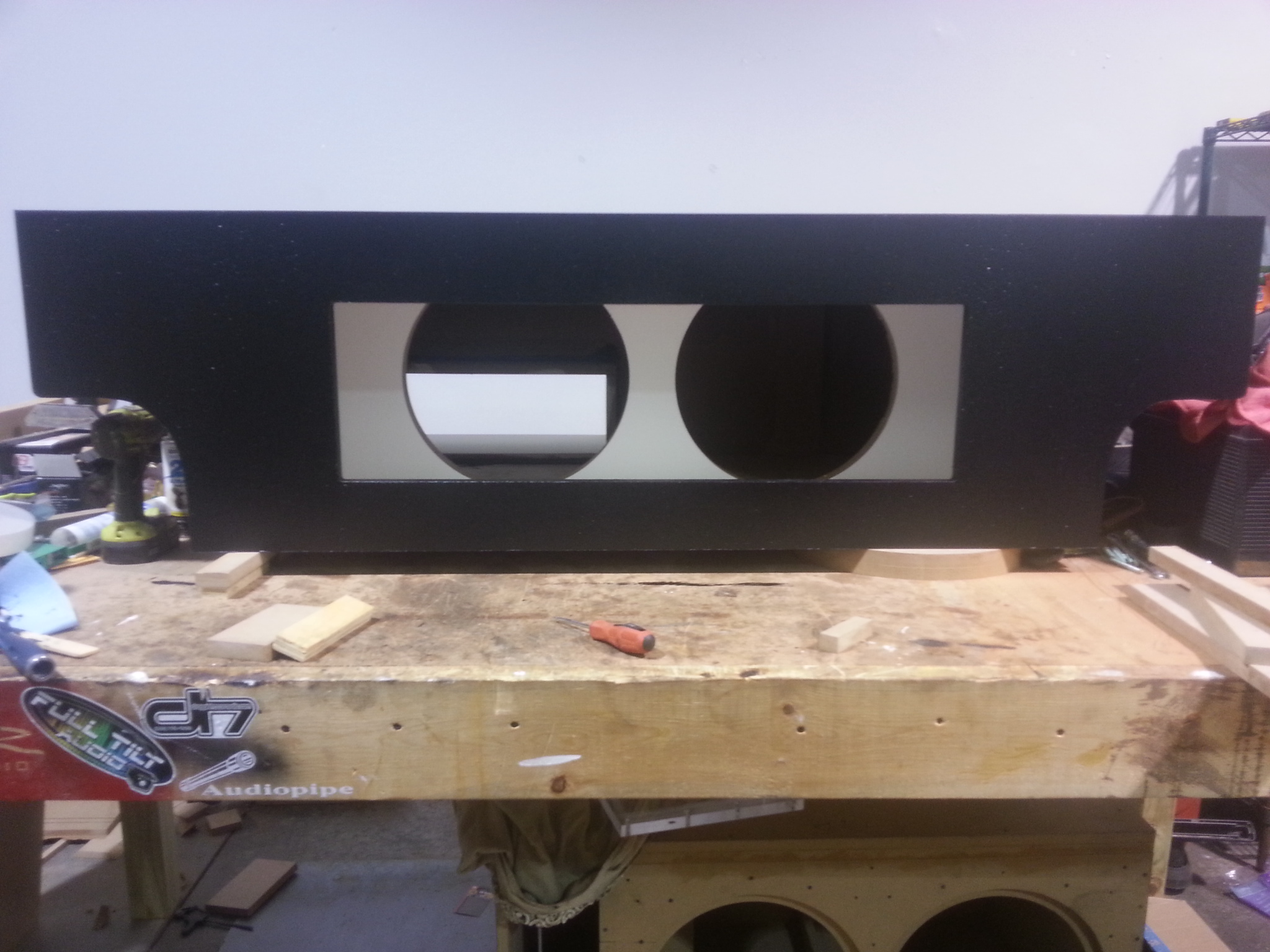

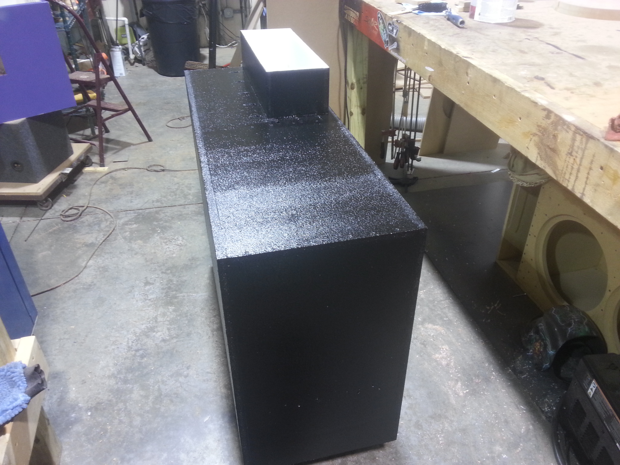

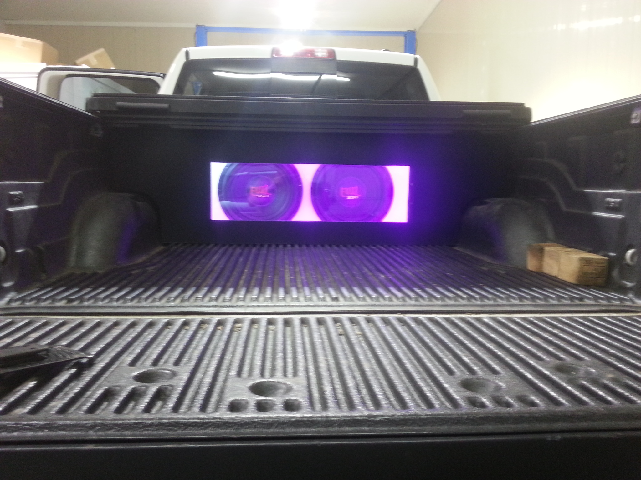

January 25, 20187 yr Author Going to use some roll on bed liner to protect the enclosure from weather

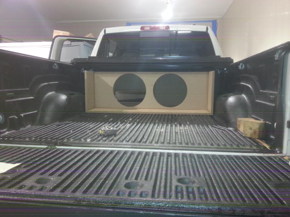

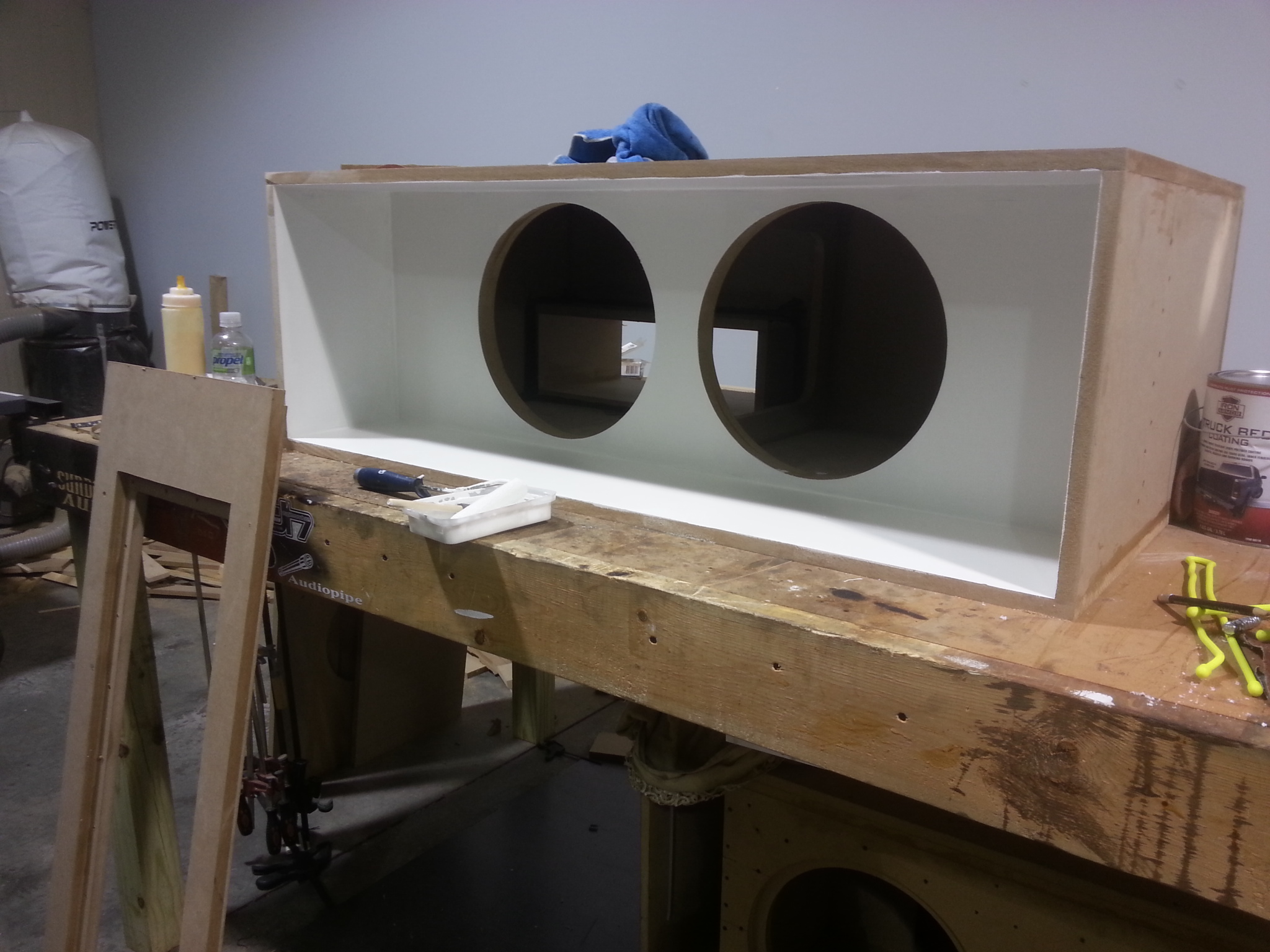

January 25, 20187 yr Author It would be different if it was my build . Had to work with the room dude wanted to use. Ended up with about 7 cubes net in the ported section which left about 3.5 in the sealed. Wasnt much I could do with the space available and size of the subs. . If it was mine I would have made it as big as possible so I was able to go in and experiment with different sizes of each section. Change port size. Tuning
January 29, 20187 yr Author Would have it playin if the dam accordian boot would have gotten here. Ordered it almost a week ago. Coming from the same state .. says it will be here tomorrow though
