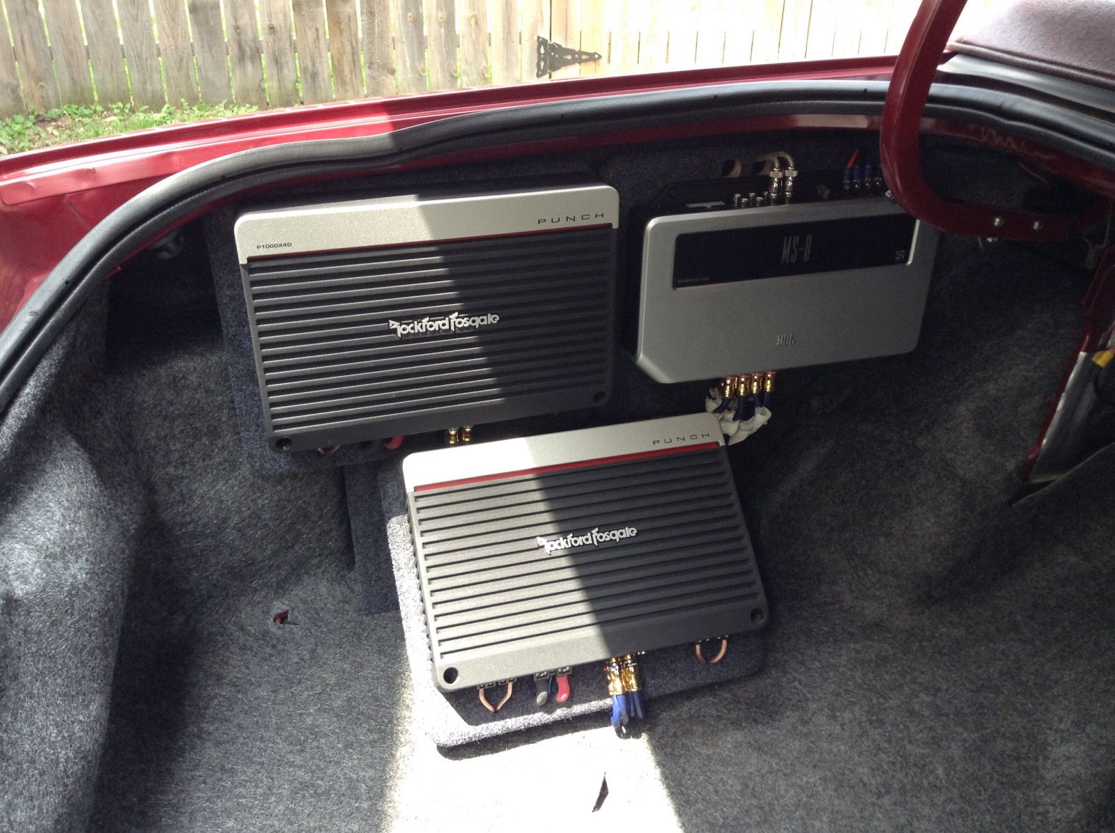

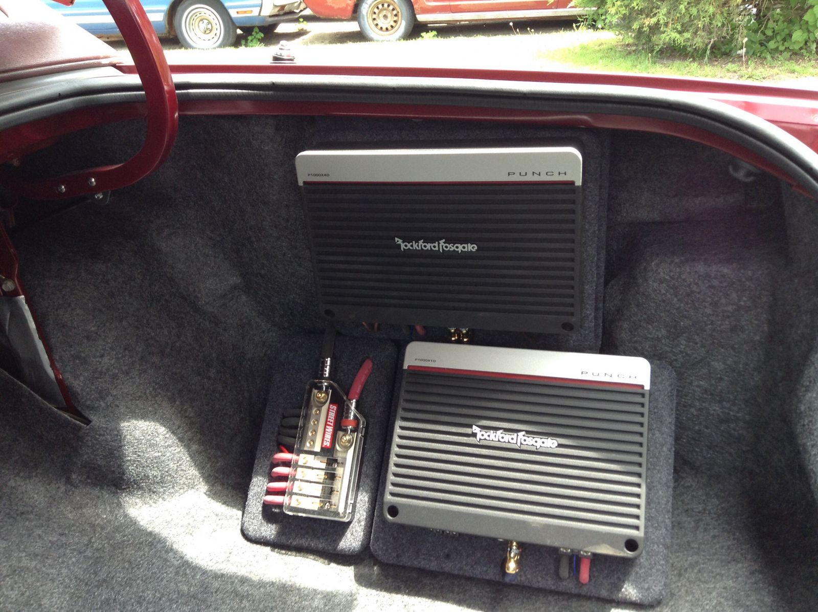

Amp rack, which as long as i didn't fuck anything up and it all works correctly should be done.   Going back to that fabrication issue, if you look closely at the wires you can see a few of my mistakes.  For starters I drilled the hole for the ground at the D-block too close to the block, I didn't account for the connector and left too tight of a bend for the wire to make.  I also purchased new RCA's, which are a little thicker than those I had planned to use when I first laid out the rack last year.  So in addition to having to take a Dremel and enlarge all of the RCA holes, the bends for the wire were a bit too tight in a few places for the RCA's as well...Oops !!

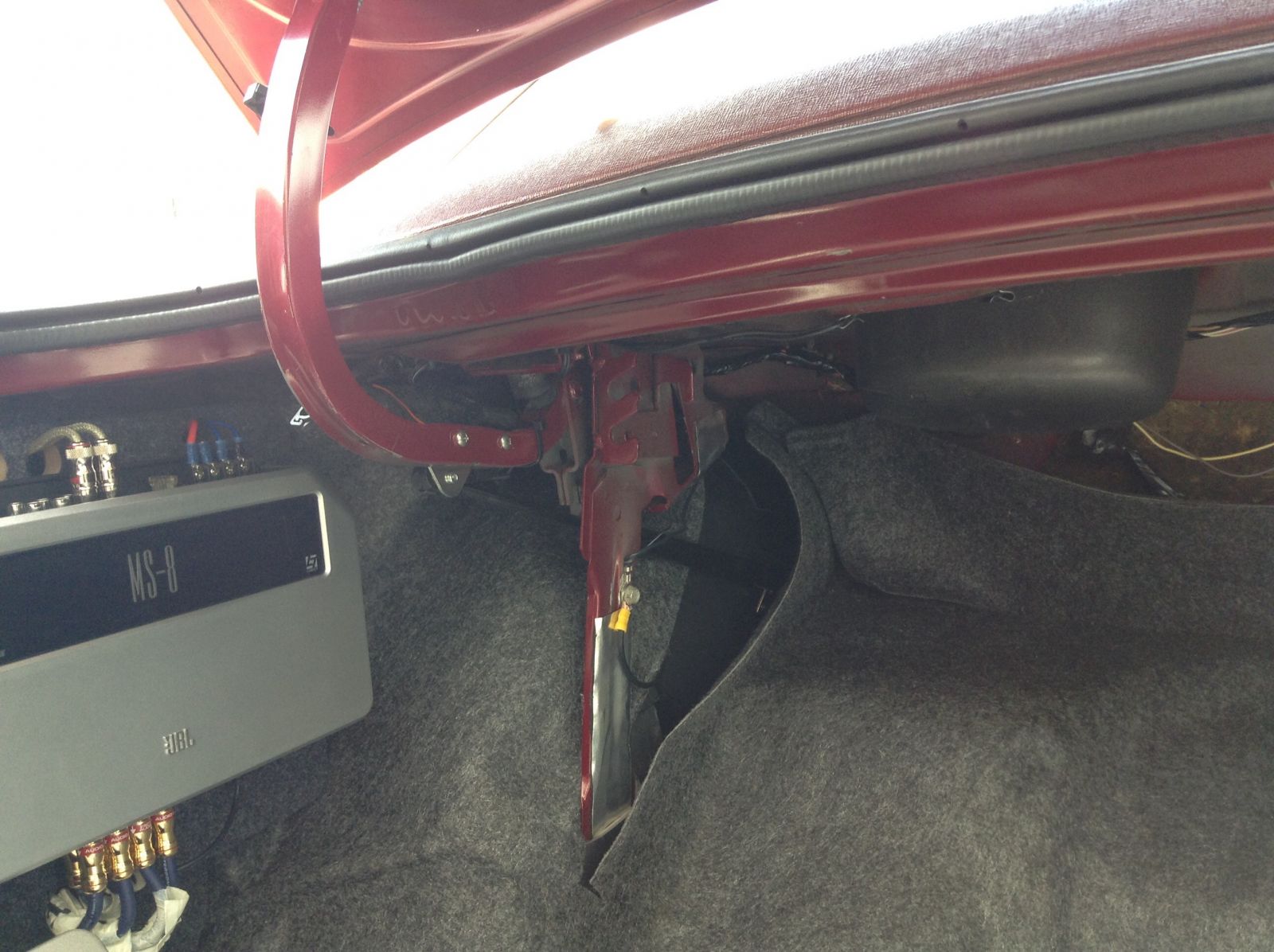

Kinda hard to see in this pic, but I had also replaced the torsion bars in the trunk for struts.  Can't have those pesky torsion bars in the way wink.png  If I ever get a sub installed, you'll see why they had to go.

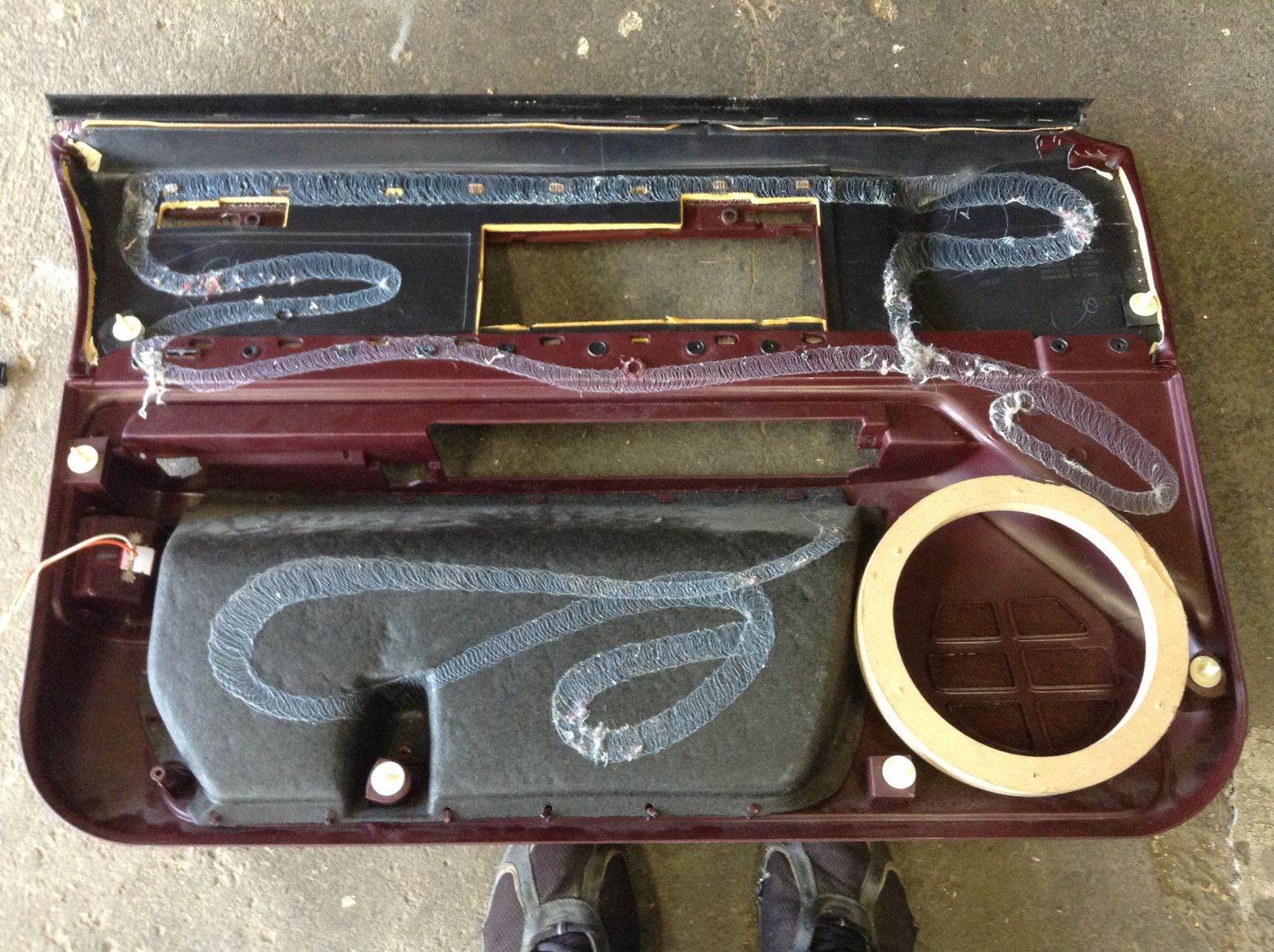

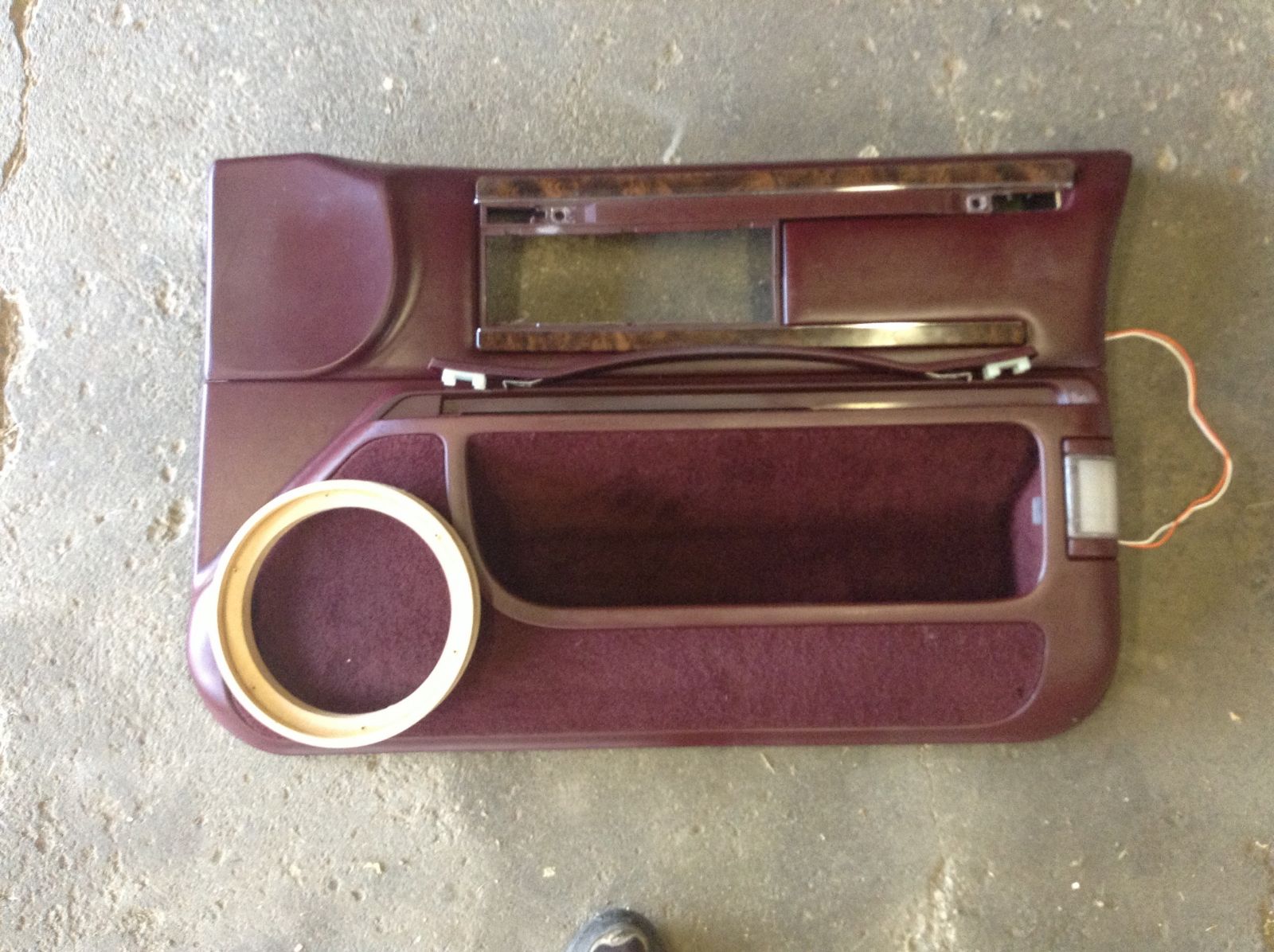

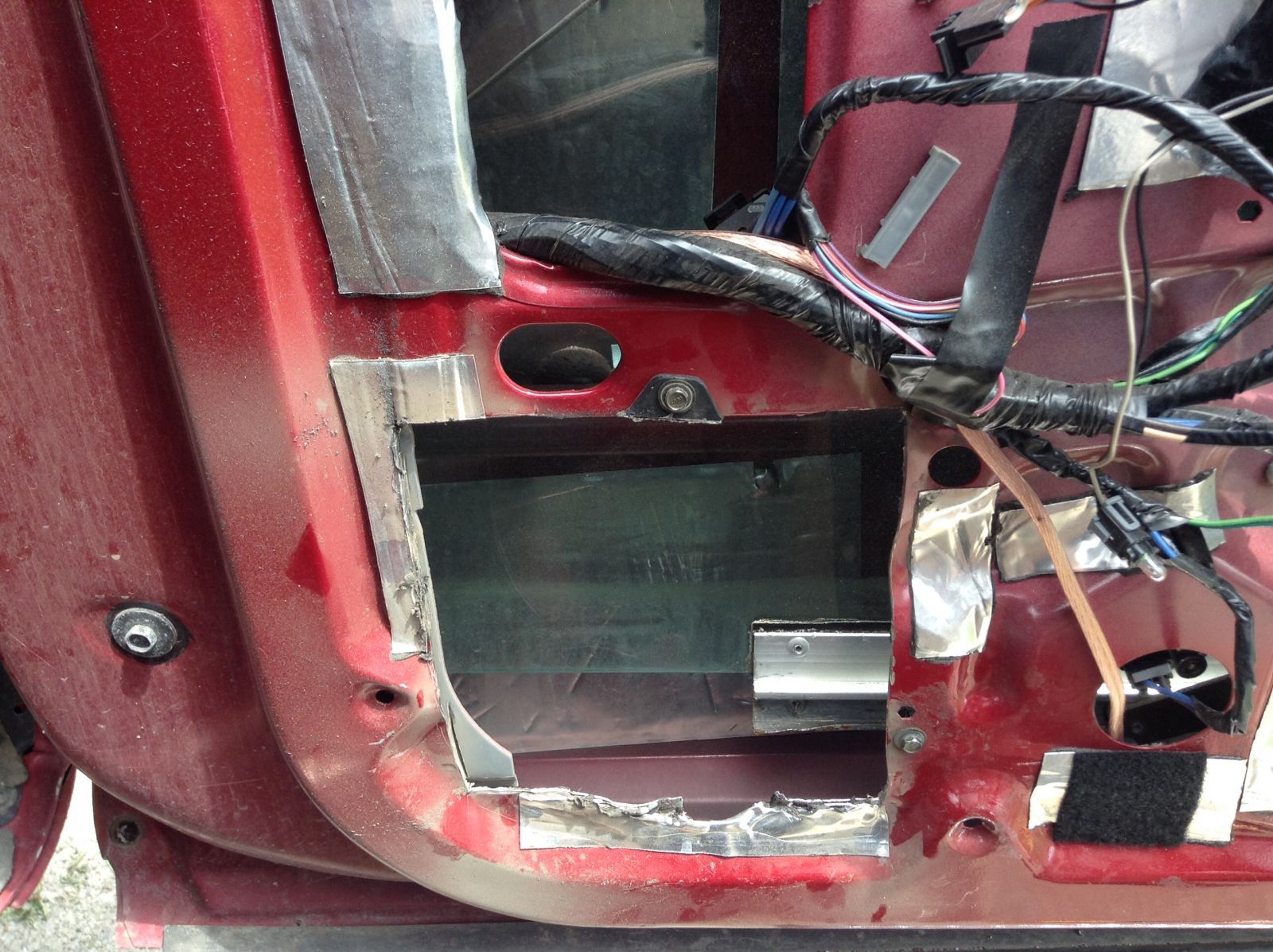

With the trunk taken care of (except for the sub, but that'll come last) now moving on to the midbass in the doors.  The Trio8's were designed for home audio, they are prefer an enclosure.  Additionally, they are capable of moving some serious air.  So in order to try to bring their response more in line with my goals, and to reduce door vibrations/resonances I'll be 'glassing ~.5cuft sealed enclosures for the door which should put the drivers in an alignment of right around .7 Qtc.  They however are not shallow mount, so first I needed to make cut some metal to make room for the motors smile.png  The ultimate plan here is to make a little "box" that recesses into the door that will fit basically the motor, the rest of the enclosure to be where the map pocket would be.  No pics of the rest of it yet, but here's the hole I cut...don't worry about that little guy in the bottom left corner, he's been taken care of.

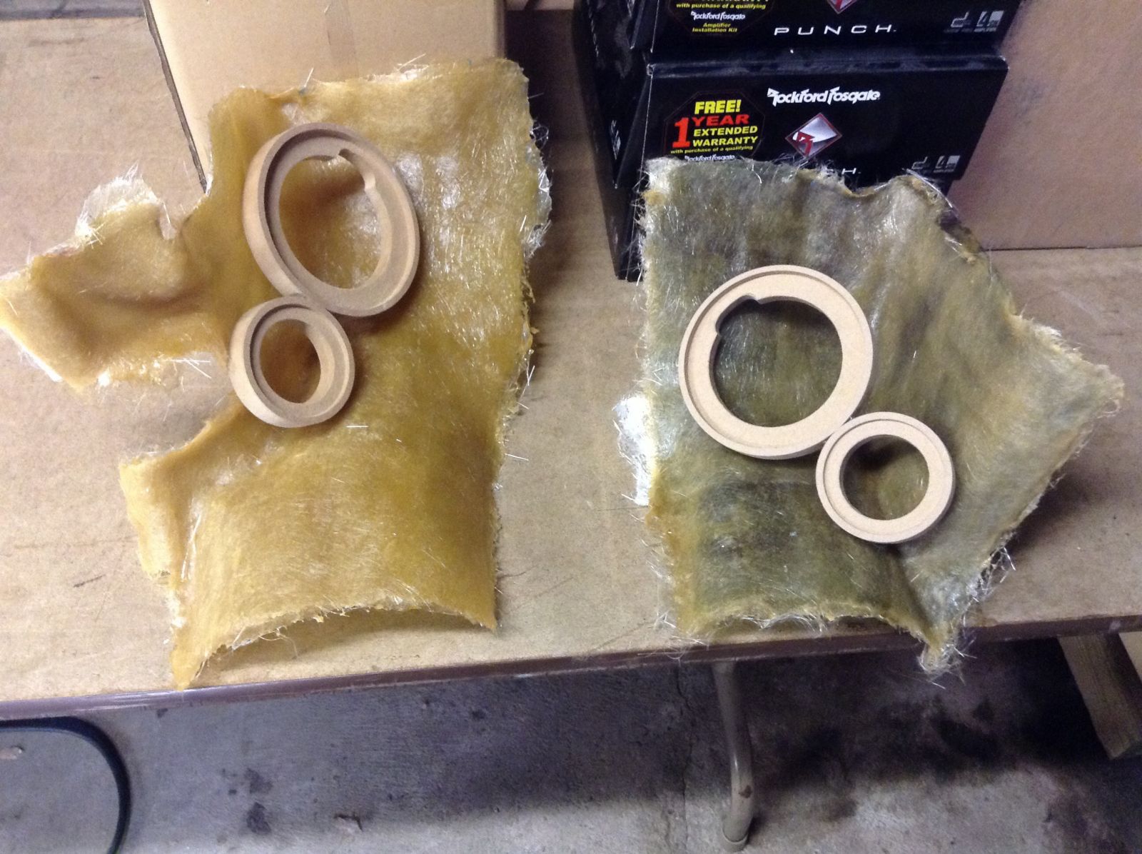

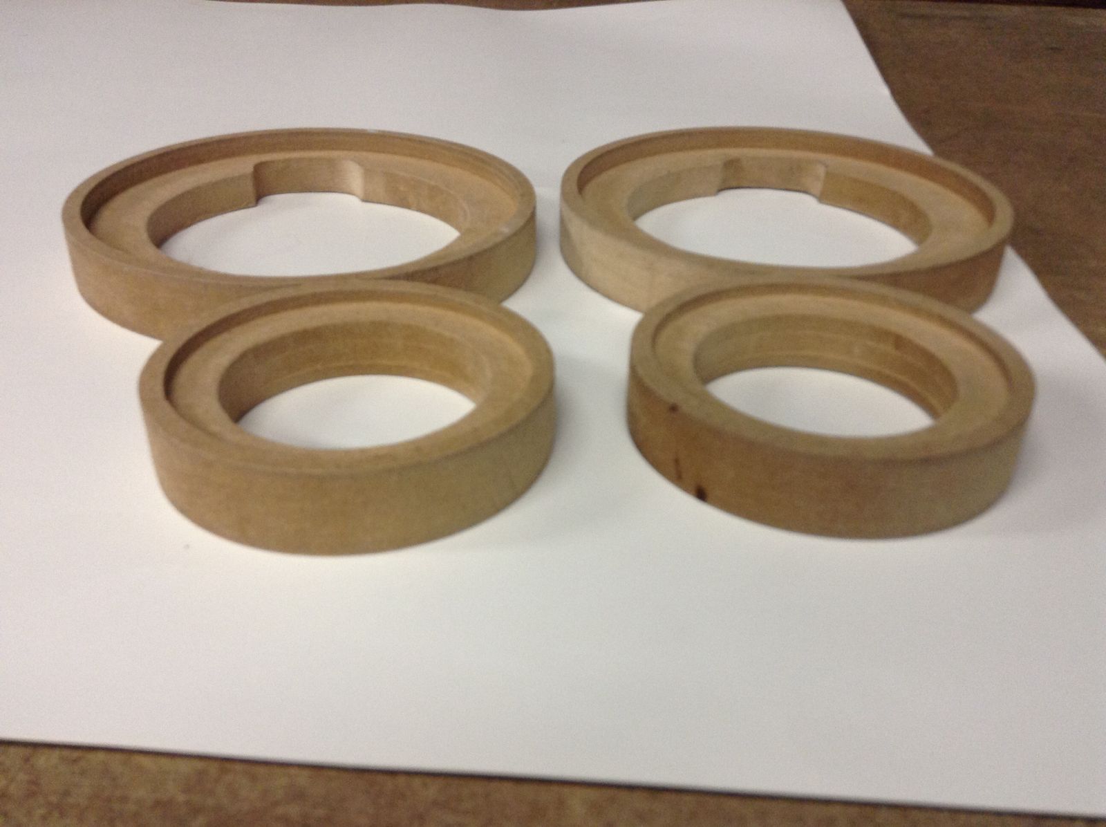

I also do have the molds for the kicks and rings for the midrange and tweeter made, but I want to finish the doors before I move on to completing the kicks.  Here's where they stand at the moment, the rings aren't attached to the mold so this is most definitely not their actual aiming.  But just to give you can idea of the general setup

They are actually not the Prime, they are the Punch.  But yeah, great dollar per watt at the $250 I paid for them authorized through Crutchfield.  Being that I'm a headroom guy, I wanted decent power but also needed small form factor.  I was originally going to go with the PPI/Soundstream/Polk/NVX/Hertz class D board amps that are the hotsauce right now, but reading the objective reviews in PASMAG I believe of the 5-channel Punch amp and the PPI or Polk 4-channels, I liked the Punch better.  Not much that would be audible except about 1.8db or so more power at 12V and a stronger power supply which allowed for more power bridged or loaded down.  Overall the specs for the RF all measured better which lead me to believe it was possibly a better designed board.  The RF was also a little more tightly regulated, and with me not upgrading the alt anytime soon I wanted a little more stable power output.

On/Off axis depends on a lot of factors.  The xover points of the drivers (ie if you run them into beaming), response of the drivers, obstructions and design of the lower dash, one seat or two seat car, etc.  Generally speaking the drivers end up being off-axis, especially in a 2-seat car.  One of the requirements for good imaging is to have even FR from both the left and right drivers.  Most people recommend to start out by aiming them at the back of the headunit and adjust from there.  This way the speakers end up being about the same amount of off-axis to both listeners.  All of my kicks end up being quite a bit off-axis for the best imaging.  I've never understood the people who aim both kicks at the dome light or the like, the passenger side kick ends up being way more on-axis to the driver than the driver's side kick, and vice versa.  If you aim the drivers to both be "on-axis" to the driver, then by default they will be all fucked up to the passenger and the power response will probably not be even at the listening position since they will be aimed differently in the vehicle.     Look at pictures of vehicles like Gary Biggs Regal....the kicks were aimed basically straight across the car.
As for the same plane, I assume you mean how I have them aligned horizontally?  I'm doing this for basically height issues.  If I tried to stack them vertically then either the midrange or the tweeter would be tucked way up under the dash and wouldn't have a direct "line of sight" to the listener.  So all of the sound would basically be indirect reflections since the direct radiation would just be shot straight into the underside of the dash.  Between that and the short wavelengths I can only imagine the comb filtering and other interference issues by having either driver *that* close to a reflective surface.  The downside is that the FR in the horizontal plane with this alignment will probably be pretty bad around the crossover region, so aiming is going to pretty important to make sure I'm not shooting that crappiness straight at me :)   Vertical would be better if I had the room, but I don't.
Yeah after I posted that I realized they were the older punch series.

Same plane -> equal distant motors to the ear prevents the need for t/a, synergistic aiming simplifies interference between the drivers, looks more balanced to the eye, easier to install/aim a single baffle, simple to setup vertical, allows for closest spacing between drivers allowing more flexibility in the crossover point. Lots of ways to skin the cat, but some combination of the above are hints. Obviously depending on aiming some of them go away.

Sean pretty much hit most of the acoustic reasons in his response, and to be perfectly honest it just makes life easier when trying out aiming and finishing the kicks. The only real downside I can think of is that the midrange and tweeter will be forced into similar axis, but I think the time saved, ease of testing out aiming and other issues like maintaining close center to center spacing will more than compensate for any slight deviation in imaging from either driver being a few degrees out of optimal aiming due to being affixed to each other.

If anyone has any great suggestions on how to glass a sealed enclosure in the door, I'm all ears smile.png
There are my door panels.
Can't decide if I want to glass the entire rear area from the metal of the inner door, or if I want to make a mold of the map pocket itself to create the rear half of the enclosure. The former would give me a little more airspace, the later would make life a little easier I think.

To make a sealed in enclosure in the door I cut an old coffee can in half. I then sunk that half into the door until it just about touched the window. This is now the area that the magnet sits in. Then I fiberglassed that to the backside if the door card. There are numerous ways you can do this hopefully you can picture what I am explaining. You can also add deadener to the "bucket".
