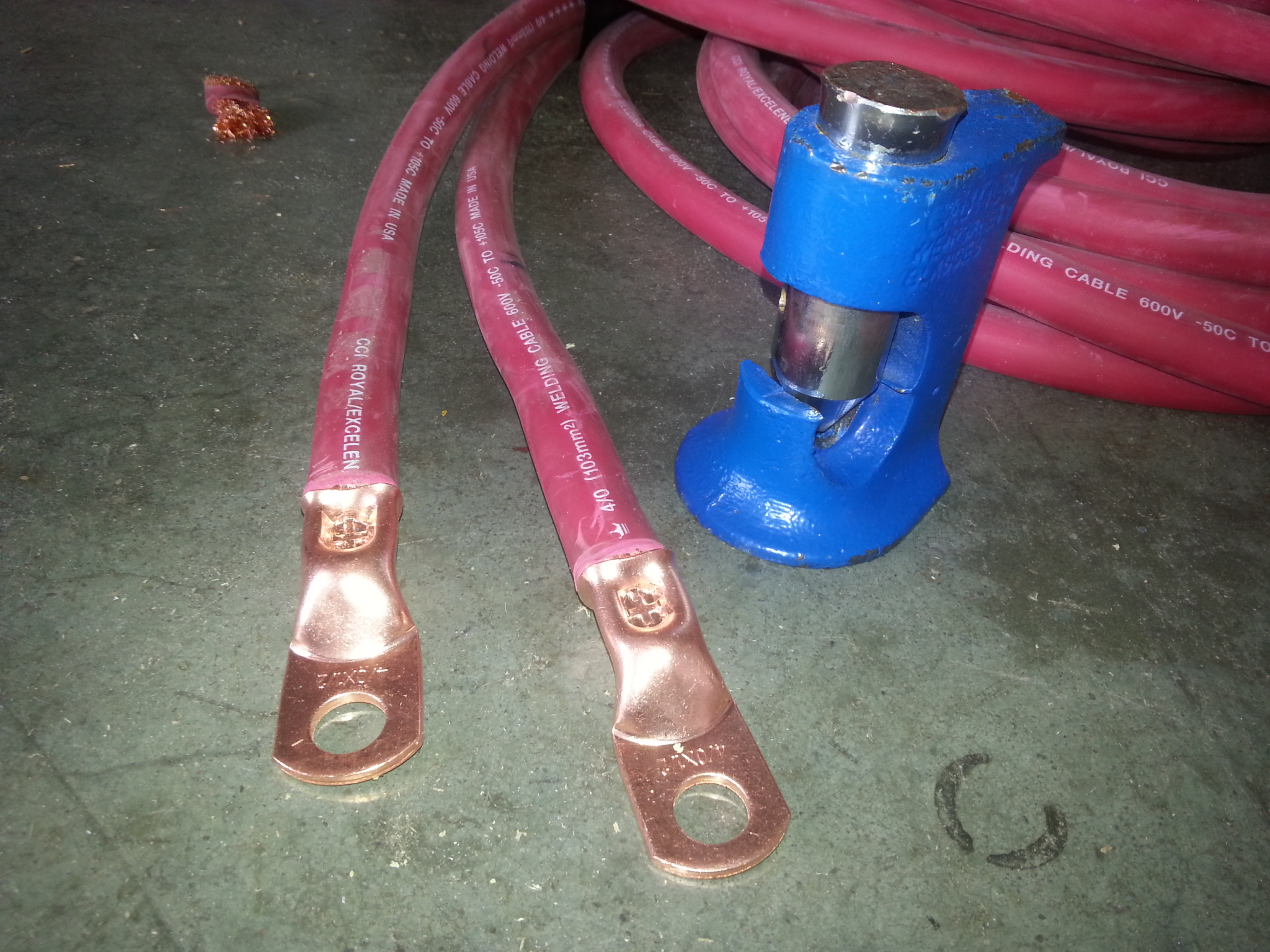

Nope only goes up to 1/0 . . Mite just have to use a fat screwdriver and a hammer To crimp the 4/0 lol  . . Or could try soldering . Have never soldered any copper lugs befor
Fit on my hammer crimper :)

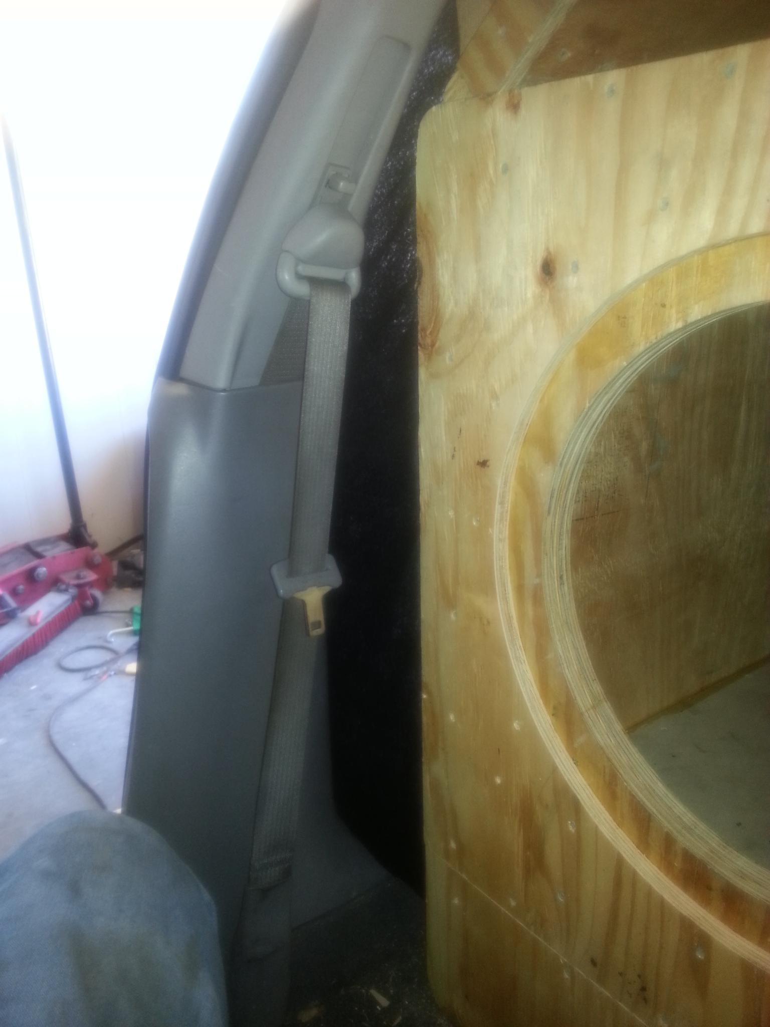

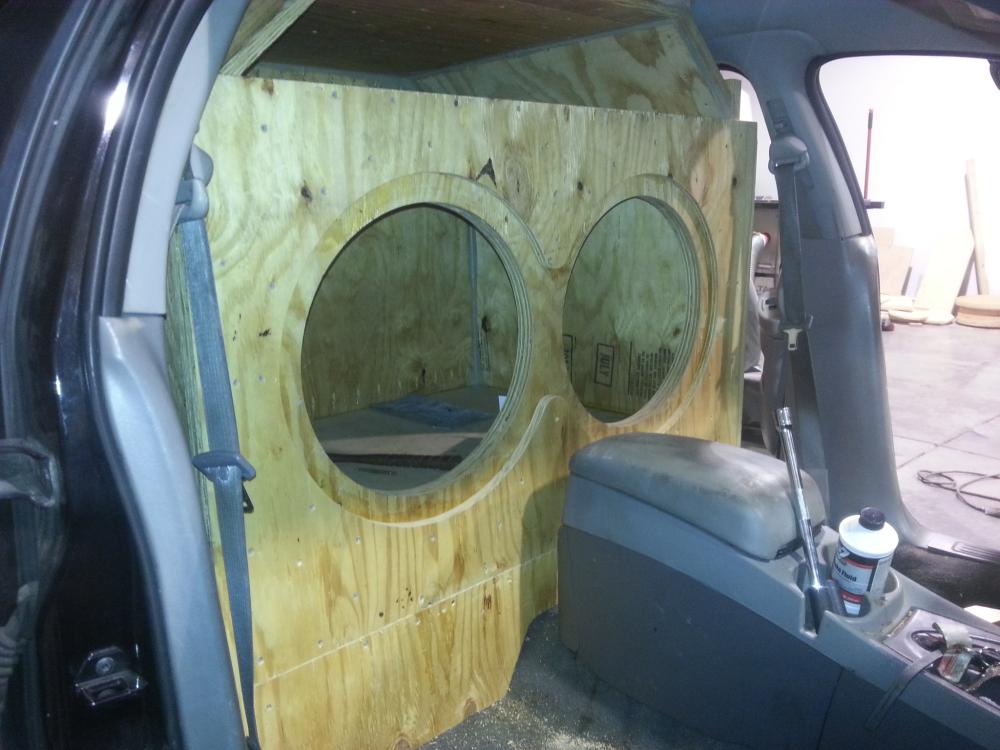

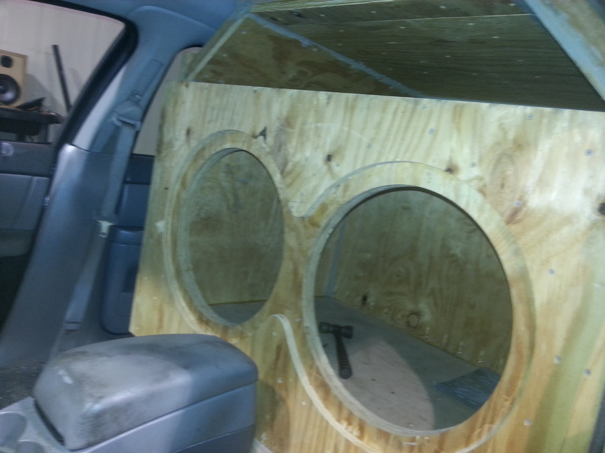

Baffle just sittin there. Just to give you an idea of what it will look like

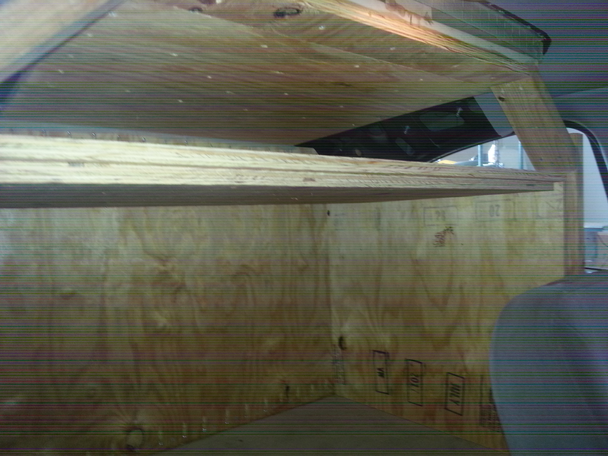

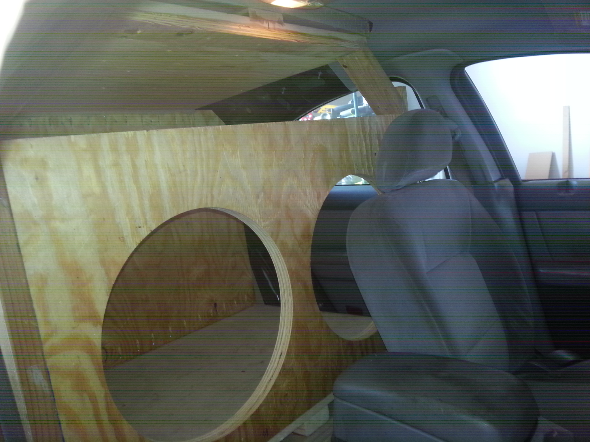

Test fitting pieces
Man its coming together. Im getting excited lol

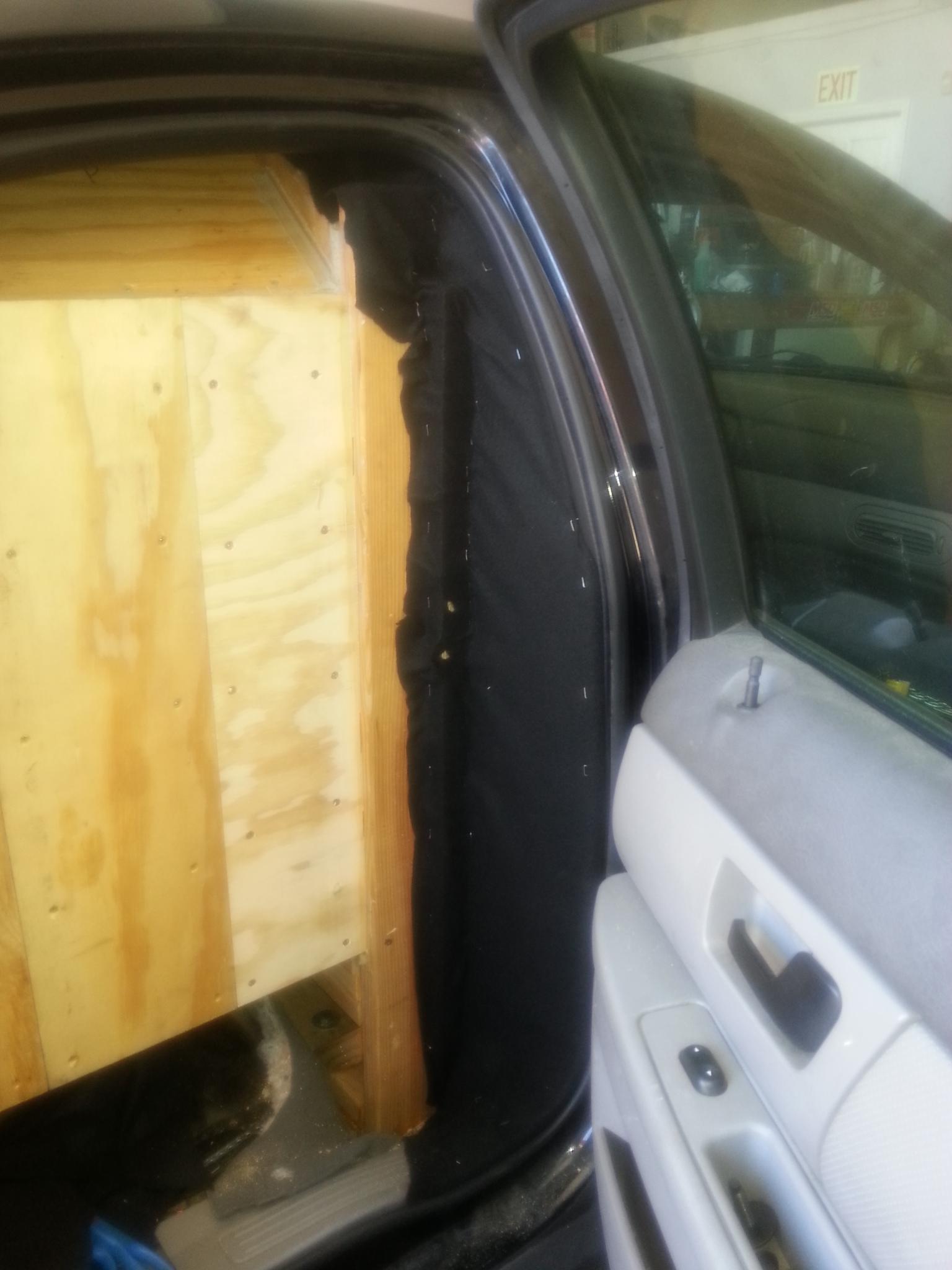

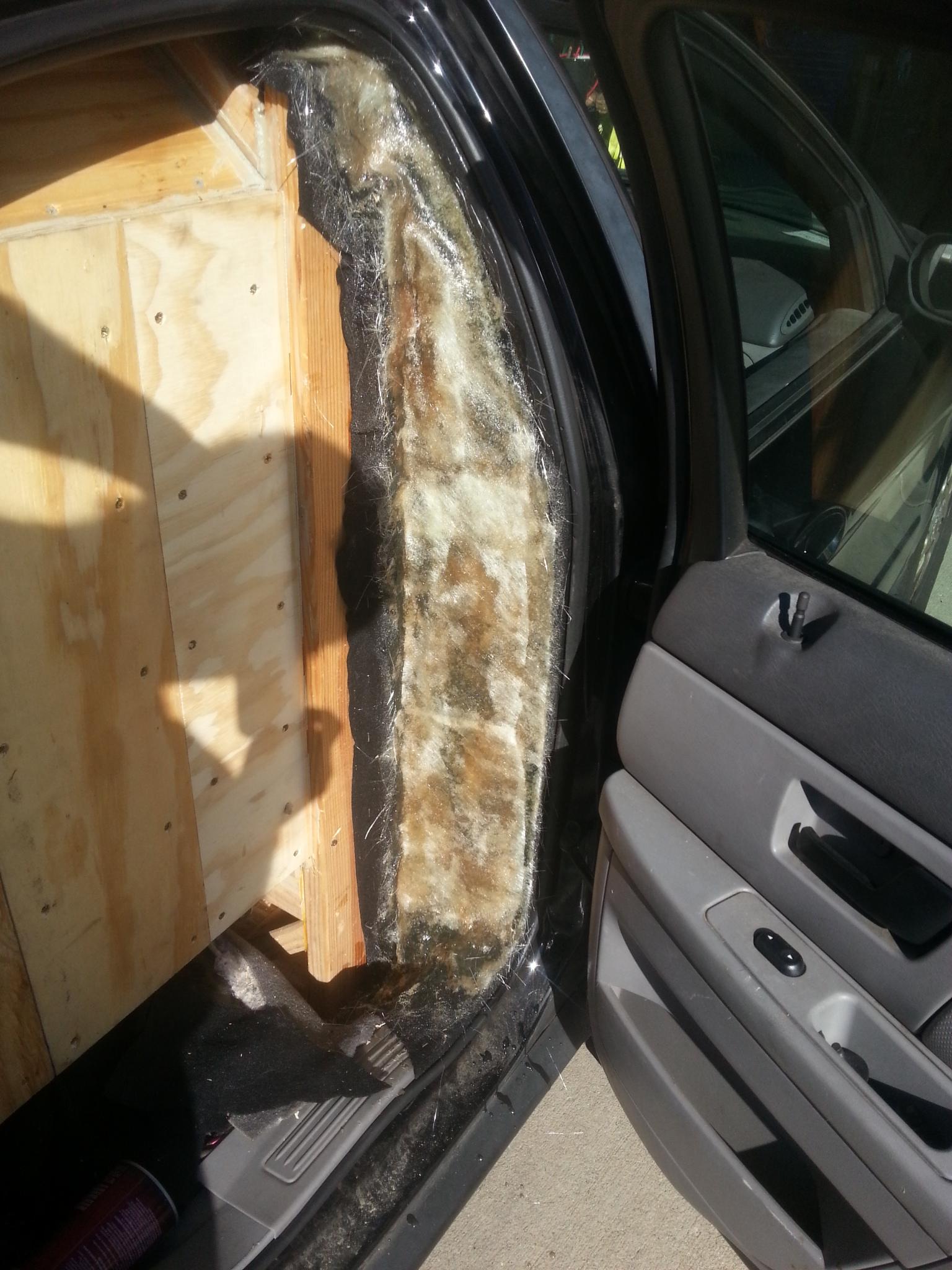

Pretty much just some finberglassing to do :)

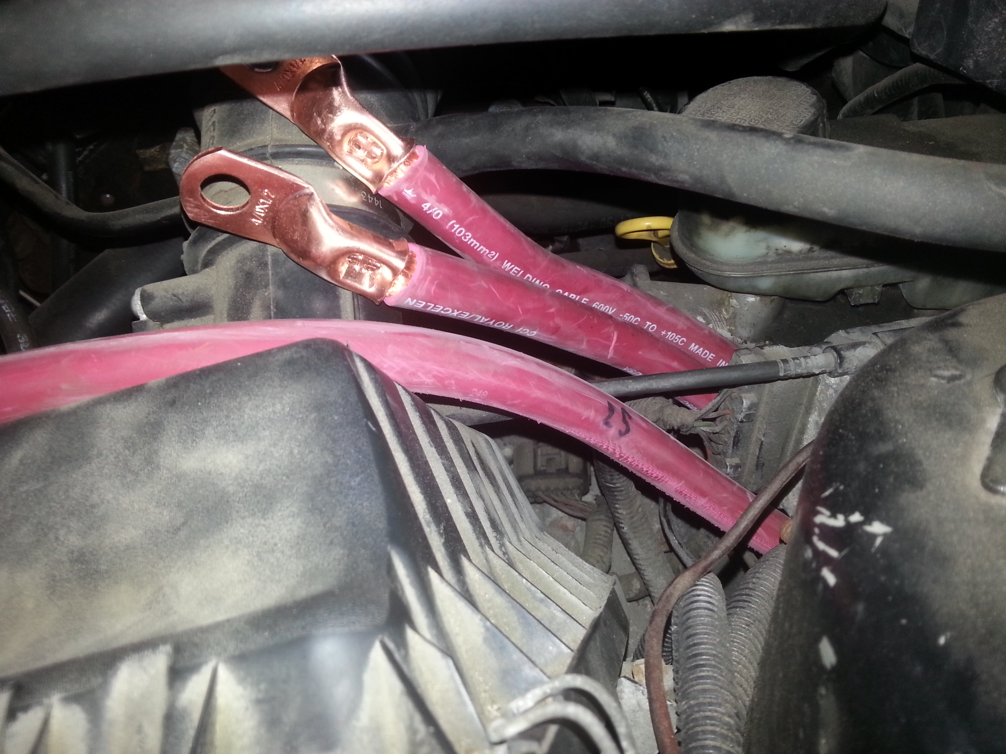

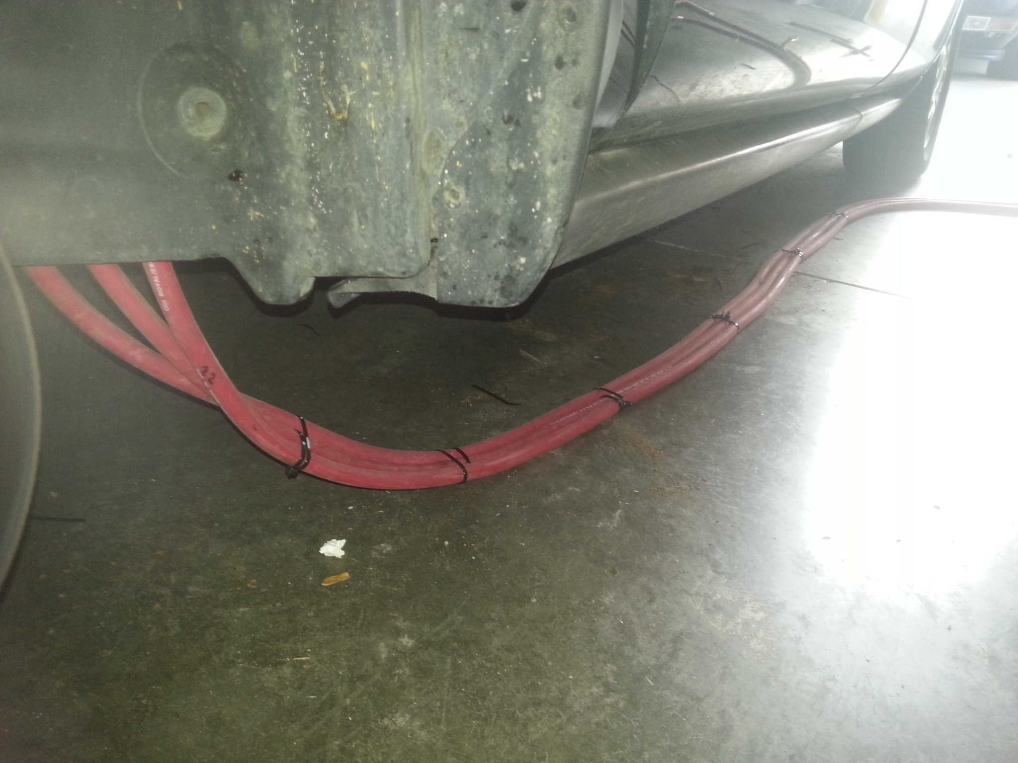

2 runs pos 1 run neg of 4/0 . For now
Fiberglassing tomorrow!

I love the zip ties keeping it clean. Only suggestion I would make is maybe securing the wires under the car or through the car. :lol:!!! Looking great so far man keep it up!

I love the zip ties keeping it Only suggestion I would make is maybe securing the wires under the car or through the car. :lol:!!! Looking great so far man keep it up!
I ran them Inside the plastic panel that runs along the rocker panel .
Not perfect but it will get the job done
