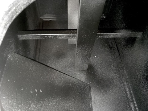

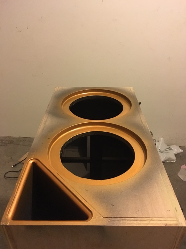

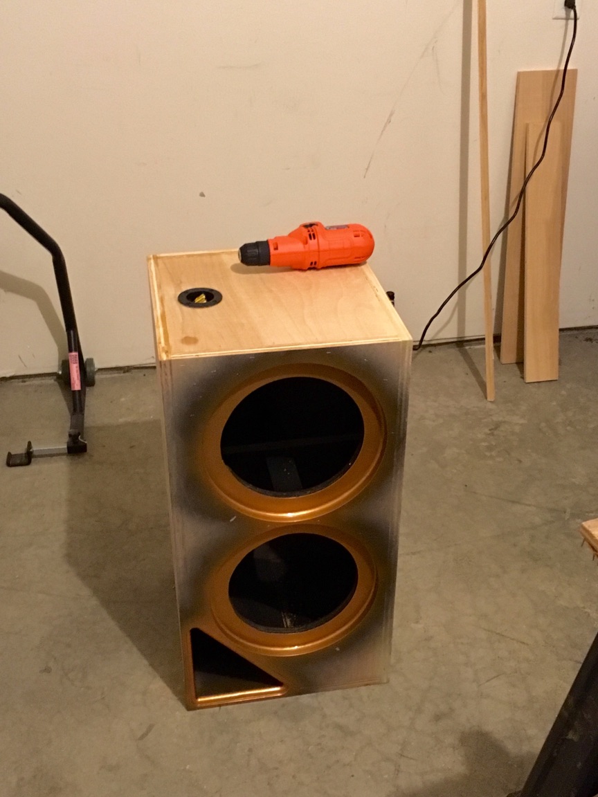

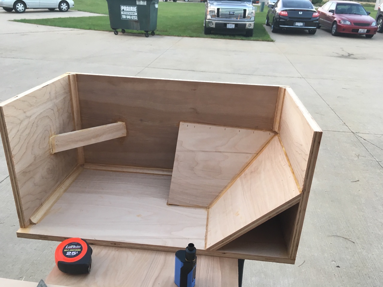

Posted October 12, 201610 yr Popular Post There are two things I have never had since I got "serious" into car audio. A 10" sub, or a decent dual sub setup. So this is my build for two 10" xcons! Im super excited, they should be finished building and arriving soon, I hope. I am fitting the maximum dimensions of my trunk while still being able to fold up the stock floor and access the spare tire. I was left with 3.11 internal cubic feet without sub, bracing, 45s, or port displacement. This is firing into the car, so I also needed the subs and port to be on the same face. The triangle port is unconventional but takes up less volume than a typical slot port inside the box and also has less port wall surface area, so I'm hoping it works out. That angle took some wizardry to figure out, and it still came out a little crooked but oh well. The "45s" are little pine cove trim pieces, figured this is the best I can do without sacrificing internal volume. I used minimal bracing but it should be enough, and undercoated everything with two cans, I honestly dont think it does anything but I like to do it on my boxes. it gives a solid completed look to the inside of the box and its extra leak insurance. Final volume and tuning should be 2.4 cubes at 31 hz with 25 sq in port area. The box is a little too small and the port is a little too small, but its all the space I have. Got some black base down and some custom copper orange pearl, trying my best to match the faceplate of my Crecendo BC3500. All thats left is to carpet it with black felt, wire the drivers in, and go to town! Edited October 12, 201610 yr by Smanleyman
October 12, 201610 yr Cool I like the box. And that port is cool looking to definetly different I have only seen those on factory boxes.
October 12, 201610 yr I like it. I hope it works for you. Show/tell us more please ! What car, what else in it ?... How do you like it ?

October 12, 201610 yr Cool box and I love the port man, almost wish it was an external port. He'll of a start to a build log

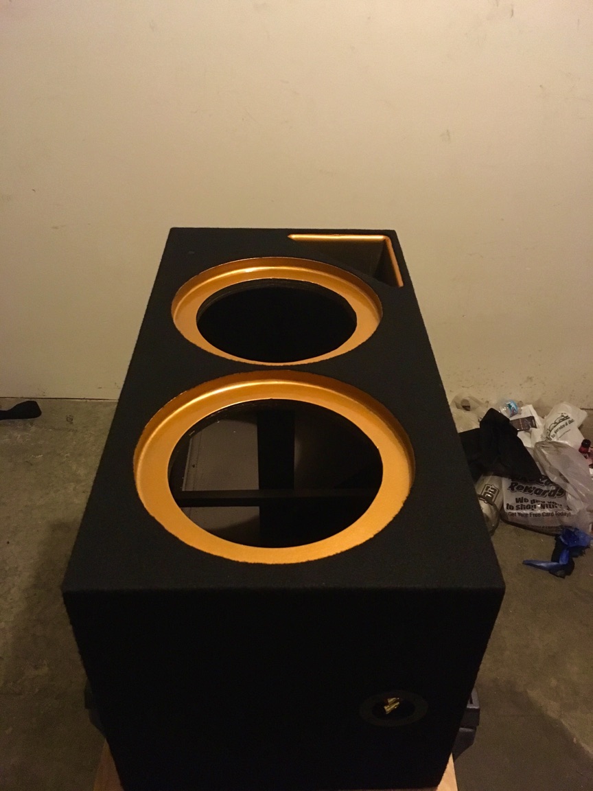

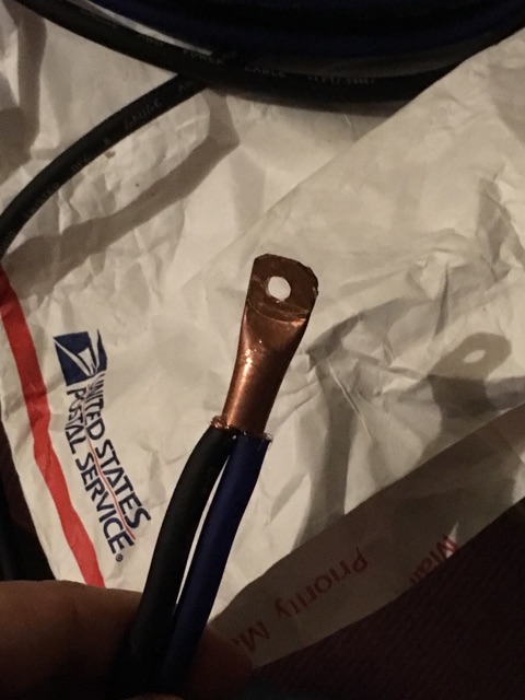

October 15, 201610 yr Author Popular Post Made some awesome progress this weekend!! Got my terminal hole cut then went to carpet town. Its hard to get the gloss metallic combo in a picture, this was the best closeup I could get Im very happy with the results. Of course there a few imperfections but thats DIY life. Up next is the wiring. My homemade terminals hold two strands of Sky High 8 gauge perfectly. Man I really want these subs to show up soon now that the box is finally ready. Stay tuned for their arrival!
October 17, 201610 yr That box looks very nice : I love the color, and the finish. But I don't understand the 2 8 Ga wires in a single terminal.
October 17, 201610 yr Author 4 hours ago, Notorious97200 said: That box looks very nice : I love the color, and the finish. But I don't understand the 2 8 Ga wires in a single terminal. Thanks! There isn't a lot of room to hook up to on the back of my terminal cup. Two dvc subs in parallel, this way each sub only needs two terminals instead of 4. I guess the colors could be confusing that was a test shot, of course it would be two + in one and two - in the other

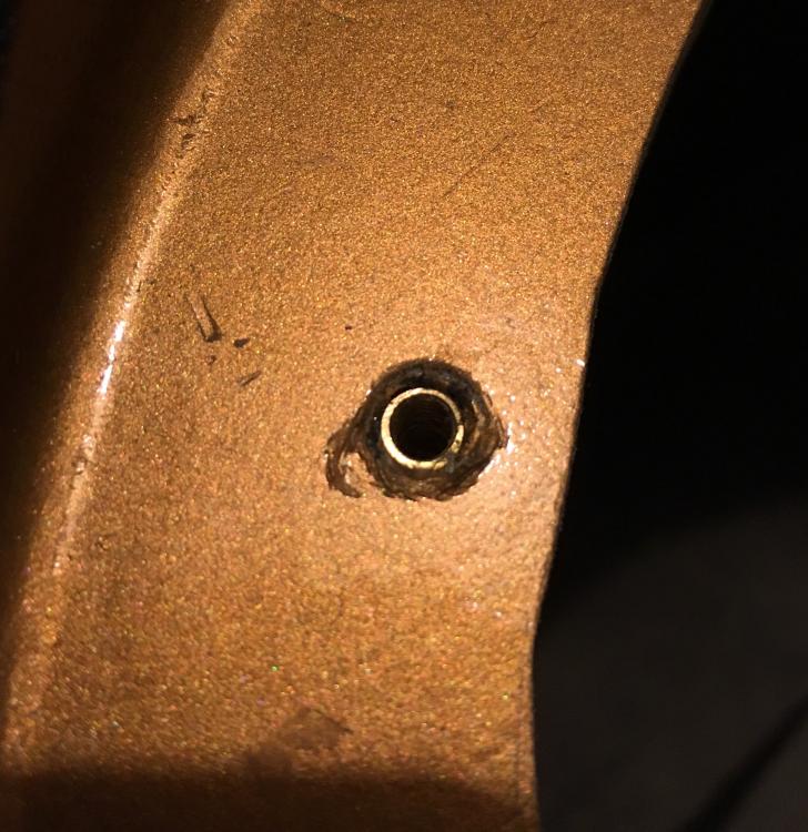

October 28, 201610 yr Author Finally got them! First step was to mark my holes and add the inserts. This was my first time ever using them and it was definitely a painful process, but at least I learned along the way. I also kept a cutout in case one ever goes out I'll be able to run a single(with less power of course)
