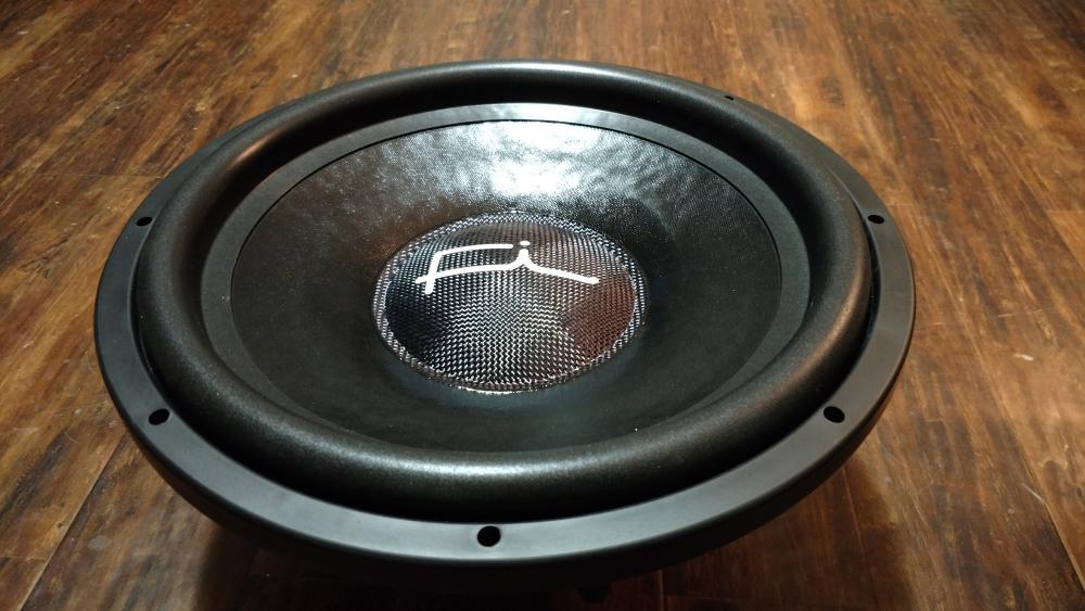

The Fi came in, so it's time to start a build log. Will continue with pictures of the enclosure as it progresses (might not be for another week or two with Christmas parties and stuff coming up). Rundown of what the system will consist of:
Fi Alpha V2 15 D4, BP plug, Carbon dust cap
Alpine MRX-M100 running at 2 ohms
Factory radio with a Scosche LOC
Ported box with viewing window, SPL dust, and custom fabrication like you've never seen.

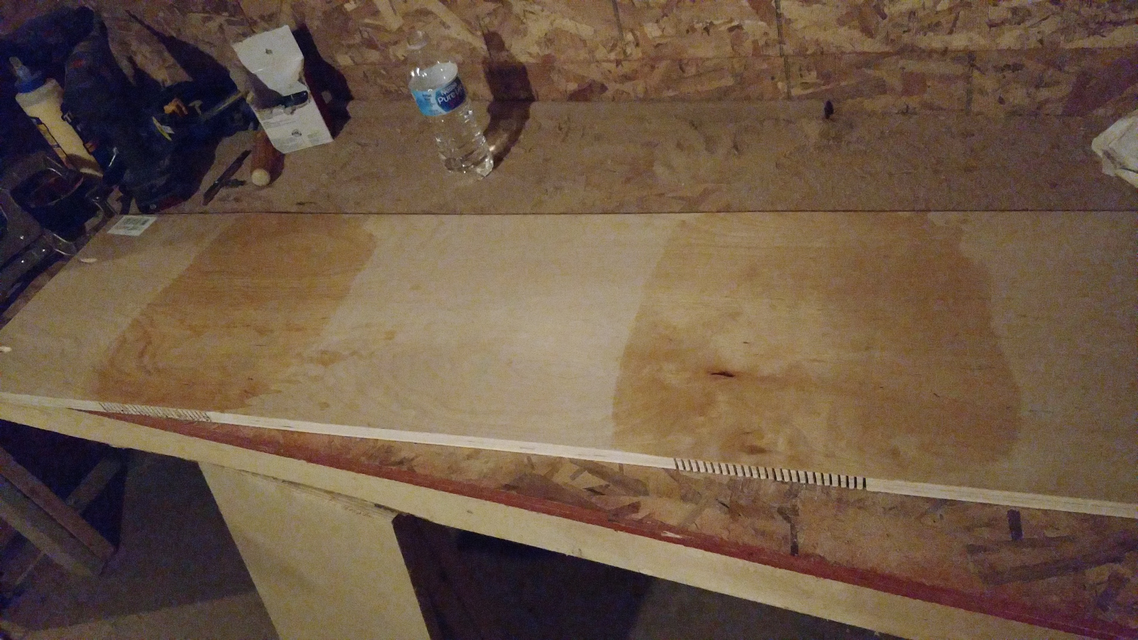

  • I think wood dye is my new favorite thing to play with. I LOVE this color! And it'll be shining bright with 3 coats of poly on it!

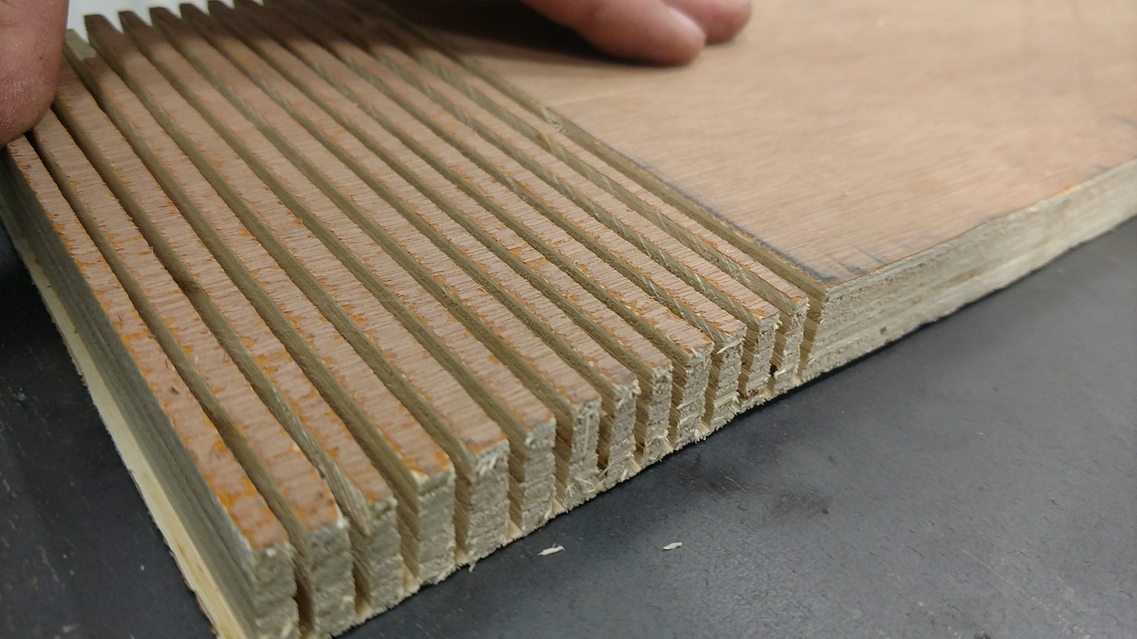

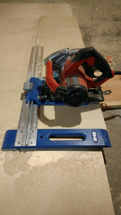

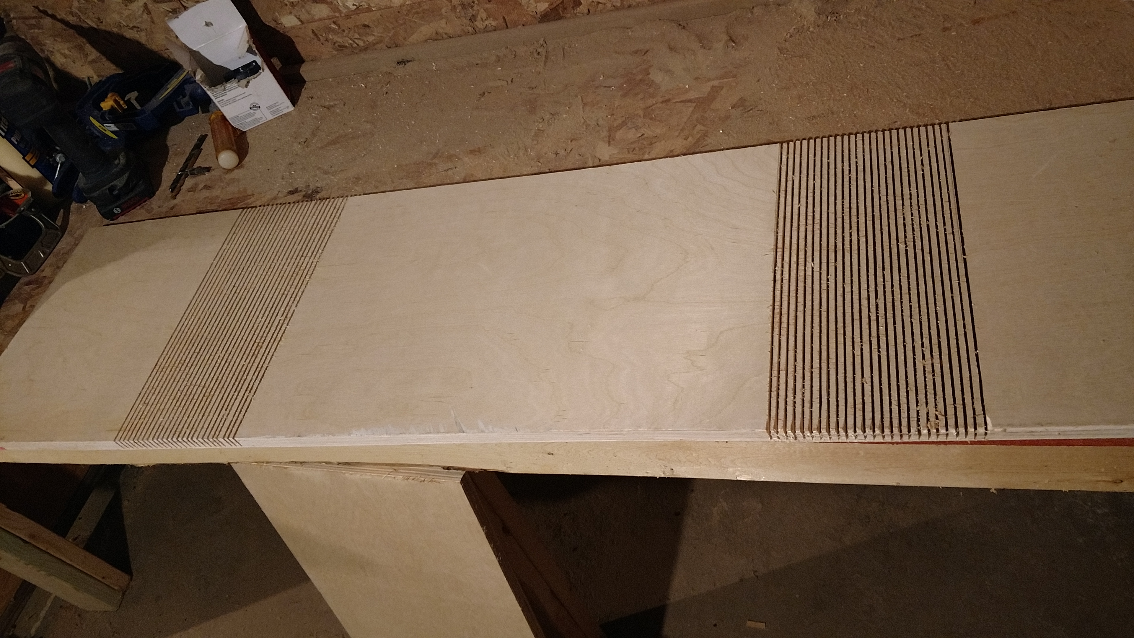

It's been a few years since I've done this. Just making sure I get my spacing right to have a 180° kerf (90° is for amateurs). Will have to spray the back with water to make it more pliable and less prone to breakage, but my radius should be good with 1/4" cuts.
I guess I’m an ameteur! Lol. So what’s the measurements??

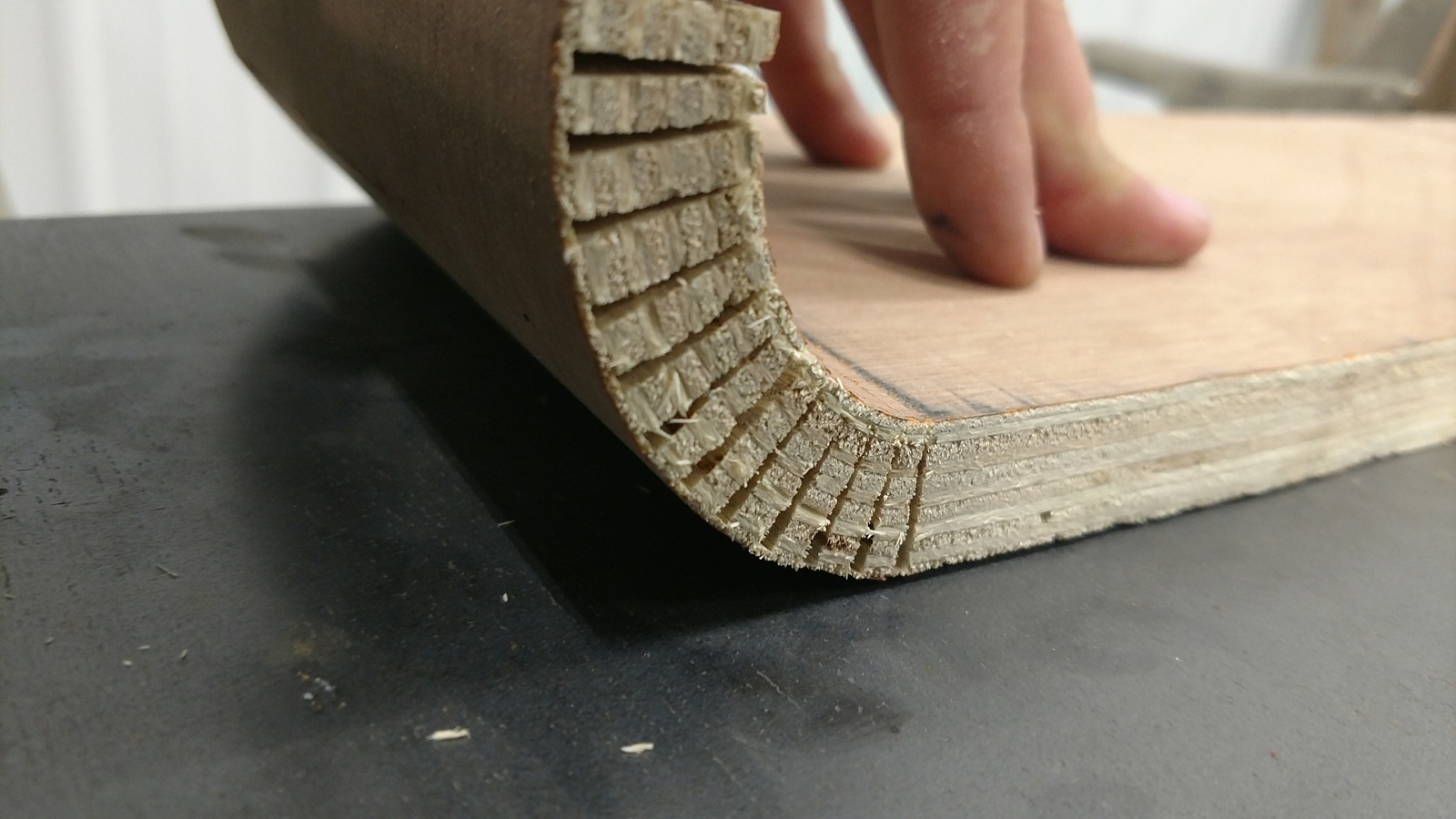

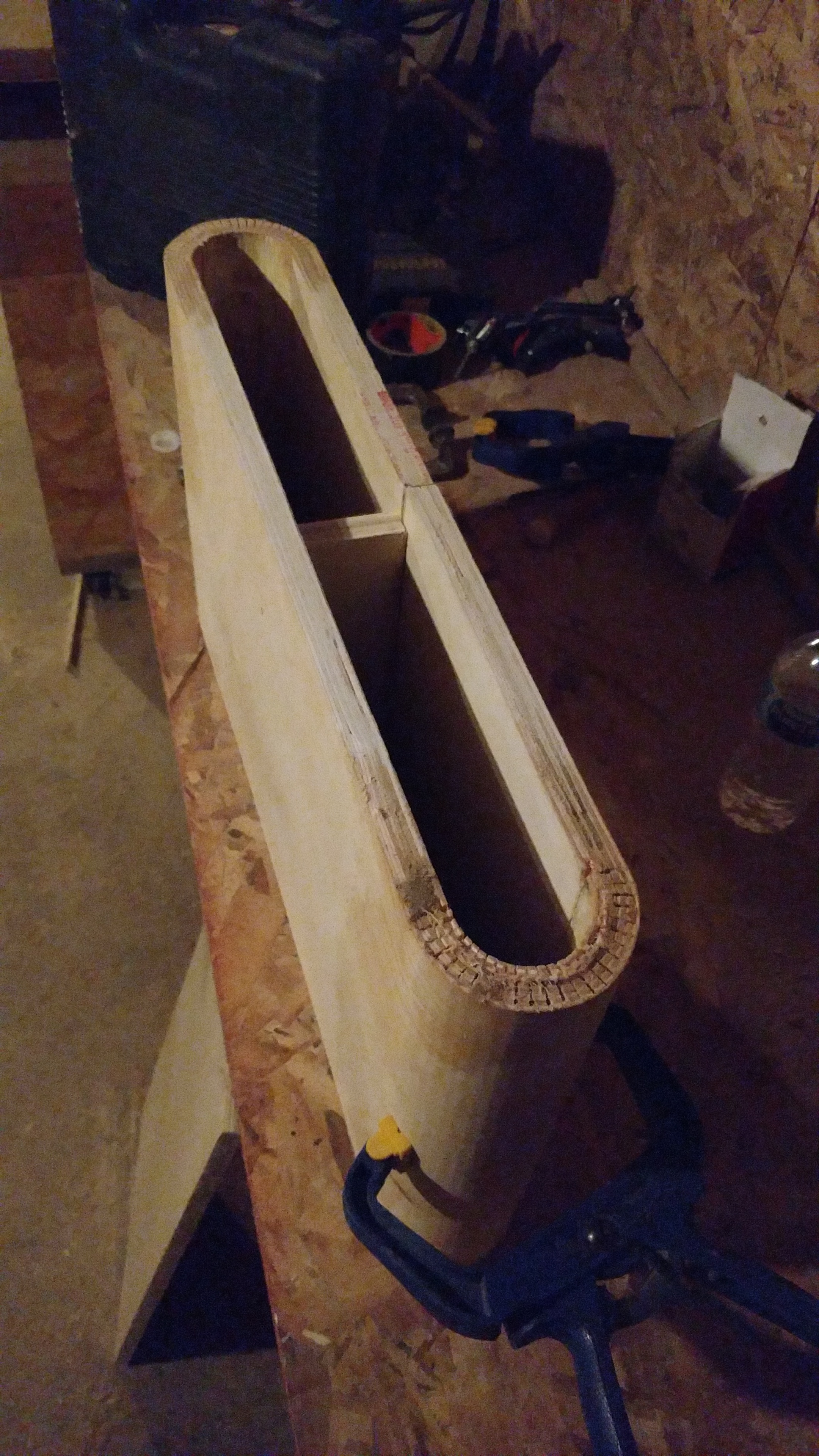

50 cuts later aaaaaaaaand, we've got a port.
That looks awesome
46 minutes ago, ManzKea said:
That looks awesome
Ive only seen this once before, and it was in a firebird with 4 12's under the window. Subs forward port back. Fella that went by the name AQFirebird. Competed in MWSPL years ago.
So you’re using that as the port itself ?
Really like that port. Can't wait to see the rest. Keep it up.
Correct. That is just the port. 2.5" tall, 21" wide, and 13" long.
How high are you tuning
40hz
