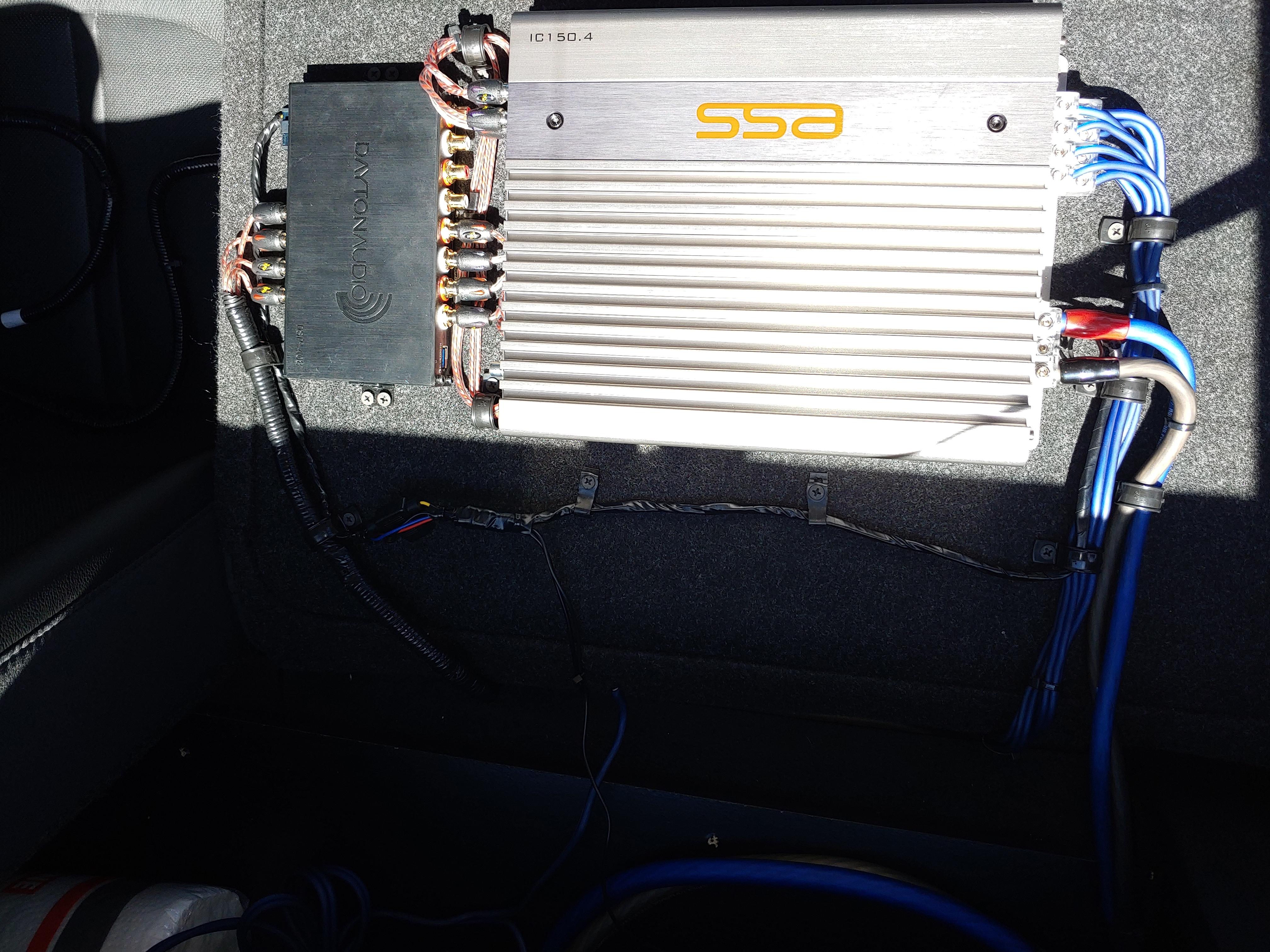

SSA front stage amplifer is fully installed, here are a few updated pictures.

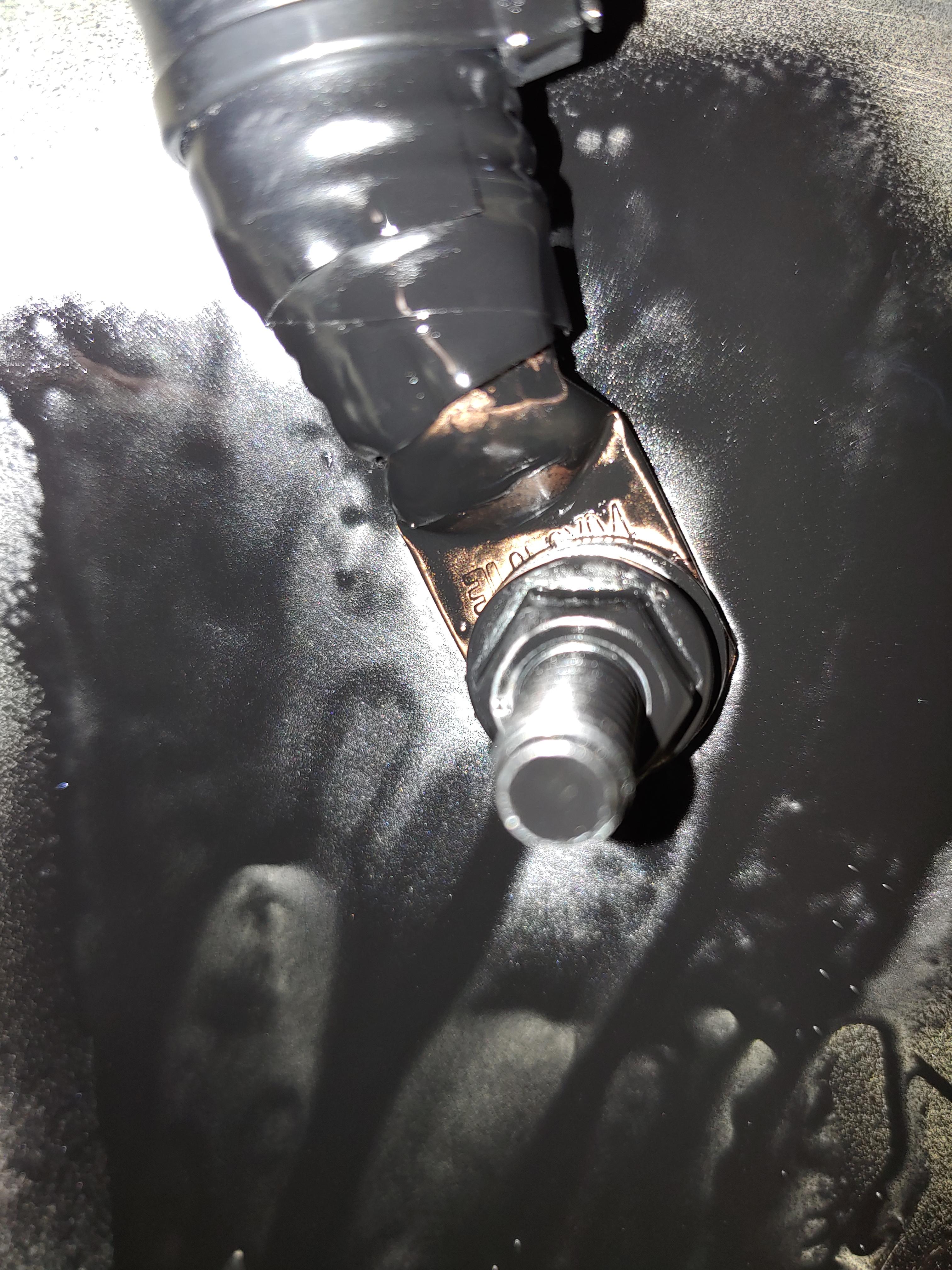

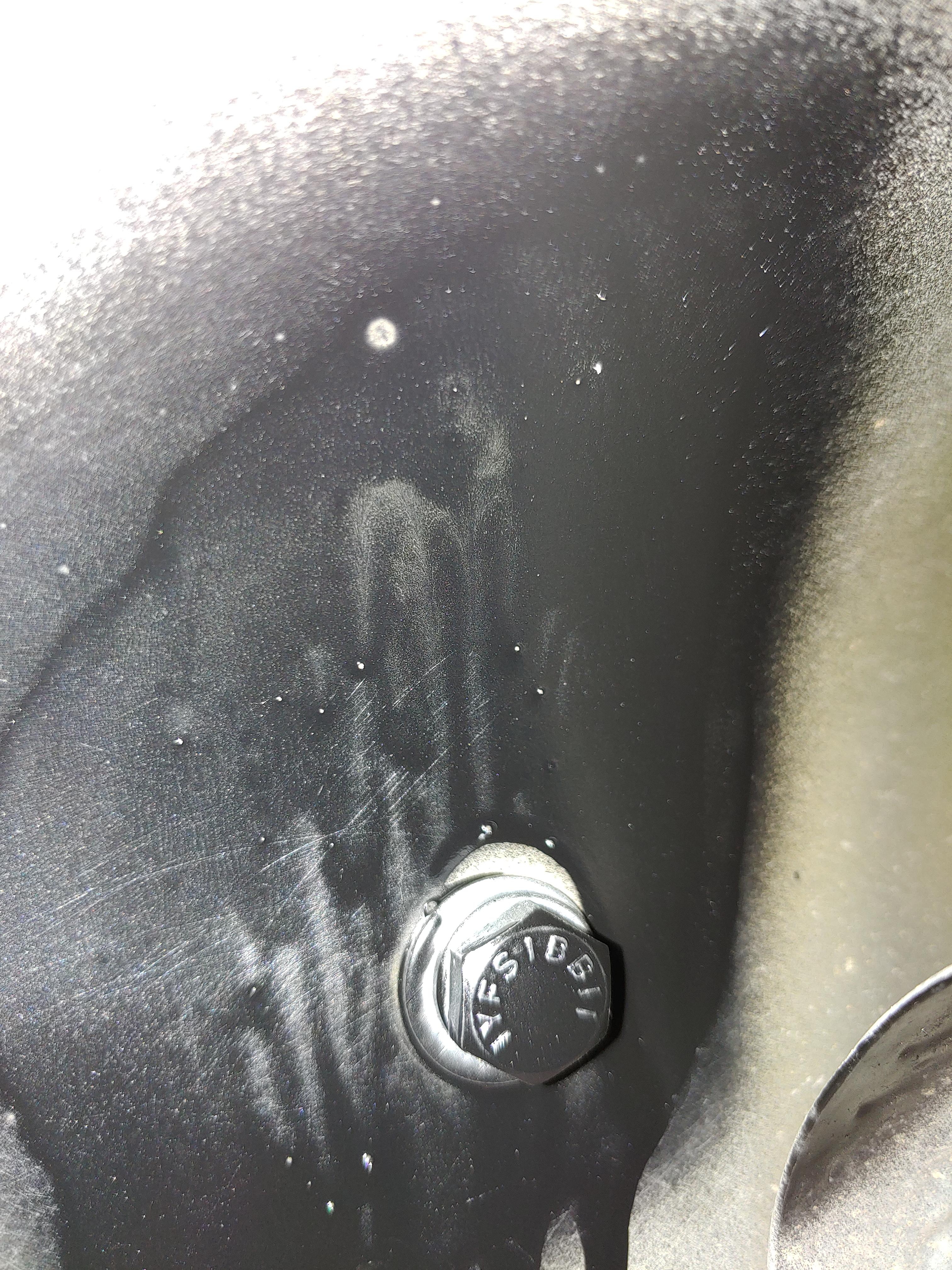

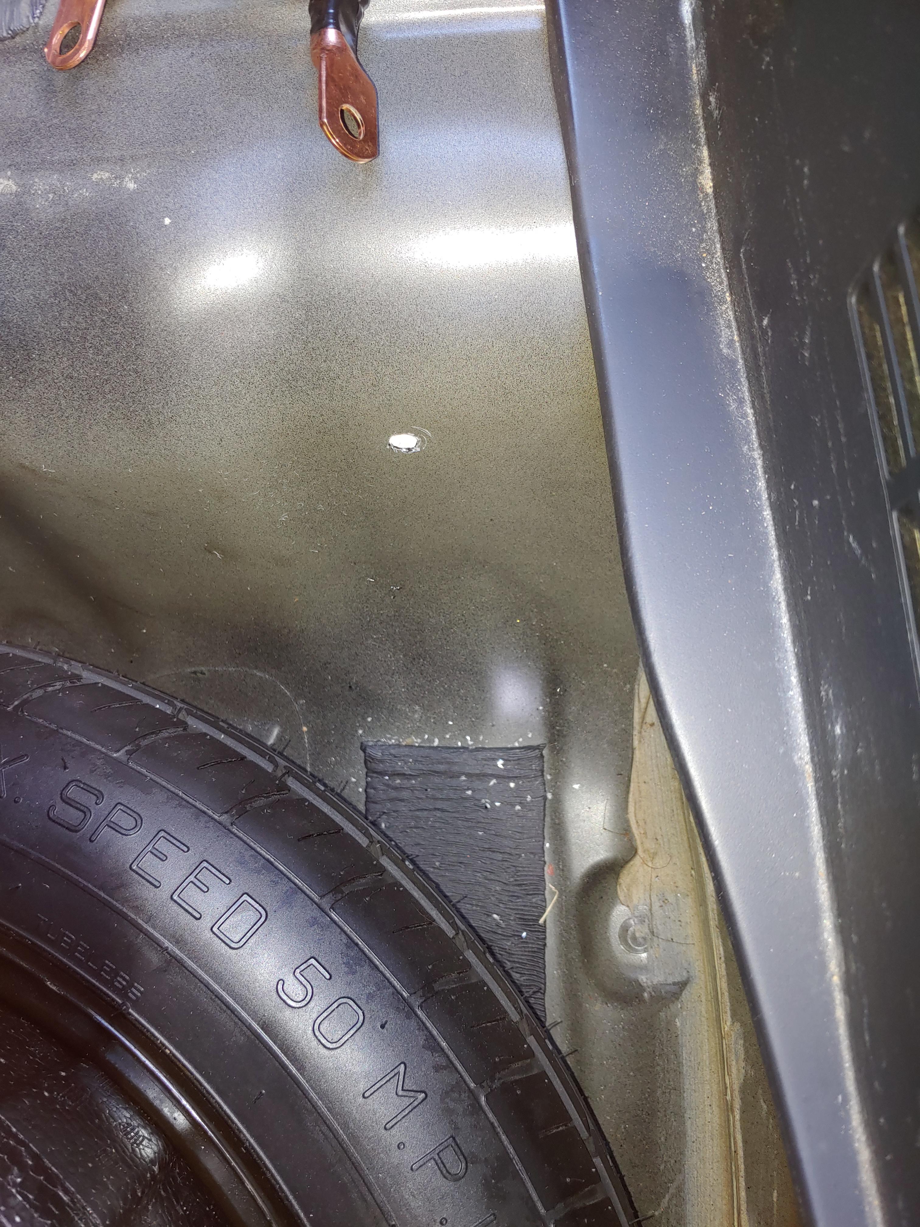

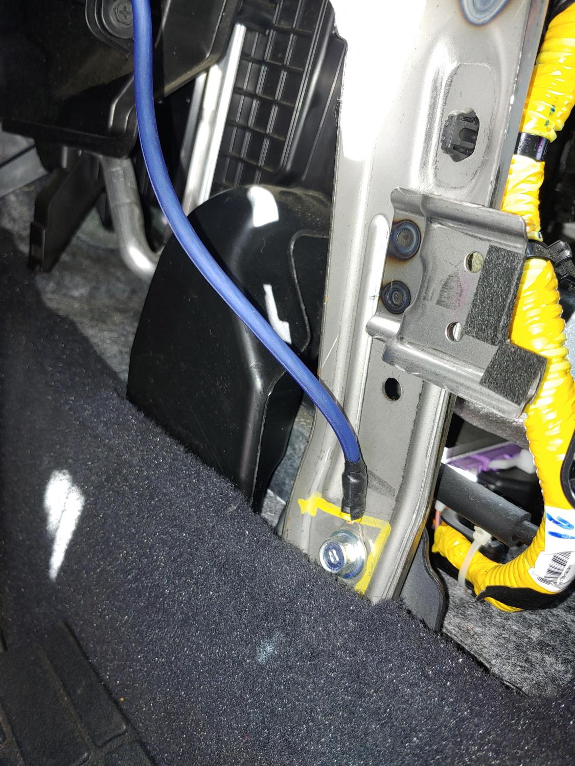

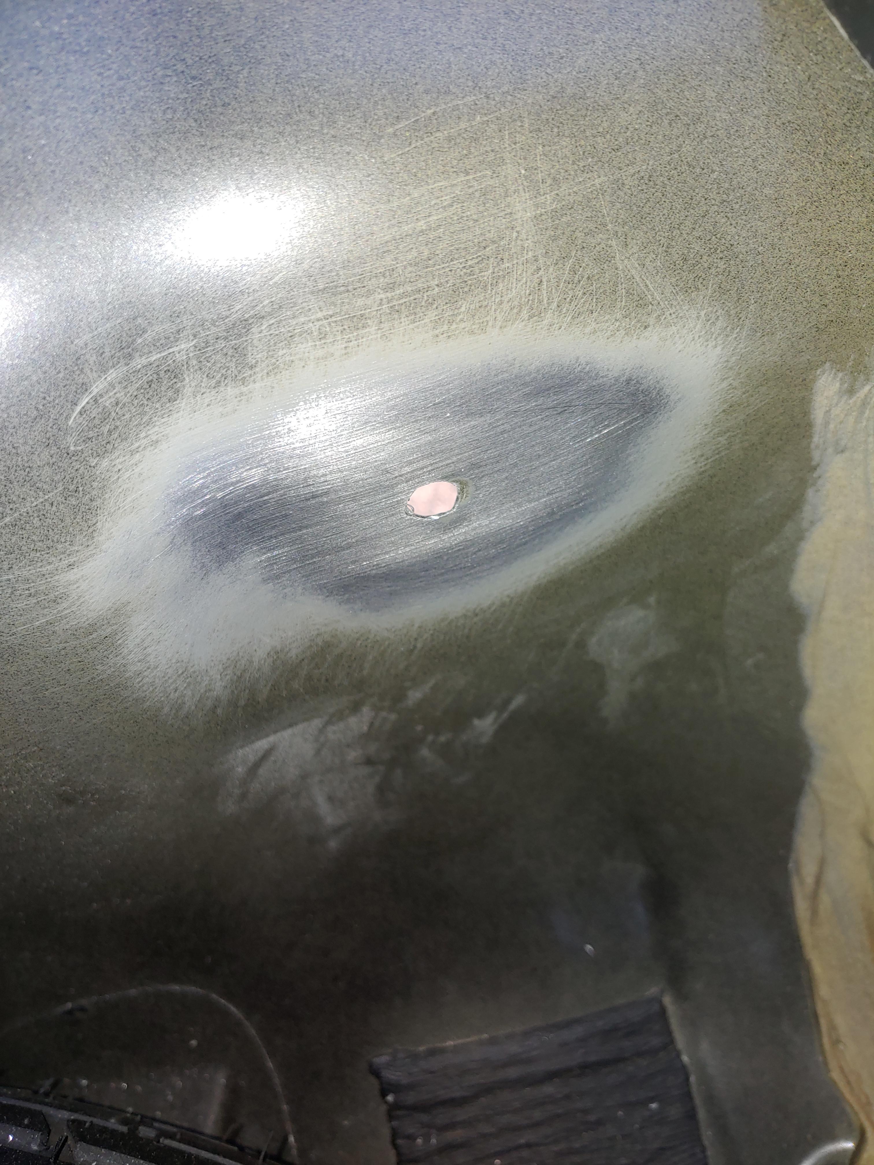

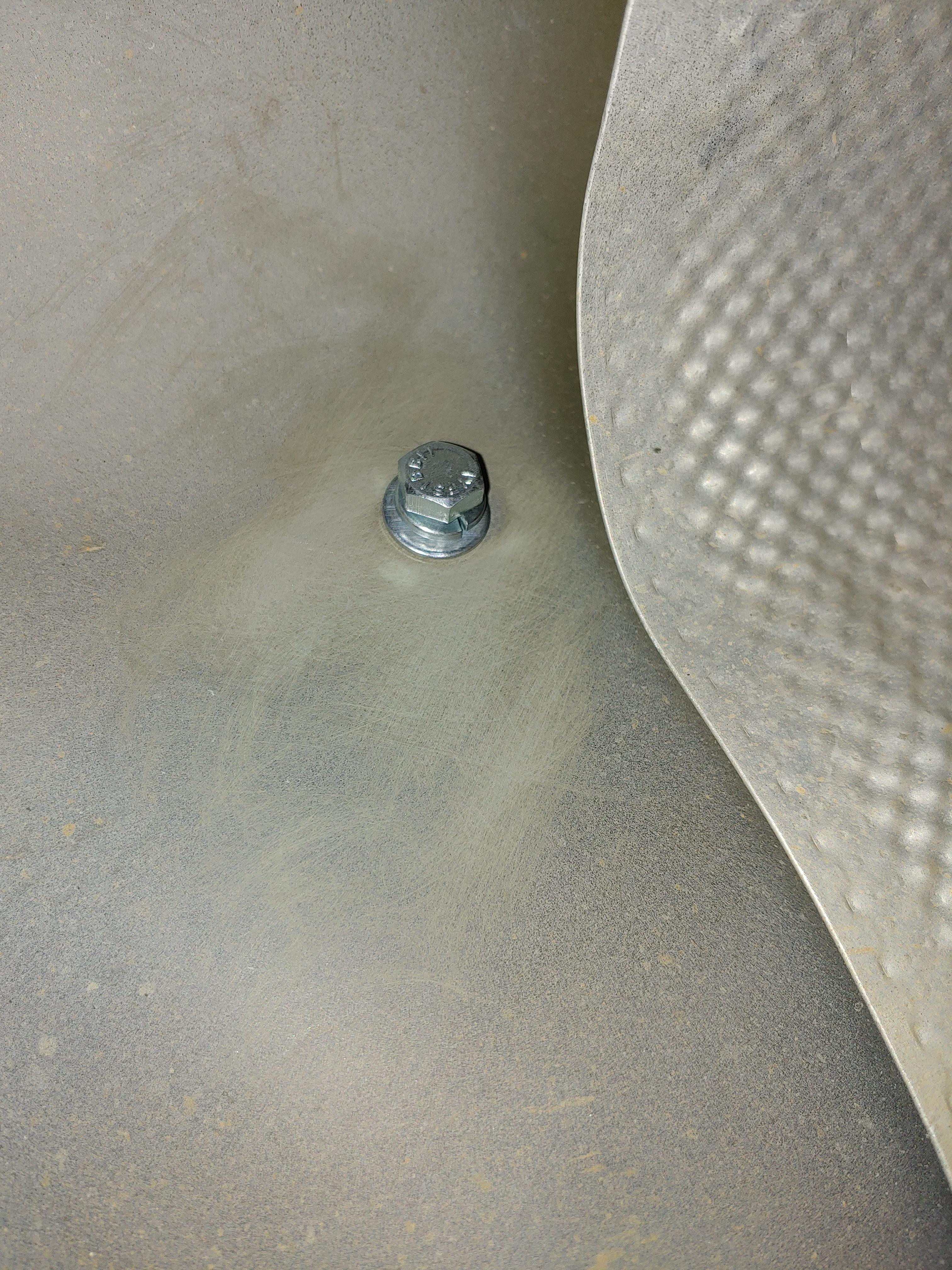

I usually use a bolt that mounts my seats to the vehicle but decided to drill my own hole for my ground wire on my secondary battery in my trunk. Removed paint and primer to get that bare metal connection, used lock washers as well to keep it from vibrating loose. Sprayed black spray paint to cover up the bare metal and it will get covered with sound deadner in the future.

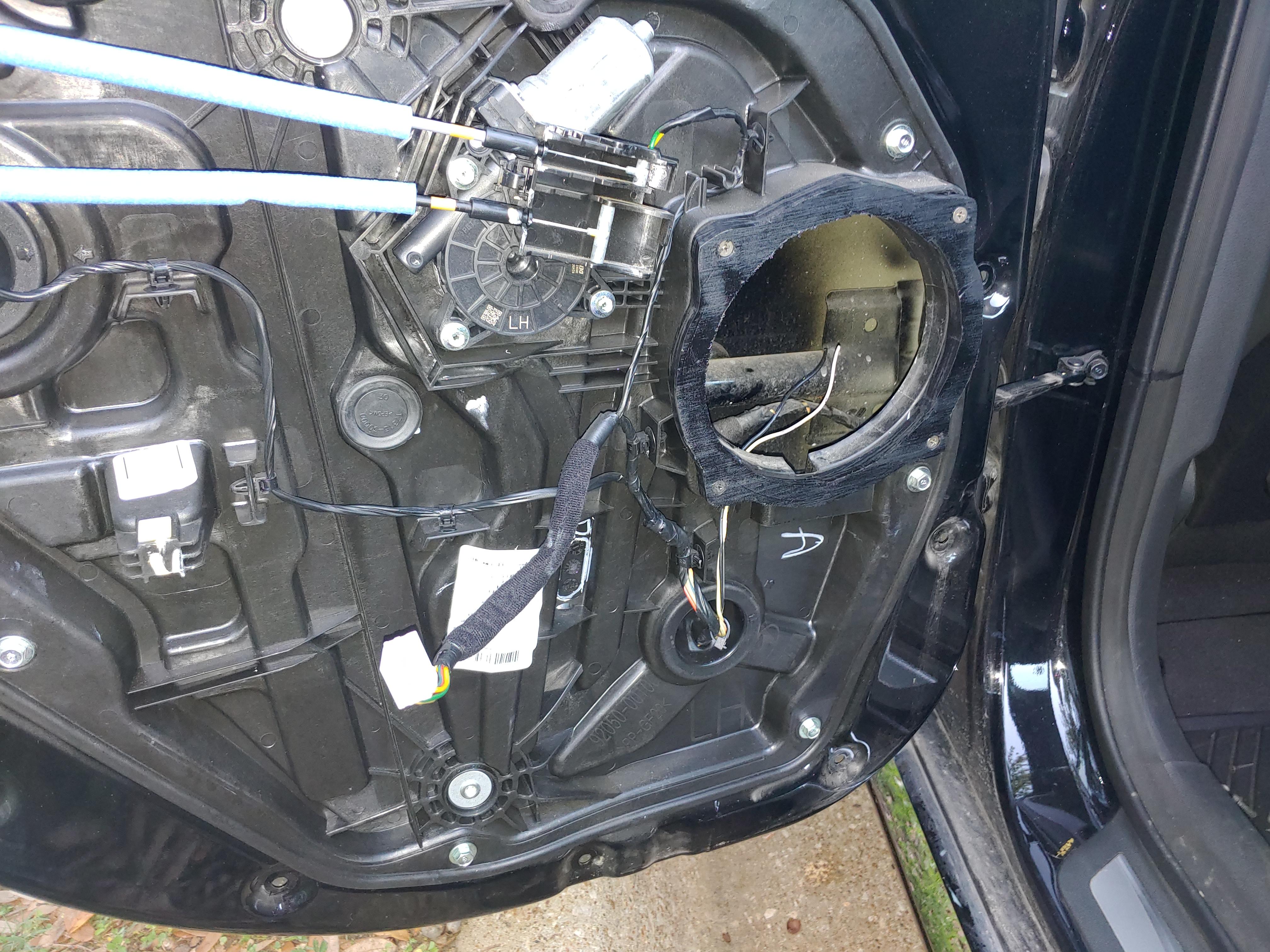

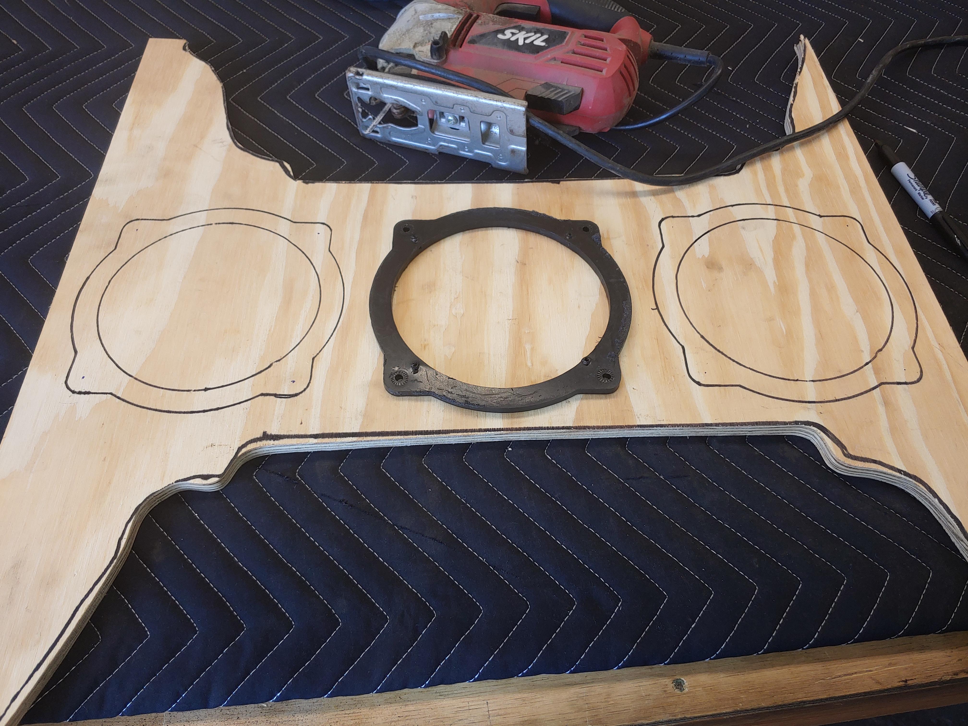

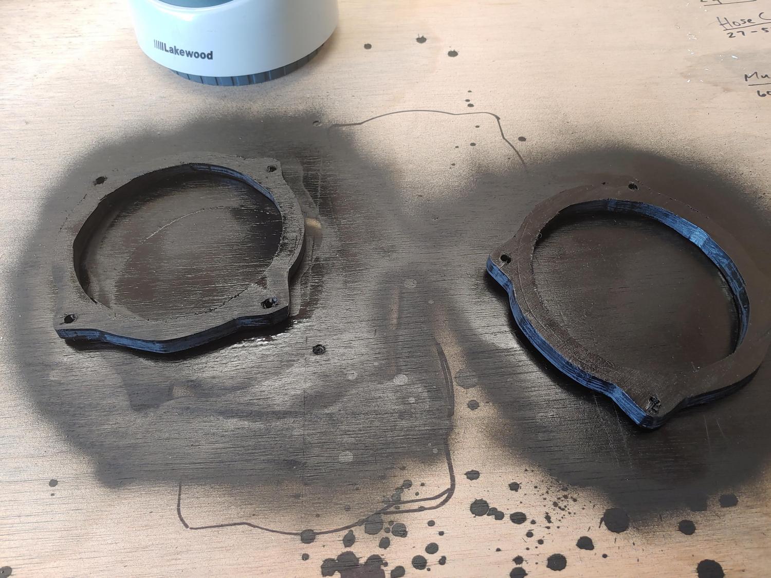

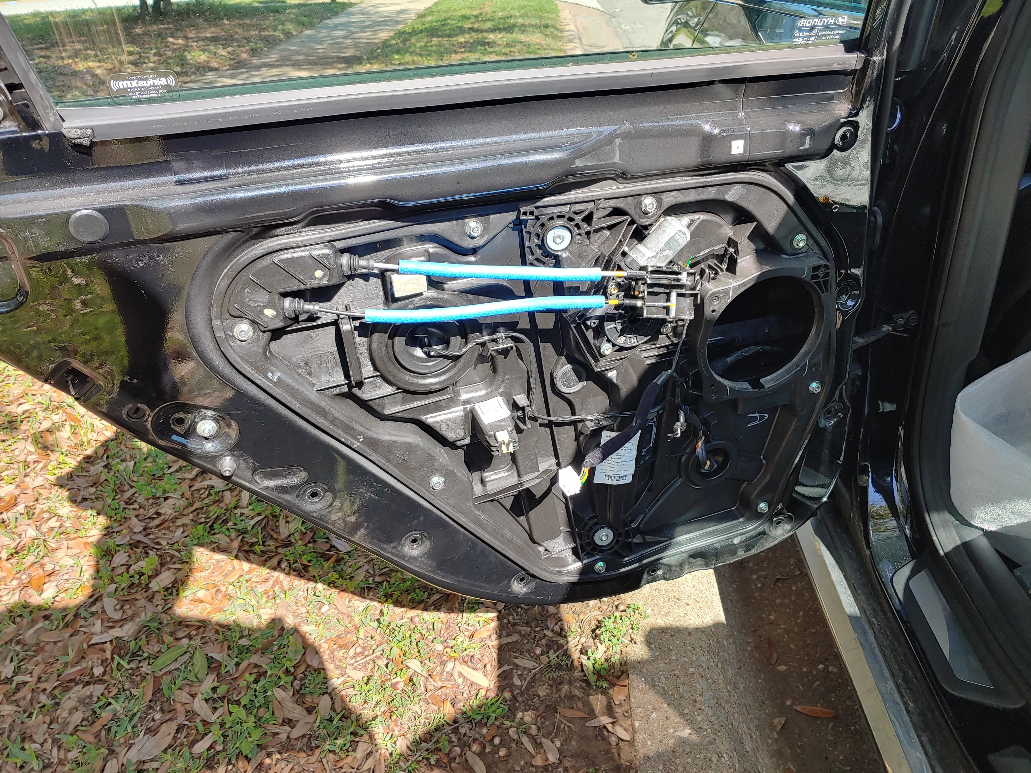

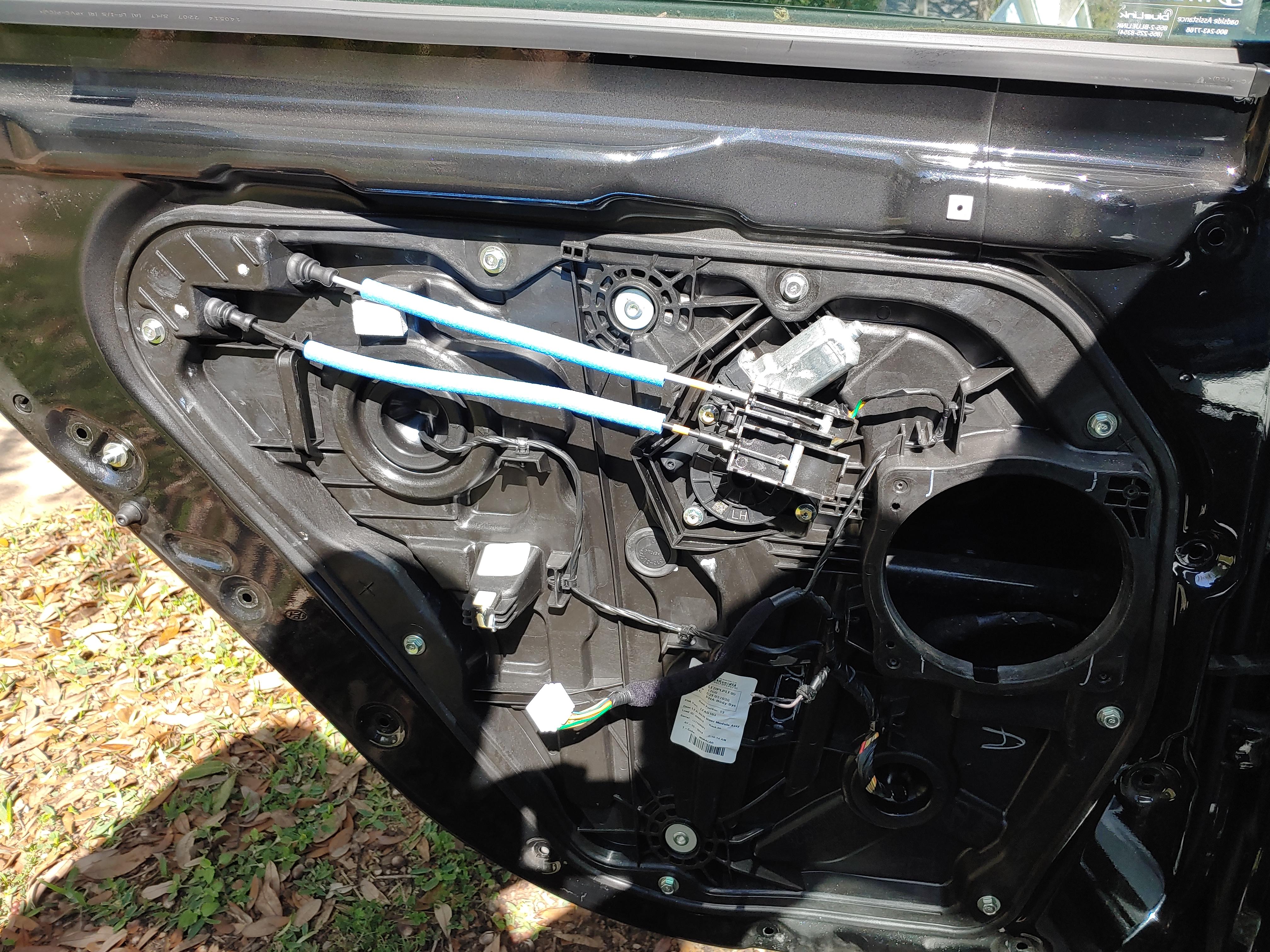

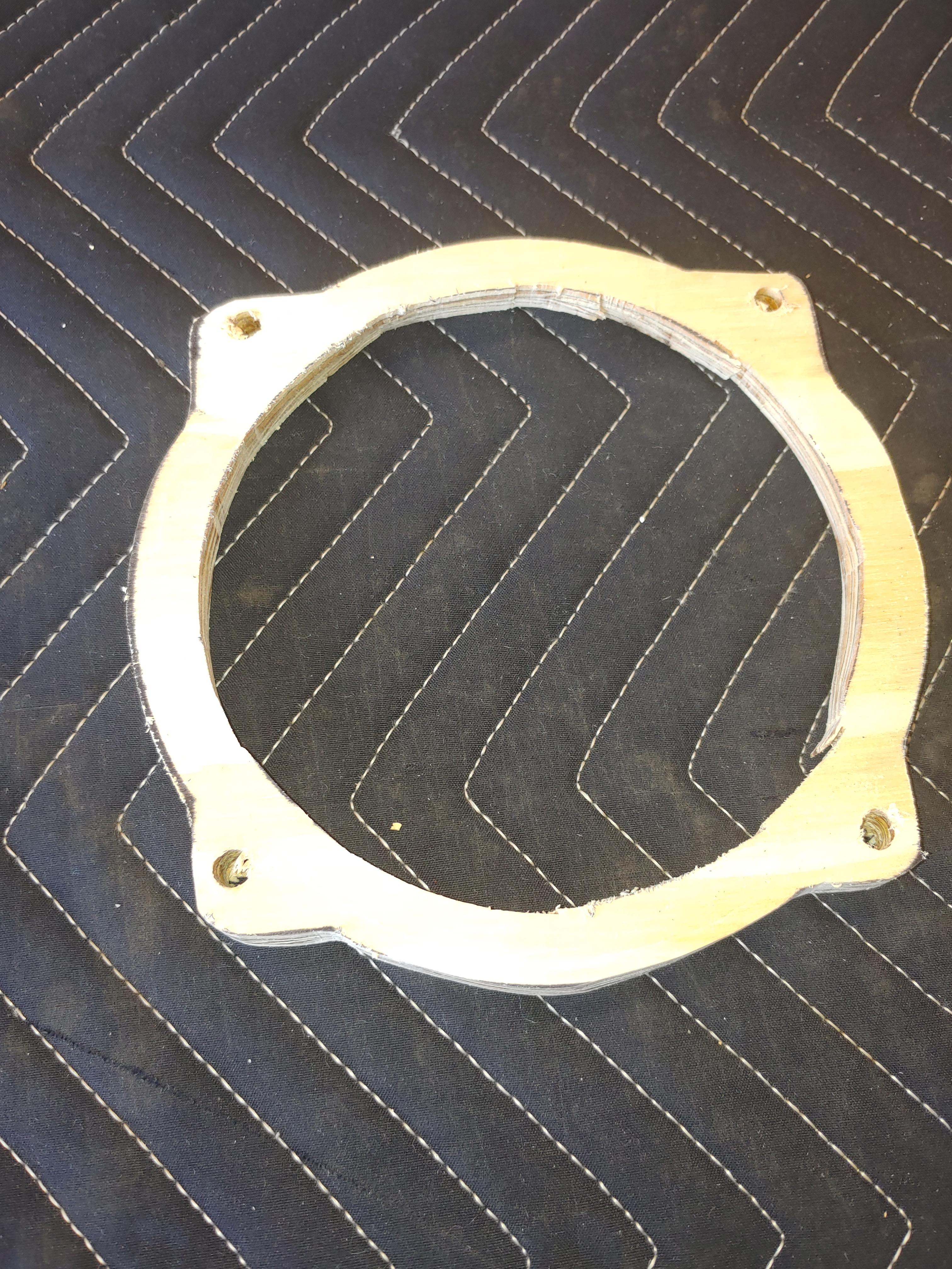

Im upgrading the rear door speakers so I needed some speaker rings made. Didnt feel like waiting on hdpe board to get here since thats what my front door speaker rings are made of. Found some wood at work and used a co-workers jigsaw to make these, also covered with paint to match the door panel.
Filled the back door with some Silver Flutes 6.5s just for the time being as Im working on my front doors, either a pair of 6.5s or a pair of 8s or a single 8. Either way the front doors will be getting glassed.

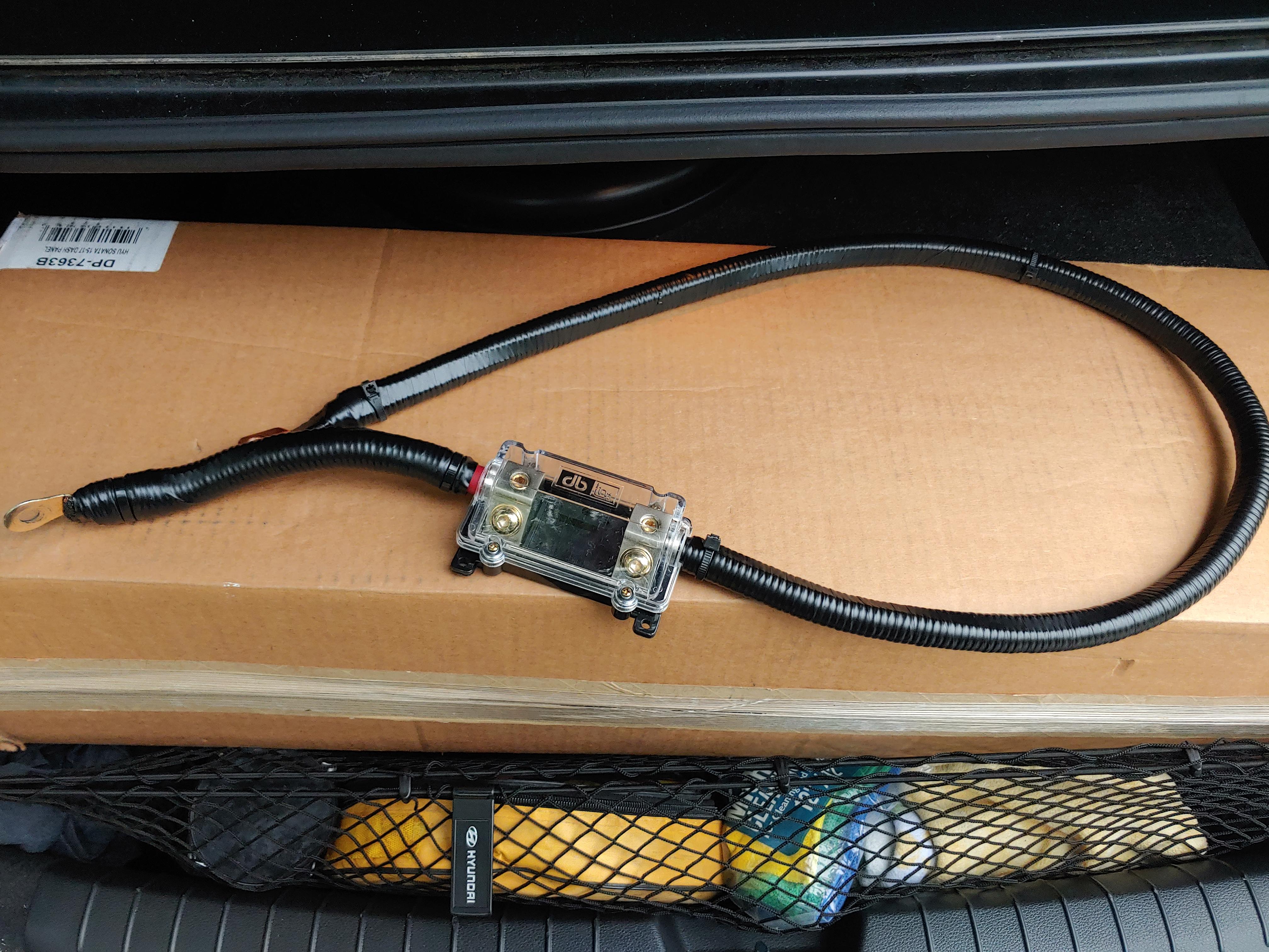

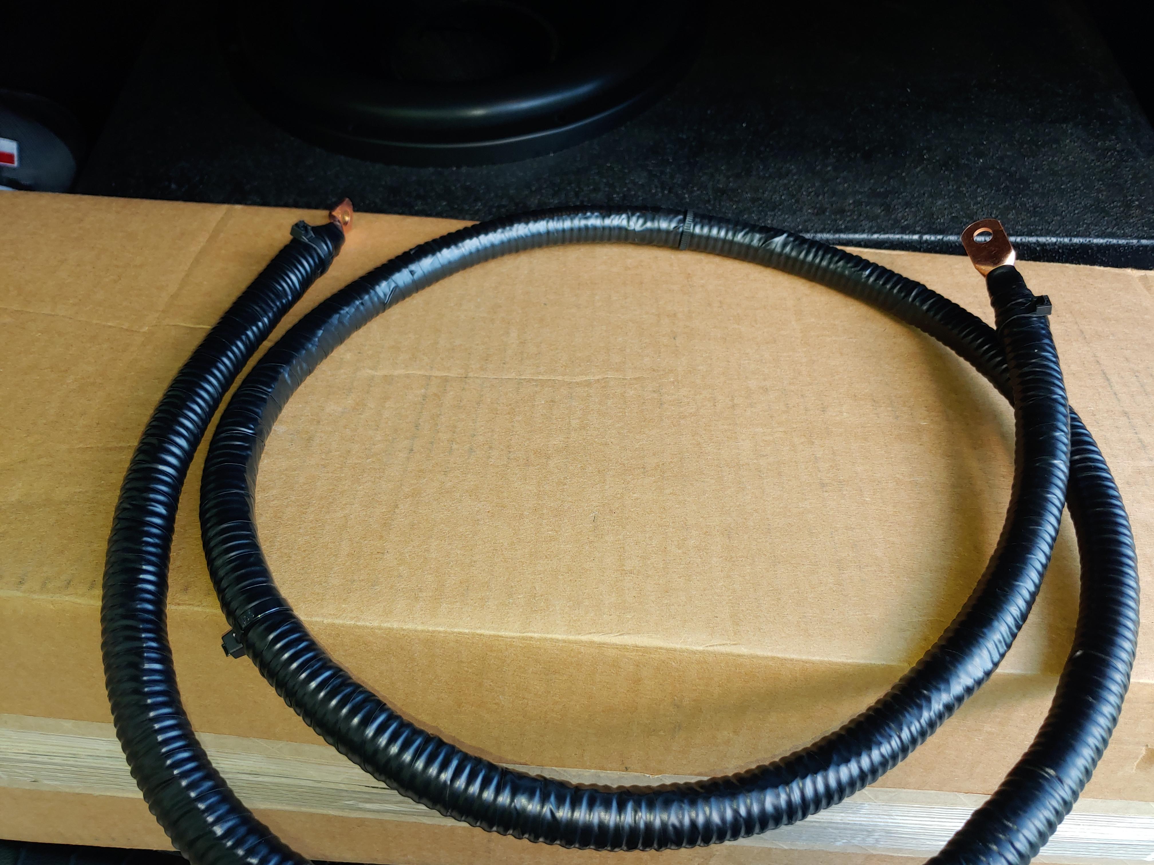

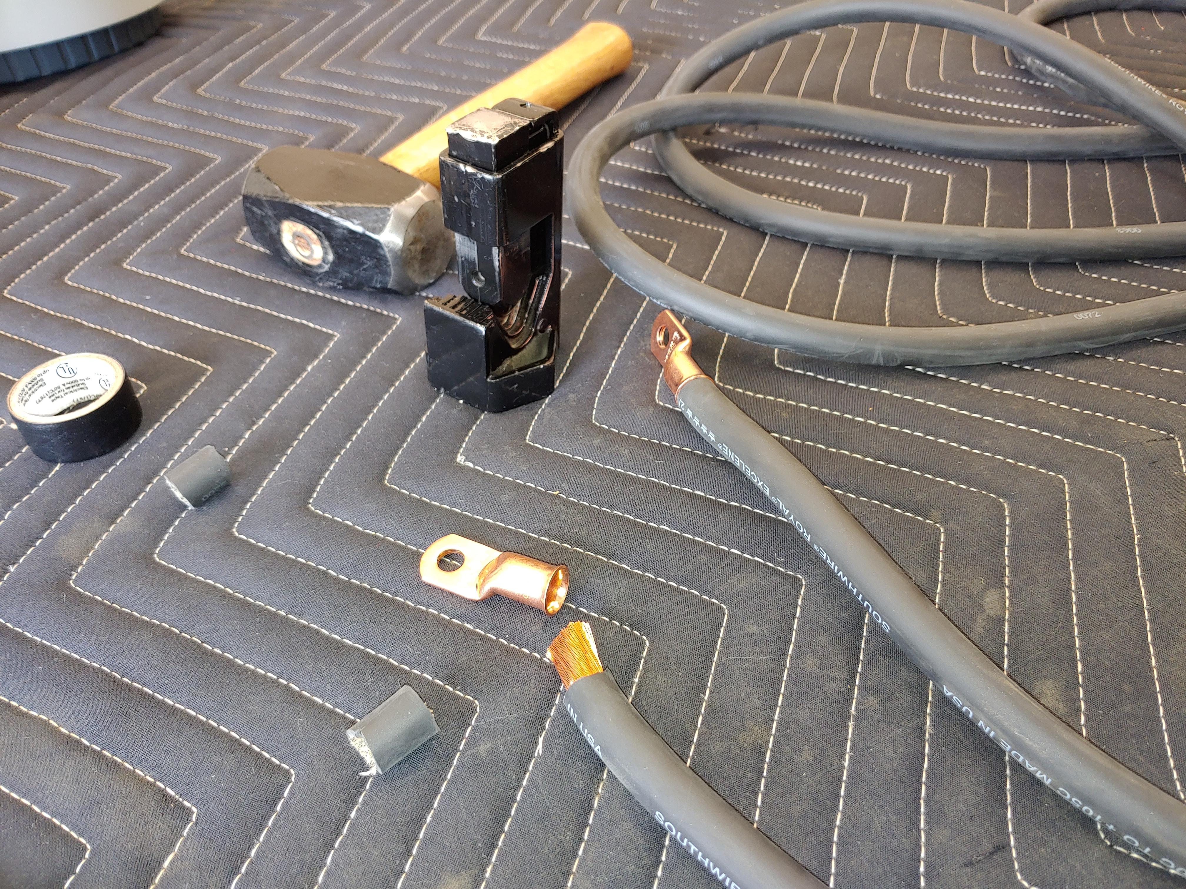

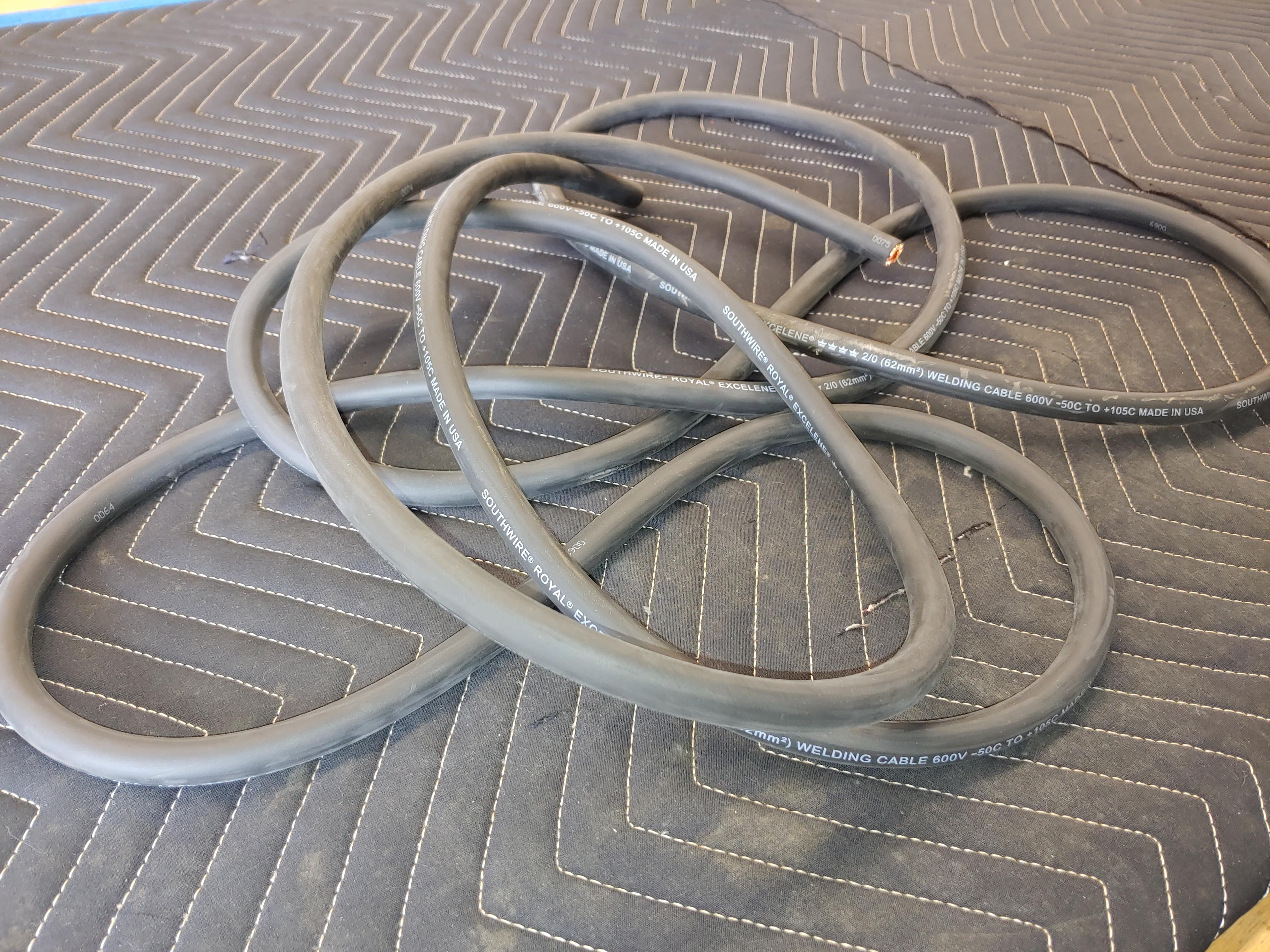

Picked up some 2/0 welding cable for my H/O runs under the hood.
Ground wire is complete, covered in wire loom and two layers of electrical tape for protection. I also zip tied to keep the tape from unsticking together from the engine heat and Texas heat.

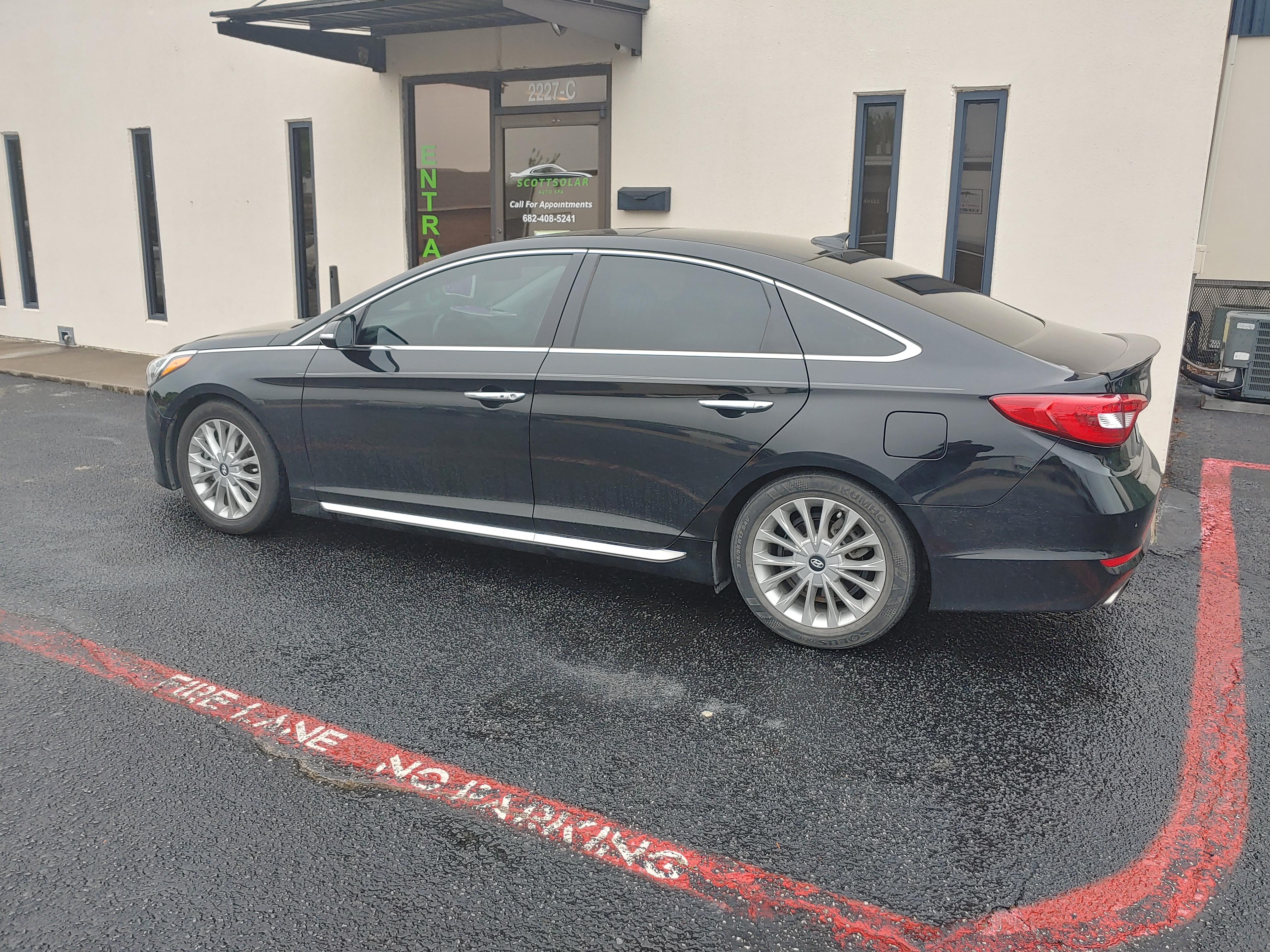

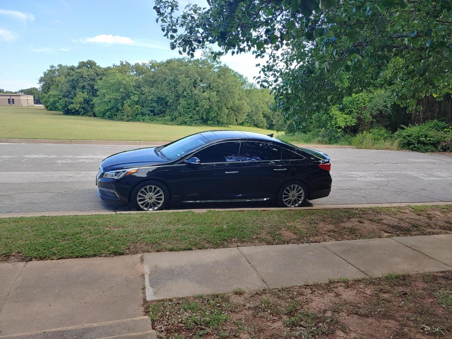

Long over due tint job.
Front Doors - Ceramic 30%
Rear Doors / Back Glass - Ceramic 5%
Panoramic Sunroof - Ceramic 50%
Edited by jcarter1885

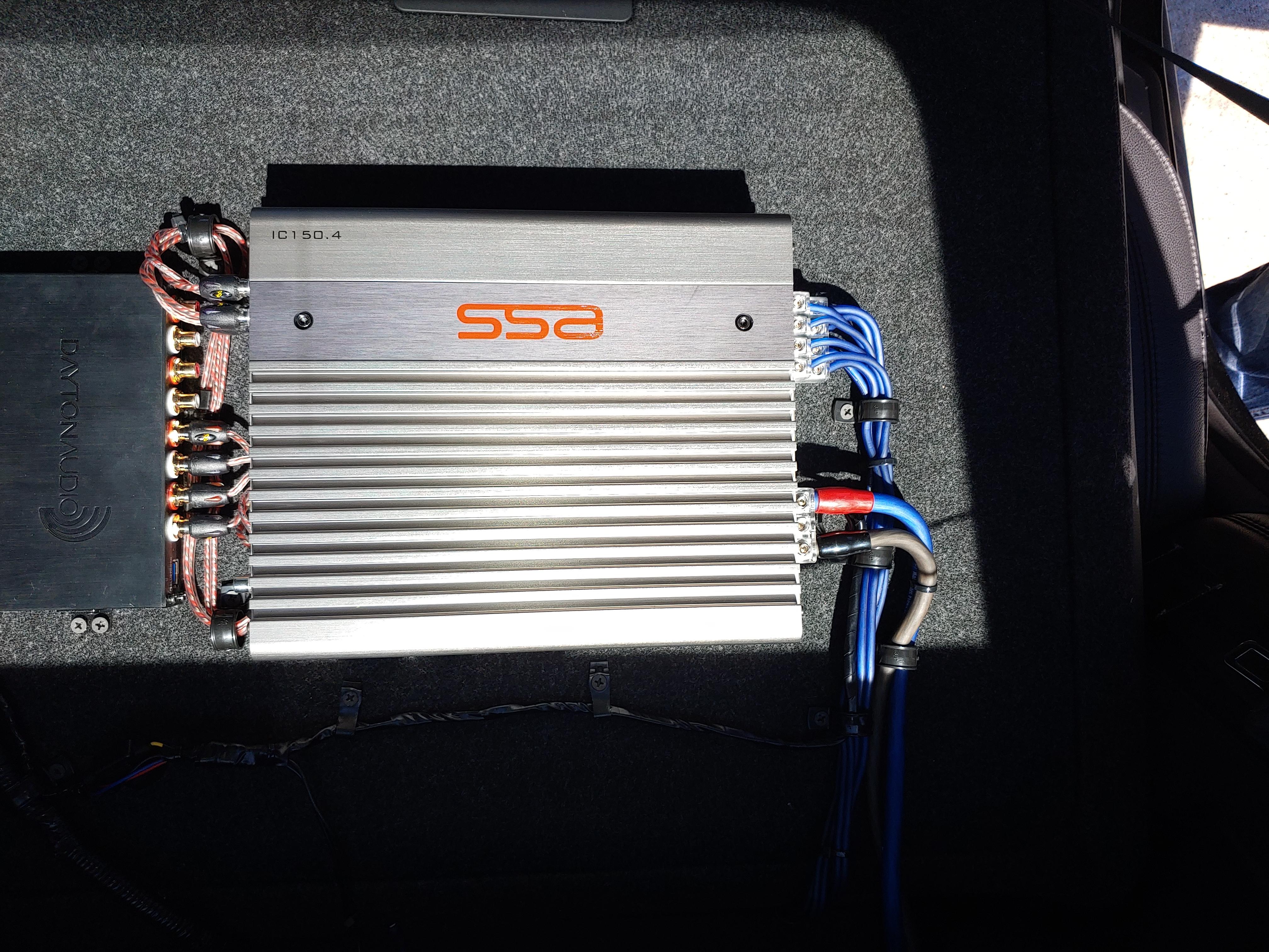

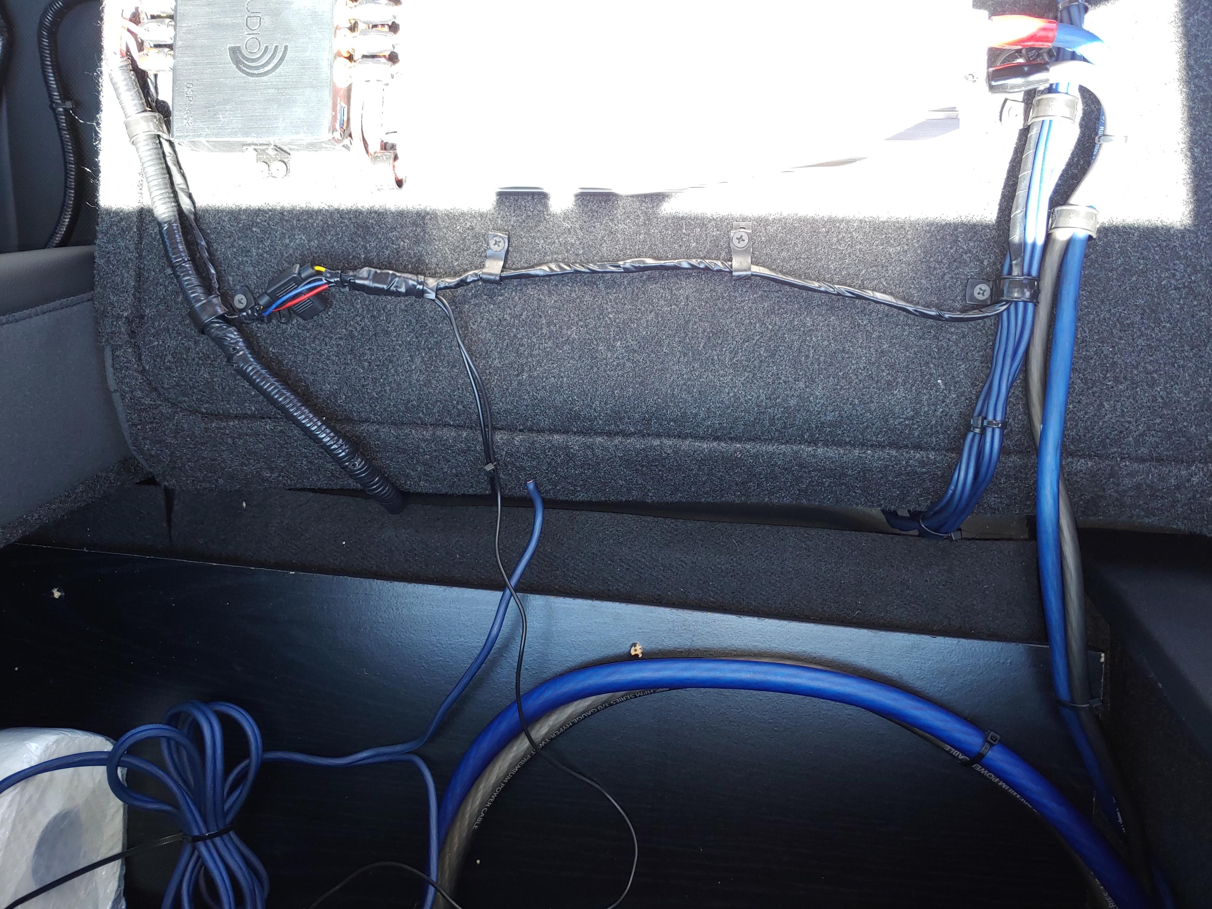

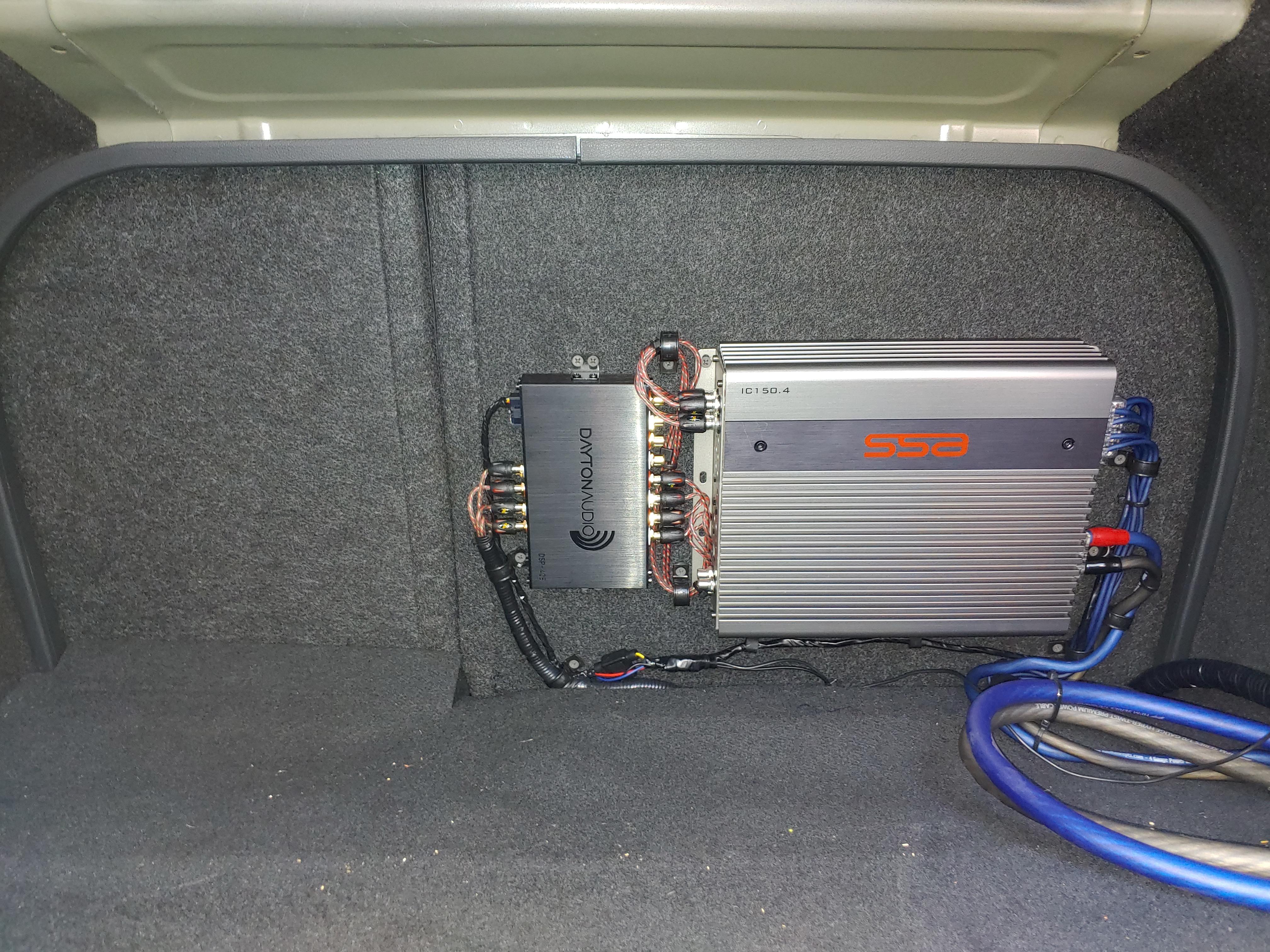

Decided against using the amp board and just mounting my amp straight to box, I have vibration dampers that will go underneath the amp's feet. View of Front Stage Amp and DSP from trunk opening.

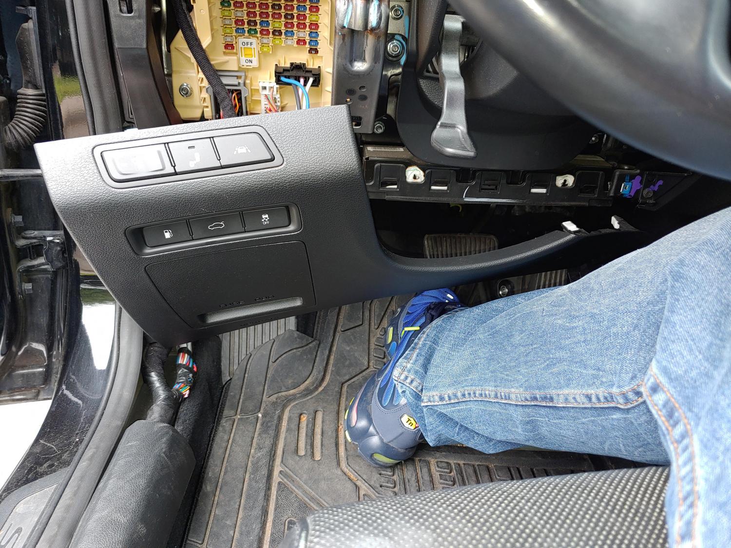

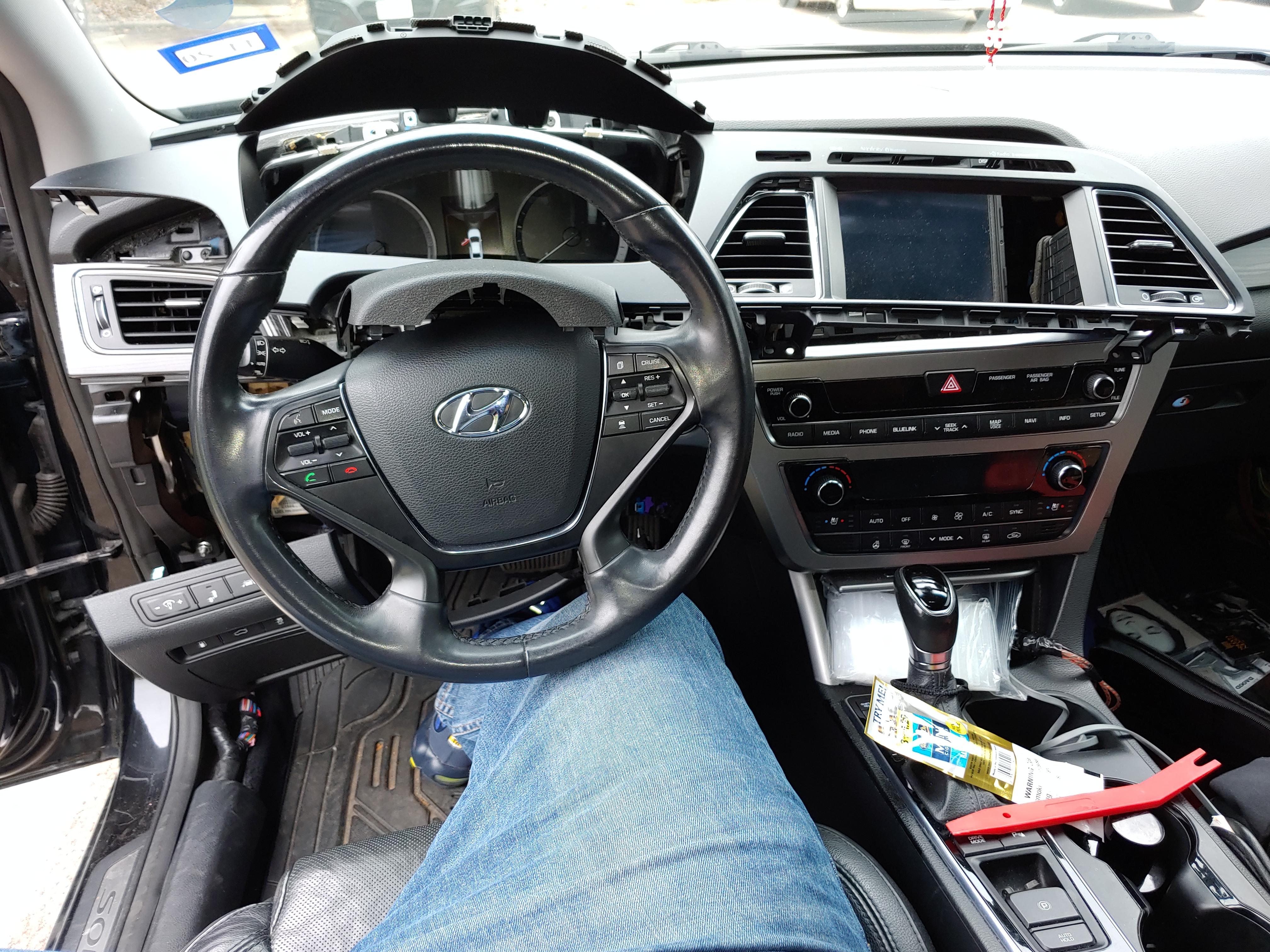

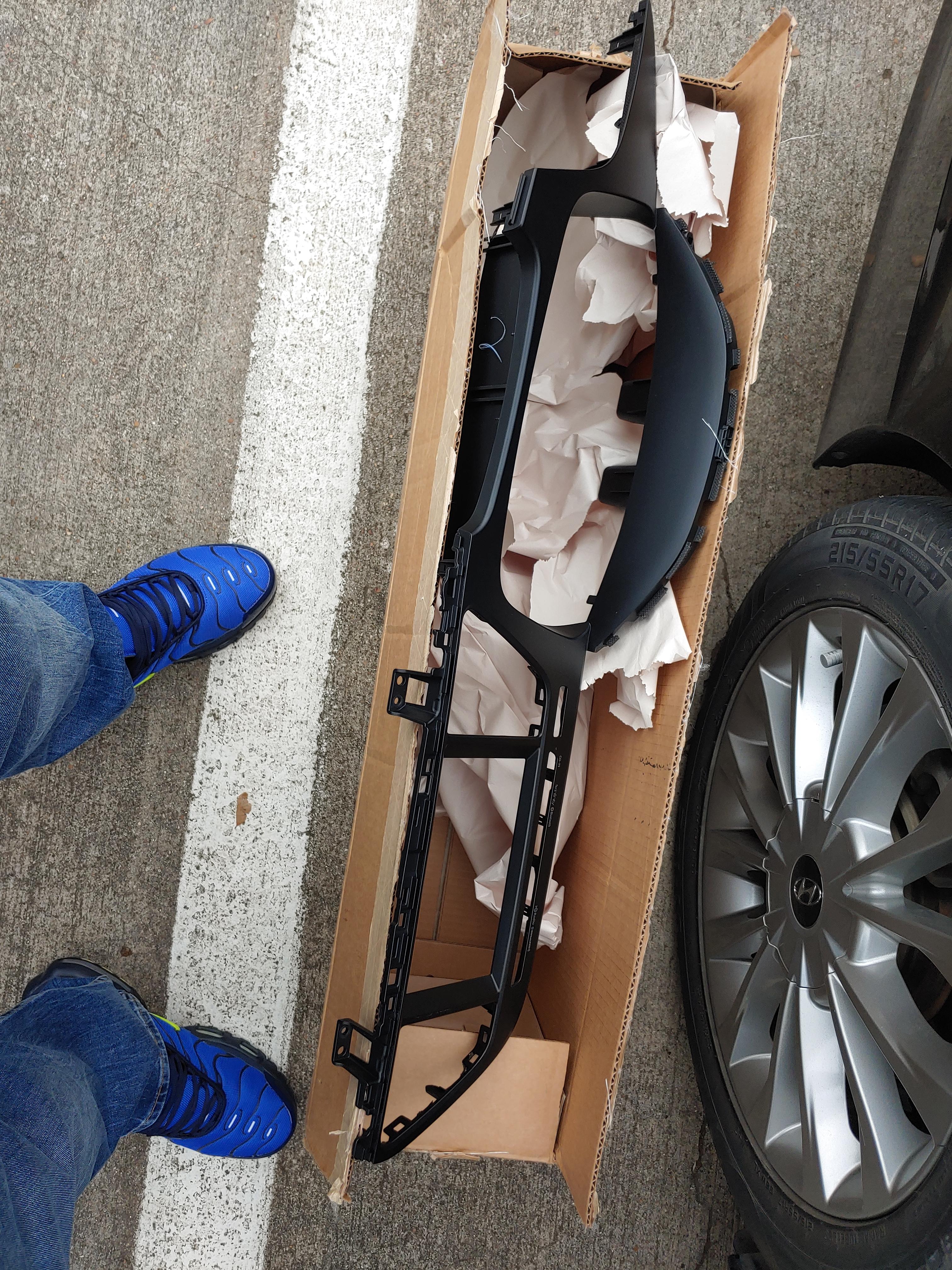

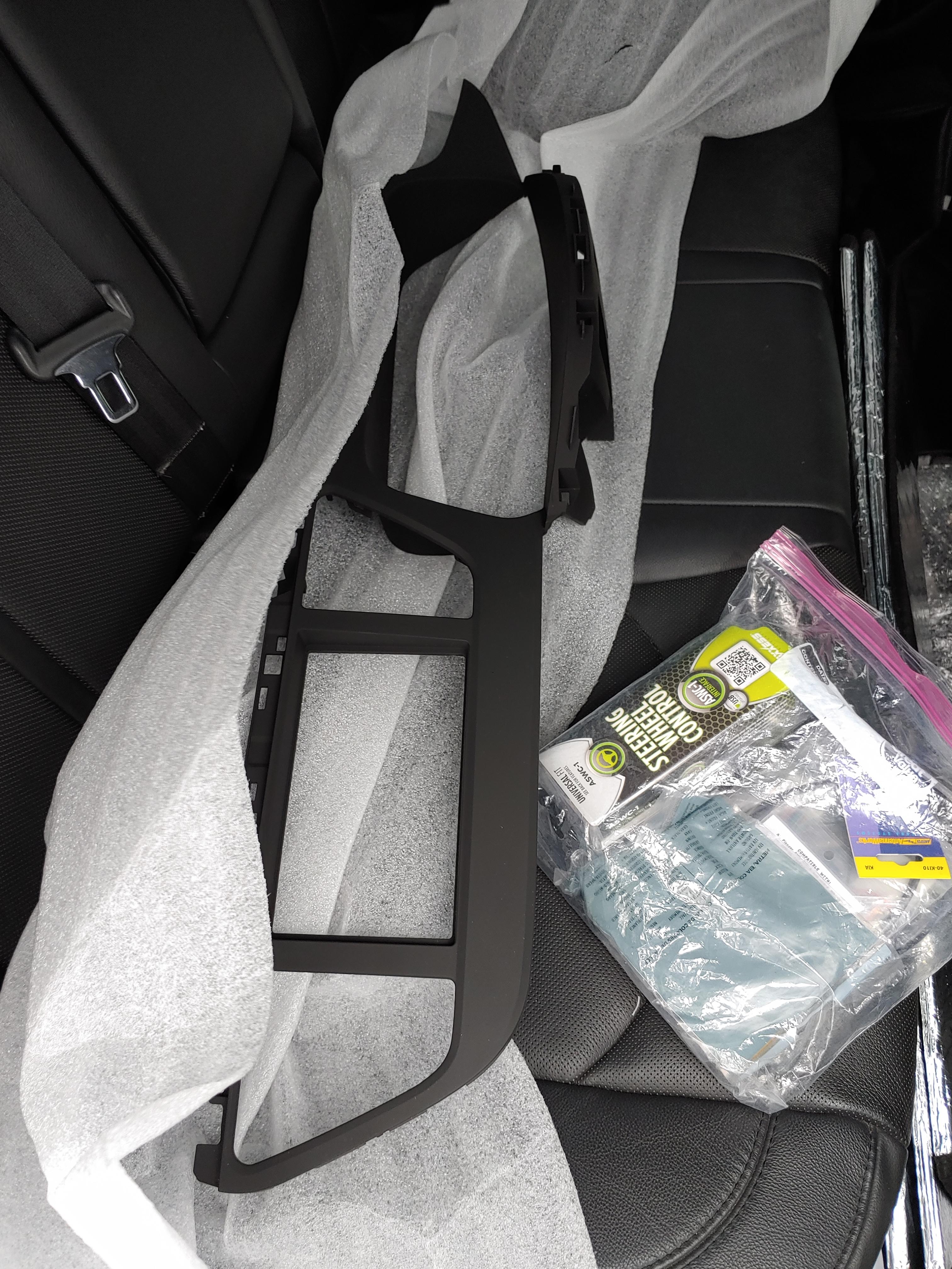

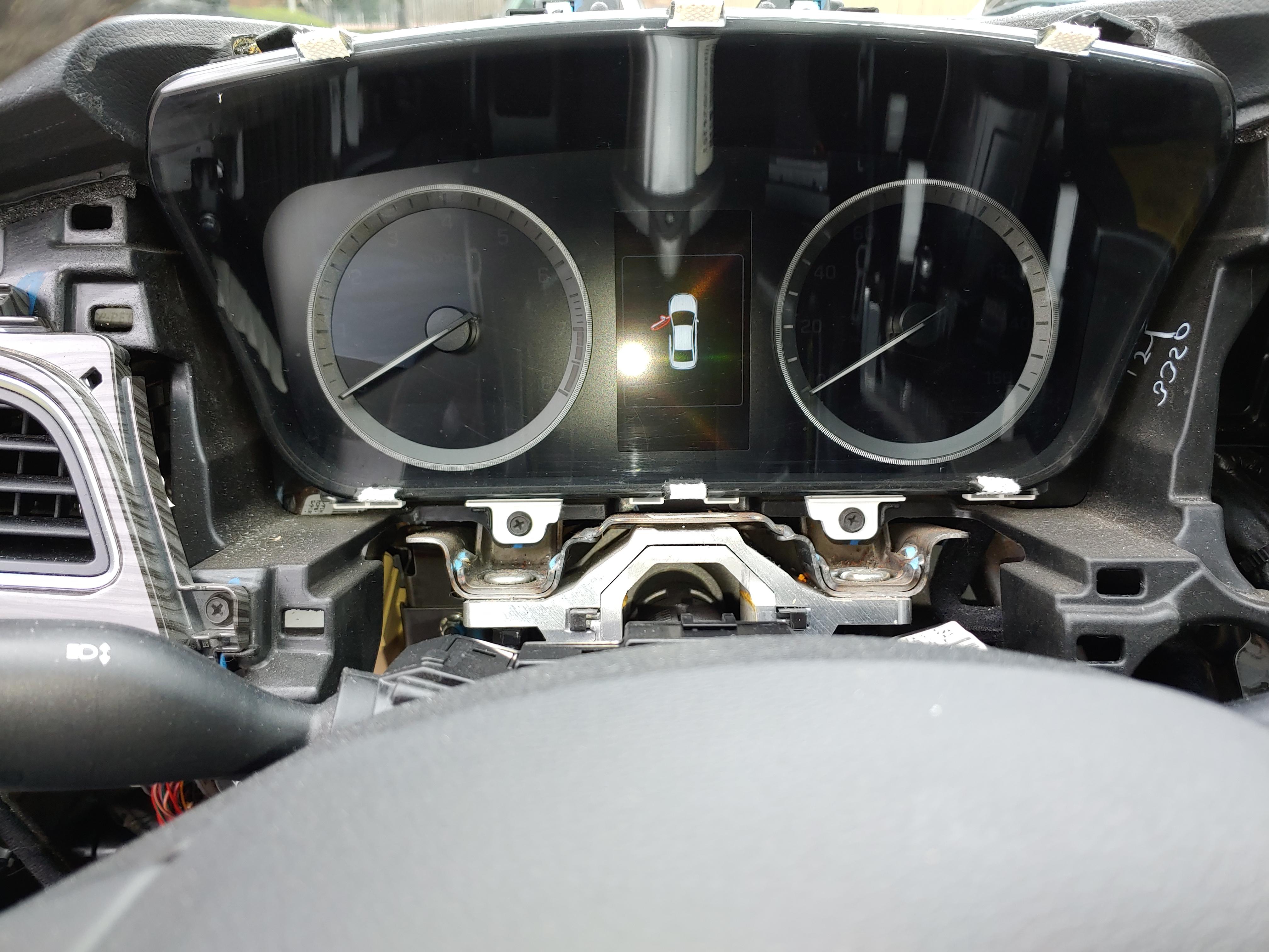

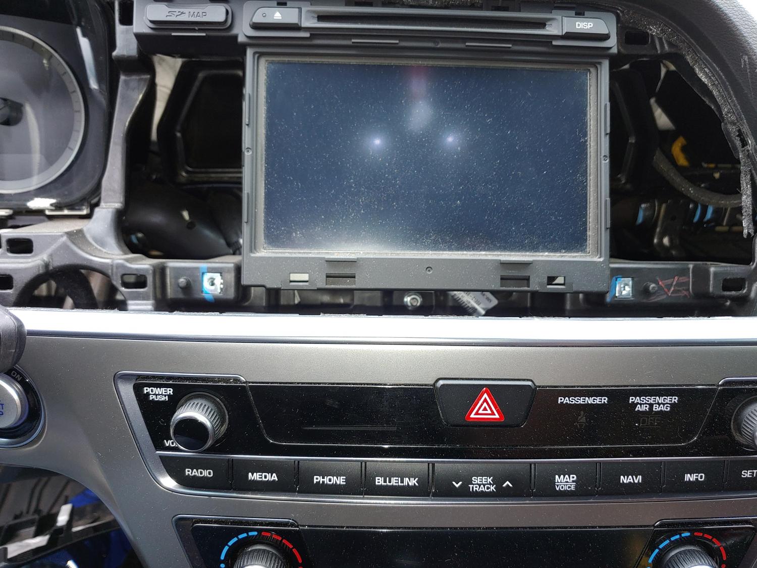

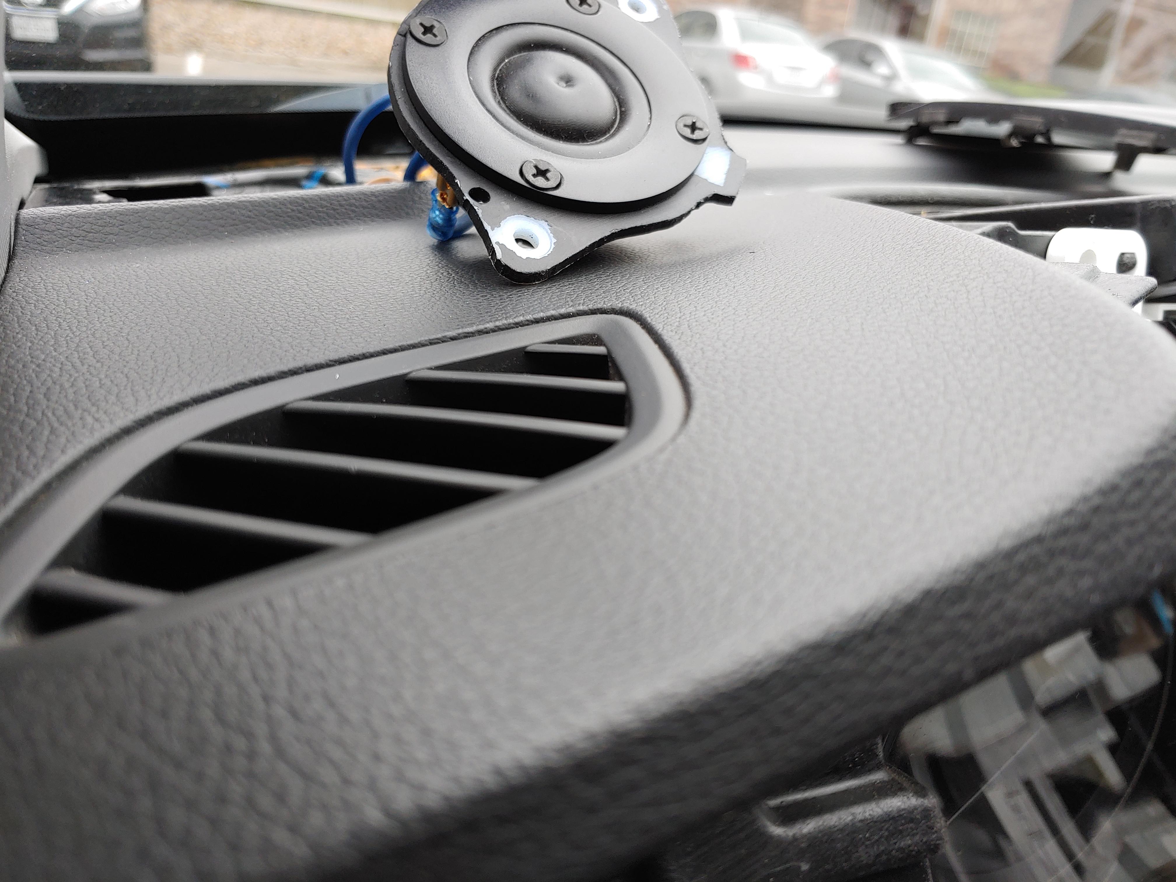

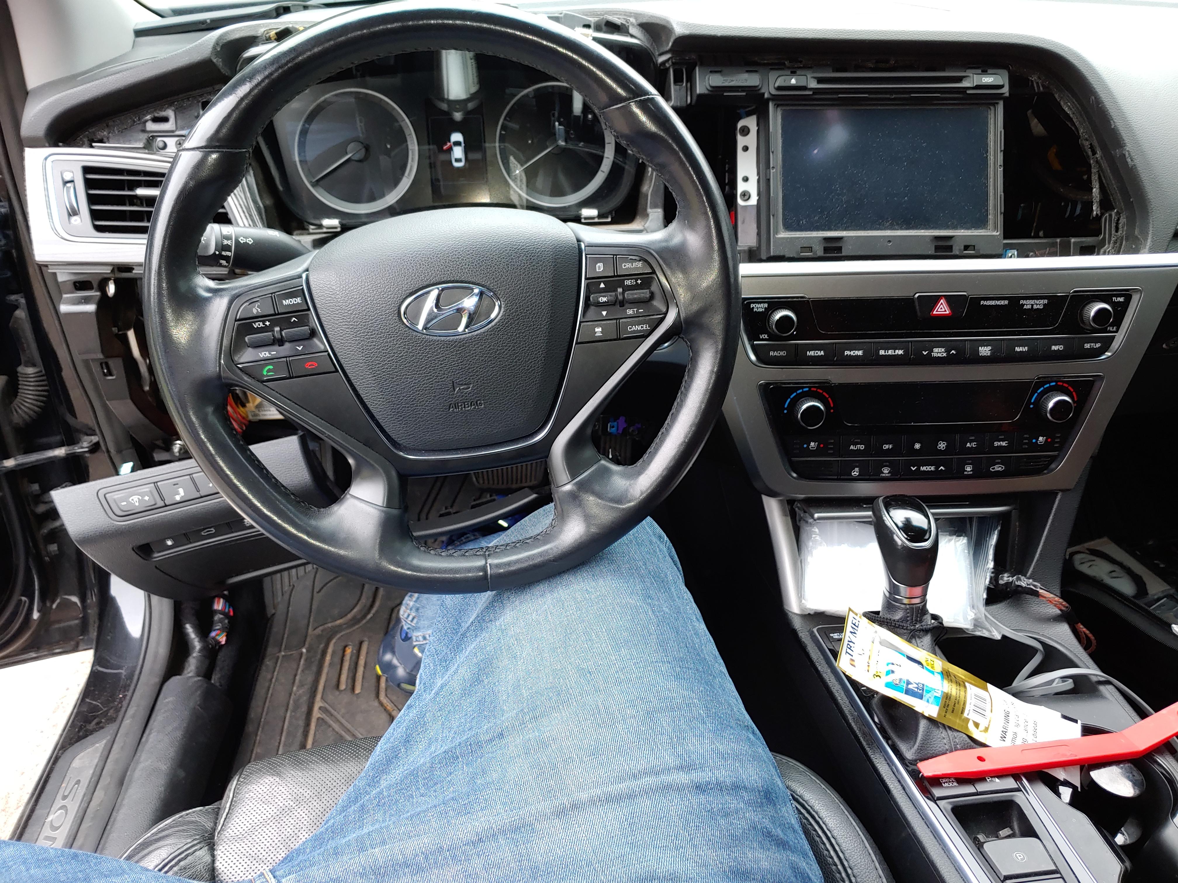

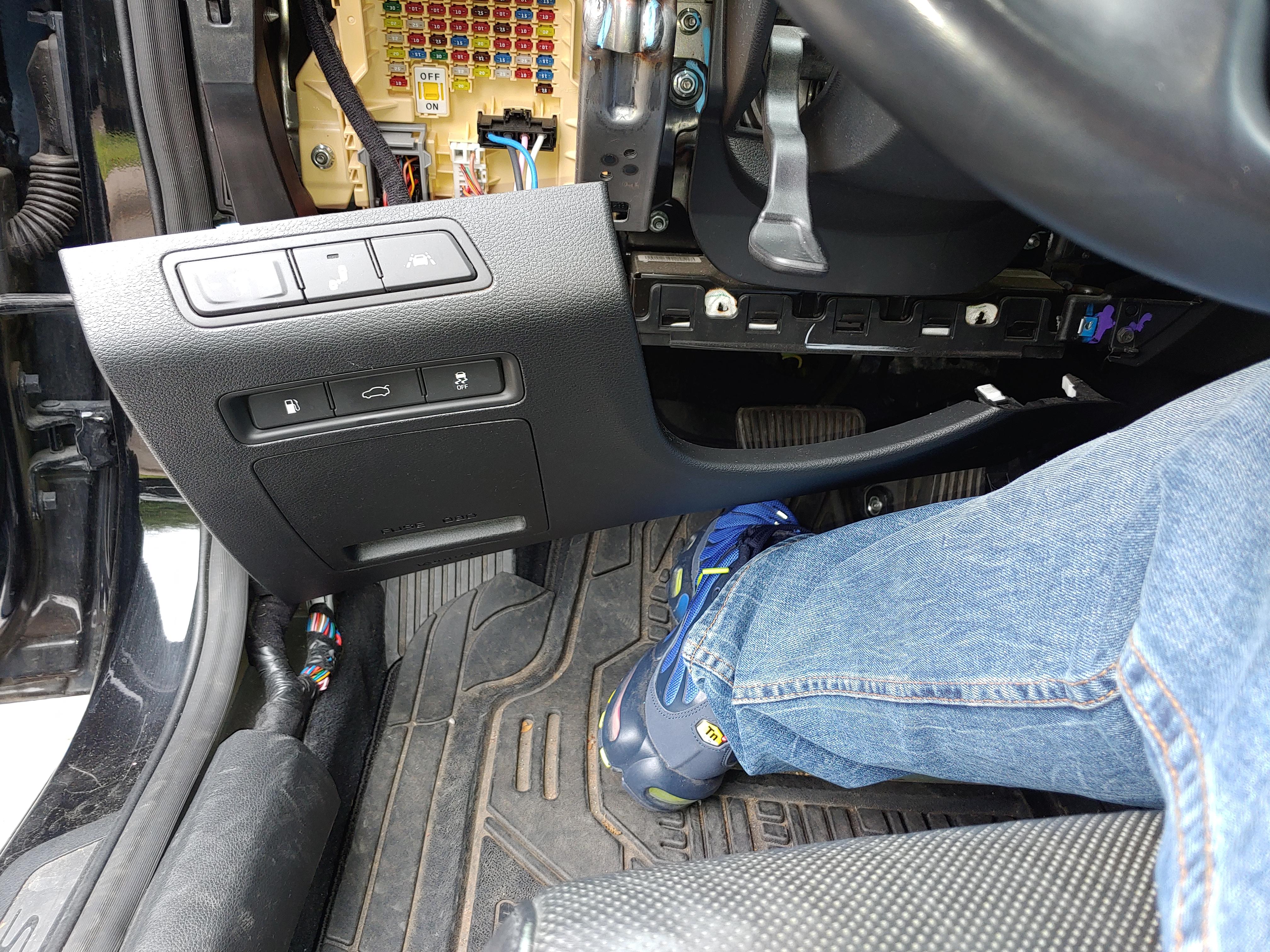

Slow process for the weekend, the whole dash has to come apart and I still have to rewire speakers from the factory wire to the new wire I ran awhile back. Once that is done I have to break out the laptop and fire the DSP (digital sound processor) up so I can tune my speakers.

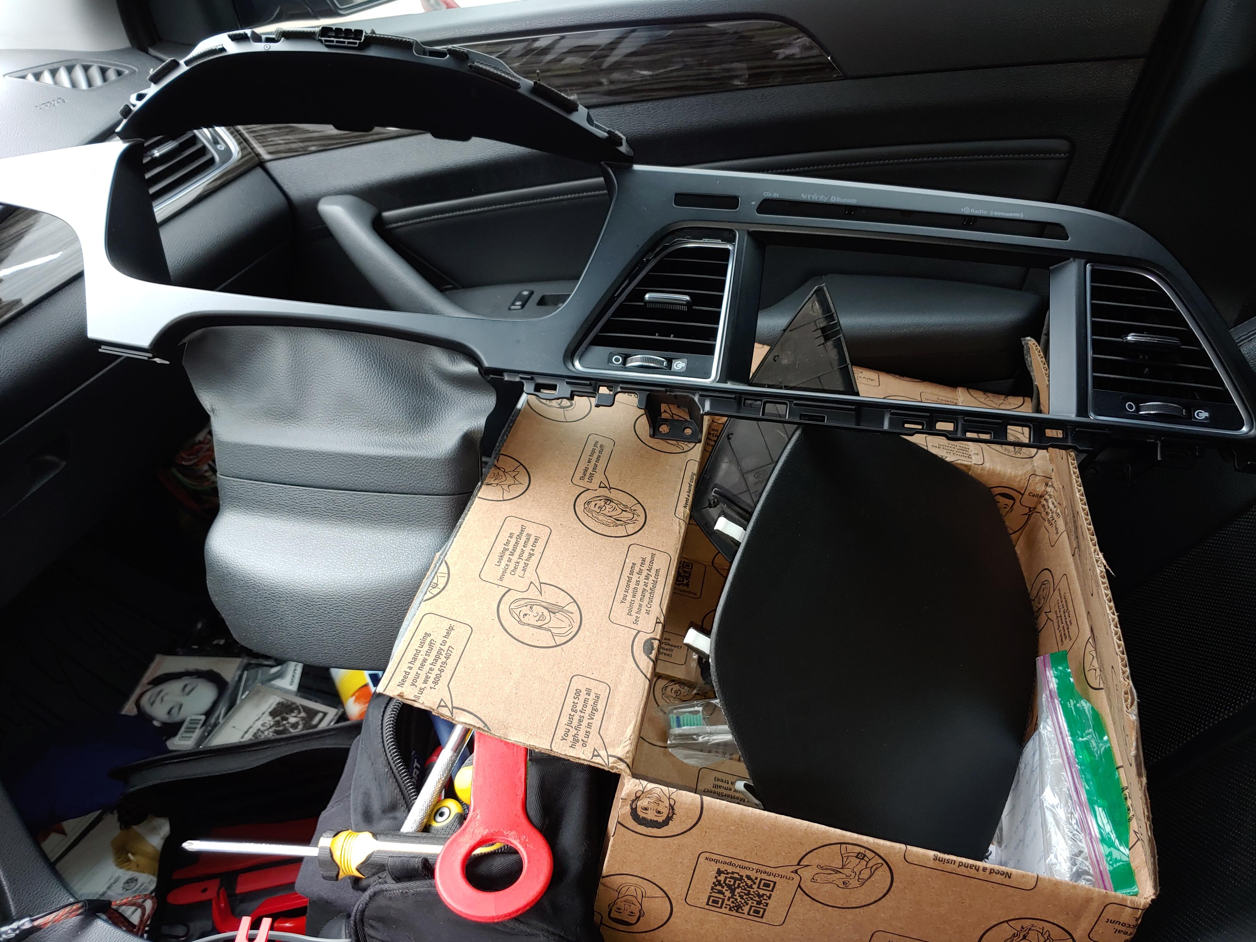

Old dash bezel vs new one, bag full of wire harnessing.

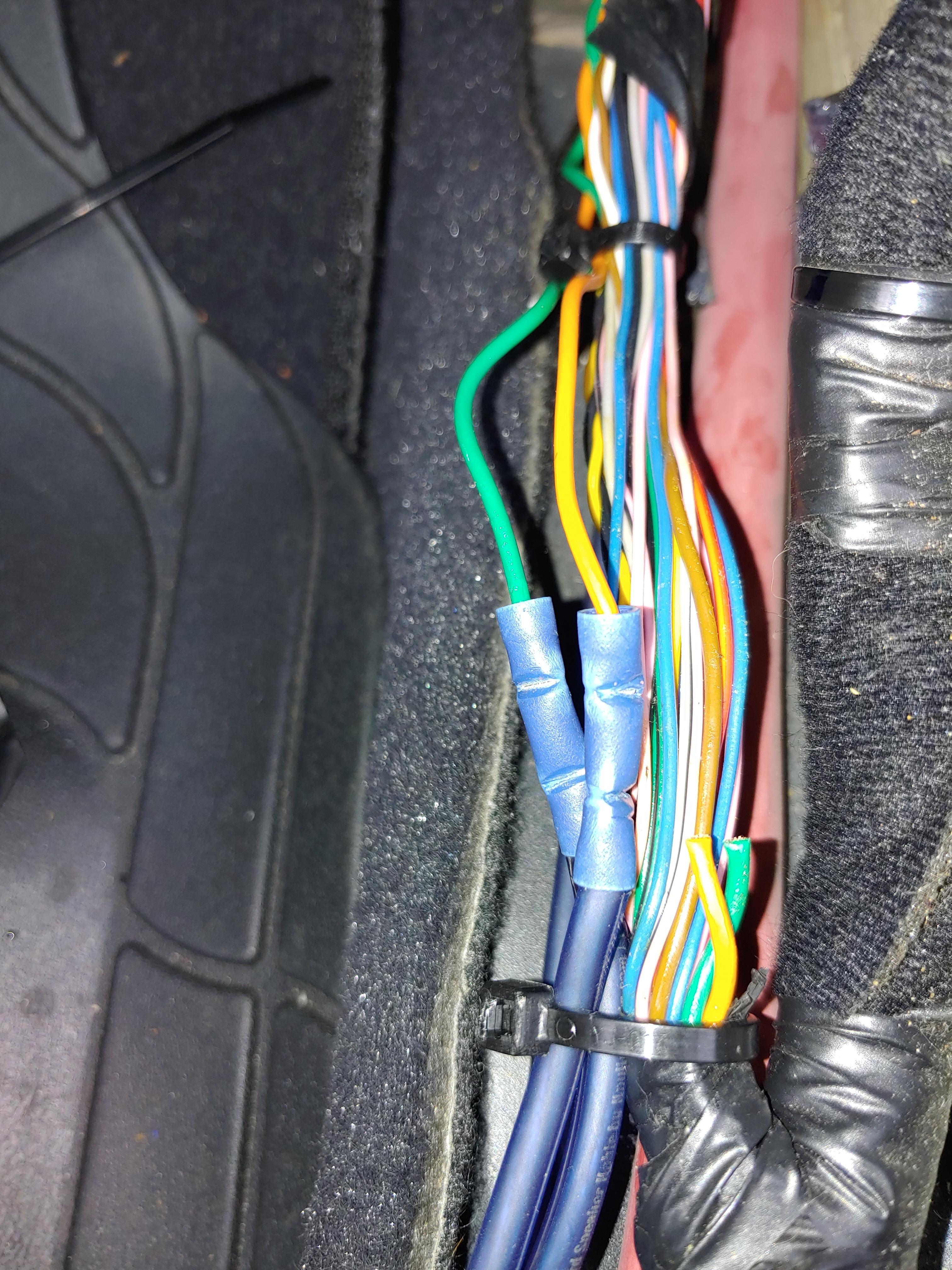

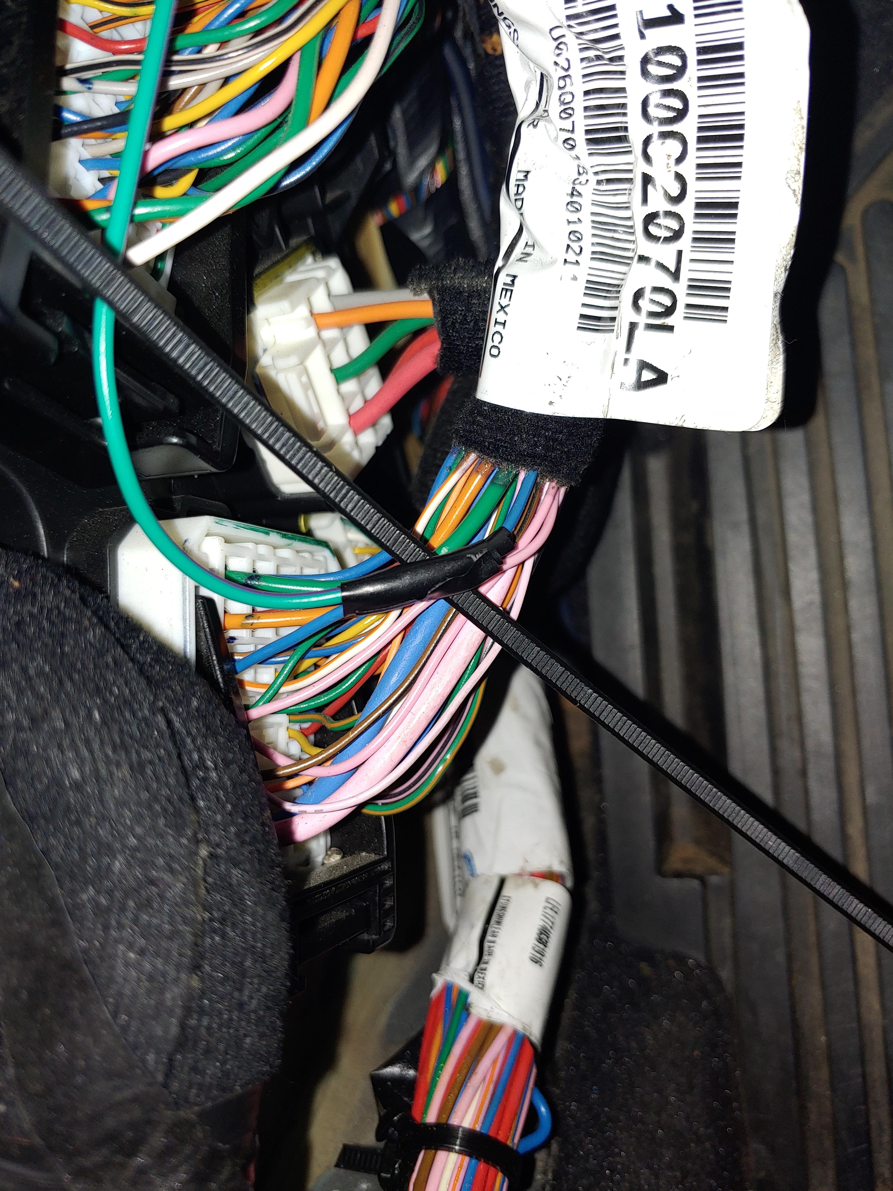

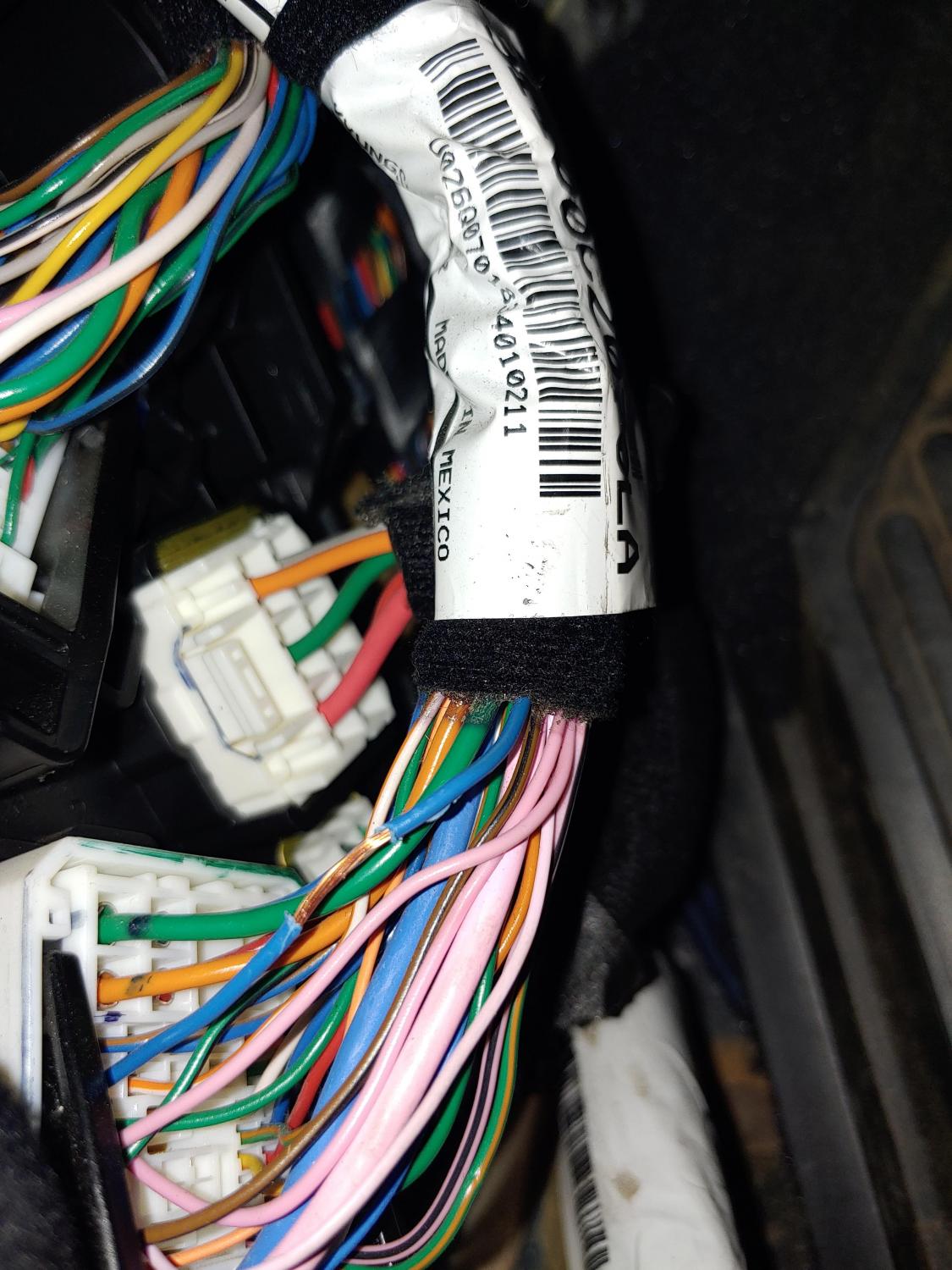

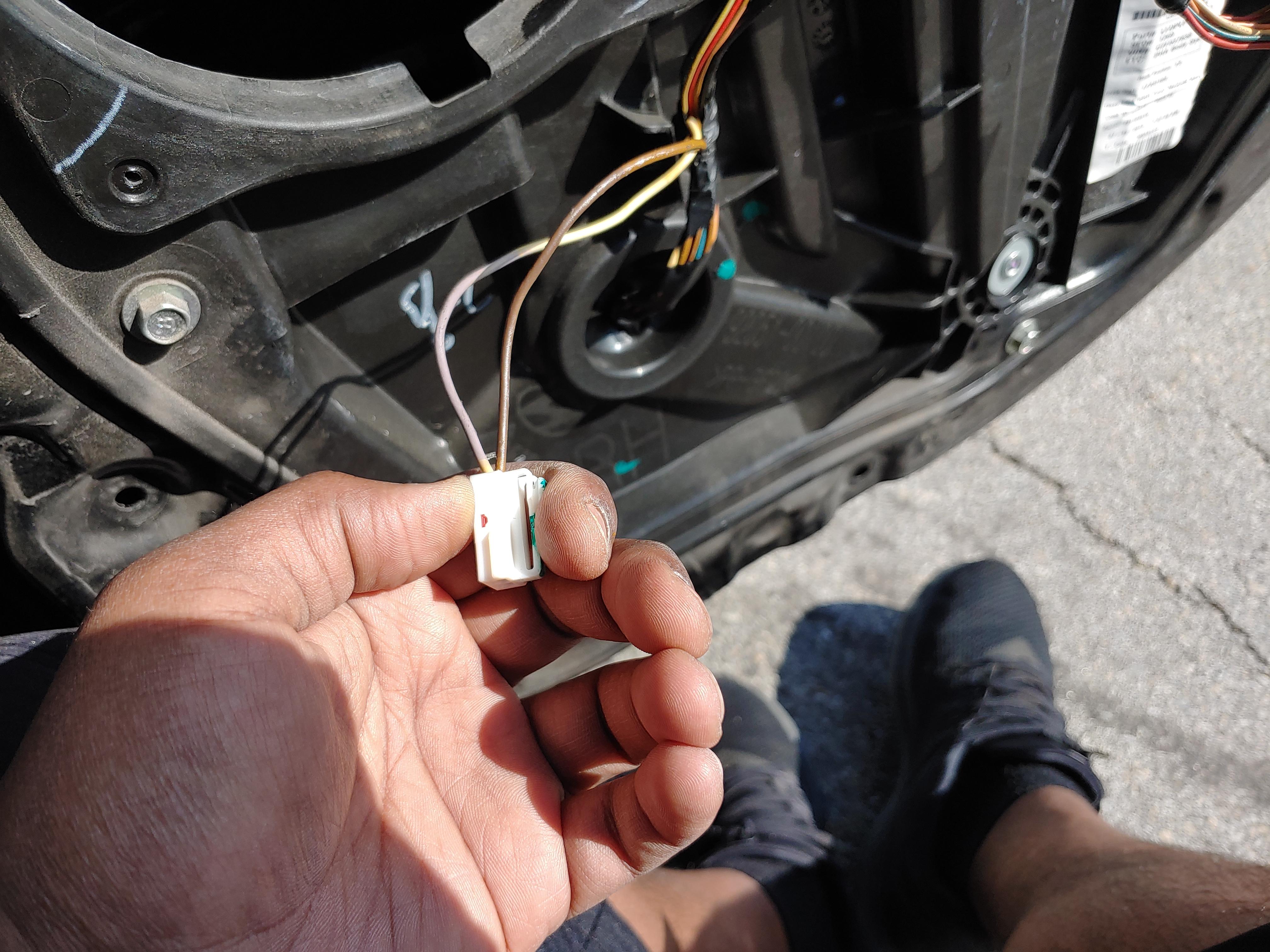

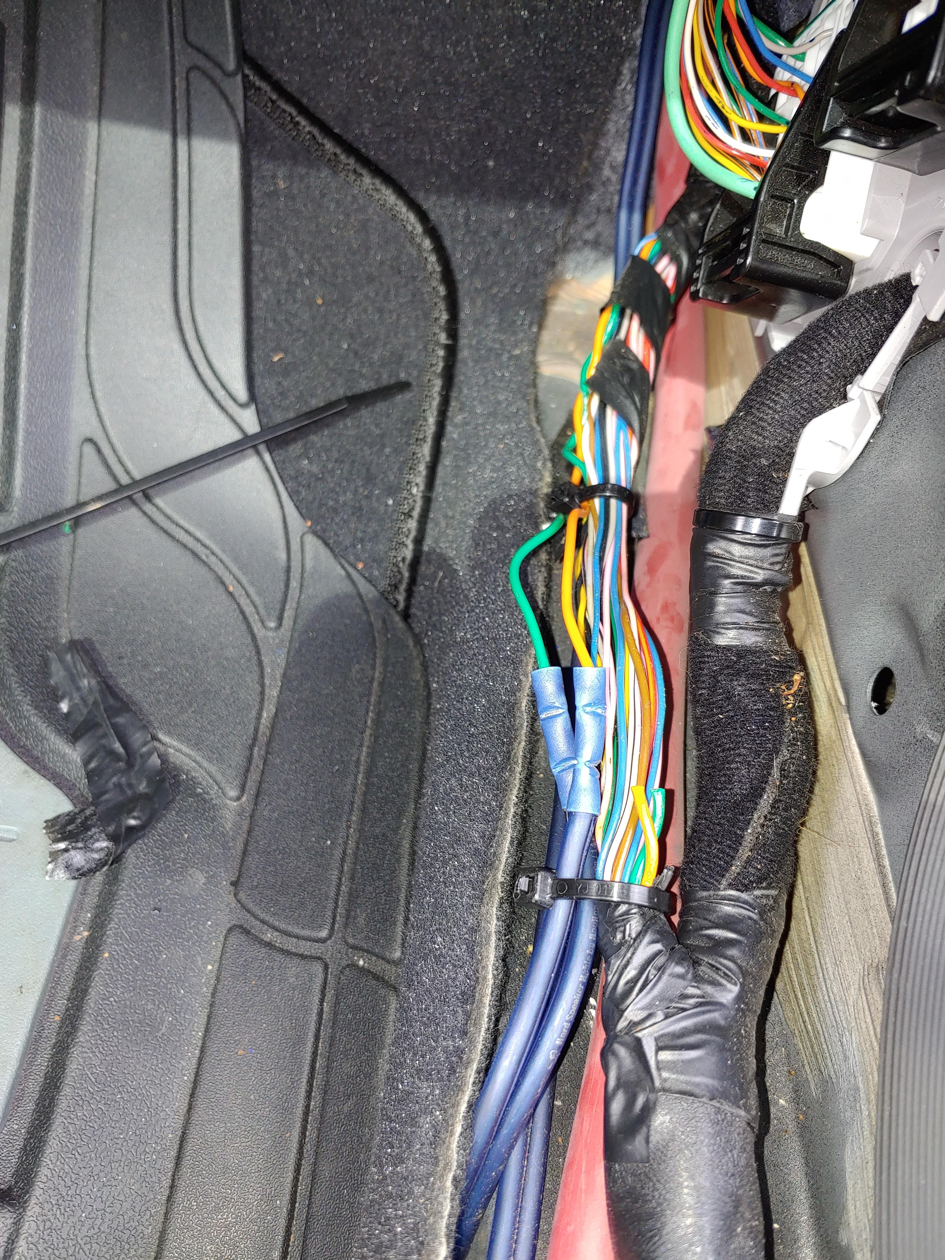

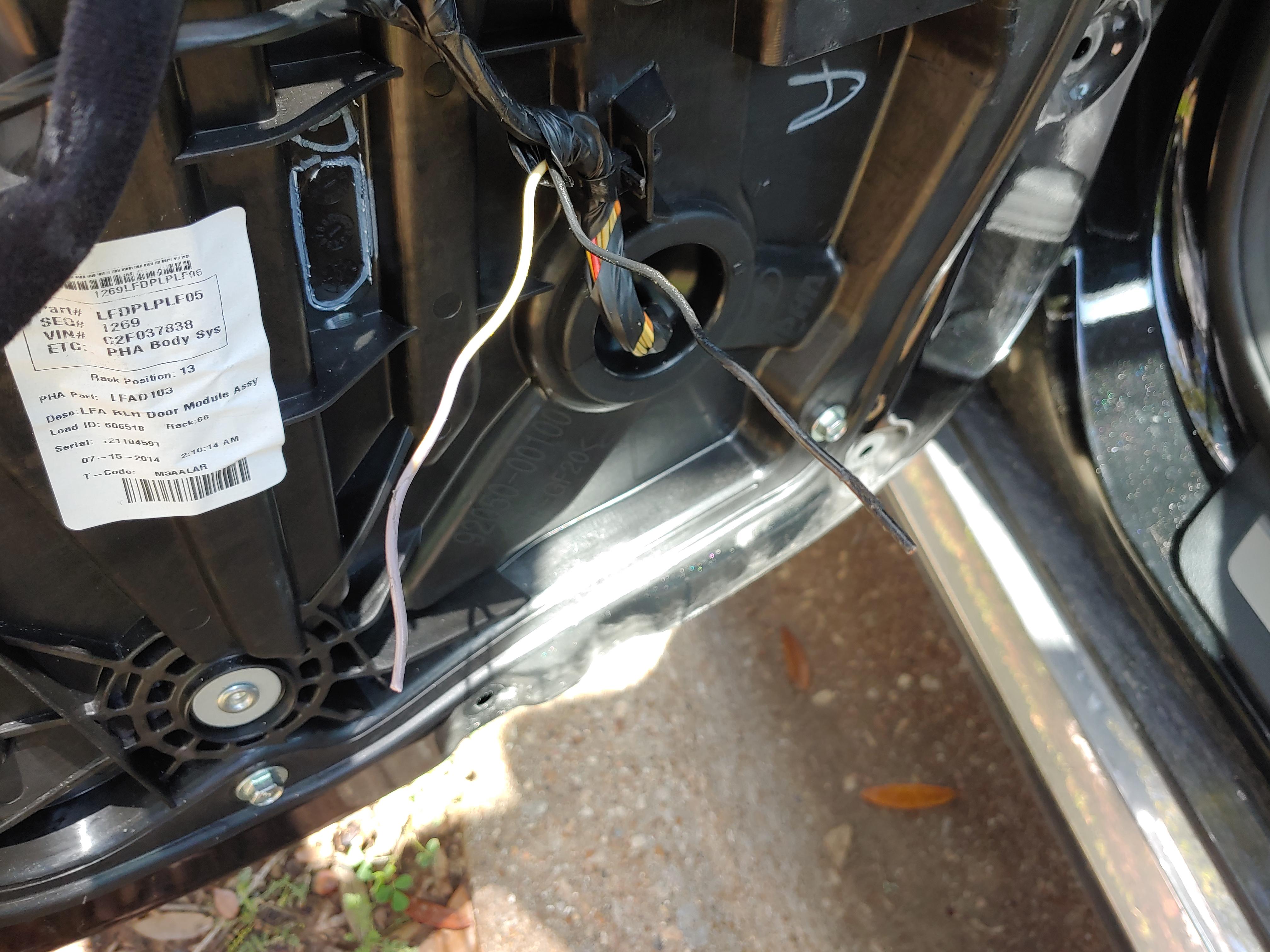

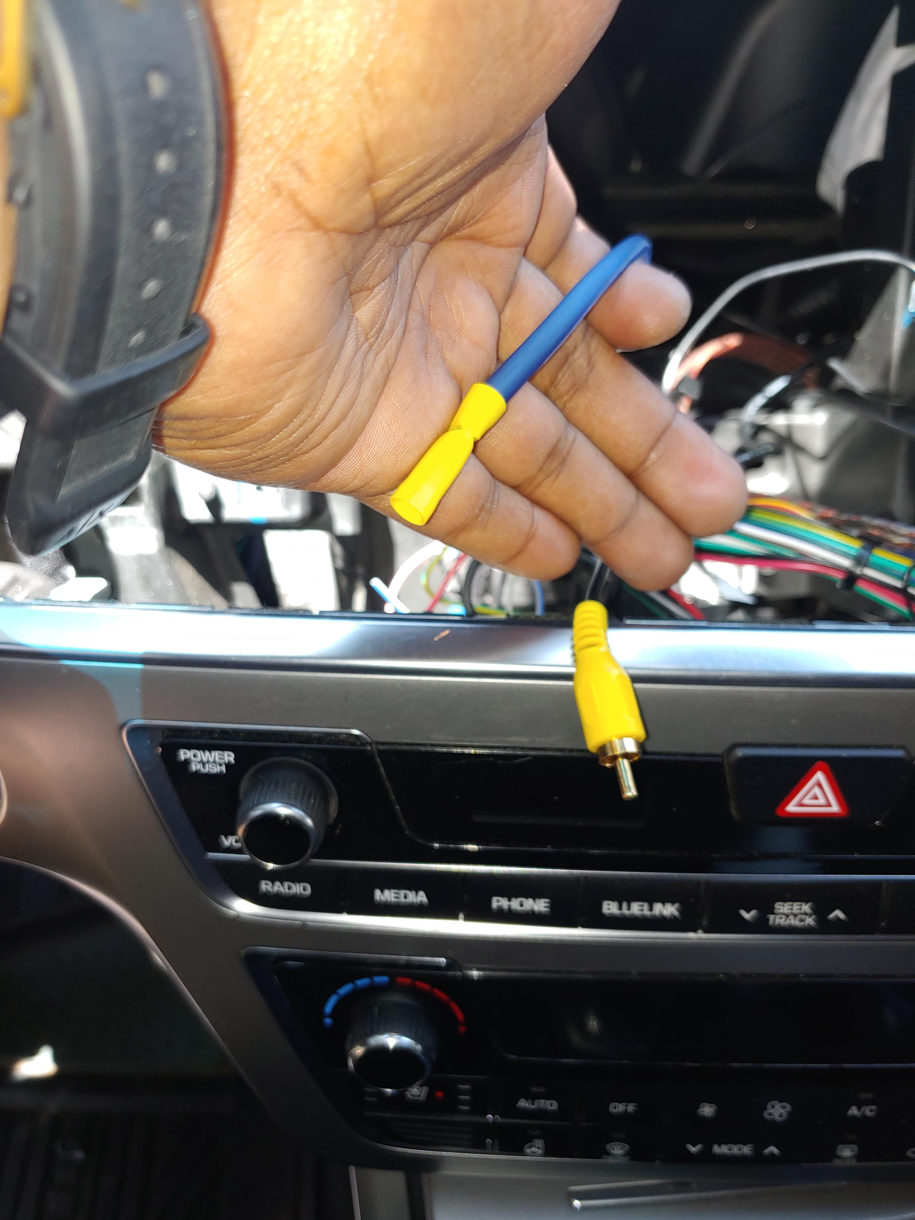

Tapped into the factory wiring since the molex plug connectors were hard to get to. Driver side looks the same just with Blue and Red wires.

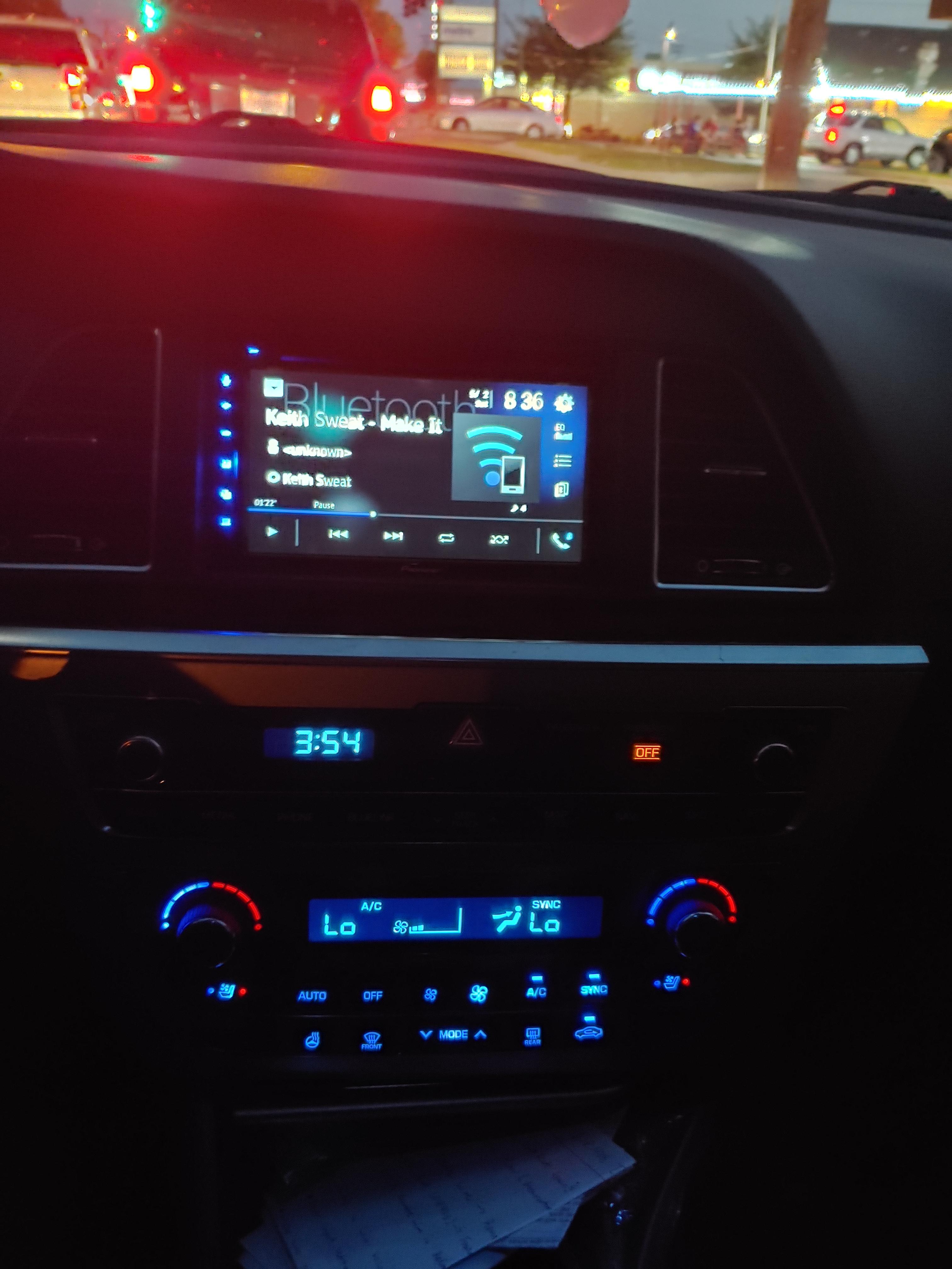

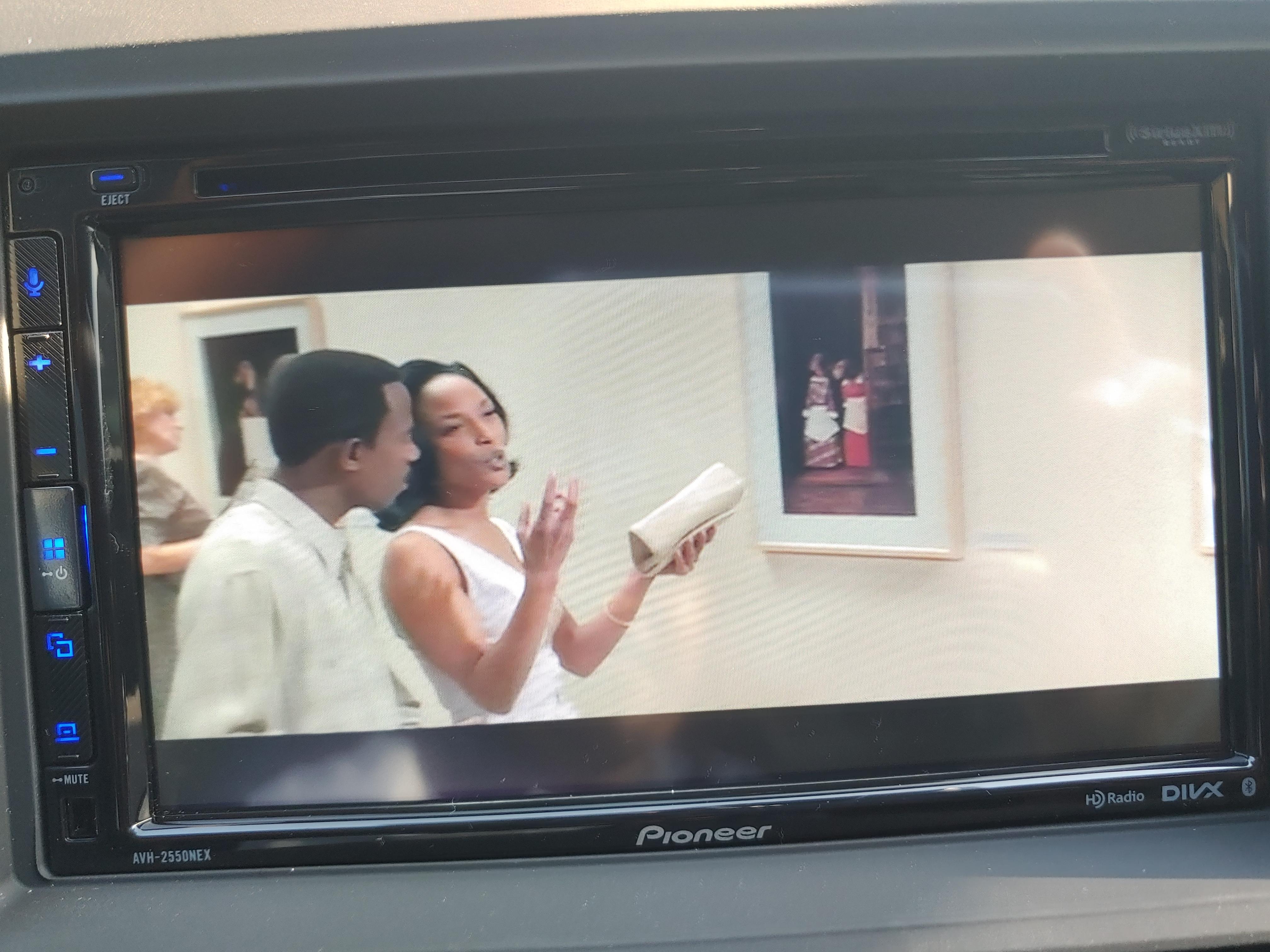

Crutchfield.com are the real MVPs, probably was on the phone with these guys for 4 or 5 hours yesterday finishing up this radio install. Tapping into wires on factory harnesses by peeling the skin/insulation off to expose the bare copper just to wrap a wire around it, I had to do this 3 times (very tedious). Wires were taped together and ziptied so this Texas heat wont unstick the tape. But the radio is finally wired, just need to put the dash back together.

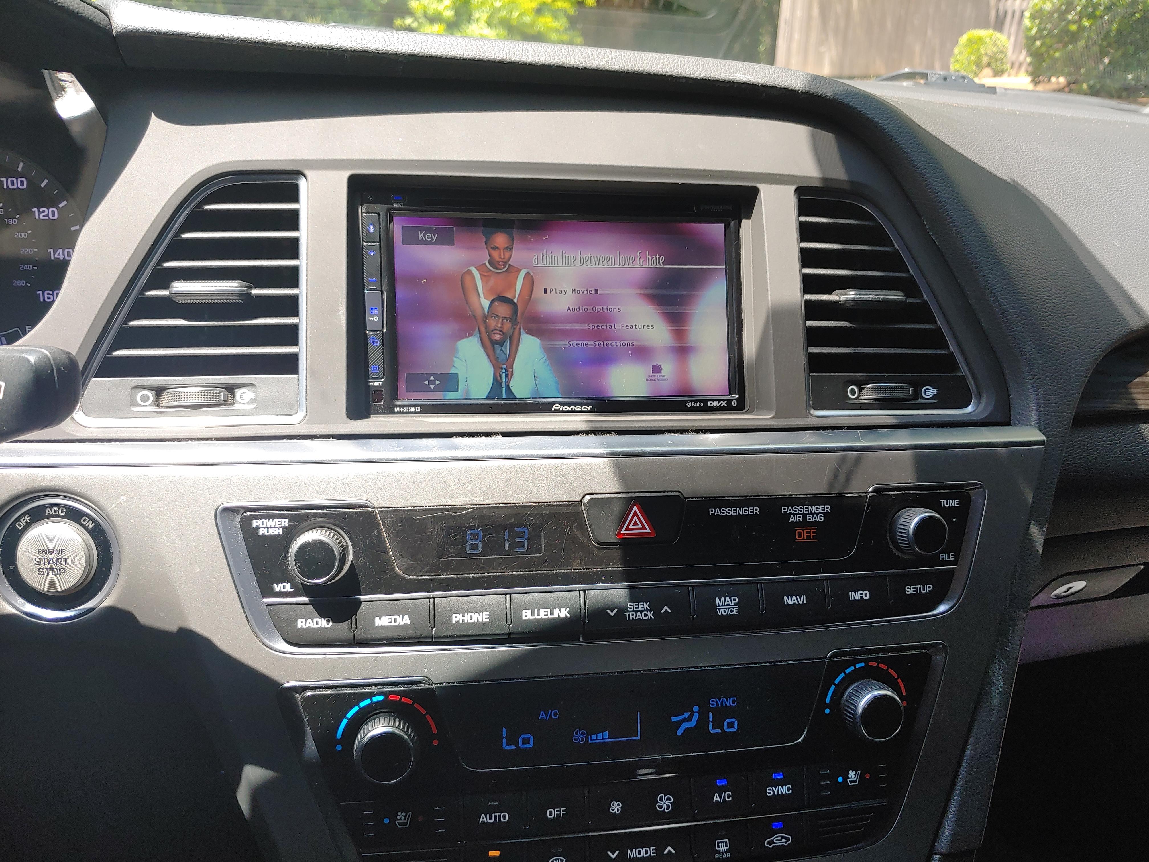

New dedicated radio ground than just relying on the wiring harness. I do this in every vehicle I install an aftermarket h/u in.

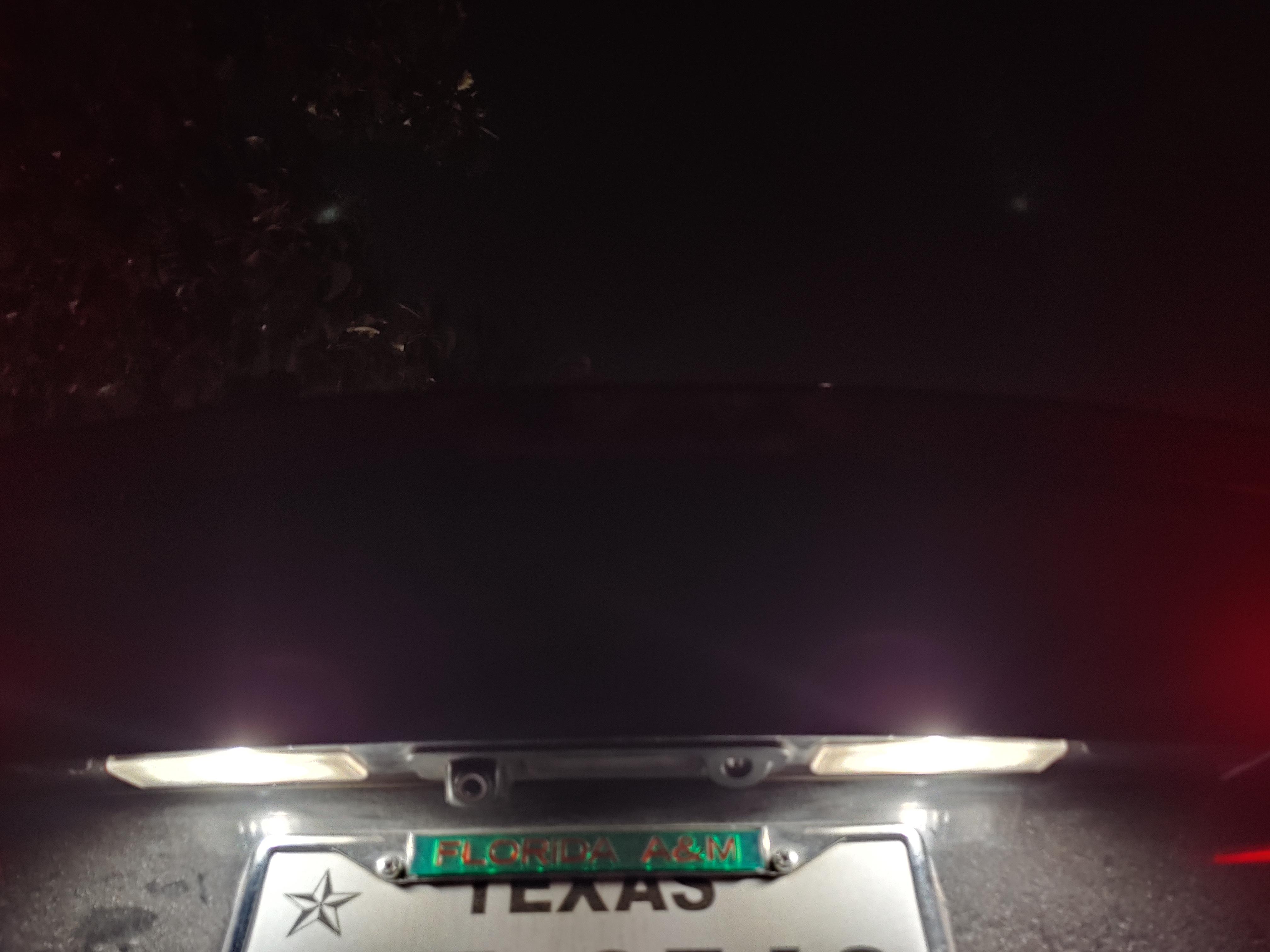

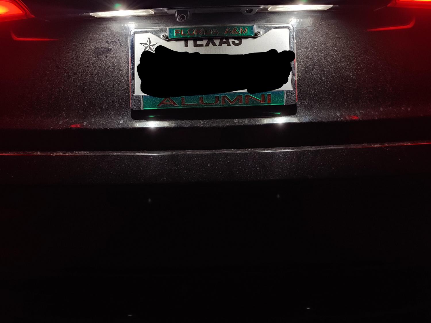

Almost every bulb in my car is a LED besides the license plate lights, trunk light and the vanity lights. Changed the license plate light and waiting on other lights to get here. This helped with back-up camera during reverse at night.
That tint came in tight! Super clean work brotha!! Thanks for posting so many pics. :)
Thanks man. I actually went back yesterday and got the front two windows 5% just like the back windows. Literally just finished up the radio install 30 minutes ago. Buttoning that up as well, pictures to commence once done.

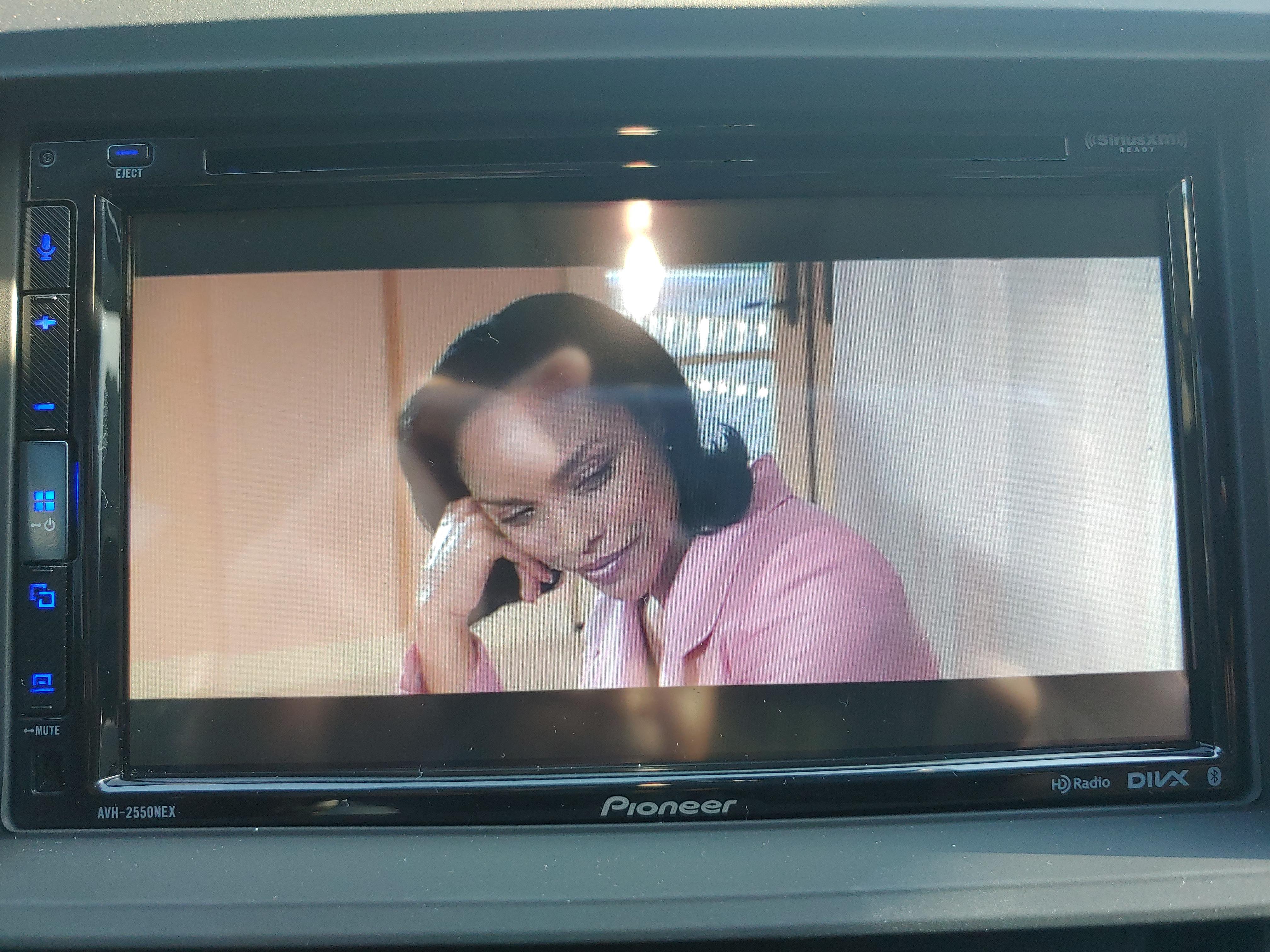

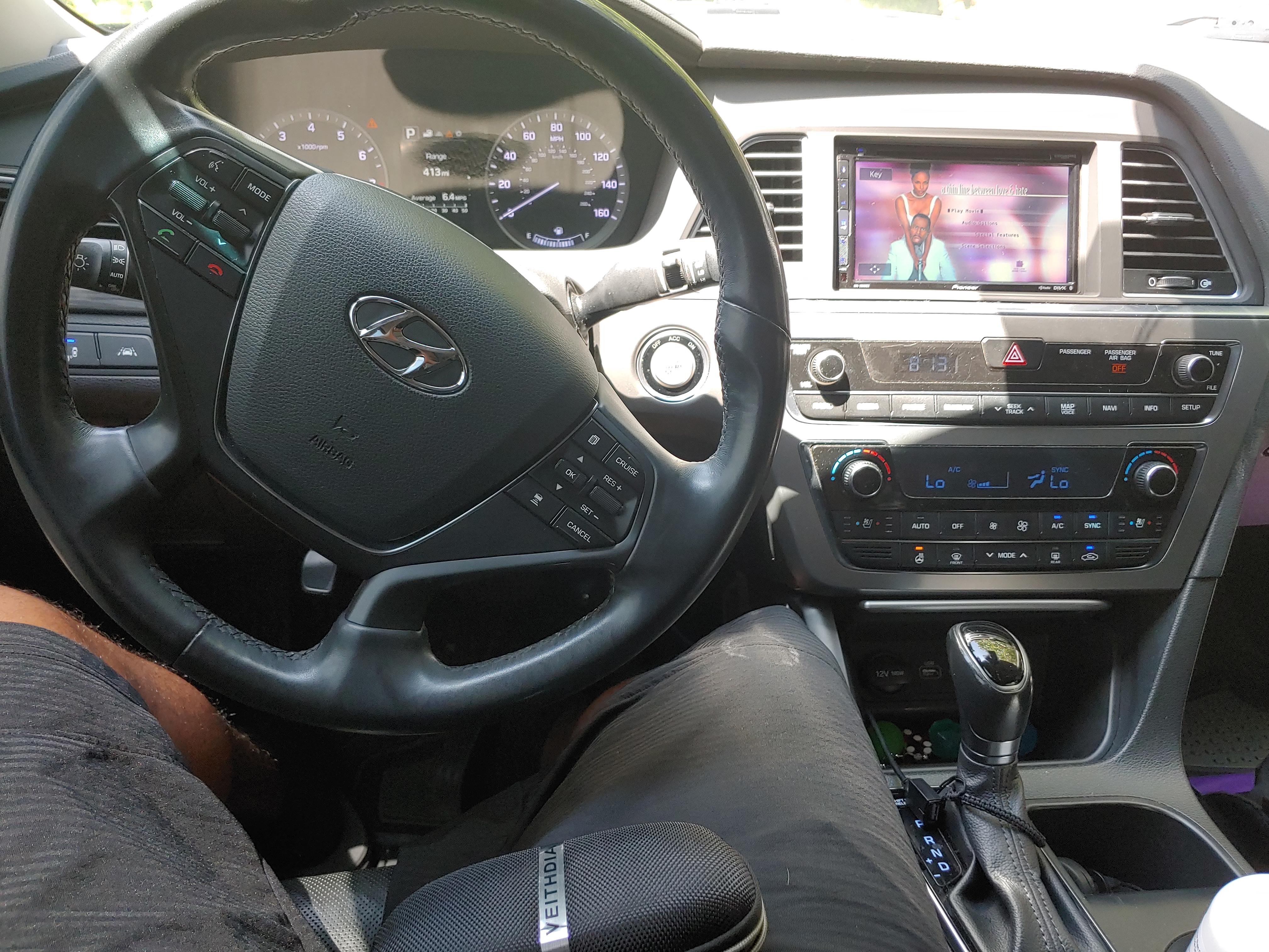

All done for now. Its getting too hot outside to turn the DSP on an tune the speakers will do all that later on tonight but she is working. Amp DSP both have green light action.
The picture is pretty clear without any adjustments, excuse the glare in the images.

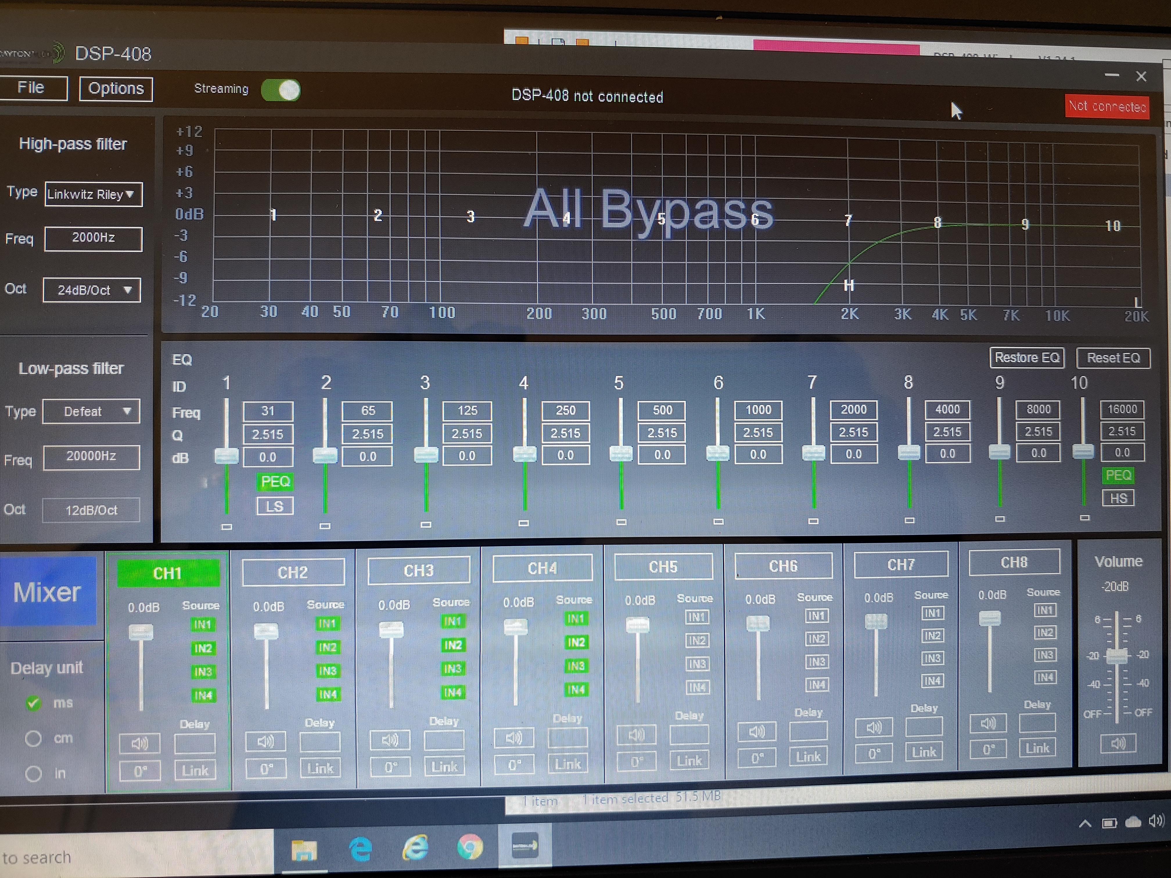

Some light weight tuning with basic crossovers just to get some sound in the car for now, didnt feel like tinkering with it all night.
SB Acoustics Tweeters 2000Hz @ 24db
SSA Evil Mids 70-2000Hz @ 24db
on SSA IC150.4 Amp.
Fi Sp4 25-60Hz @ 24db
no sub amp yet.
Butterworth vs Linkwitz Riley crossover network or pros and cons of either or? Im a beginner just looking for input and im doing research on my end as well. Thanks guys
