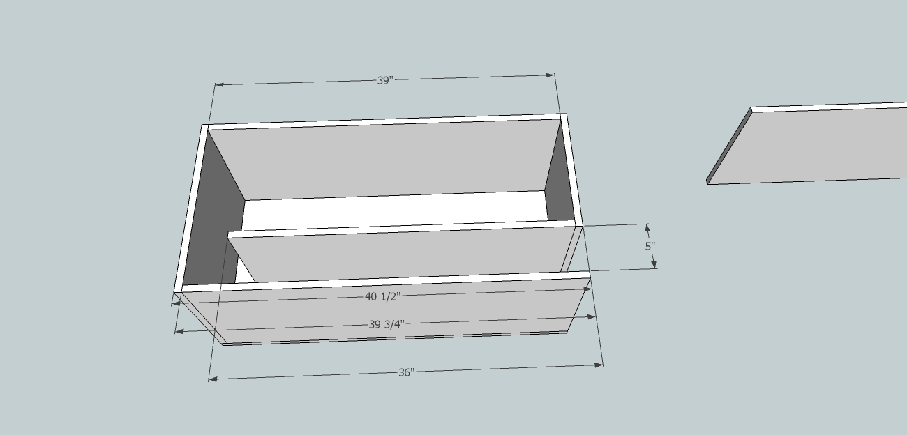

ohh, but if my port is 5 inches wide, wouldnt it need to be five inches all around? cuz if i did a 36 inch length there would only be 3inches of space at the end
Edited by NickHall
Your port should have the same amount of area from the entrance to the exit.
Anything apart from the port is enclosure volume.
ohhh so the port starts at the very beggining of the port opening in the box? ive been under the impression that if the port goes close to the back wall then the distance should be the same as the width of the port and should turn
It only bends if you run out of room going that direction.
Am I missing something Stefan?
He's doing a side port. The external width of the box is 40.5" - 0.75" - 0.75" = 39"
The port length would be 36". Why wouldn't 36" fit in 39"?
So if his port was 38" long he would still not have to bend it?
If it was 38" long then that's pretty close to the panel, and I would reconsider it, but he would have 3.75" left open to the port entrance. You don't think that's enough?

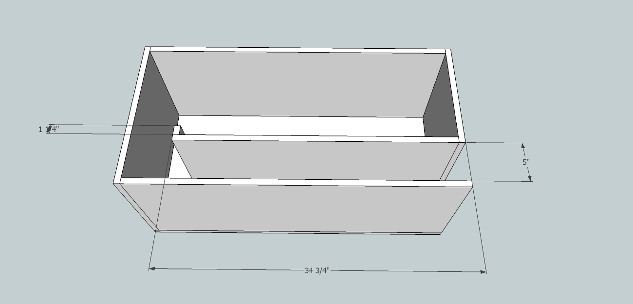

If so, he could make the one length 34.75", and 1.25" for the second part. Correct?
so it should effectively look like this?
That's what I was envisioning, but wait until Rick replies to my last post. I'm curious, and he's built more boxes then me. :P
aight, either way is cool as long as ill have enough volume in the end

how much would it bring the box volume down to?
what would it tune the box to to just bring the port to 34.75 inches? that would give me five inches all the way through

aight so it would be like this correct?
but what would the volume end up as?

nvrmnd its like 4.053ft^3 tuned at about 33.285htz. unless my math is jus really screwed up

ok so i used sketchup to design the enclosure you mentioned to the best of what i could tell you were saying.
Did i do it right? is it tuned correctly? whats it tuned at?
Oh and i think i kinda went overbaord on screenshots, lol
http://www.soundsolu...&attach_id=3097
I'd use this one before all the others. 4.4ft^3 @ ~33hz add a little bit of dowel bracing and it would be perfect.
the other one is about 4.5 cubes too, but i accounted for sub displacement (.34ft^3 for two 12's) and dowel bracing displacement. so it'll be roughly 4-4.1 ft^3 in the end.
