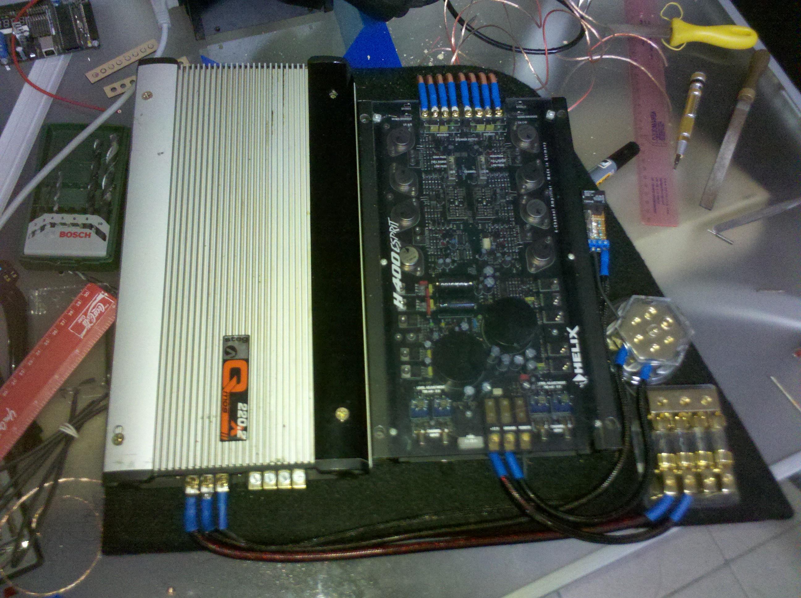

First, I made an amp rack.
Simple particle board. It just fits 2 amps, distro blocks and a small relay board.
post-18968-0-44266000-1367755330_thumb.j
Techflex on most of the cables. And MOLEX connectors for the speakers(1 for midbass, 1 for tweeters). After connecting everything I thought it would have been better to use the connectors for left/right pairs. On my to-do list.

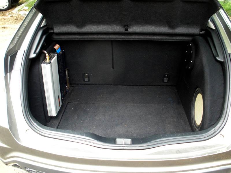

Mounted on the left side of the trunk (and yeah, I know the Steg is sticking out):
post-18968-0-59933000-1367755639_thumb.j

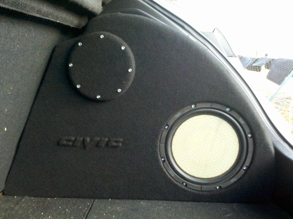

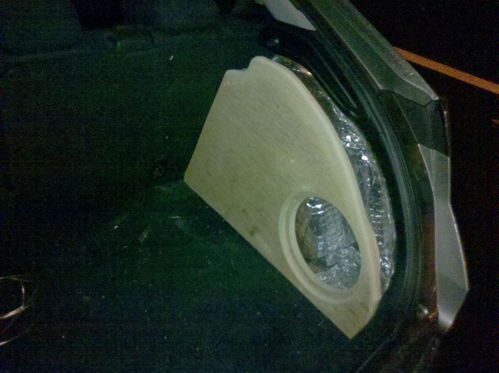

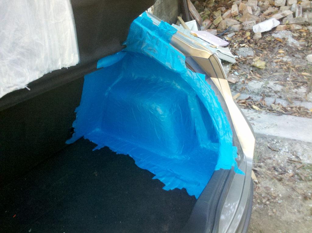

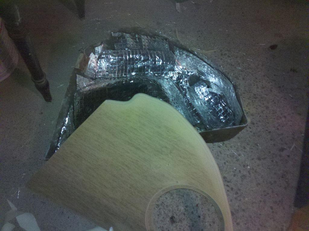

Now, the fiberglass subwoofer enclosure.
This was my first attempt at building one, so I messed up a few times, but quite satisfied of the final result.
post-18968-0-50640600-1367756018_thumb.jpost-18968-0-52984000-1367756023_thumb.jpost-18968-0-16997500-1367756026_thumb.jpost-18968-0-88198900-1367756028_thumb.j
post-18968-0-66478500-1367756033_thumb.j
Enclosure is sealed, but I made it easily vent-able... The round thingey is actually a plug for the port hole. Just need to make another round thingey with a port.

very well done, i like how neat everything is. Though i will ask about your box. If its sealed typically you need 1cu ft of air space behind the subwoofer, but if its ported you usually need a minimum of 1.5 for it to sound good. How are you adjusting for that?
Well, I've made some bassbox stimulations and with the volume I have there are some possibilities... with a ridiculously long port. Still haven't tried yet.I'm satisfied for the moment. I'll cross that bridge when I get there...

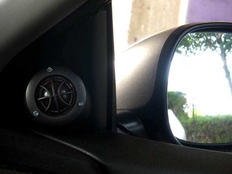

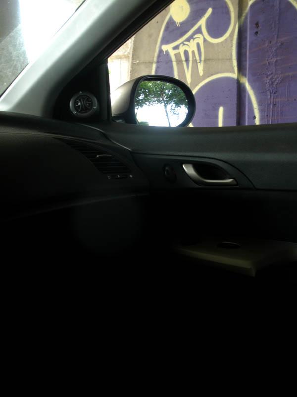

The tweeters fit perfectly in the stock locations:
post-18968-0-88994900-1367845388_thumb.j
post-18968-0-75189400-1367845387_thumb.j

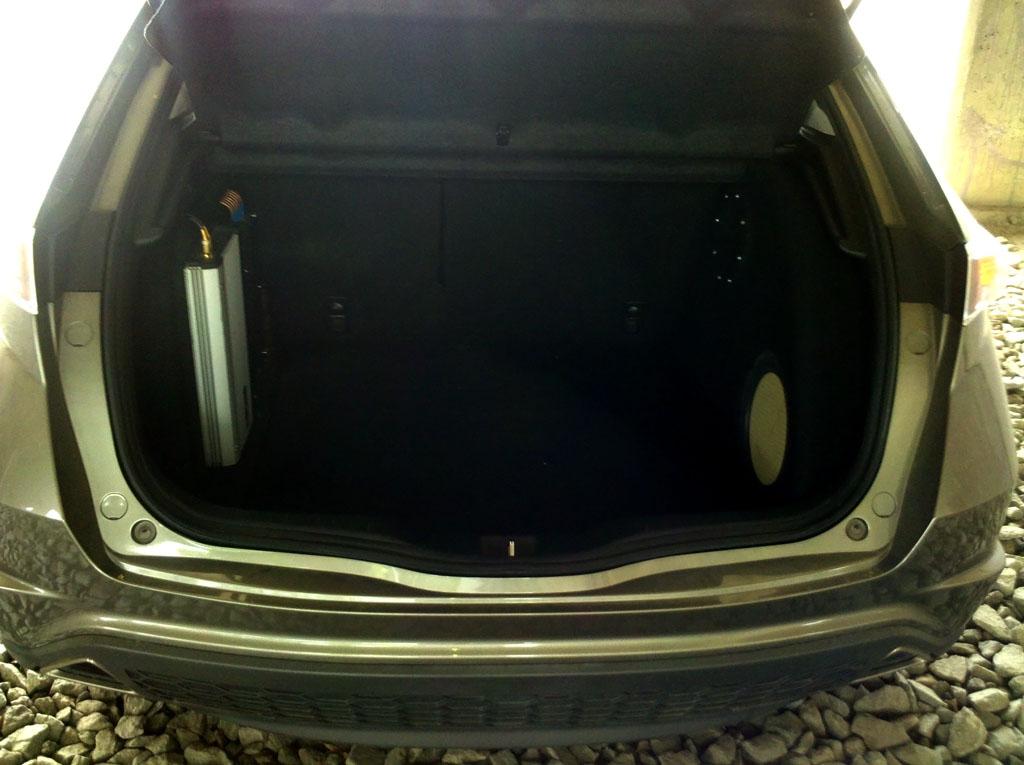

And a better view of everything in the trunk(still not perfect):
post-18968-0-00830300-1367845386_thumb.j
post-18968-0-06091300-1367845385_thumb.j

Final results... Sound is good enough... but could be lots better with just the equipment I have. Still have to bring the midbass drivers out(the stock locations are far behind the door panel). And the tweeters placement is quite awkward, one is on-axis and one is off-axis, so I have to figure that out too...
Looks are decent, a bit annoyed with the mis-matched amps, but I can live with that.

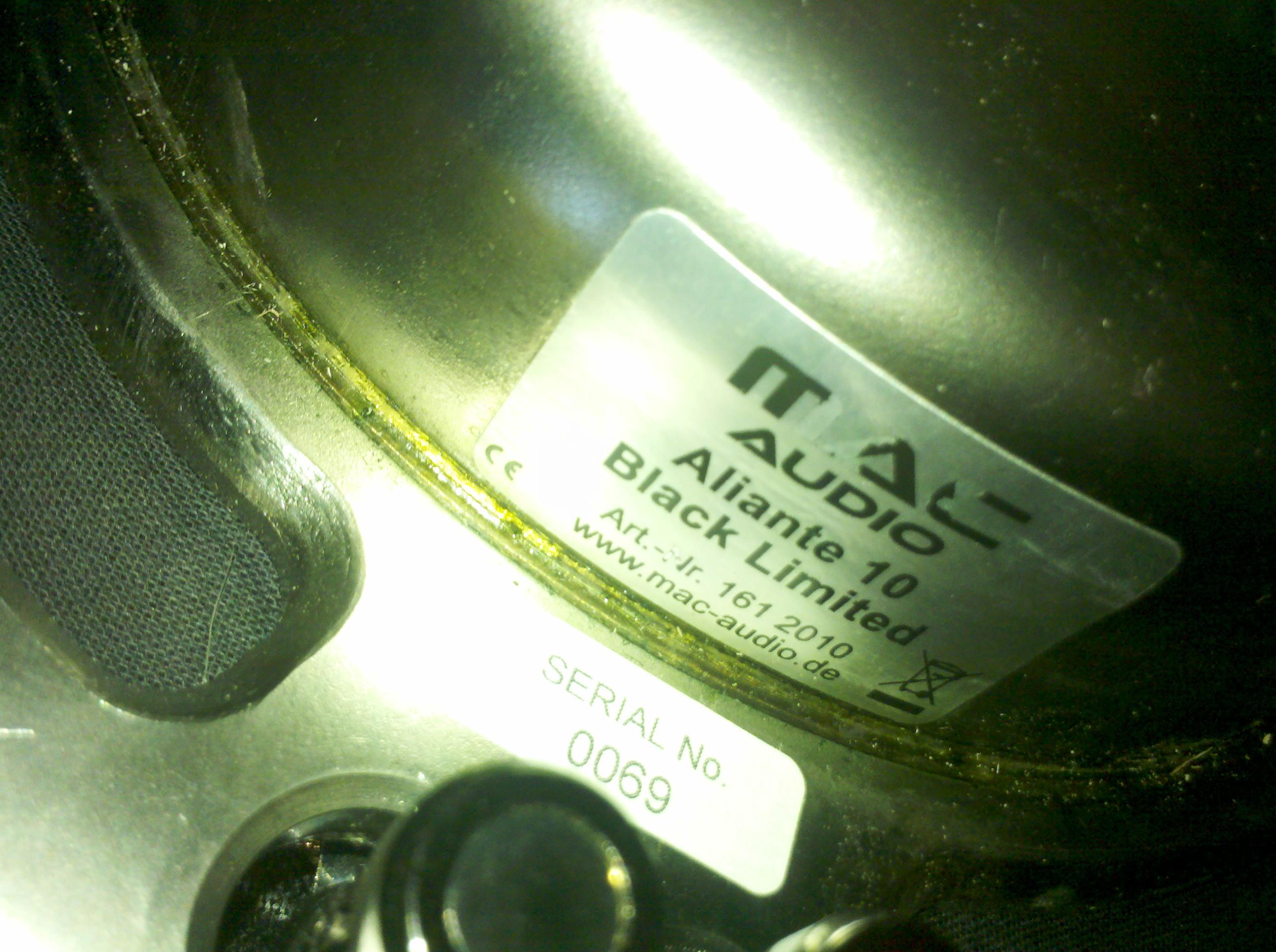

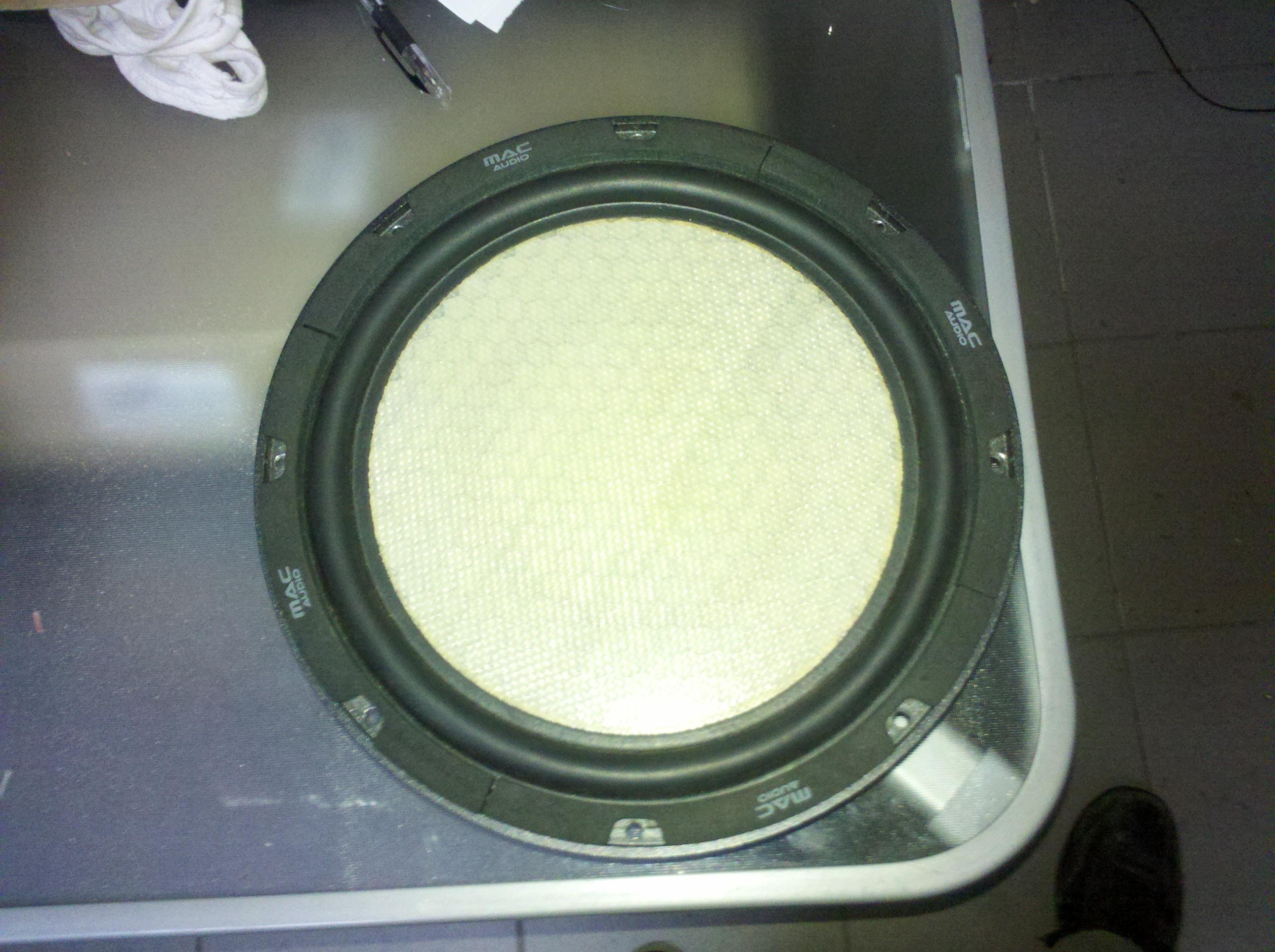

The sub is actually a Phase Linear Aliante(build under license by mac). Pure SQ sub. Doesn't really move that much air(but it eats up 400W like they're nothing), it's mainly a 10" midbass driver. But it's really smooth, fast and it blends in perfectly with the front stage.

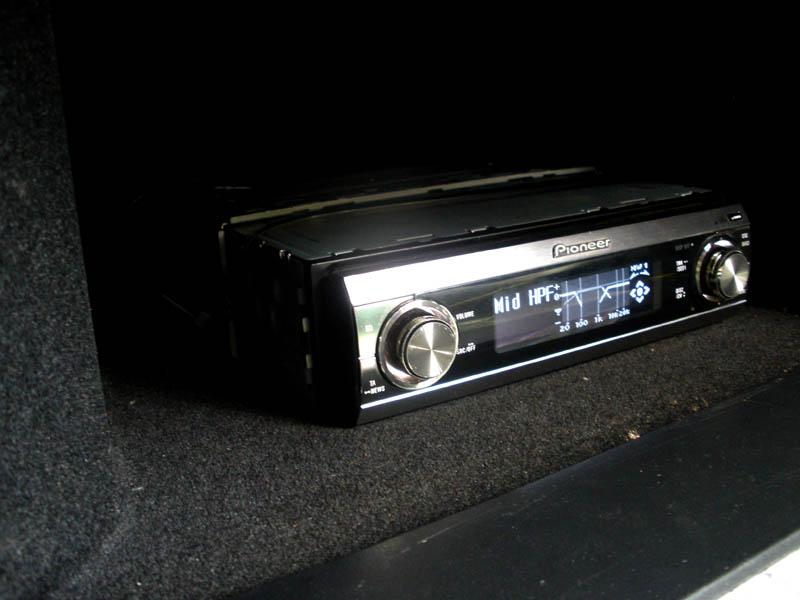

Well, this is awkward. Updates with upgrades.
Traded in my P88 and 150$ for:
The guy who sold it to me said it had noise issues, I've tested it on a lab power supply, updated the firmware and ... there's no unwanted noise whatsoever. Still, fingers crossed for when I install it.
Edited by groowe
Well, it's all installed, using the high level inputs there is no noise, the only thing I've noticed is a digital beeping noise caused by the DRC(as I've read) - when using AUX inputs AND the source(phone) is connected to the charger... so it's probably a ground loop somewhere. Probably easily fixable.
Sound wise it's not an improvement. That would be an understatement. I've rediscovered my speakers and amps. Still have to tune a bit, but everything is already so much better.

The Aliante is disturbingly weak in a sealed enclosure, so I had to port it. Big difference, tuned to around 40hz right now, still want to go lower. I just need a lot of plastic tube :| And somehow integrate everything so it doesn't look awkward.
