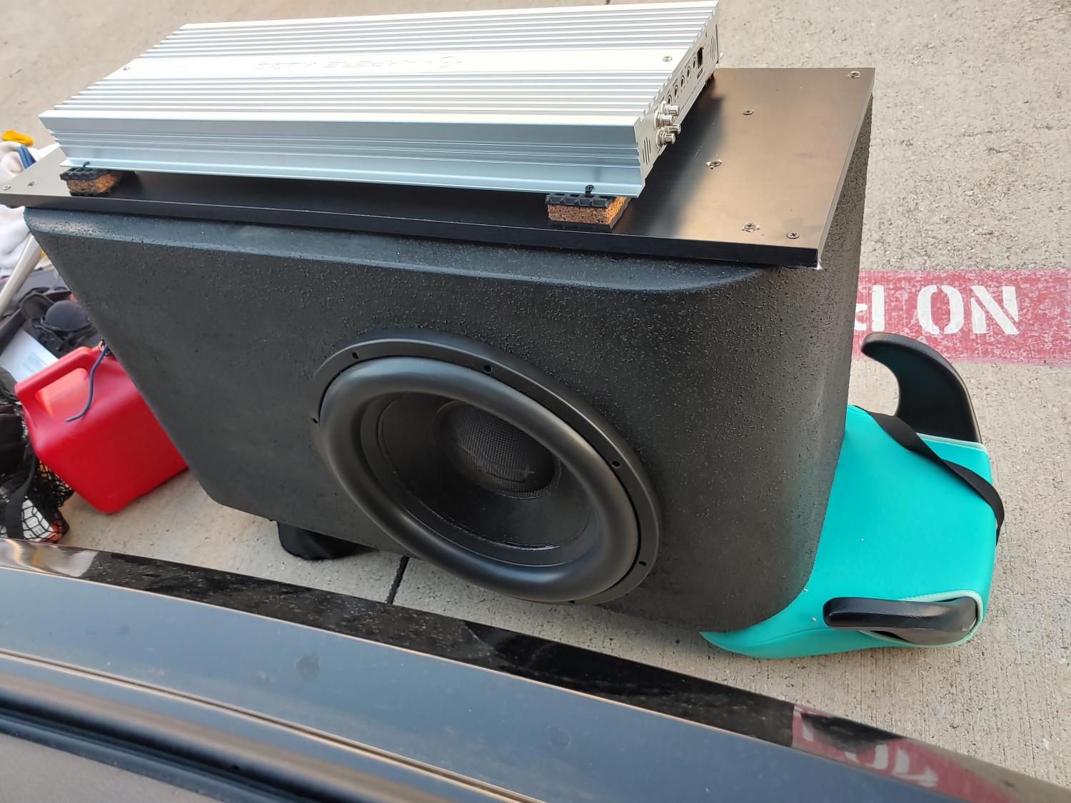

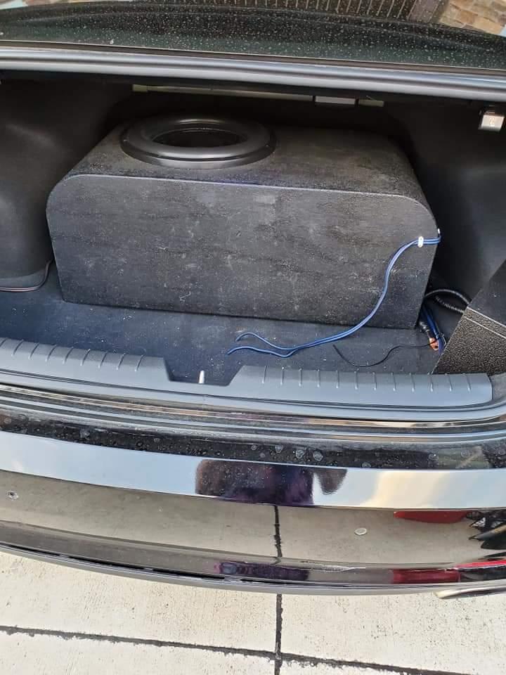

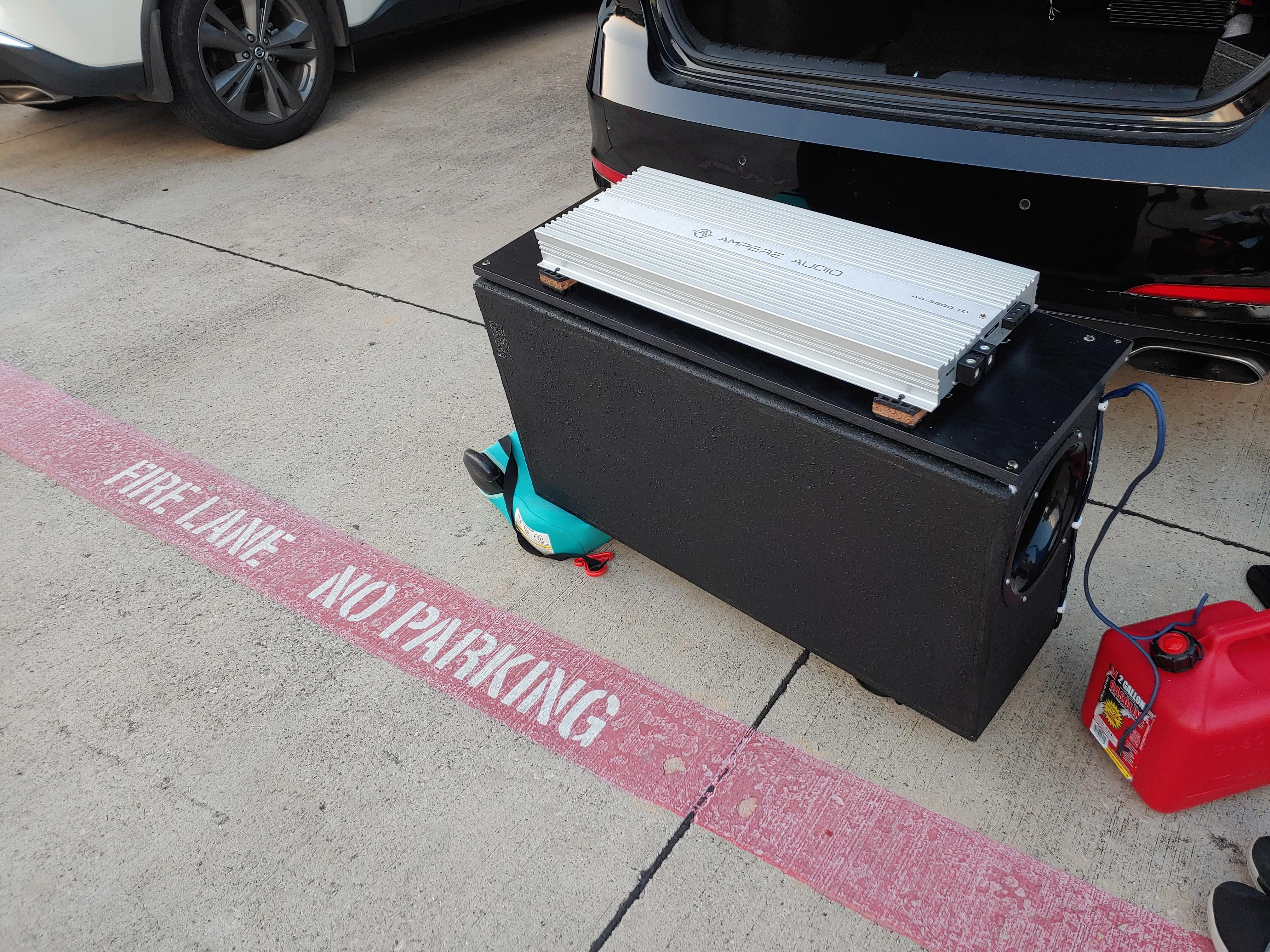

    Enclosure designed and built by a local builder. 3.81 @ 31hz before sub 3.6 @ 32 hz after sub (15" SP4)

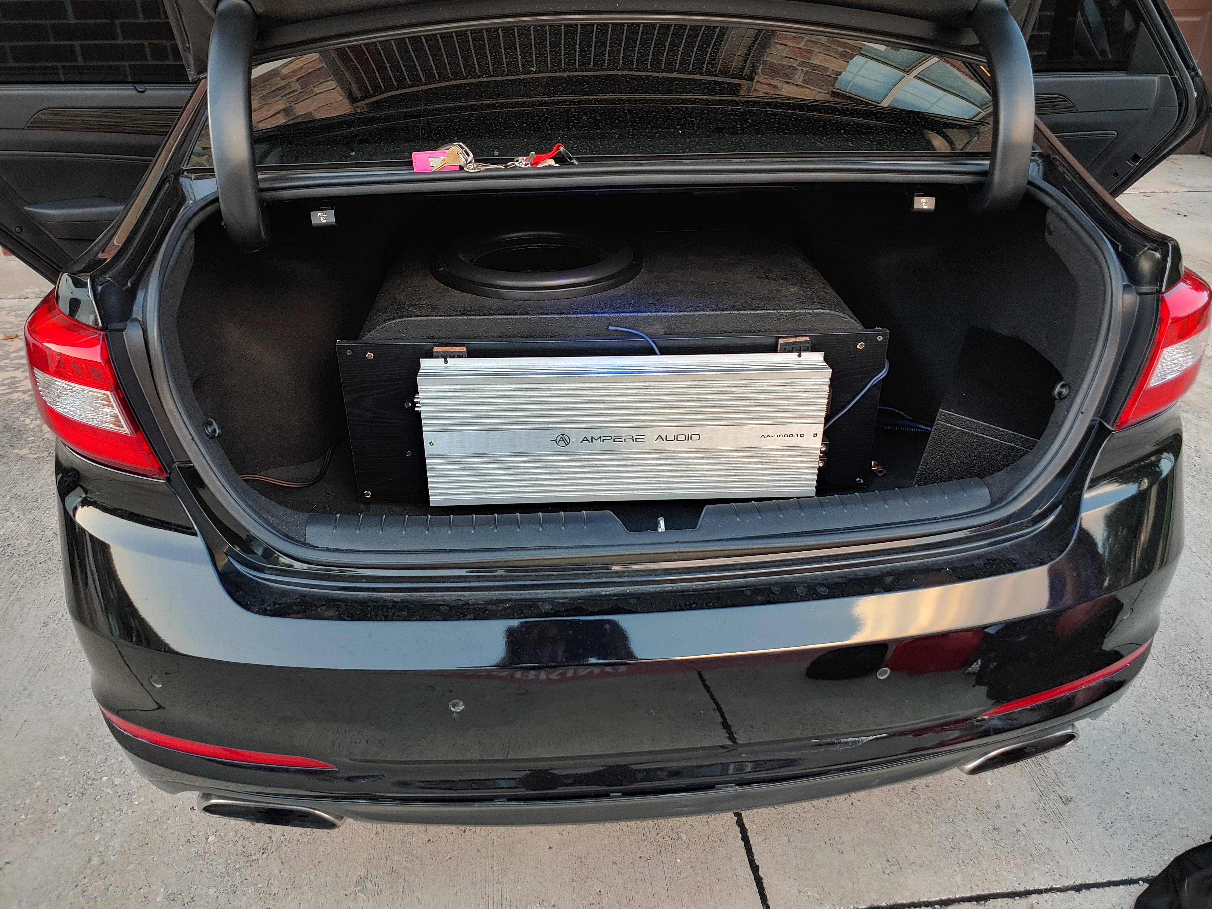

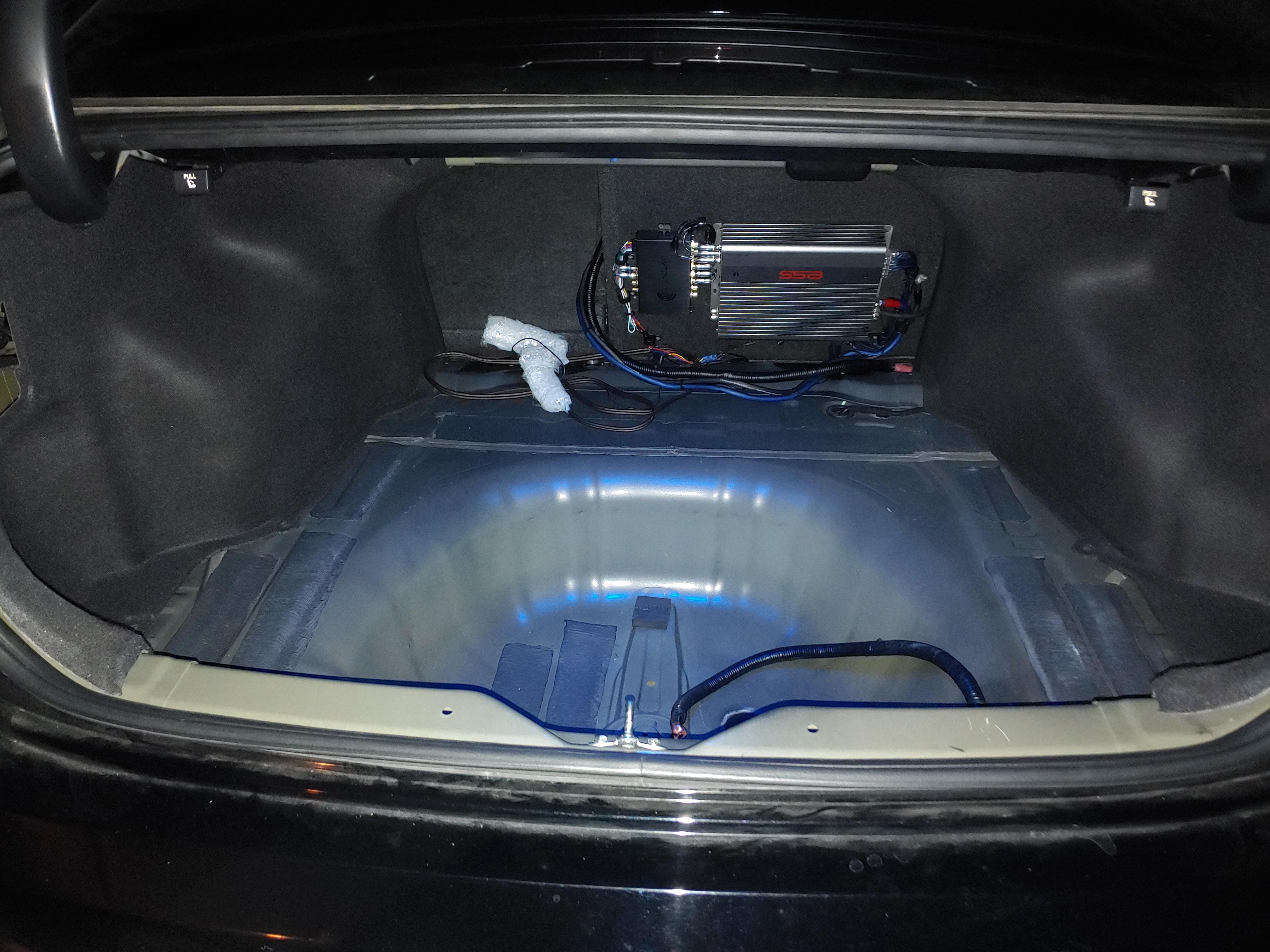

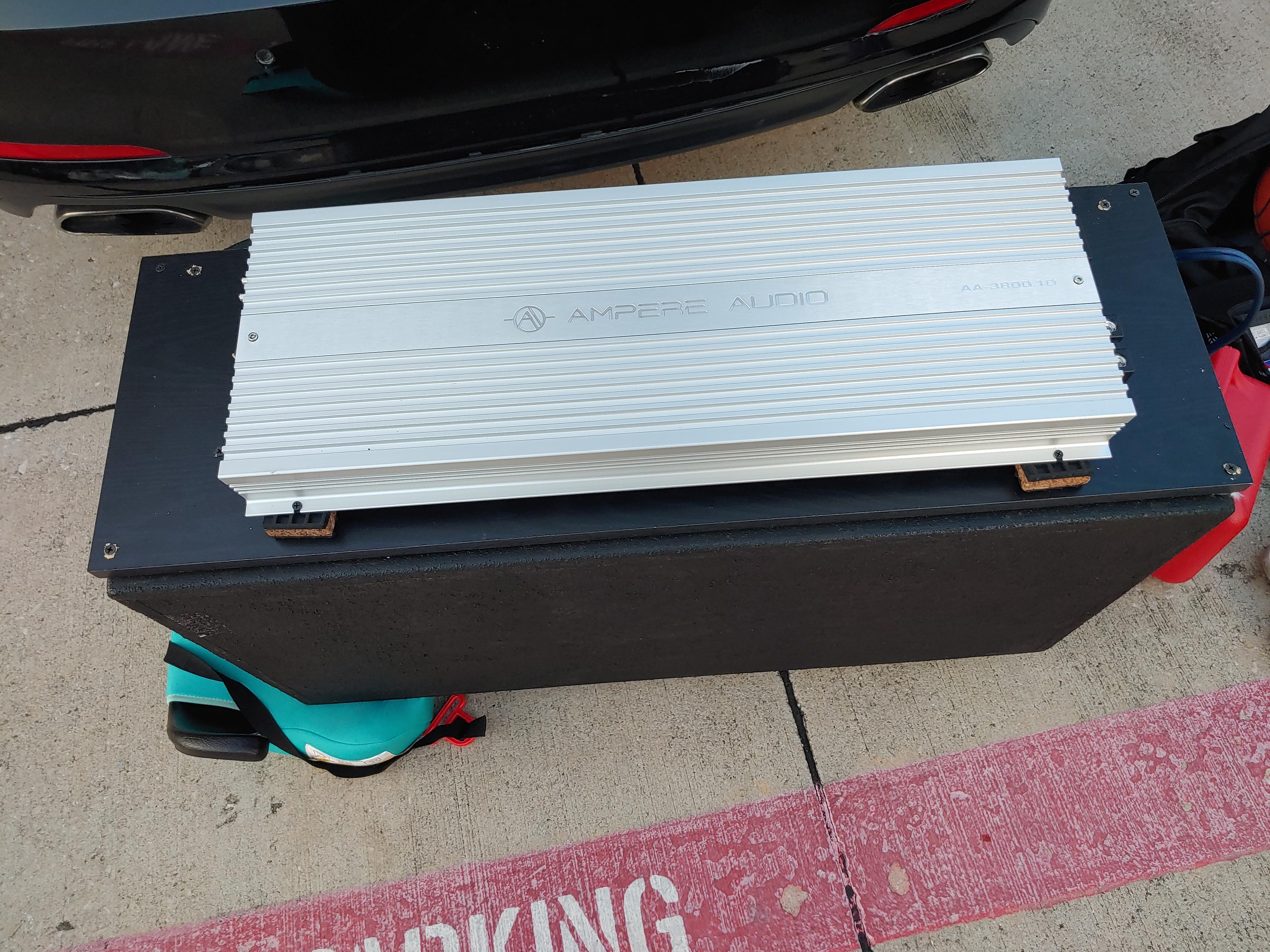

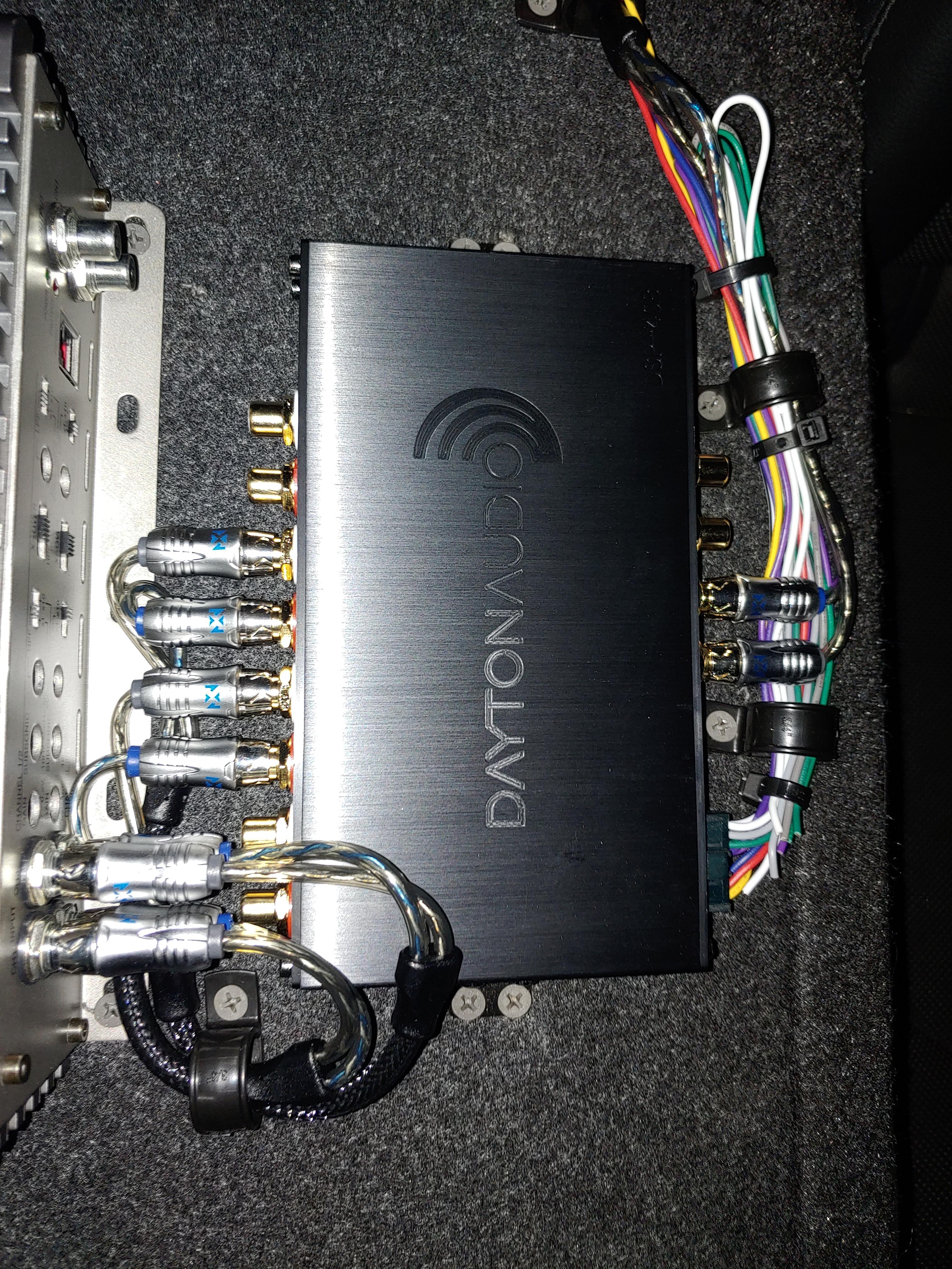

    Another piece to the puzzle was dropped off today at my job.

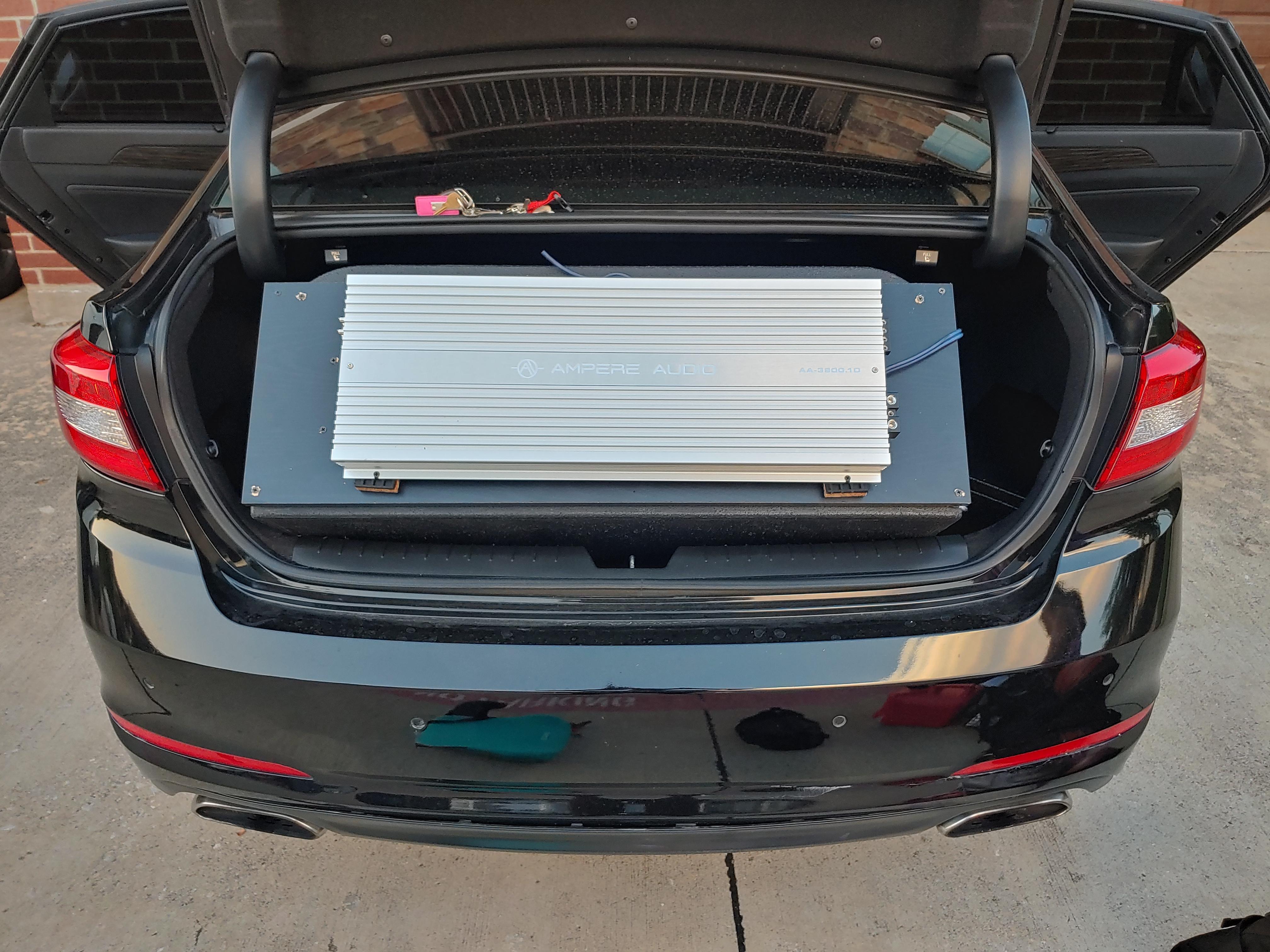

Amp mounted to the box using neoprene vibration pads between amp and amp board. Also have some washer style vibration feet between the amp board and sub enclosure.
I used my mom's place to do the install instead of mine, here's a couple before pictures that she took for me. That DSP and SSA Amp is one of my favorite pictures, they looks so good together.

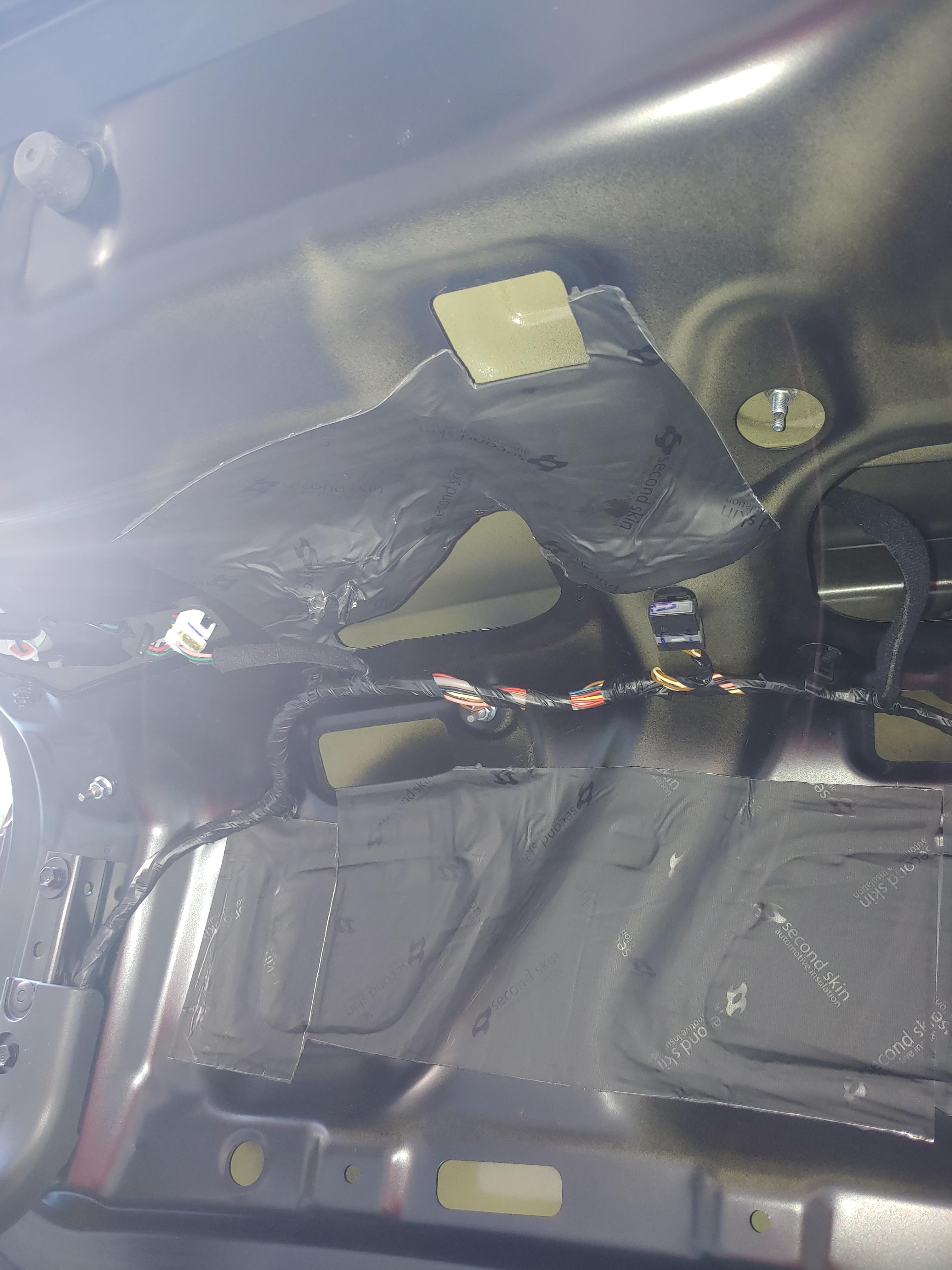

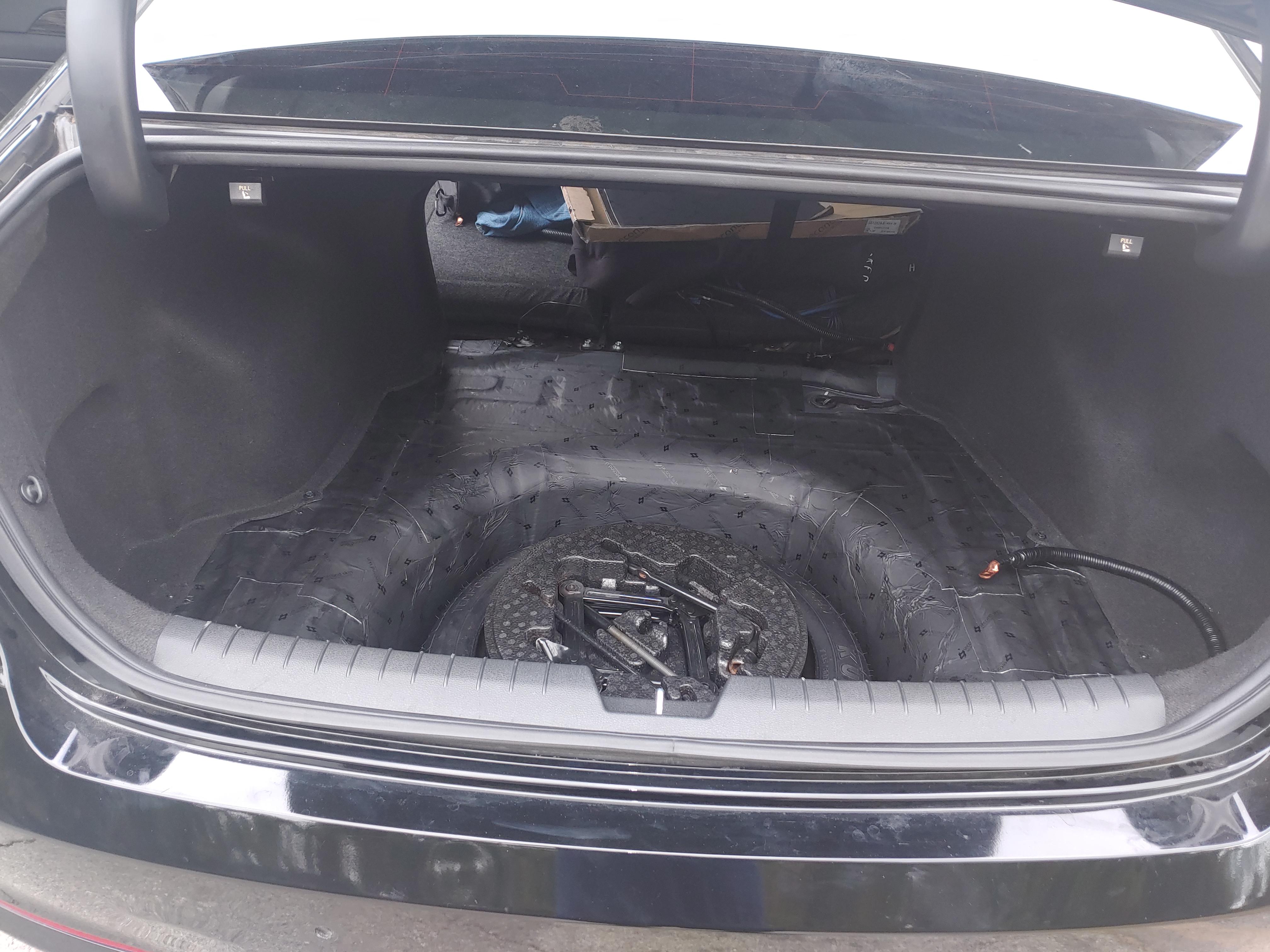

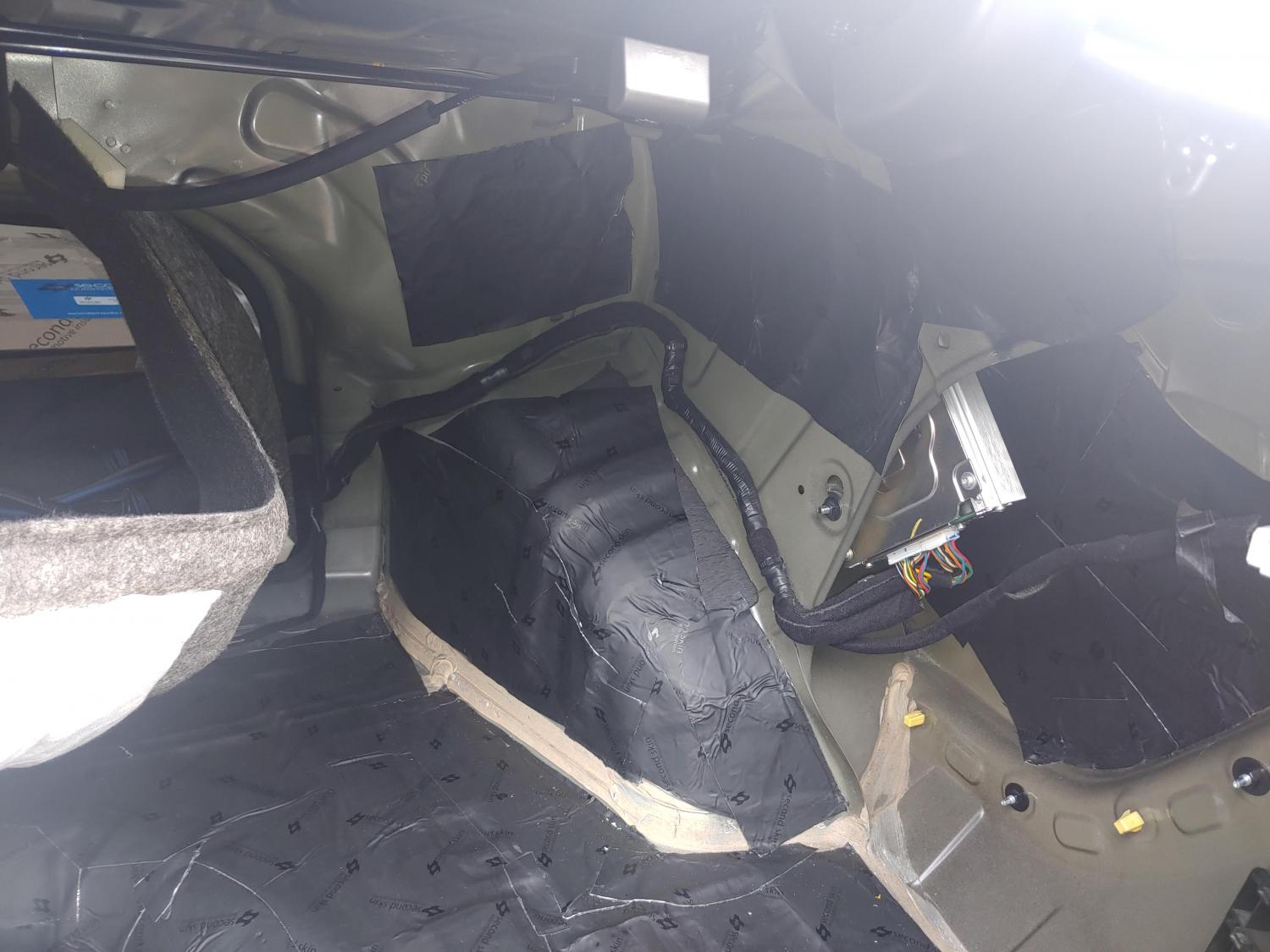

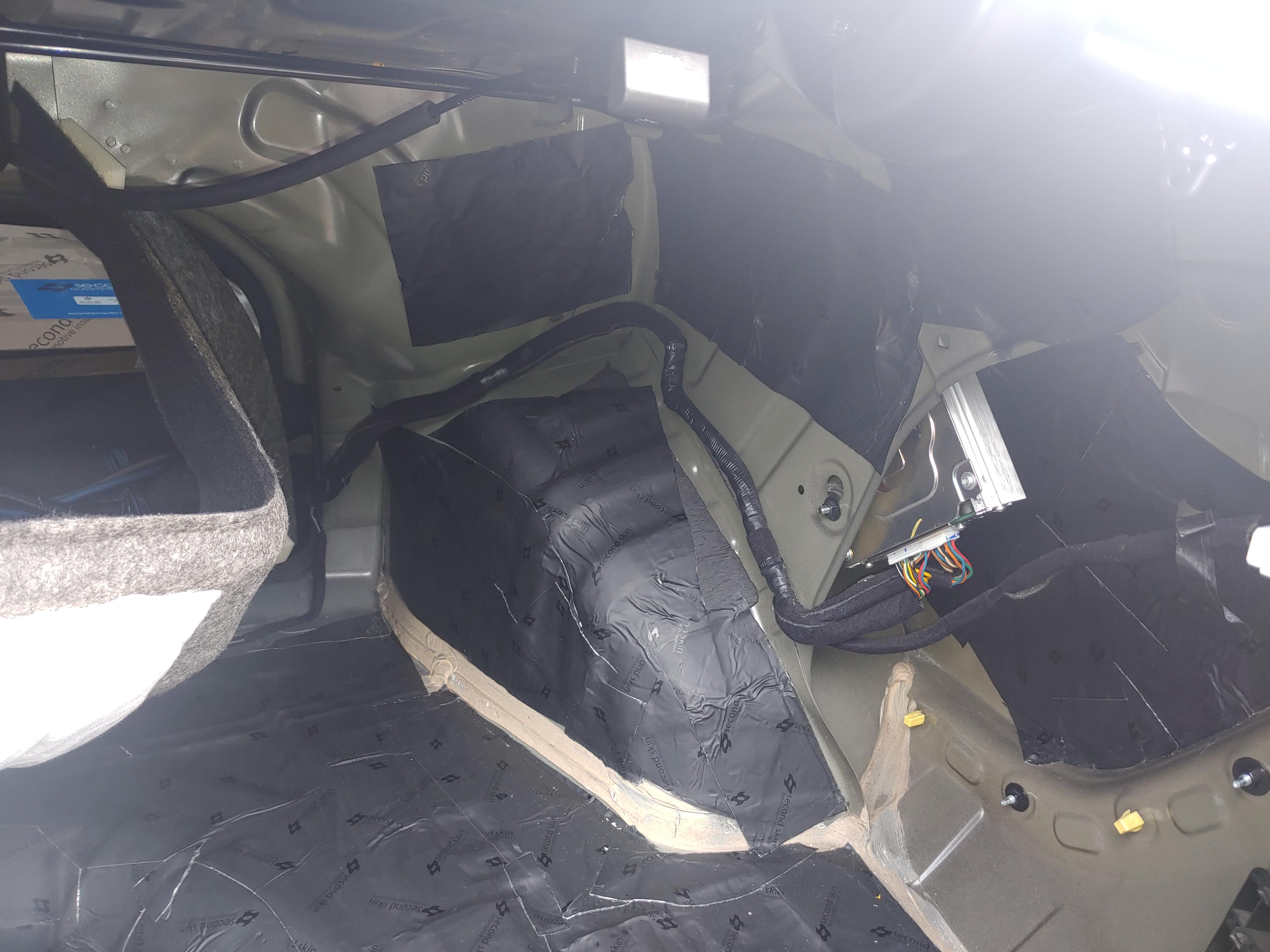

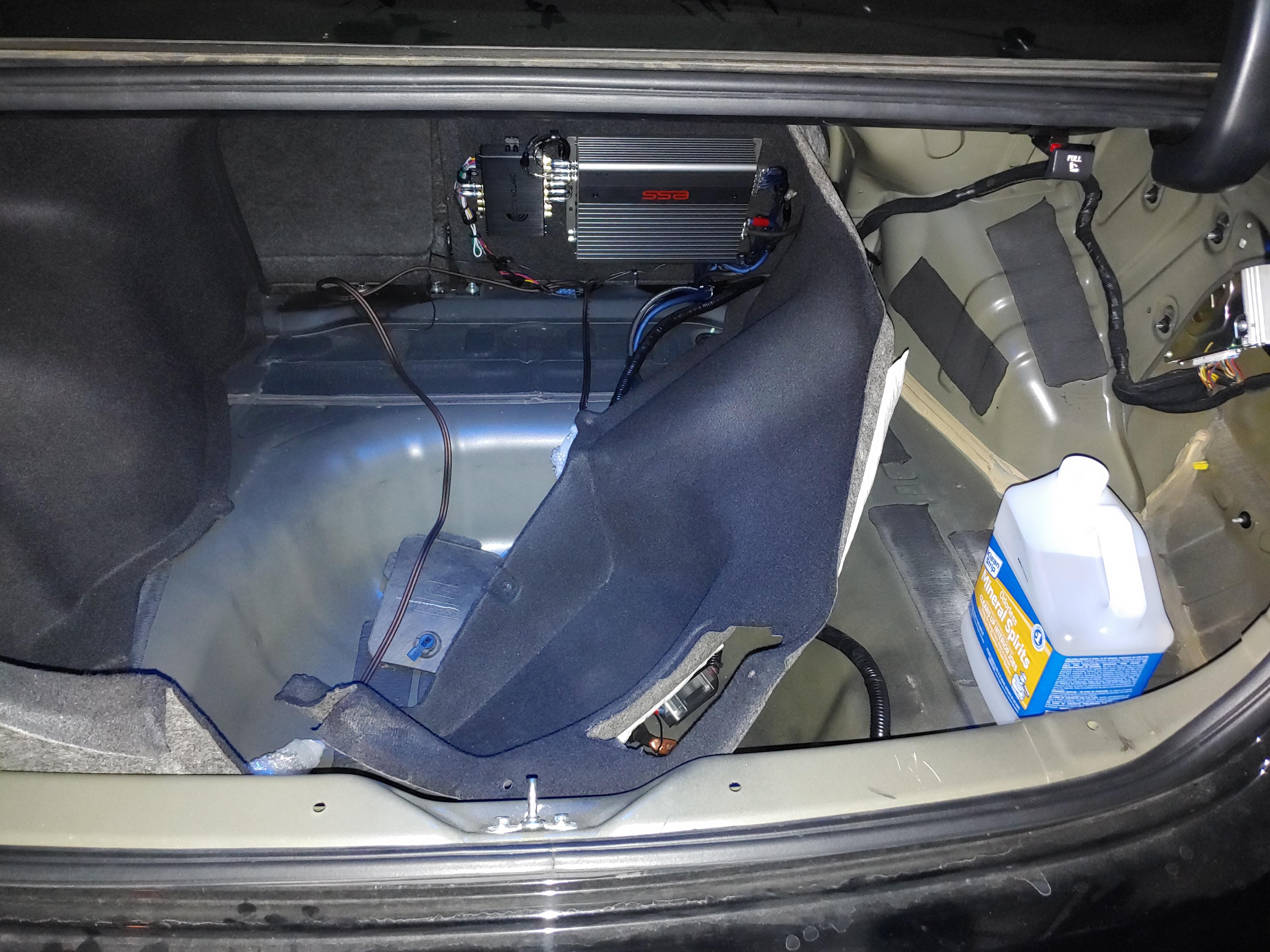

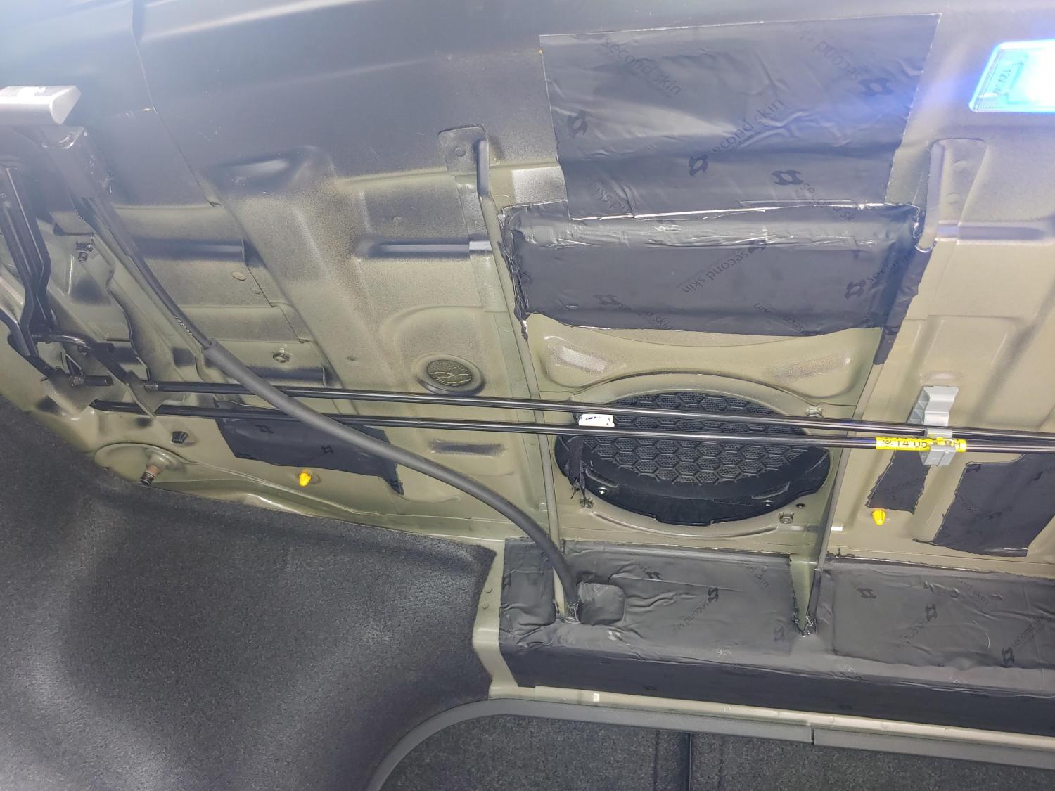

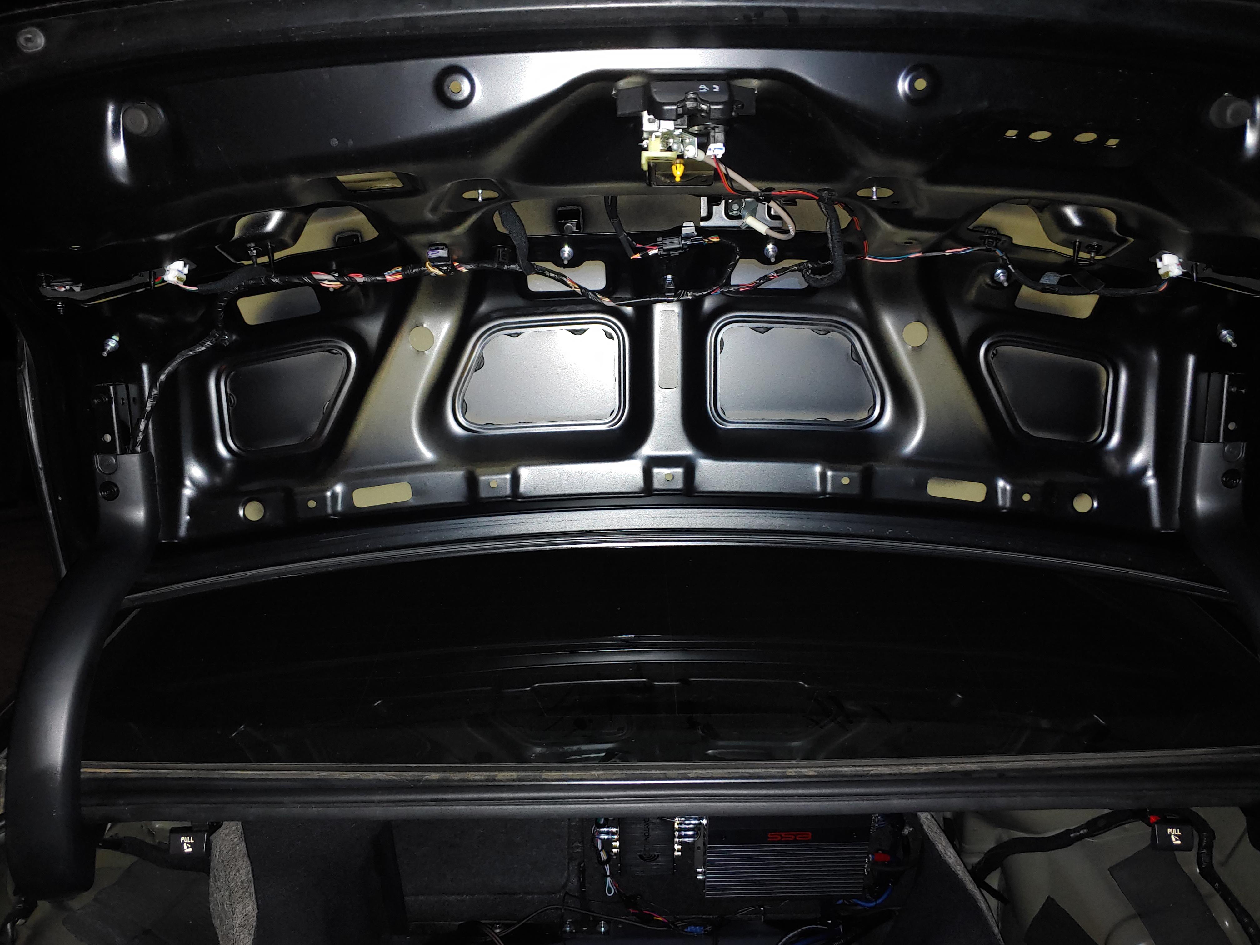

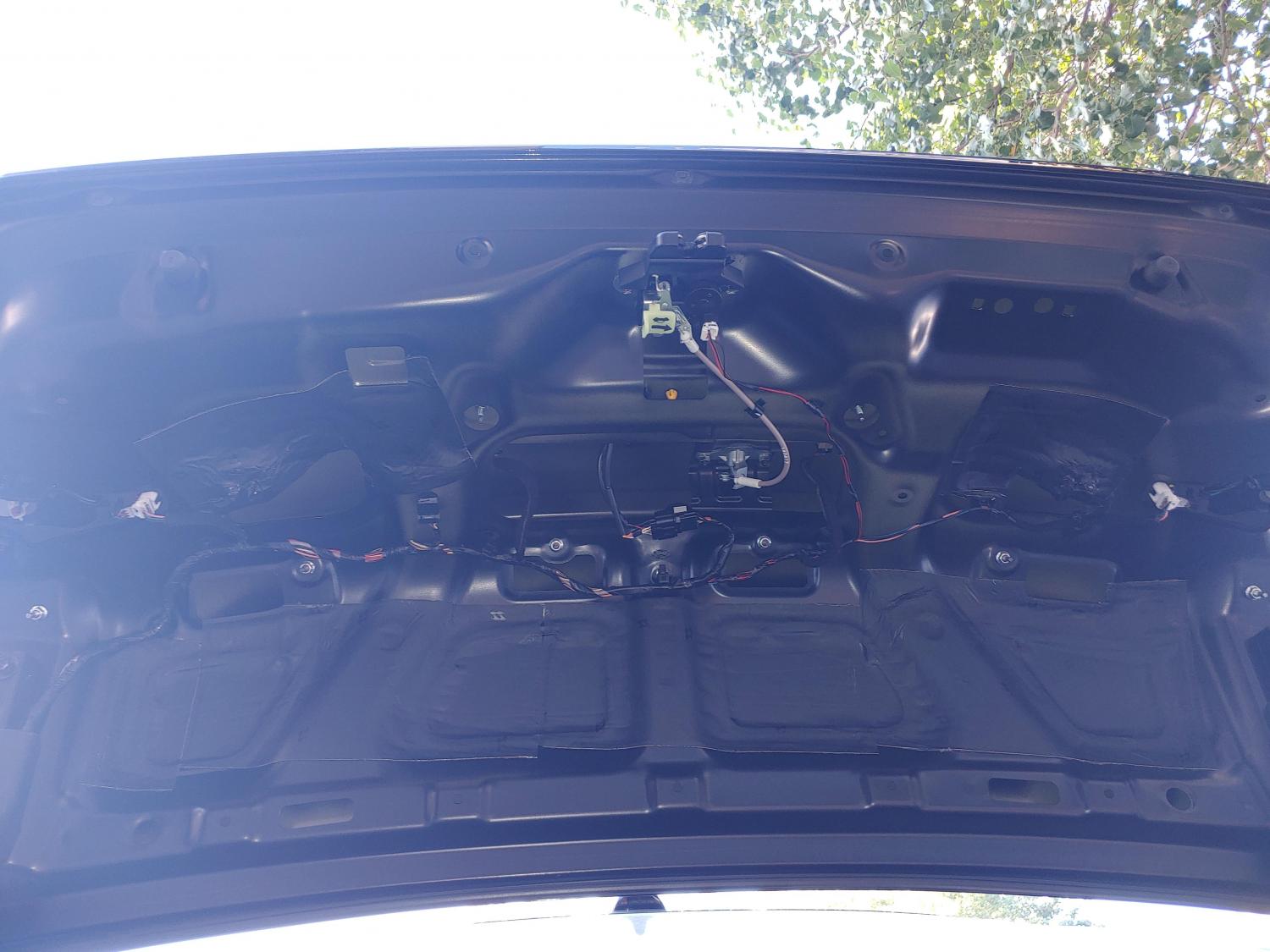

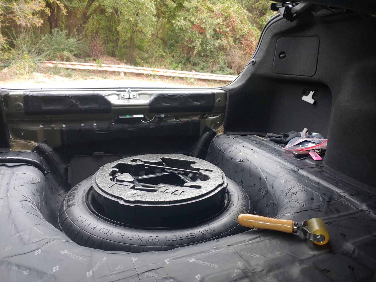

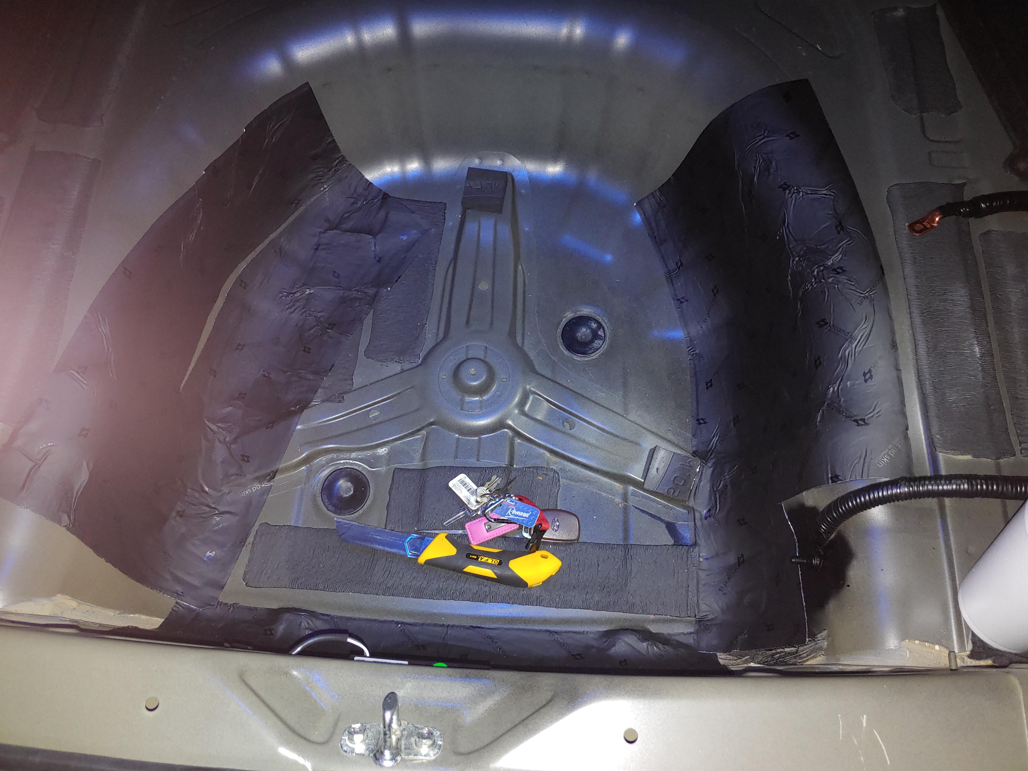

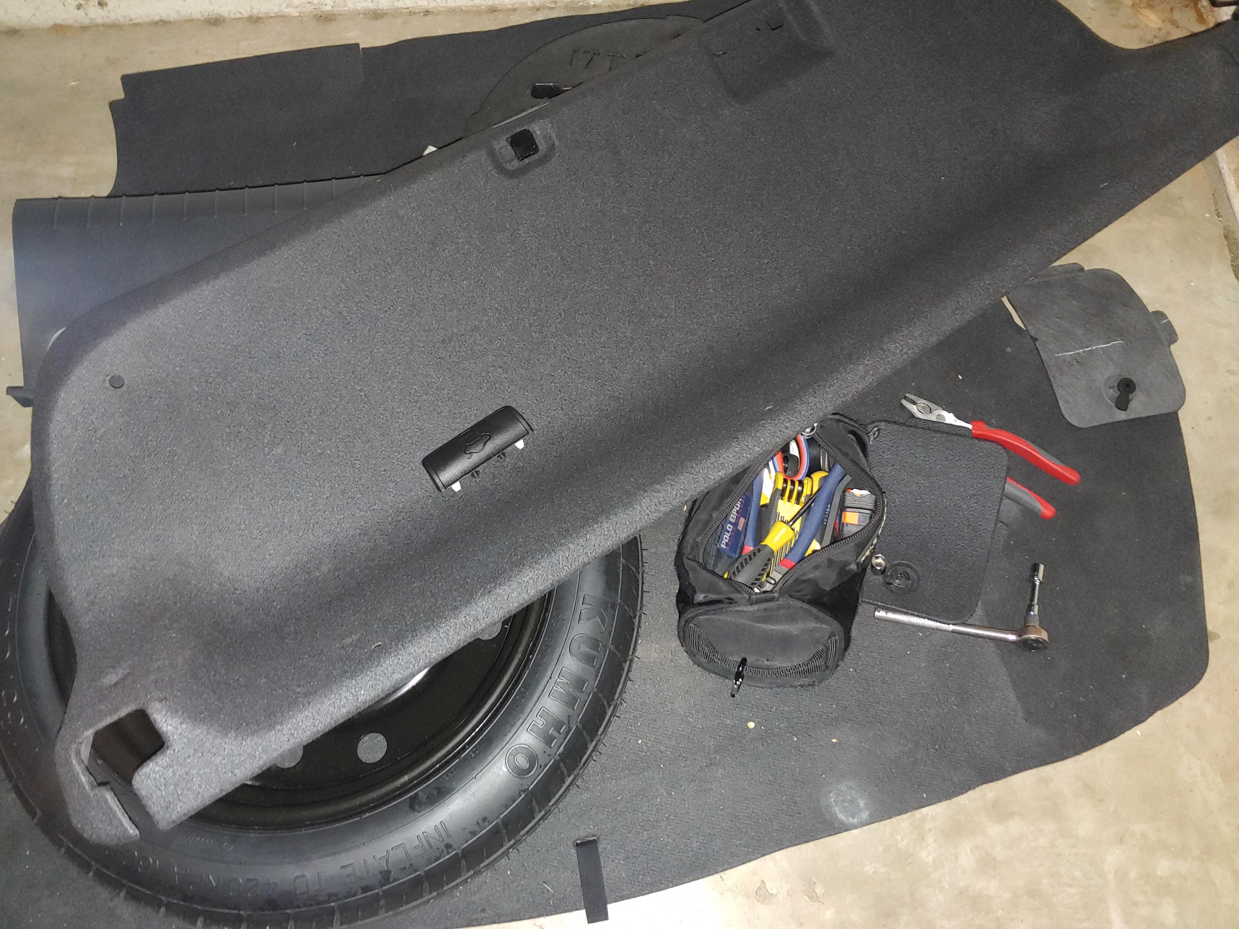

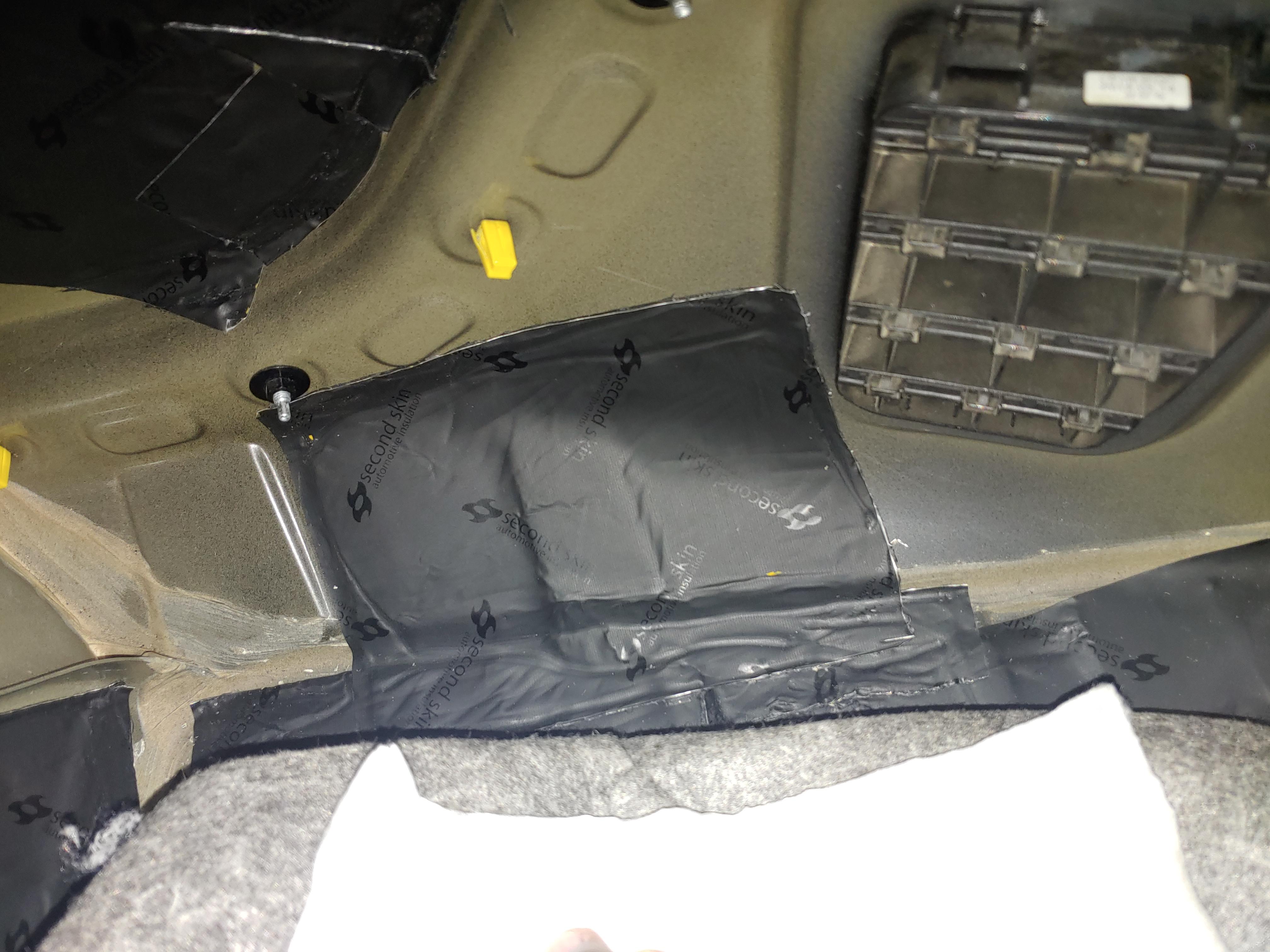

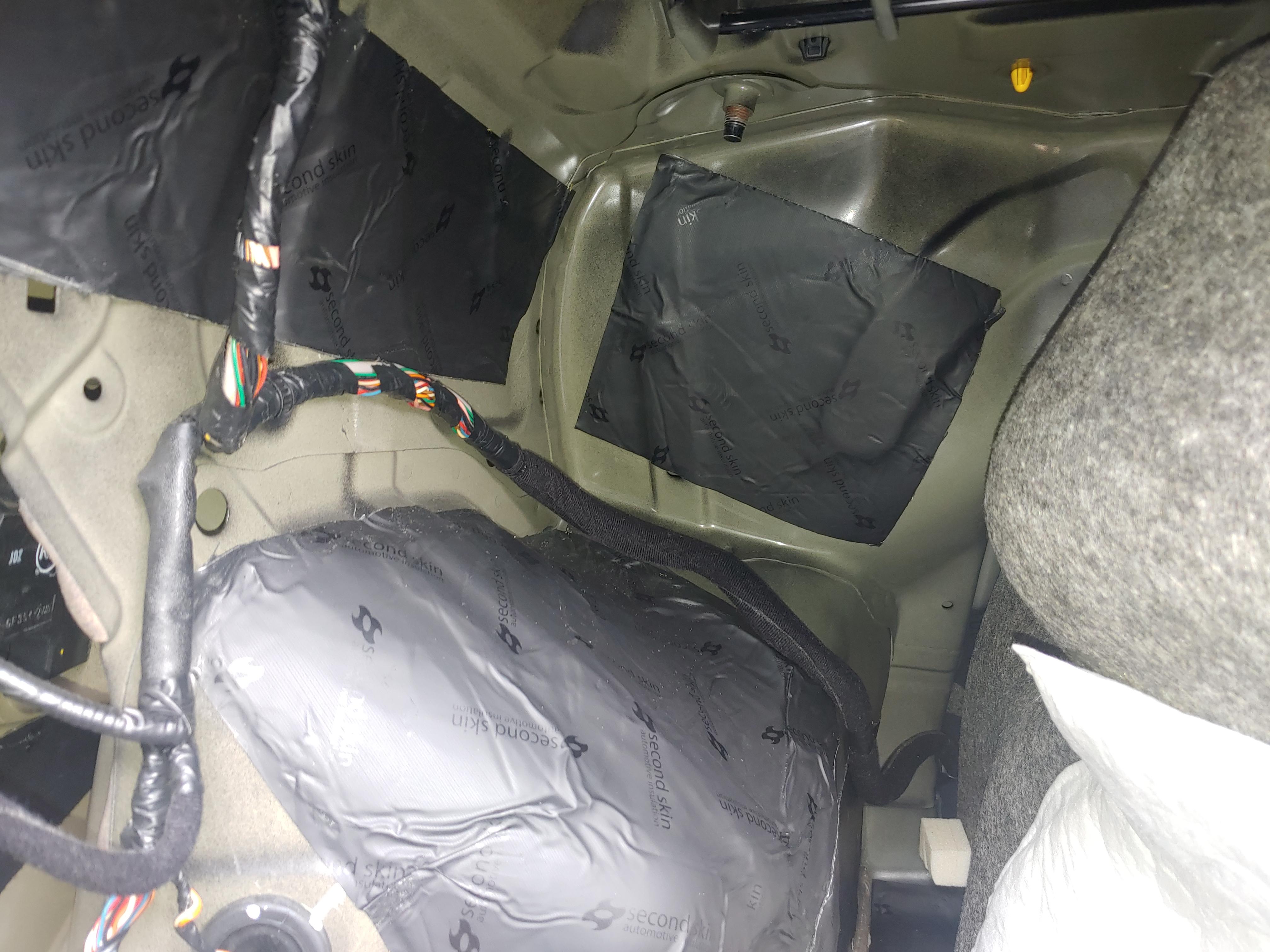

The best way to be ready is to be prepared. Saturday is going to be a long day, steps one and two are complete. Most of the trunks interior has been removed and wiped down with denatured alcohol, it should be dry after another wipe down on Saturday morning. All the interior sheet metal is prepped and clean.
As much as I love car audio, I will pay someone to install my deadner in the future. Haha glad I decided to start a day early and do it in sections vs the whole trunk in one day.

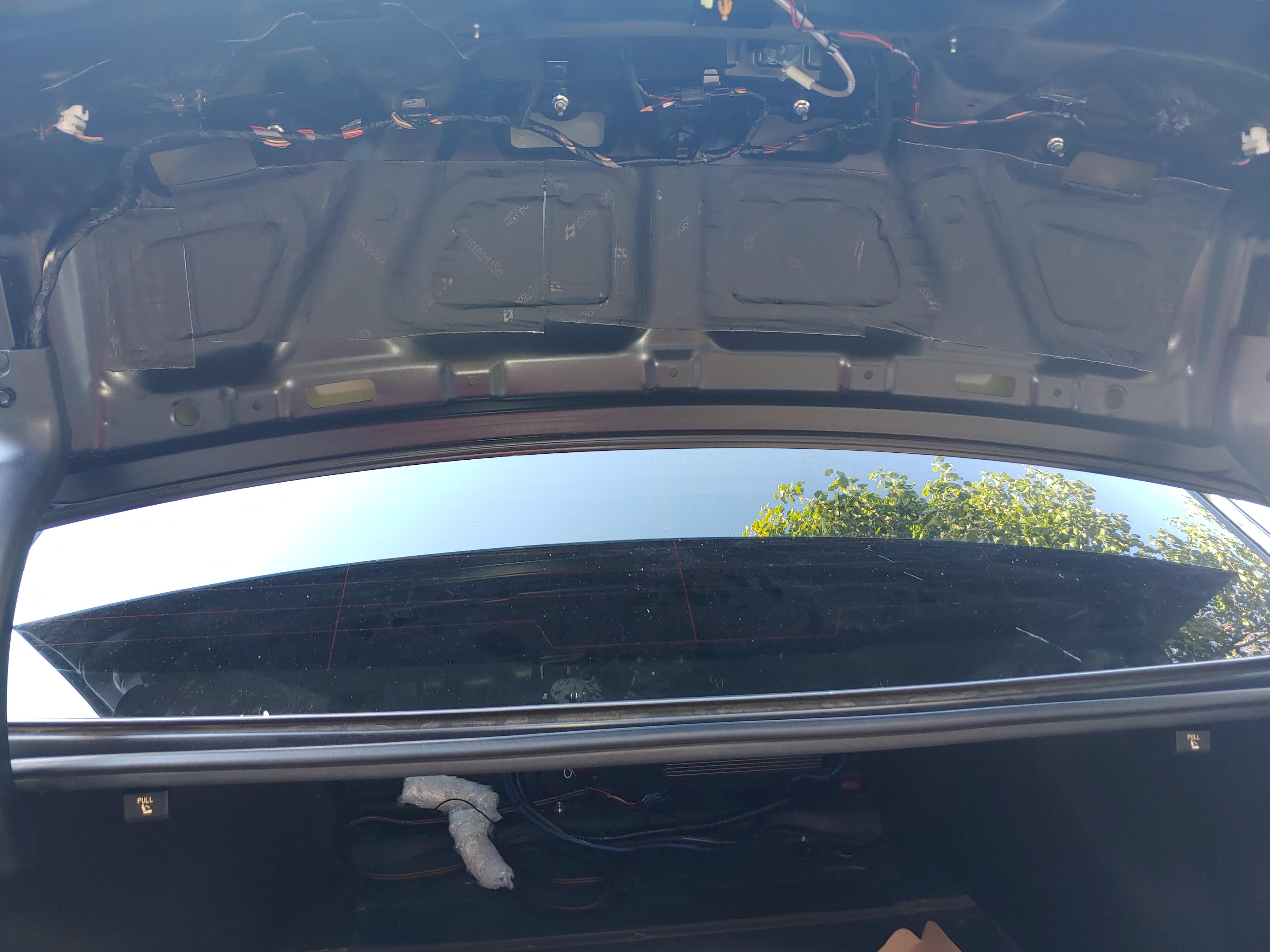

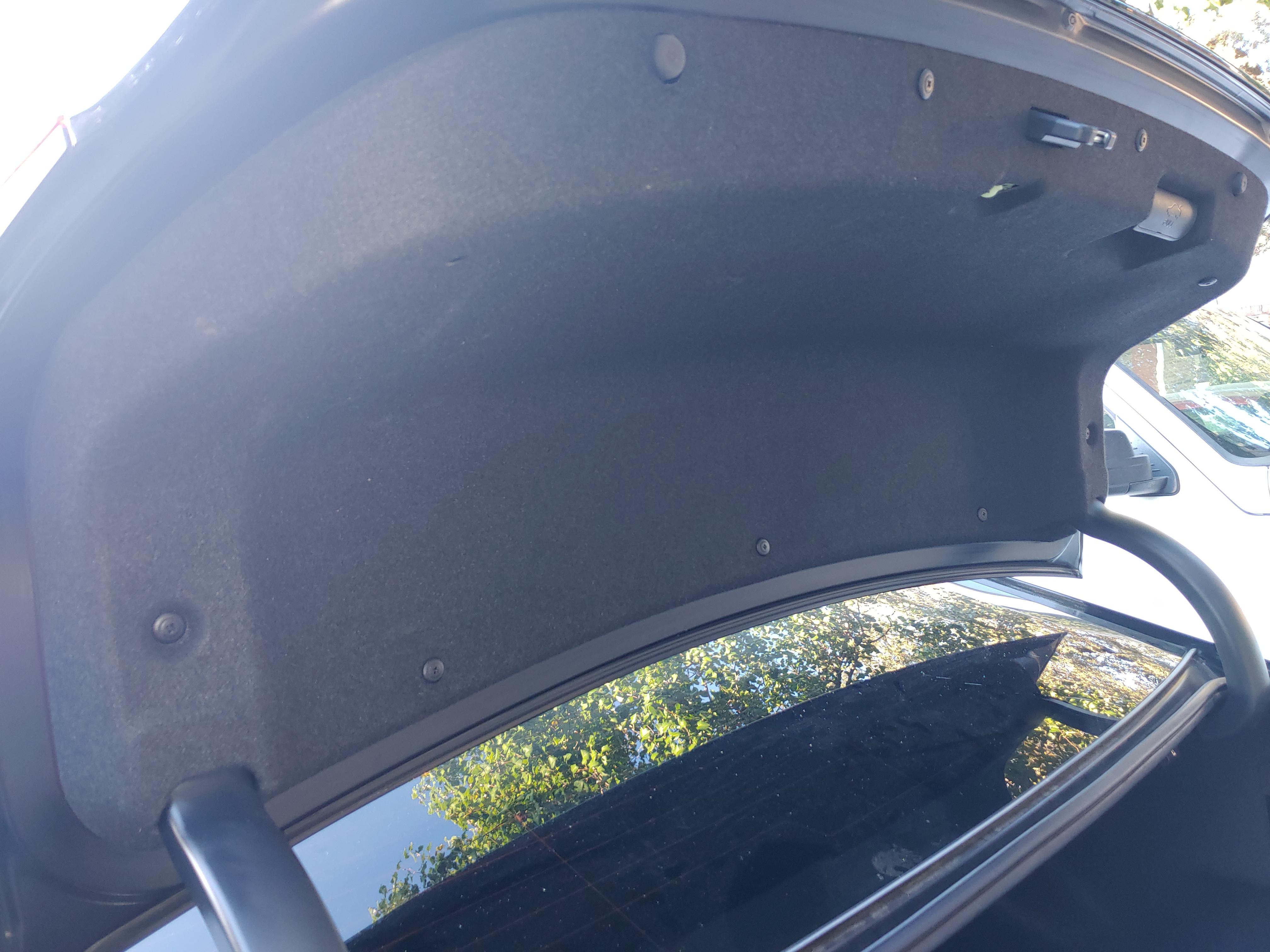

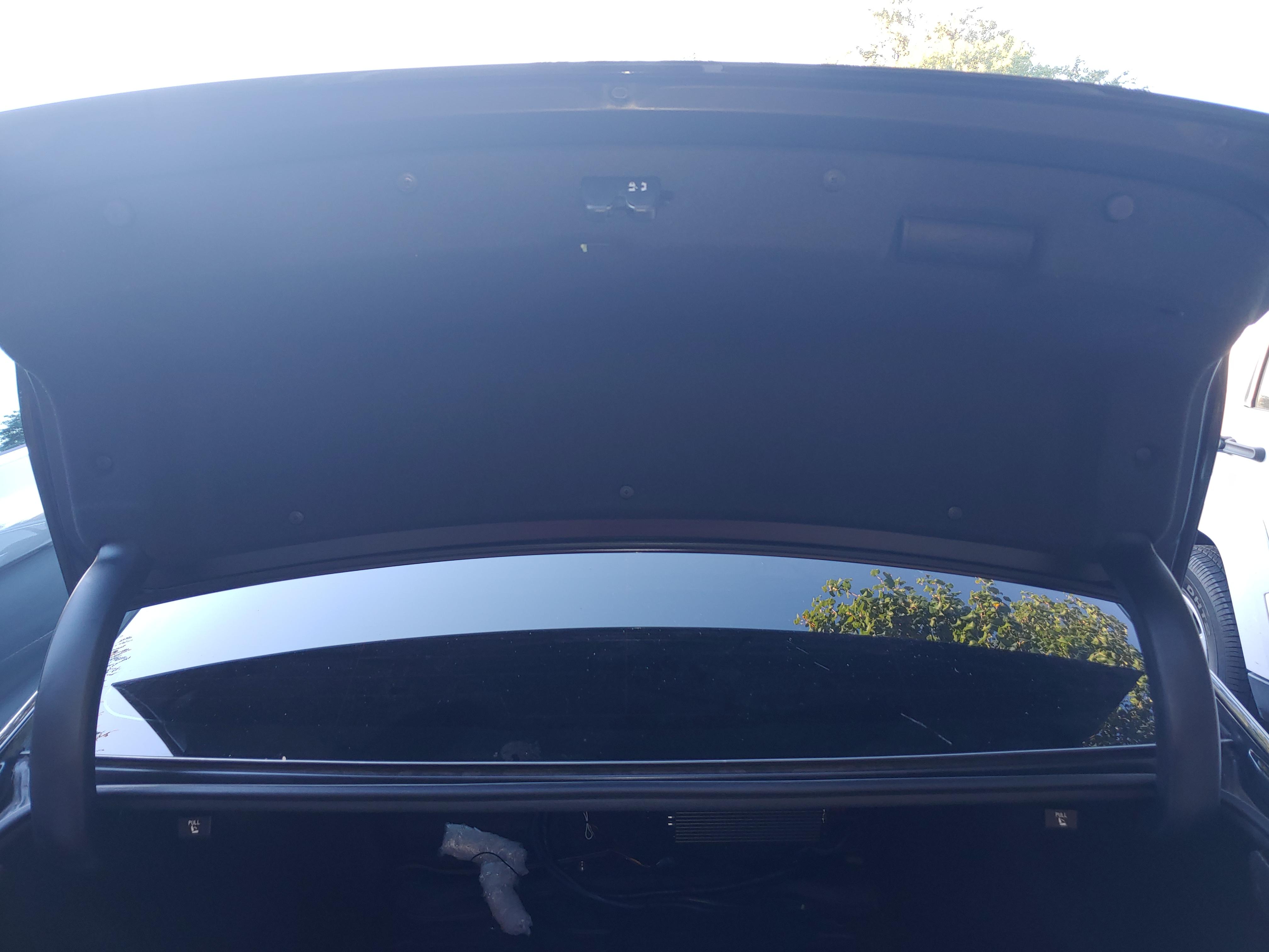

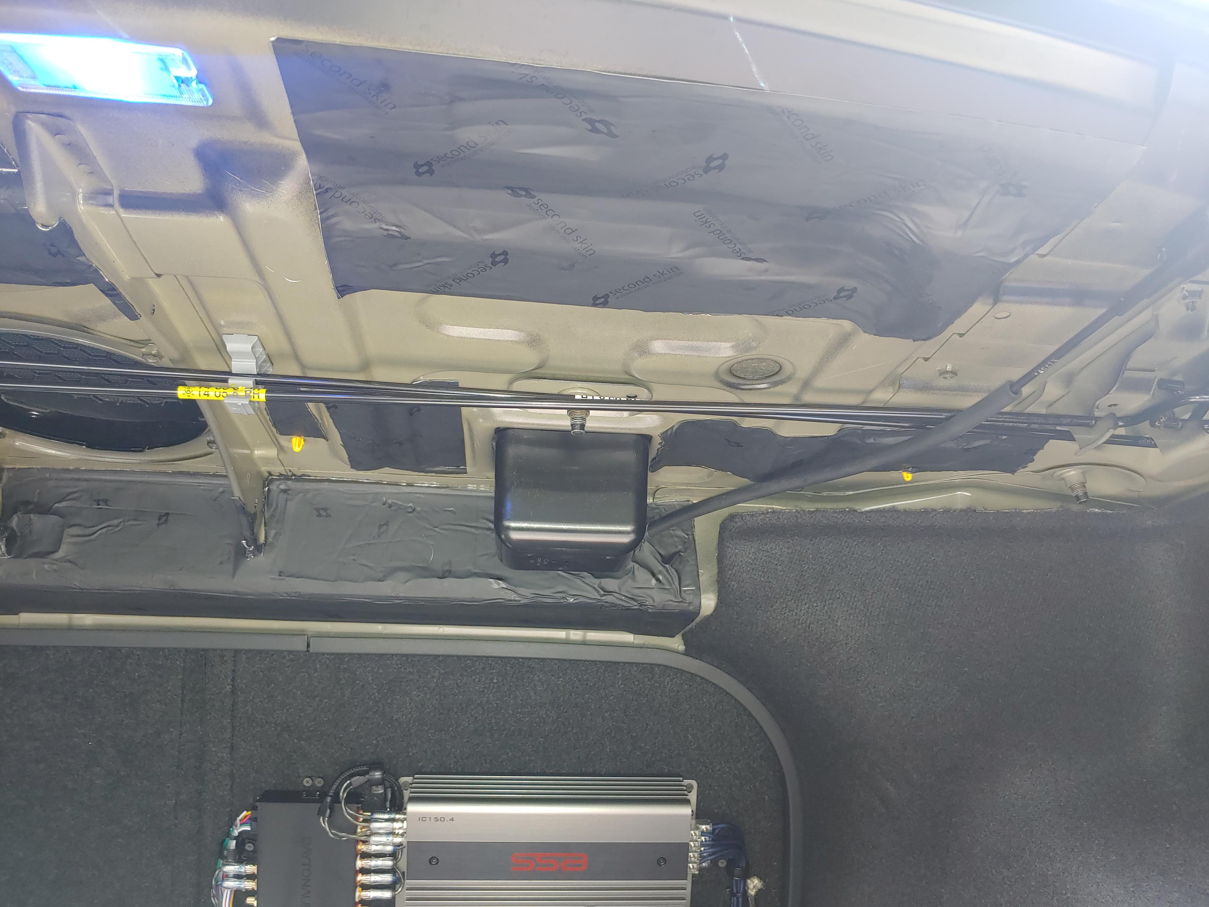

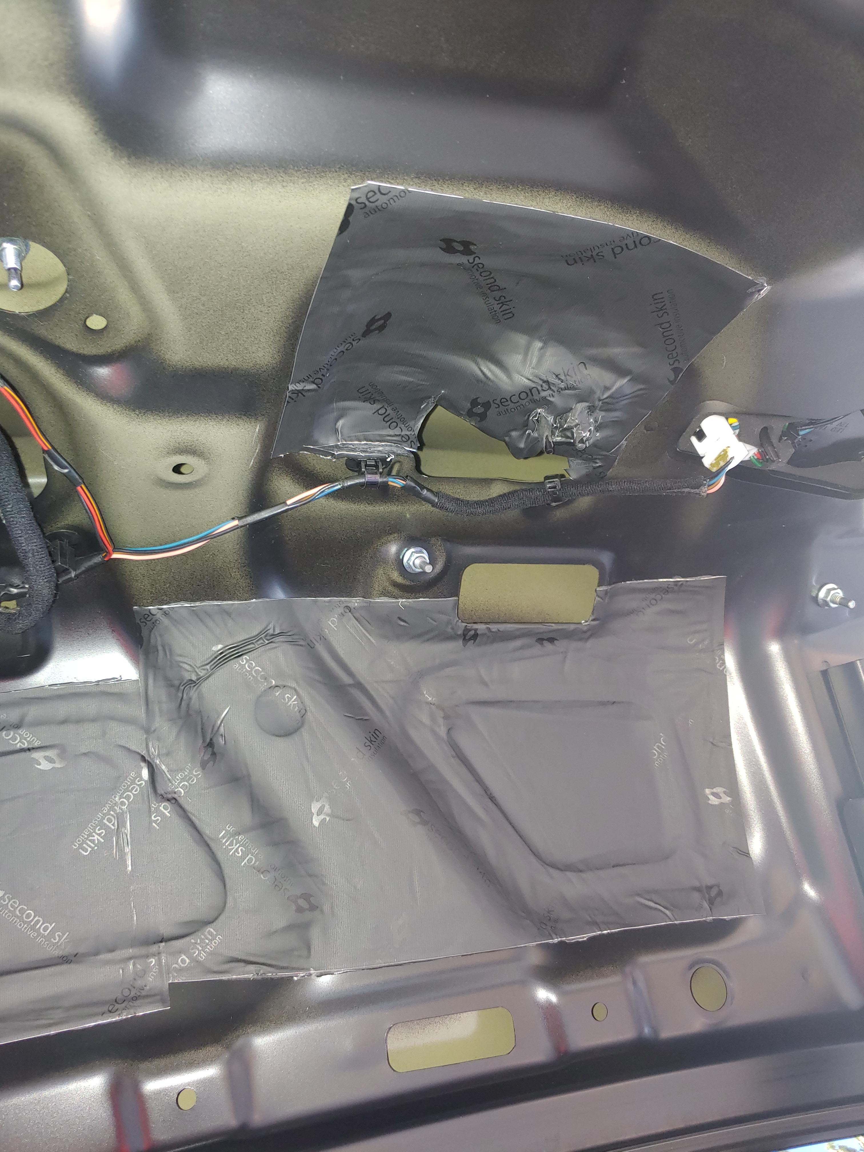

Trunk Lid is complete
  • Popular Post

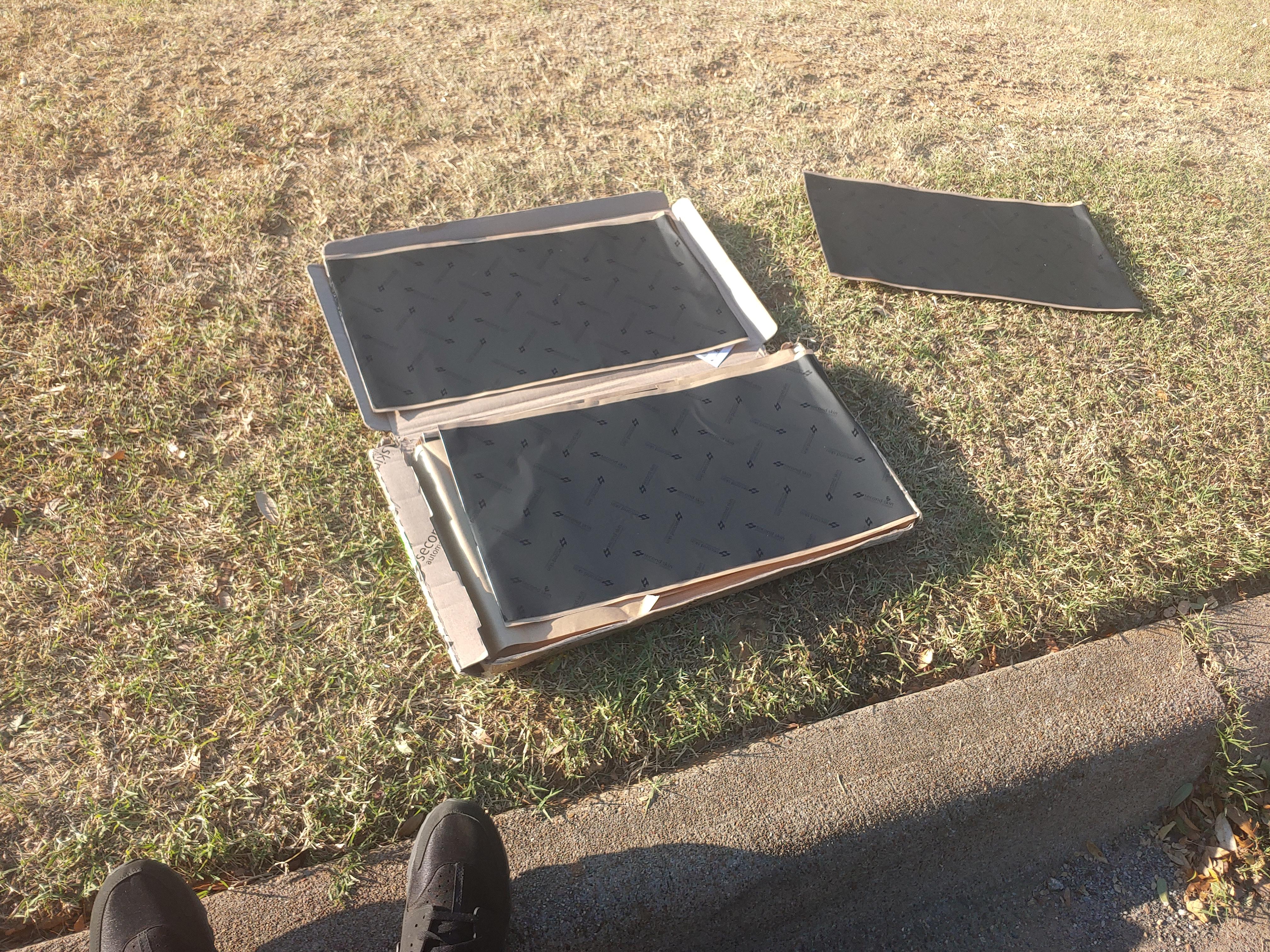

Got a little chilly last night so I let the sheets sit in the sun this morning.
Edited by jcarter1885
Spelling

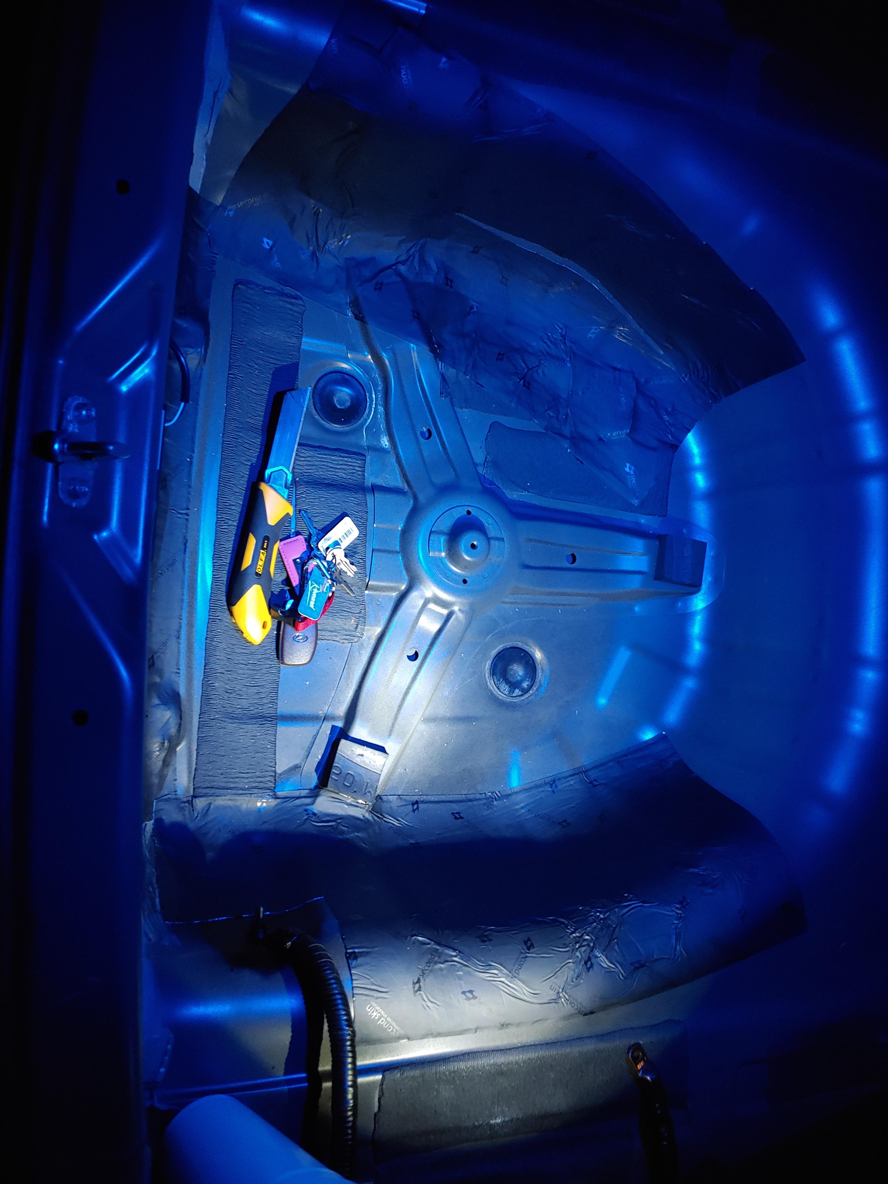

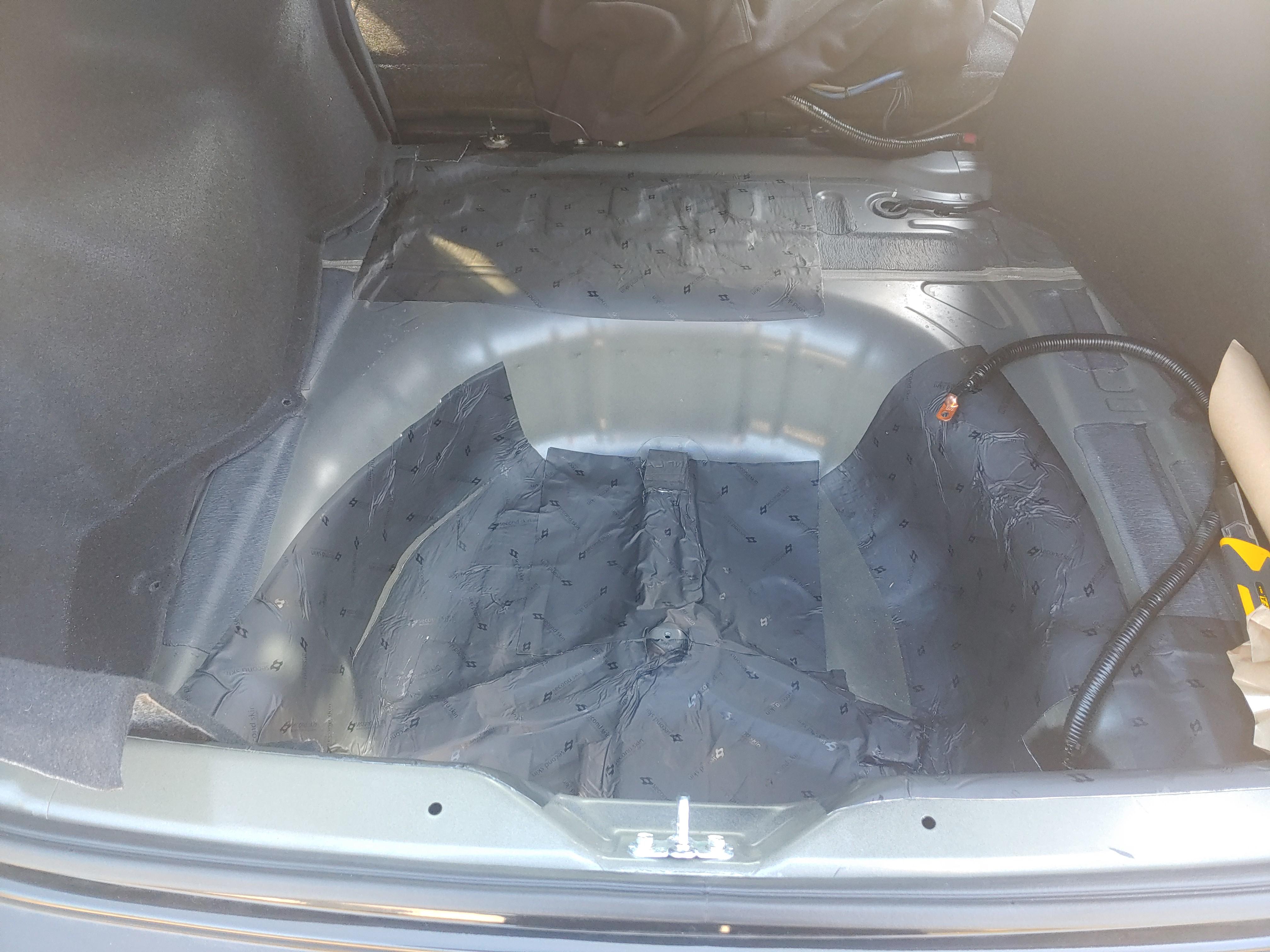

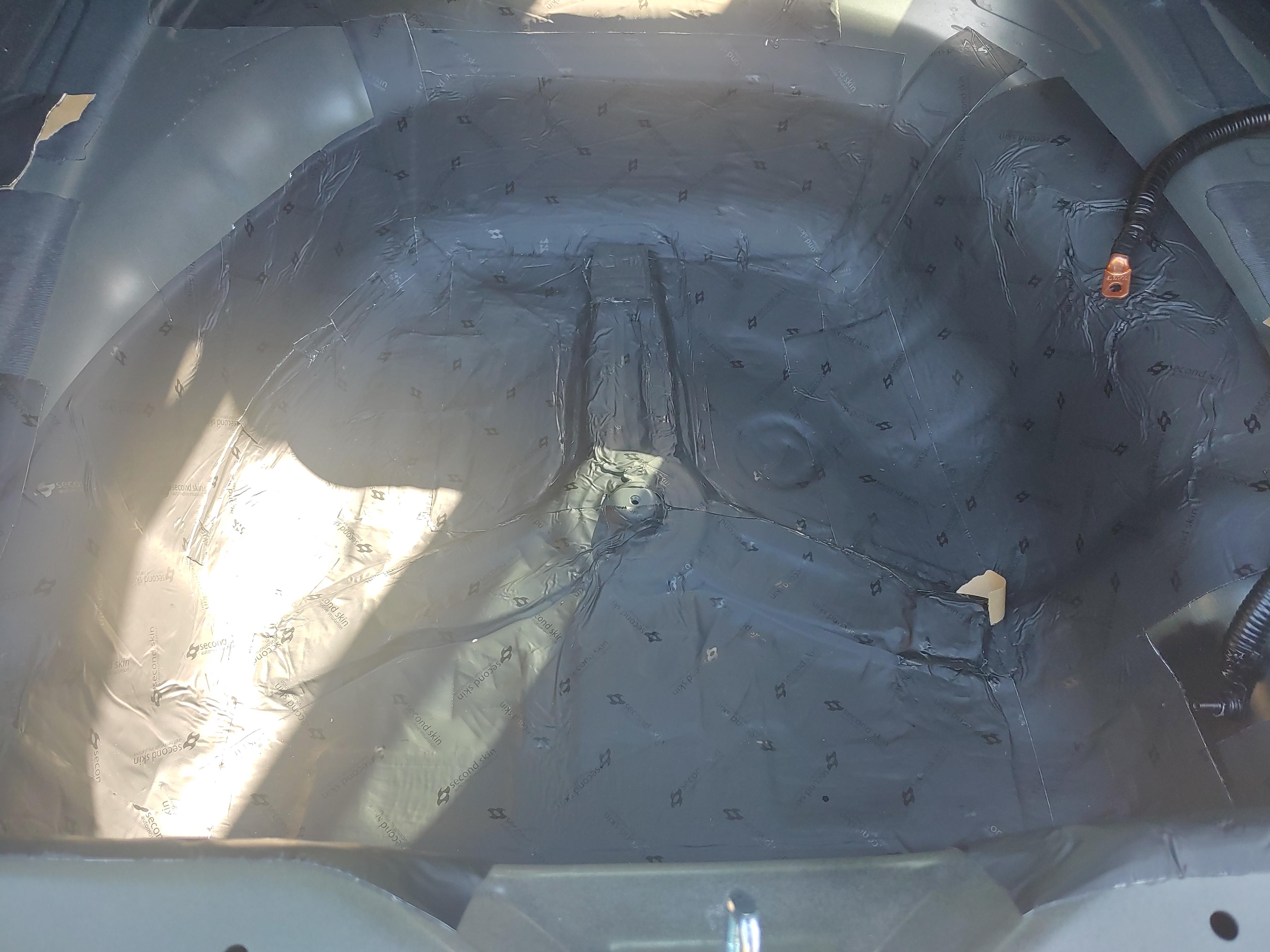

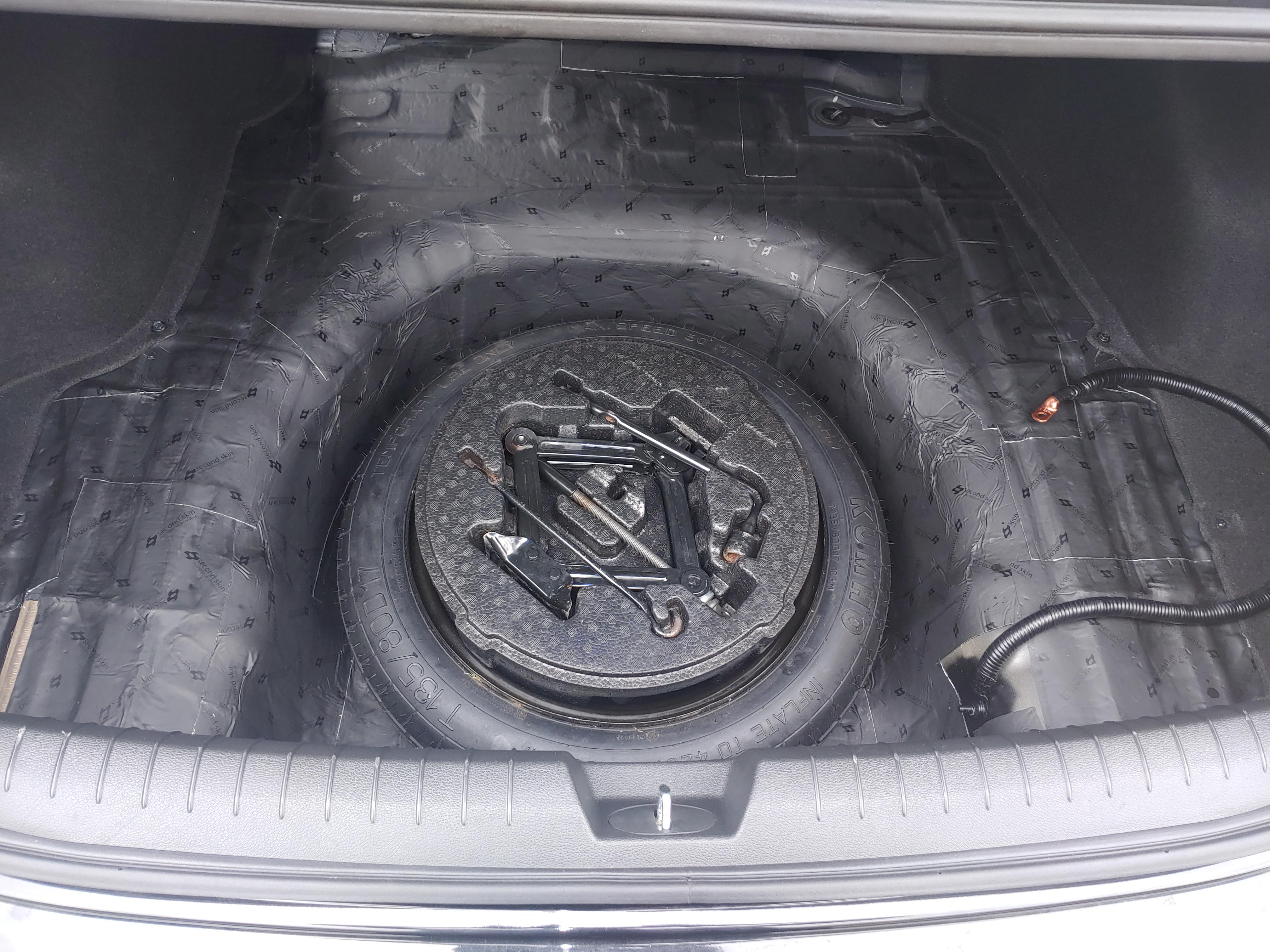

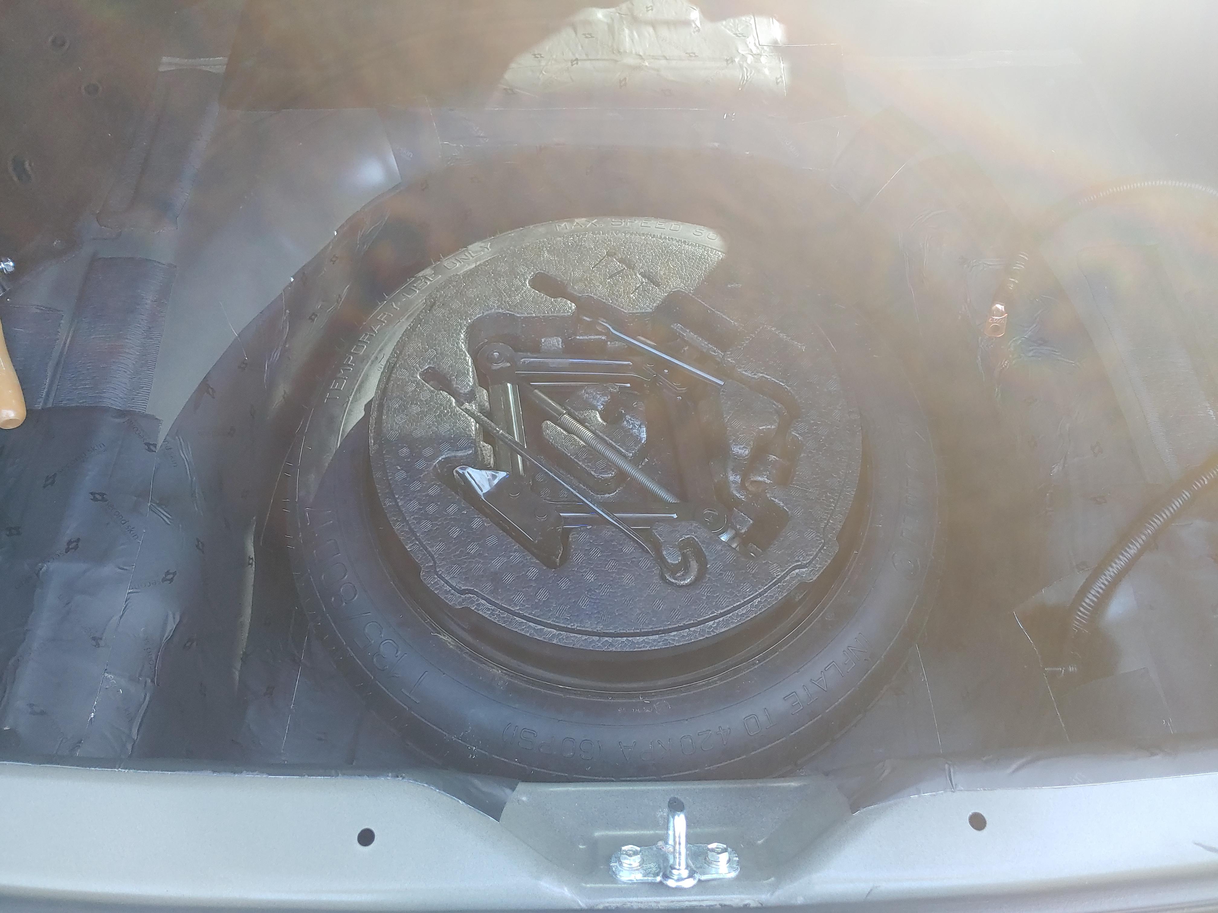

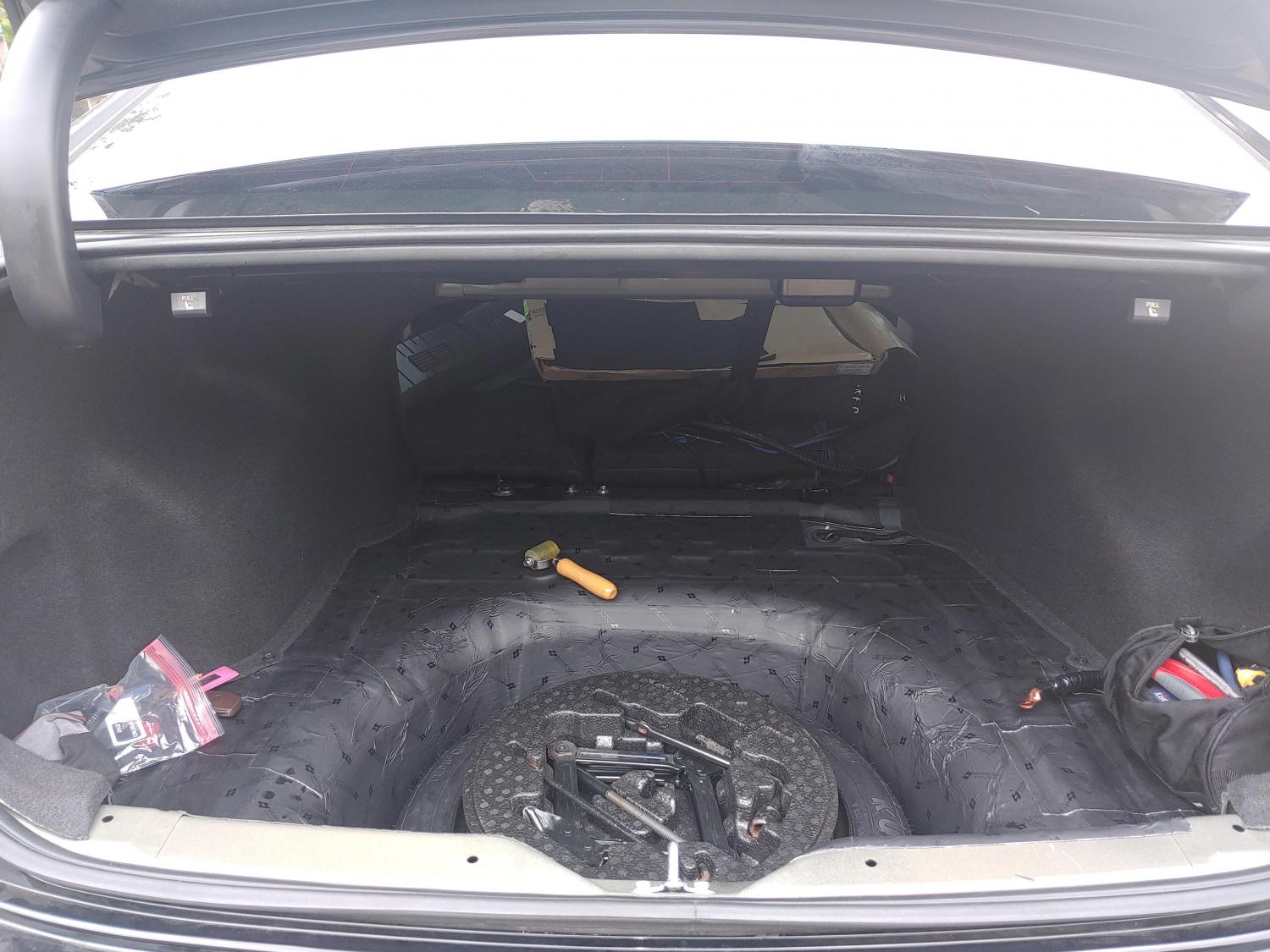

Trunk spare tire well is complete.
  • Popular Post

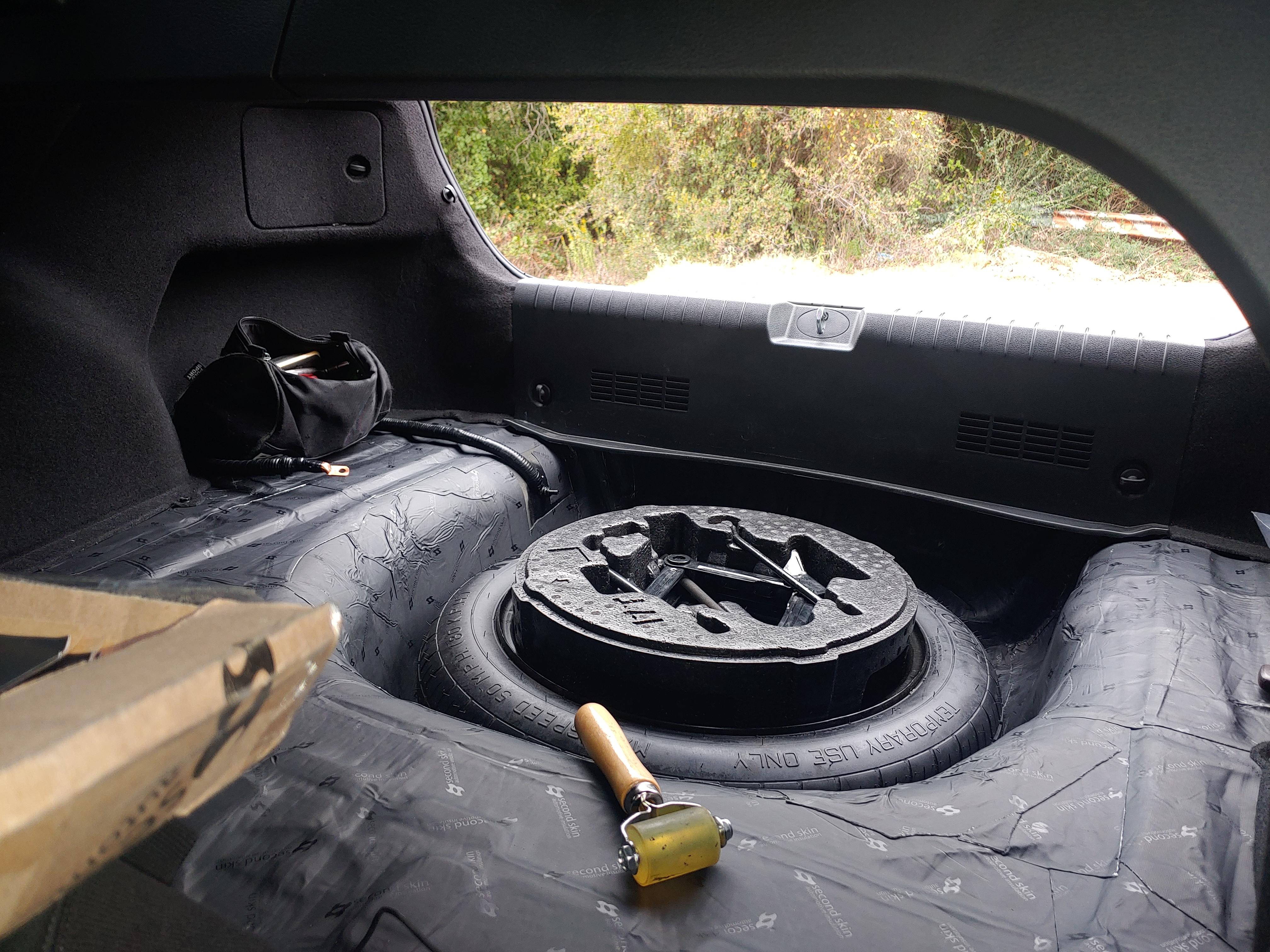

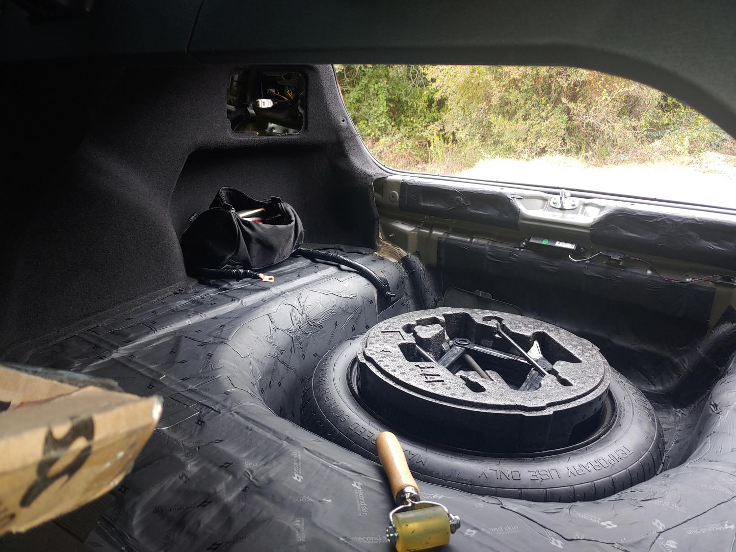

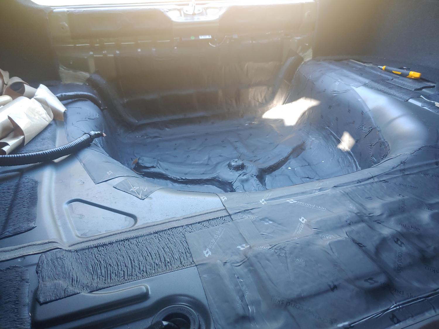

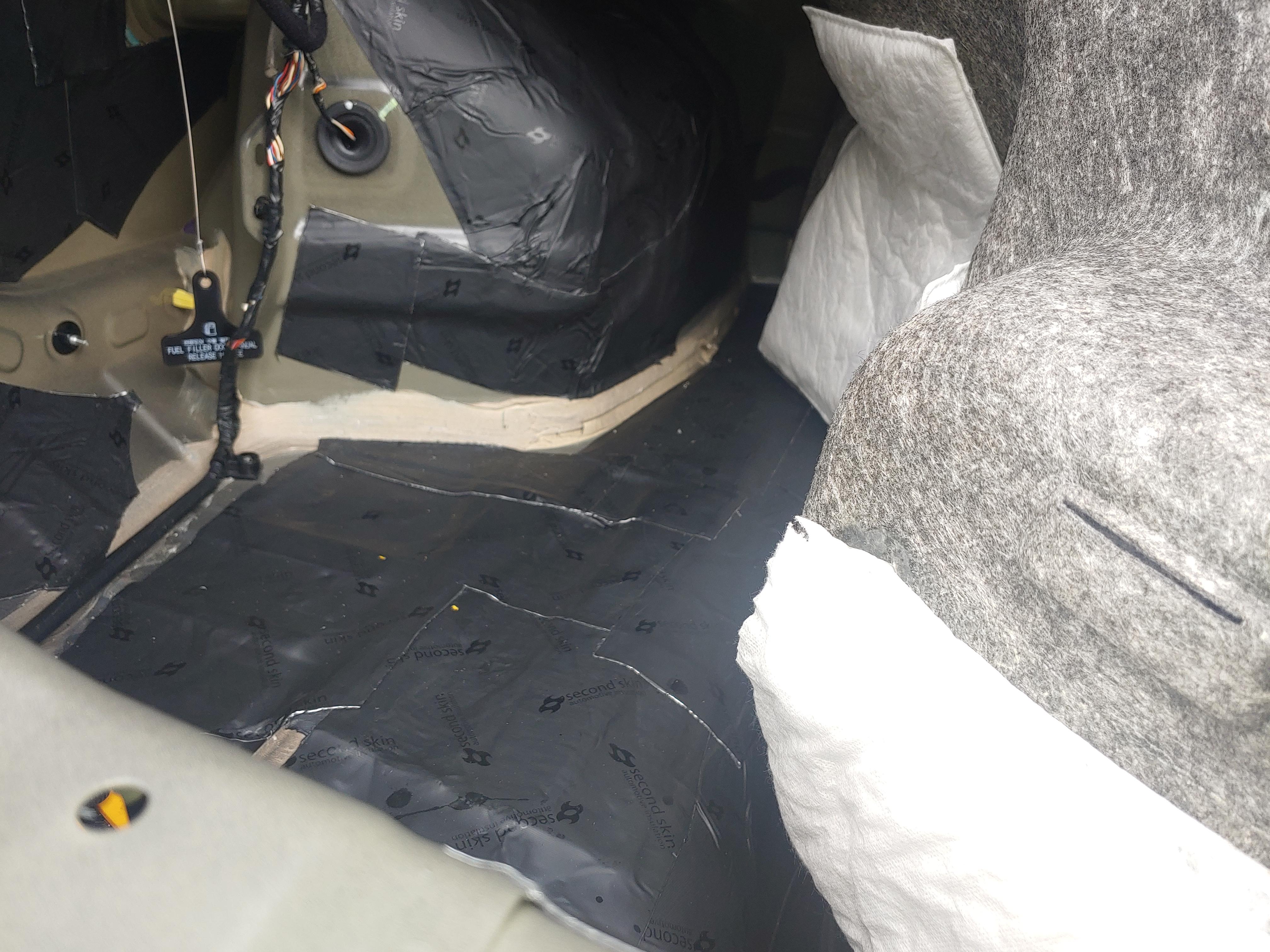

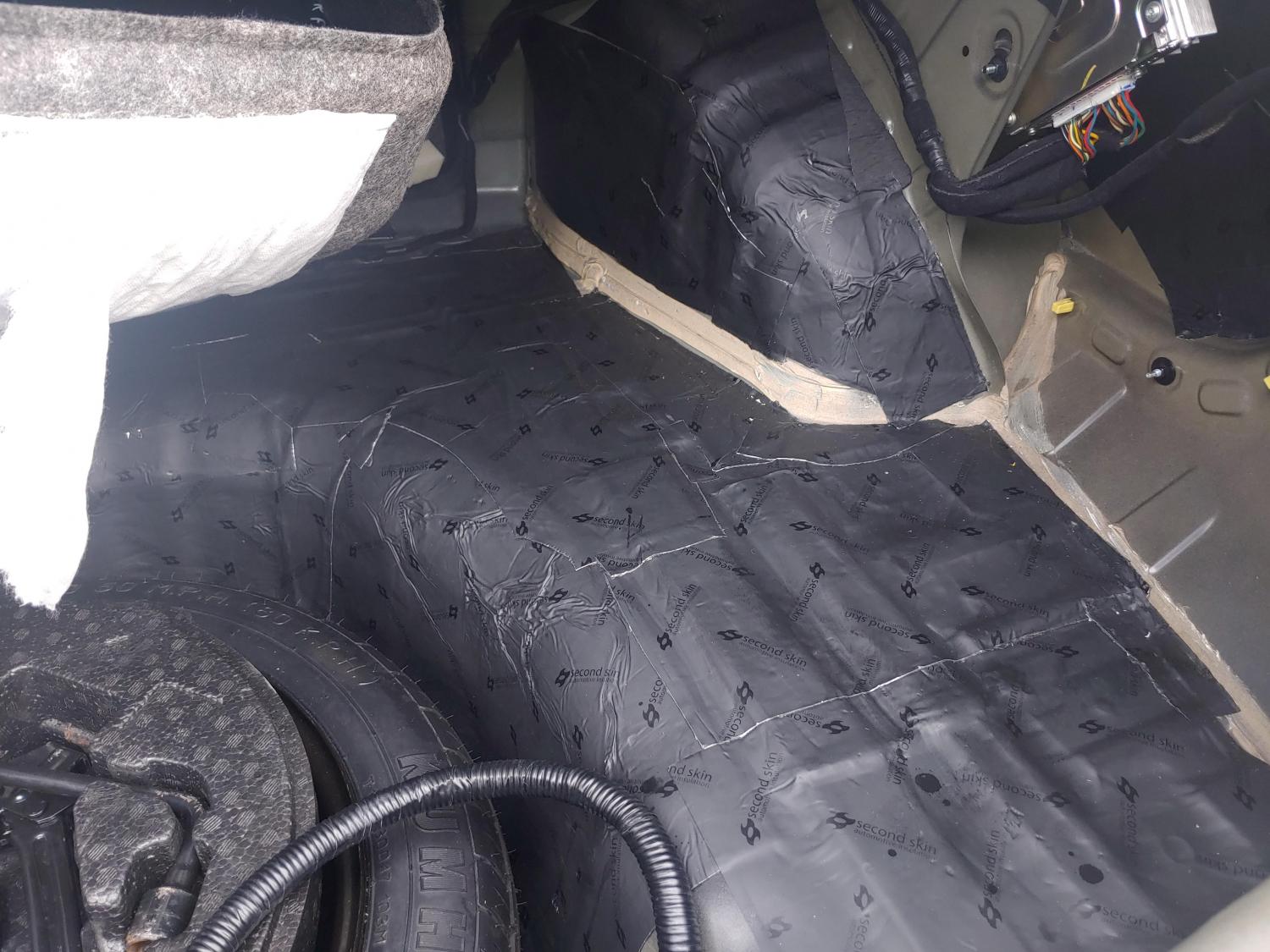

Trunk is done, rear deck and doors next.
  • Popular Post

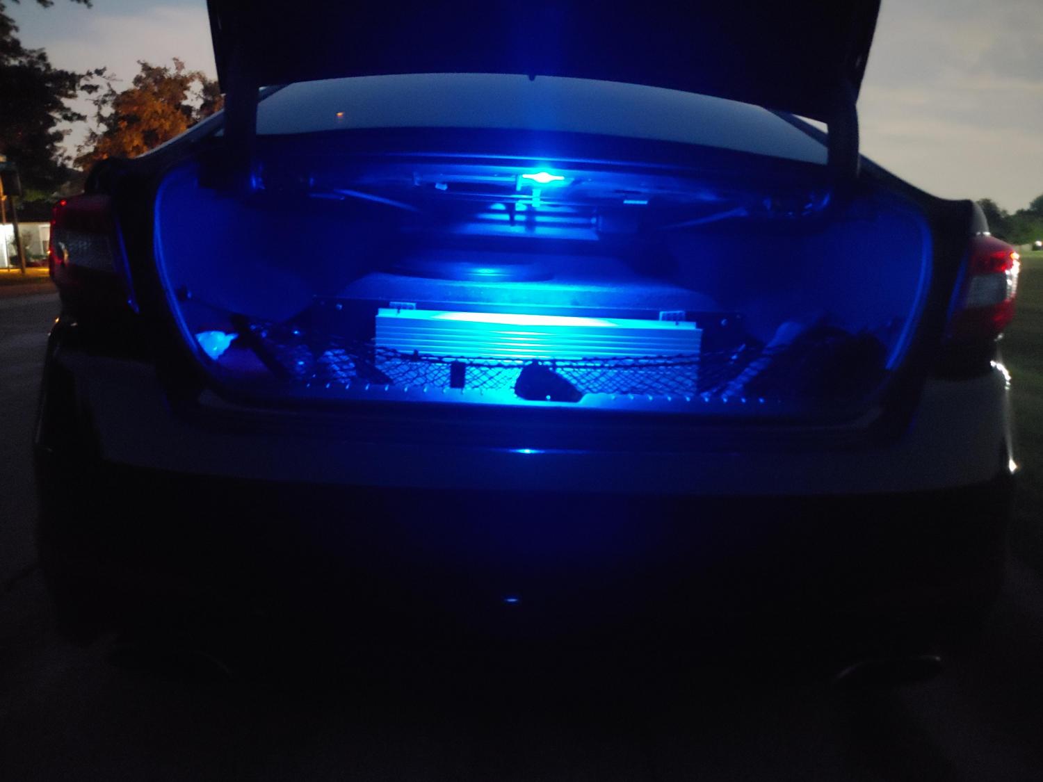

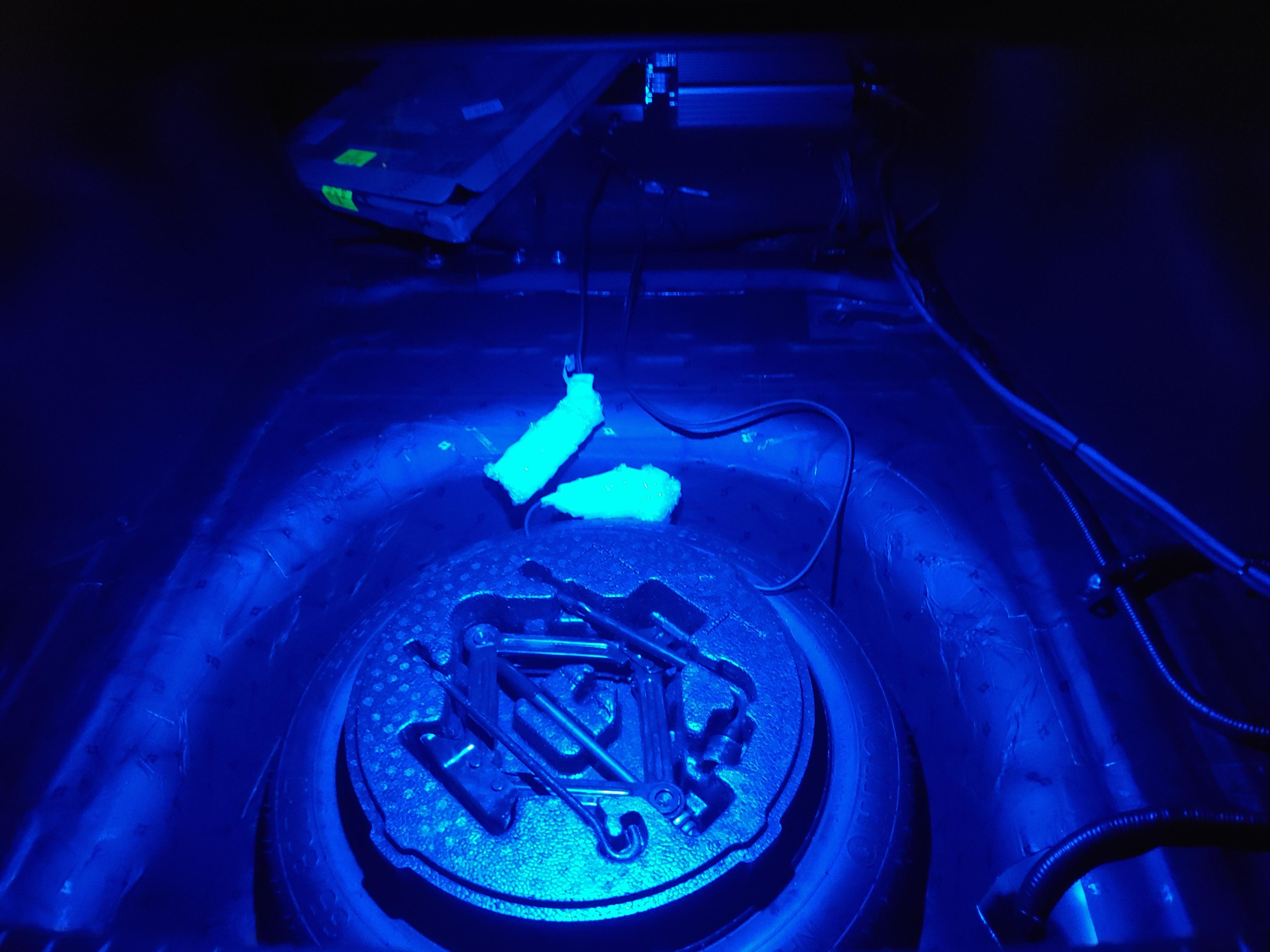

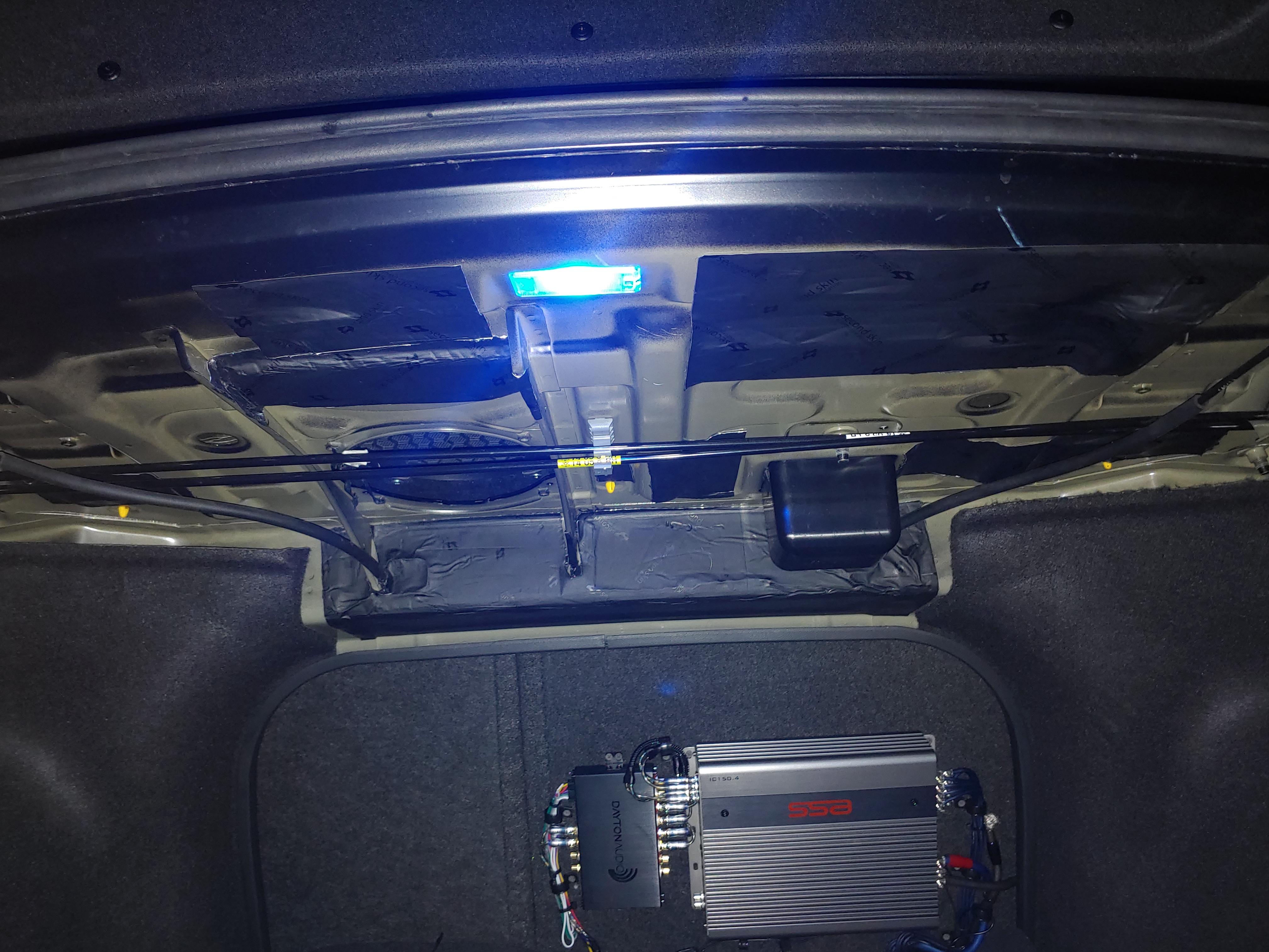

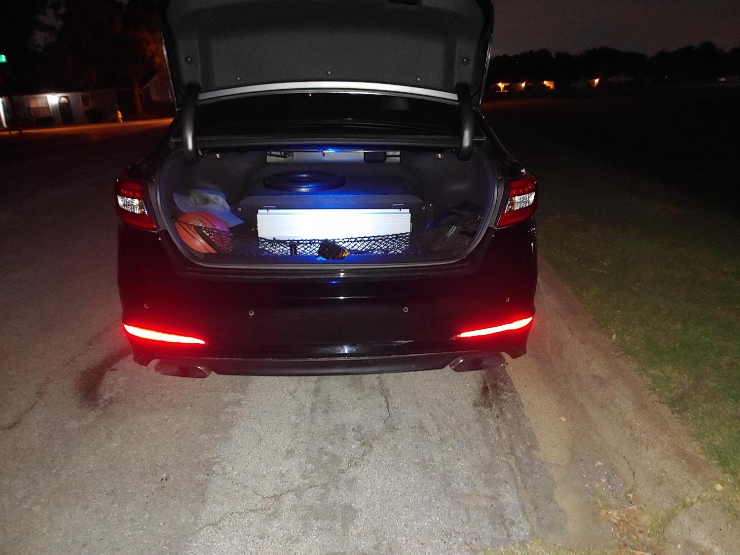

Night shots before the carpet goes back in.
@Second Skin thanks for the great poduct, it was quite easy to apply. Trunk is solid now :woot:

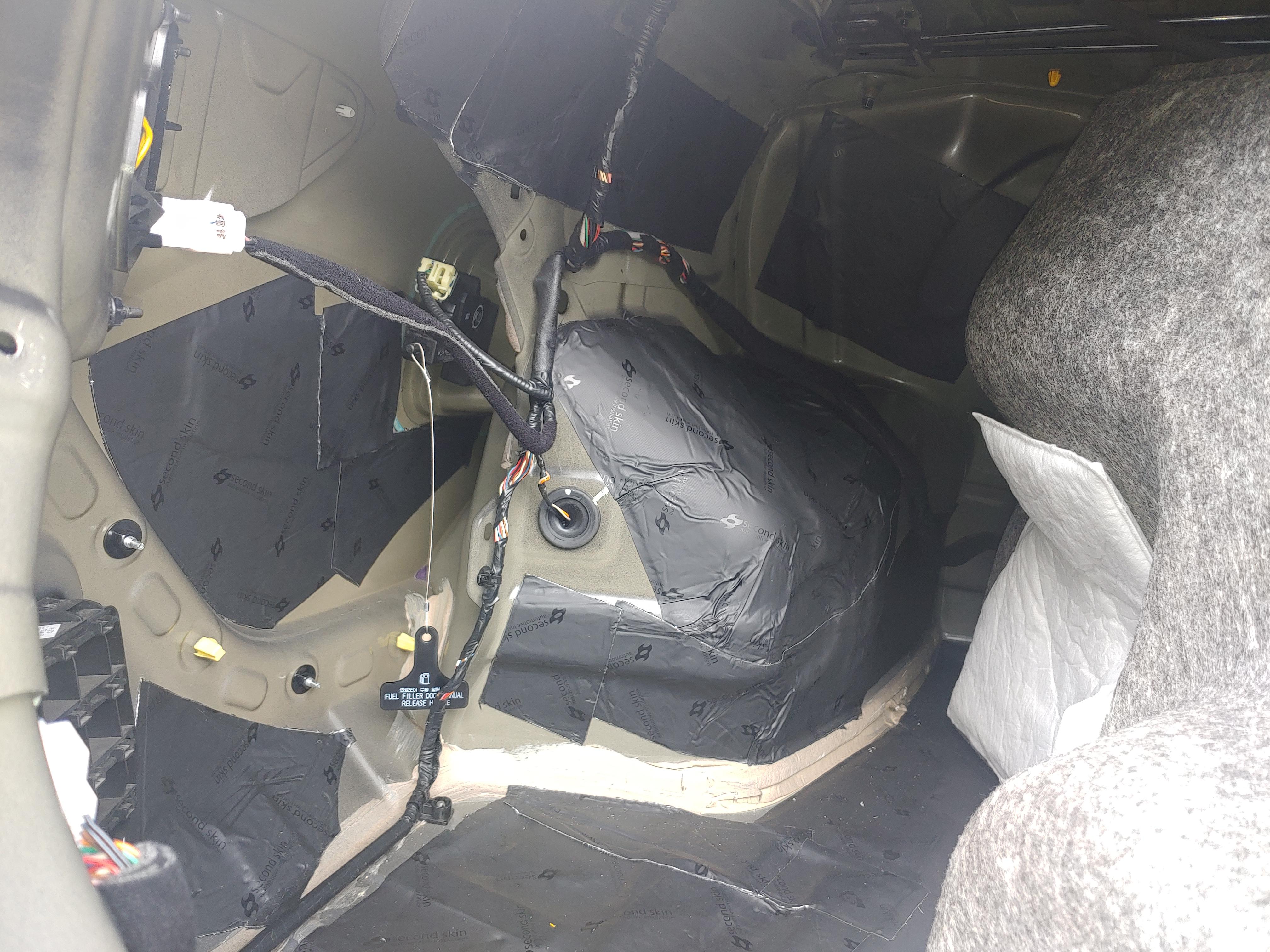

Just finished the rear deck, ill do the doors in the future. Still have 3 sheets left out of 20 sheets (I got the 40sq. feet pack).

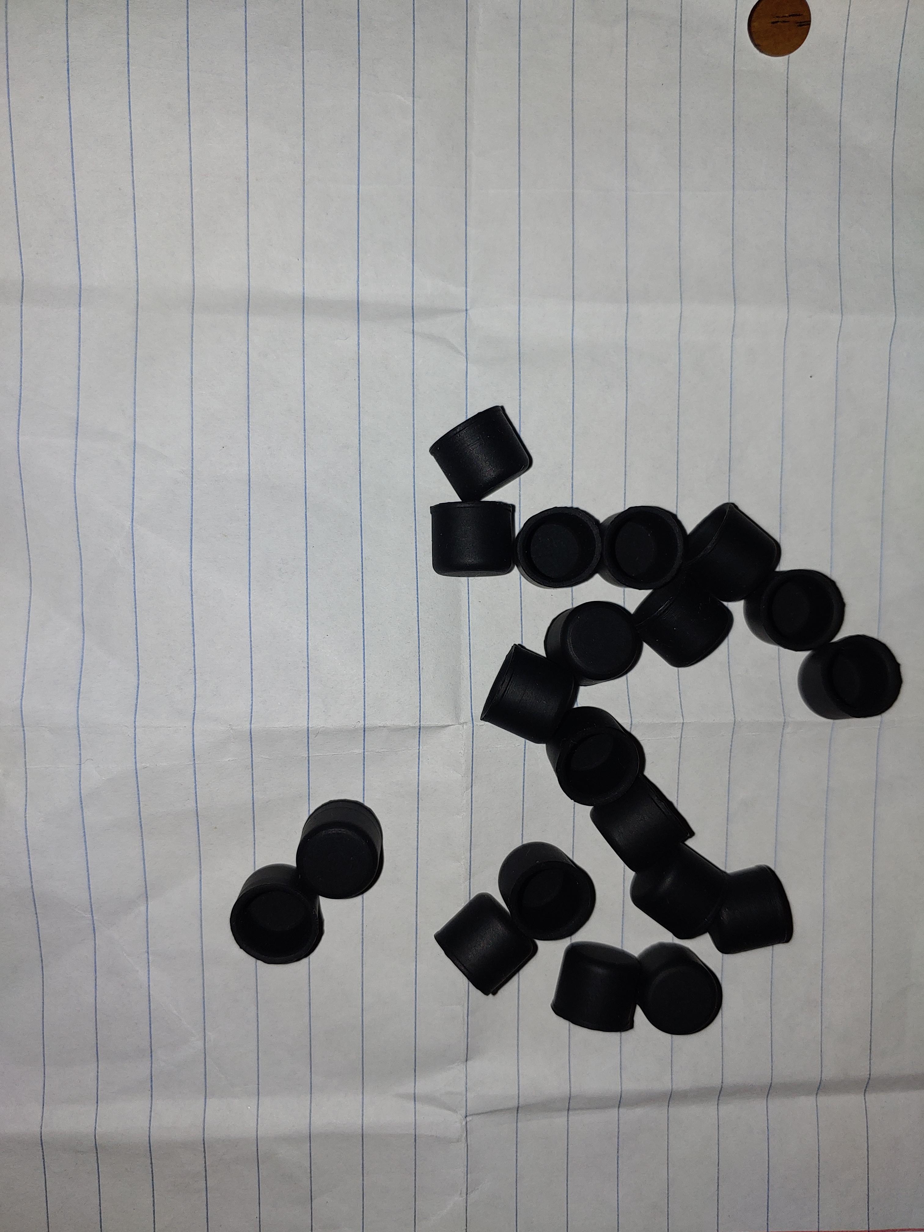

Bought some female RCA dust covers for the the jacks that aren't used.
