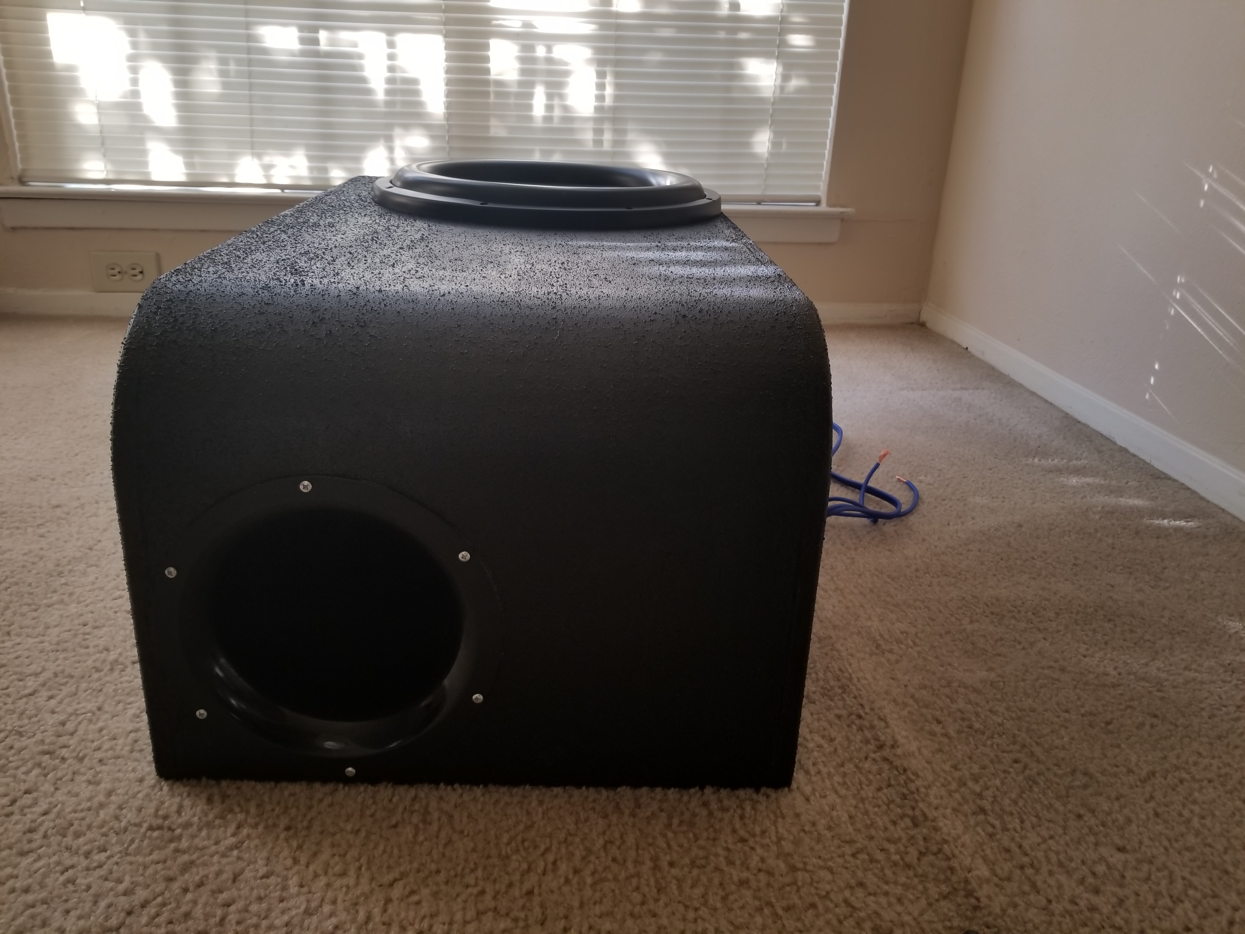

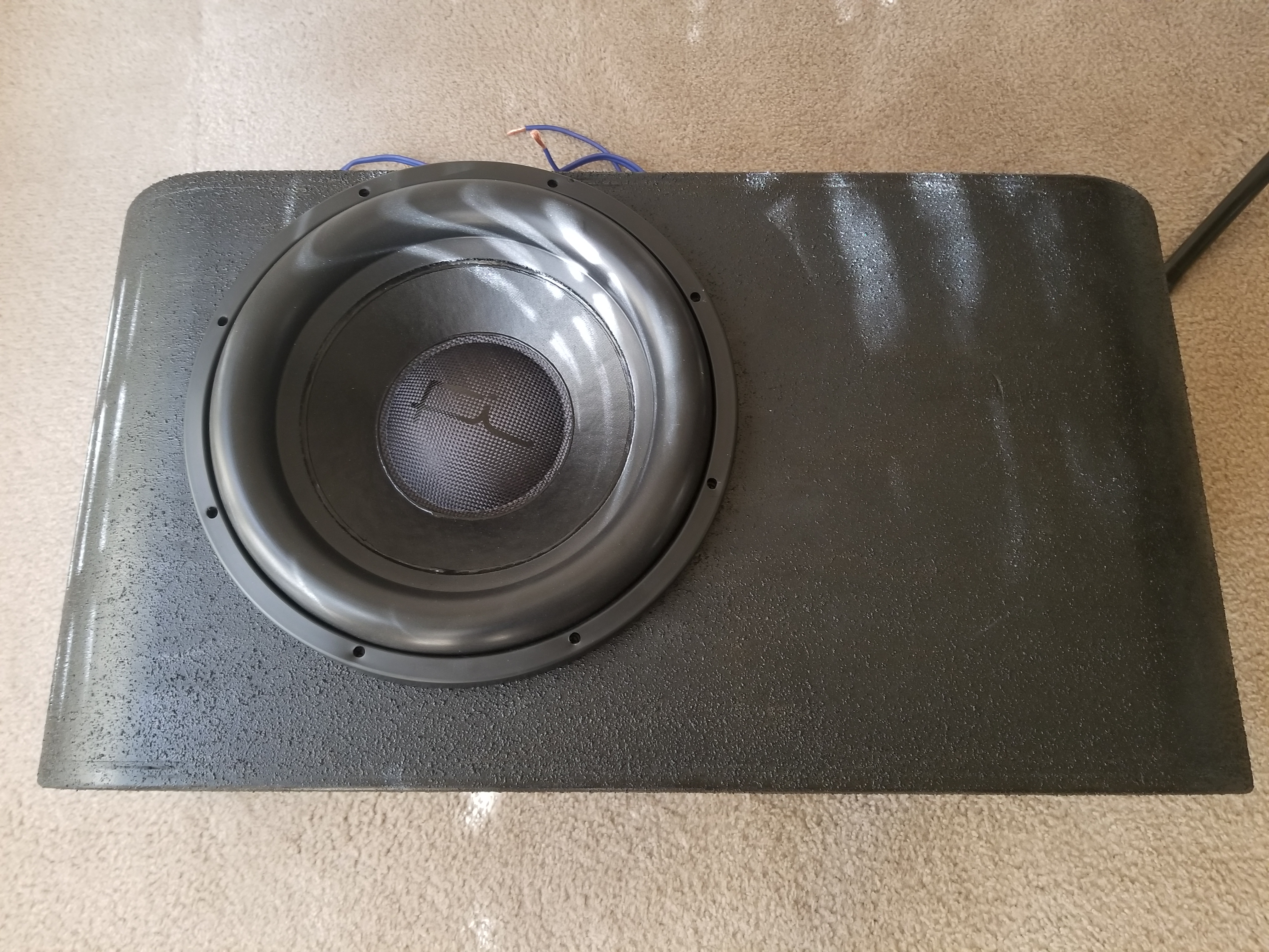

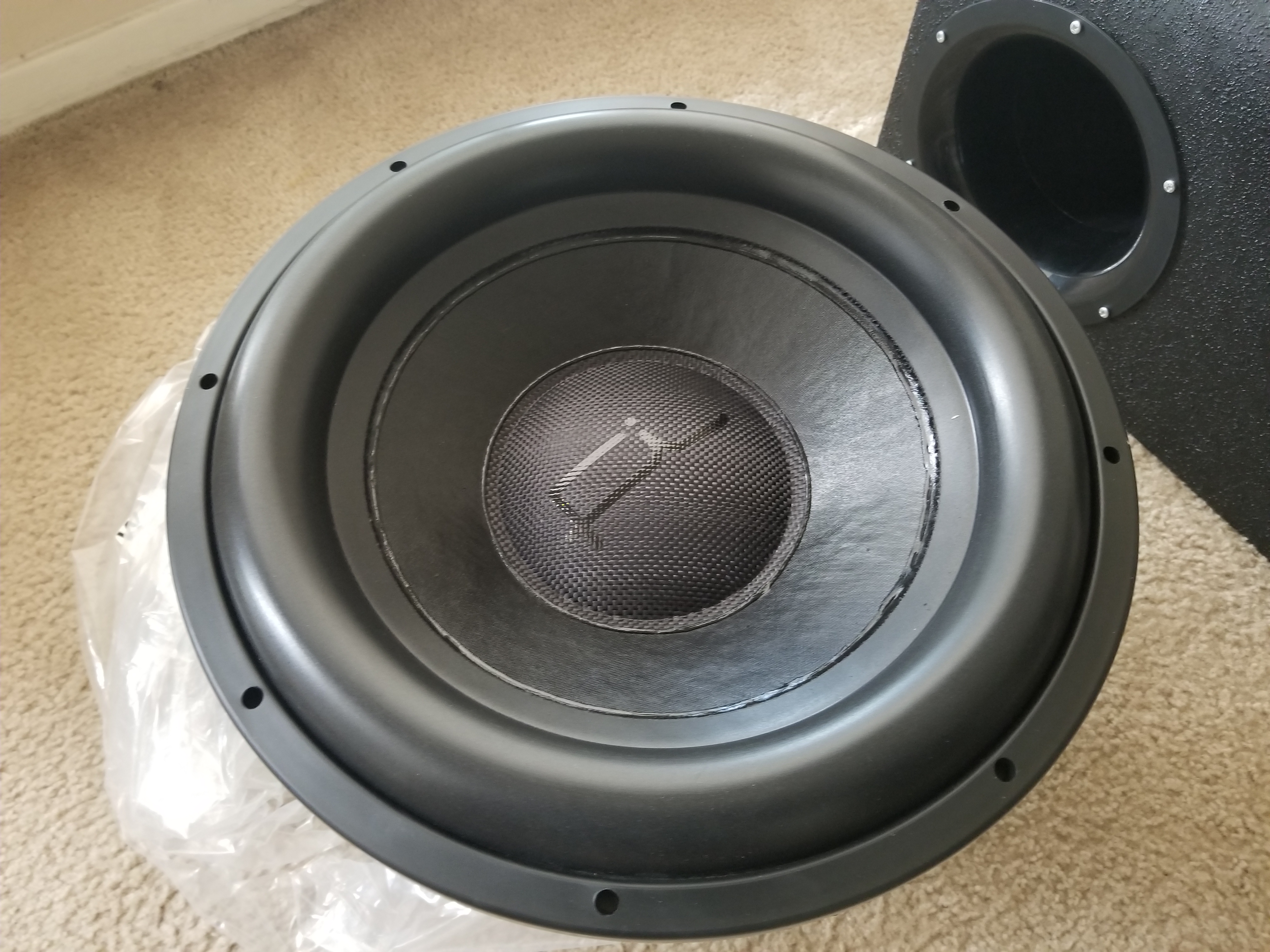

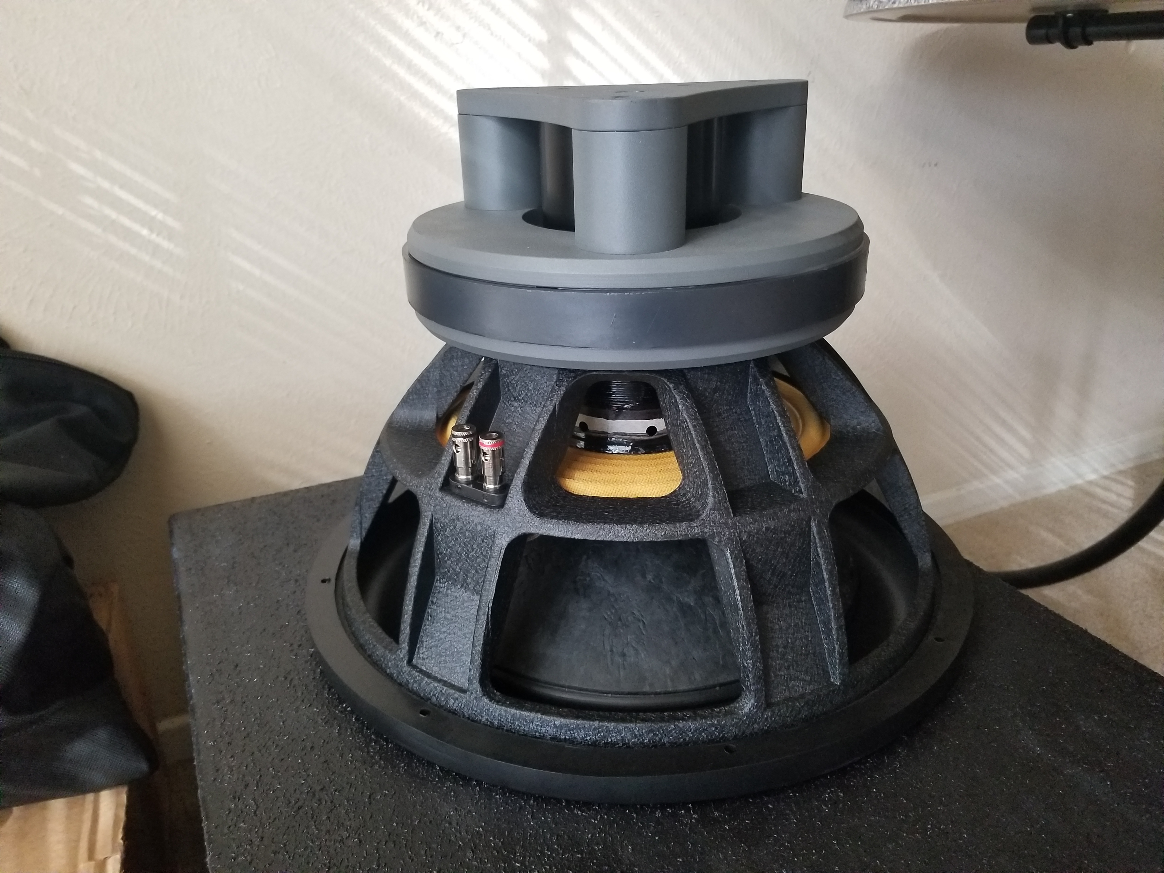

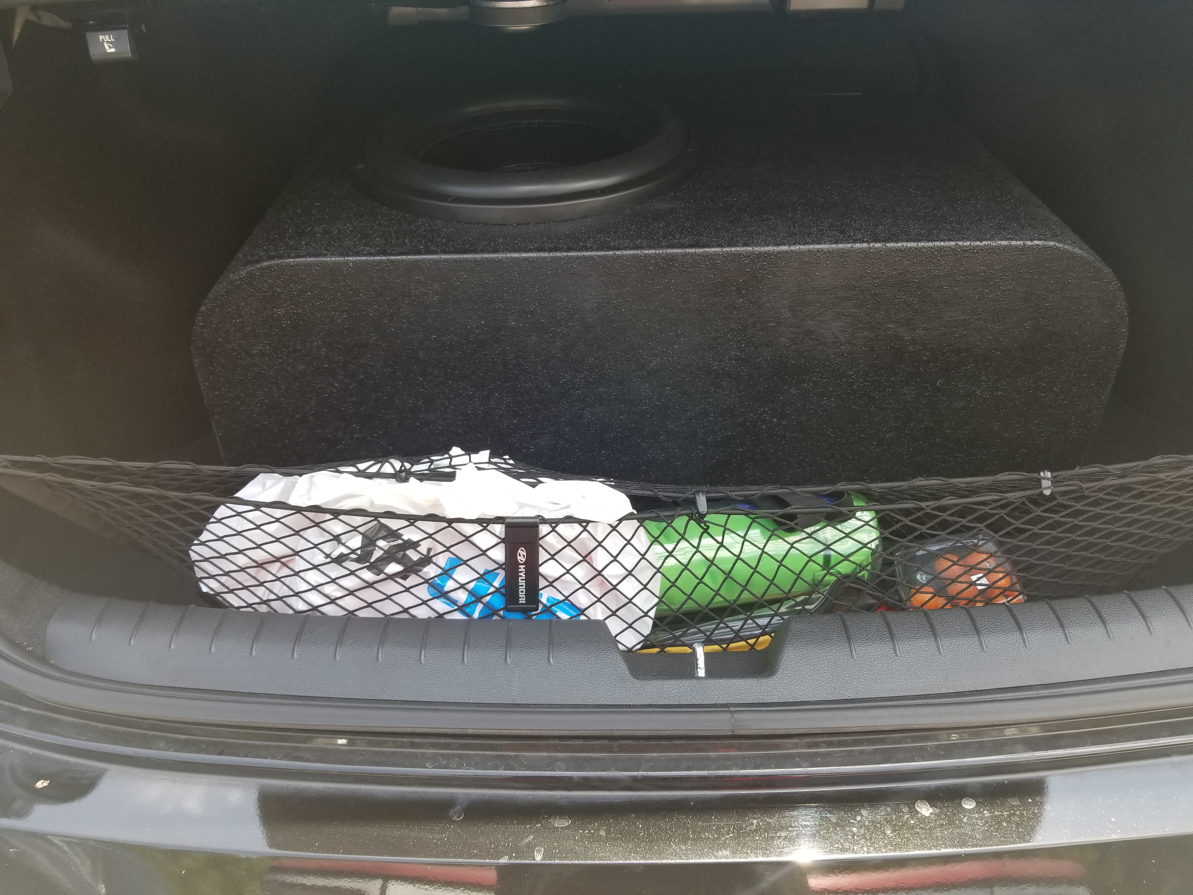

    Enclosure designed and built by a local builder. 3.81 @ 31hz before sub 3.6 @ 32 hz after sub (15" SP4)

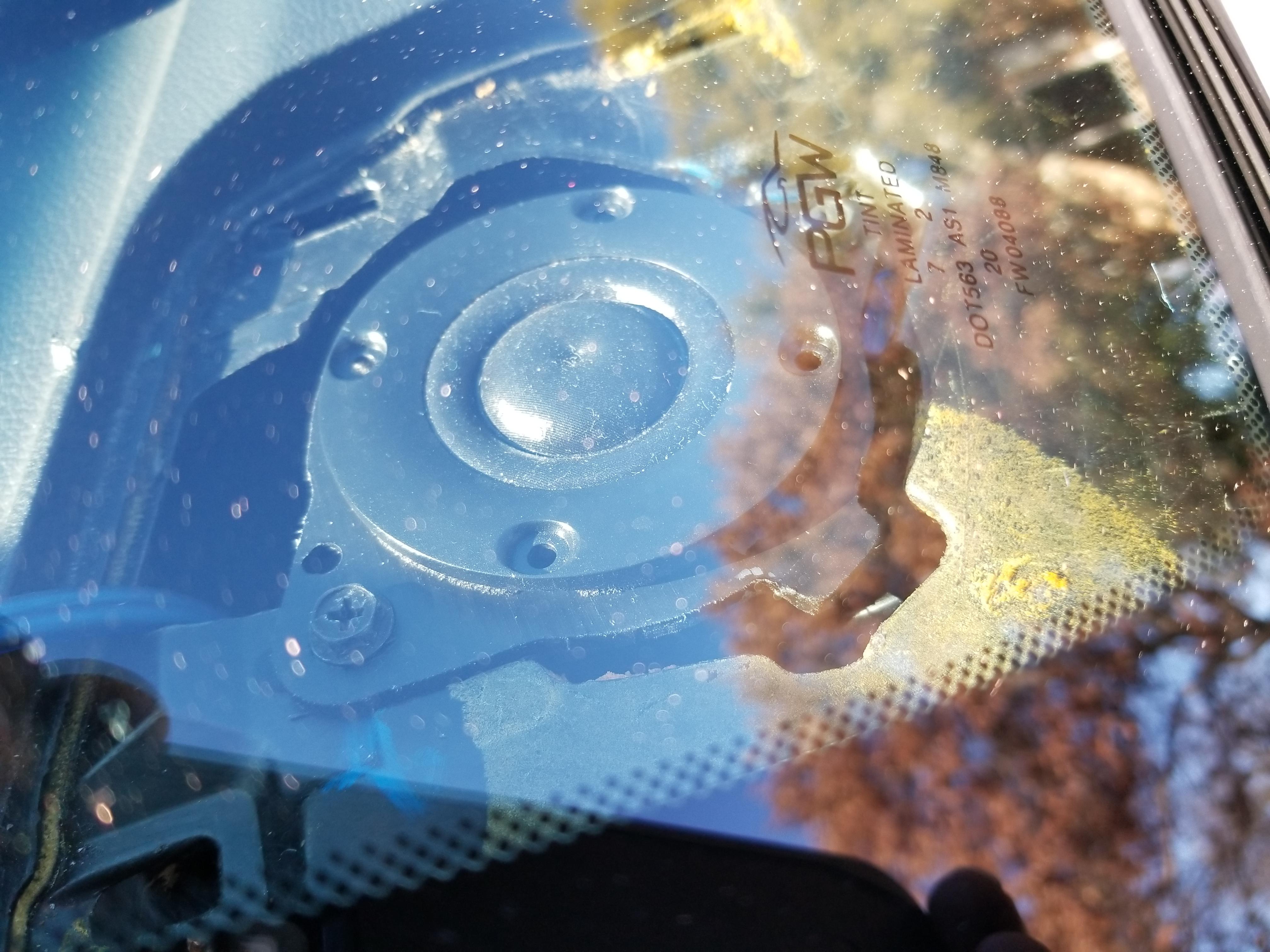

I wrapped the interior panels up since it's taking me longer to put them back together. Need to go buy some sail panels, after cutting into mine. I decided against mounting my tweeters in that location.

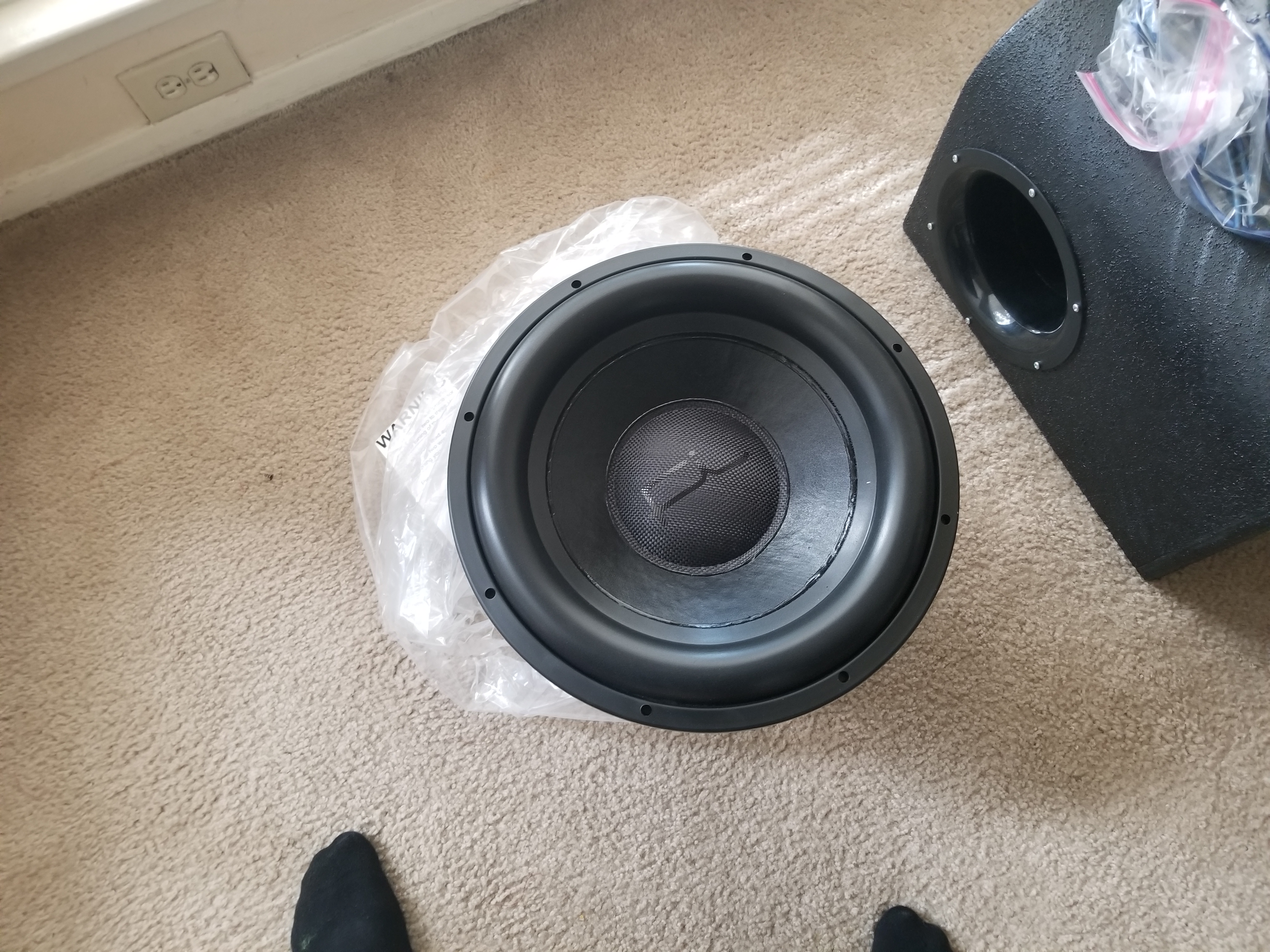

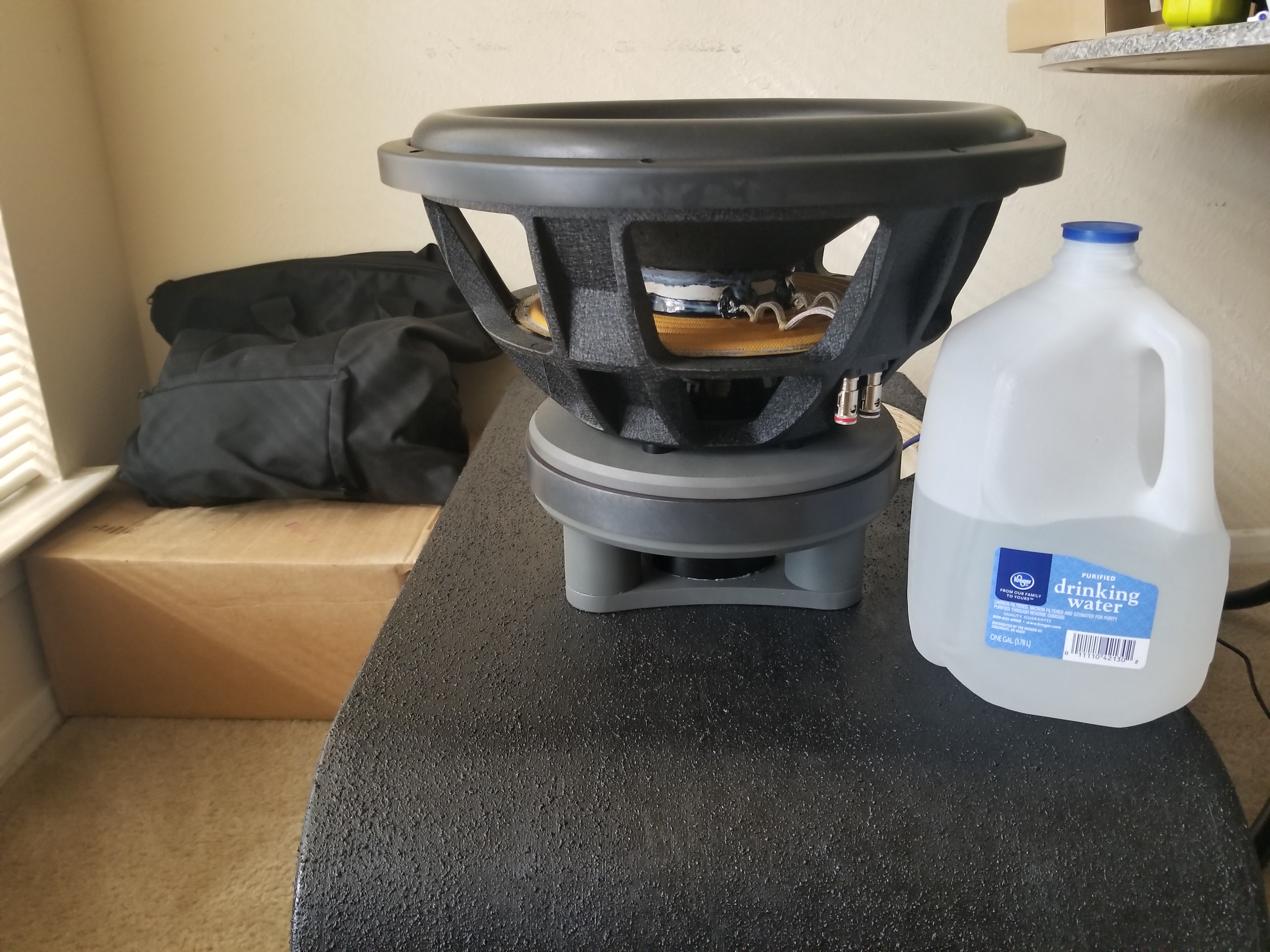

It is just a sitting duck for the moment, rushed to buy the subwoofer in fear of prices rising in the future due to the steel tax hoopla. Need some more equipment first, trying to do the whole install at once but we will see how long that last.

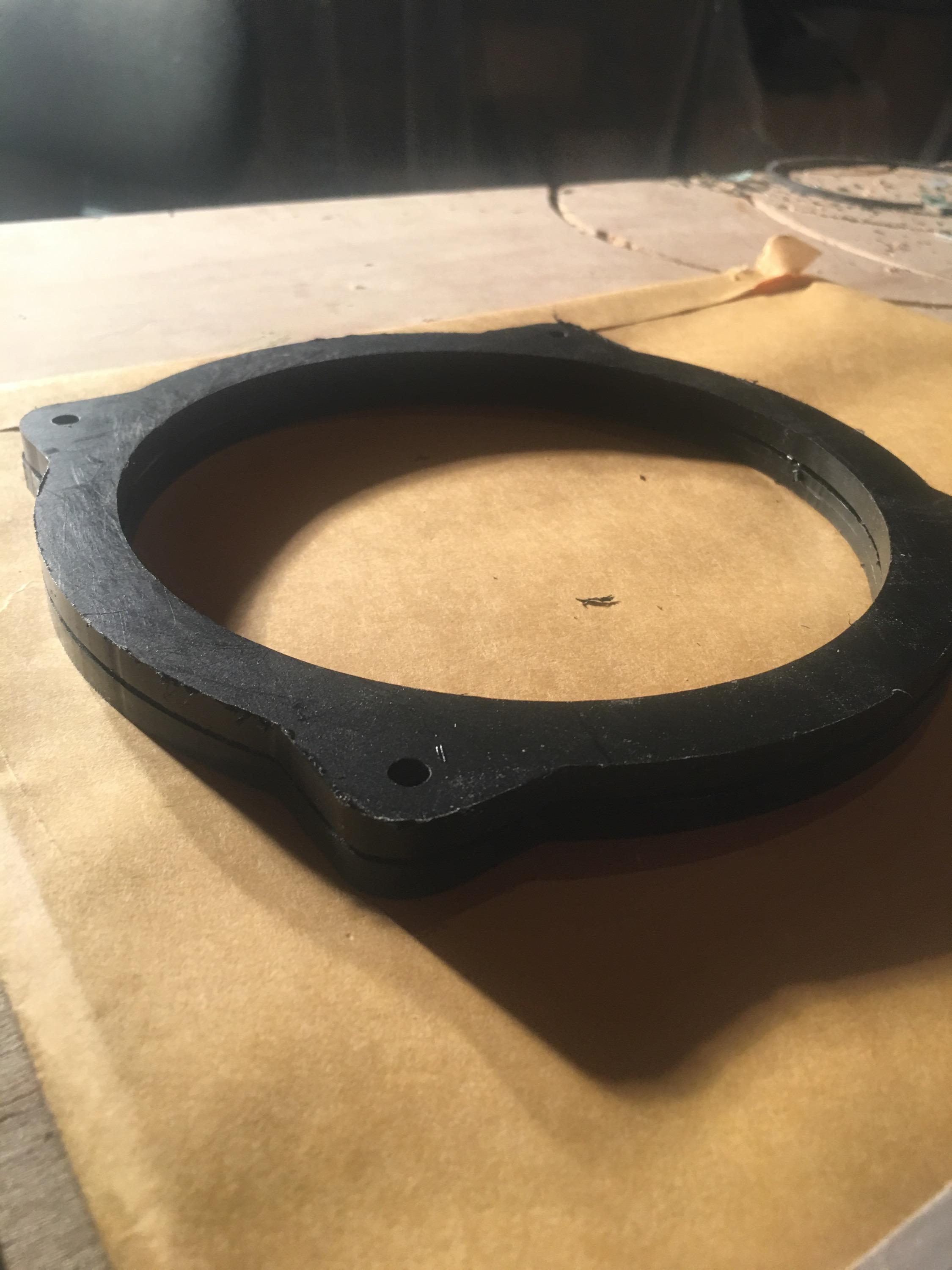

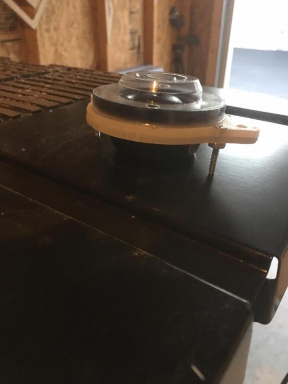

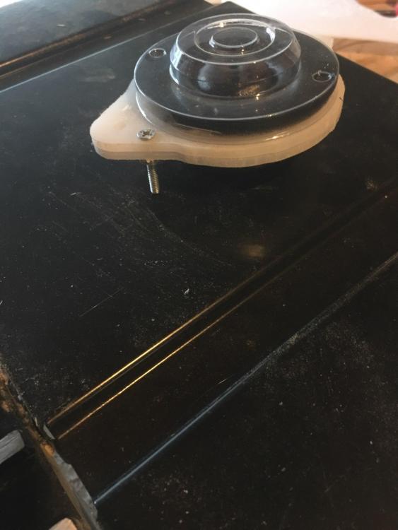

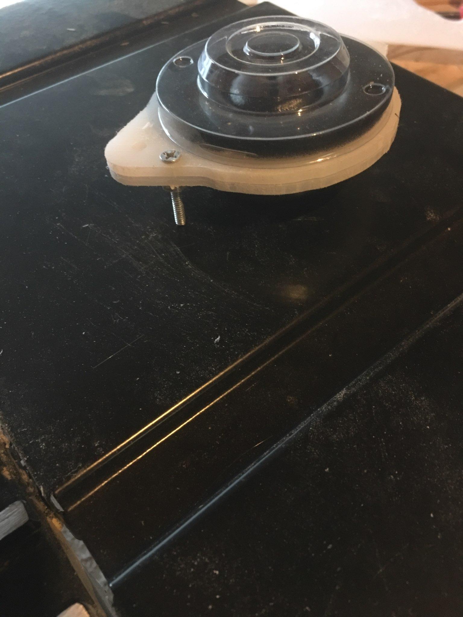

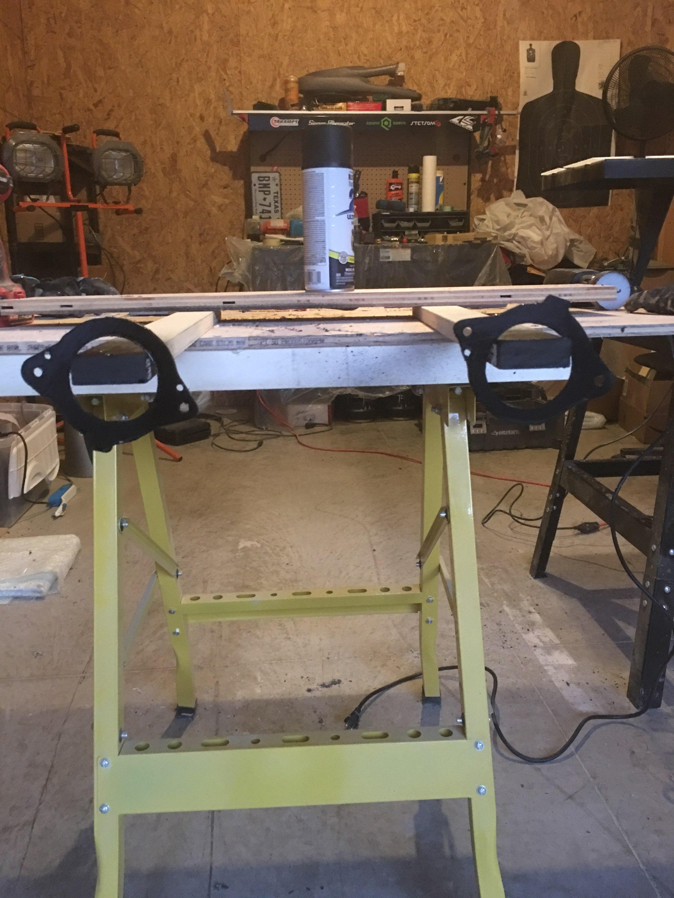

The top speaker rings are for my 6.5" Evil mids being made by a friend. The bottom three pictures are my tweeter rings, had to be painted since the board I bought was white. They will be shipped to me soon and installed.
Edited by jcarter1885

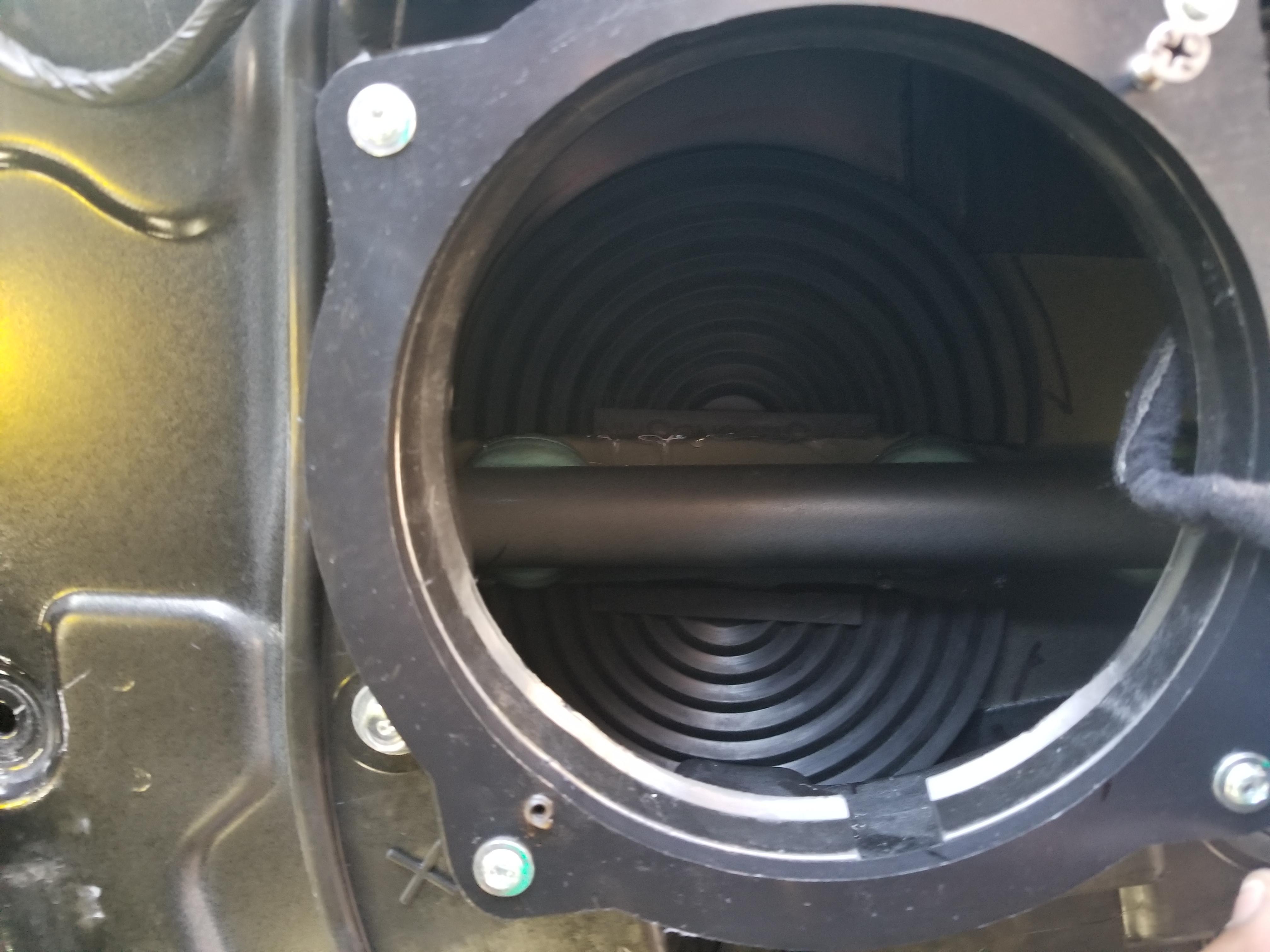

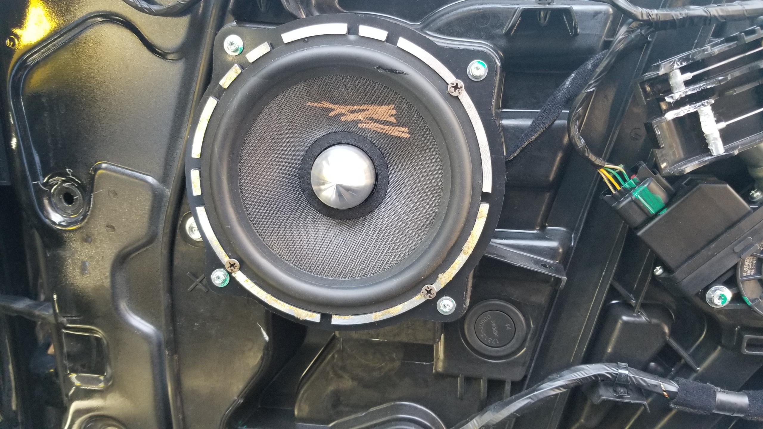

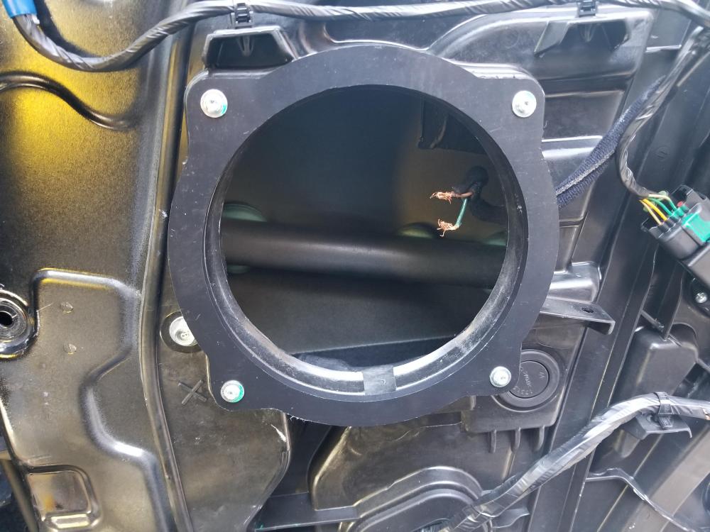

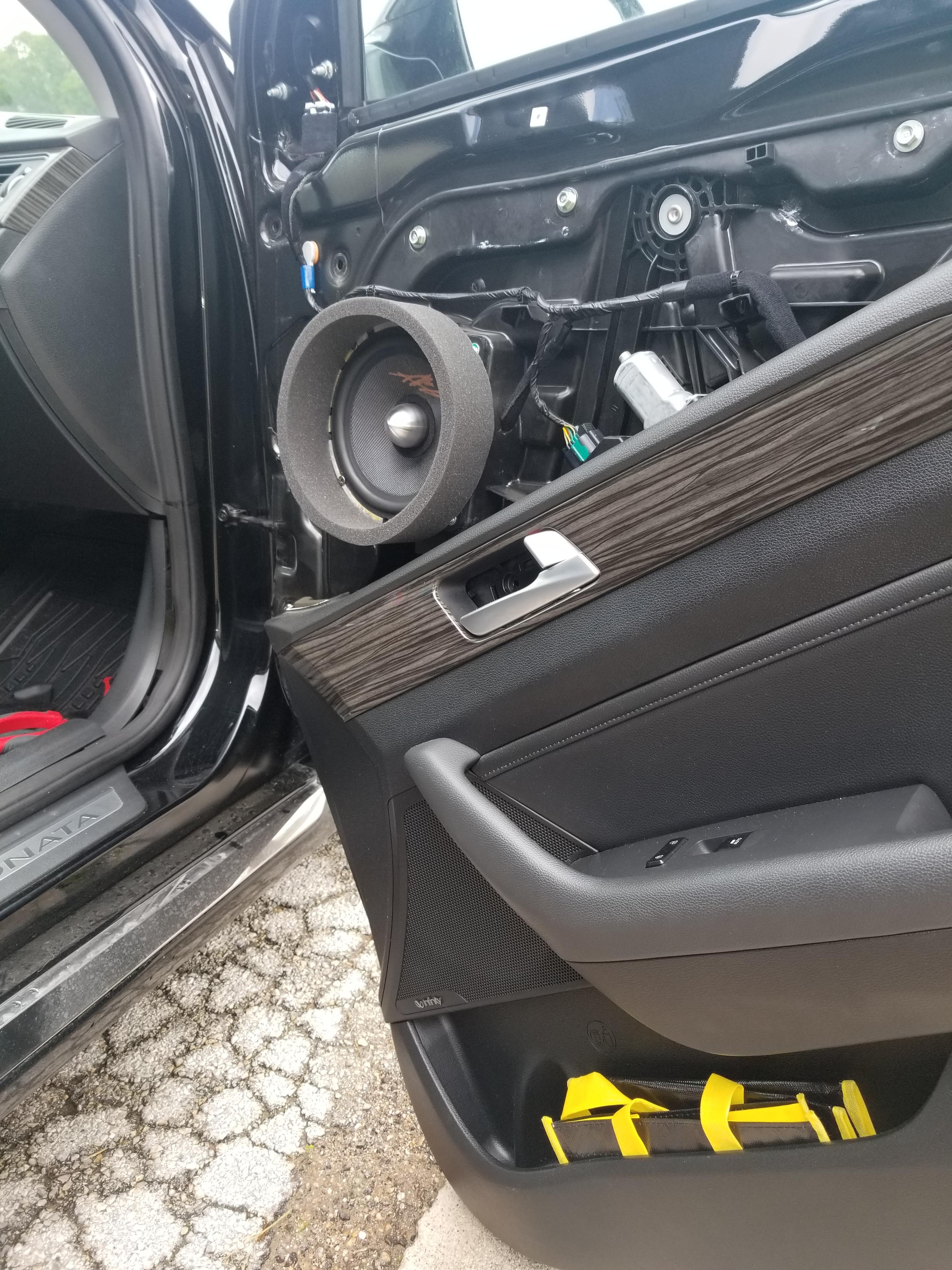

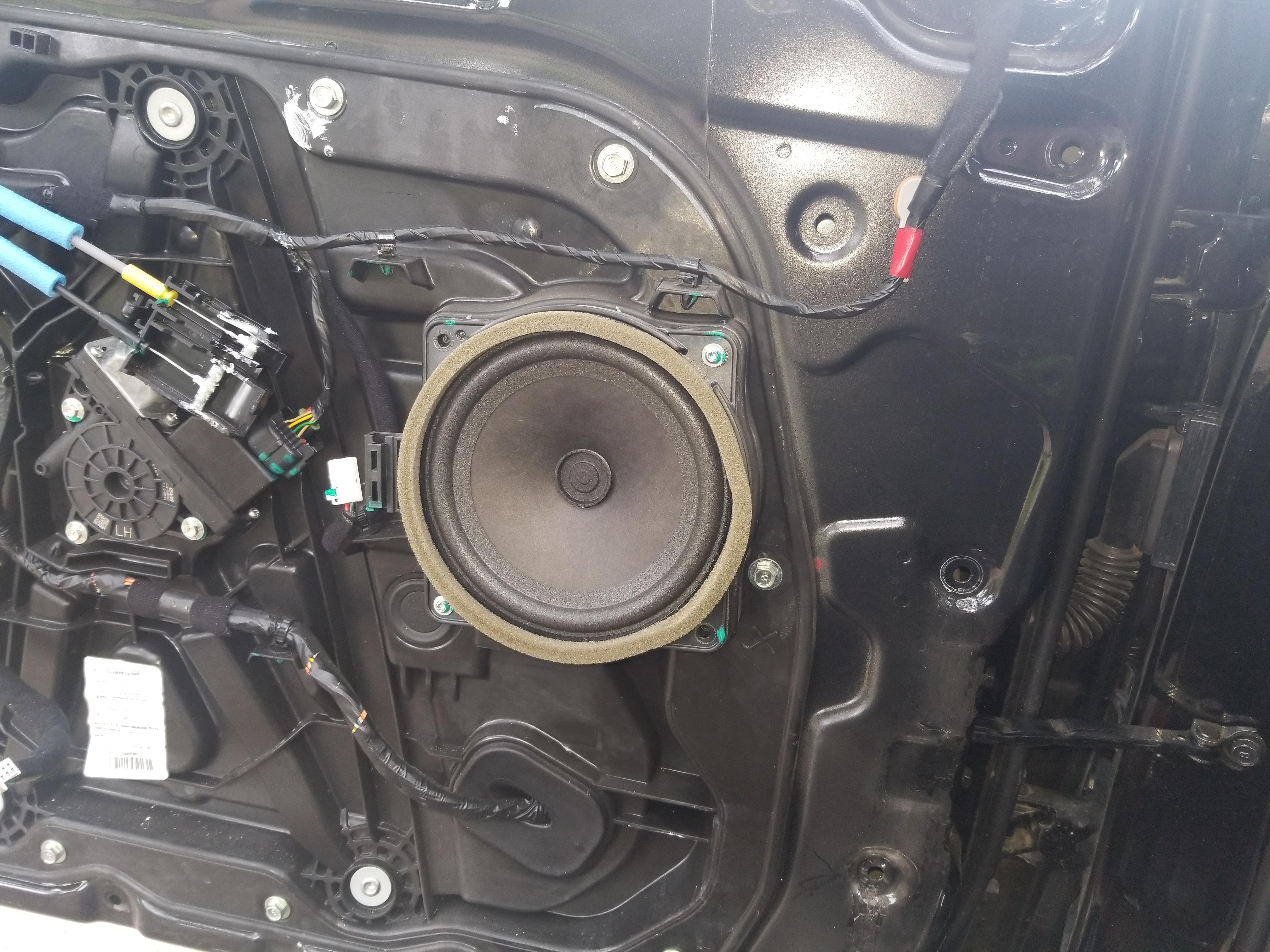

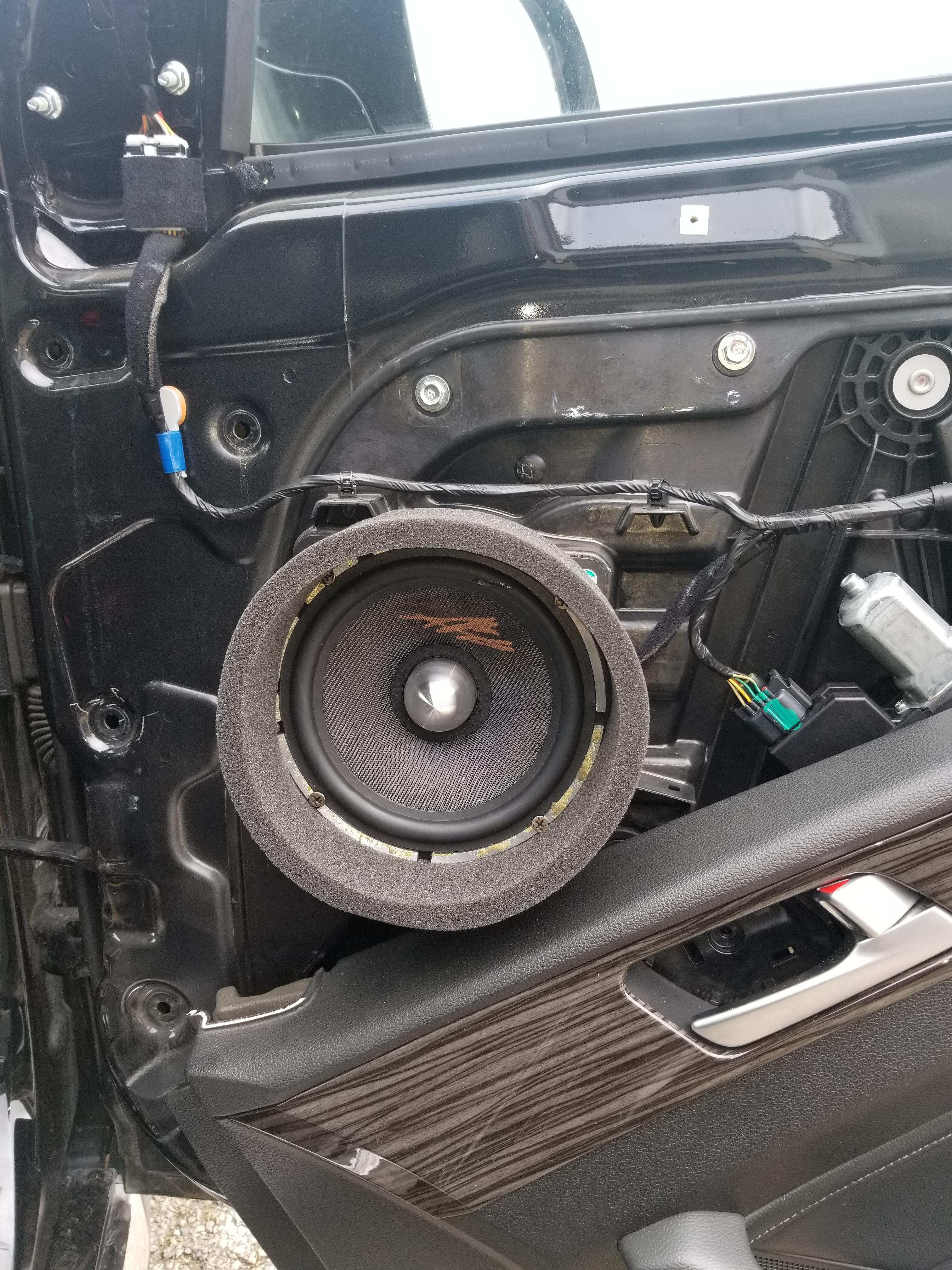

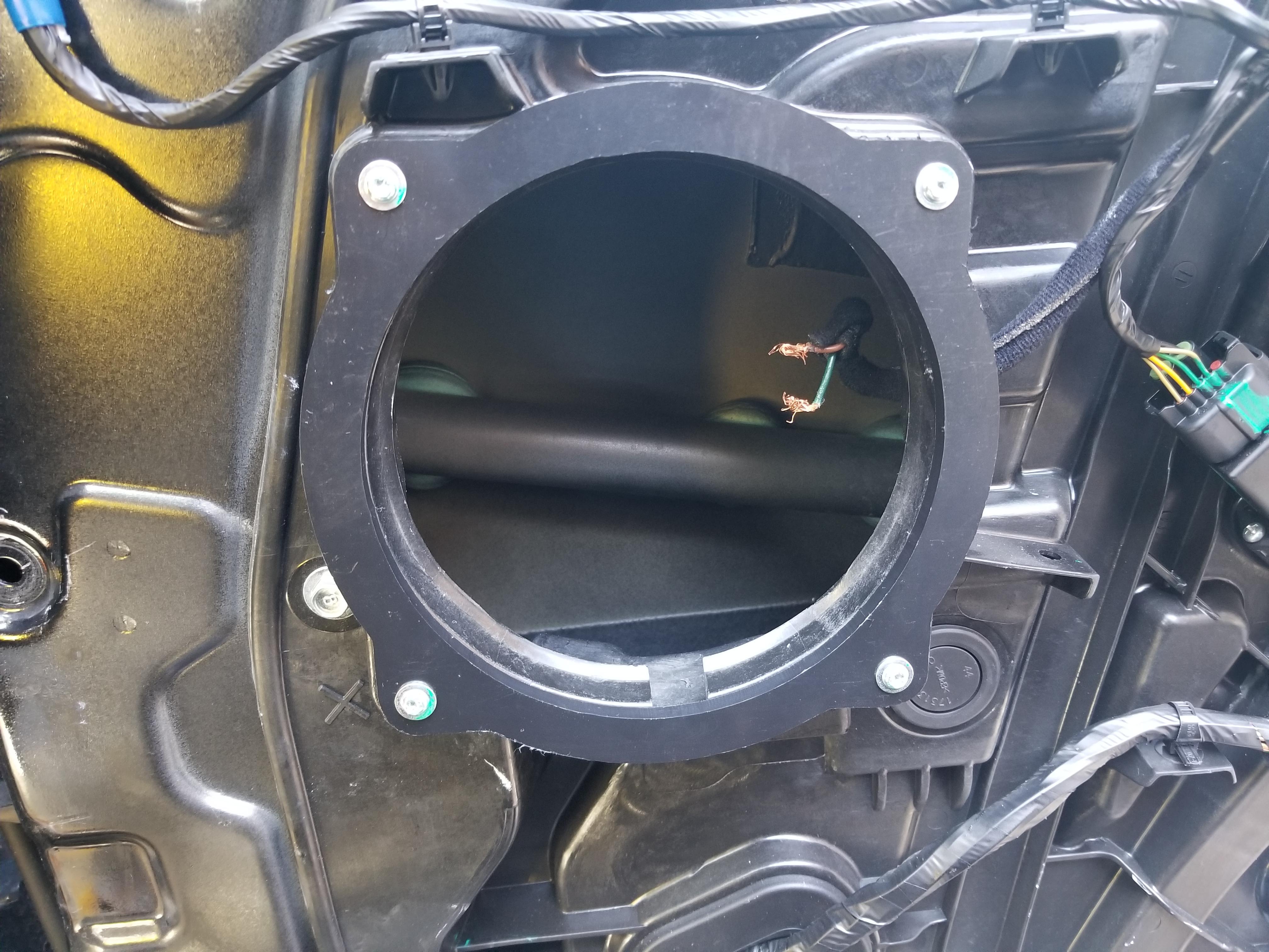

Bored at work so I decided to install my Fast Rings around my SSA Evil 6.5" mids. The amount of midbass these speakers put out in an untreated door is unreal, I had too much panel vibration going in. These rings definitely helped.
Picture Edit

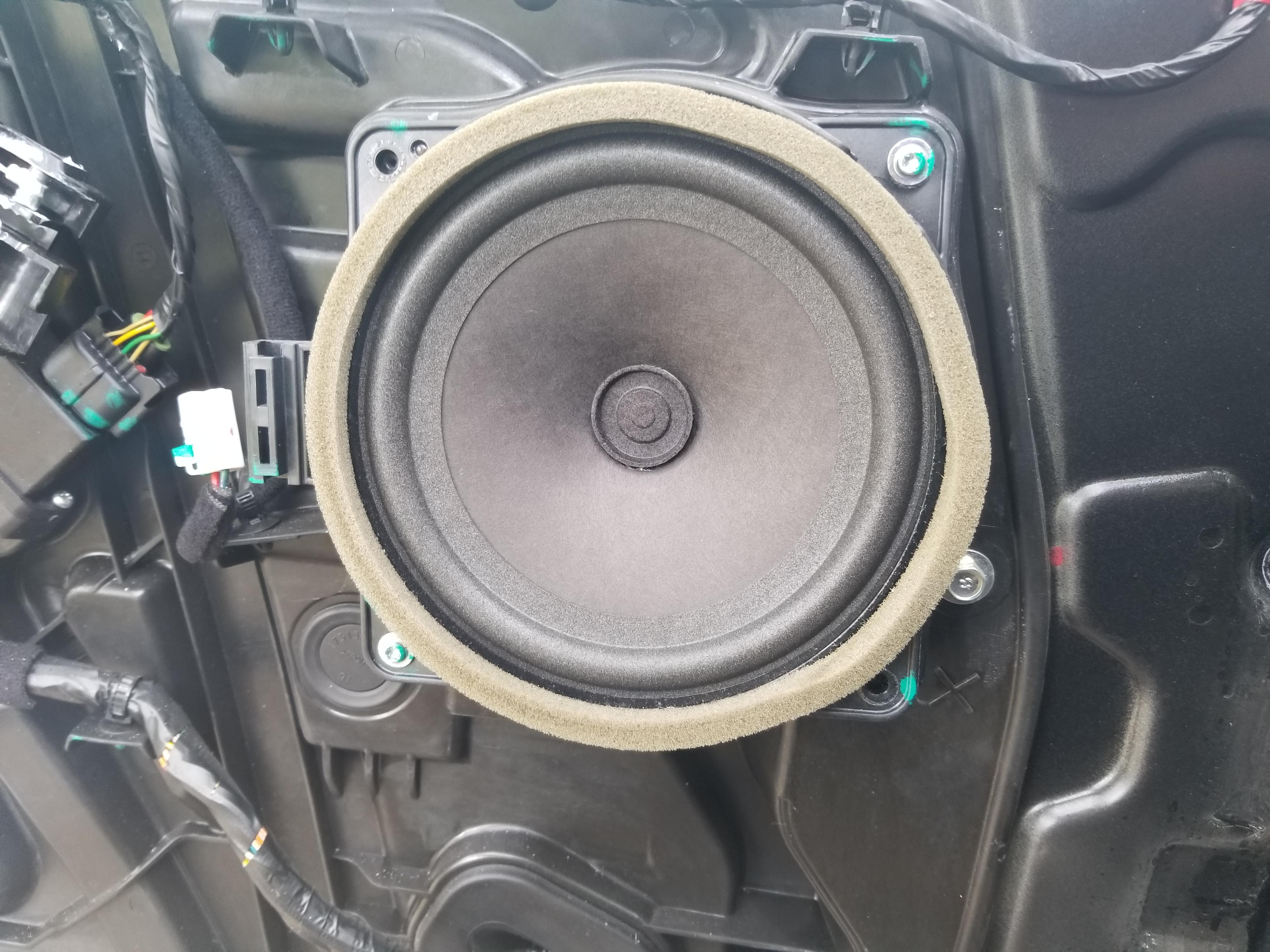

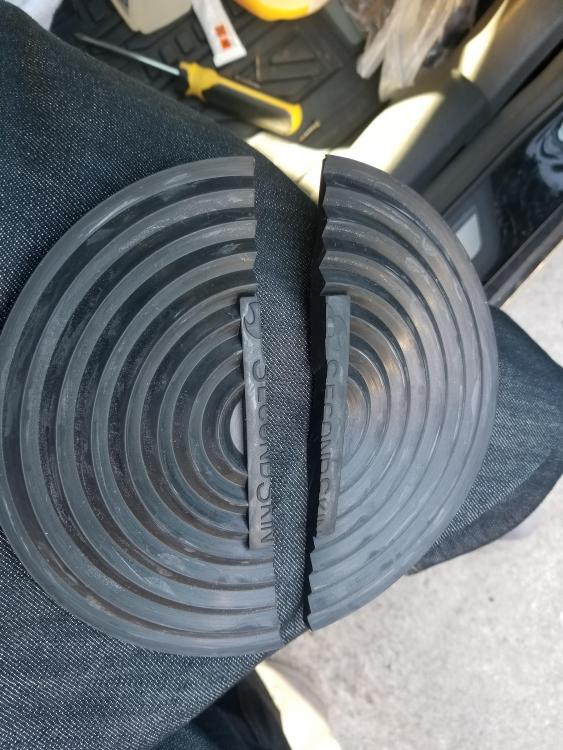

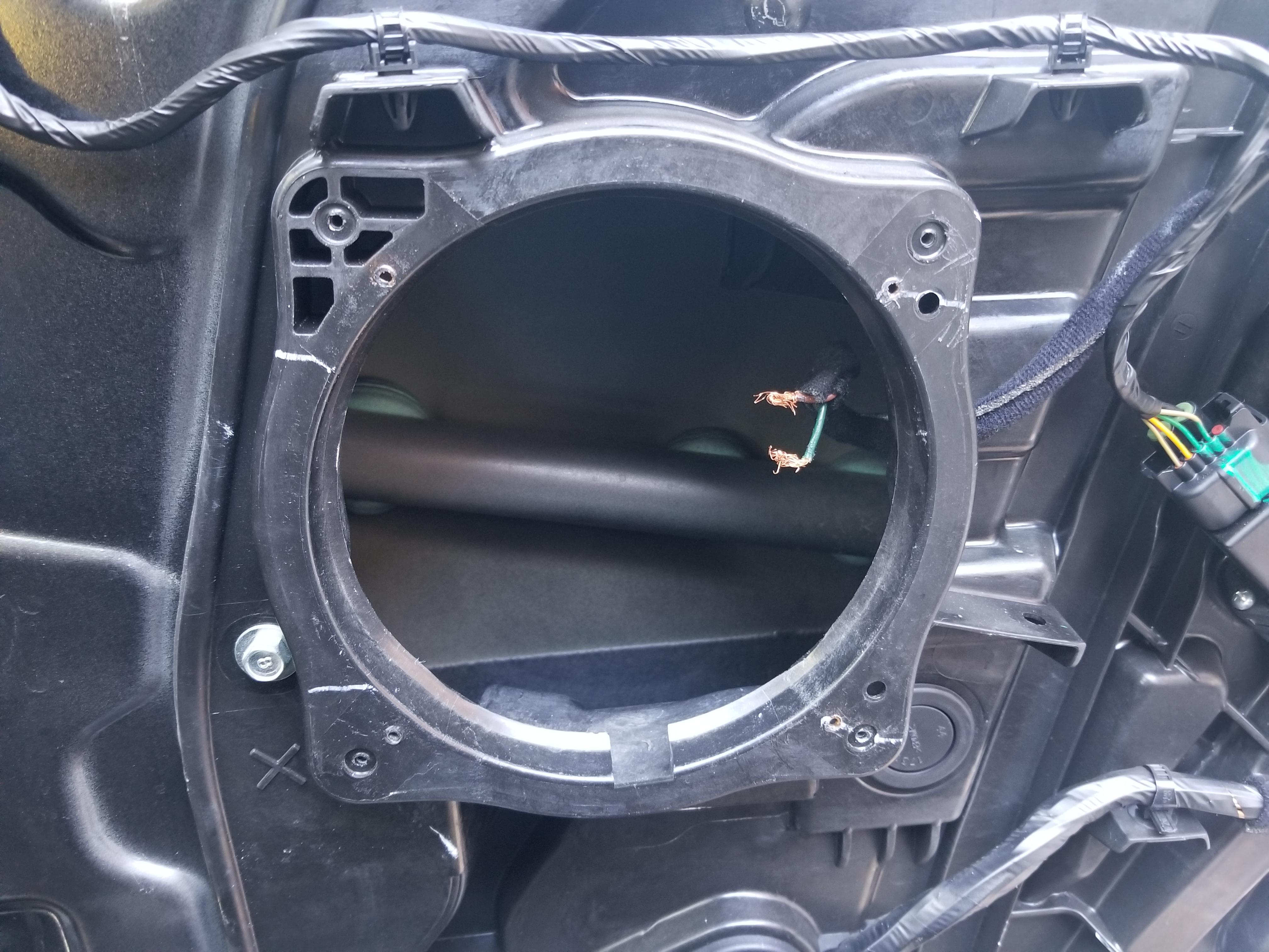

Couldnt get pictures to upload from my phone for a while but they seem to be working now. Installed my speaker rings back when I got them, love the simplicity of them. I also installed my Speaker Tweakers I won a few years ago from Second Skin in a raffle. To apply them I had to cut in half due to the bar on my inner door skin, super glue worked great as advised from Second Skin. Doors themselves need to be treated one day but for now they got a little love to help improve the sound.

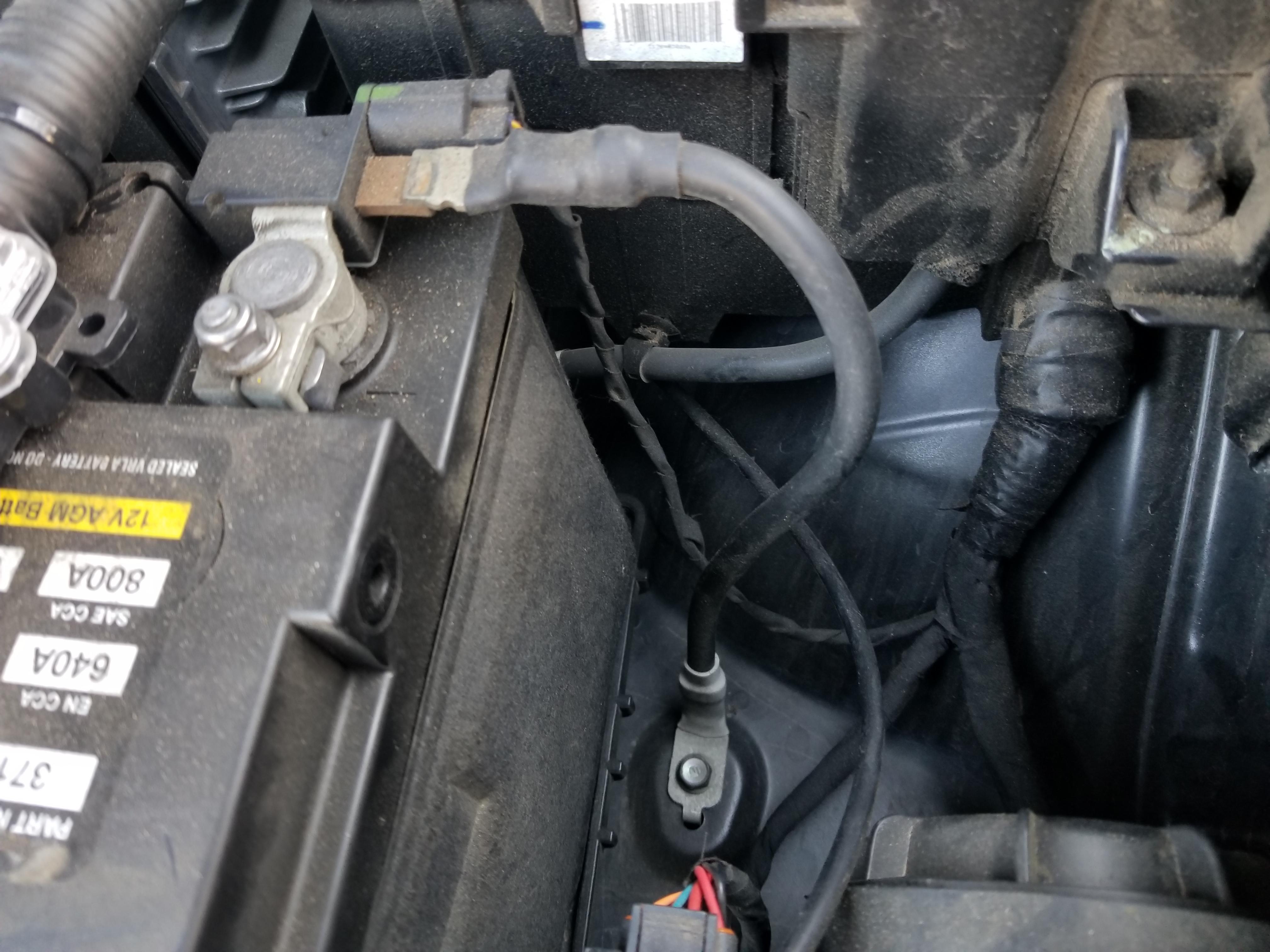

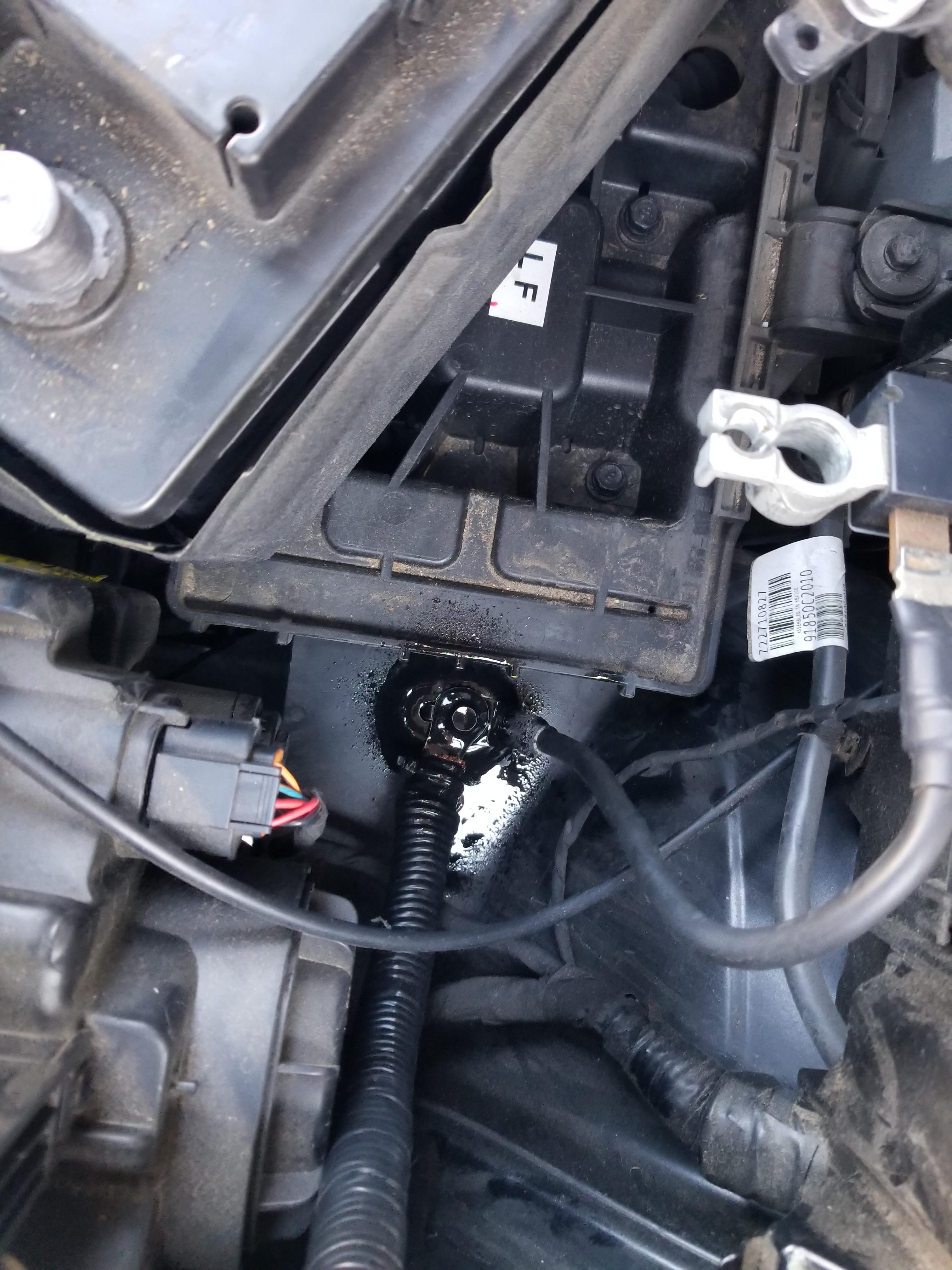

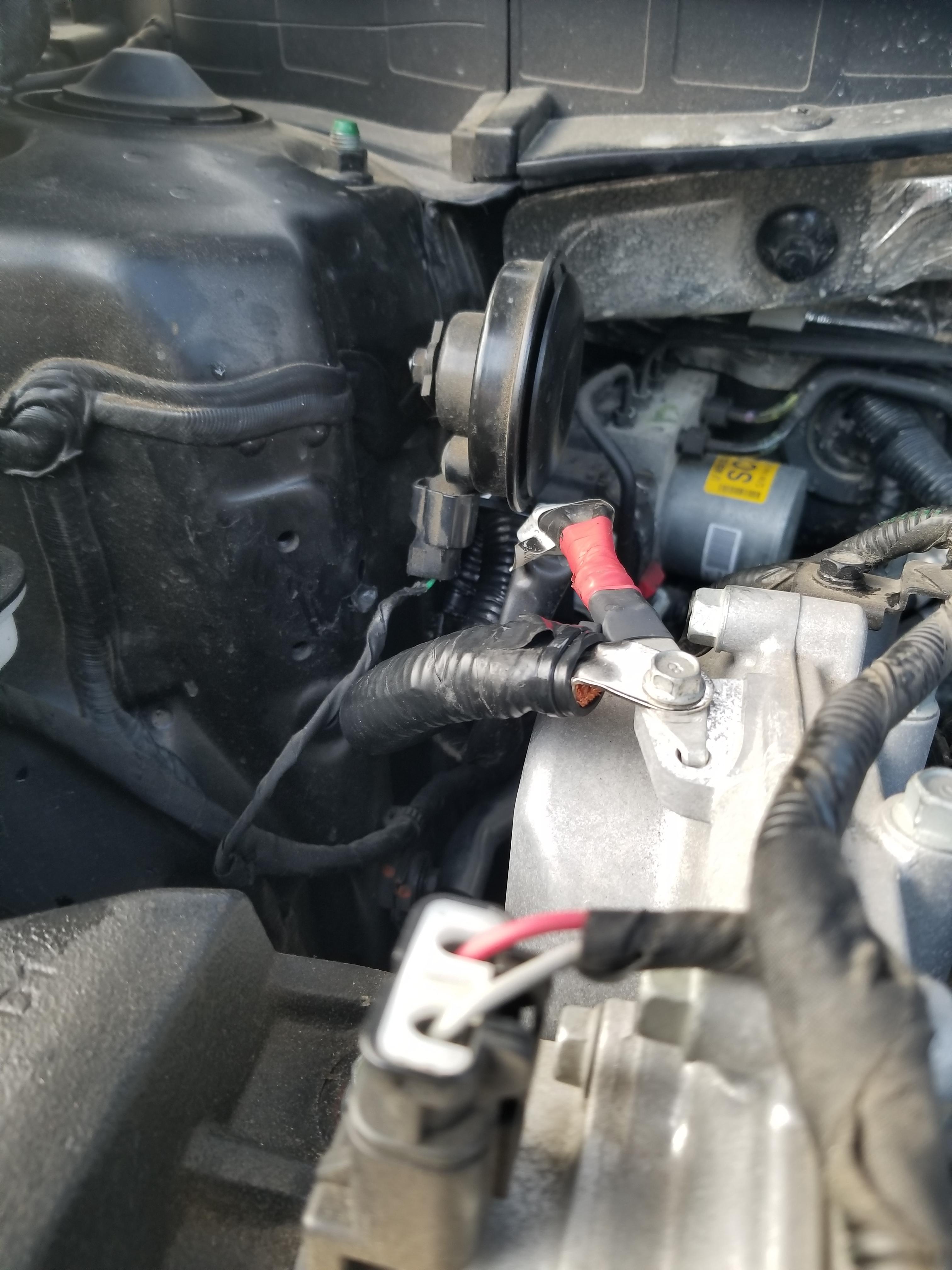

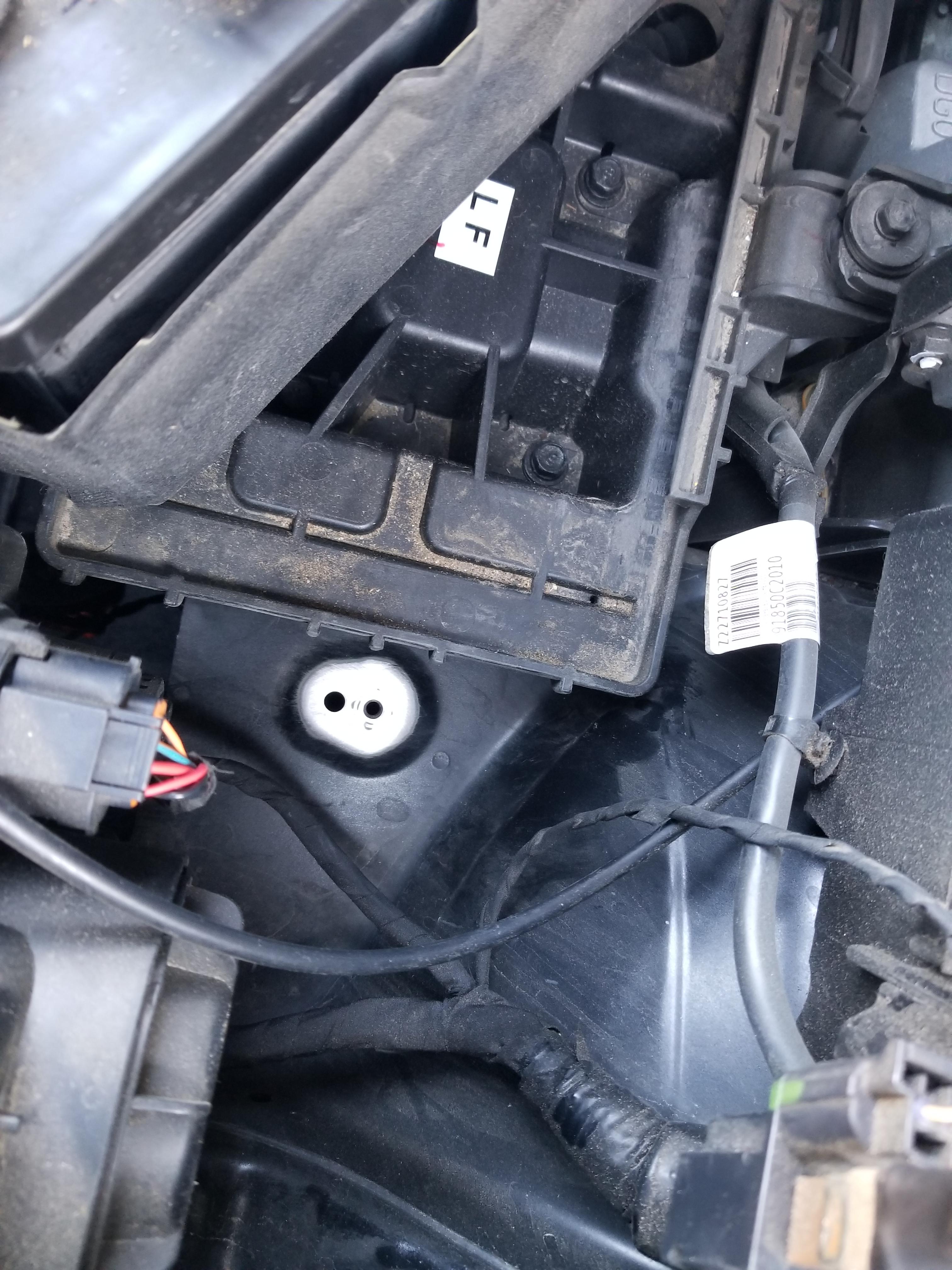

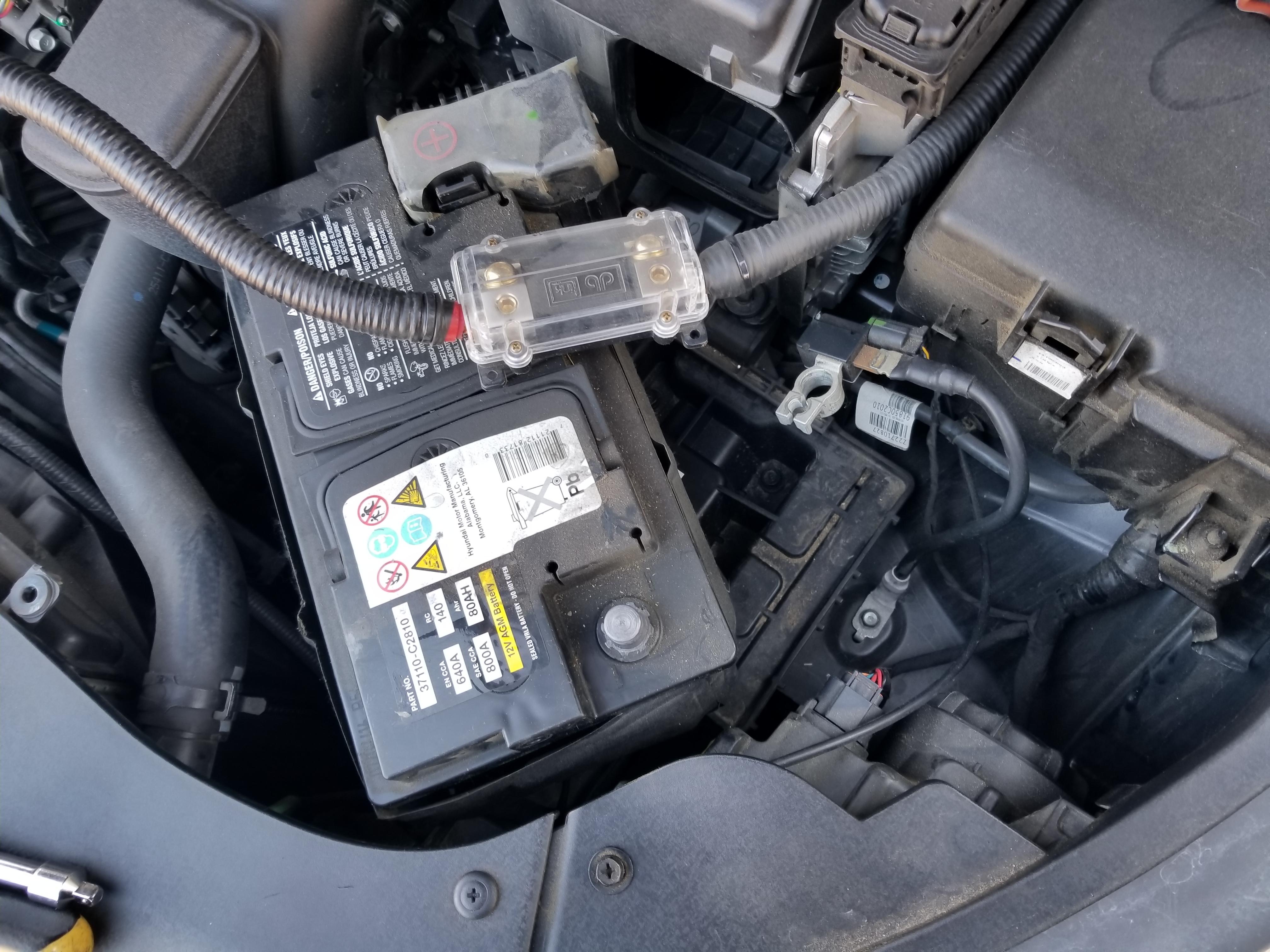

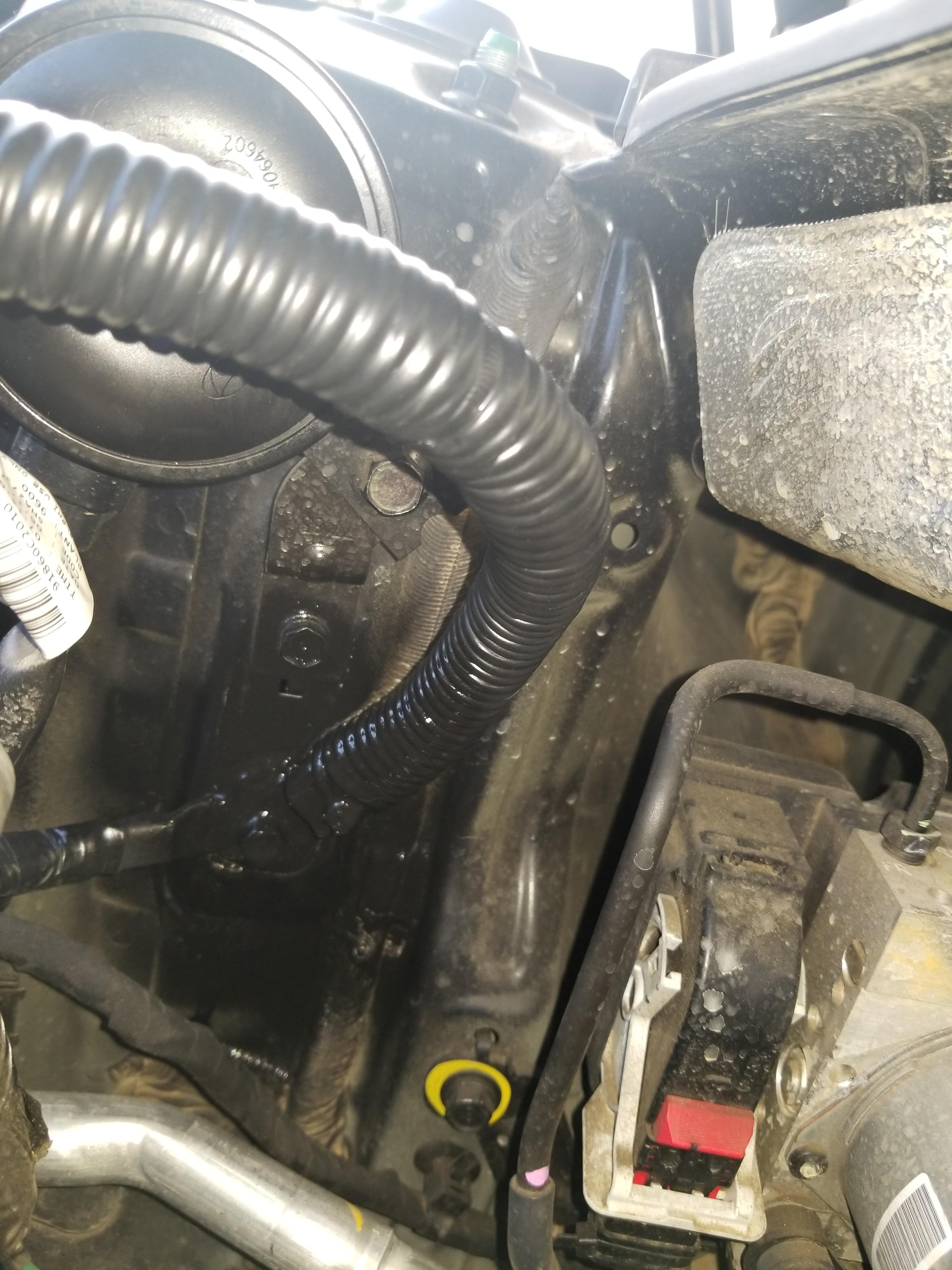

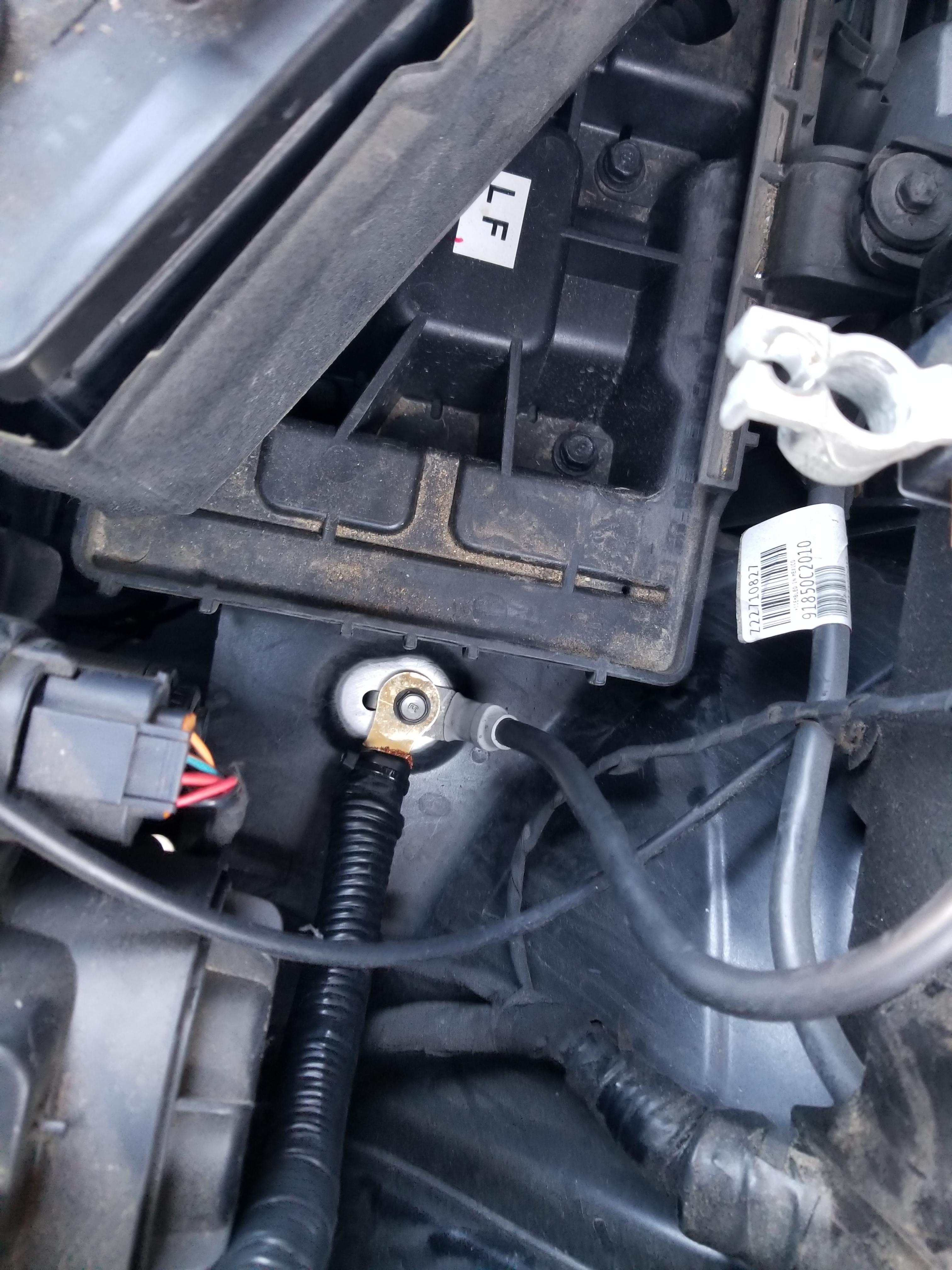

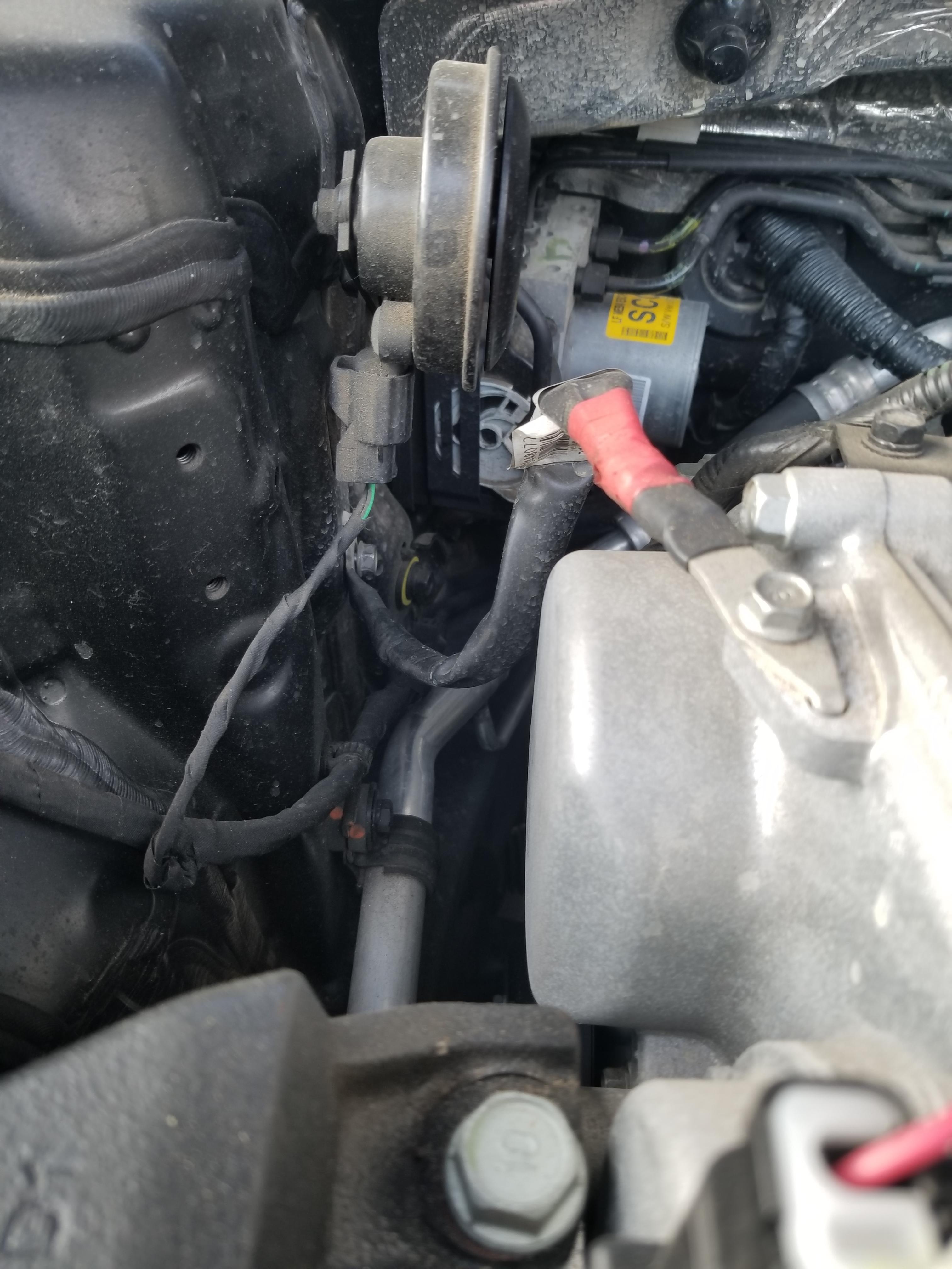

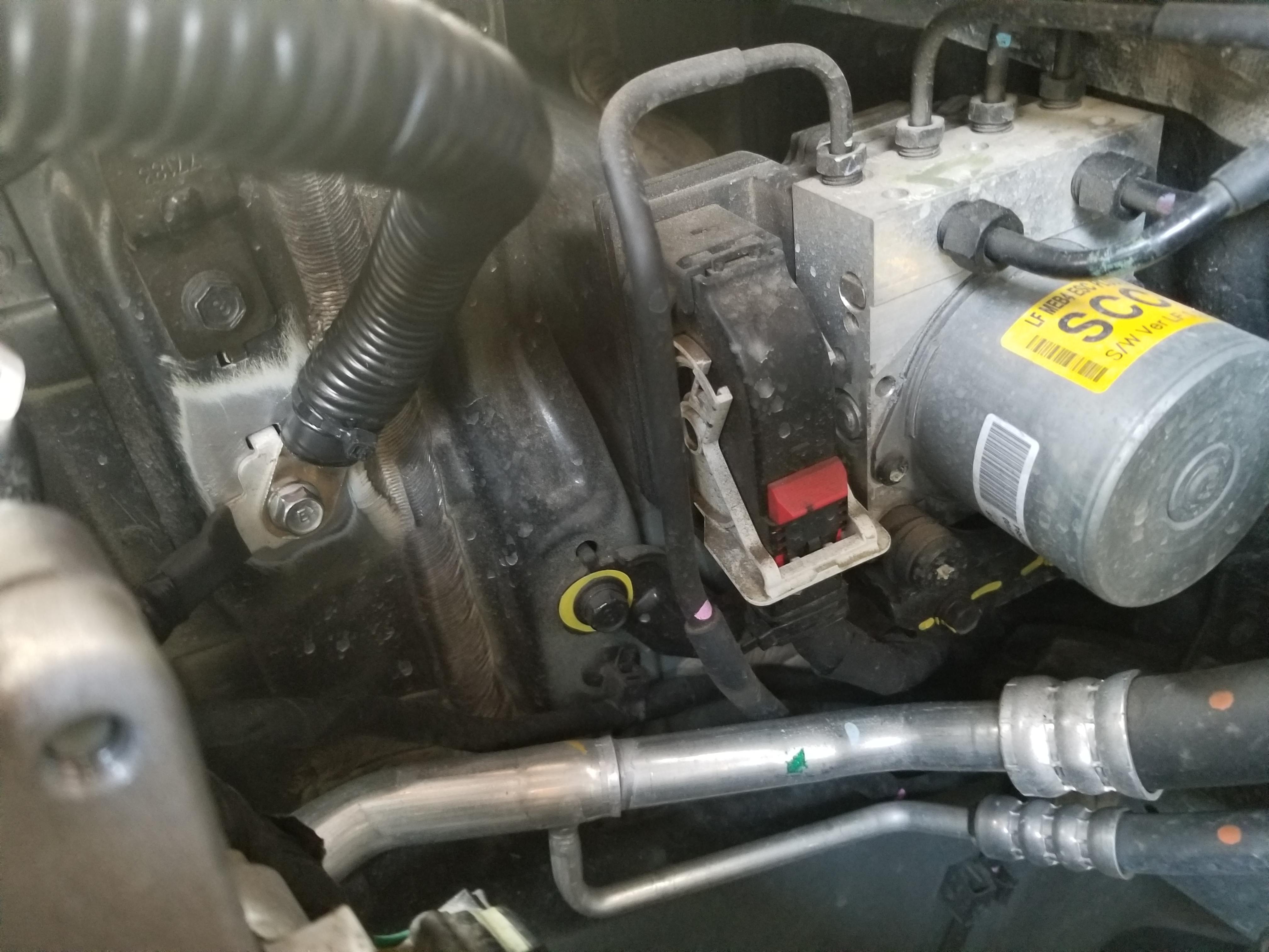

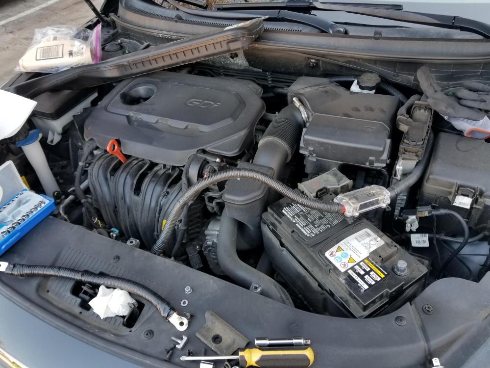

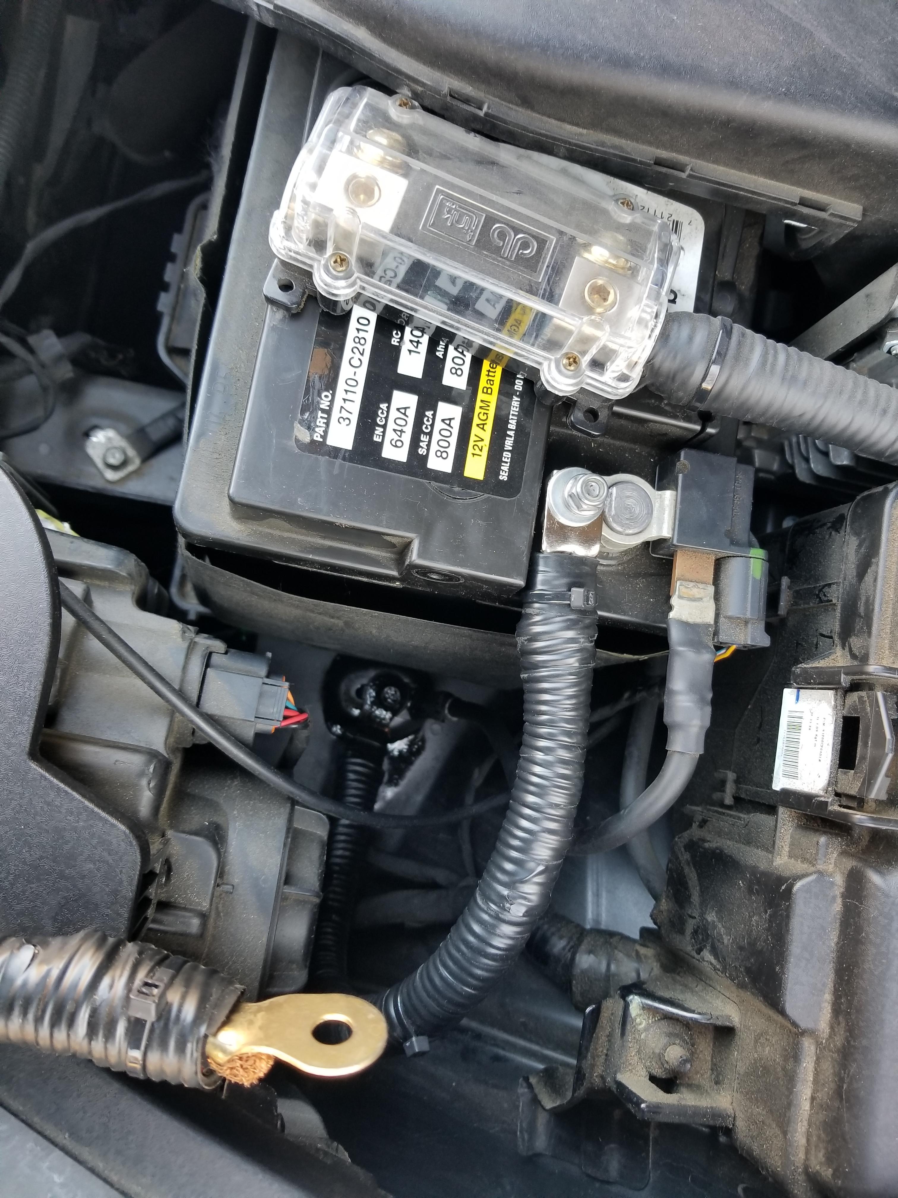

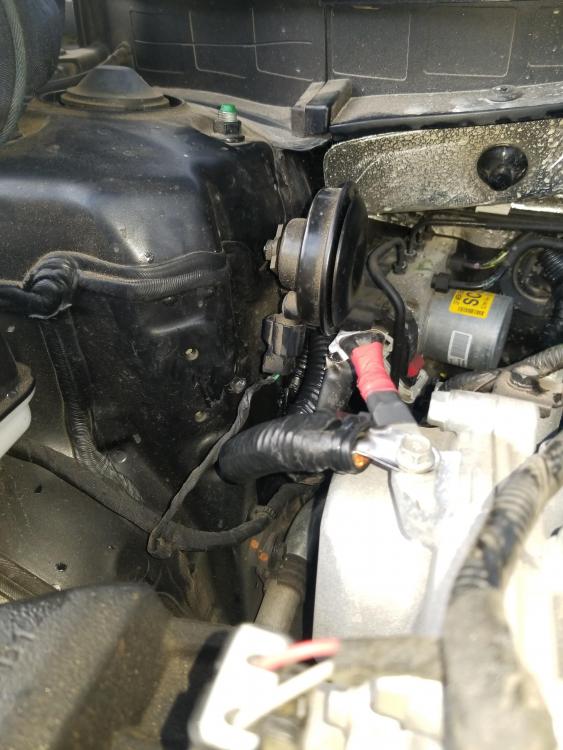

Big 2 done so far:
Battery Negative to Frame/Chassis
Engine Block to Frame/Chassis
I covered all unpainted areas with Plasti-Dip to keep from rusting. If I should use something else then let me know, since Plasti-Dip can be removed. I will wait to do the Power and Negative run to Alternator from battery once I upgrade alternators.

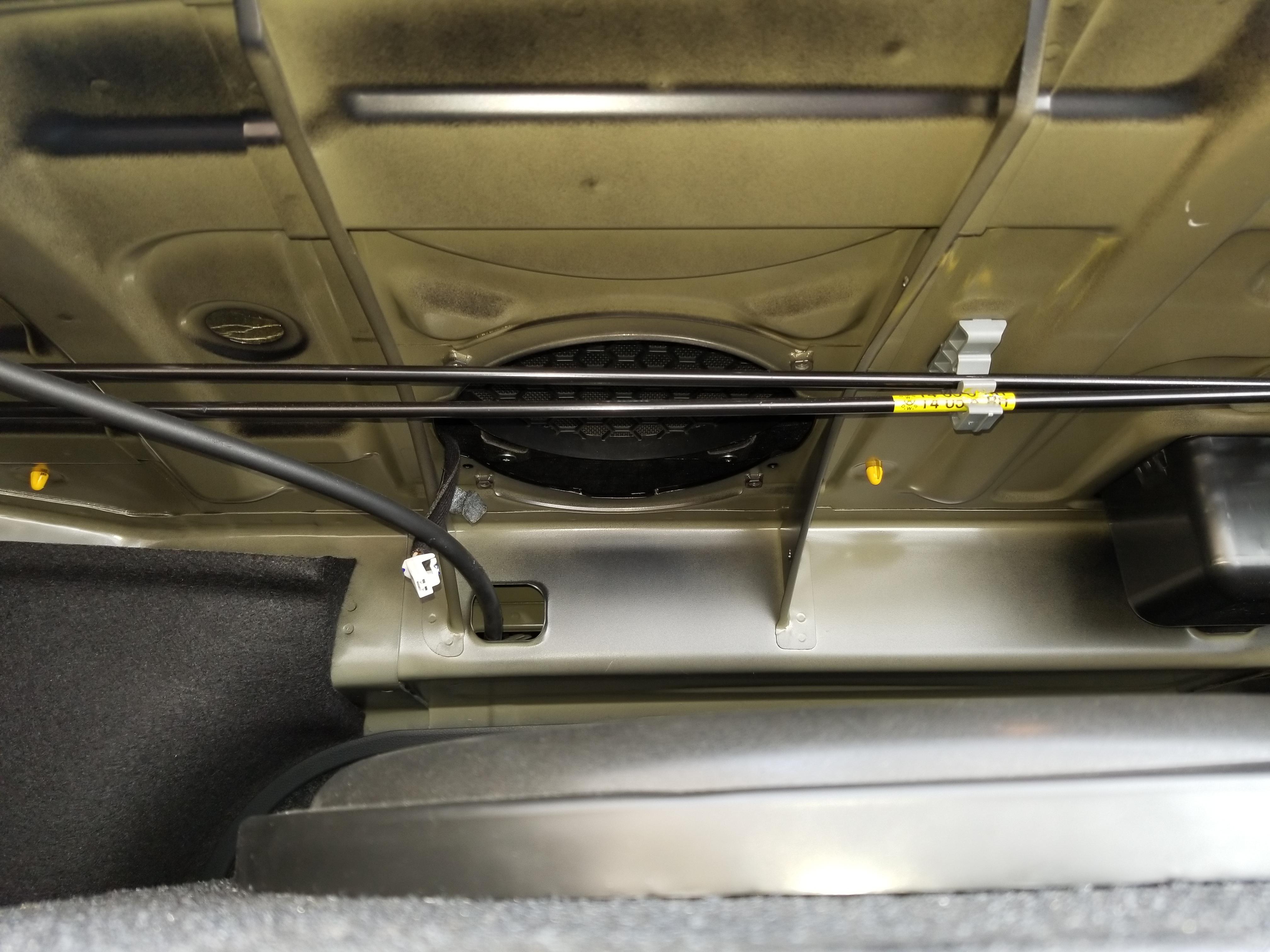

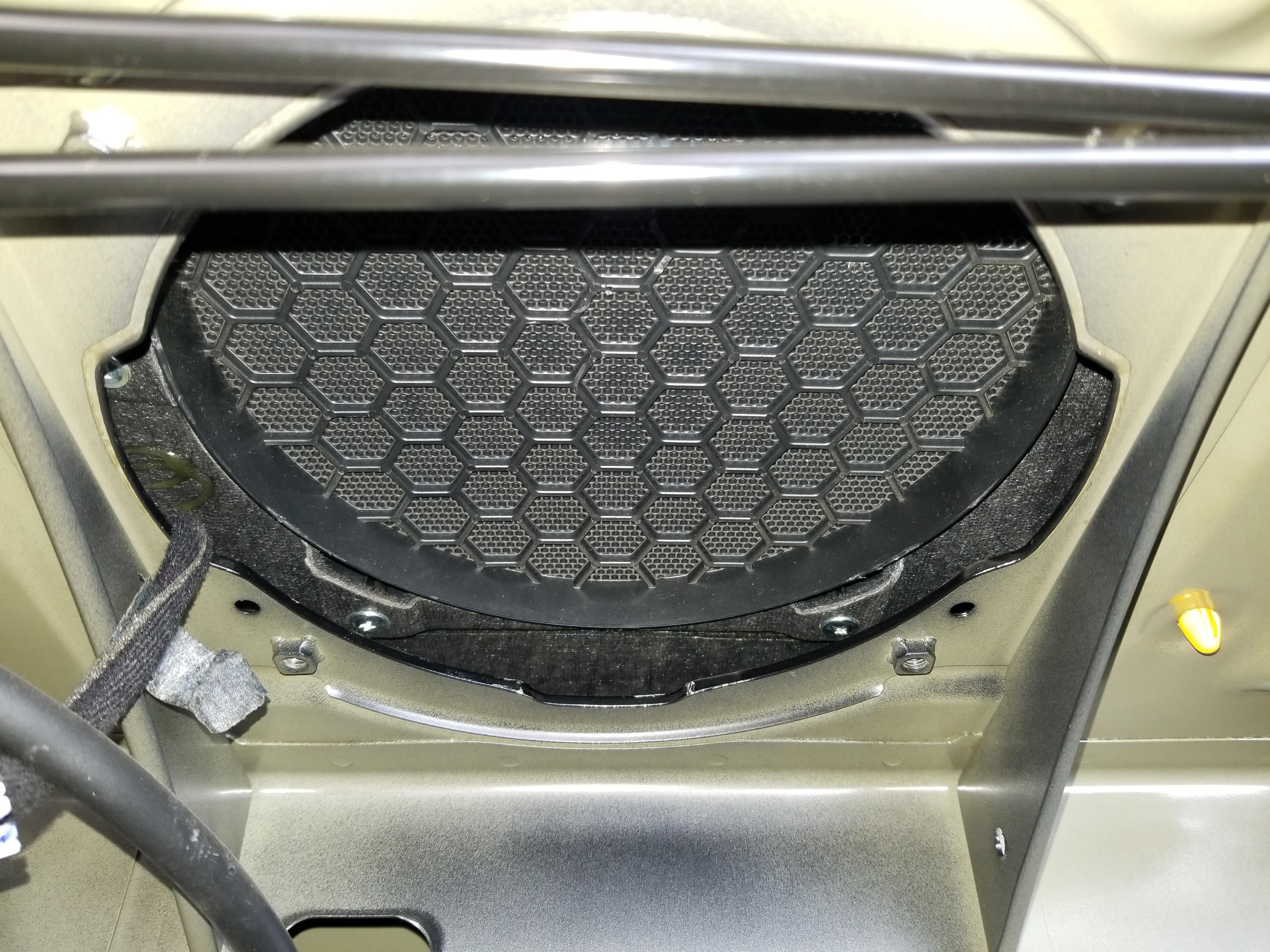

Factory sub delete since it died on me last summer I believe, even though it was subpar I miss the bass.
