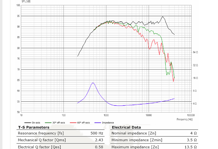

SS Teacher 177 Posted March 9, 2017 21 hours ago, ///M5 said: Ah. I would be more worried about constricting them in too small of an enclosure than aiming them. Venting the enclosure aperiodically may be a way to gain breathing room and might let them play nice below 80Hz. Is the 3kHz just because the driver "can" play that high? Considering the placement of the mids, I'd want the tweeter to play significantly lower than that. Obviously for the time being ignore that statement, but long term the more you get up on the dash the better. I'll measure the volume of the pods FCA uses, but I know they aren't tiny. They might actually be close to the .30 cubic feet recommended by SSA. I just did some research on Aperiodic venting (I vaguely remember that from the 90s), but I don't want to cut up the factory pods unless I have to. I picked 3kHz because I didn't think I could find a 1" tweeter that could much lower than that. 0 Share this post Link to post Share on other sites

///M5 2,833 Posted March 9, 2017 2 hours ago, SS Teacher said: I picked 3kHz because I didn't think I could find a 1" tweeter that could much lower than that. I've run my Scan Speaks down to 1200Hz at quite high volumes. Going below 3k should be no problem 0 Share this post Link to post Share on other sites
SS Teacher 177 Posted March 10, 2017 I'm obviously no expert, but it looks like this ScanSpeak Limited Edition D2604/8320-02 1" Textile Dome Tweeter has an fs of 500 hz, 100 watts of power handling, and relatively flat frequency response all the way down to 1000 hz on axis. This appears to be a very good match with the SSA Evil mids unless I'm missing something. Opinions? 1 Share this post Link to post Share on other sites
///M5 2,833 Posted March 10, 2017 5 hours ago, SS Teacher said: I'm obviously no expert, but it looks like this ScanSpeak Limited Edition D2604/8320-02 1" Textile Dome Tweeter has an fs of 500 hz, 100 watts of power handling, and relatively flat frequency response all the way down to 1000 hz on axis. This appears to be a very good match with the SSA Evil mids unless I'm missing something. Opinions? Tweeters with balls are easy to implement with anything...but it doesn't always mean they will mate the best. Install what you have, let's conquer making them sound as good as they can and then move forward wtih a replacement based on what they don't do well. The Evil tweeter should dig pretty low too and there are others. I run a Scan D2904/60001 but they are uber expensive and while awesome arent' worth the price for an in car installation. 1 Share this post Link to post Share on other sites
