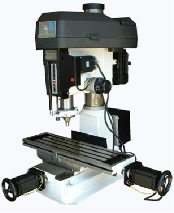

looks like you need a milling machine/ bridgeport lol!!
